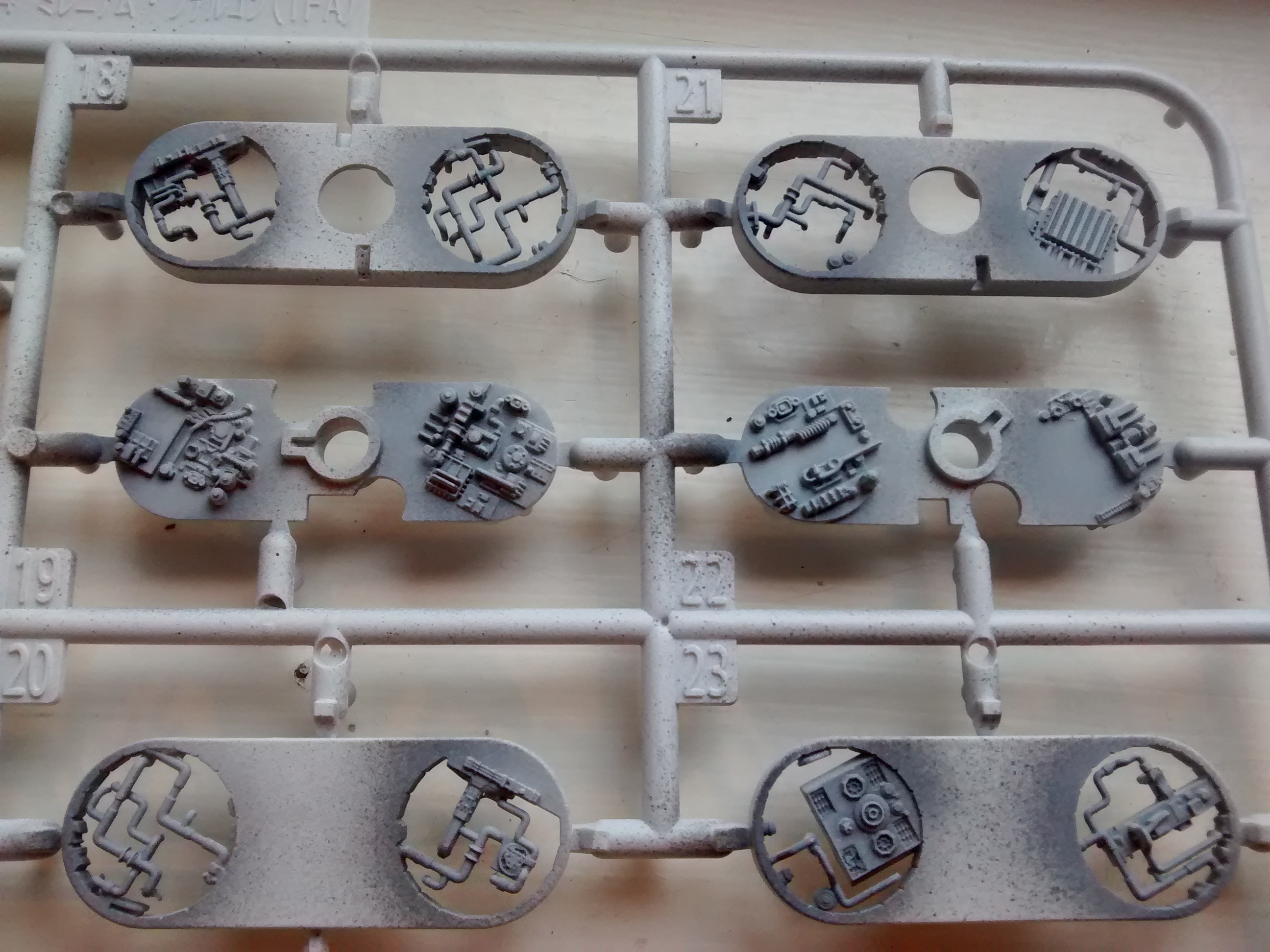

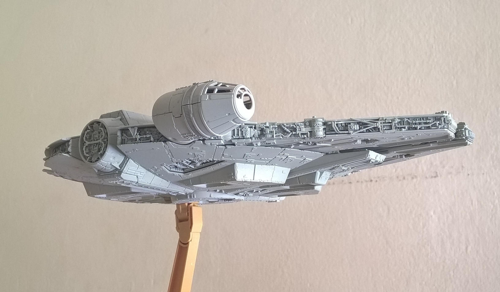

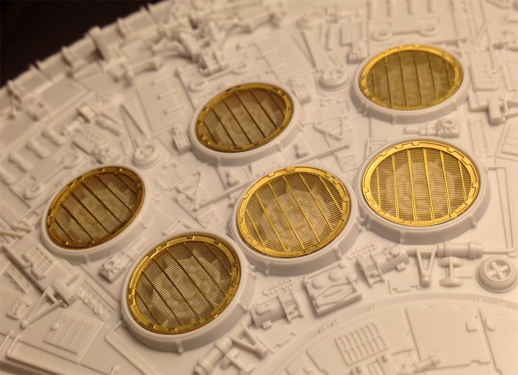

Small progress while I wait for paint to come in stock and 3D parts to arrive. Here are all six grills test fitted. The outer ring angles are a bit approximate (so hard to get 100% with superglue). The thick bars are slightly off on one, but you can't see that with the naked eye so I'm happy the others all seem to line up under magnification!

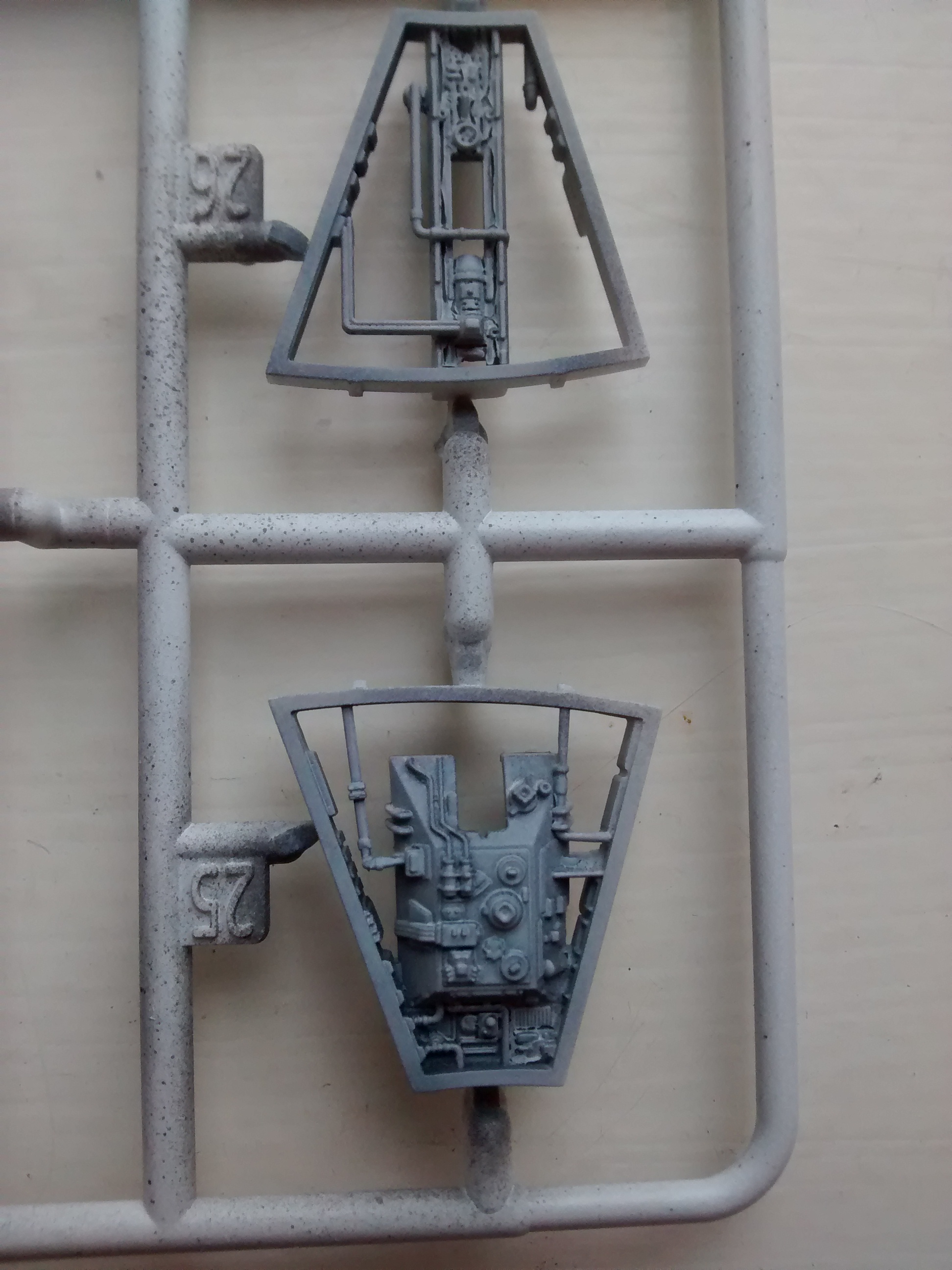

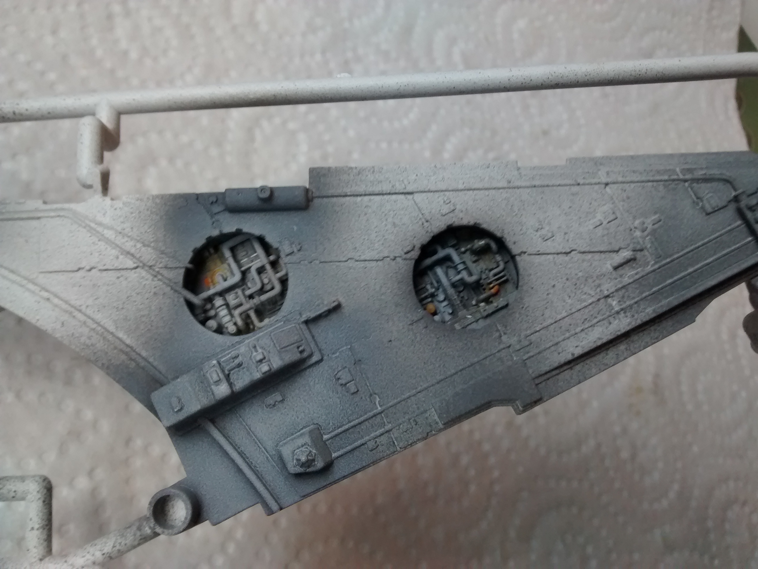

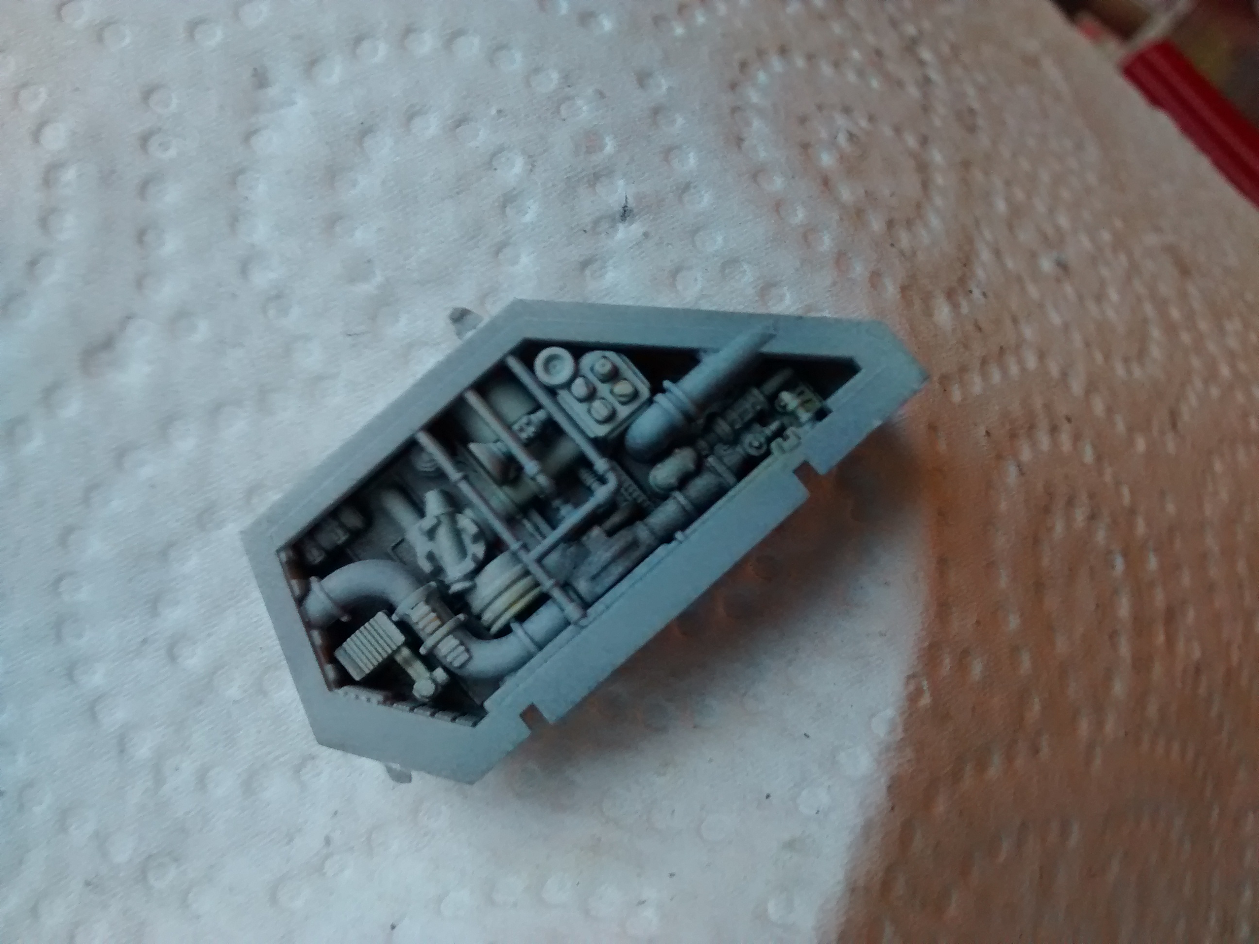

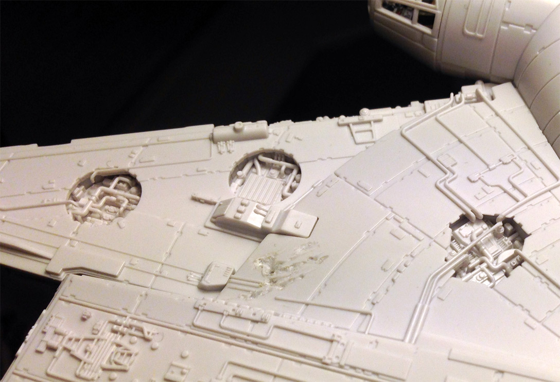

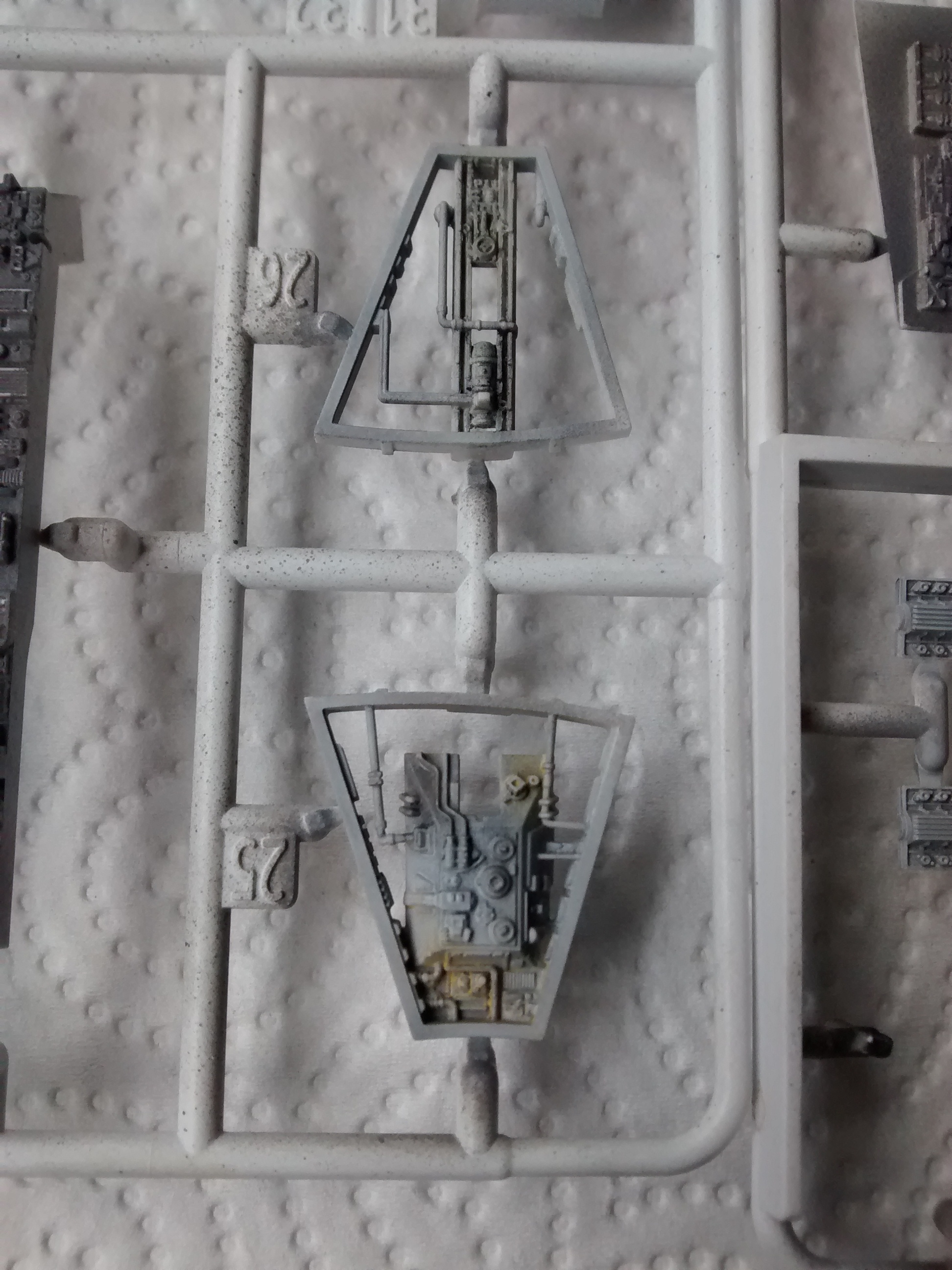

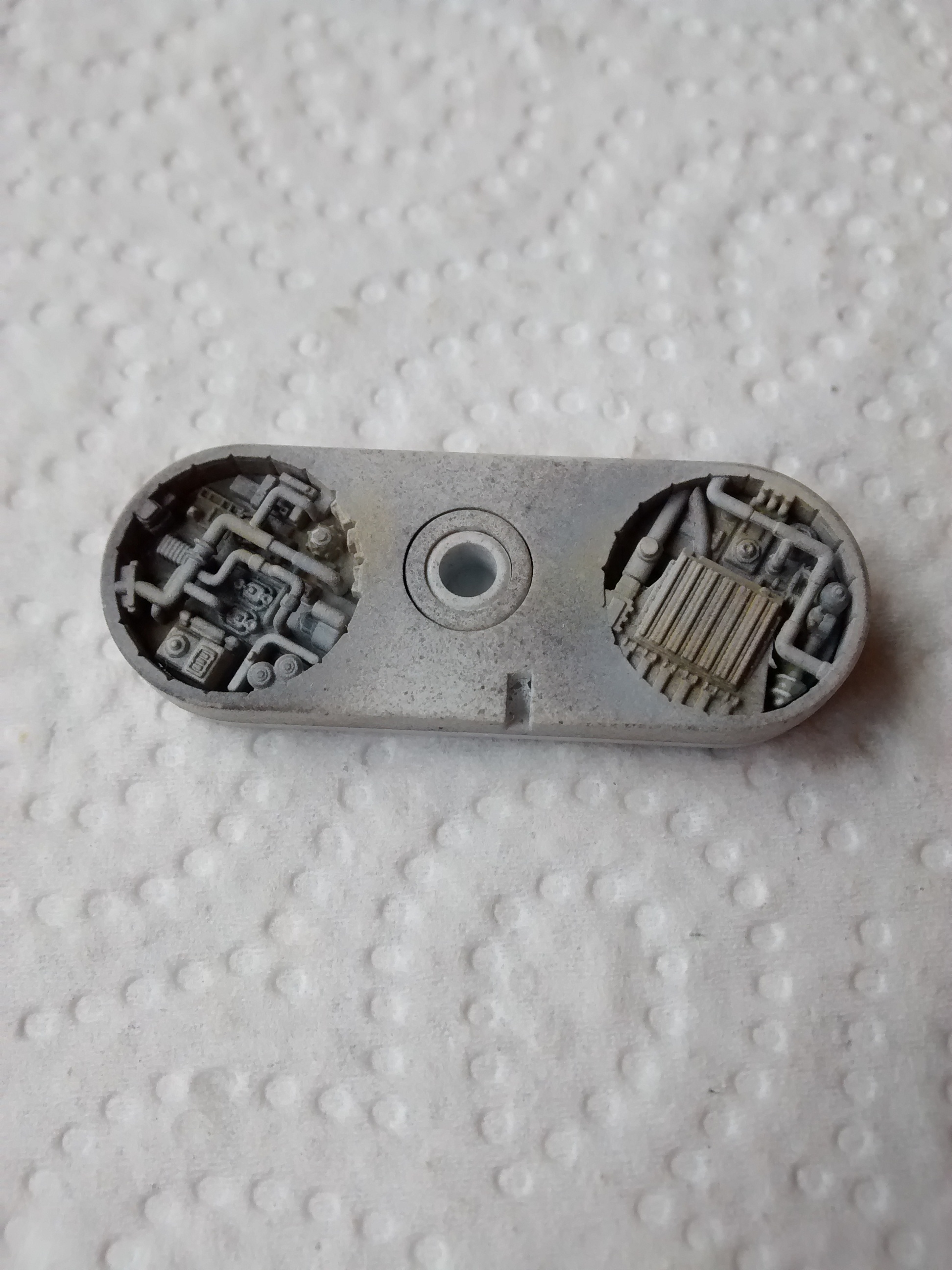

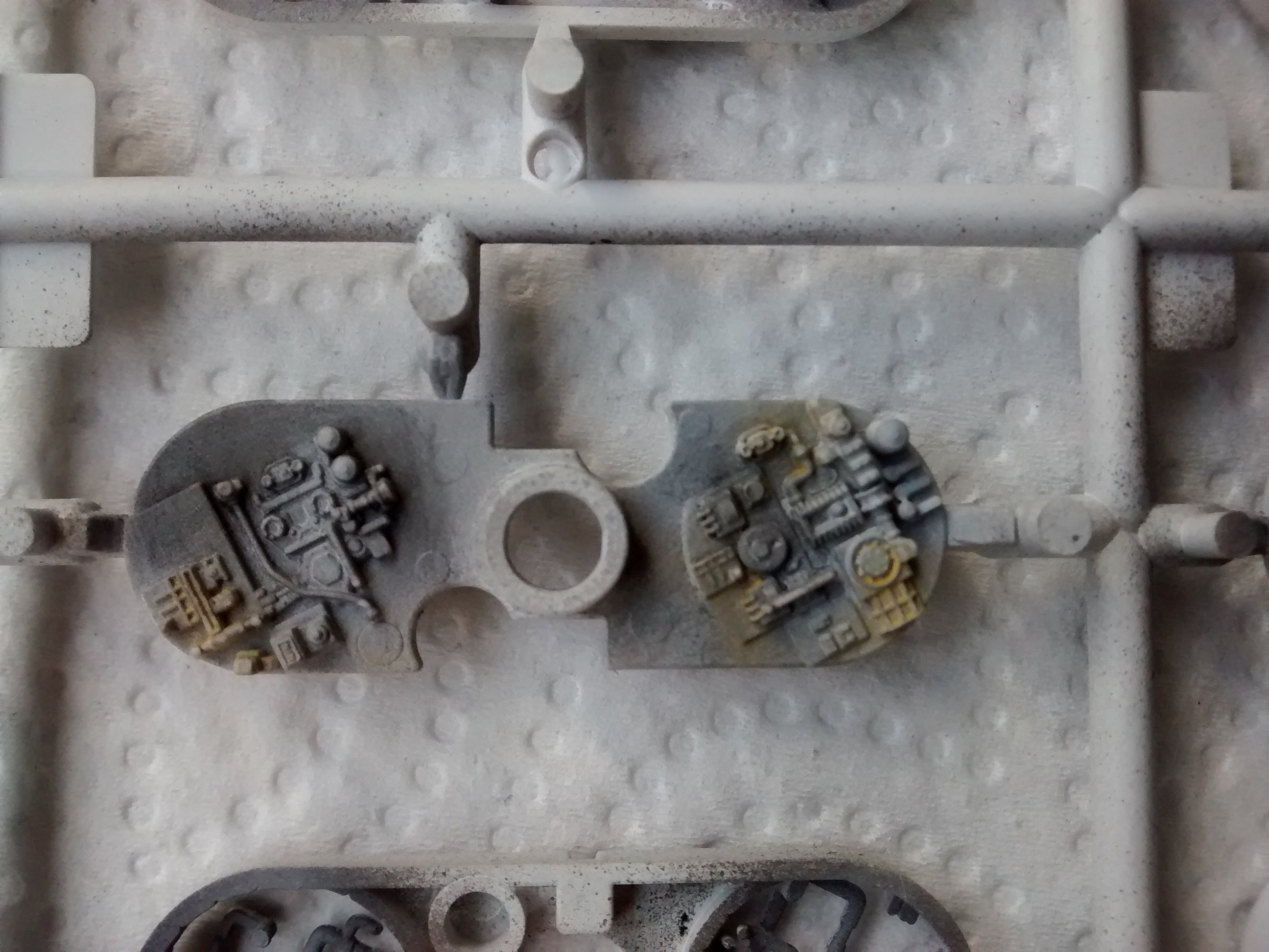

Also, I've thinned more of the pipes that go in the cavities on the top. This was painstaking and done by digging them out from the back with the very tip of a scalpel. Hours of work! Although it's not 100% and not as good as replacing them with wire, they actually blend in now and will look OK I think with weathering. Also a close up of the starboard front scar, which I worked on more to make it slightly more screen accurate.
This is such a nice kit. With care and some modifications, it really starts to take on the look of a much bigger model

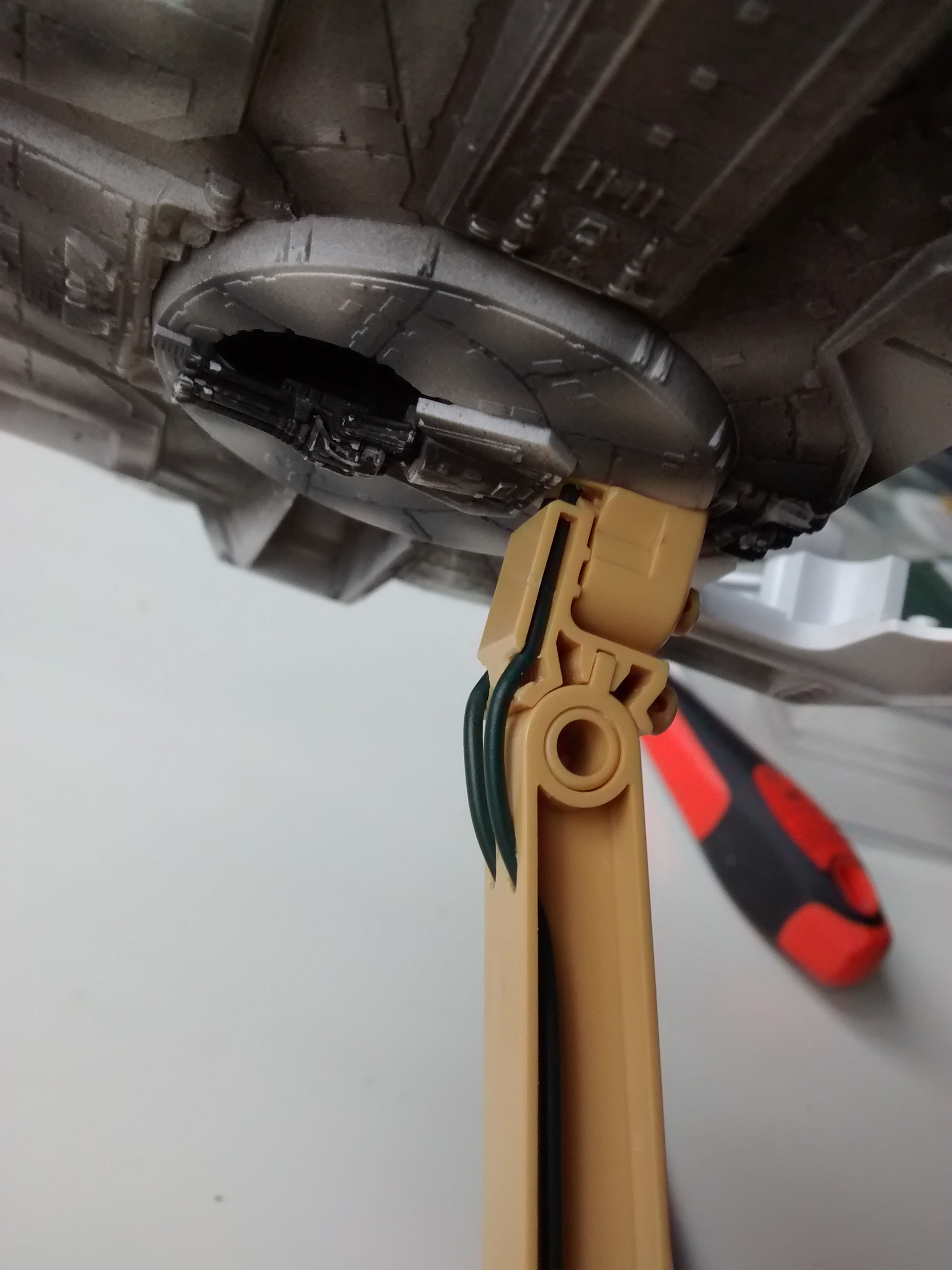

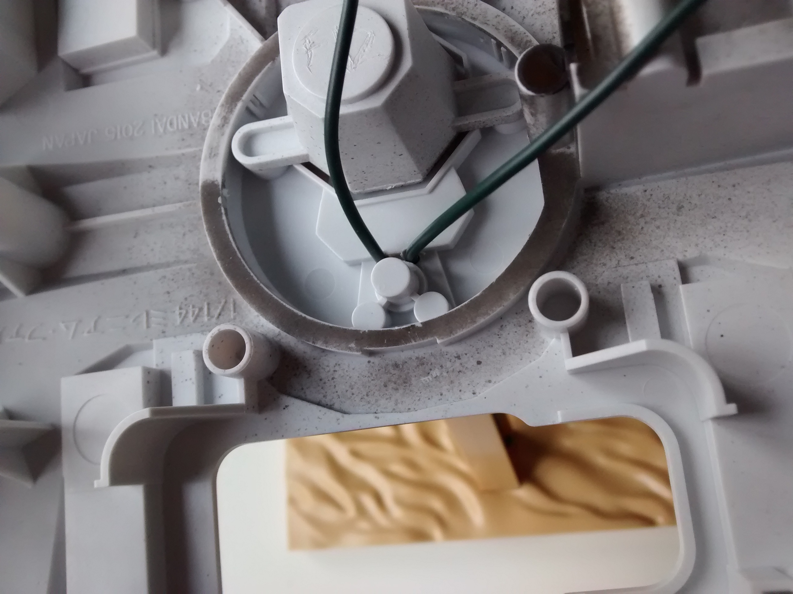

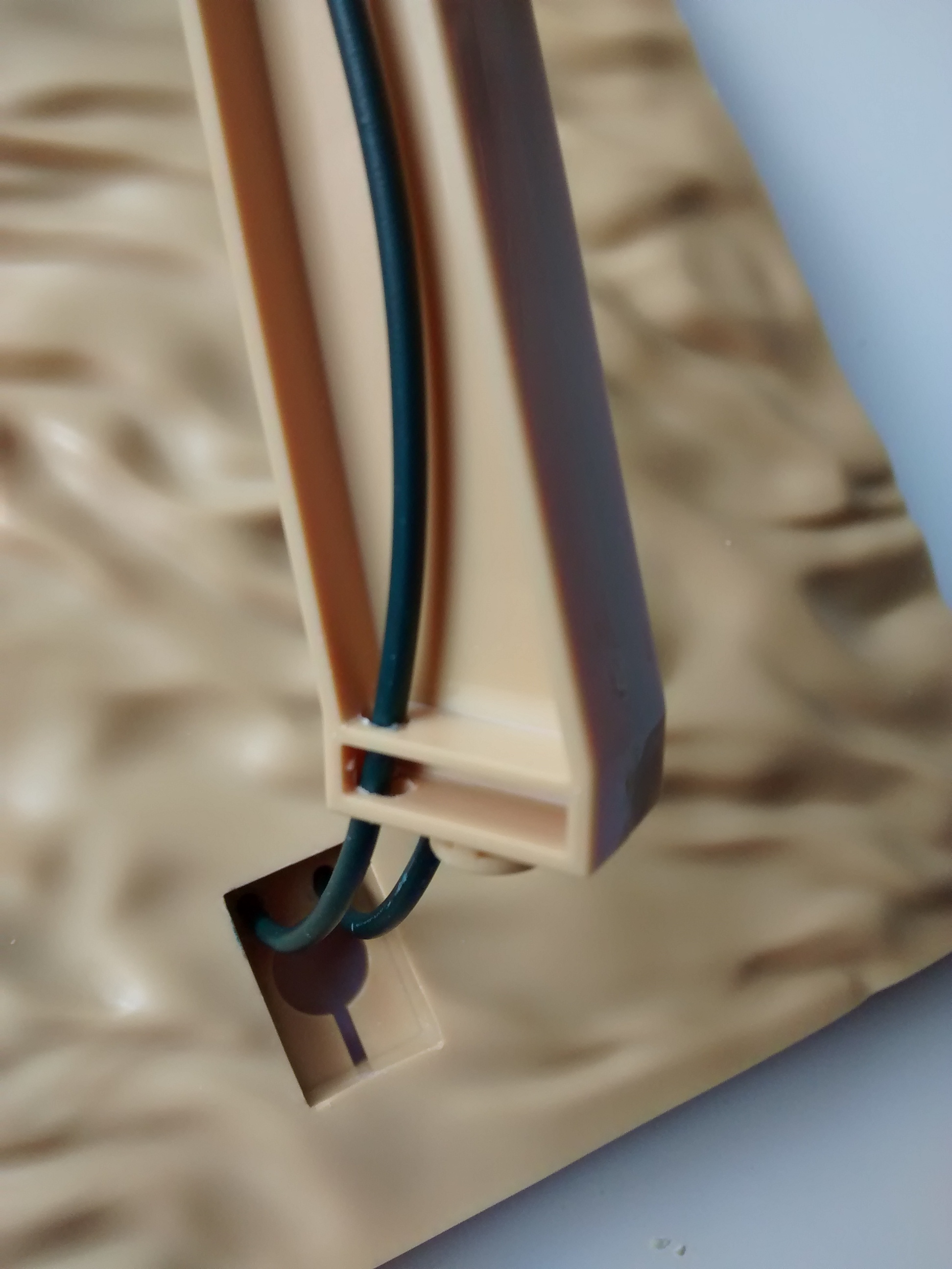

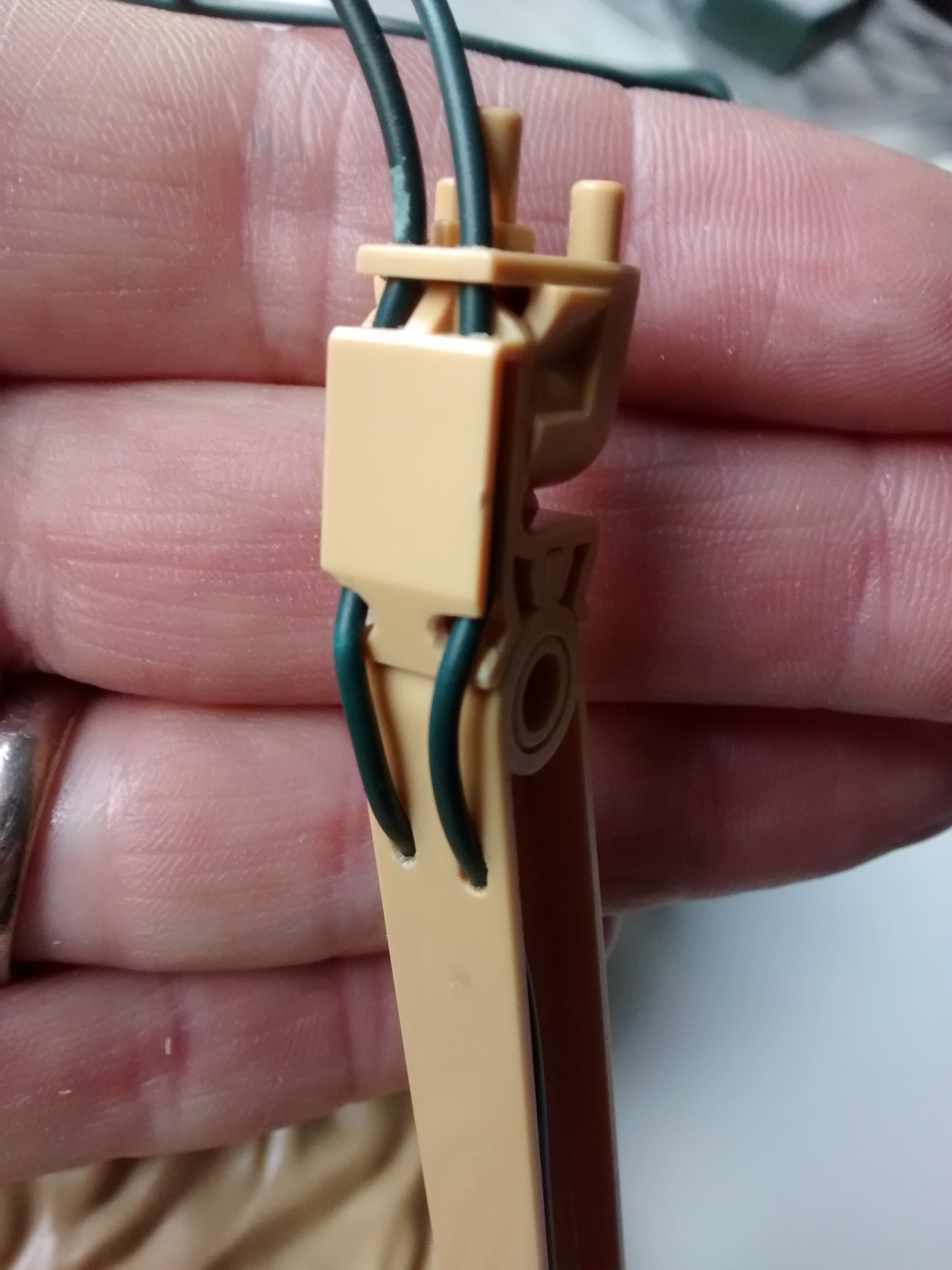

I'm going to try utilize the Bandai falcon stand to support wiring for the lighting power source which will be hidden beneath the base plate, anyone else try this with success?
Here is how far i am along with my efforts
Having a 9v battery inside the model doesn't appeal to me, too much handling of the model itself and fitting resistors'n'whatnot. two AA's is what i intend to use powering about 6-7 led's

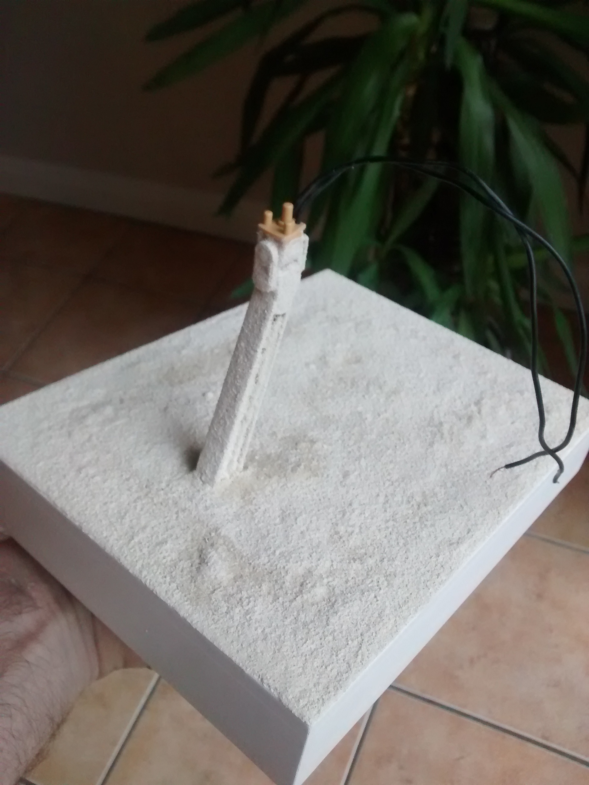

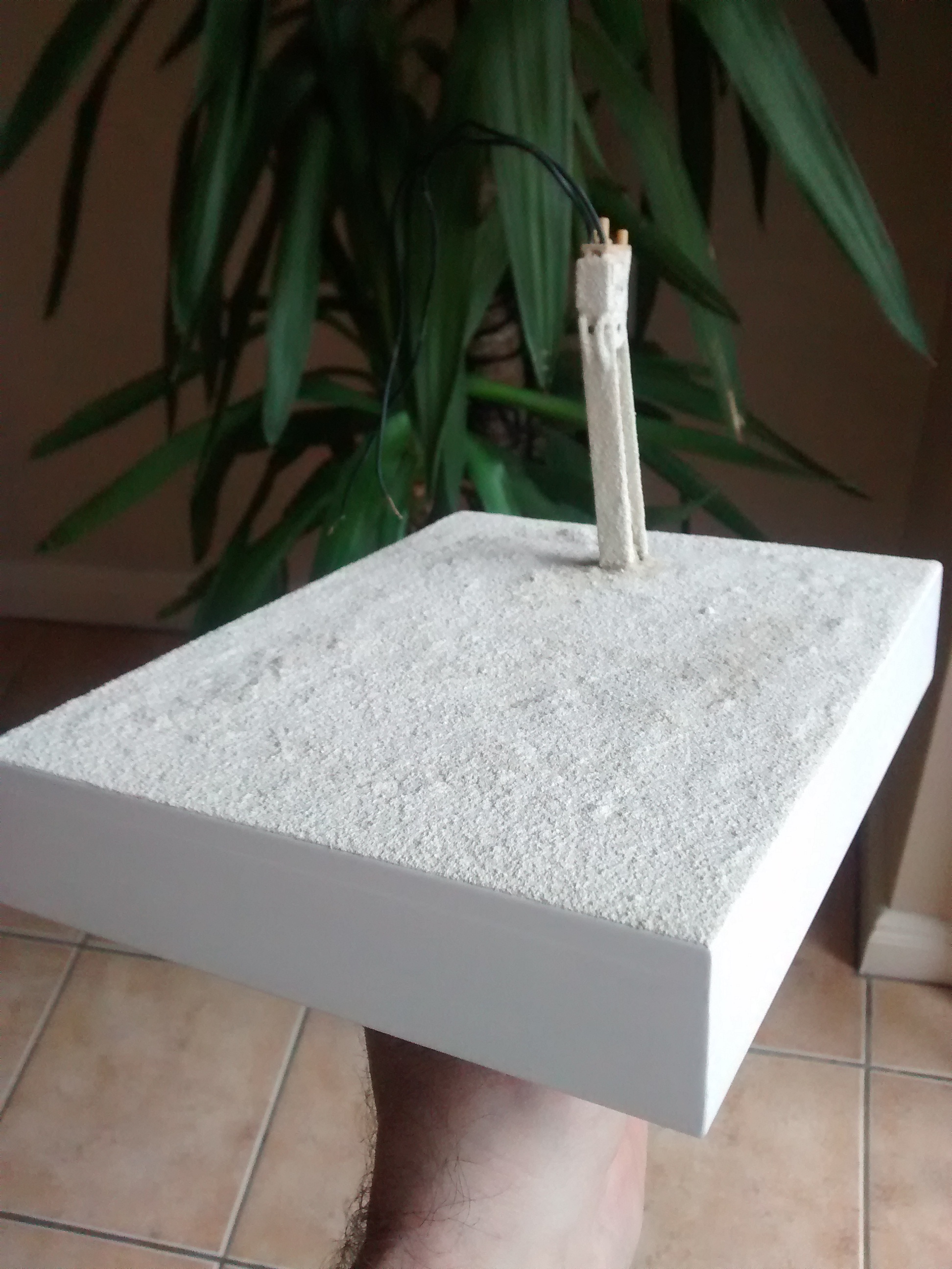

The Ikea Ribba picture frame makes a good sturdy base for the Falcon and leaves lots of room for battery packs
, i finished mine up today in a Jakku style sand effect, i used PVA glue and sand colour tile grout, i sifted trough a very fine grade one
