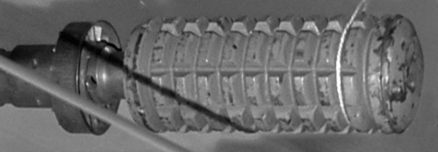

Great version of the Tunisia pic. I think this one really shows the weird frag body. Also, since the groove in the top most ring doesn't flare or shrink towards the end of the frag body, this in my eyes lends credence to the idea that that last ring has no slope.

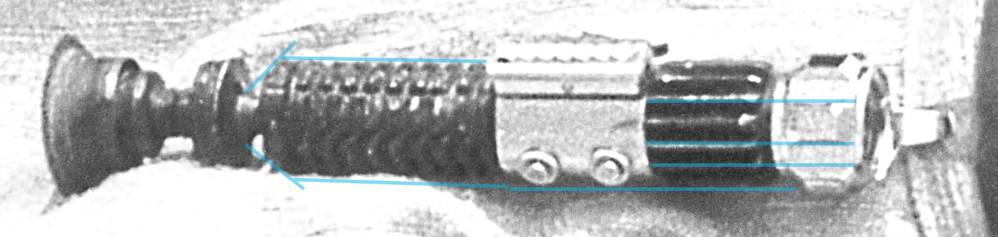

Made this comparison so we have all OB1 sabers Tunesia vs Chronicles in one frame :
When I 'boxed' in the Tunesia saber from above picture with some blue transparent line ... I see this :
Shadows and lights play tricks when judging props from pictures alone ... however I do notice the more rounded light 'blobs' on some of the fragment parts of the rings of the Tunesia grenade and to me, this does seem to suggest it is a much heavier damaged WW1 relic than the one from Chronicles with it's sharp edges, otherwise the light would reflect more evenly and not like 'blobs' as seen in the top comparison picture.

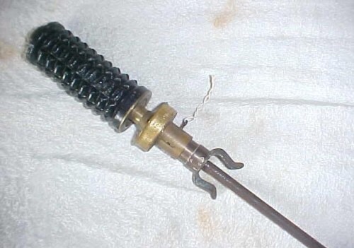

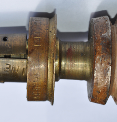

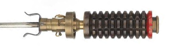

Here's another real grenade to emphasize these uneven light 'blobs' when the surface is more damaged :
Now another matter that's always bugged me ... is the shape of the
windvanes . . . most grenades I've seen for sale are 'smooth' :
Whereas the Chronicles saber windvane has clearly a 'ridge', for lack
of a better word, as seen perfectly on this grenade :
Question is ... could the windvane for OB1 Chronicles have come from
a No.3MkII grenade with this neck instead? :
And what is on the Tunesia lightsaber ... a windvane with or without a 'ridge'?

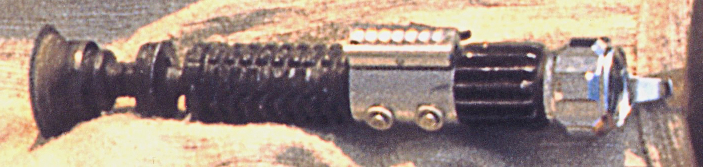

Thanks . . . now if the grenade is as you suggest Dan, which is all straight on top, . . . then it's a lot
more damaged than seen on this one :
and this previousy posted picture could suggest it does have a 'smooth' windvane :
Chaim

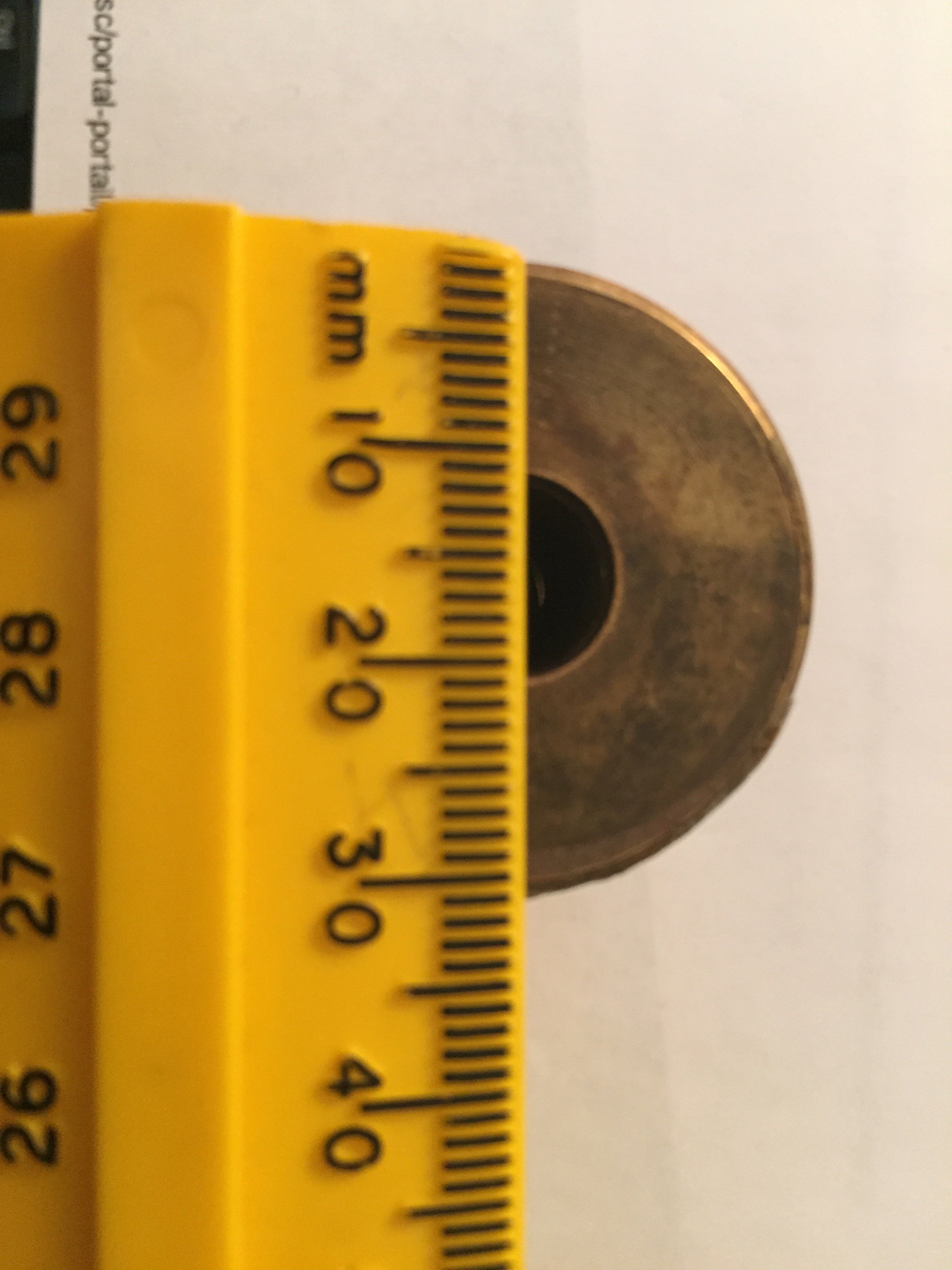

If you can forgive the crappiness of big yellow here, it appears that the diameter of my relic stem is about 31-32 mm... if you're saying that the normal diameter is about 34 mm... that's a pretty big difference...
