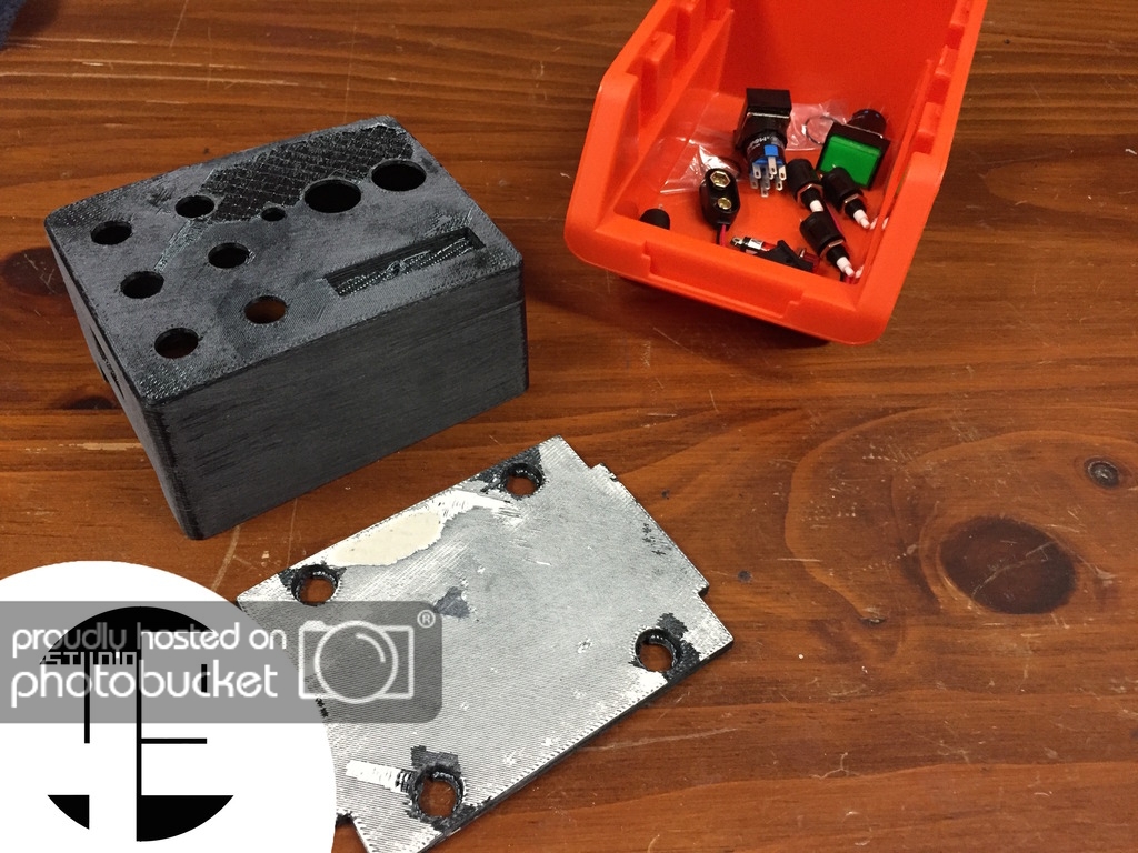

Made a heap of progress today on my soundboard box.

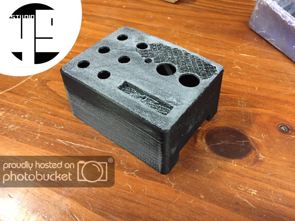

First up I printed myself the entire box and it all went well until he decided he wasn't going to play nice with removing the raft in a small portion of the part. But that's easily fix so I've applied filler to that area and it is almost completely smoothed out now.

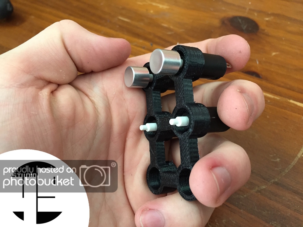

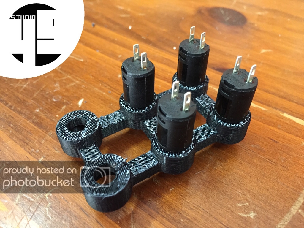

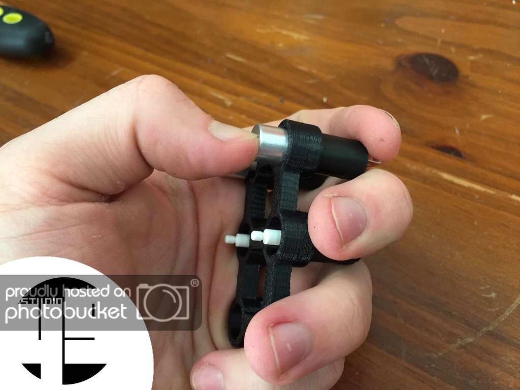

With the box ready for etc first coat of primer I switched gears to creator a completely custom bracket that houses the switches/button. This little bracket will sit directly below the hols allowing the knobs to go through the hols and be pressed while providing reinforcements. In fact I got the fit so snug I was actually able to thread the switches into the holes!
That's all for today with updates, there's still plenty more work ahead of me with building this with sanding, filling, painting, wiring, etc.

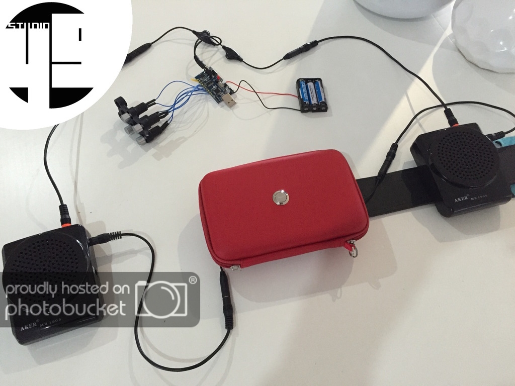

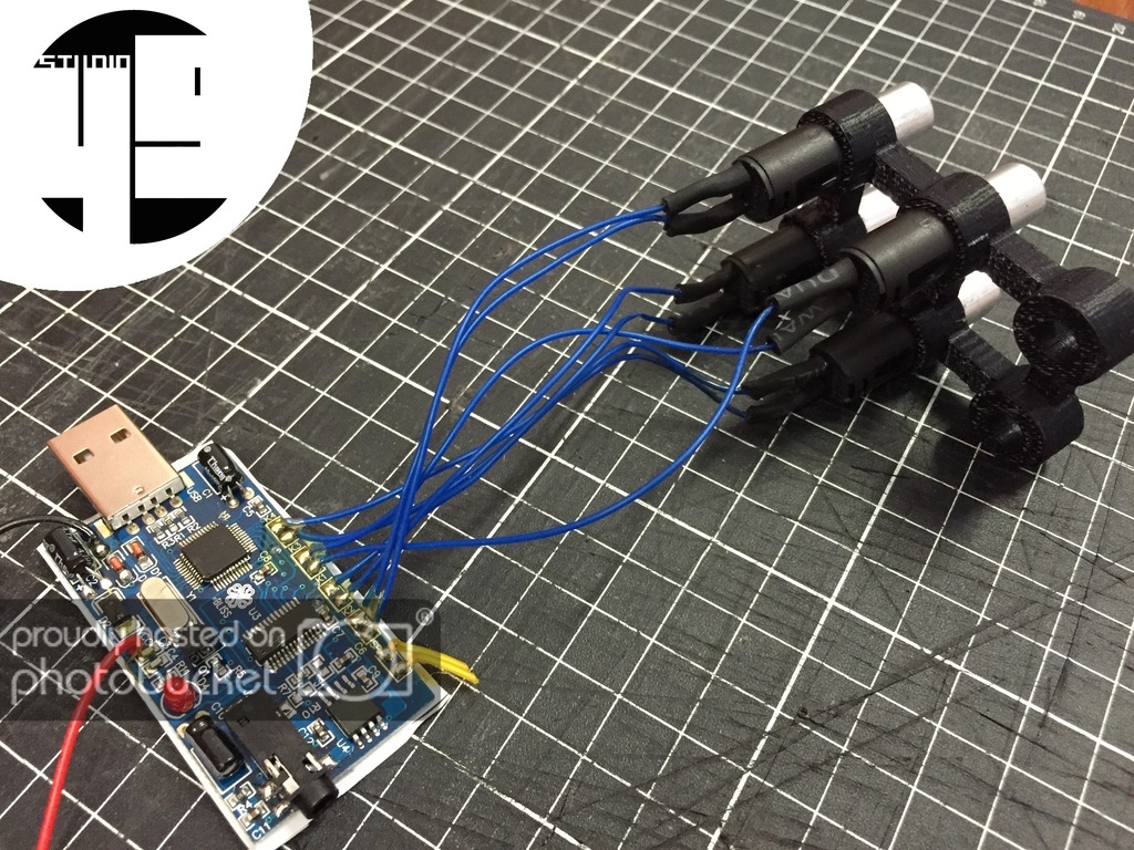

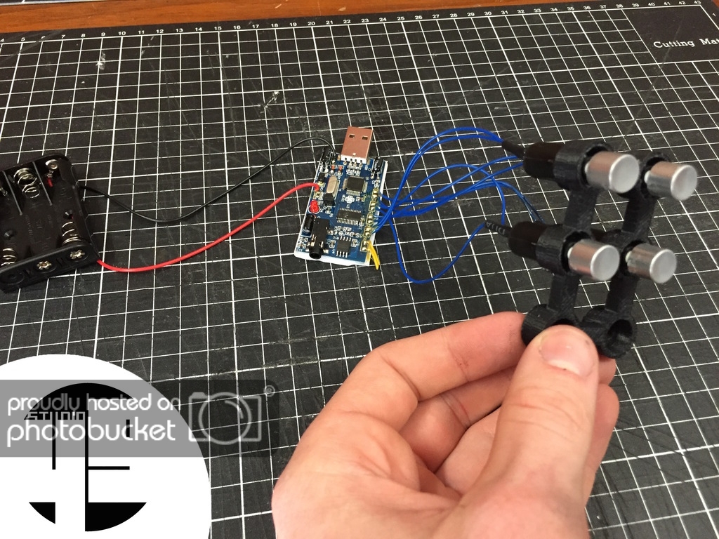

The soundboard finally arrived yesterday afternoon so I was able to get to work on the electronic and audio set up for the box

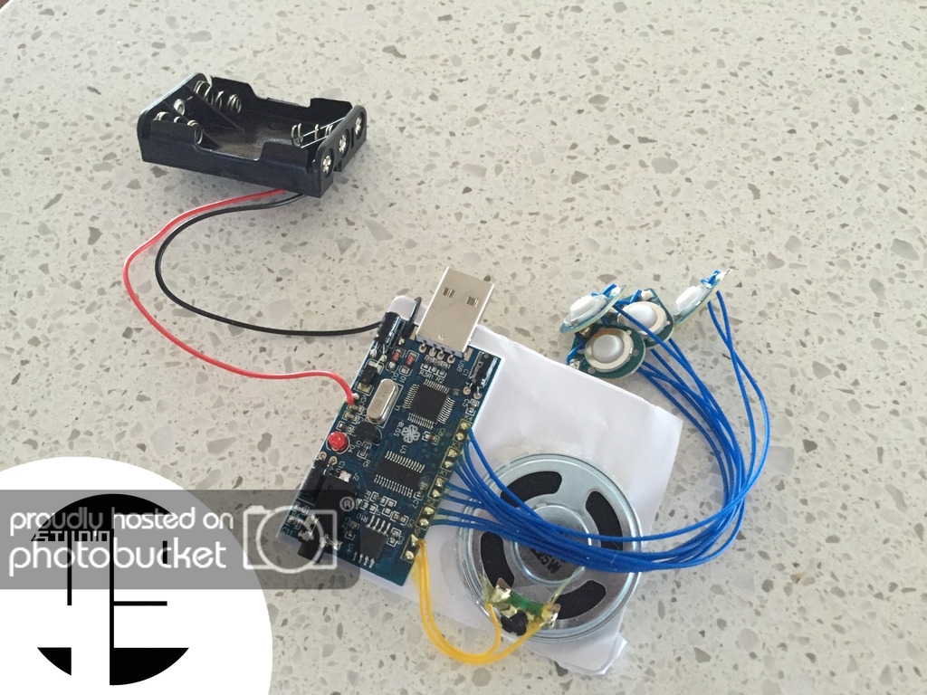

First up I did a test set up with out any mods to the board, just so I knew I had the set up nailed before proceeding further
And I've got to say I'm stoked with the results! The quote choices are still in progress but it runs perfectly to the 2 AKER's and works perfectly with the breathing loop
See the video below for a demo (all that's left audio wise is tweaking volume levels and that's it)
And of course I also started wiring up the the switches for the box which was a simple matter of cutting off each existing switch then soldering + heat shrinking the new switch in place

Ok so in terms of changes to the finals set up I bought two 3.5mm Y splitter audio cables that had integrated volume control wheels. The solved my biggest issue of trying to work out what volume to have the quotes which was hard with the only mobile source of volume control being the AKER volume wheel
So now if need be I can tweak all levels of volume for both inputs anywhere any time without the need for a computer which is a life saver

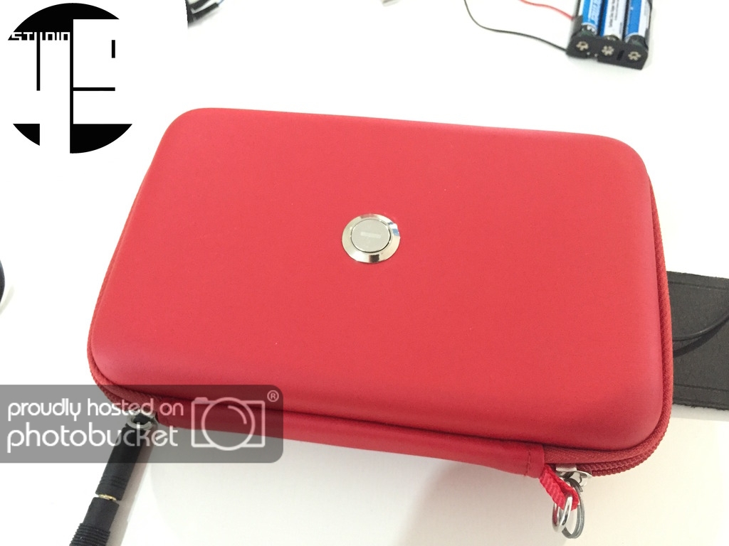

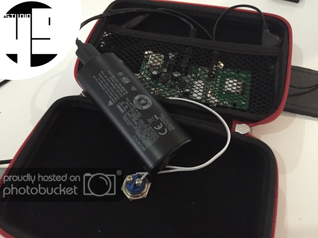

Now I also scored a soundboard from a gentleman in my local carrion who works at a electronics store which is replacing all their head phone displays so that meant they were just going to throw it out. But instead he was able to grab a box full for us. What it has is a micro SD slot which I can load my breathing loop onto and with the simple press of a single button I can control my entire breathing loop, which is far easier than the fiddly MP3 player I had perviously that always liked to turn off.
That's enough talking, here's a demo video for you guys
And some photos:
