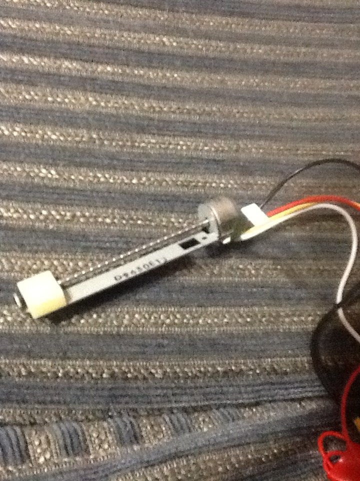

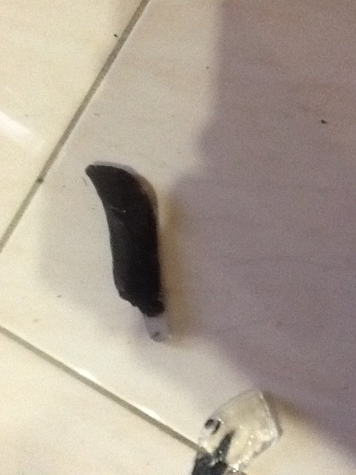

Here are some more pics of my progress: i finished all the electronics and only need to cast one more piece thenn put it all together,the forehead piece broke so i had to make one out of polymorph image.jpegimage.jpeg

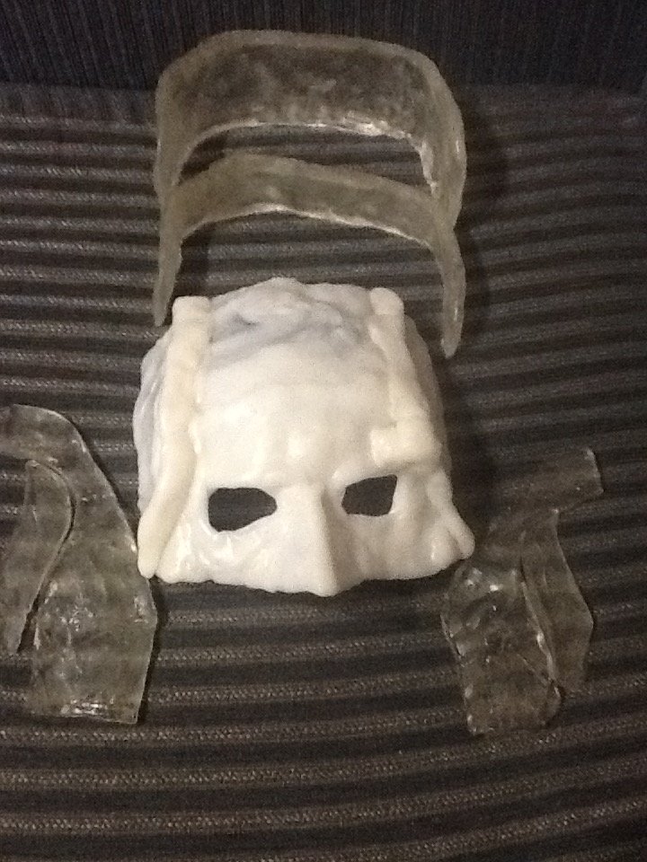

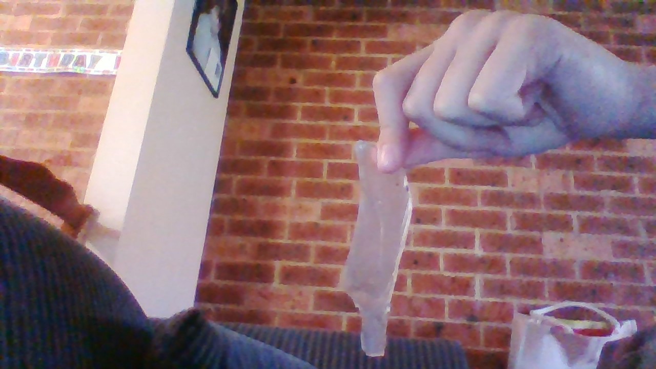

Hry guys,just finished the forehimage.jpegimage.jpegimage.jpegdiece and backpainted the clear resin pieces.Because the resin is clear painting the back only makes a beautiful color in the resin.
