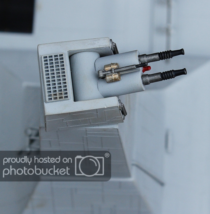

I laser cut some plexiglas to build up the box parts of the barrels. The white bits are pieces of Evergreen strip styrene glued to the inside corners to reinforce the joints and help keep everything square. (Laser cut edges tend to be ever so slightly not square and glued butt joints can go out of square unless something is used to help hold the joints at 90 degrees.)

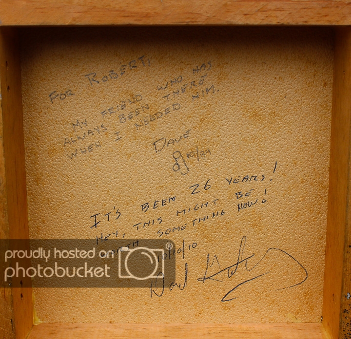

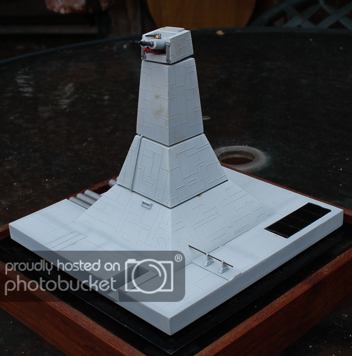

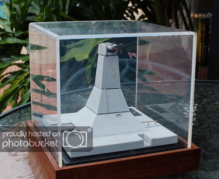

Okay, here's a blast from the past! Back in 1984 I was a recent college graduate with a burning desire to build models for the movies. Shortly before moving to Los Angeles to pursue that dream I made a small 8 inch tall model of the Death Star Laser Tower, based on Joe Johnston's sketch. When I left for L.A. I made a display case for it and gave it to a friend who had helped me out a lot. More than 30 years later he still has the model and it's in almost prefect condition! And it's signed and dated on the bottom.
Re: The (Uber) Death Star Laser Tower Project
That's a good model there Dave; love the two signatures at the base :)

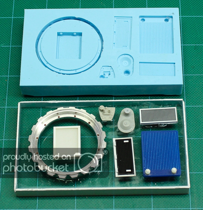

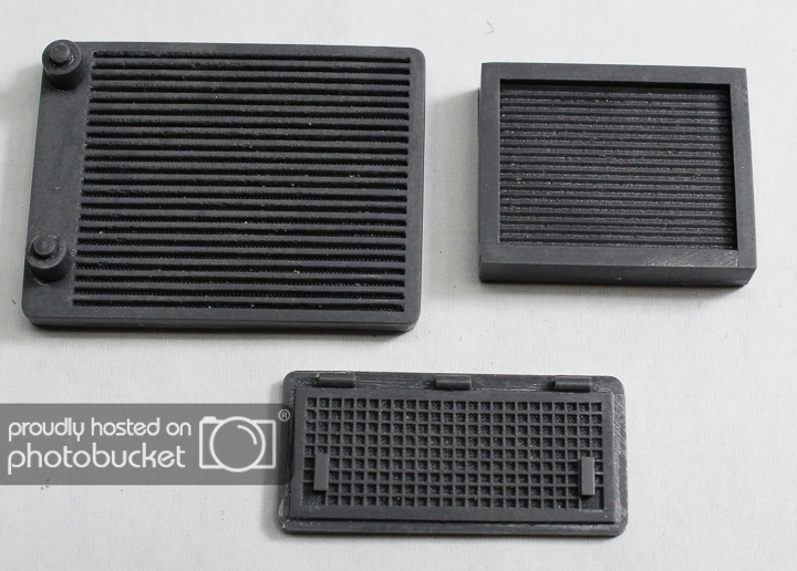

Molding and casting some of the nernies. The patterns for the rectangular parts were made using a combination of laser engraving and CNC routing.
