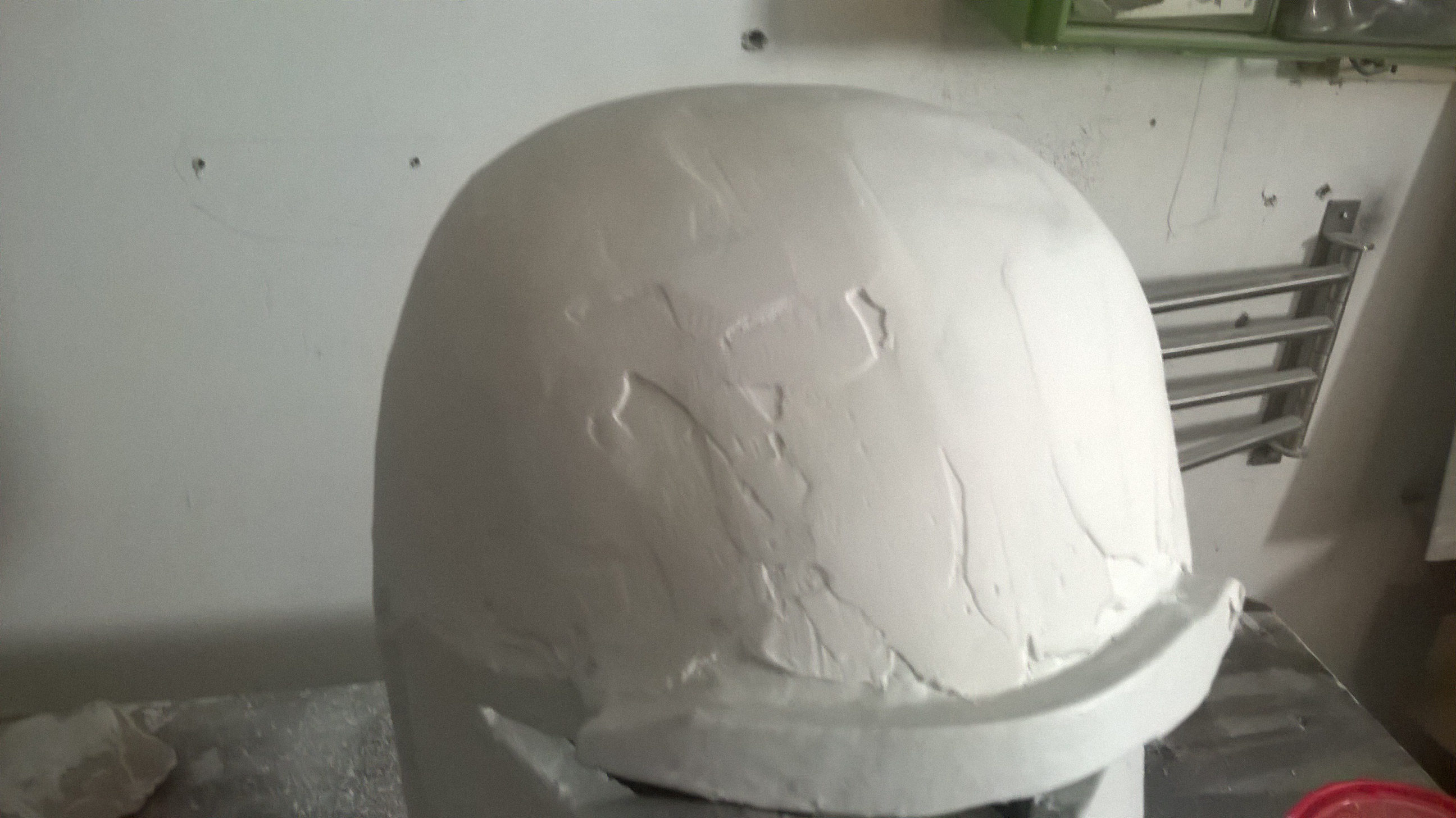

Ok, so that didn't work. After two coats of paint and a lot of sanding, things weren't looking much different. Then I got out the electric sander and a whole patch on the top of the helmet ripped away, just like Snowbuilder warned me it would. Unwilling to face the prospect of applying more paint and trying to make good, I reverted to slathering the helmet in filler. Backward step, I know. But maybe I can be persistent enough to make this one work?
Like a bad doctor, I have no patience. (That's a joke.)

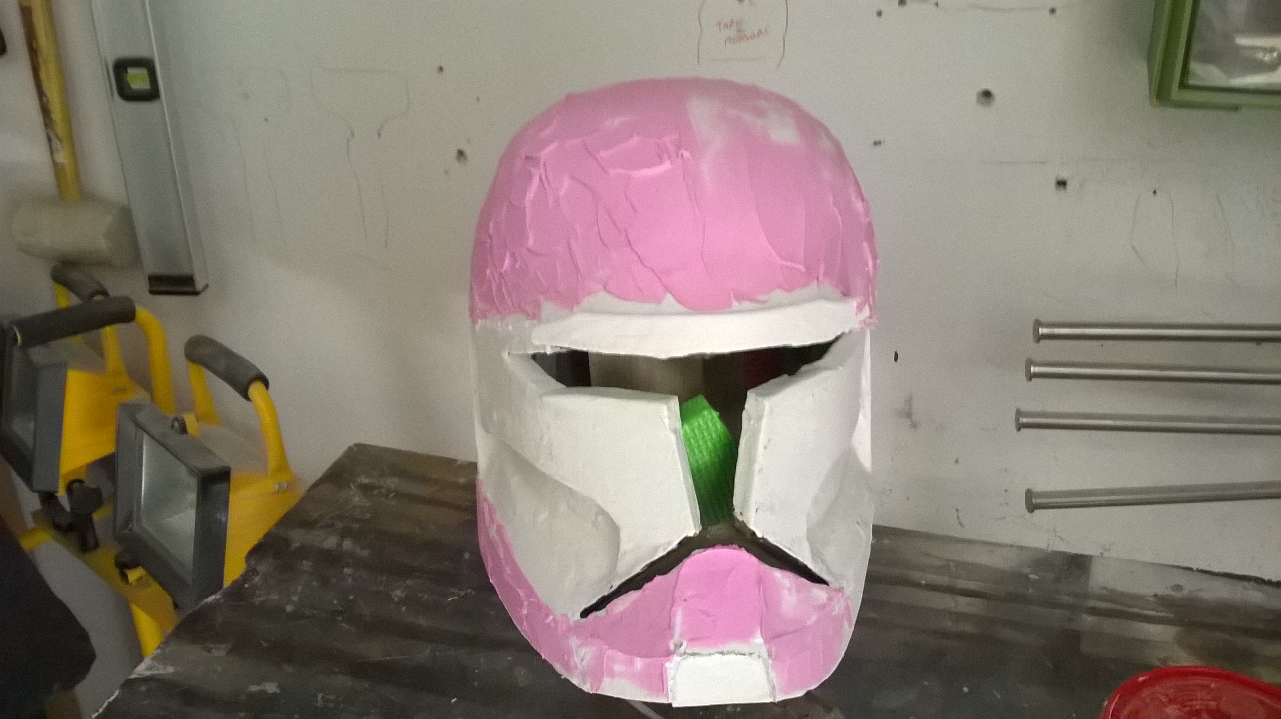

I bought this colour-change filler because I thought it would prevent premature sanding (It's pink until it dries, when it turns white.) However, "dry" is a relative term, and the filler still feels a little soft, especially if the layer is more than a millimeter thick. And ALL my layers are more than a millimeter thick.
Thus, sanding off yesterday's podging was only semi-successful.
Another disadvantage of the method I'm using is that the dome itself is soft - there's no hard structure involved, so when leaning on it to sand away, the surface dents, and the filler cracks. I found myself surfing car supplies websites, looking for some miraculous material that's easy to apply, easy to sand and dries hard and shiny. Also, it needs to be free because Mrs Dim just took a job for 30K a year less, and then her car died on the way to work. Big repair bill coming in. Sigh.

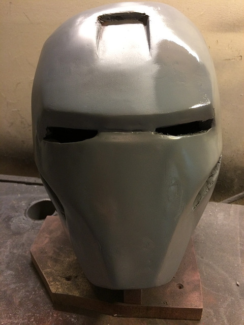

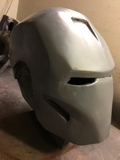

If you have an open area to work you may want to think about trying fiberglass resin/strands. Here's one of my earlier attempts:
...and after the first round of sanding and priming:

Oh, that is SO pretty! Open air is becoming more likely now the weather is improving, but fibre glass will have to wait until the finances improve. Know anyone who needs a kidney?

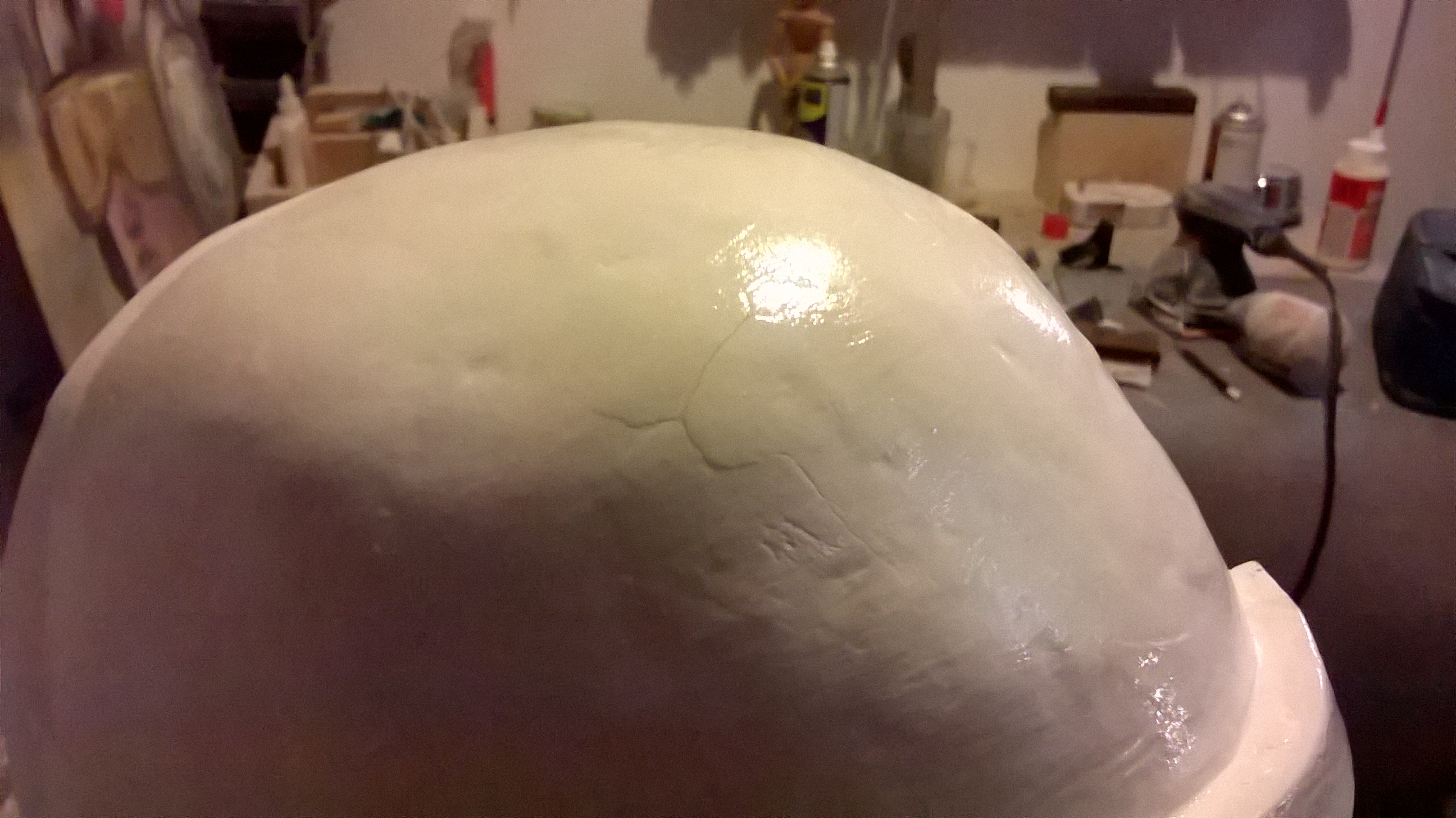

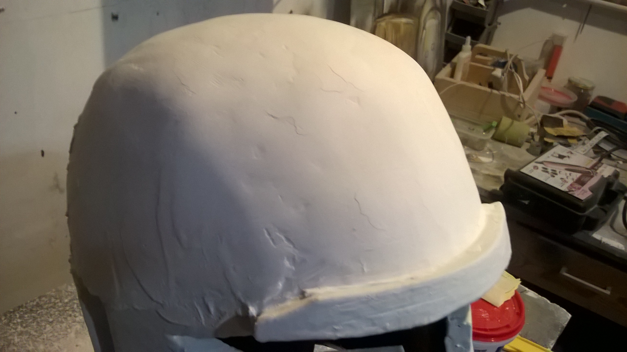

Taking Wedge86's advice (at least until the fiber glass option becomes available), I have been delicately sanding but also using a wet paintbrush to redirect and smooth. Progress is slow, even for me, but I think it's a definite improvement.
The front of the dome, where I've done the majority of the sanding, is coming together nicely. The sides I have barely touched yet. Still a long way to go, but the general plan is this:

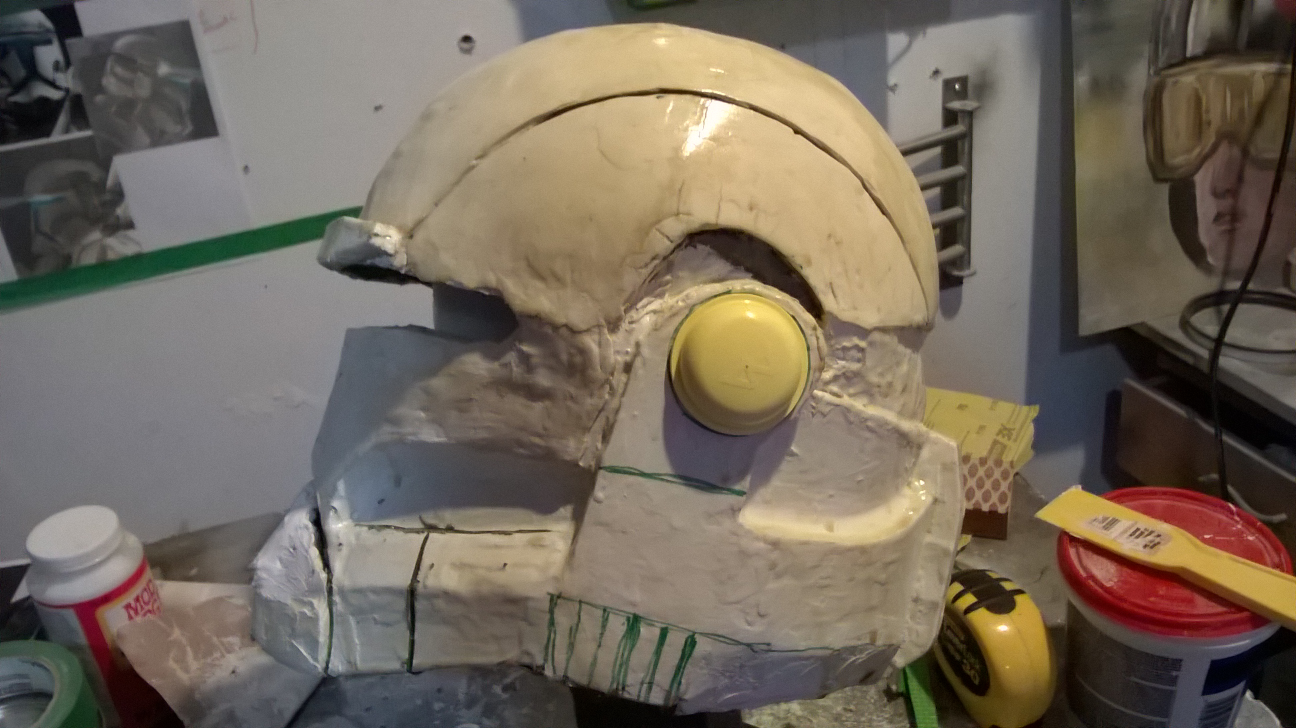

Got a day off. Spent too much of it staring at Twitter and despairing about the state of the world, but I pulled myself together and went downstairs to add in the neck pieces I've been thinking about for a week or so. Except, of course, I didn't. I decided to fix the t-slit, making the edge rounded instead of pointed.
Not much difference, admittedly, but it's more in line with the reference picture. Since I had the dremel out, I switched to a cutting tool and put the lines in.
As always, I'm bashing on before the surfacing is done properly. Sometimes I'm picking up a sheet of sandpaper and making determined attempts to smooth stuff out while I'm taking a break from cutting, but it's not the intensive, patient effort I should be making. Also, the filler is still soft, even though it's dry. I should modpodge or something over the top to prevent damage.

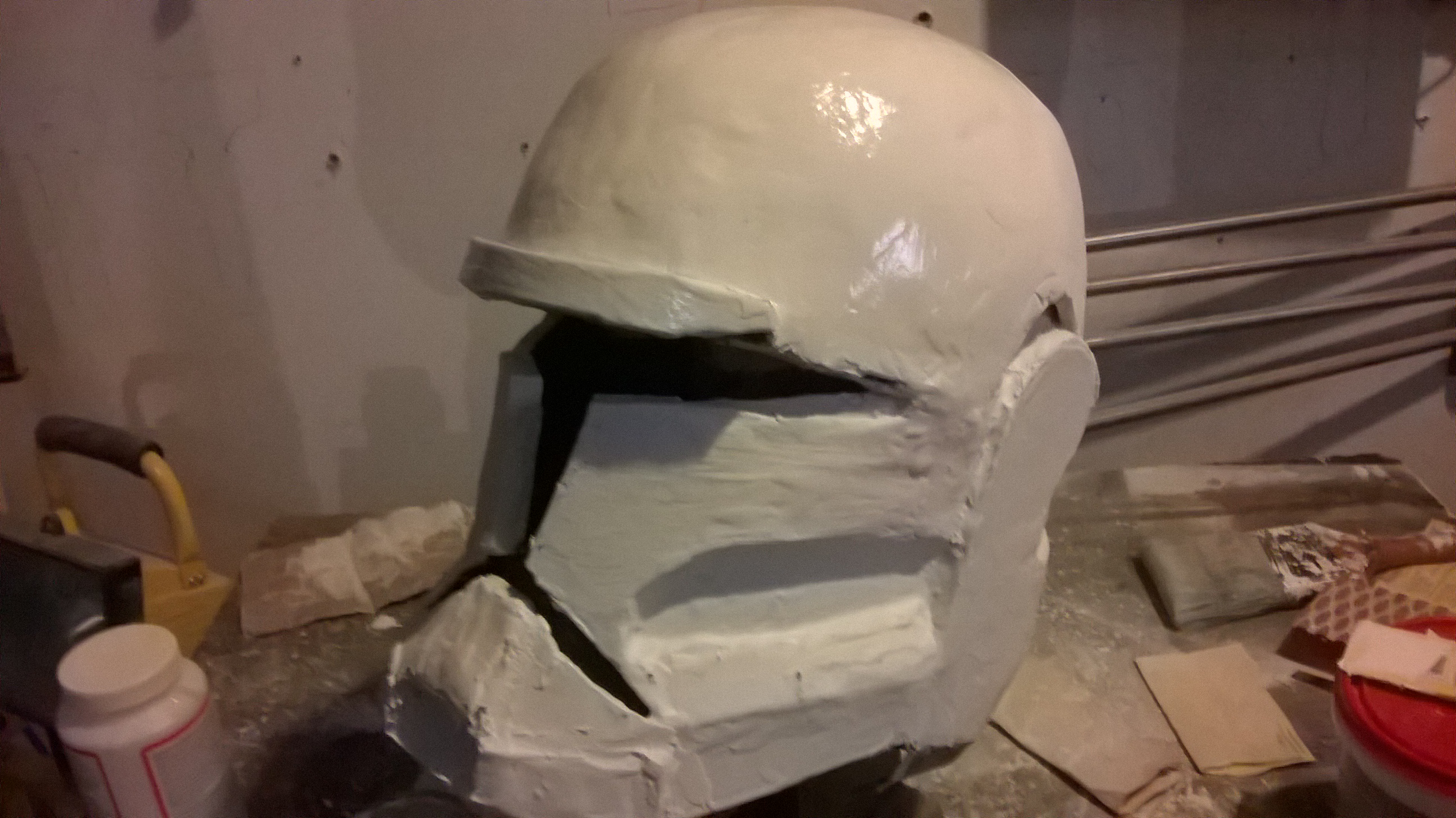

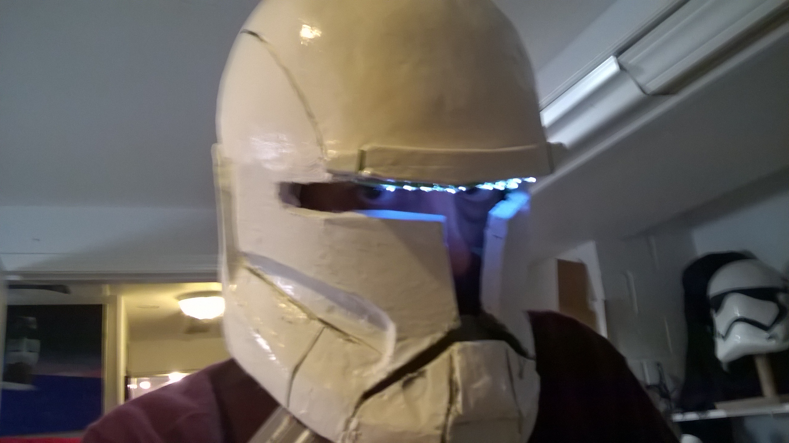

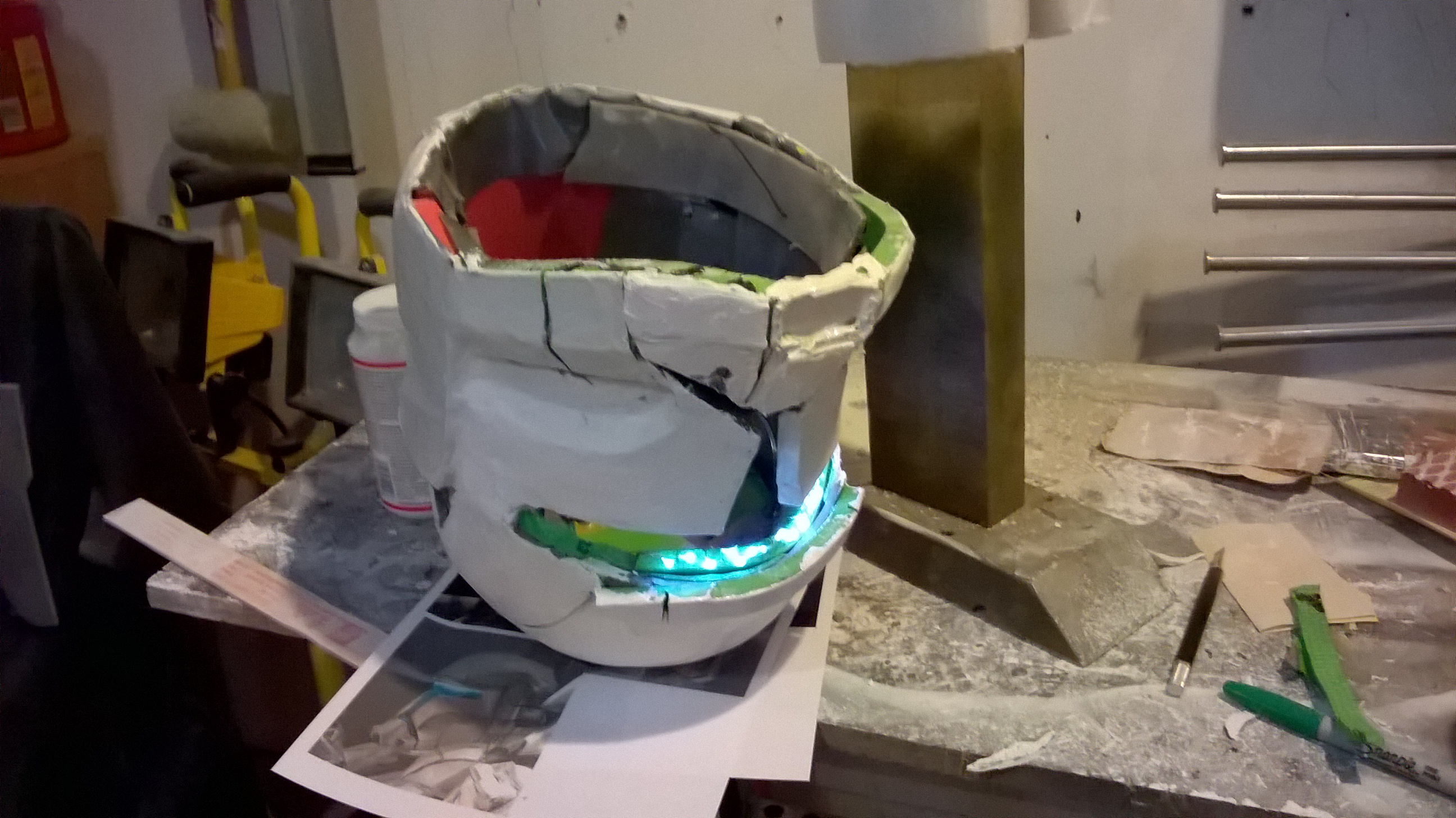

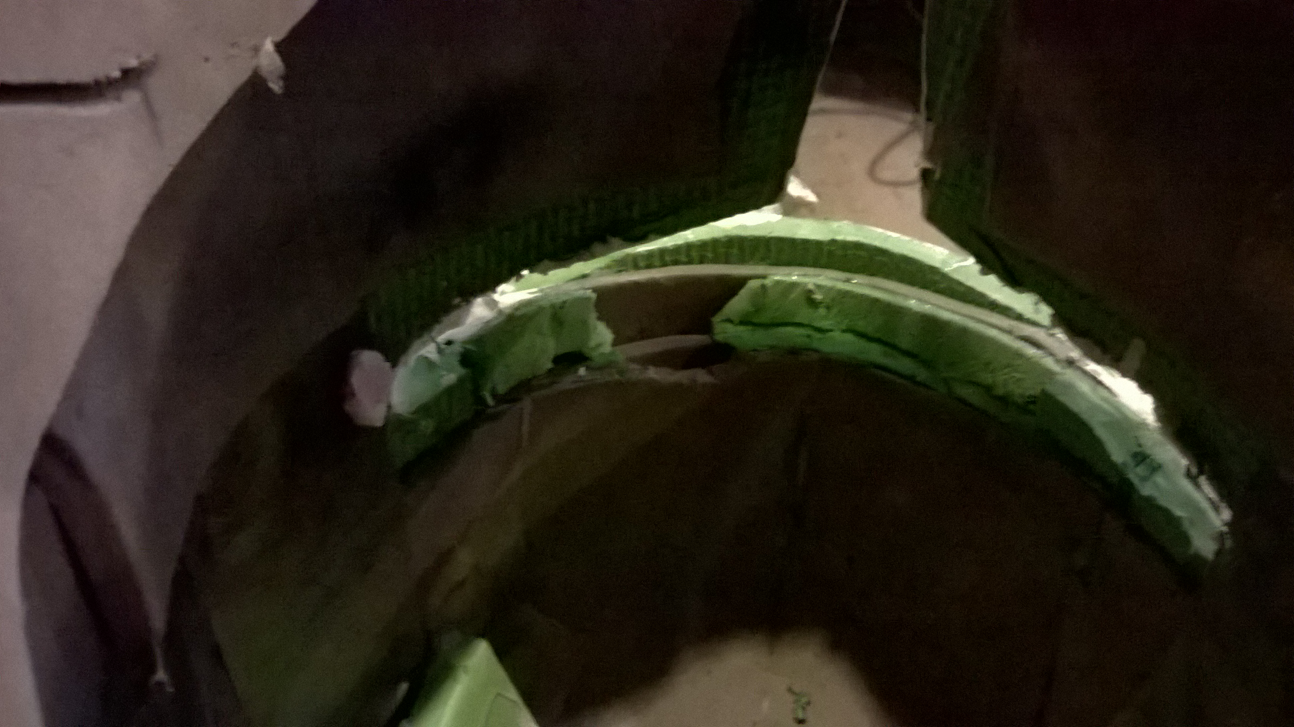

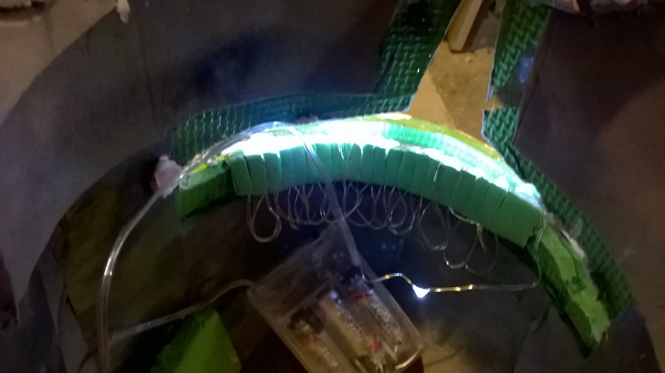

Still avoiding doing the obvious work, I cut a slot for the row of lights to go in.
Once I tried this, I cut away some more of the interior so they fit better, then held them in place temporarily with some duct tape. Still not sure exactly where the battery pack will sit - at the back? That makes sense, rather than offsetting the balance by having it on one side or the other.
Things look ok from the outside.
But it's still too soon to try it on.

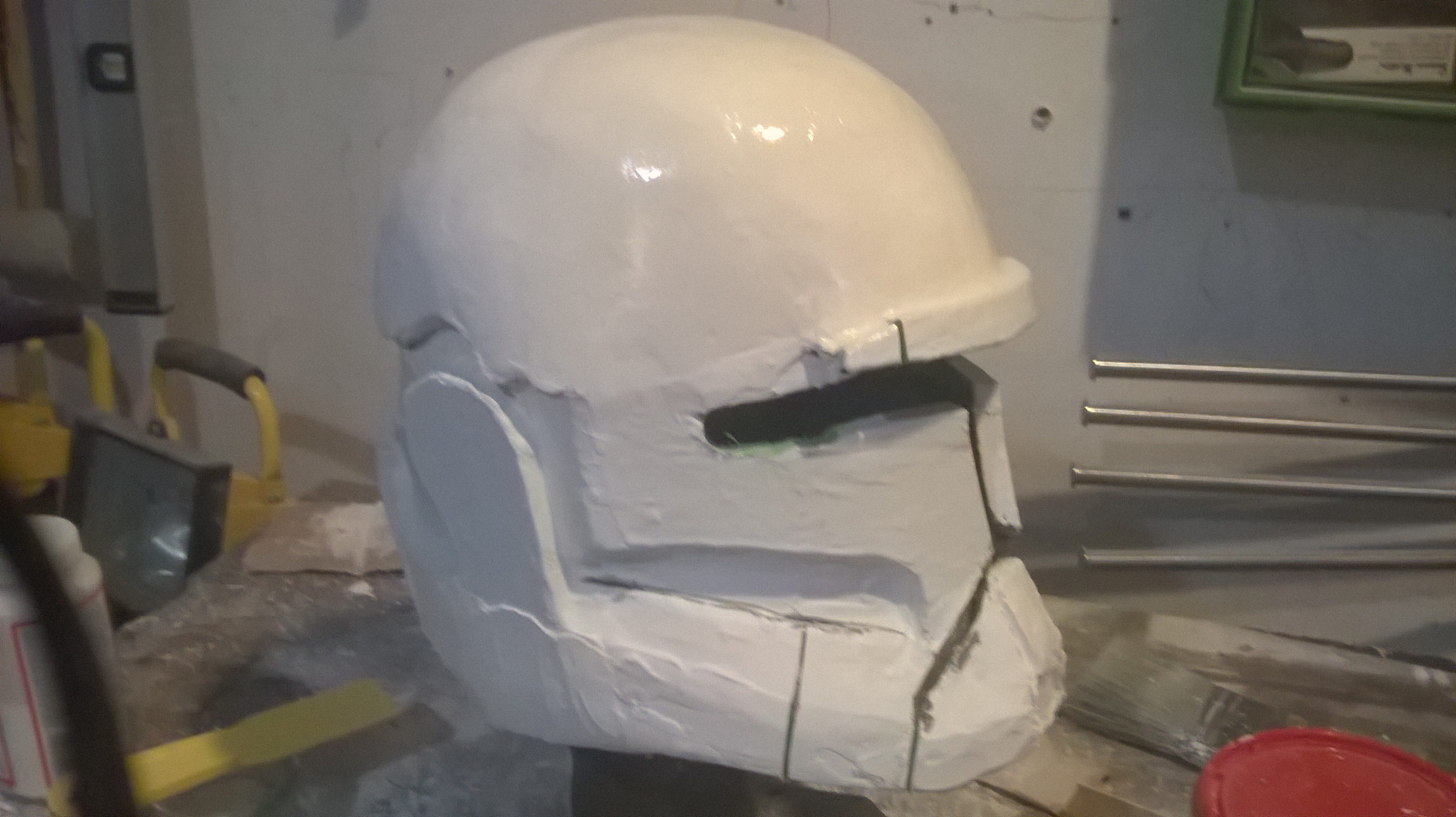

No pictures today, but I'm adding lacquer to the list of things I have painted on my helmet. Hoping it will add the strength that has been missing. Also, three or four coats might be sandable. Want to move on now. Don't have another project in mind, but this one has been going on long enough!

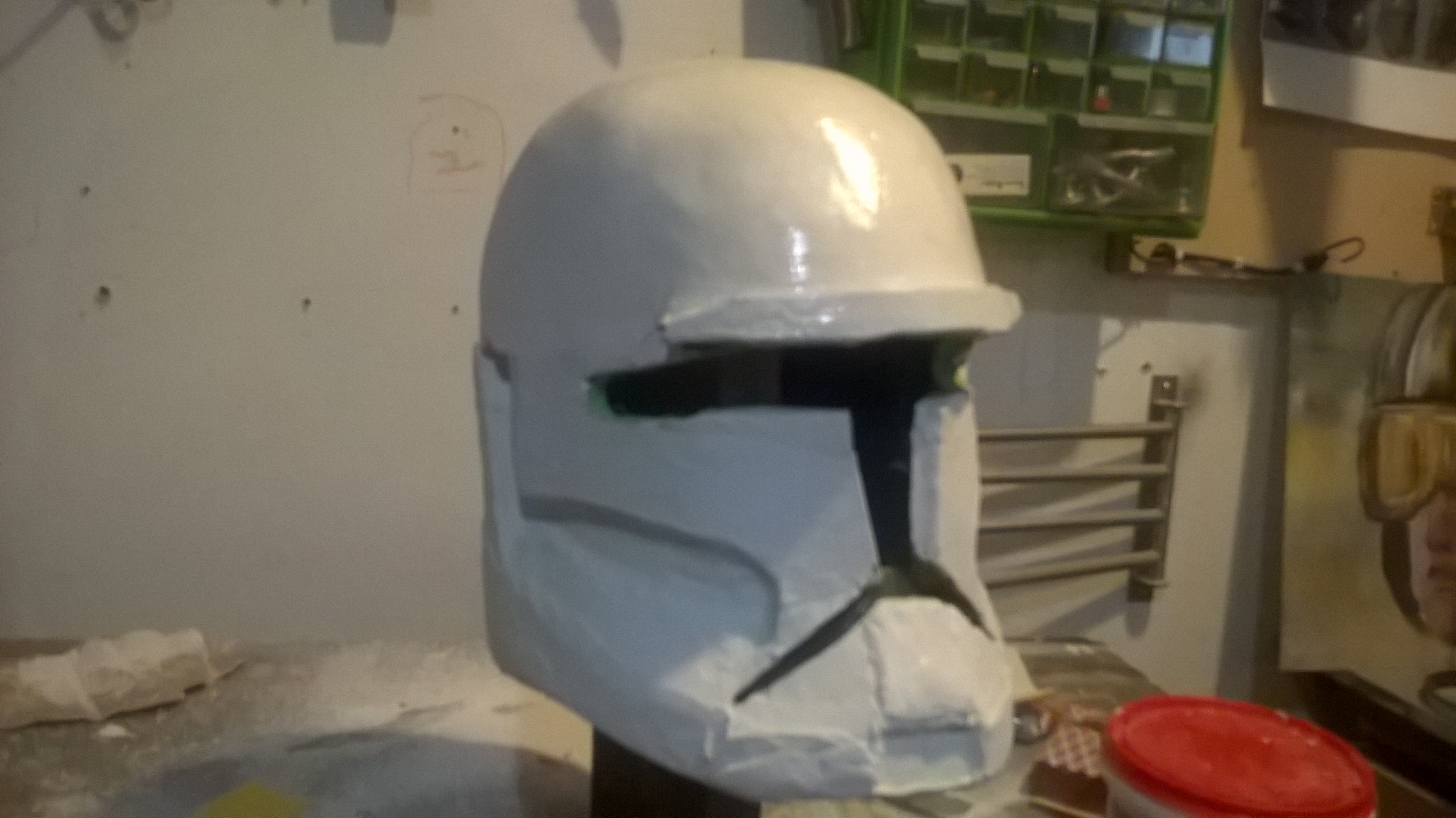

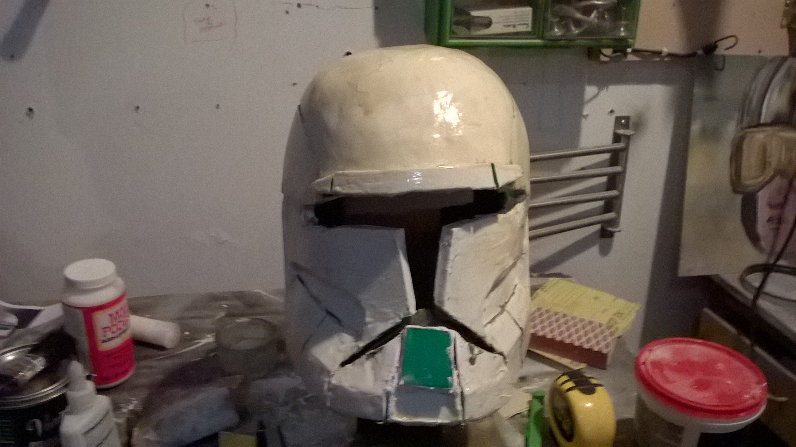

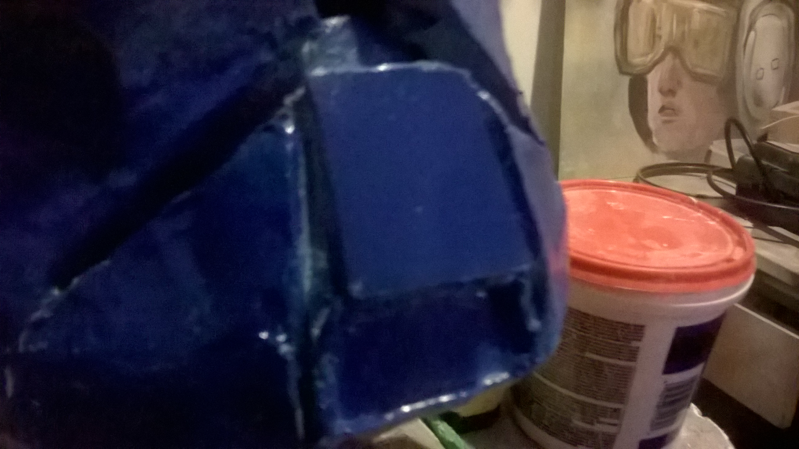

Got a couple of photos to add to what I did yesterday. I'm plating certain areas of the helmet with plastic to cut short the problems I'm having with surfacing (the same cheat I used with the beak of the First Order Stormie bucket.) The lacquer has been an improvement, adding a little strength and smoothing out some of the areas, as well as being sandable where there were ridges. Right now I'm trying to figure out which part of the household budget to raid for a new can of white spray paint.
Anyway, photo number one:

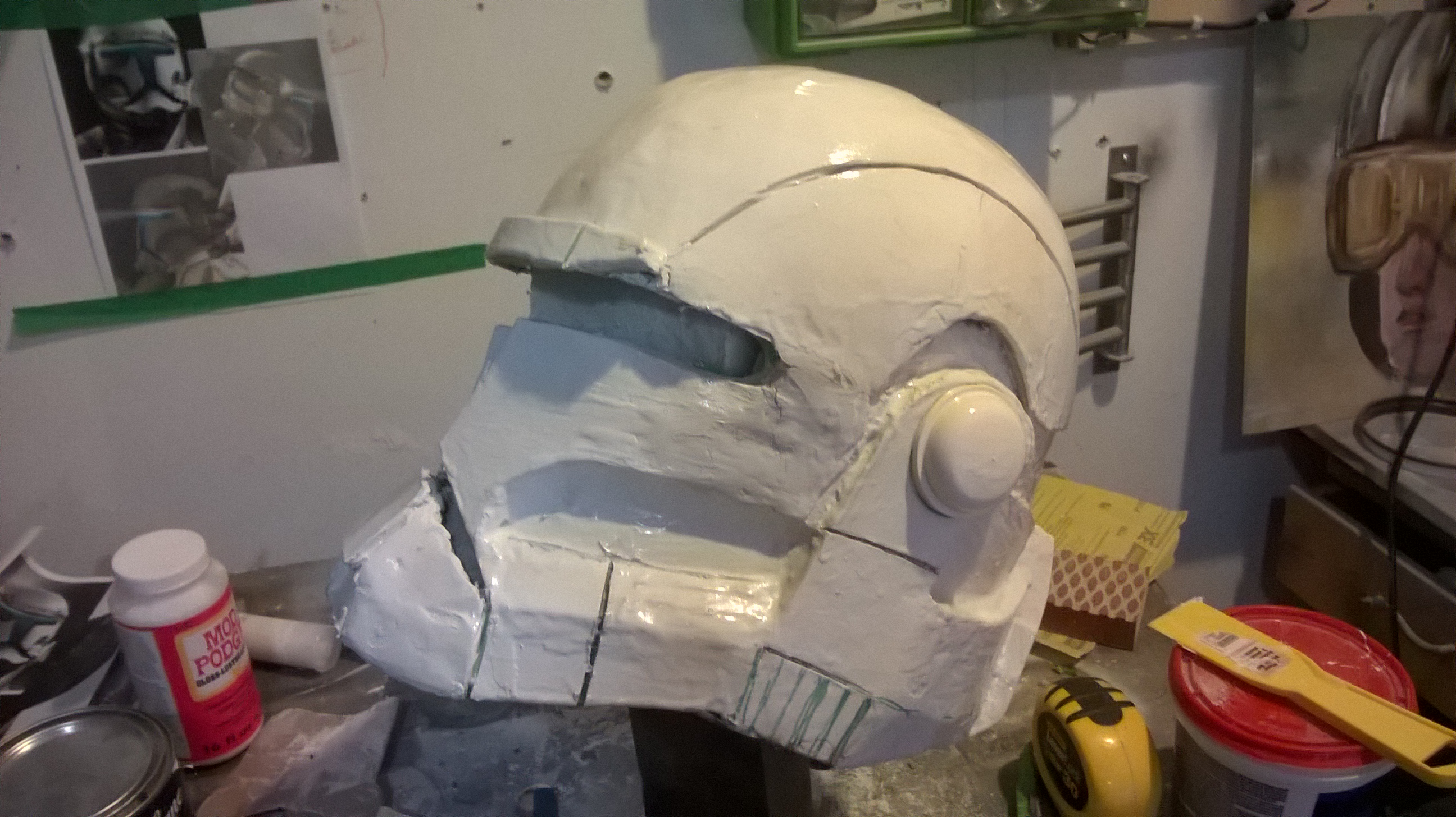

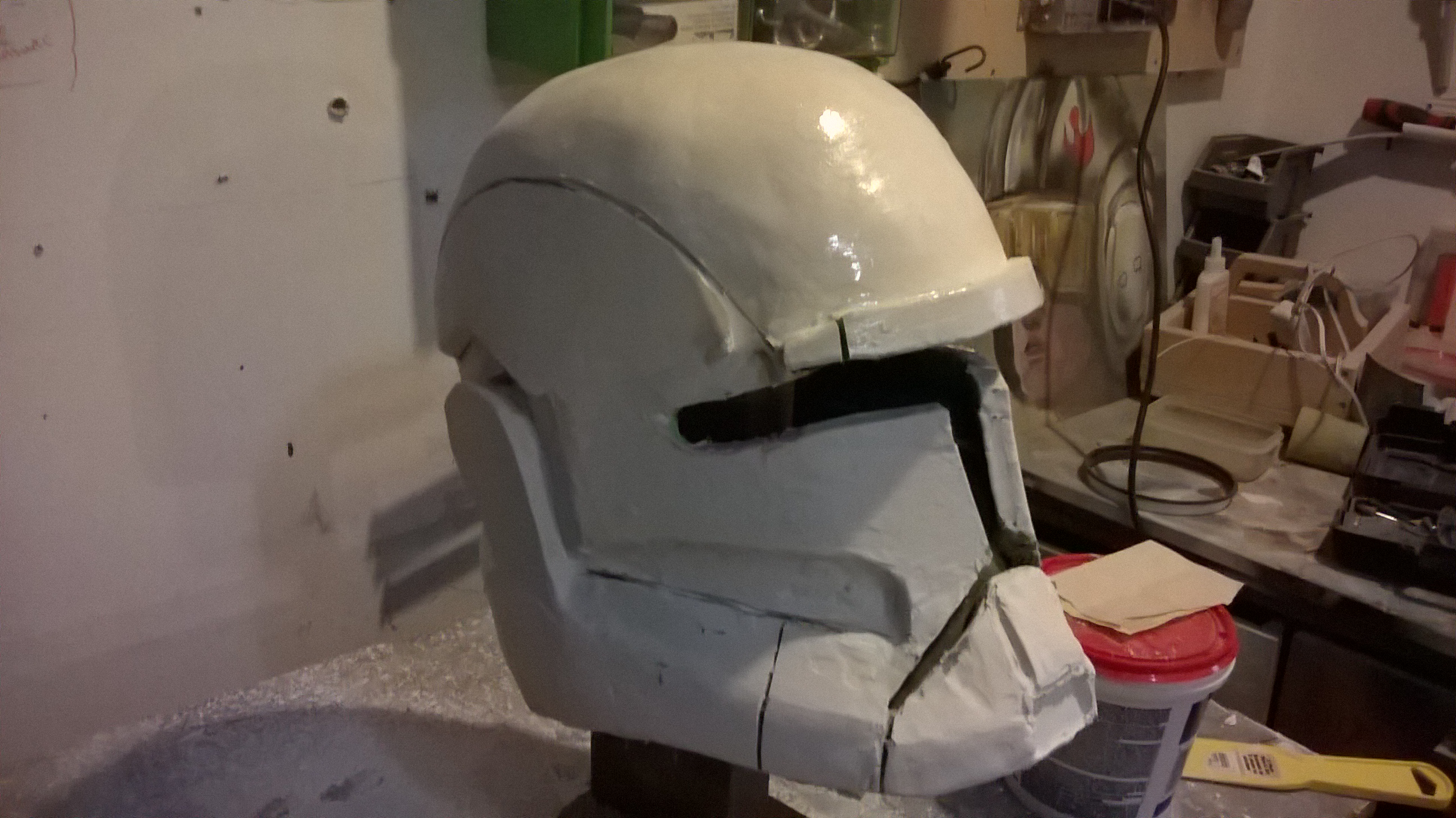

After a day or so of fiddling with the front, I took a look at the left ear, and fitted a semi-dome that I had lying around in my greeblies box. I also marked up where the next series of cuts need to be made.

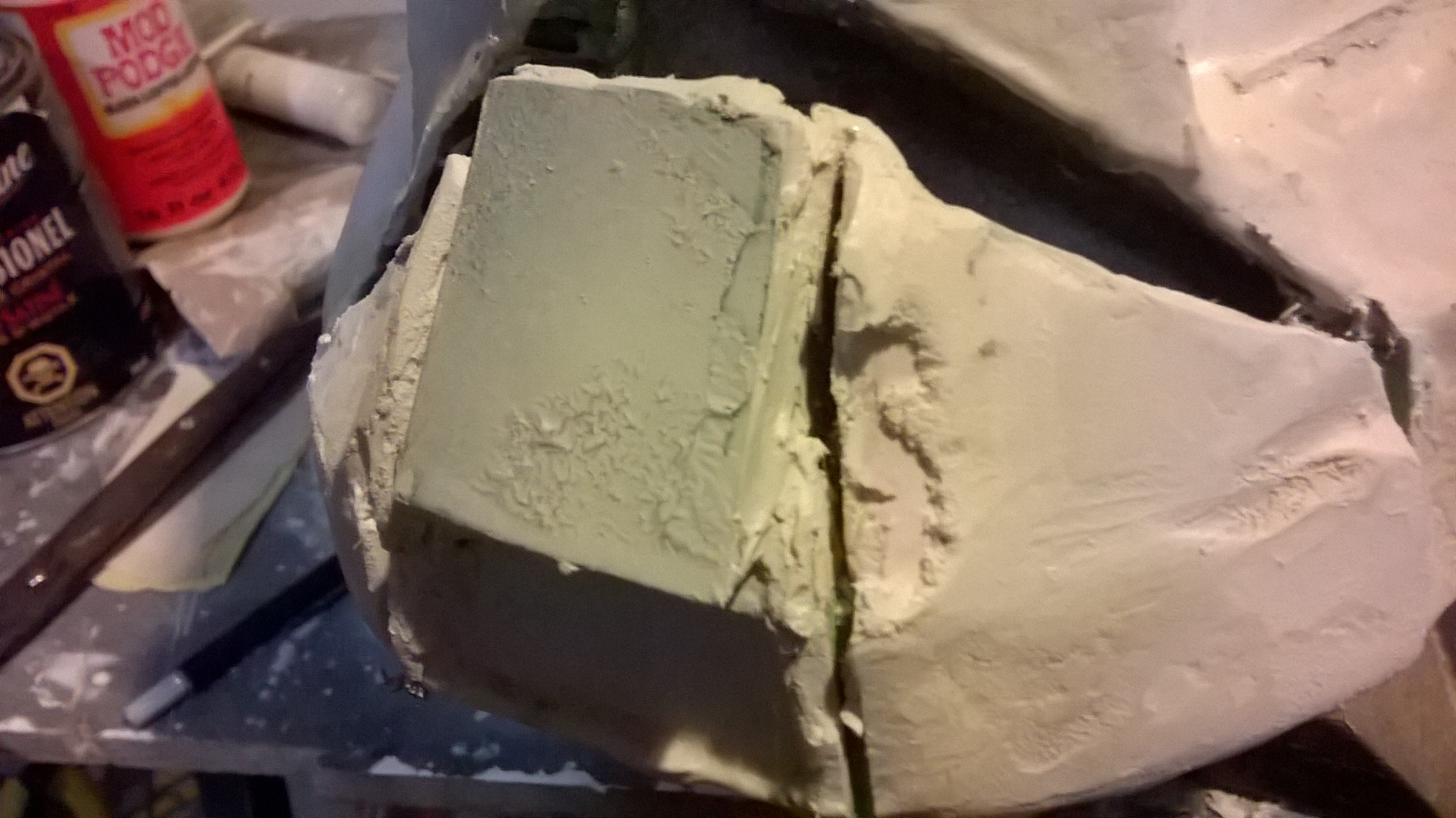

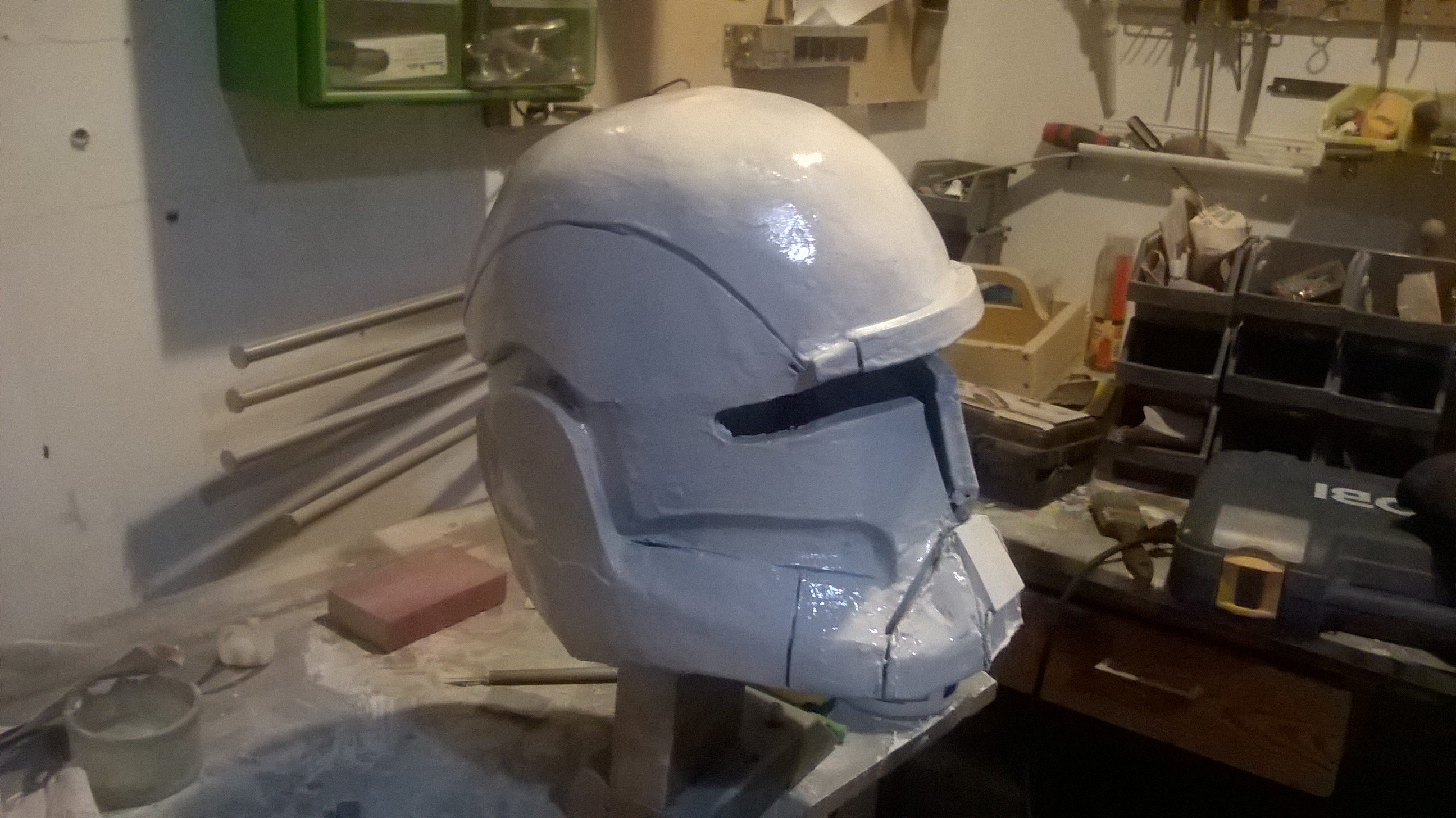

Owch. A little too enthusiastic with the sanding, and a chunk of filler broke away. I'm getting impatient, which is always bad. Today I watched the video for "Battlefront 2" and decided I liked the look of the Imperial Special Forces helmet, which seems to be a TIE Pilot variant, but thinking about what a mess I would make of that was quite depressing. I repaired this damage and added a little more paint here and there, a little more sanding in other areas.
I still have more sanding to do overall, have to finish figuring out how the lights fit in properly and what I need to do to the ear on the right hand side. I have a light for it, but need to figure out the shapes.

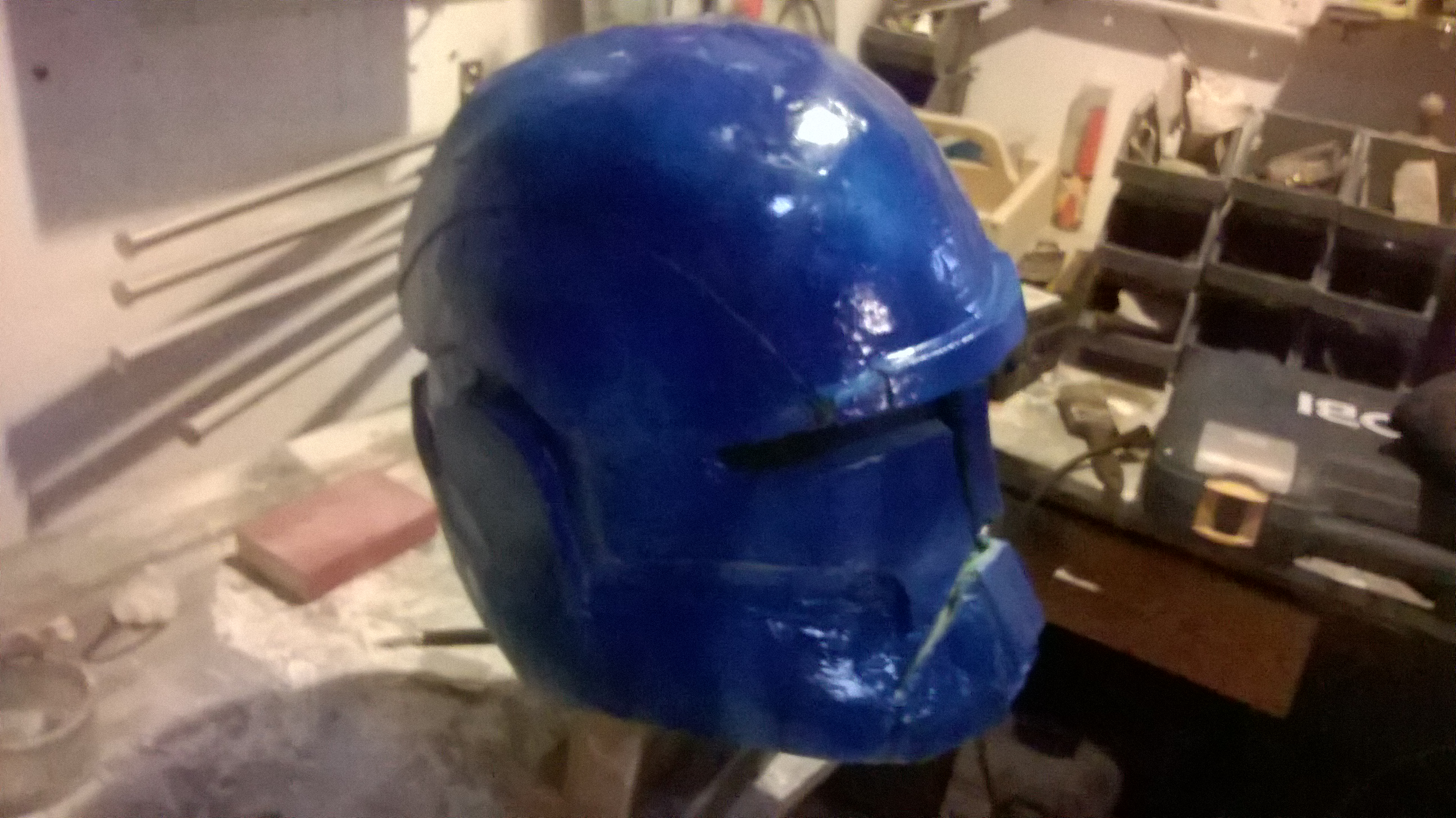

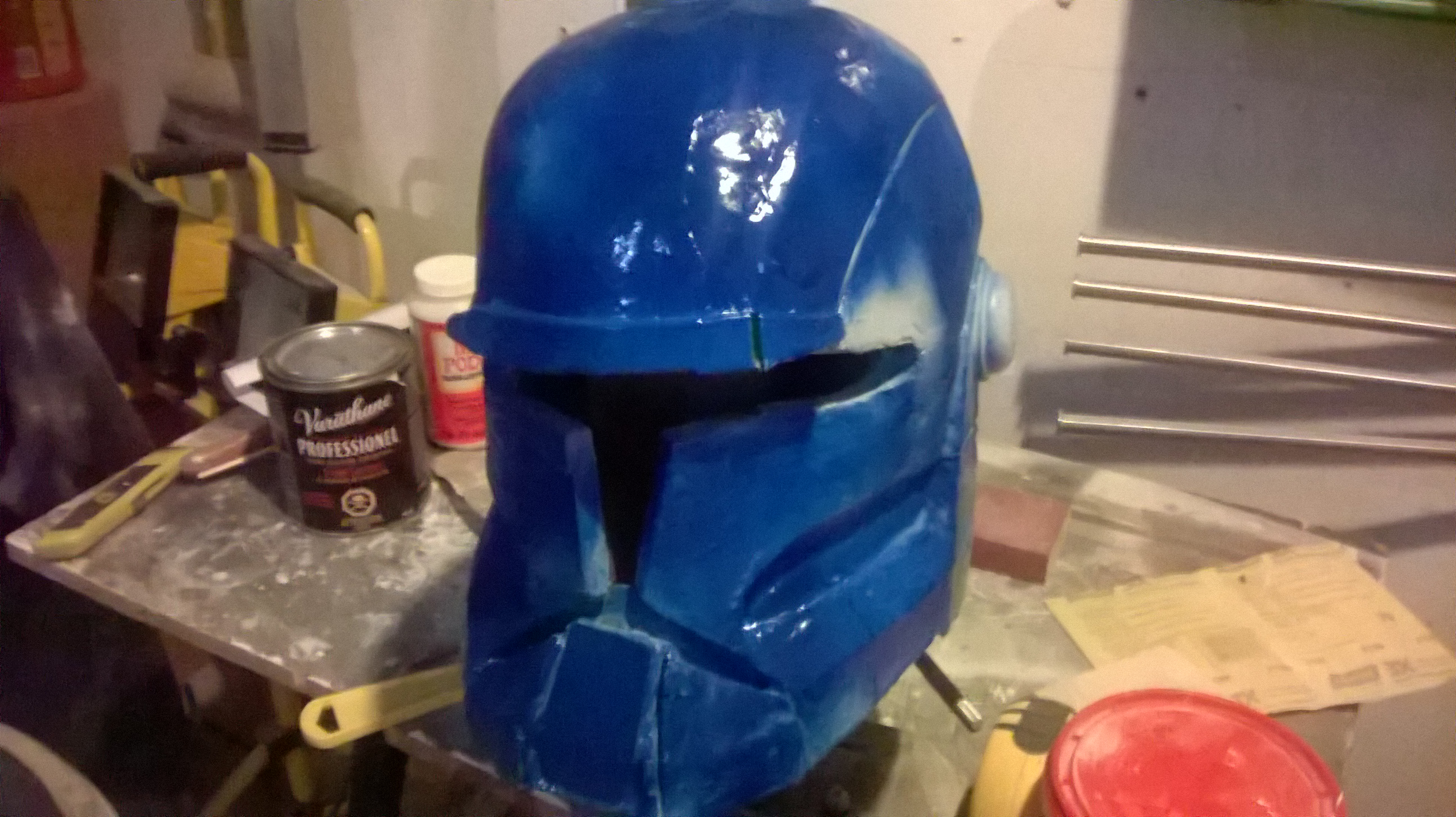

Someone - and I'm not admitting anything here, but it MIGHT have been me - thought that the solution to the orange peel effect could be to use a different type of spray paint. And they sprayed my damn helmet blue.
Not even doing a very thorough job, you'll notice. My guess is that they were overcome by guilt about the things they were supposed to be doing instead of hiding in the workshop and spraying helmets.
Anyway, look, it worked.
Still have other surfacing issues, but this small patch on the chin is fine. And blue.
I'm blue all over.... Except for a few patches here and there. Lucky my wife bought that white spray paint...

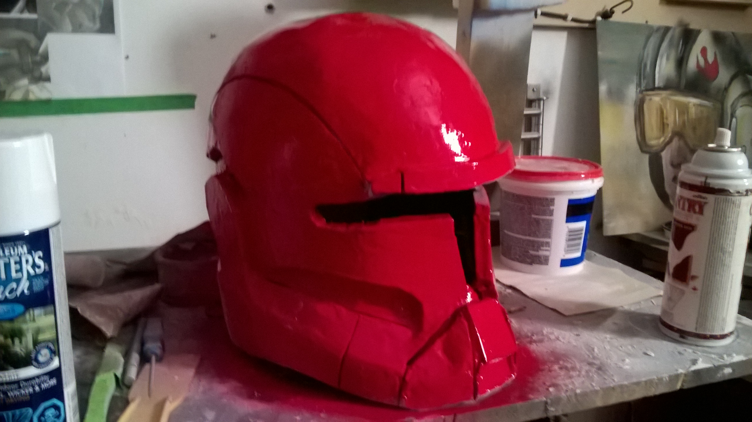

One day I'll have time to finish this, right? And then... Then I can get to work ruining this beautiful thing:
