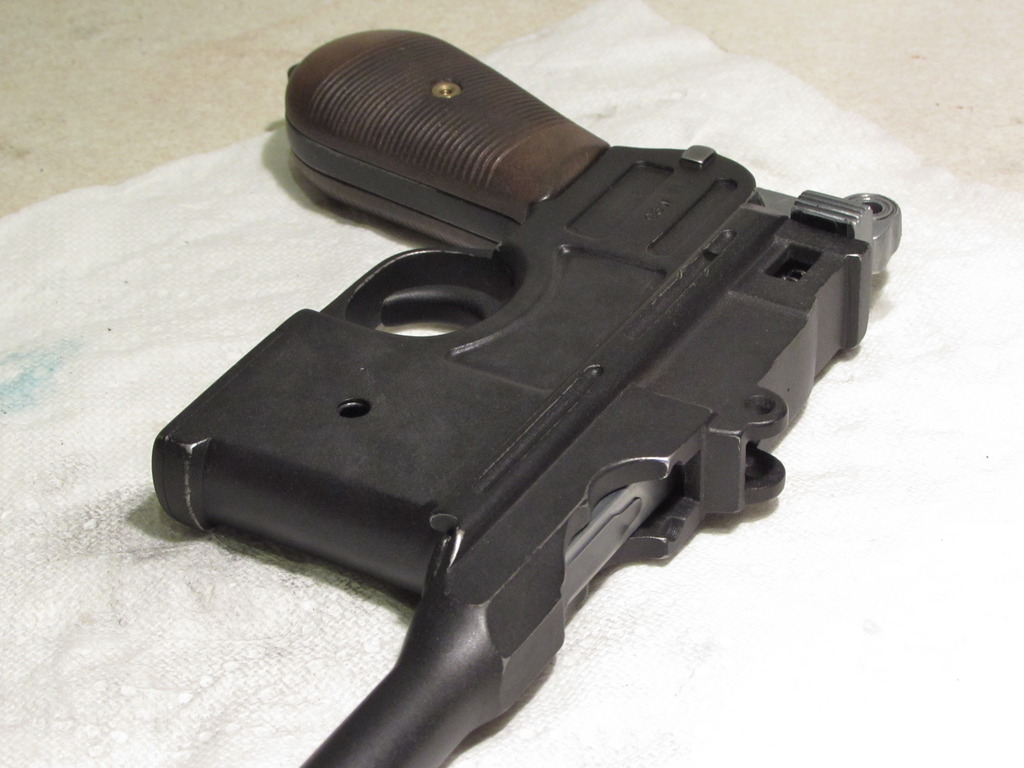

Still working on the finish, but man, that metal is smooth now. I got rid of all that nasty pitting. Detail is still pretty sharp, so things are looking good.
Thanks guys! Next up on the chopping block is the site. I popped the slide off and filed all the edges to get rid of those ugly seams. I also took off the "butt". I got it down as far as I could without cutting into the hole for the pin. You can't really tell in the pic but I also rounded the front end a little so it's not so squared off and more like a real one.
I'm going to darken and weather it a little bit with some perma blue.

I got everything put back together today. The site parts were all re-blued and weathered. I had to cut down the pin a little because I had countersunk the holes. I refinished and weathered the grips a while ago too.

Thanks guys. After I put the site back on, it started flopping around whenever you moved the gun. In the past, I had fixed this by gluing it down. This time I went for something a little different. I drilled out holes for small neodymium magnets and set them flush into the gun. Now the site clicks into place and stays put unless you want to raise it.

Here's the magnet before touching up the paint. The other one is on the bottom of the slide.
I also had to make another extractor for the bolt. I ruined the first one by reshaping it too much. This is cut out of thin steel and blued just like the other one.
