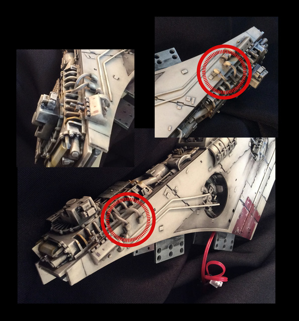

Hey DARK don't forget that the box on that top port mandible just behind your circles in your pics here...
Is actually in the wrong position and needs to be moved to the end and edge once you have the mandible in place on the main hull as shown in your reference shots. As well as finishing off the tubing that is in the same area that just abruptly ends rather than running up under the main hull armor as it's supposed to as seen in the reference shots. (Not sure why it shrank your image so much but you of course have the original).
I figured you'd want to adjust those things and adjust the weathering on them as well...
If we finite every single detail then just about every build is wrong in some way or other especially the Deago, Yeah l know the box needs moving but lm waiting till it's joined to the hull before revising and doing the smaller details in both weathering/decals/moving and what small parts l see clearly are missing about the engine portside parts. At the end of the day a happy medium will suffice.
The pipes were just a start, I've a tad drilling and ring ends to add when l look for something suitable, Already made queries about other parts. :).

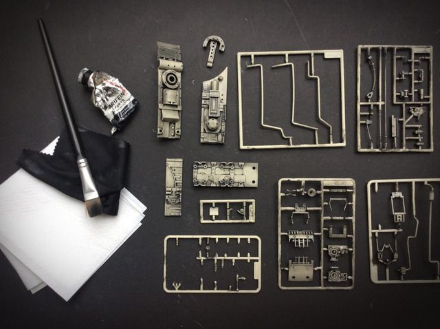

Here's more of the side details in early weatthering....1st painted black then rubbed with a paper towel...you can leave it anywhere from straight away till an hour to rub off, no rush...add white spirit when needed to wipe more away... also a fine sandpaper if good to use long after dry.
Also a fine cloth, like a lens cleaner helps smooth wear n' tear.

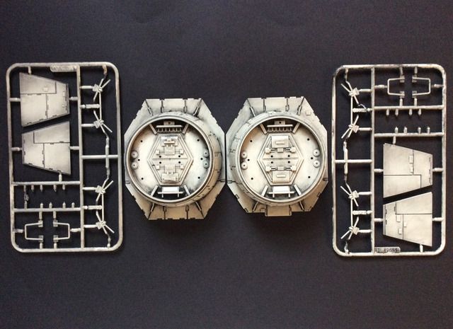

Hello, thought ld show you the Airlocks lve started from issue 95. below is raw...
Below: with the weathering as per usual to start off with, (like pg7 standard guide) will post the finished when l've
time over this festive period. lve had a kitchen to decorate never mind the stuff we buy this time of year/work etc.
Also got in the new year Shapeways and other reviews, tips... lf you look at this picture you'll see lve cut & stuck
to the Airlocks what l deem needed to the first weathering from the runners first off!.
I'm also planning to get mine started over the Xmas break. Would be great if you could outline in a bit more detail the processes you use after the initial weathering technique. From what I can recall it's weathering kit A,B or C from Tamiya and maybe a wash ? But I'm never sure to what extent, or if there is any additional weathering techniques you use on pieces like these. I was thinking of adding some small rust streaks here and there too.
Would you recommend keeping the smaller parts on the sprues for the initial weathering ? I could imagine it makes it a bit easier to handle them. Just need to be careful not to break anything I guess.
I will outline the next stages as l do them, same as page 7 etc... yes lm happy doing the black wash weathering on the runners wherever possible, l just cut them off when dry and sand the runner marks away then use the soot Tamiya kit black to cover plus the sanding is great to take off any excess dried black oil that looks wrong etc.

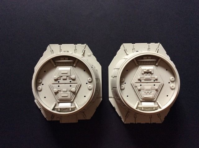

So I've done one test piece (like a few others) before I really get started. I did it in two halves. One with less oil taken off, the other with more removed with some thinner.
At first I liked the side with more black on it, however when it comes to streaks etc I think less background black on the panels is better.
Jordan, one question. Do you typically remove the oils on the panels back to the original base colour ? I've looked through your thread and it's not always so easy to tell with the photo colours.
I did start removing the oil straight away. Perhaps I should allow to dry for a while, then rub off. That might get me a look between the two extremes. Weathering "soot" can add to the base colour I guess, but I find it's not as easy to apply as the oil.
I usually leave it 10-15 mins then rub off with paper towels till I get the required effect, yours looks great, the left side looks a tad dark I do tend to add a little white spirit to a cloth and rub after... it helps the black spread & cleans panels, the base colours fine by me, it sometimes adds a satin shine to the surface tho...but that will be sorted with the Matt fixer spray l mentioned earlier in the thread towards the end of the build.
