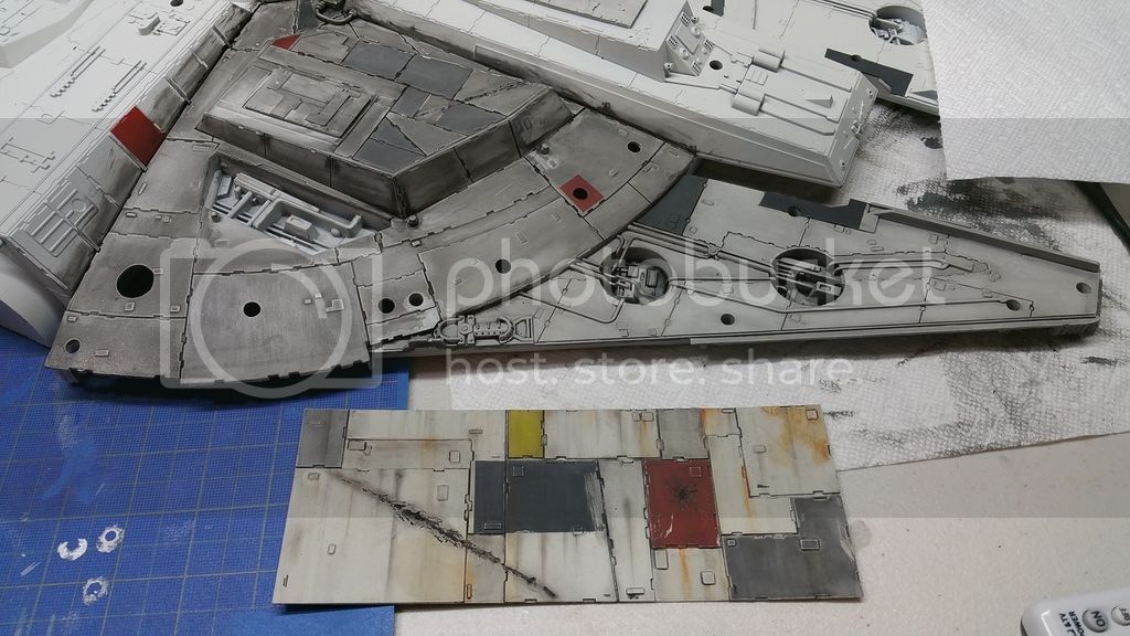

Hey Darkview I got a question for you. You are applying this oil method directly to the unpainted surface of the deago plastic parts right? So my question is, if I want to use this method on a model that must first be painted, what kind of clear coat would be best to apply over my base coat and panels so that this oil method will get the most accurate results to what your getting?

Yes to the first question. To tell you the truth I've never thought of using this method for anything else that would require a base coat.
The method of rubbing would ruin it, definitely with using white spirit as a thinner.... lve used it on things like my pre painted BB8 l showed earlier in this thread. If I were to paint a model id do it the old (long) fashion way .... priming, paint/spraying/dry brushing etc

I created a test piece earlier this summer to test my method and it worked great. (You can see it in the pic) So I have been spending the lest few months doing everything with that plan in mind. I got the base coat done and all of the panels masked and painted and some initial wear done and everything was going great! Until I started adding oils. And now it's completely messed up and I don't know what to do!
The method I used on my test piece was tamiya surface primer, then insignia white, then scratches and scuffs, then oils. This worked beautifully.
Now when I did that on the mandible of my actual falcon you can see in the pic...it was too dark. I couldn't remember my exact process so I thought maybe I did a dull coat before I did oils. So last night I sprayed a dull coat over it and tonight I tried to apply oils and it's even worse! You can see the dark section of the hull. Using turps to try to remove the oils does nothing! I have no idea how to fix this! Please help!!!
What l do & show in this thread is only for the deagostini Falcon with its factory set supplied colour. (not sure what kit that falcon is your showing?).
I'd clearly stated throughout my thread it's for factory set surfaces if it's a darn good colour match.
You may have to strip it & redo, google removing sprays, paints etc...hope you manage to resolve your dilemma
or ask others advice in the main thread. Wish l could help more but I've never had that problem, sorry.
SirCharles77, had similar problems with applying ( and leaving ) too dark an oil coat. Methods that worked for me were a: rubbing selected panels ( in direction of intended flow-lines I.e gravity streaks ) , using an ordinary pencil eraser ( Jordan's idea ). b: rubbing away at said panels/areas with ' magic eraser ' made by ' Chux ' cleaning products here in Oz. Just followed the instructions and it works a treat. That idea came from Brian Taylor. I used both ' lightening ' methods on areas with/out a primer/colour applied over the natural kit supplied plastic colour. Jordan hope I wasn't stepping over the line by offering advice on your thread mate. ✌️

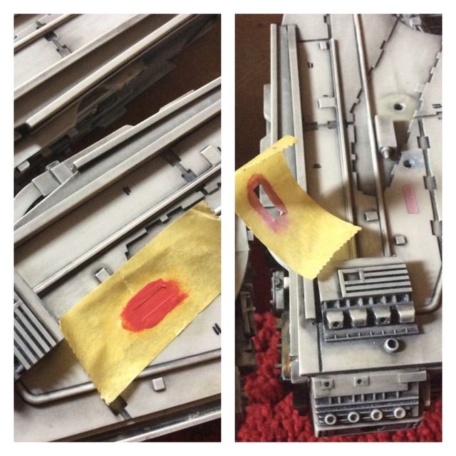

Ha ha yes Mike, l then just added some Tamiya Weathering Master Kit white SNOW powder within the mask or after peeling.
But you can just use any enamel/acrylic/paint whatever. Perhaps just mix a fade Red to get required tone first. I stuck the tape on a cutting board first then cut it out.

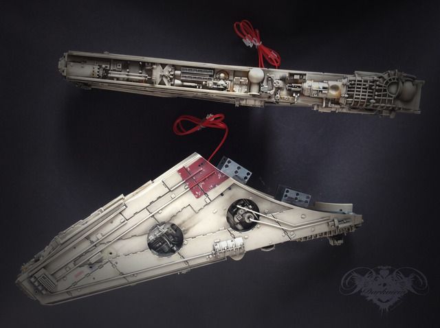

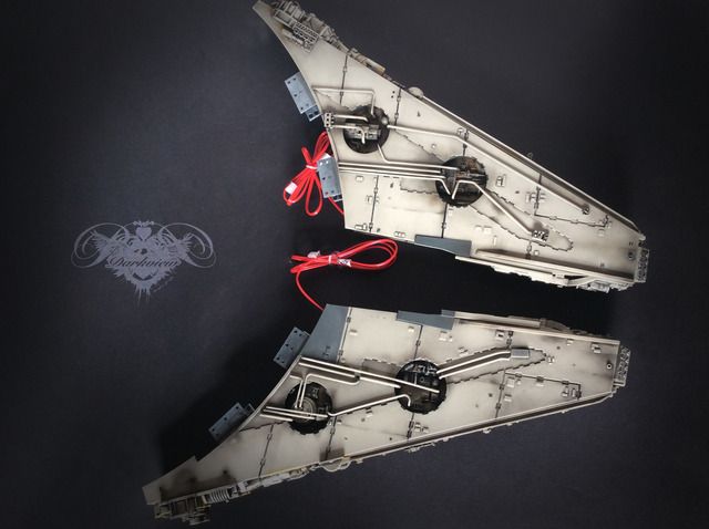

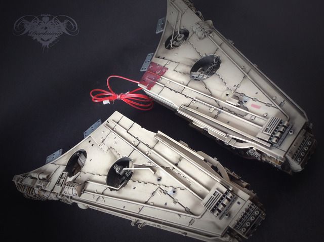

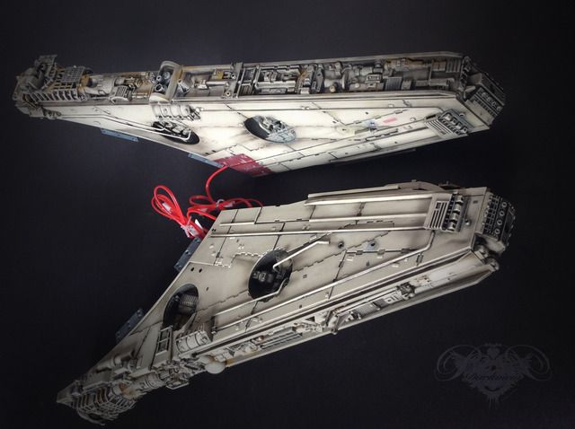

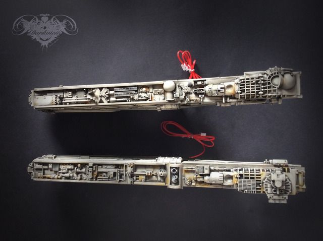

Tomorrow after my Hallowe'en shenanigans tonight I'll show my finished mandibles & rust techniques I've done on the side details.. With the last 8 or so issues, lve decisions to make with lighting,floors etc...internal stuff and lm gonna take my sweet time getting it right for me before sealing this big old bird. ;-)
Mandibles so far.
Rusts....ld researched all the rusty areas and brushed in with various Tamiya Weathering powders rust colours.
I then found some Acrylics lve had for years so with a dish and a bit of water added the rust in various places to try to
match the studio model splat like rusts, not a big fan of the original weather but know them guys were probably in a hurry!.
Anyway I can add or fade it (note 3rd picture up) when it's finished if l feel it needs more or less or tone down the orange with
a darker rust but for now I'm happy.
Beautiful weathering on the mandibles Jordan. Any problems applying acrylics over the oil base coat , and , have you considered watercolours as well ? Asking 'cause I've come across various YouTube videos where these mediums are discussed for ' finishing ' off detailing/weathering too!. Cheers
