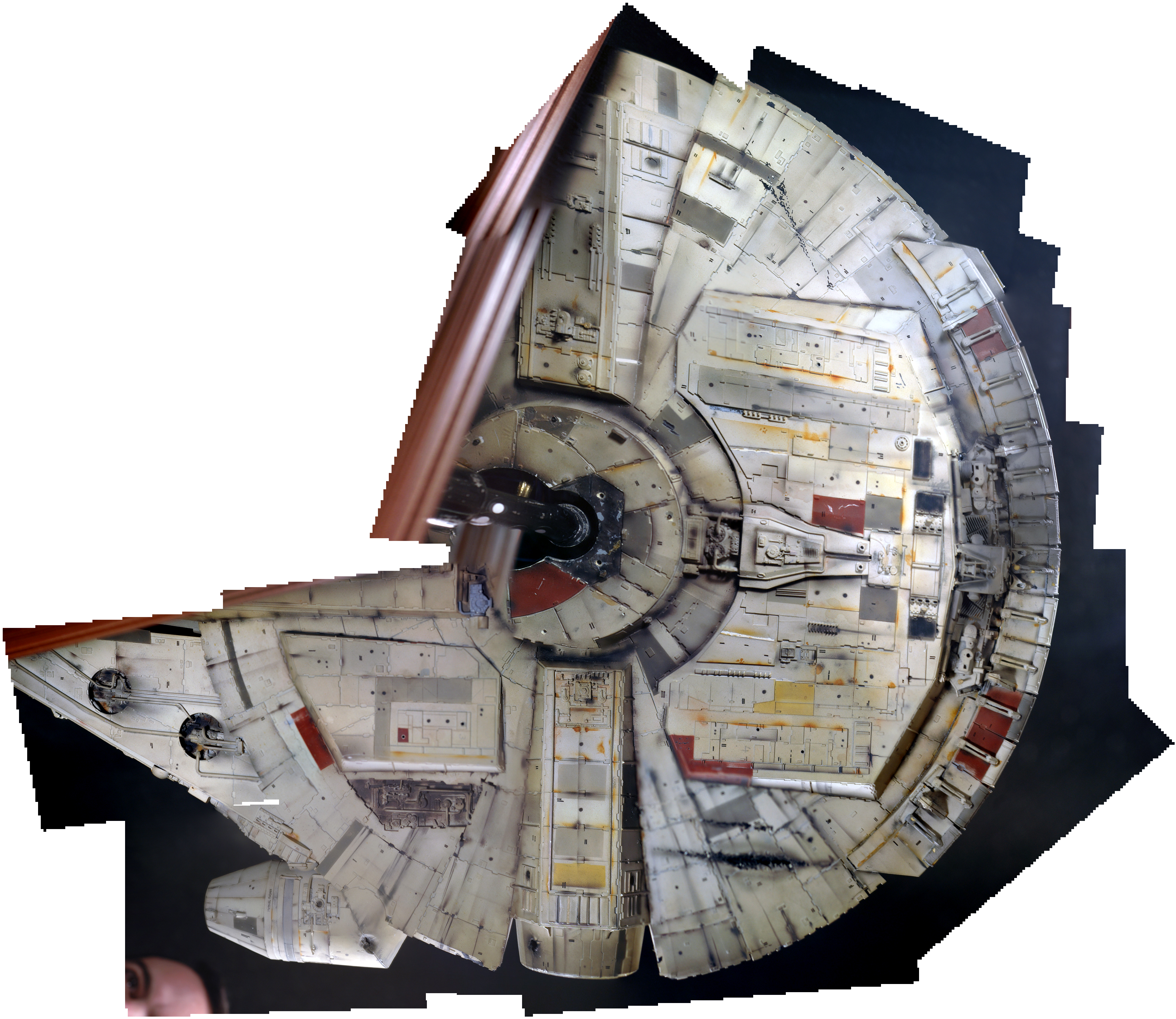

I've reversed the support bolts now I'm reasonably happy with the weathered underside.....only bits lm going to refocus on later is the rusts & that awful yellowing rust parts you see on the studio ESB Falcon, but still happy as.....

Thanks dudes, l only want it to help builders....lm not using any true 'Yellow' as you call it but for now I'm using Tamiya E for now....it's a understanding that what l may think of as yellow may be rusty colour lve once been told, it's up to seeing more promised photo actual of the studio Falcon so I may later change its rusty yellow colours... Never been keen on the yellow marks but will follow its design.
