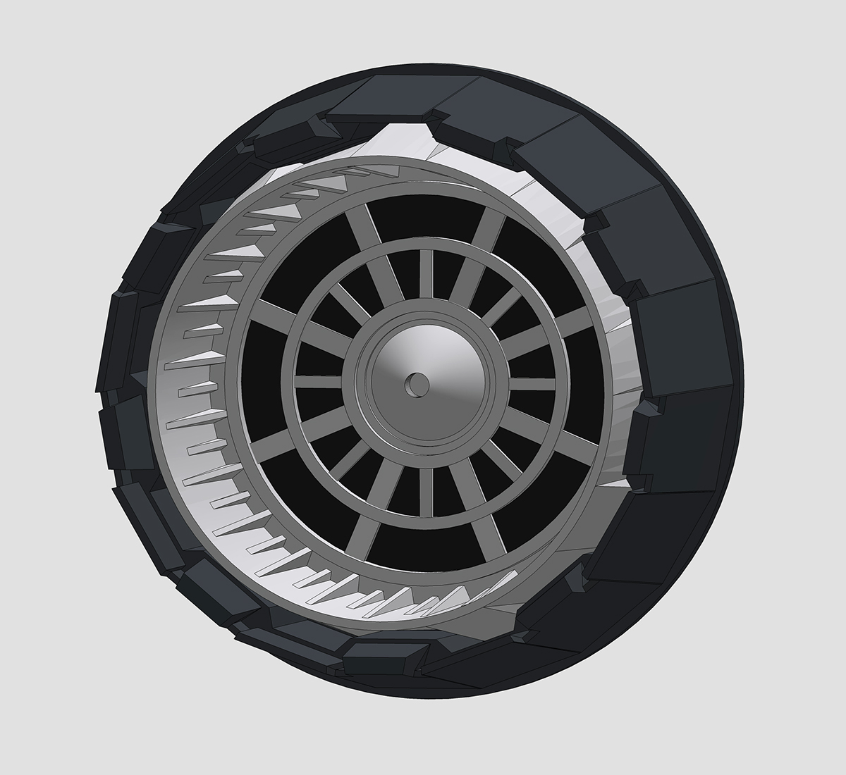

Decided the engines outer facets will be photo etch over a simple base structure so they can be glued on. Will be fiddly with 18 pieces for each engine but will keep the fine detail that casting a master I think would lose.
Engine feather fit over the dark grey part, inner engine is new also following the full size version

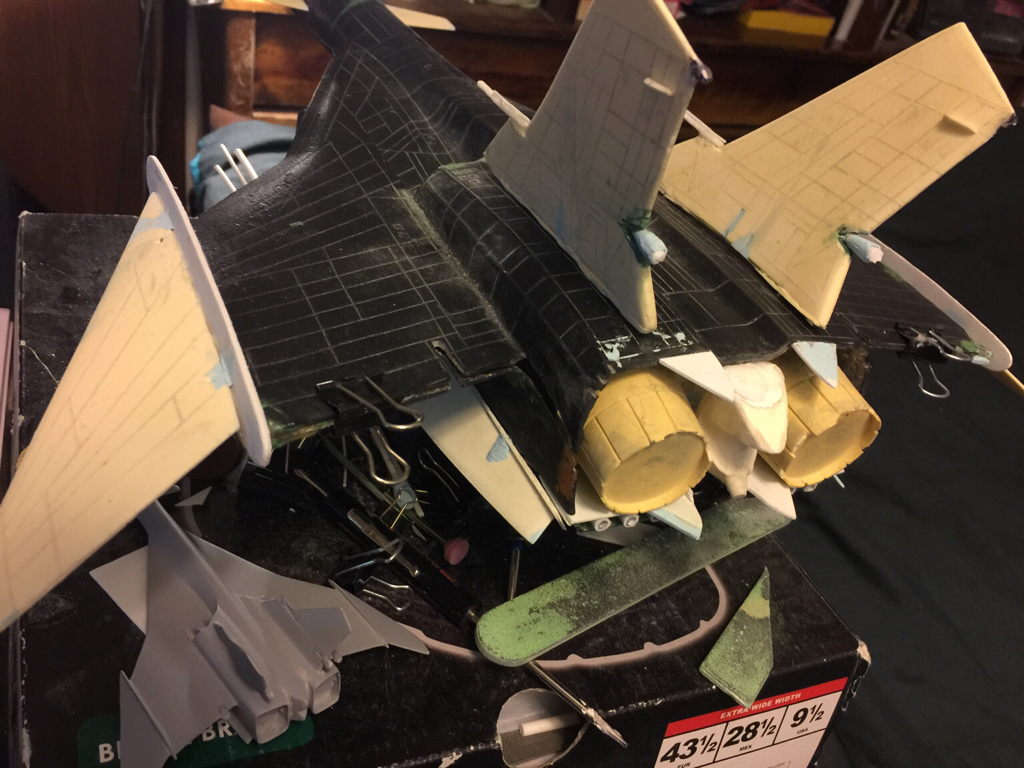

As I said a number of parts rebuilt or fixed, remade most of the front fuselage as I could see the profile much clearer and the shaping of the top of the canopy which was too flat before. Panel lines still have to be embossed, wanted to make sure everything was right before I committed as it's damn hard to undo afterwards!

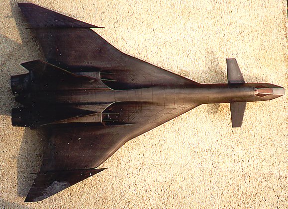

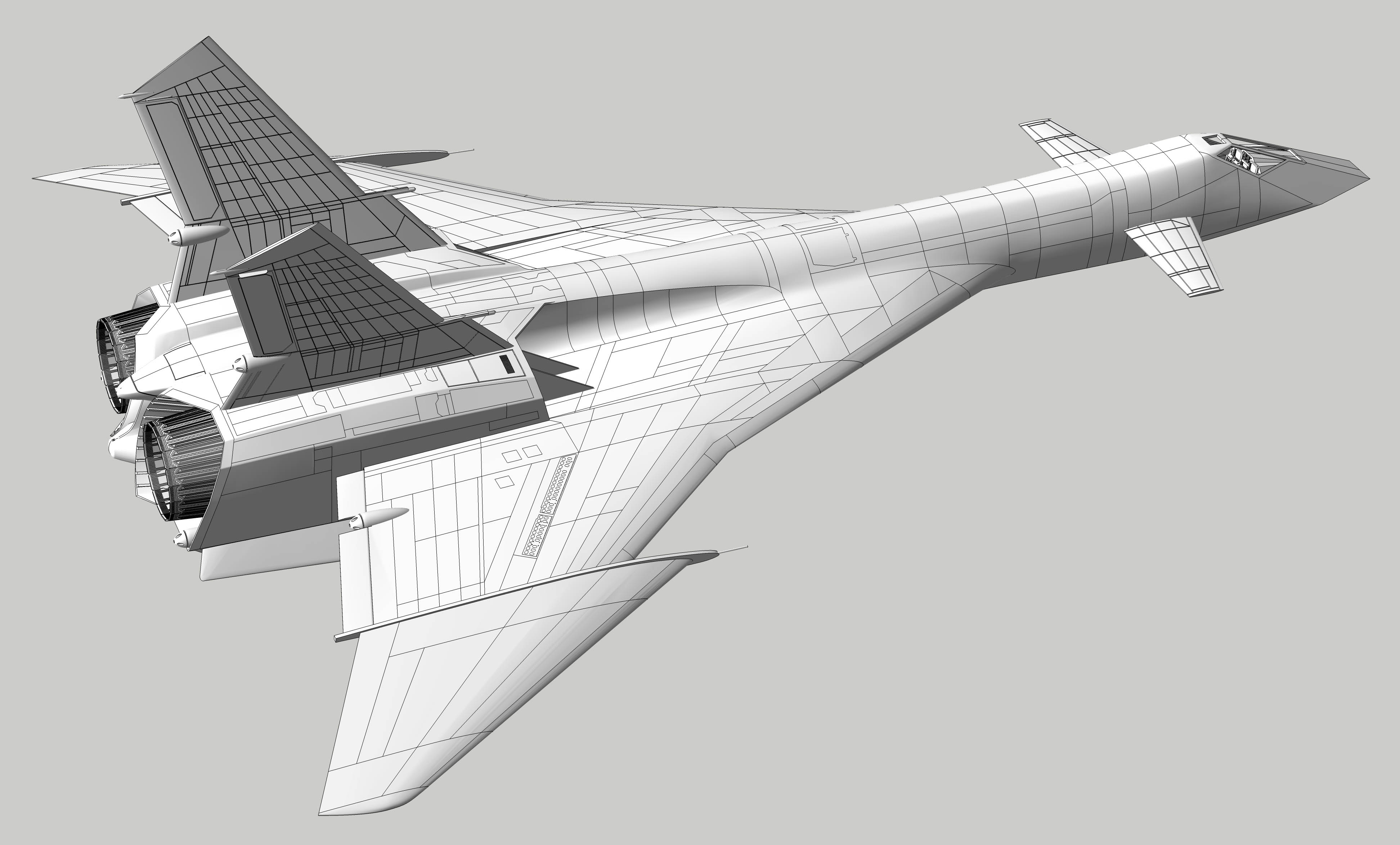

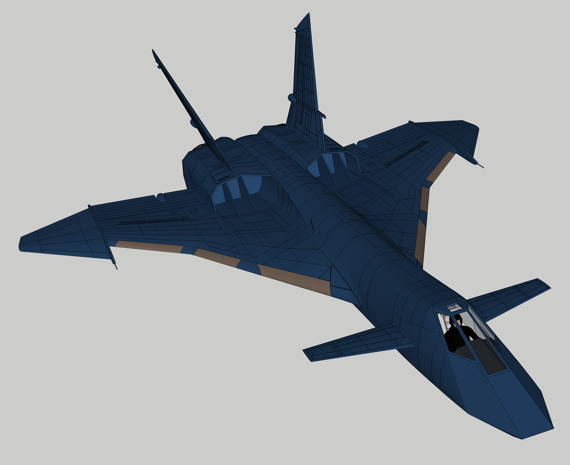

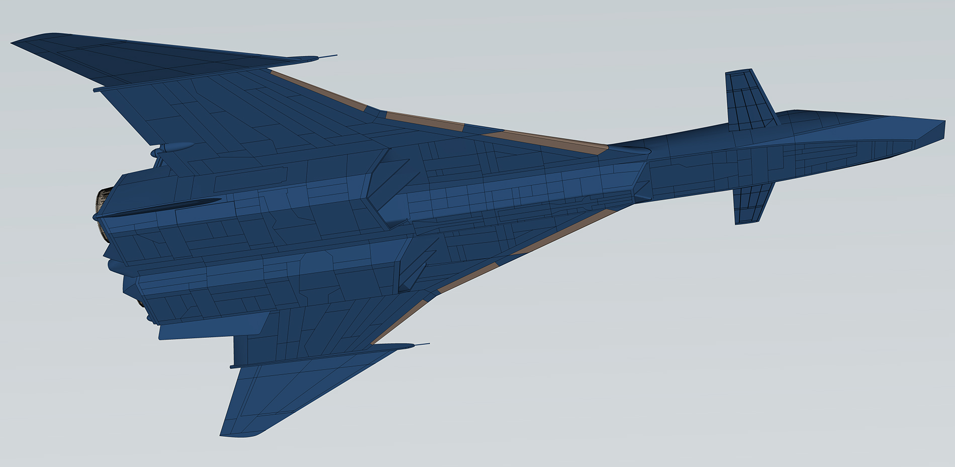

Last bit of fiddling/tweaking done, finally got the front fuselage neck/wing transition right. Something about it kept bugging me, on the original there is a way the shadow/highlights are created that I didn't have. Finally realised the top of the fuselage from a bit behind the canards to the wing root is sculpted/flattened in quite significantly above the midline, much more than I thought. It's hidden as for some reason that part has very little panel lines compared to the rest of the plane. There are a couple of extra panel lines in there more for me as it shows the transition of the shaping
Left the pics in monochrome as you can see the shadow change, it shows up more in the top down view - the top flattened section narrows then widens and blends to the rounded part around the airbrakes. It probably looks hardly any different to anyone else than me, but now it just looks correct. These are big pics so click and click again for full size.

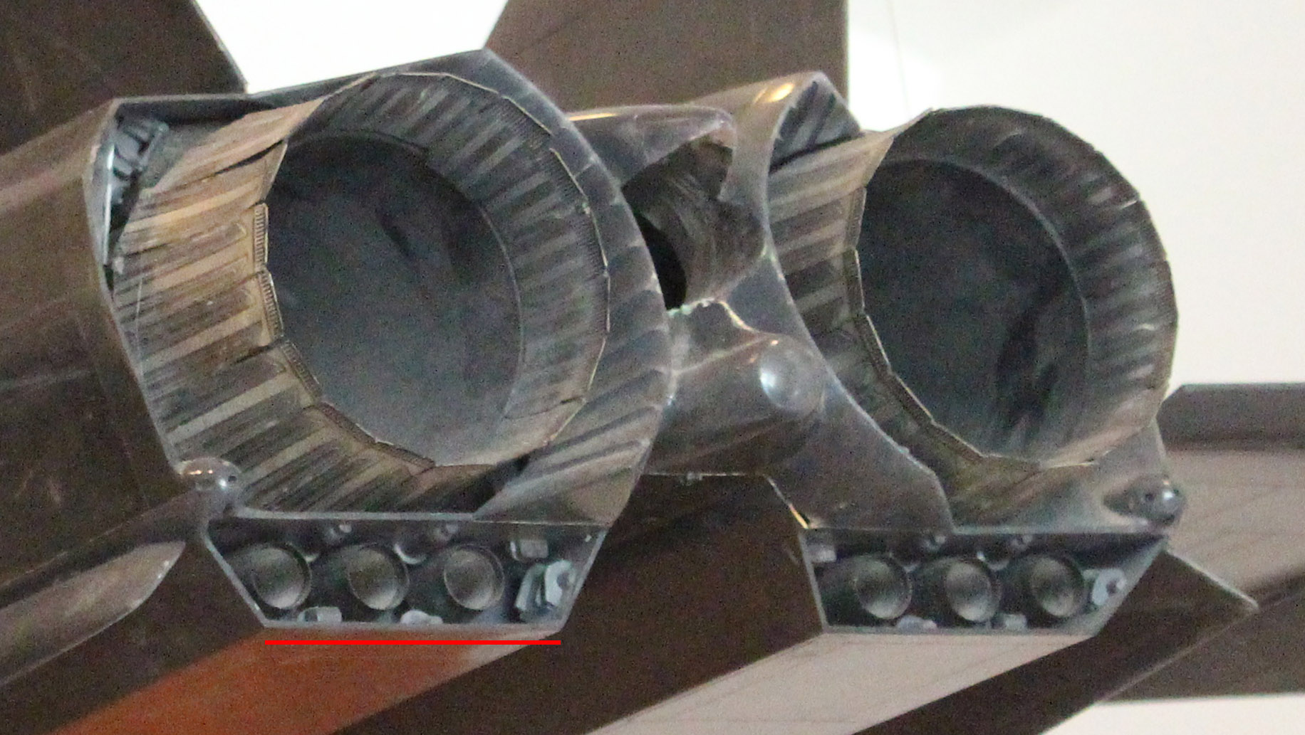

Meant to ask this a while ago, there are some what I think must be kit parts around the lower engine section, does anyone recognise them?Firefox engine parts.jpg
The width denoted by the red line is 90mm or 3.5 inches. There are 2 parts on the inner top surface, look like half a spark plug to me, but might be 2 parts put together. Then one on the inside edge and bottom middle which looks vaguely familiar, maybe on the Millennium Falcon? Then another part top right and bottom left which makes me think of a fuel tank with straps?
It's not a big deal as this is 1/12th and it's unlikely the parts are available in the smaller scales, will just have to model something similar.

I don't recognize any of the lower parts, but this is from the Kettenkrad.
Parts under the engines look like the tops of shock struts (thrust collar visible...)
Hi Robert is there a pic of the Kettenkrad part available, I know I have seen part maps on here somewhere? I wasn't planning on incorporating that bit as I am not sure it is on all the versions, and it leaves little material on the corner at 1/48th.
I will just scratch the other parts, that's the best/only view I have of them.

I am about to start printing 1/24th pieces for my model, these will be a first run test to see it actually looks right in the flesh. Also working on the Form1 resin printer to get that going for the 1/48th master, looks like the silicone base in the resin tray has started to break down as resin had been left in some considerable time, turns out the life of the trays is ridiculously short, you have to treat them as a consumable.
After a lot of web searching and suggestions for improvements by people running Form or other laser/DLP printers have found a more suitable replacement silicone to re-do the tray myself for a fraction of the price of new trays.

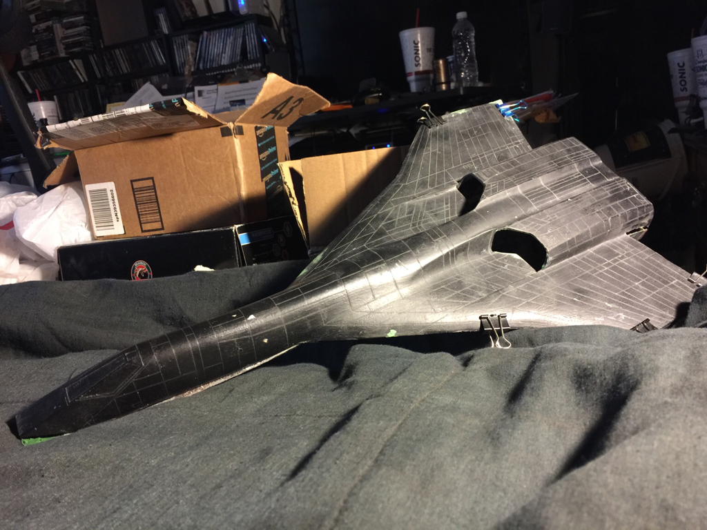

I thought I would throw a few pics of it out there for everyone to check out. It came in 2 fiberglass halfs with resin parts.
I also took a few pics with the parts rough mounted.
As you can see from the pics I've got my work cut out for me lol. Not sure how I'll get the shrouds done, defense pods etc..Also looks like with the added tailpiece it comes out to roughly 20 inches.
Also I'm a noob when it comes to forums and never post so apologies if the pics attached are the wrong formats or maybe not following a certain forum protocol so by all means let me know. Just looking for suggestions other than put it in the garbage lol.
Sean
DO NOT PUT IT IN THE GARBAGE!
I am fairly certain that is a cast from the moulds of the 21" version as it matches this one, can't remember where I found these but the panel line pattern matches.
But.....it is different to the bigger 1/12th version I am working from. I think it might have been done first as it shares differences that appear in the original 2D plans, where the proportions of the rear section engine pod and wings are different. I would take a guess they made changes on the big one to make it more airworthy.

Jon, it just occured to me that the trio of nozzles might be from a 1/72 scale modern jet fighter kit, given the 'petal' lines engraved on the surface. Something like an F-16 or F-15 kit may have been the source (not an F-14 as they seem? to lack the recursive ring at the opening where the inner layer of nozzle plates show a bit.)
I'm looking for some motorcycle kit scans but no joy yet. I don't think the shock struts would come from the Kett kit since the front forks are enclosed in pressed steel fairings...
R/ Robert
