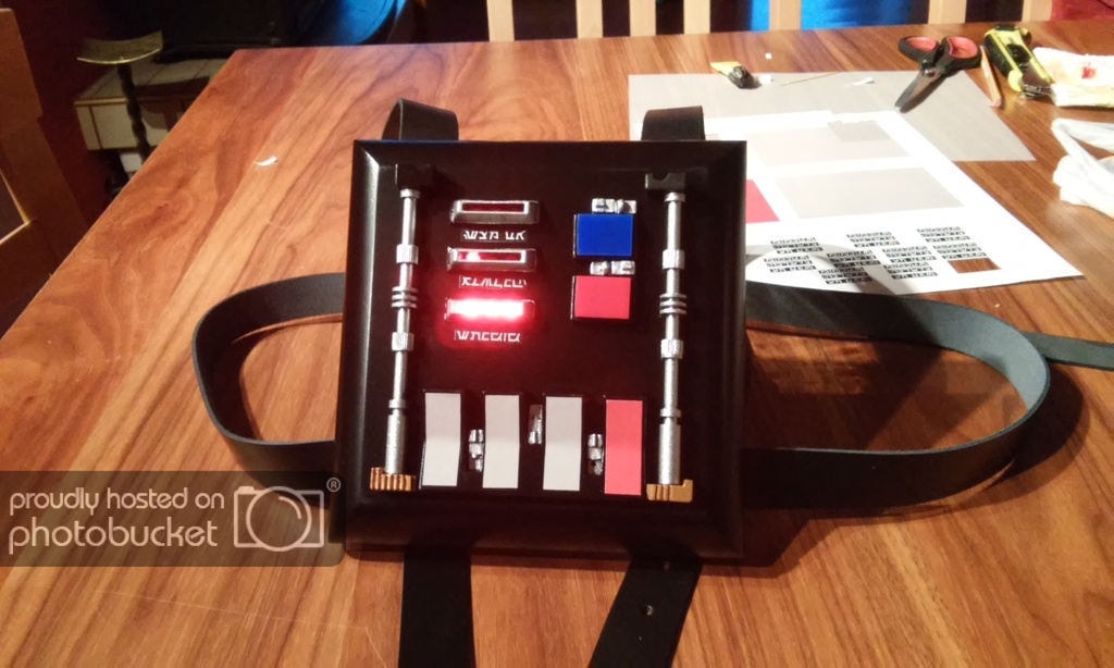

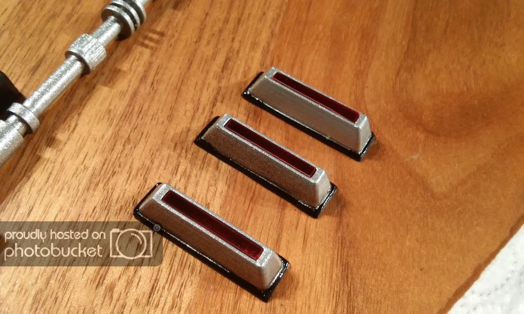

A veeery productive weekend:
Finished the armor, now all I have to do is attach the shoulder bells with a leather straps, but I'll give the clearcoat some more time to dry first.
Chest box is finished too...and I'm really proud how it turned out. After the sanding and acetone smoothing of the 3D prints, some extra work was required to make the golden pieces longer.
Next week I plan to dedicate myself to the mask only ;)
What do you think?
