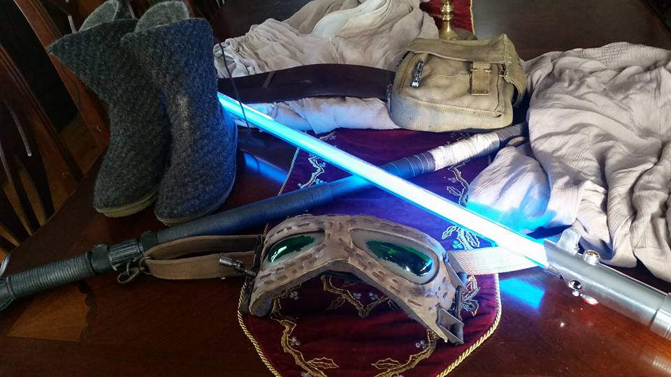

A gathering of a Scavenger's things...

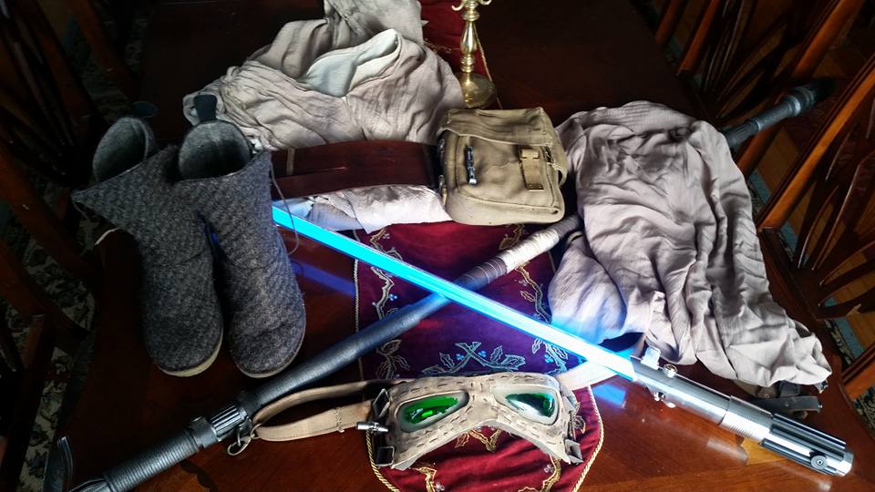

Now to wait for my head wrap fabric to arrive from Dharma, and to find a blasted flashlight for the goggles...!

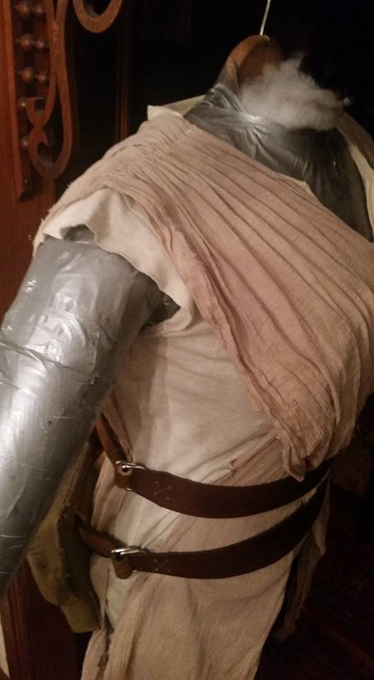

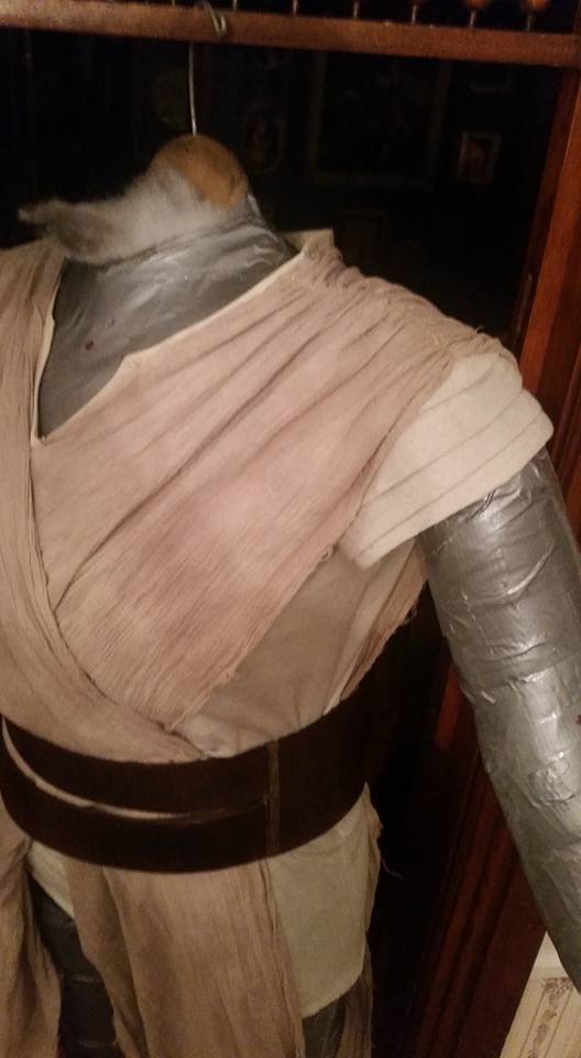

I gathered it first, and then attached it to the shirt at the shoulder seams. once I had that on, I draped it the way that it's meant to go, and then strategically tack stitched it in a few places to the shirt so I can just put it all on at once.
Ok, great! That's basically how I was thinking I was going to do it. I didn't want to have to adjust the wrap every 2 seconds! The color/pleating on it came out great, I know you mentioned you still have some weathering to do but so far, really well done!
Thanks!
The fabric was a good sandy tone to begin with, and then I dipped it in RIT Taupe dye for about 10 seconds and wrung it out and dried it. That sort of gave it a tea stained look.
I want to try airbrushing darker in the folds to make them look more prominent.
I have the Rit taupe as well, but my fabric is more white (I'm using the viscose from Dharma, although I did see a few in Joanns I might test). Thinking about experimenting with a sparay bottle, I've had some success in the past on dirtying up clothes for Walking Dead and Evil Dead stuff.

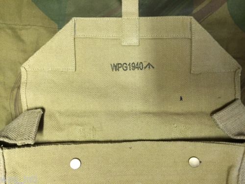

It appears someone is selling a "repro" British P 37 bag on eBay, for those that might want to "dirty it up yourselves" for authenticity:
Item number: 331611544848
(no affiliation, just an observation) ;)
I think this CAN work really well considering its price is that of what the real deal WAS before...and the corners are only folded under so it can be modded easily I think.
Notice the flaps are stiched not cut..
Be forewarned that the pouches unravel really easily and fast so be careful modifying them.

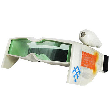

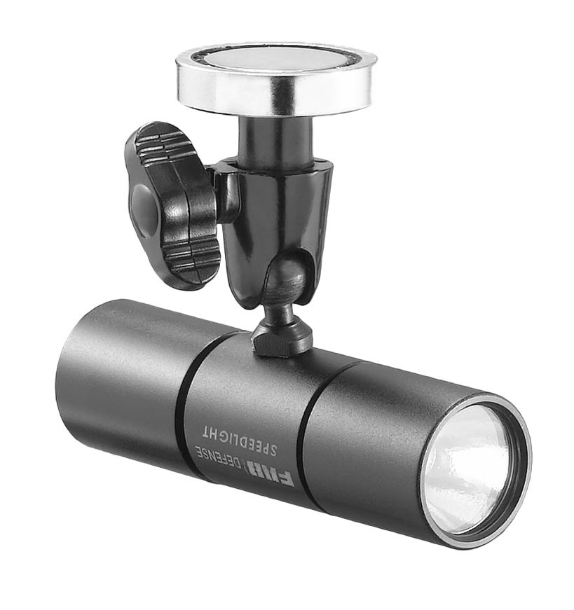

Been scowering the internet for a flashlight...closet thing I can come up with...way to long though. I feel like its gotta be something like my princeton tec helmet light. As in about 2.5-3"
The light they used had a KREE LED.
You can tell because the hero was on display at D23 and it had the yellow light behind the lens (KREE's are yellow in appearance)

I was looking at the cree LED flashlights...are there any shots of the front of the light you have?
Found a few shots in my mess of a folder I saved someone posted in here.... disregard. Going to probably get it 3d printed....

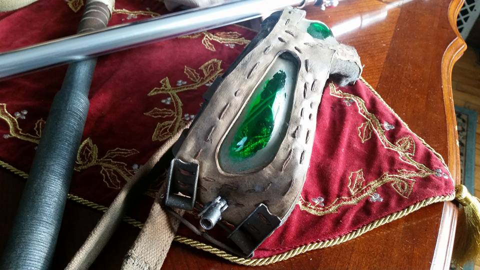

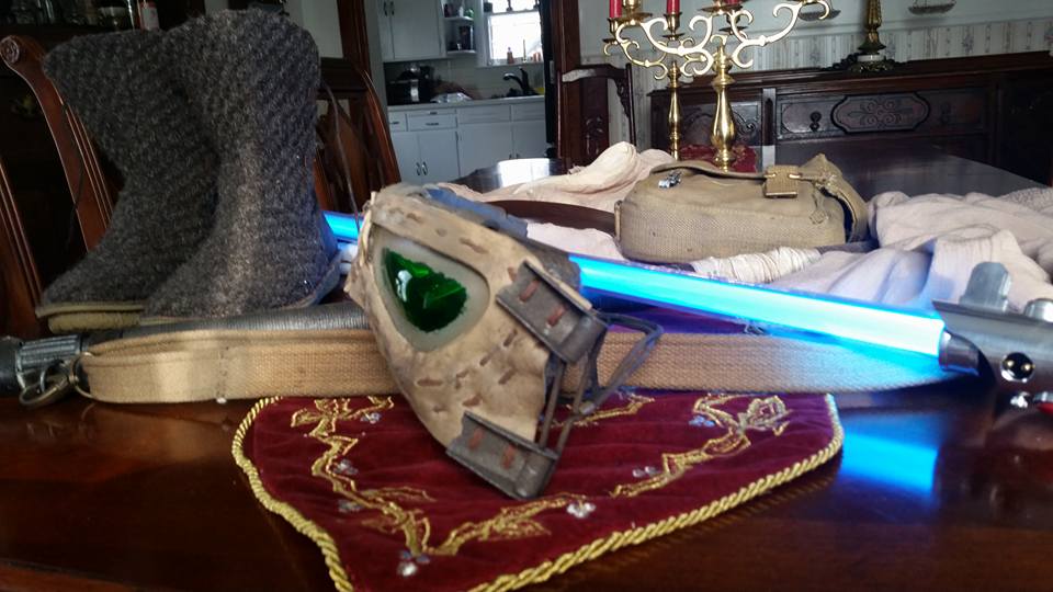

I epoxy'd the lenses into 1/8th black flexible foam (what I had on hand), and it's easy to trim.
Worbla! How is it I'd never heard of this stuff before. Wow. (had to google)
White leather face, grey wool felt, grey leather (or possibly rubber), reddish brown cloth (same stuff used for the left shoulder plate)
What exact materials are you all using to make the goggles? I have the accurate lenses and I intend to use worbla as a base for the frame, but I have no idea what to wrap them in to get that accurate look.
