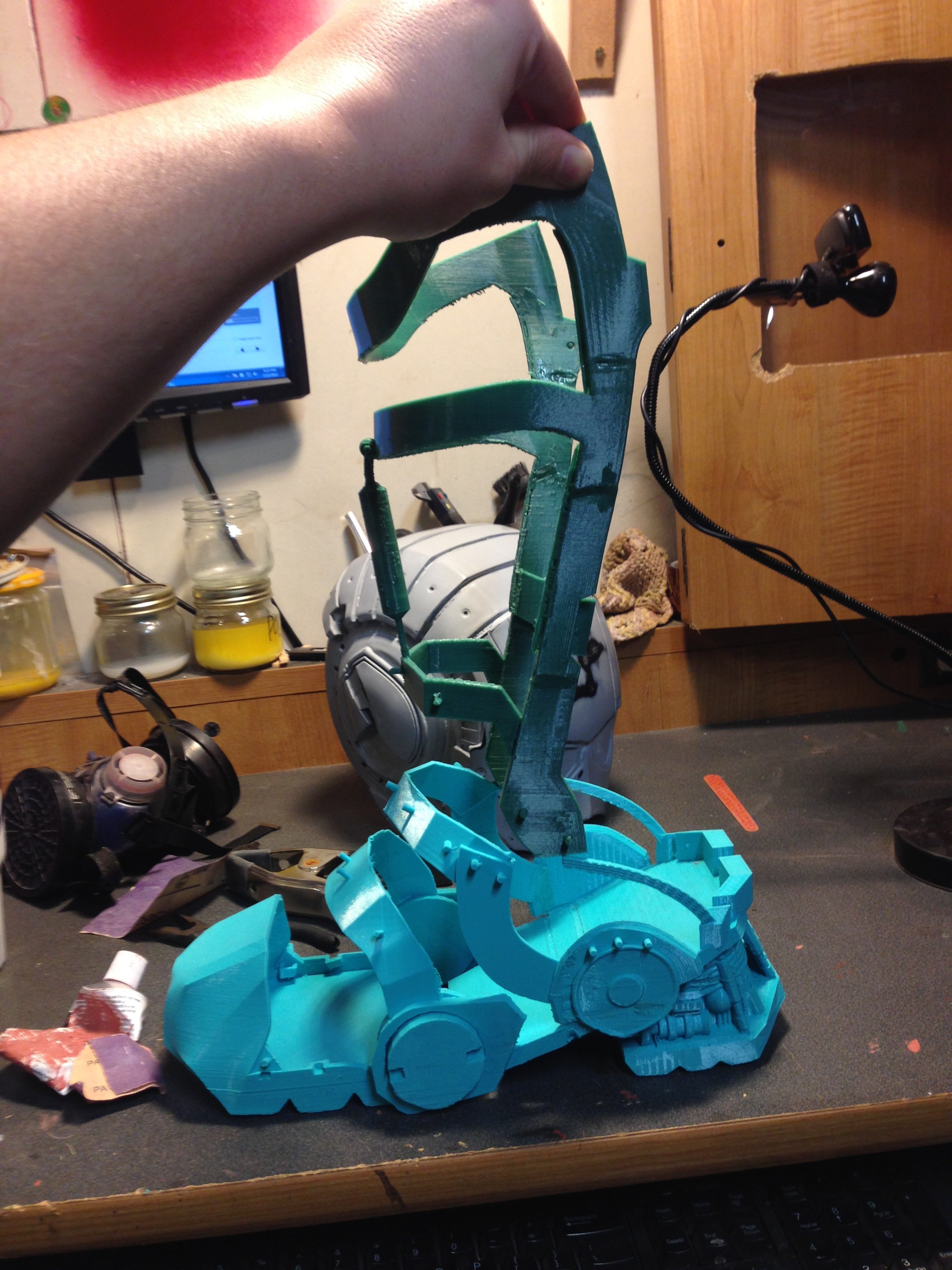

    Mar 13, 2015, 1:31 AM - Re: Iron Man MK 1.5/ Flight Test 2.0/Mech Test 2 week speed build, 3D Printed #30
    Got the shin printed up finally! Not gonna be ready by saturday unfortunately.....

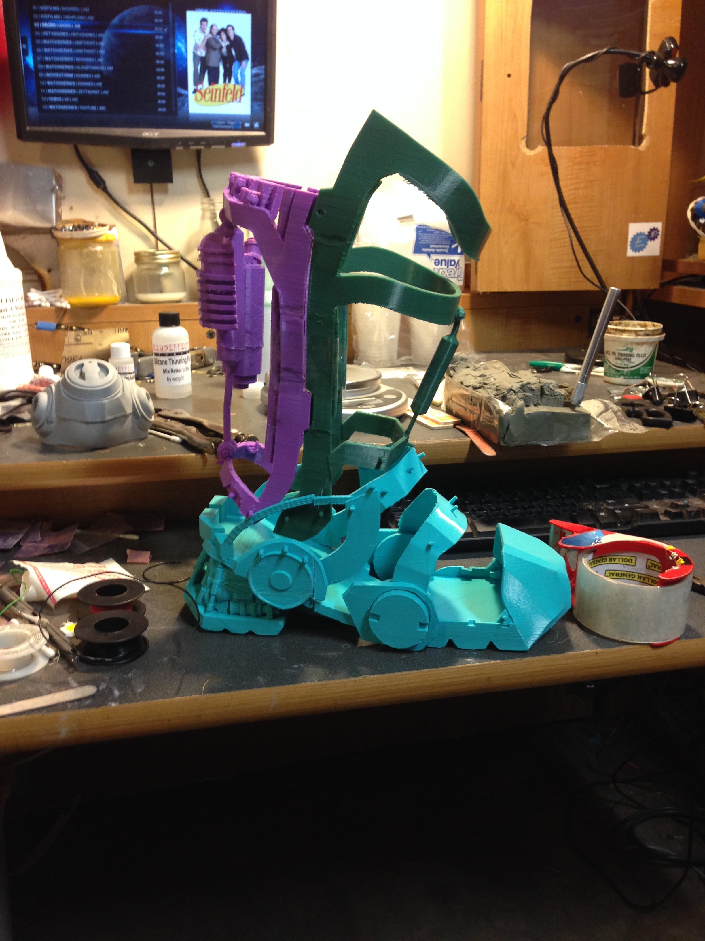

    Mar 17, 2015, 2:54 AM - Re: Iron Man MK 1.5/ Flight Test 2.0/Mech Test 2 week speed build, 3D Printed #32
    Got most of the calf printed. Didn't have a big enough spool to do it all in one go. Although, it would have been able to fit on my print bed in it's entirety, if I had a large enough spool.
    Should finish printing the calf soon, then all I have left to print on one boot are the ball joints! When I start printing the right boot, I will finish the gauntlet models, and while those are printing, will do the arc harness.
    Thanks for keeping up guys!

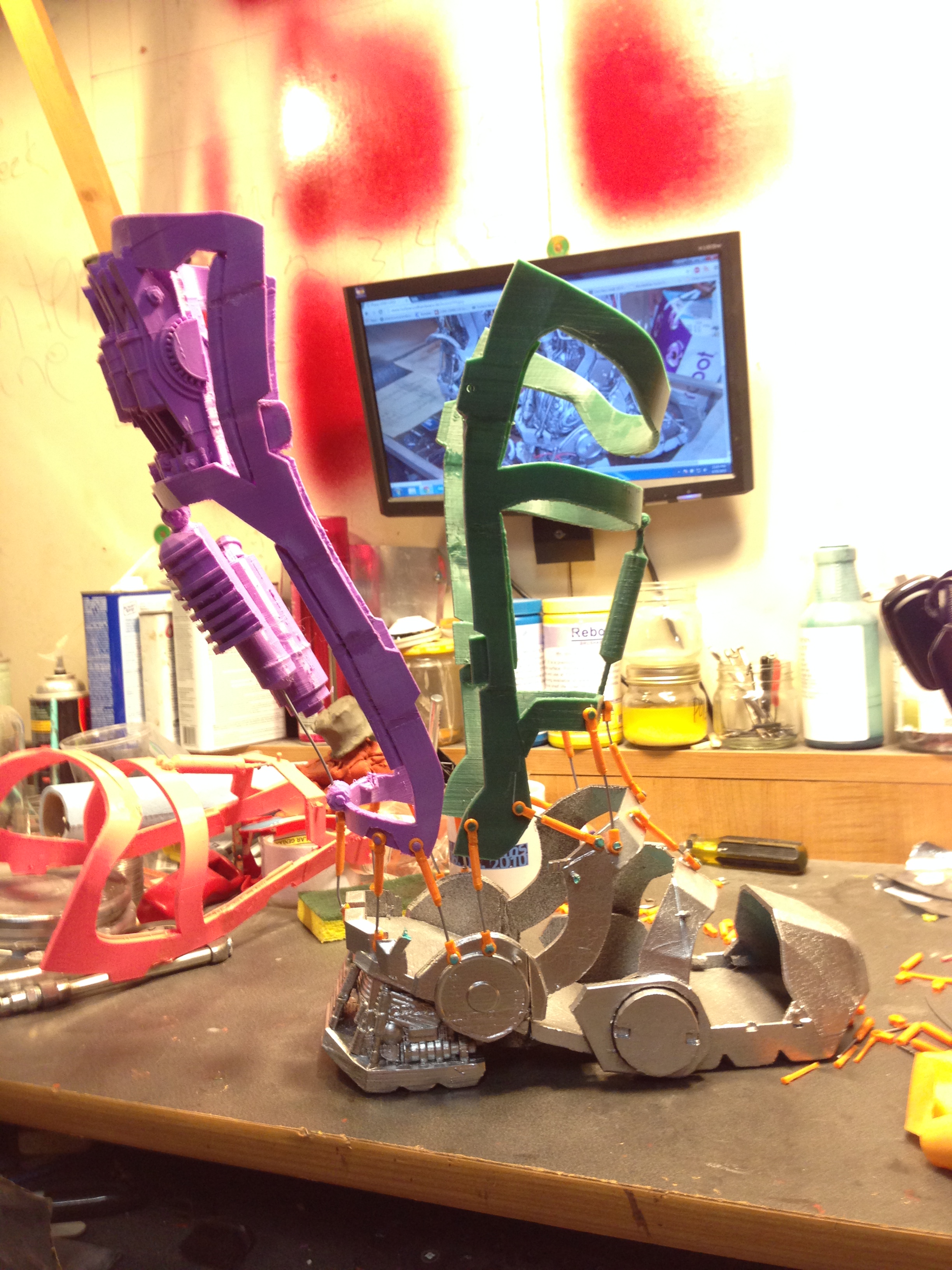

    Apr 25, 2015, 11:20 PM - Re: Iron Man MK 1.5/ Flight Test 2.0/Mech Test 2 week speed build, 3D Printed #34
    Welllll......
    As you're probably aware by now, I didn't make it in time with this project hahahaha.
    However, I got some time to work on it tonight, and have been messing around with the telescopic cylinders that tie everything together, and I've got them working pretty darn well!
    The cylinders are 3d printed in 3 pieces, 2 eye holes, and one cylinder. Then the cylinder is tapered off with a soldering iron to 1.71 mm, then I use pliers to smush down one piece of filament on the end, then I push the filament piece into the cylinder, then use a soldering iron to attach the eyes to each end, then I solder the little "nubs" on the boot into a dome shape after pushing on the cylinders. If it sounds like a lot of work, that's because it is! But, as you can see in this picture, the effect is really killer !
    Click image for larger version.
    There is still some tweaking to be done for range of motion and durability's sake, but it's coming along, albeit slowly!
    Here's a pic of the thing all attached and STANDING ON IT'S OWN WEIGHT!!!! WOO!

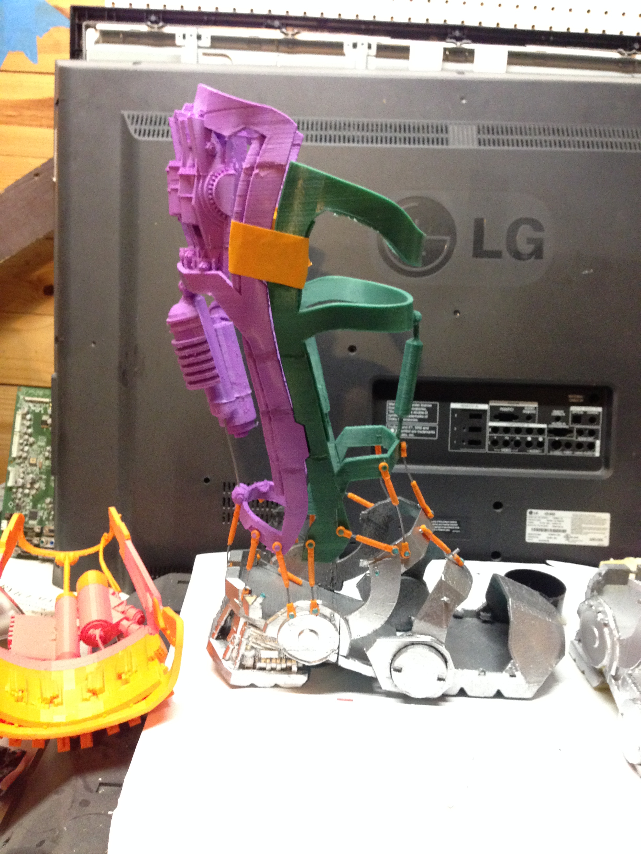

    May 22, 2015, 3:03 AM - Re: Iron Man MK 1.5/ Flight Test 2.0/Mech Test 2 week speed build, 3D Printed #35
    More progress.
    Got a fairly nice metal finish on this, and got the telescoping cylinders worked out. Added a bunch of gack, still more to add though, printing a bunch of different pieces now.

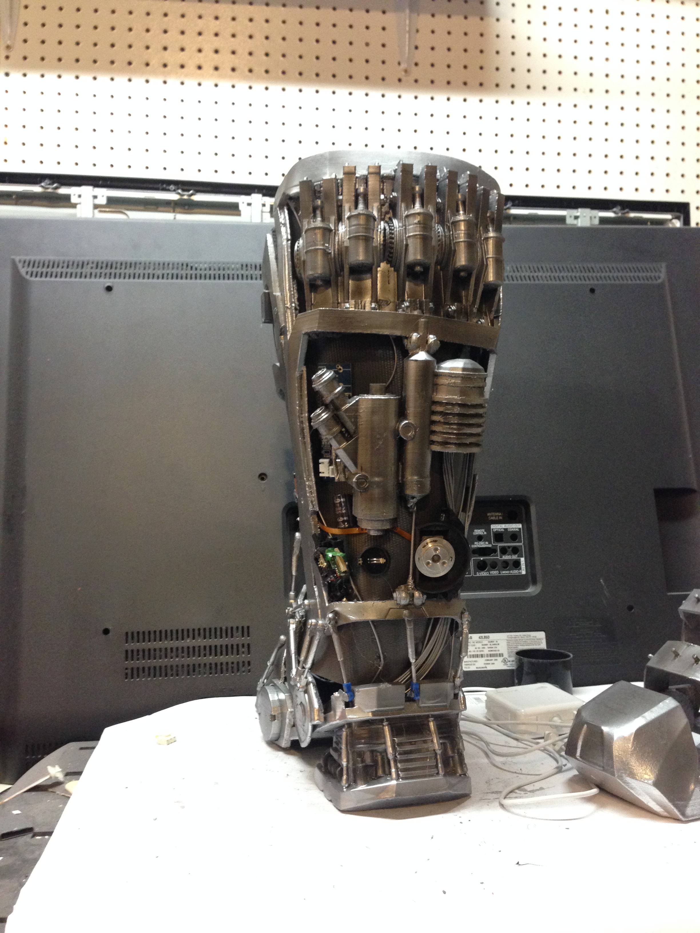

  16. The Digital Armory RPF Premium Member drumguy560's Avatar
    Member Since
    May 2013
    Messages
    328
    May 29, 2015, 3:28 AM - Re: Iron Man MK 1.5/ Flight Test 2.0/Mech Test 2 week speed build, 3D Printed #41
    this first boot is JUST about done. I need to add the braided metal sleeving ($$$), and the lighting, but after that I'd say this one boot is done! Then it's on to the next boot, then the arms, then the arc harness, then it's time to start shopping for clothes!
ID:	482954Click image for larger version.

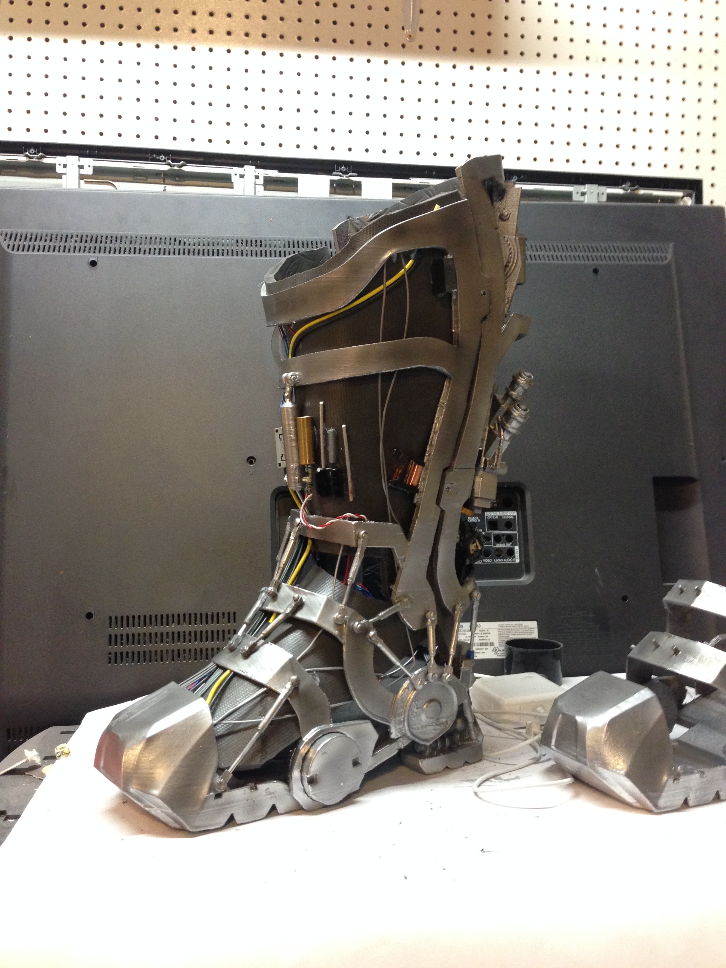

    Jun 7, 2015, 2:05 AM - Re: Iron Man MK 1.5/ Flight Test 2.0/Mech Test 2 week speed build, 3D Printed #42
    got my braided metal installed today, looks great!
    I'm almost done wiring the lights up on this one, just waiting on a battery pack to get here.
    Should be done this next week!

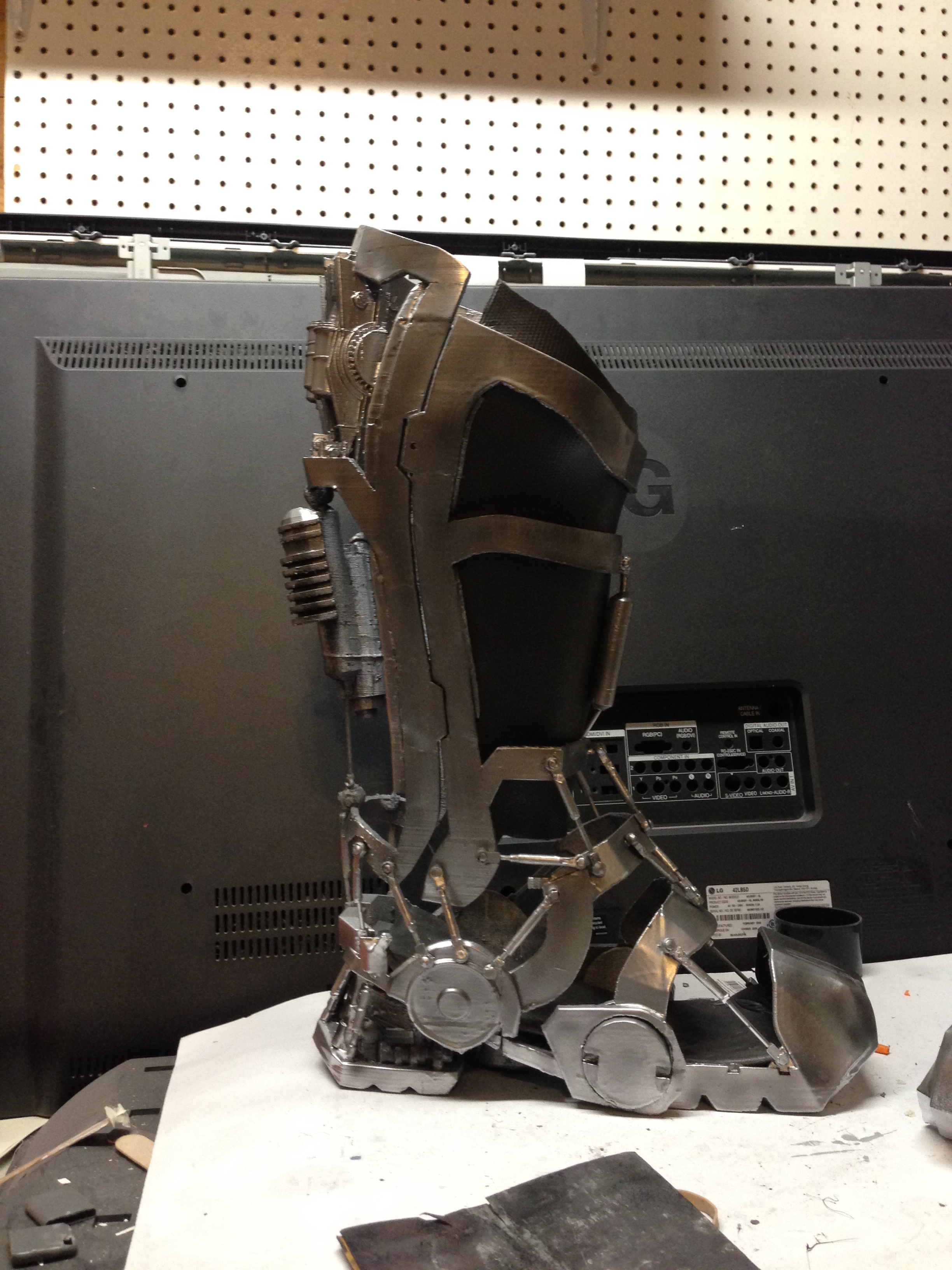

  18. The Digital Armory RPF Premium Member drumguy560's Avatar
    Member Since
    May 2013
    Messages
    328

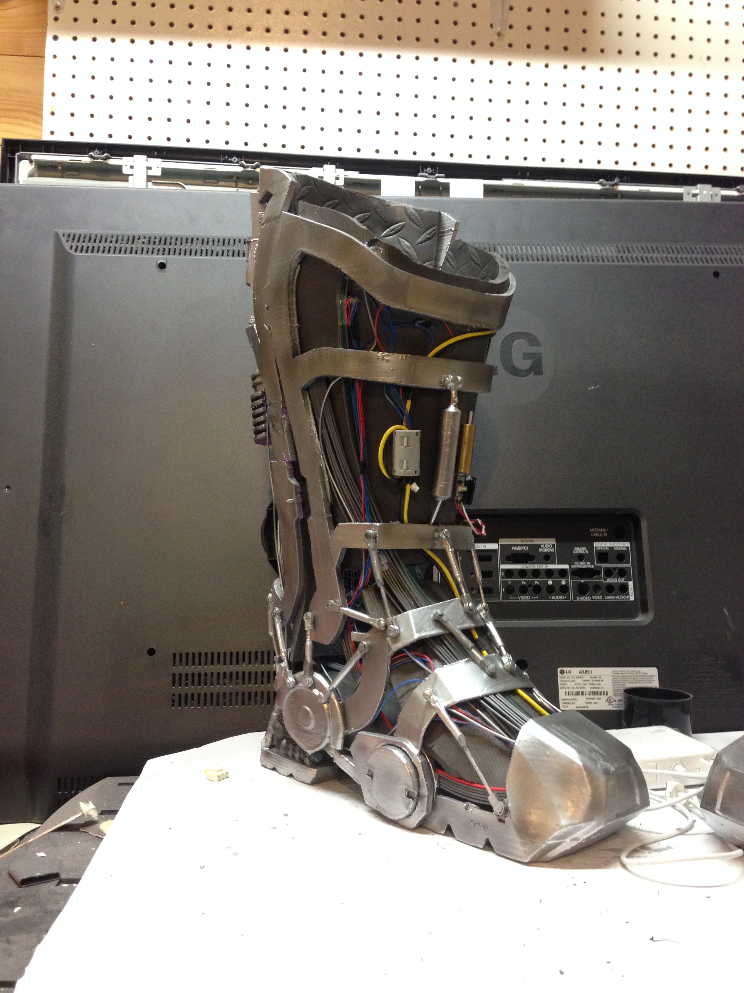

    Jun 12, 2015, 1:41 AM - Re: 3d printed Iron Man MK 1.5/ Flight Test 2.0/Mech Test build *first boot done* #43
    Alright folks, looks like the first boot is done! Check out pics below
