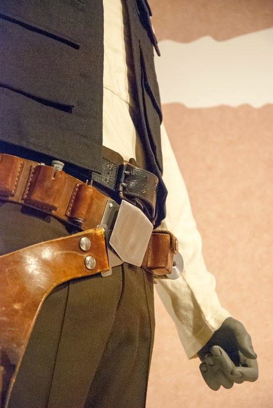

Costume Observations
I was able to see the ROTJ version of the holster, and while the zoom on my Nikon D80 isn't super amazing, I was able to snap over 150 pictures of the holster. While I haven't been able to delve into the photos yet, I was able to confirm a few things.

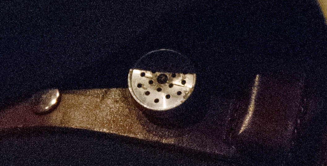

- Disk
I have clear photos of the disk, and am now able to share exactly how it looks. I can also 90% confirm the accuracy (or inaccuracy) of the current disk offerings...at least on the ROTJ version.
- Pouches
I was able to confirm a few things on the pouches, namely the size and location. I was surprised how small they were in real life. The photos I took, along with an actual greeblie, should confirm the size 100%.
- Buckle
I was lucky enough to have the costume turned in a way that allowed me to get a gllimpse at the back of the buckle. What I noticed was that my patterns are almost perfect, except for the length of the the loop the hooks attach to. On the ROTJ version at least, the loops attach almost at the very top of the buckle, whereas I had them a attached a bit lower. I also realized the shape of one of my hooks is slightly off, so I'll adjust that when I'm home.
- Color
I was able to get a great idea of the color, and I made sure to adjust my camera to as closely represent the color as possible considering the lighting.
- Holster Detail
I was able to get some great angles of the holster, so I was able to pick out some details like wonky stitching, and such that you can choose to add into yours.
Finally, this version of the holster has a broken/misshapen back buckle. It threw me off for a bit because I couldn't figure out why the shape was so strange. After checking the screen grabs, I was able to determine where in the movie it was used. The broken buckle might be due to it being one of a few holsters, or it may have gotten broken during filming, and the shoot order in the movie is why it only shows up in some scenes.
I will double check this when I'm home to confirm if it is a broken holster, or one of a few versions made for the movie.

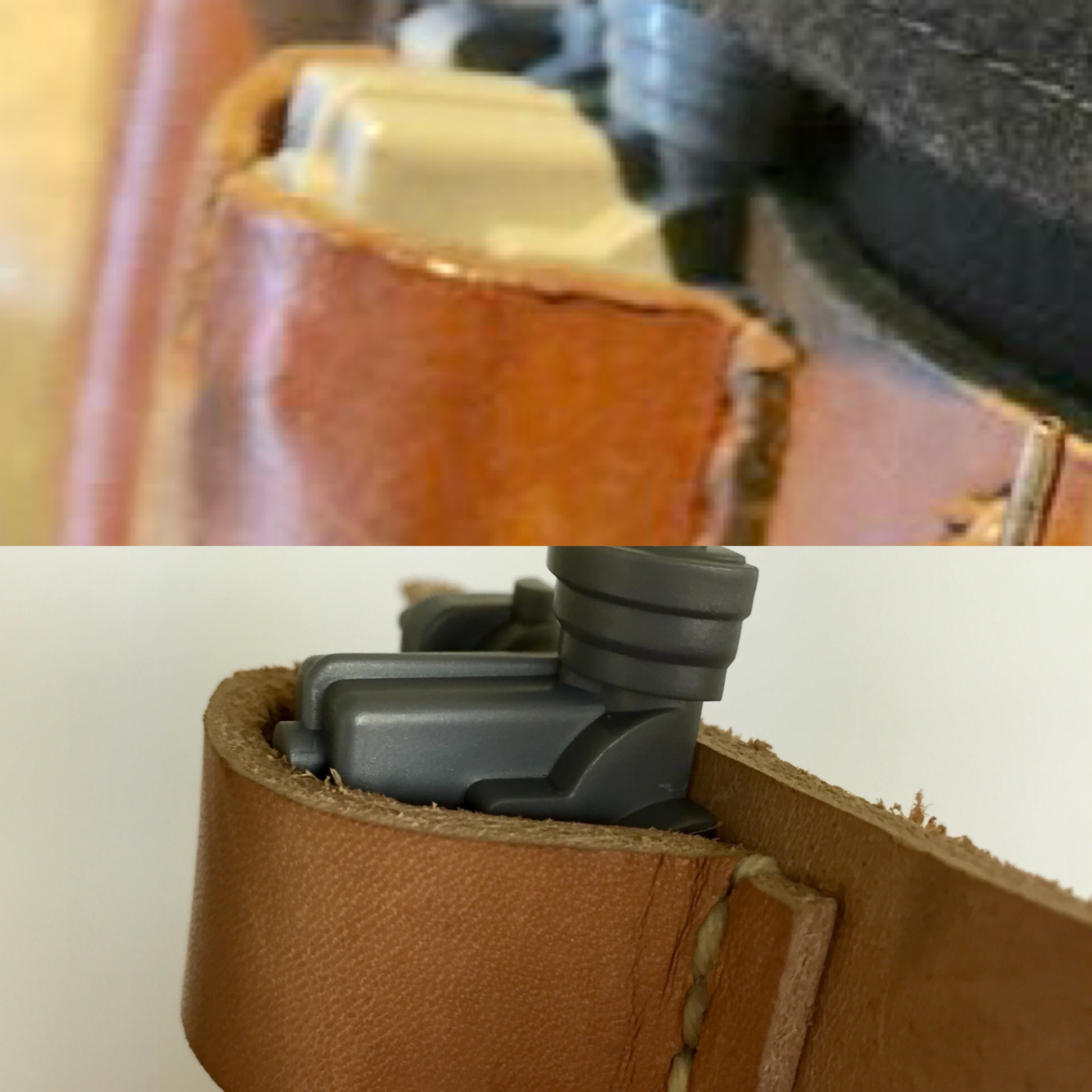

Today I spent almost the entire day at the Tandy Leather store. It was pretty cool because I met a guy who is super into making Judge Dredd props/costumes.
Anyway, it was a bit of a nerve racking experience. There are so many options for choosing leather, and they're not all that cheap, so picking up the right ones was a bit daunting.
What I ended up getting was 9-10oz (9/64 - 5/32 -- 3.6mm - 4.0mm) for the holster, and 7 - 8oz ( 7/64 - 1/8 -- 2.8mm - 3.6mm) for the pouches.
I have been second guessing myself all day, but I decided to get them home and put together a bit of a mockup to see what you guys think.
Forgive the crude sewing/cutting, I just sliced off a few corners to give me enough to work with.
So, do you think this is the right thickness of leather?
Originally we were saying 8oz for the holster, and 6oz for the pouches, but as I said this is 9-10oz - 7-8oz. So visually do you think it is right....or am I going to have to get some more leather?
Correction/edit
I looked at the receipt and it says the pouch leather is 6 -7oz. The measurements I took seem to range between 6 - 8oz, but, It could just be minor fluctuations.

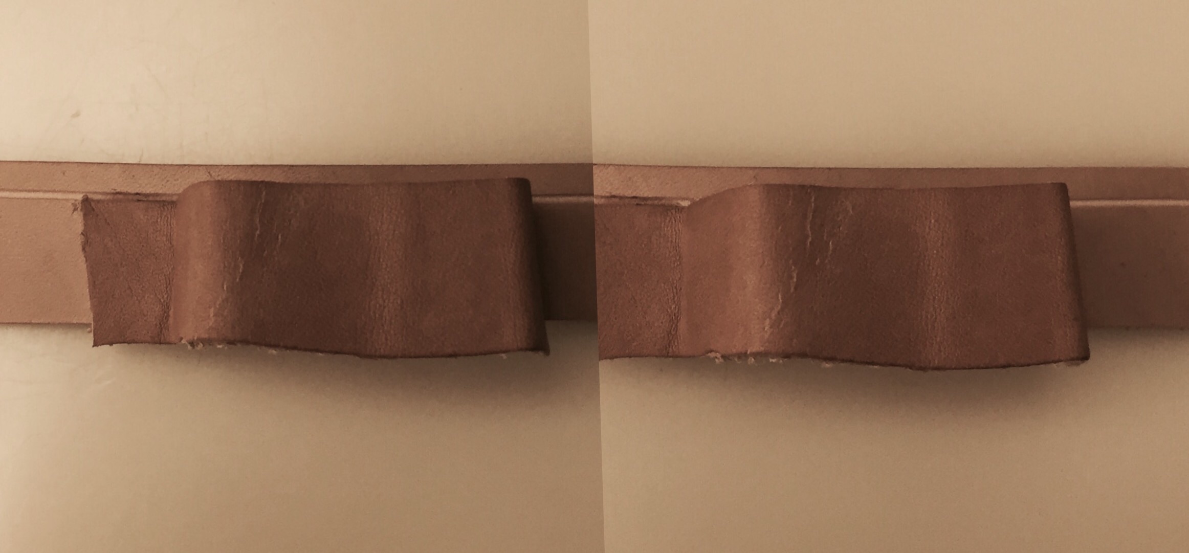

Well, this has been a bit of a frustrating and expensive experiment. I posted the image above yesterday, and unfortunately I didn't get much feedback. I sat there most of the night with the mockup on my nightstand, and while catching up on some House of Cards, I would glance over, pick it up, compare it, and ponder.
By the morning I wasn't any more sure than I was the day before, and so I headed off to two leather shops, and after a lot of debating with my girlfriend, I decided to bite the bulltet and purchase a 8-9oz () and a 4-5oz () so that I could compare.
I am now at about $500 in leather, so I should have enough variation in size to get as close as possible to the actual leather thickness.
I just finished this mockup:
Now, I realize this might be a difficult way to assess this based on a few different factors such as angle, the blurry photo, shadows, etc, but I hope it can at least be enough to get a good idea of the right direction.
I am hesitating saying much about the two photos because I don't want to influence what you think.
I'll leave this a few days to give you guys time to mull it over. :)
8-9oz is pretty typical for a belt, and you don't want to go too thick on on the pouches, so the 4-5 is probably a good weight
I agree. However...
I can't assume that was the case here.
I don't know of the original was made using carefully picked leather, or was made using whatever hide was in the shop. I can't assume that when they built it, they used 8-9oz, or went heavier for esthetic reasons or to compensate for the weight of the blaster. I also have no idea if leather thickness was the same then, as it is today (look at 2 x 4 wood, and how that has grown smaller over the years).
The original holsters may have been made from a single hide and then sanded/shaved to achieve the desired custom thickness. They could have been made using a mish mash of left over hides that were in the shop. Or they could have been custom hides shaved to custom thickness.
These are some pf the reasons why I opted to approach this from a more visual perspective. If it looks correct, and then is backed up with other evidence such as measurements, then I will be much more confident that we have the correct info.
Judging from the picture you posted, I'd say the belt looks accurate and the pouch appears just a little bit too thick.
What is the origin of that picture of the original holster belt? Was it taken from an exhibition or from actual screen- or posed shots with Harisson Ford at the time of production? Somehow it seems that greeblie is sticking way to much out in that leather pouch and it's well known that during building exhibitions worldwide the set up varies depending on the person in charge of dressing the mannequins.
Chaim
Hey,
As far as I can tell, it is a screen used version from ESB. It is the same one I saw at the costume exhibition last week (I screwed up and said it was from ROTJ).
The Greebie is probably different on each setup, for the reasons you mentioned. I recreated that image the best I could with my greeblie so we could see if the leather looked the same. How far out the greeblie is sticking out of the pouch shouldn't really matter at this point. What matters more is the relation between the size of the greeblie and the thickness of the leather.
This pouch is way closer in my opinion. The front vertical edge on the first one seemed right but in perspective as it wrapped around it was way too thick. This second version seems right in both regards. To me it looks like the inside may have been shaved down and smoothed out a bit, or maybe it's just smoother looking from repeated use taking the greeblie in and out. My brother, who is a leather worker, also bevels the edges slightly to clean up the "fuzz" on belts he makes. This process may make the leather appear thinner. Your dedication to this project is unbelievable, really excited to see how you solve these problems.

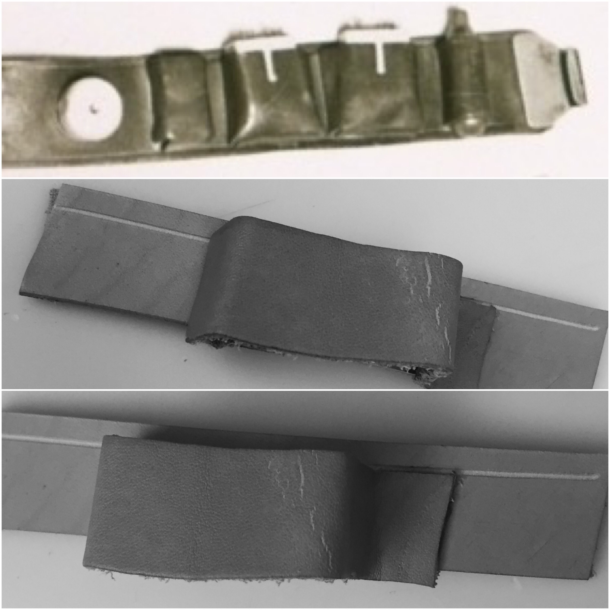

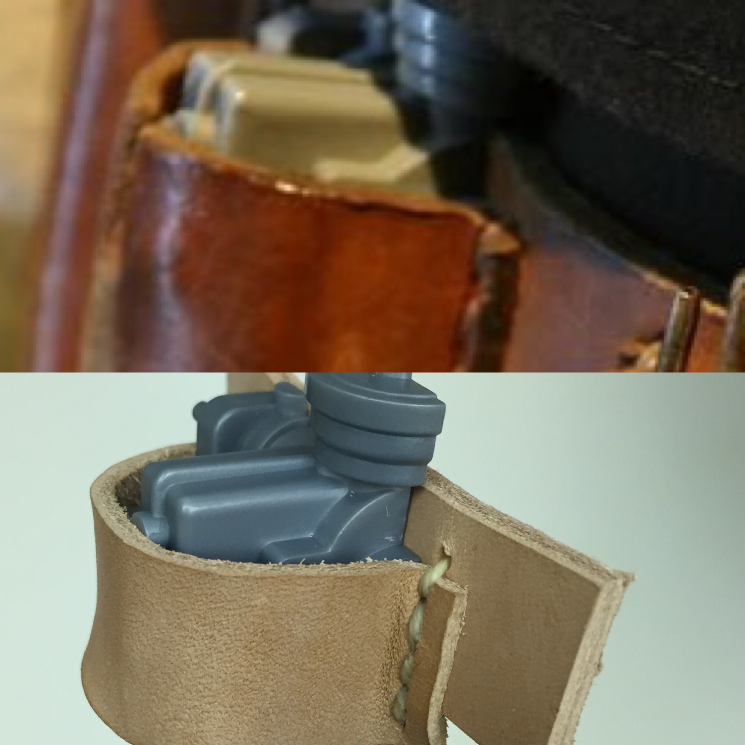

Here is a quick mockup I just completed. What I did was take a 4-5oz strip of leather and shave it down using a bevel tool to about 1 - 2oz. Then, I glued one side to the inside, and one to the outside to represent the two possible connection options.
Here is another angle.
I realize it is a bit crude, but I wanted to see if the thinner leather, paired with a glue would give similar results.
I will leave it for now, so you guys can voice your opinions.
I think you're referring to this photo.
Specifically images (C) and (D).
I put these two together roughly on the iPad to roughly match the angle in (D).
On these images I don't see a defined line as we see when the leather is folded under. Give me a few moments to take some new photos, and I'll update this post.

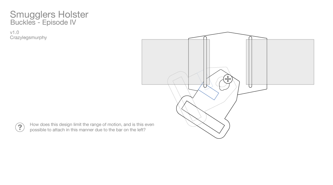

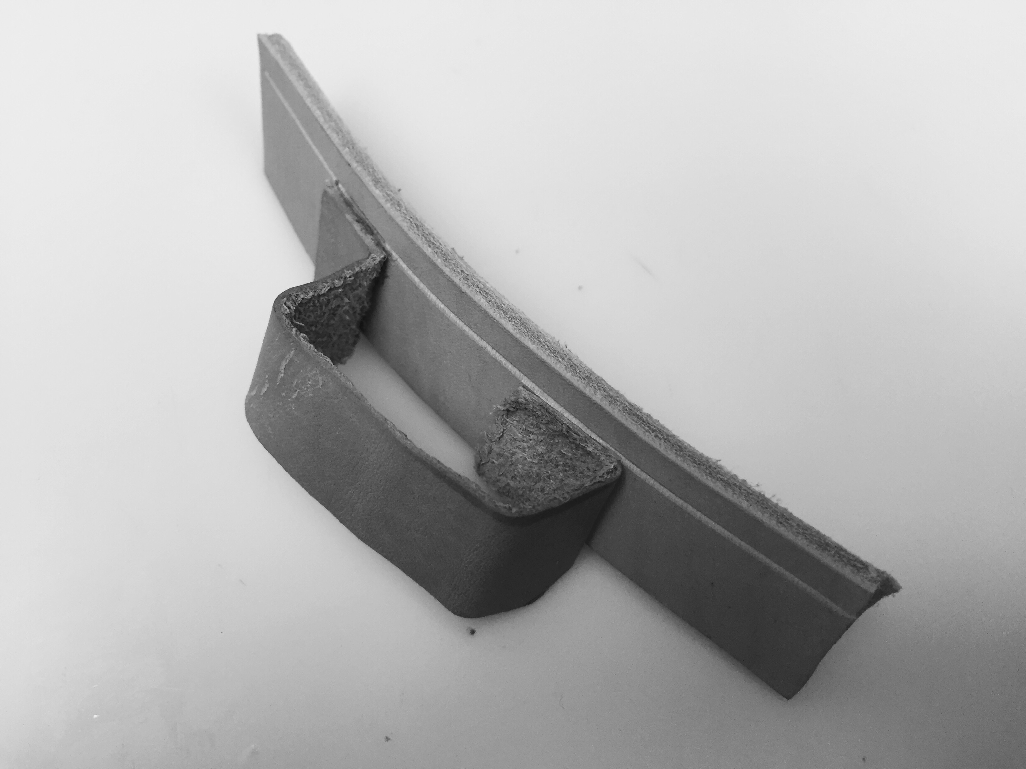

The photo you posted yesterday prompted me to redesign the ANH "Y" buckles, and they worked perfectly. Now, with this new photo, I am really struggling to figure out how that slit on the left connector, actually works with the buckle and the leather.
If I model the connector as close as I can, the range of swing motion is drastically reduced. It also requires the connector to be slid overtop the bar that holds the leather, before you attach it to the peg. Here, perhaps a photo will make more sense.
As you can see, in order to get even a reasonable range, I had to widen the slit a bit. Of course, it is kinda hard to tell on that photo with the angles and such, and so it could be wider than it seems.
With the slit that wide, that is the maximum range of motion the connecter has. I suppose that (or less) might be perfectly reasonable considering it really doesn't need that much range.
EDIT
Something else that is really bothering me is the layer of these connectors. If you look at it from the back, the order it appears goes.
Buckle - Leather Belt - "Y" Connector
Meaning, more often then not, it appears like the "Y" connector falls closest to the body. The problem is that this design wouldn't really allow for that.
The "Y" connector has to be closest to the buckle, and then the leather on top of it to allow it to freely move around the loop. It seems to shift around in different images, making this really hard to pin down.

Disk
I was luckily able to get some workable images of the disk, and have spent some time reworking the pattern to accurately reflect the screen used version. It surprised me to see how close the current disk offerings were, but also how inaccurate they are as well.
Here is a preview:
