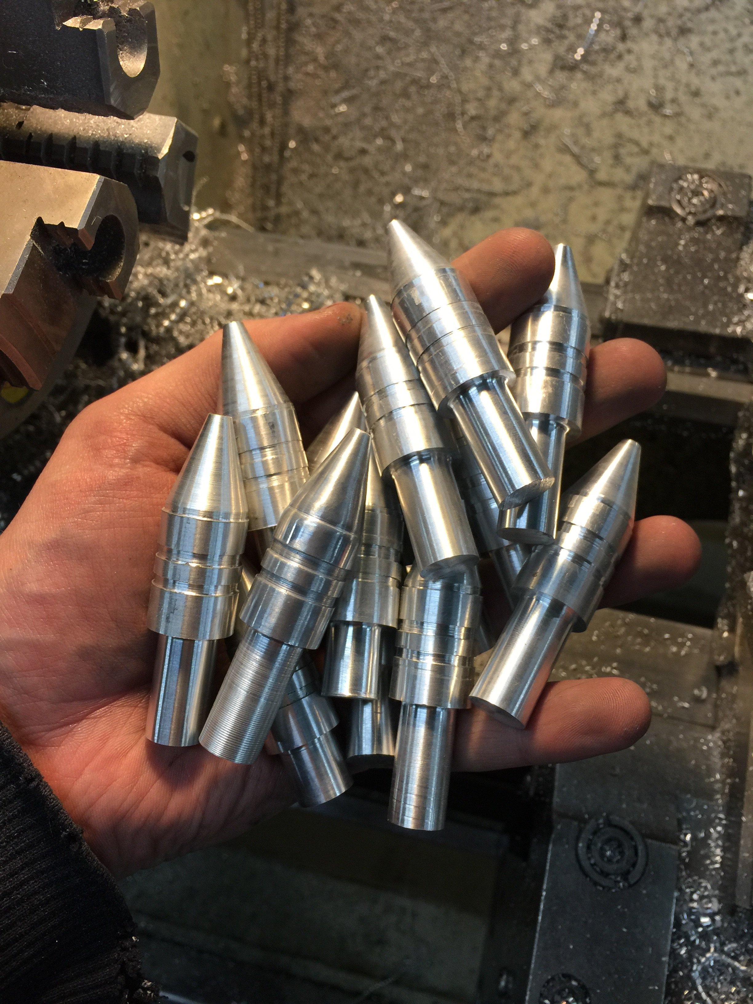

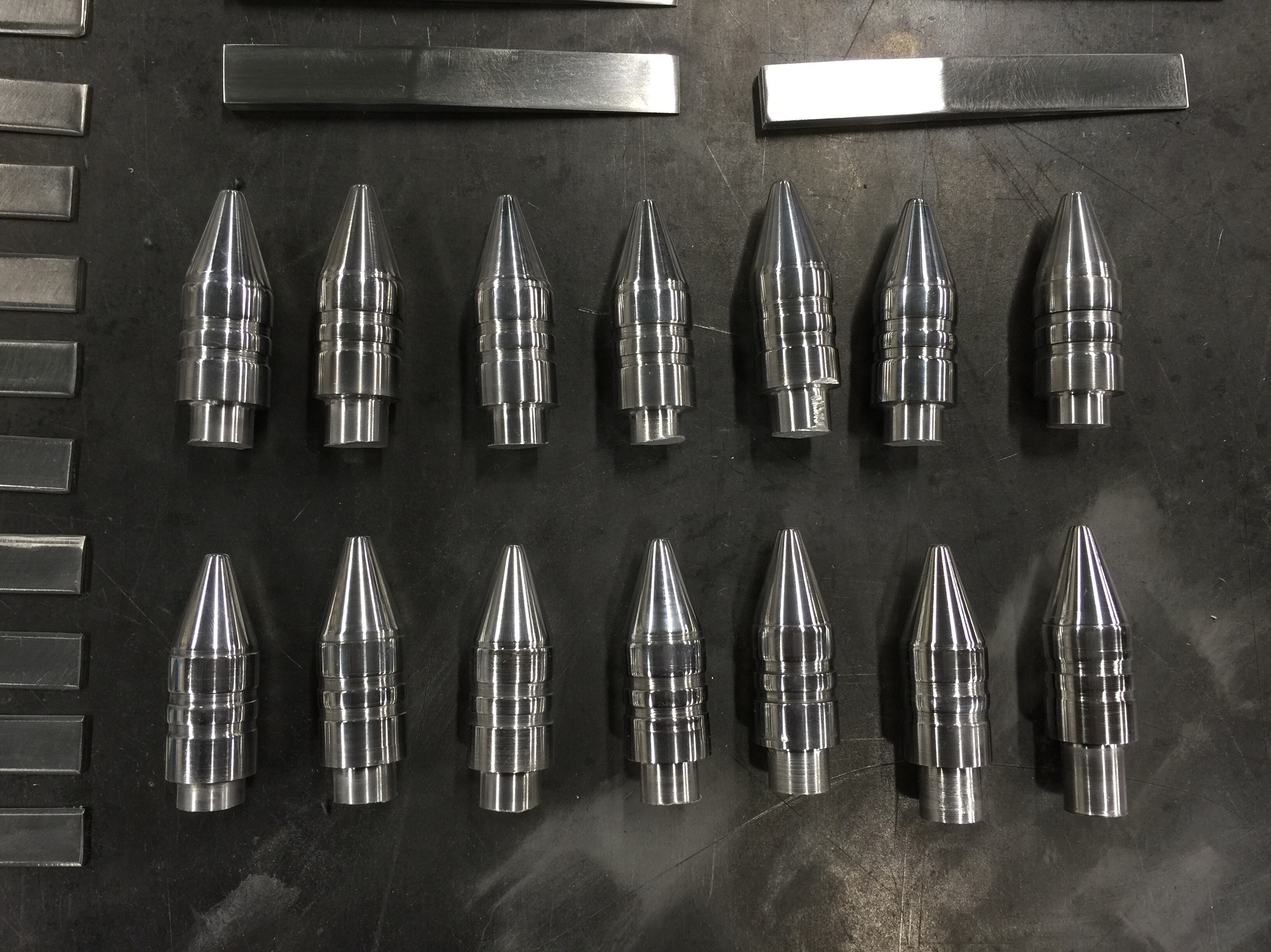

A very successful night. Firstly: nozzles! There are a couple of mishaps in there but generally I'm pleased with all of them. A bit of sanding and polishing on the lathe tomorrow and they should be looking as good as my prototype nozzle. Part of my learning process on this project has been letting go of precision machining in favor of just making it look vaguely right. It makes things go so much faster. And when the end product is being sanded and polished anyway to smooth of all the edges and surface finish (as the original was), doing everything technically correct form a machining standpoint is just an inefficient waste of time. Ones that look a little off here or there after polishing I'll just go back and touch up by eye.

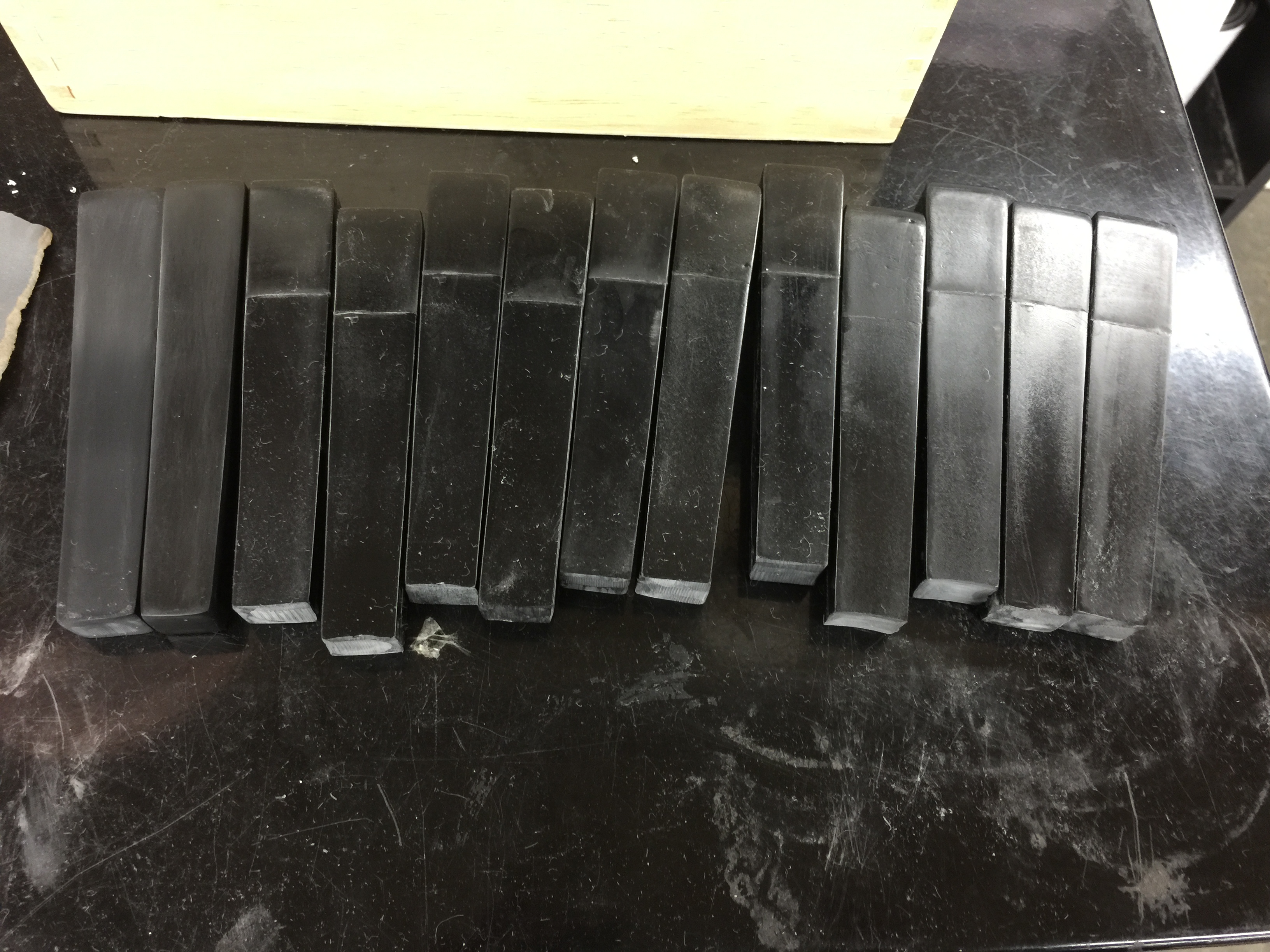

Secondly, the fast cure onyx worked out! I made four bubble-free bodies tonight in the time it used to take me to cast one. In the 2m30s pot life I was able to mix the resin and get the chamber up to pressure with only about 1-5 seconds to spare each time. :)

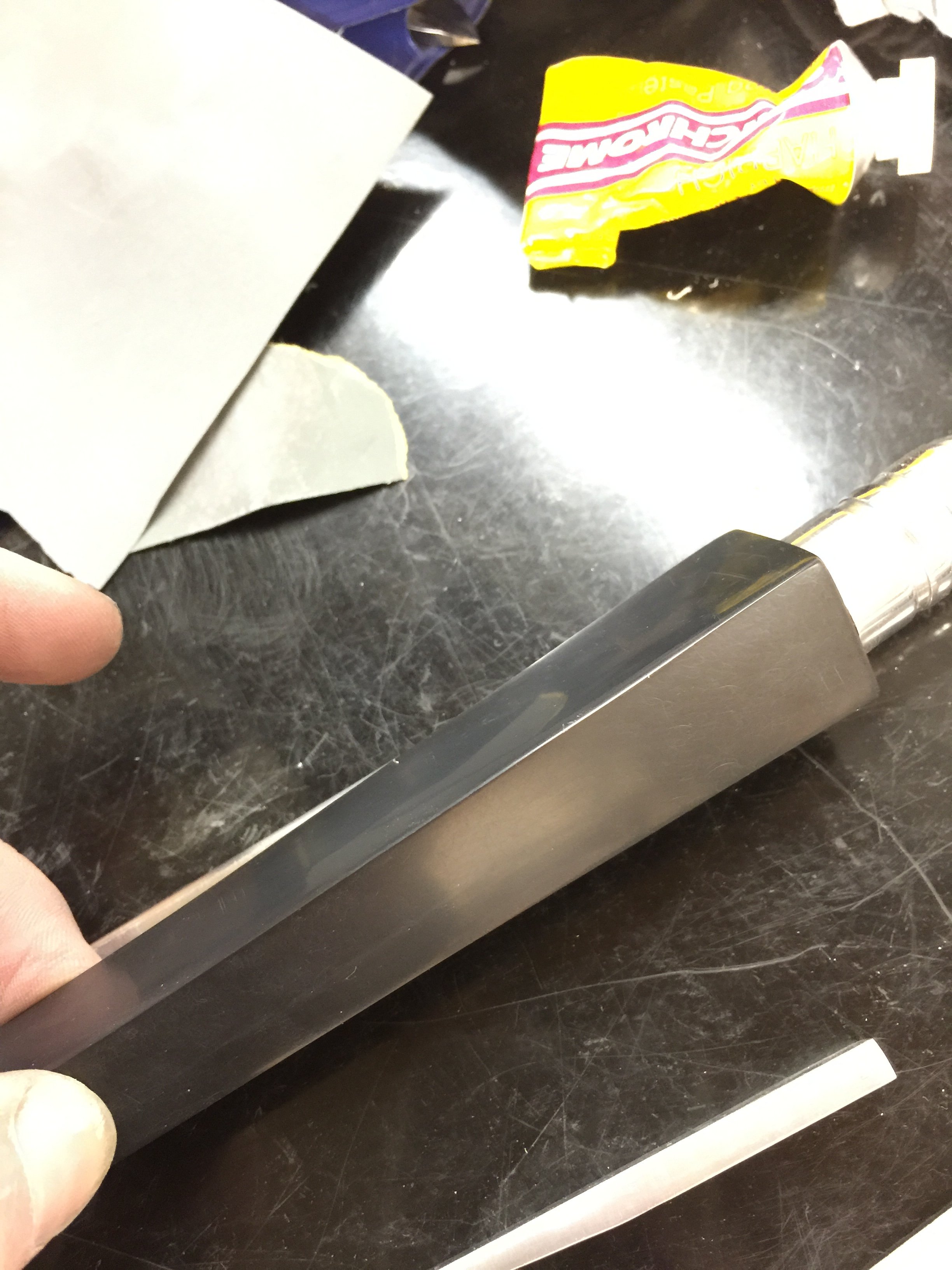

Spent all night polishing nozzles (as it were).
Re: Norbauer's Notebook - adventures in recreational Star Trek (mostly) prop replicat
So shiny! Beautiful work :D
Thanks, Ethan! This was actually the most tedious part of the project so far. Each one took about 20 minutes sand and polishing on the lathe, starting sanding at 120 grit and working my way up to 2000, and then to Simichrome polish and a soft cloth. Phew. My fingers are sore. ;)
FWIW, re the nozzles: The original has these same softened edges, which is why I used the low-grit sandpaper first.
I know I'm not super consistent in my machining from one nozzle to another (the band nearest the tip varies in width visibly), but it's close enough and each alone looks entirely correct when fit on a body. I think there were multiples of the original prop also, with similar variation between them, if auction photos from the web and screenshots are any indication. So it's tough to say even which is the most accurate.

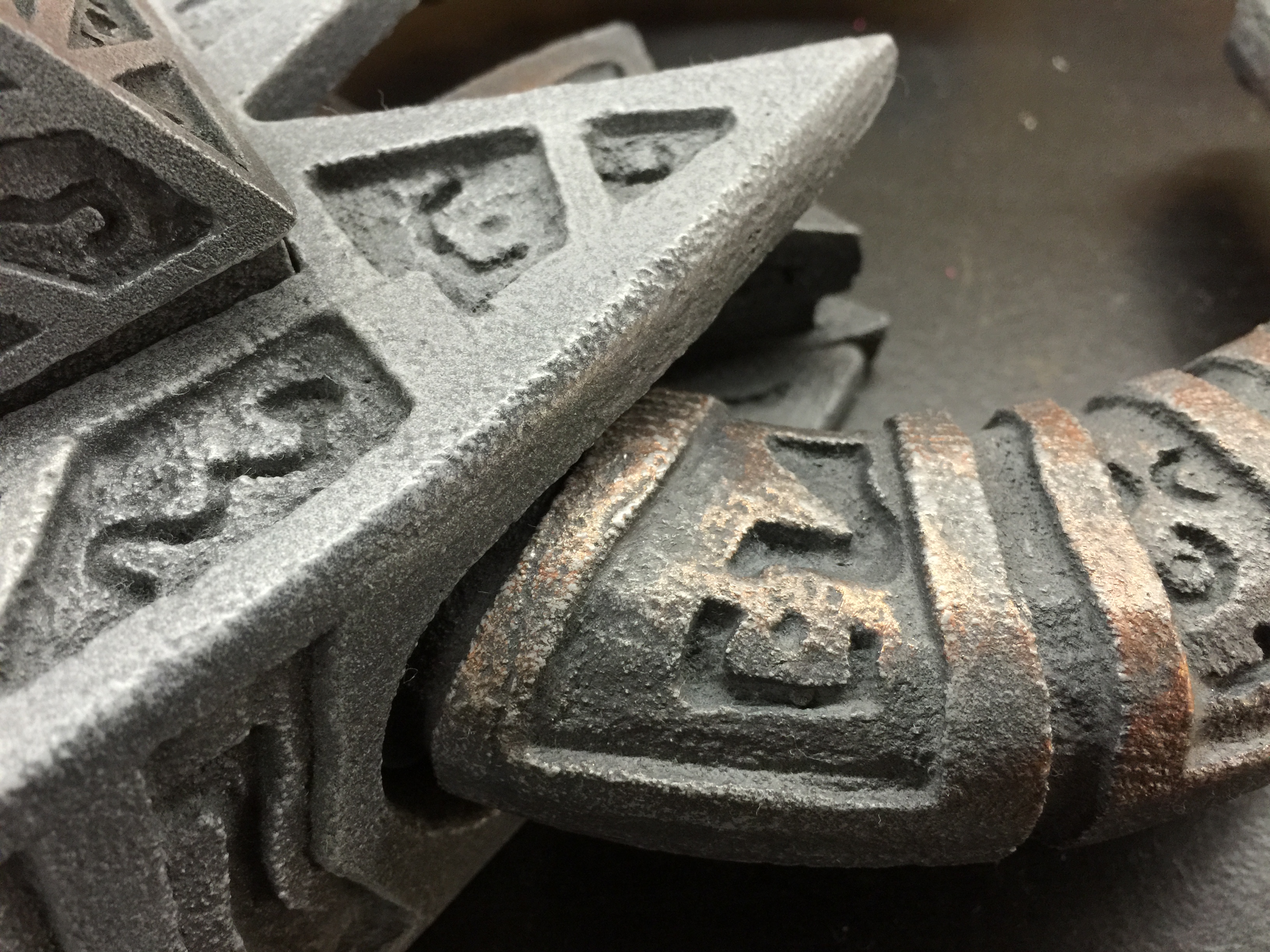

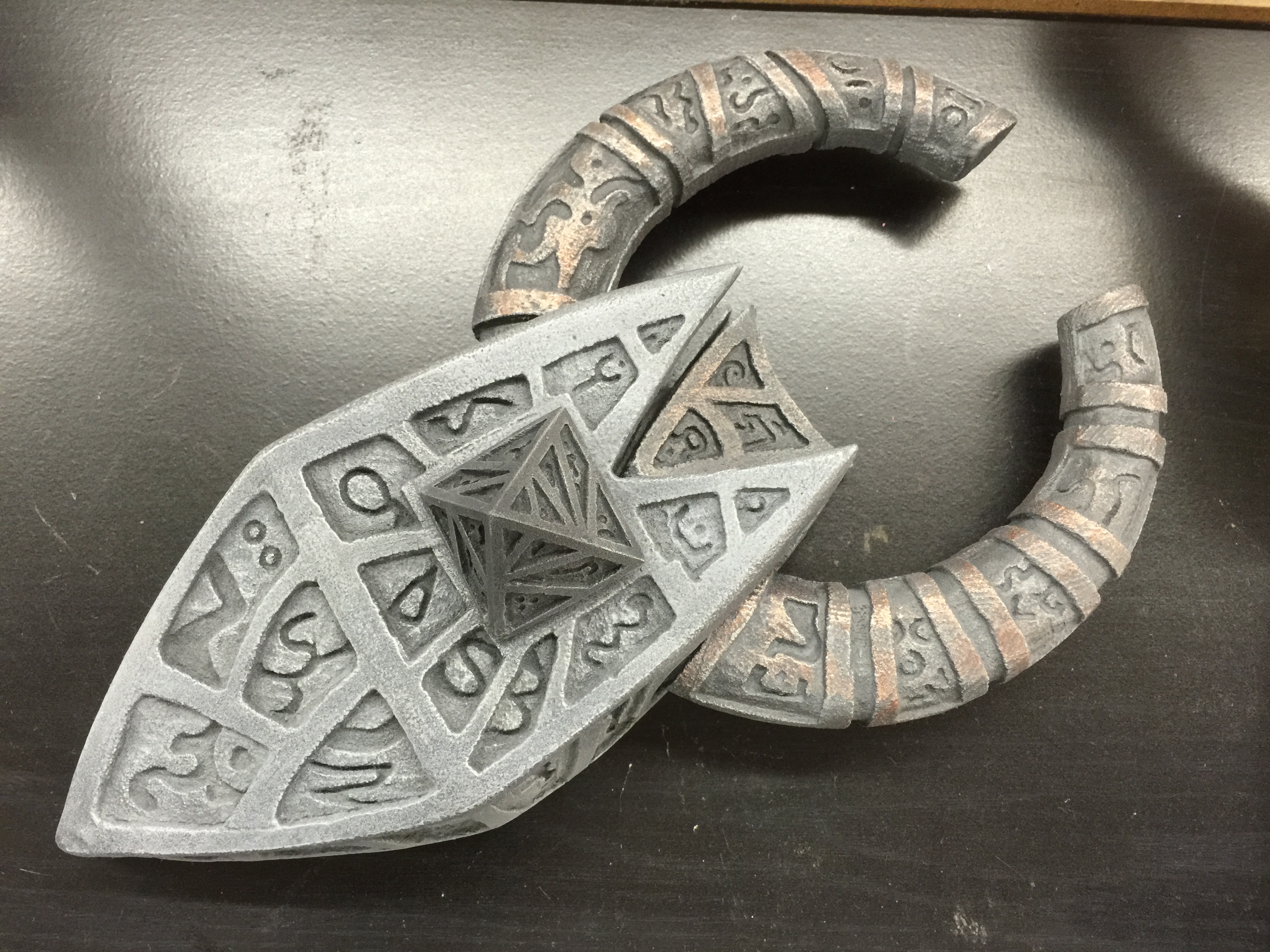

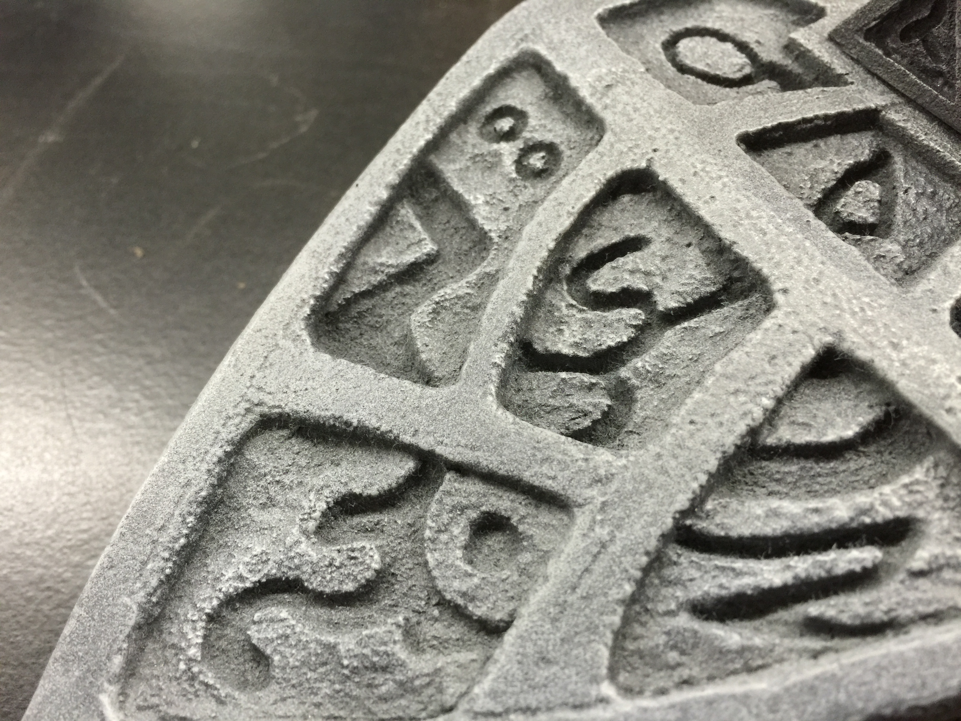

Painted my Stone of Gol today. Very pleased with the result. My philosophy on finish work is to try to make it look like how it seems on screen, not necessarily how the original prop looks/looked in real life. I used a somewhat more muted color scheme to lend more of the feel of natural stone and in particular I tried not to overdo the copper paint.

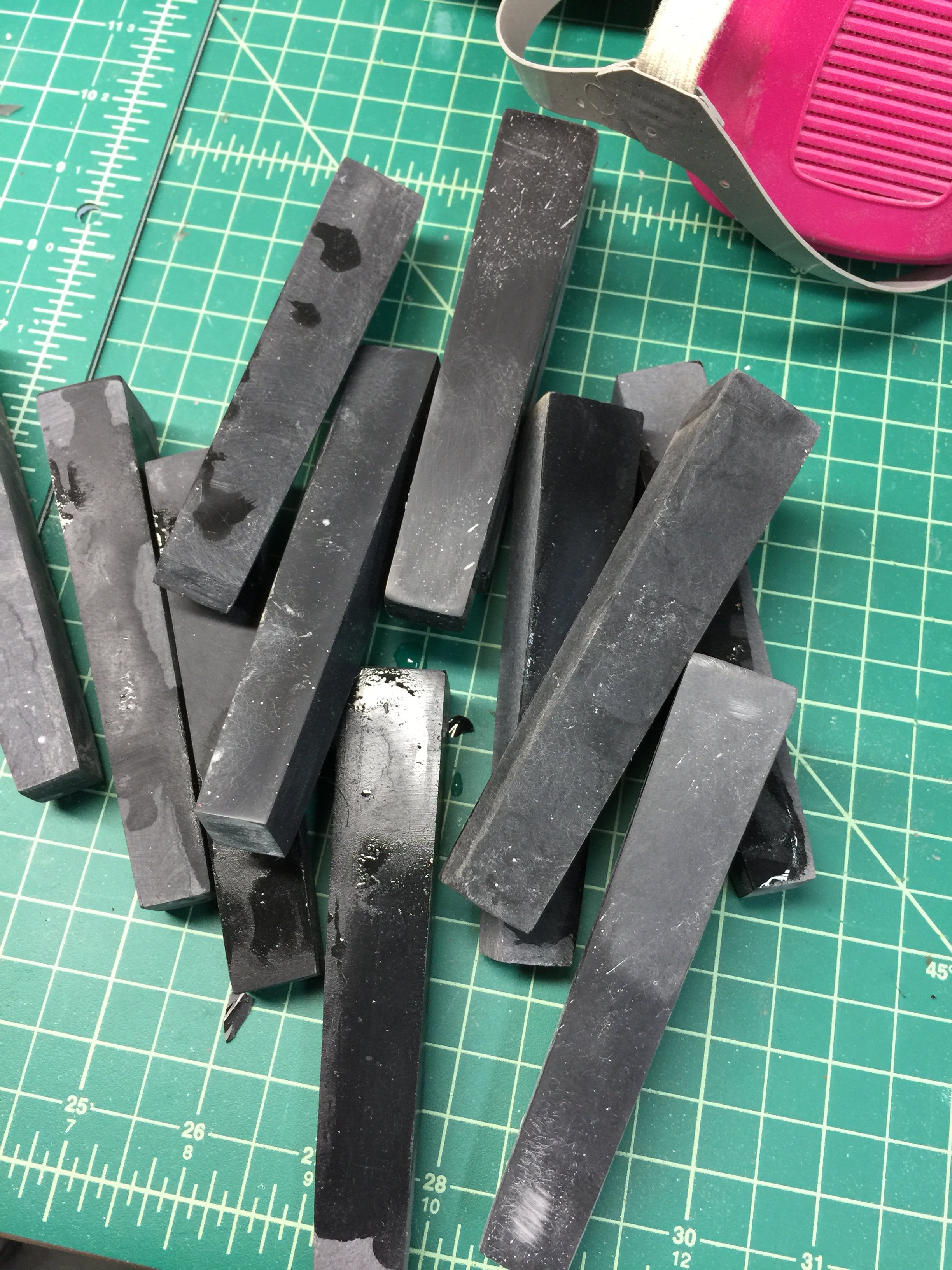

Finished casting all the TMP scanner bodies today. That fast onyx stuff is quite a productivity boon.
I wet sanded a couple (the left two in the photo), and while the result looks and feels amazing, I found the work so laborious and time-consuming I realized I'm going to need some kind of power tool to help. I've been investigating random orbit mini 2" sanders like the kind used in auto body shops for touch-up work, but I don't really have a powerful enough air compressor to drive one, so I may have to do with an electric 3" RO sander. It's a bit big for model/prop work, but I'm not sure what else to do. I don't really want to buy an air compressor the size of a motorcycle.

Beautiful paint job on the stone of Gol! I like the subtle highlighting you did to bring out the detail.
Agreed, in some cases you really do have to go with how things appeared on on screen, rather than the actual models -- otherwise you'd have things like a grey Romulan Warbird model (though on the other hand, I do kind of like the purple/green TOS D7 cruisers :)).

Thanks! This is the first paint job that didn't make me want to murder myself. I used gray Plastikote primer and then custom mixed a dark gray in Golden High Flow acrylics, which I sprayed on lightly with the Iwata HP-G3. I then used shop rags to rub off most of it, letting the lighter gray primer show through from below. Then for a final pass I cranked the pressure way down on my compressor (an Iwata Power Jet), which causes a kind of spattering effect. I used this to spray from even darker gray flecks on the finish to lend a slightly more stony finish. Airbrush artists call this the "stipple effect" (here is a tutorial). I then dry brush and rubbed the copper paint (a Tamiya copper I mixed with some transparent shading gray from Golden).

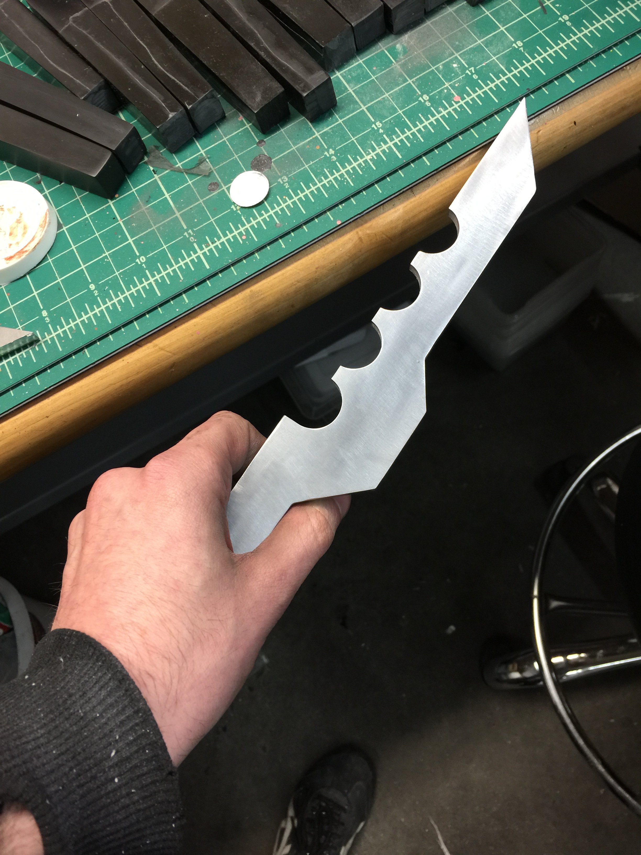

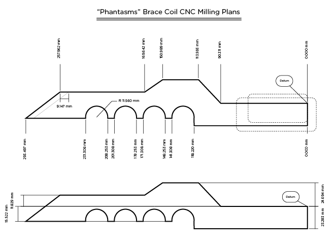

Keeeeel zem. Keel zem all.

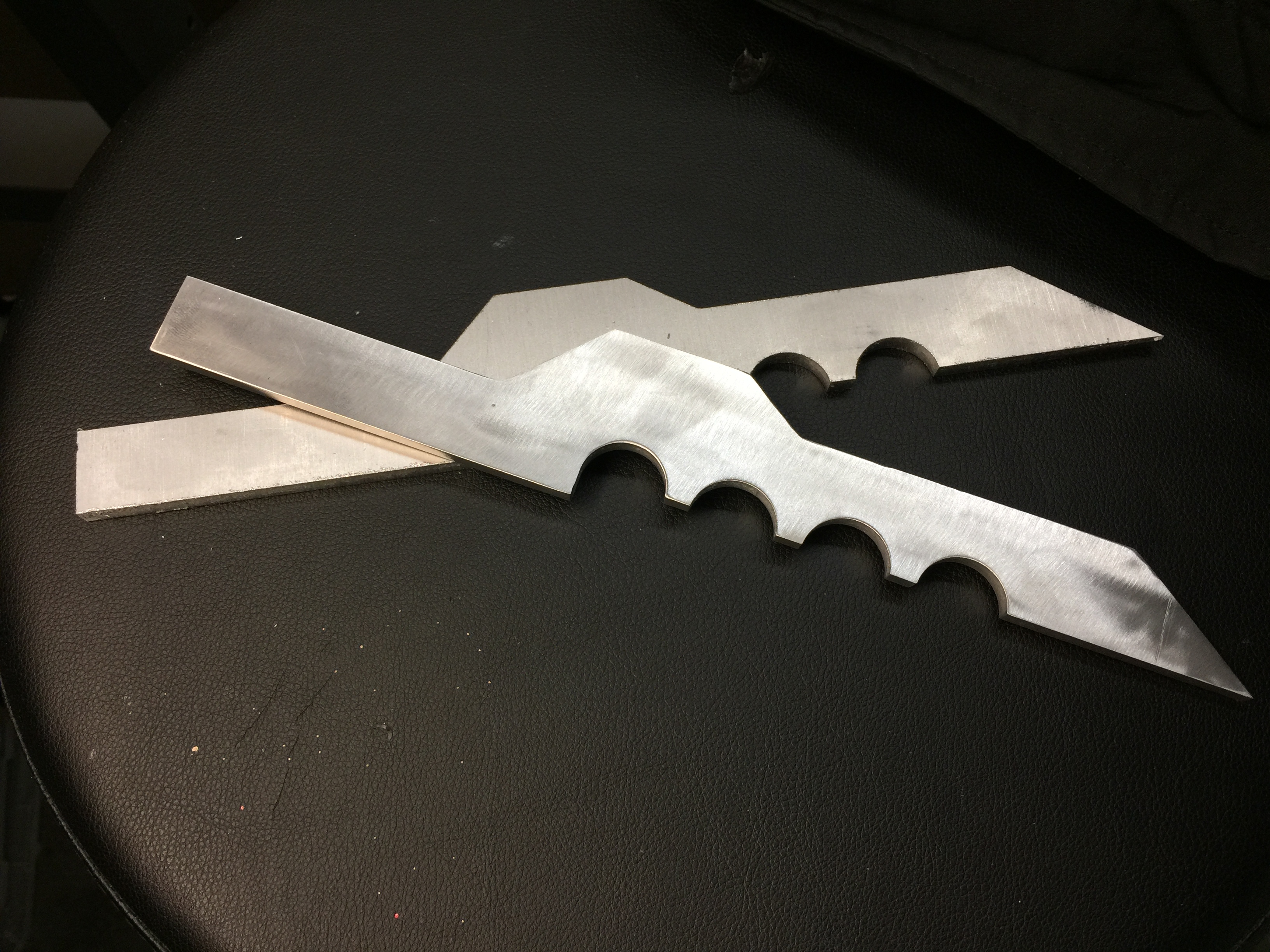

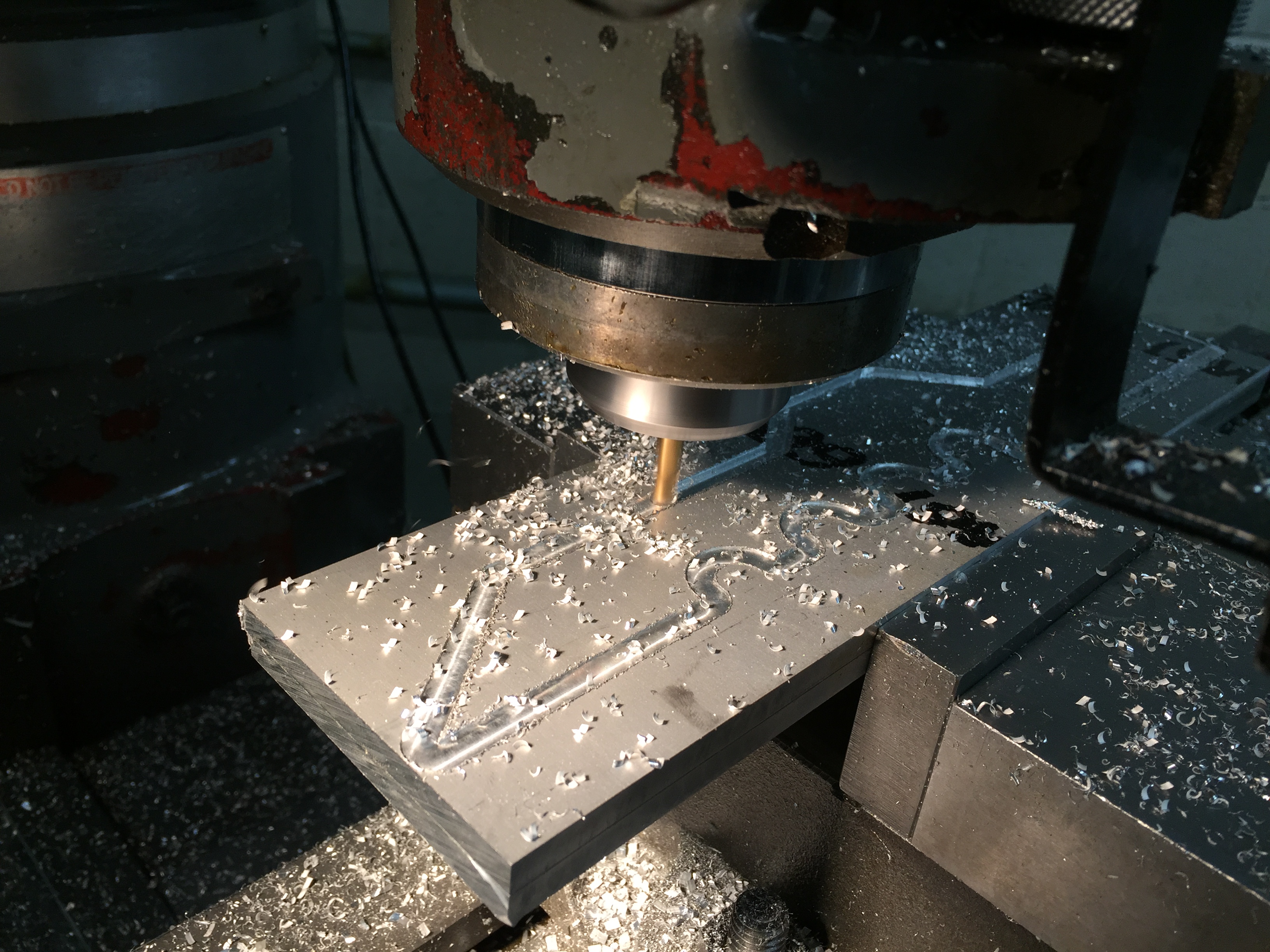

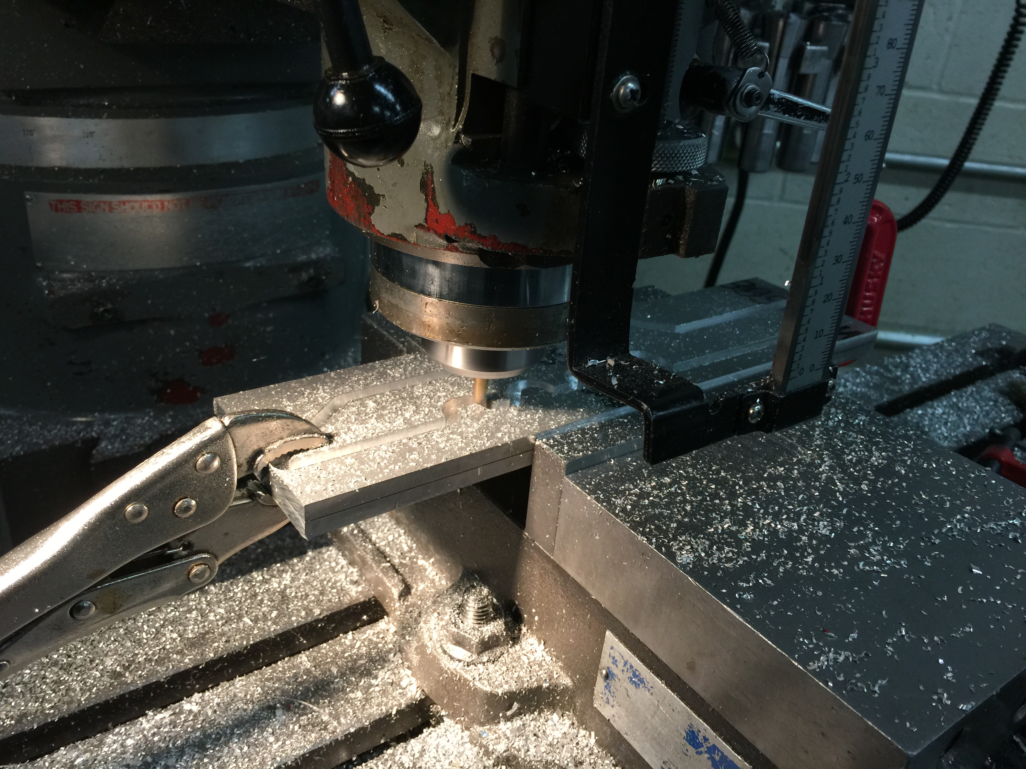

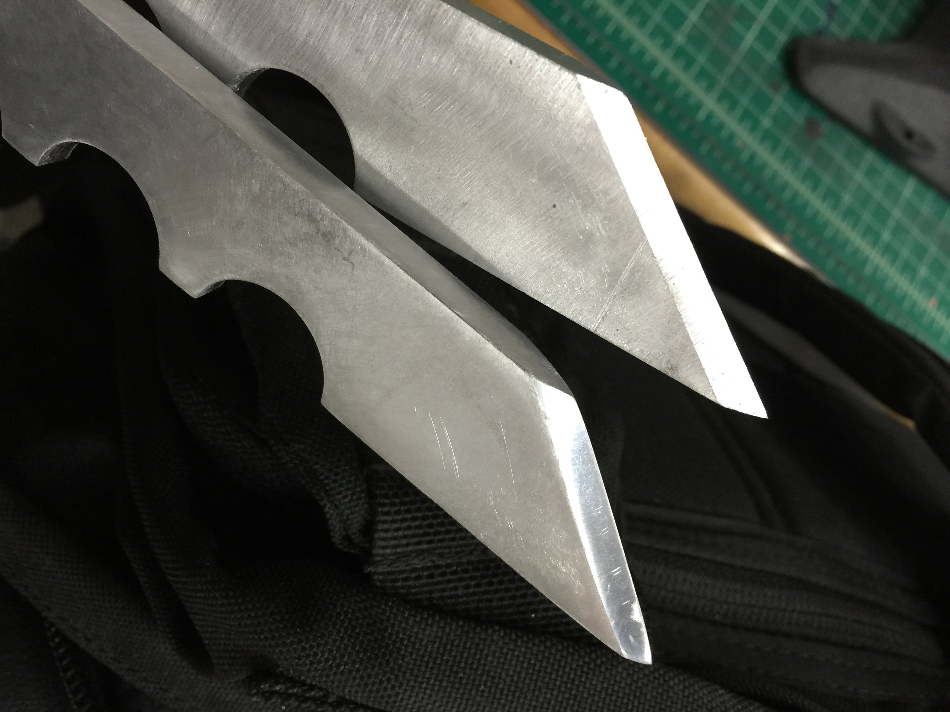

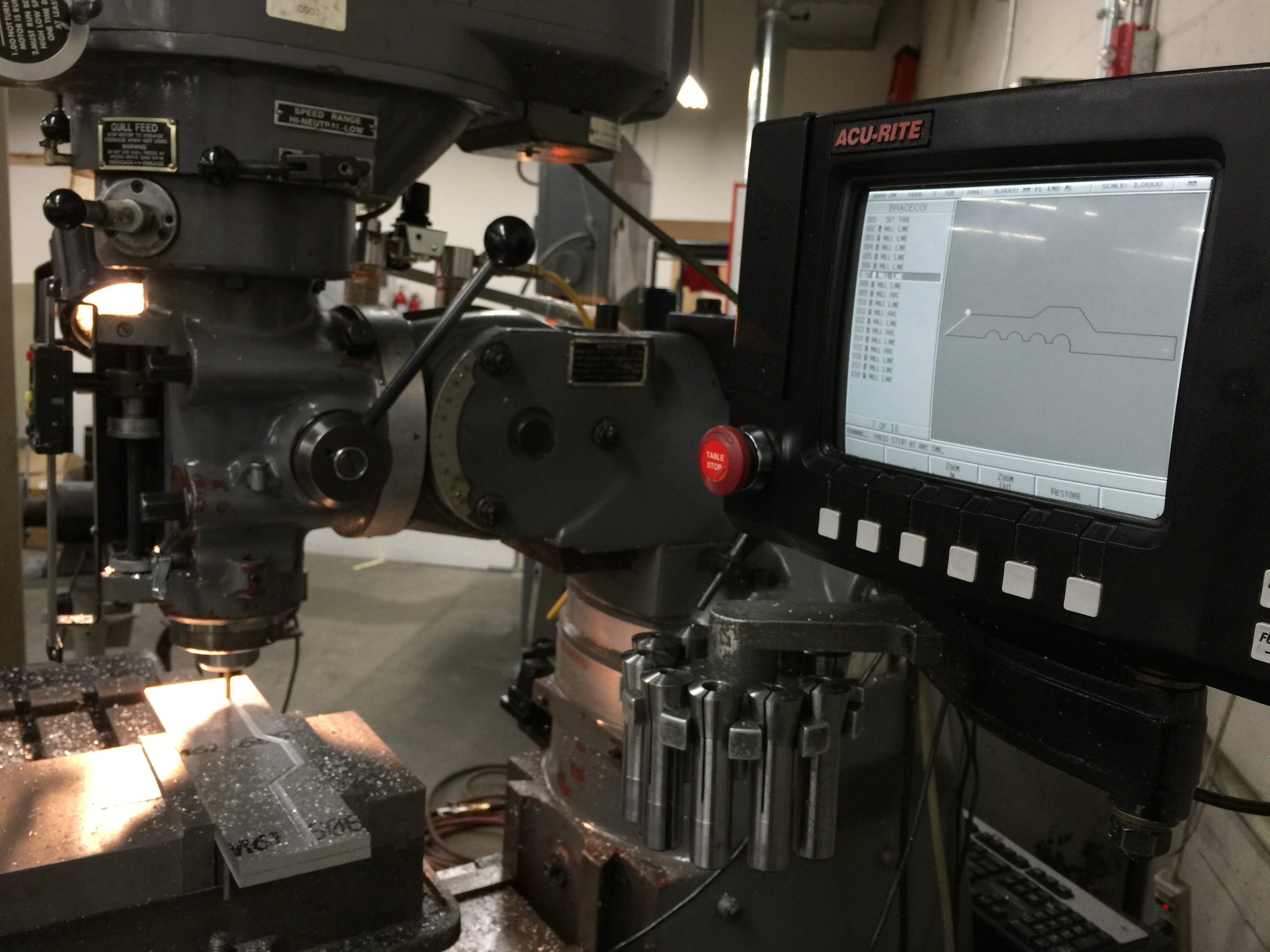

Here are the plans for anyone who wants to make his or her own. :)
CNC Milling Plans for Phantasm Brace Coil (PDF)
I now just have have to figure out how to make the handle.
Super cool.
Super nerdy.
Well done.
High praise. Thanks! :)
I'm actually super excited about this one, perhaps precisely because of its obscurity—and/or because it's from that an episode of that era of my childhood where I was at the height of my TNG obsession.

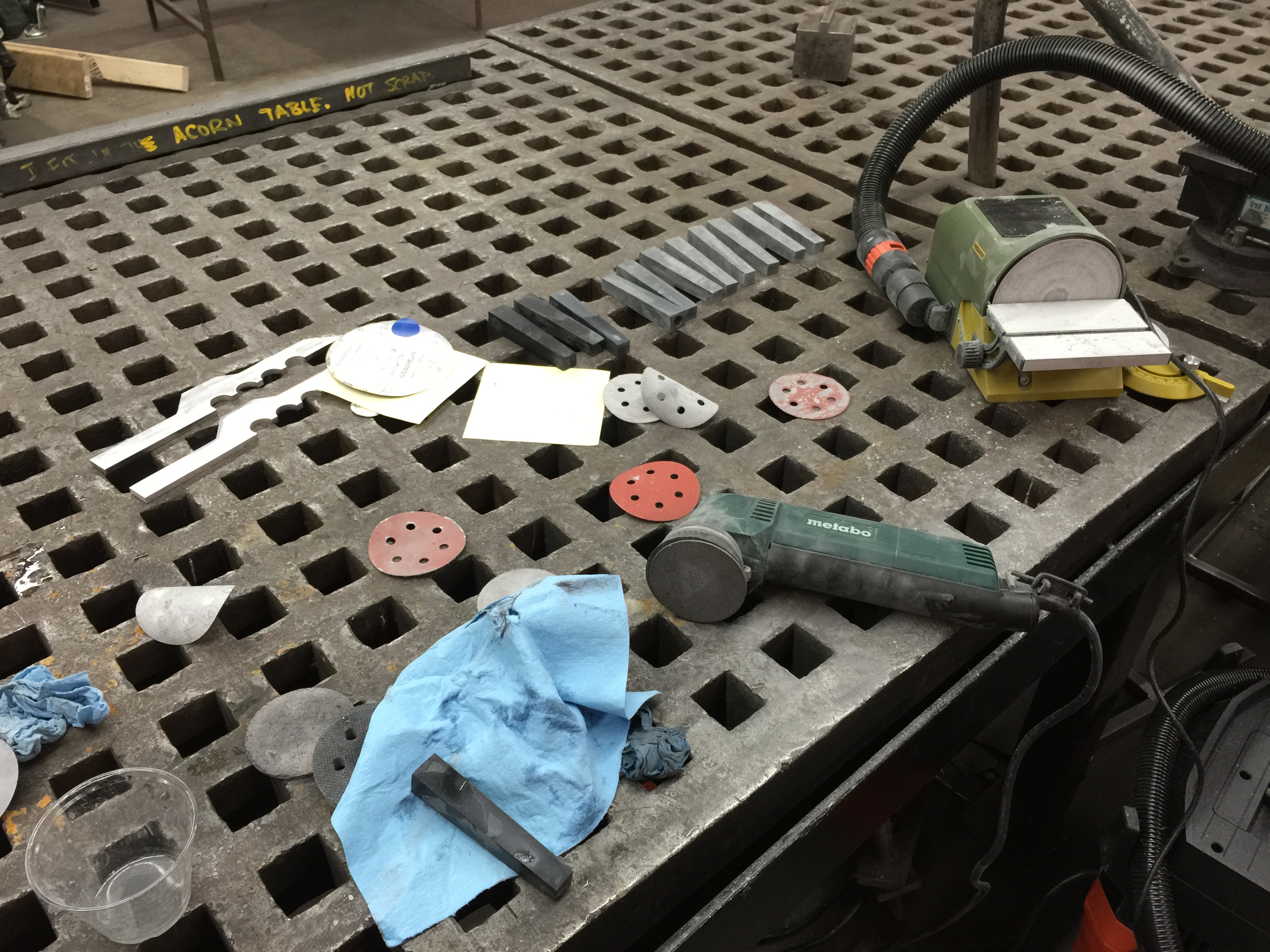

However, I did manage to get my new abrasion toys today and give them a try.

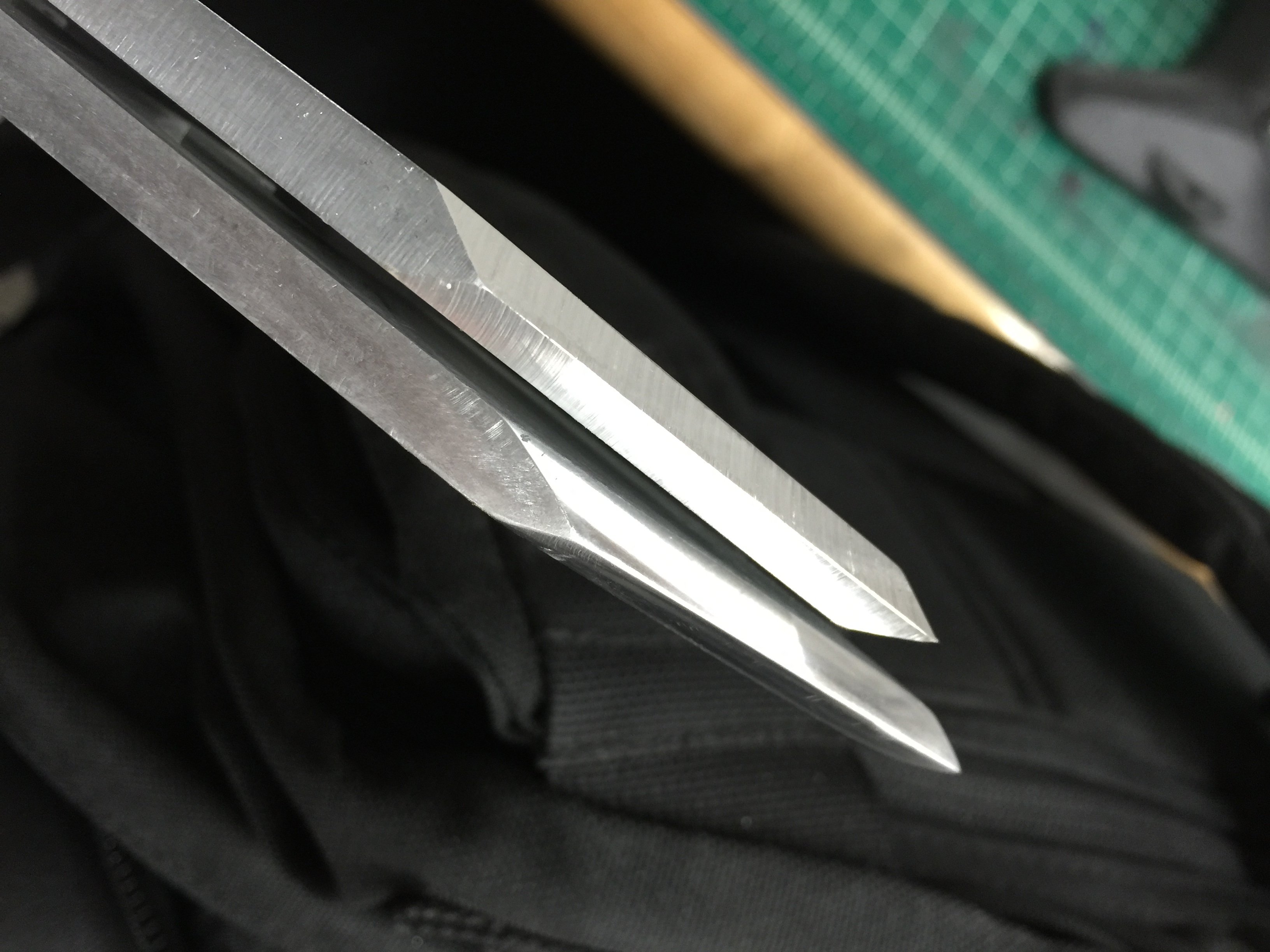

Thanks to an Amazon gift card courtesy of my ridiculously indulgent husband the other day, I picked up the Proxxon disc sander. I used it to put the proper 45 degree bevels on my the tips of my brace coils.
And it made quick work of what was previously the onerous task of roughing down the seam lines on my TMP scanner bodies.
The Metabo random orbit sander has been doing a further excellent job in helping me process through my TMP scanner bodies my quickly. Moving up in successive grits from 400 to 3000, I've been able to get the awesome Onyx resin up to a really spiffy luster.

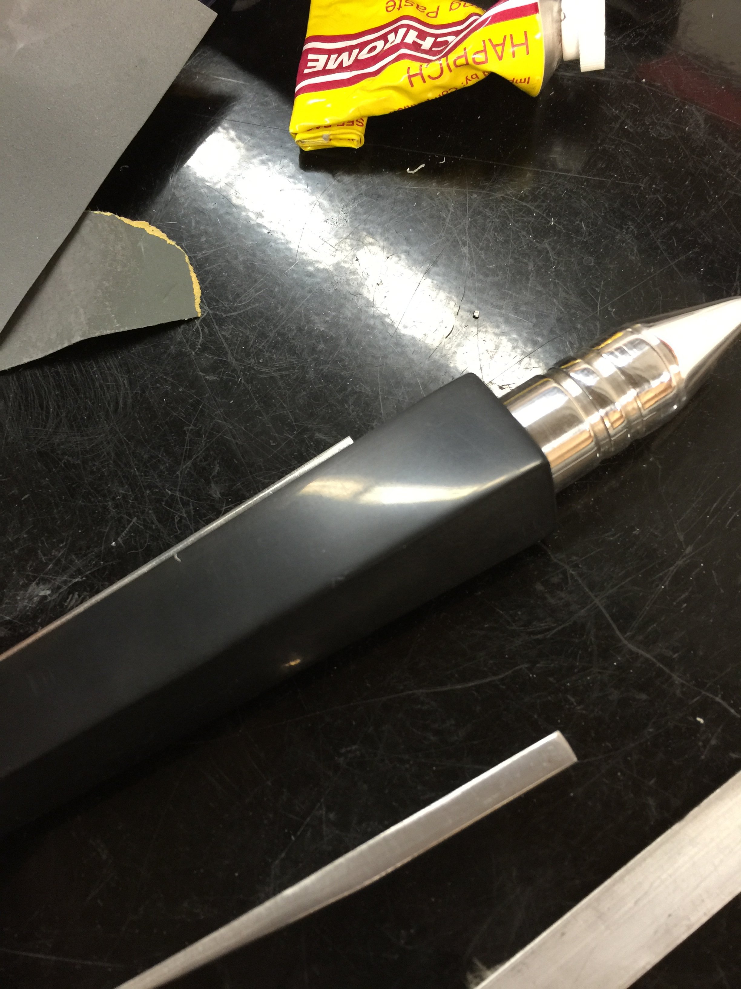

It takes a lot of work (wet sanding, drying with a paper towel to reveal flaws, and sanding again, over and over again), but it feels really nice. I definitely prefer it to paint, though I'm not sure in the end it will end up having been less work (as I had originally hoped it would be).

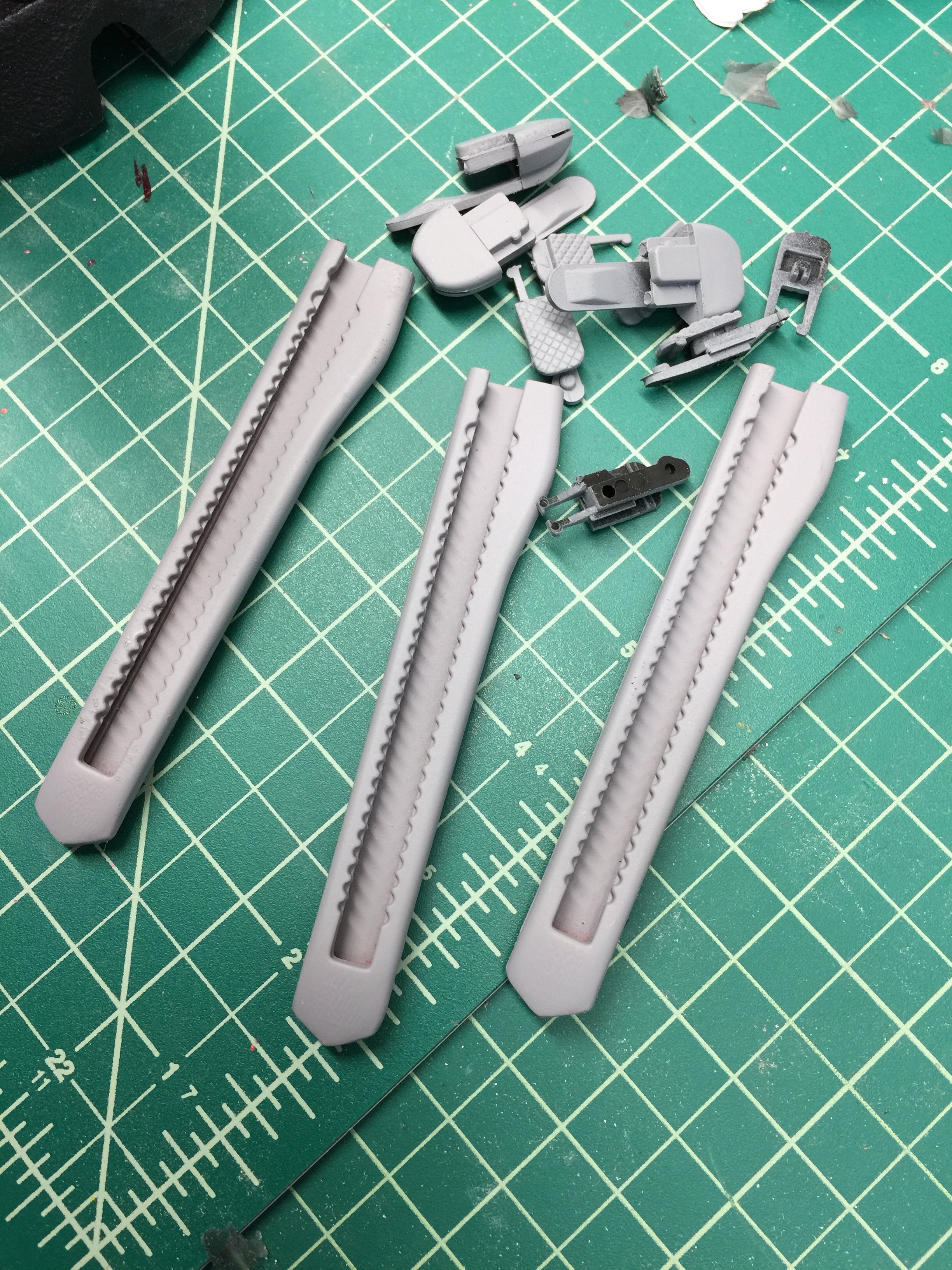

I also sanded the "Made in China" words off some snap razors and primed them, working on the cool "almond stylus" project that Nick recently inspired. I tried mixing some custom paint for it today, with iffy results. I'm going to try again tomorrow.
