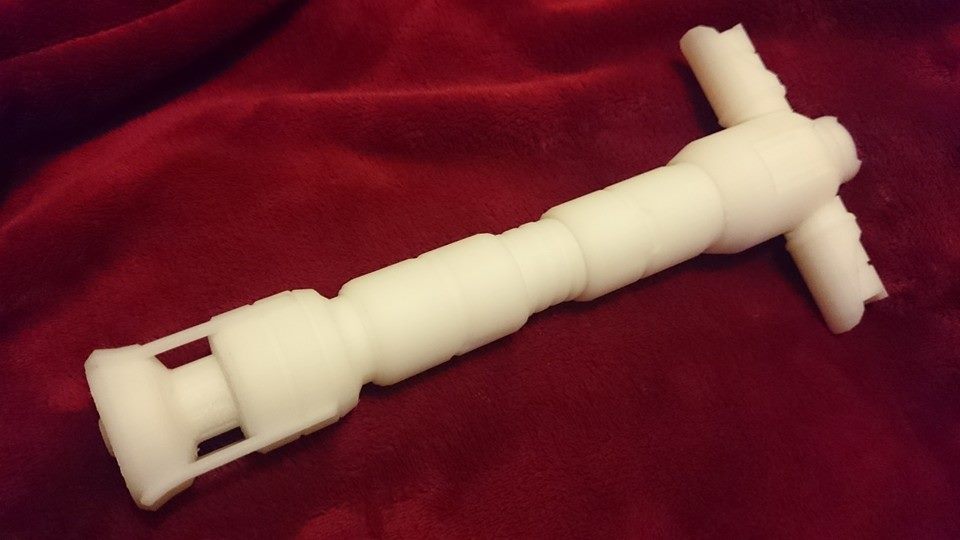

I'm a big fan of the new lightsaber design so i thought i'd have a crack at making one myself. This is my first post so i'm sorry if i've made any faux pas. The trailer was a little dark so a lot of the detail is an interpretation.
I started with a 3D model in Maya and asked a friend of mine with a Zortrax M200 to print it out for me.
The print came out perfectly.

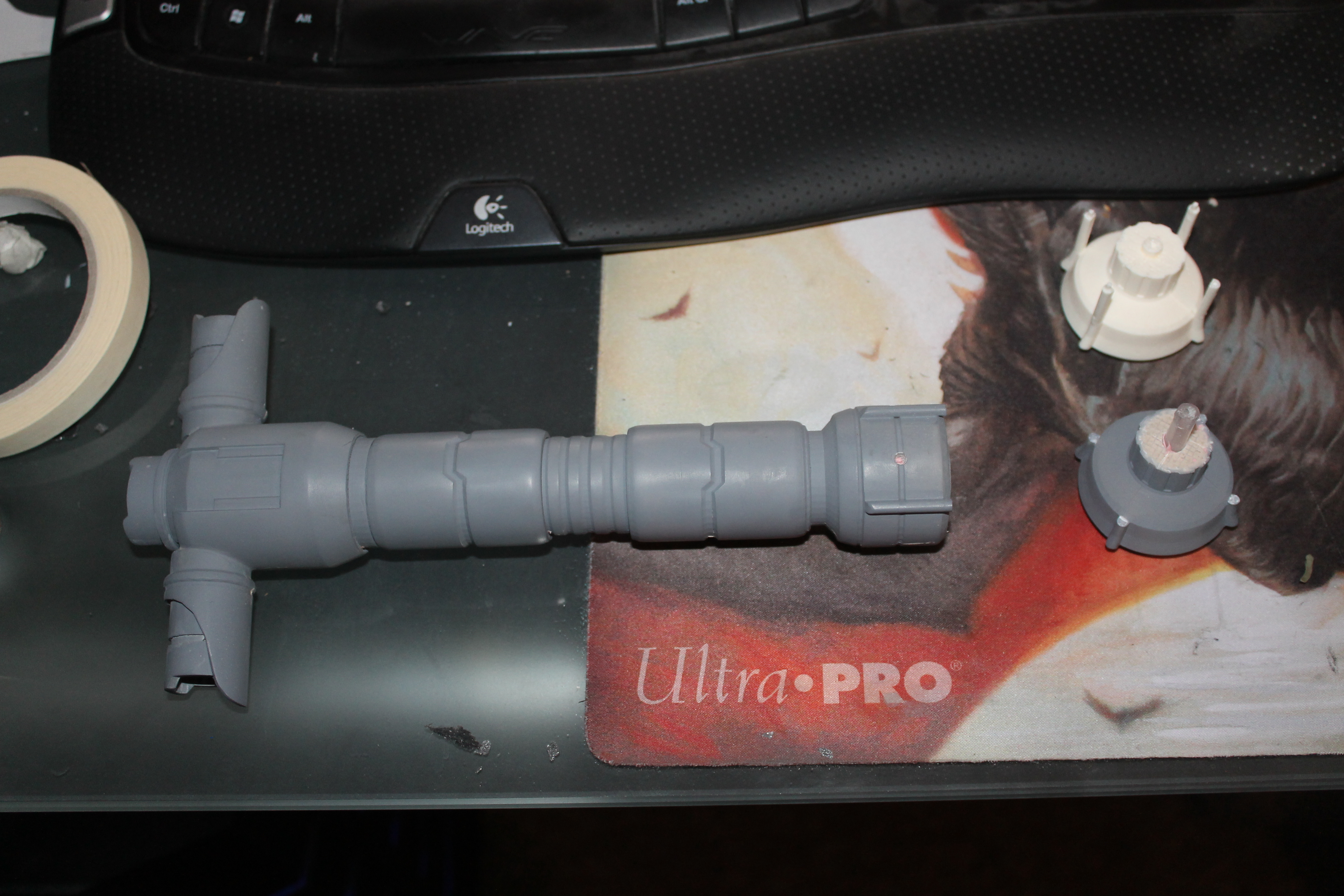

With a bit of sanding and primer it started looking really nice.

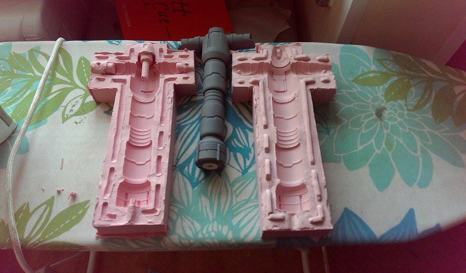

Time to mold! always a nerve racking time for me, but it came out great.
I dusted the inside of the mold with aluminium powder to cold cast it and give it a great metallic finish. A lick of paint and some light weathering and i was pretty happy with the result. has a nice satisfying weight in the hand.

good luck on your own build! it's a good shape for 3D printing, I split my model up into sections and printed each vertically (including the two side emitters) just so it printed a cleanly as possible.
In mine i've kept a hollow cylinder in each of the emitters so i can add a blade at a later date (currently working on them). I could also use my mold to do a hollow cast of i wanted to put any electronics inside.
