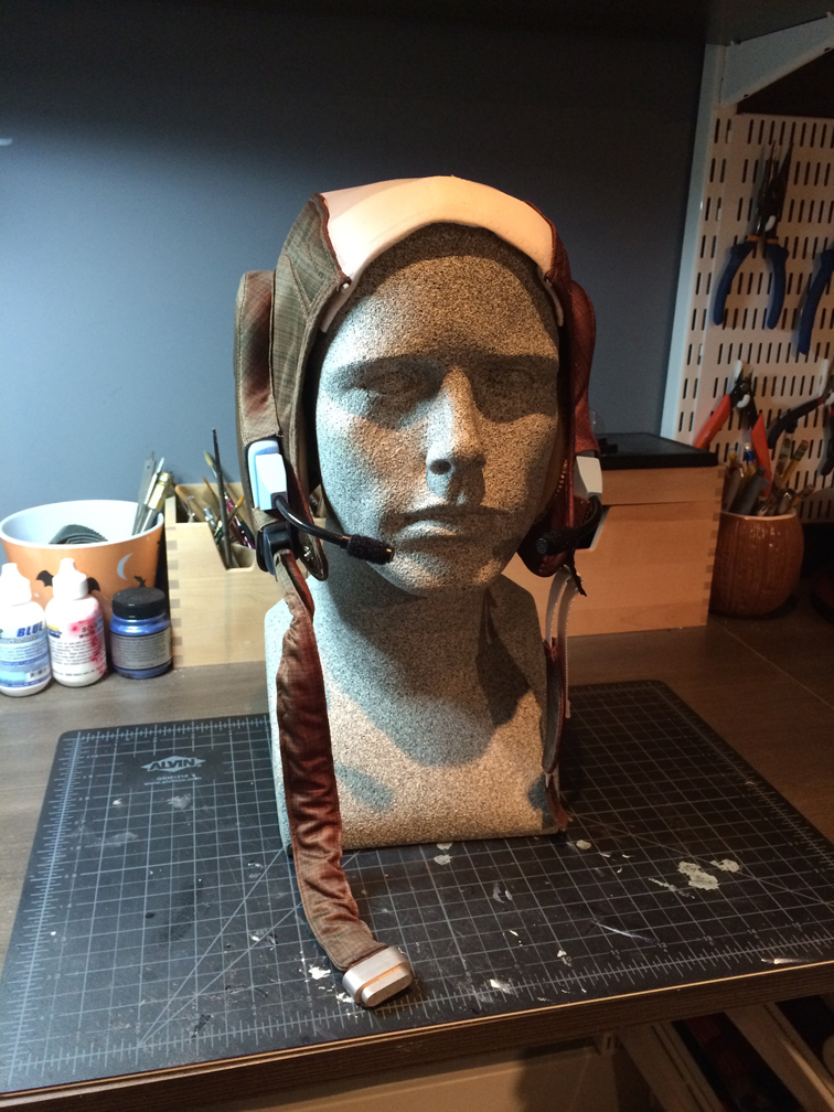

I'm starting with the communications carrier, more commonly known as the "Snoopy cap." It seems like a simple piece, but it's actually VERY complex when you look at the real caps up close:

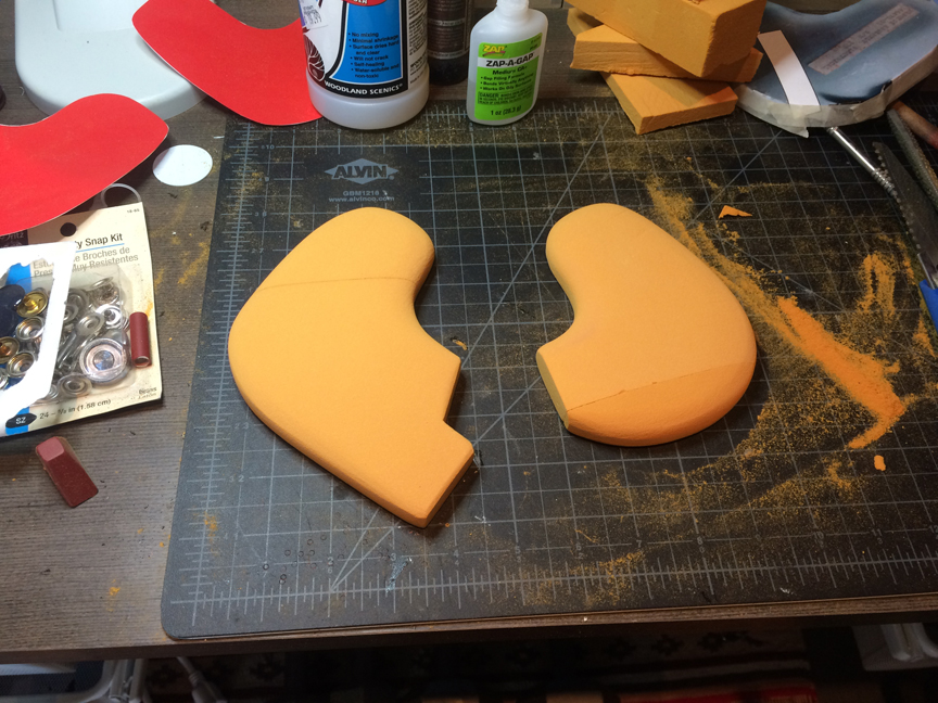

I started sculpting the "kidneys" using some good reference I had that was fortunately taken next to a ruler. I recast those sculpts in foam rubber so they would be soft and flexible:
I also scratch built the microphone parts and various cable plugs in styrene, then recast in colored resin (no paint):

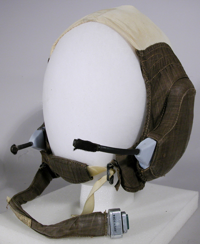

After much trial and error, I created an accurate pattern that properly fit my head. I also got a custom fabric made. The real fabric was made of teflon and it had a very unique cross-hatched pattern on it. I could not find a suitable fabric anywhere, so I created the pattern myself in illustrator and got it printed. After much searching, I also found a spandex netting that was spot on to the stuff used on the real caps. The white fabric on the top of the cap is actually netting to dissipate heat (a real cap in the Smithsonian is shown on the right):

Continuing on. I sewed the perspiration headband that secures onto the forehead of the cap with velcro. There were two types of these used that I've found. Some were chamois, and some were cotton. Sometimes the caps were worn without them. I made a cotton one out of one of my daughter's cloth diapers :). I also sewed the chamois ear cups for the inside of the cap:
I also made the manufacturer's label using a heatpress transfer on nylon fabric. The real caps were made by David Clark Co. This is pretty much as exact replica of the label that was actually put on these caps, but I wrote "repro" and changed the serial number:

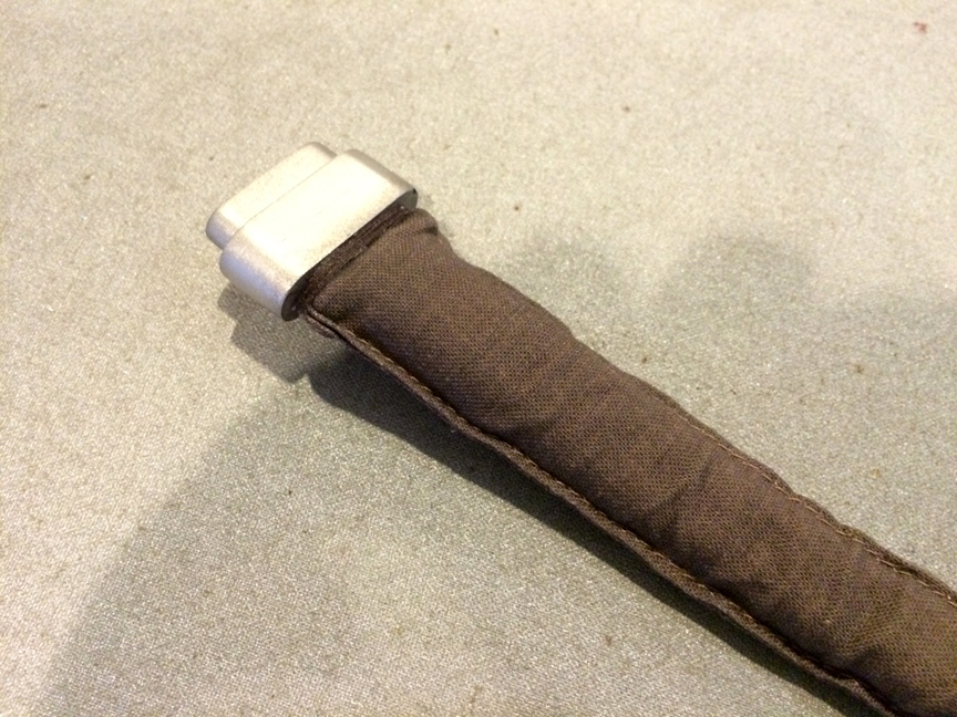

Replica cables using rope. I'm going to install magnets into the plug so I can quickly connect it to the cable that will go in the suit:
Finished Snoopy Cap!

Thanks! I agree, the snoopy cap is VERY complicated. I have a lot of experience patterning out costumes and this was one of the more difficult pieces I've ever had to figure out. So much so that I made another cap after that previous one and made some slight alterations to the pattern. I think my new cap is pretty spot-on accurate now. Because the real fabric was teflon, I decided to get a new batch of fabric made out of a synthetic instead of cotton. The color is more saturated. Here is a picture of a real snoopy cap next to my latest replica:
Some more detail shots:
