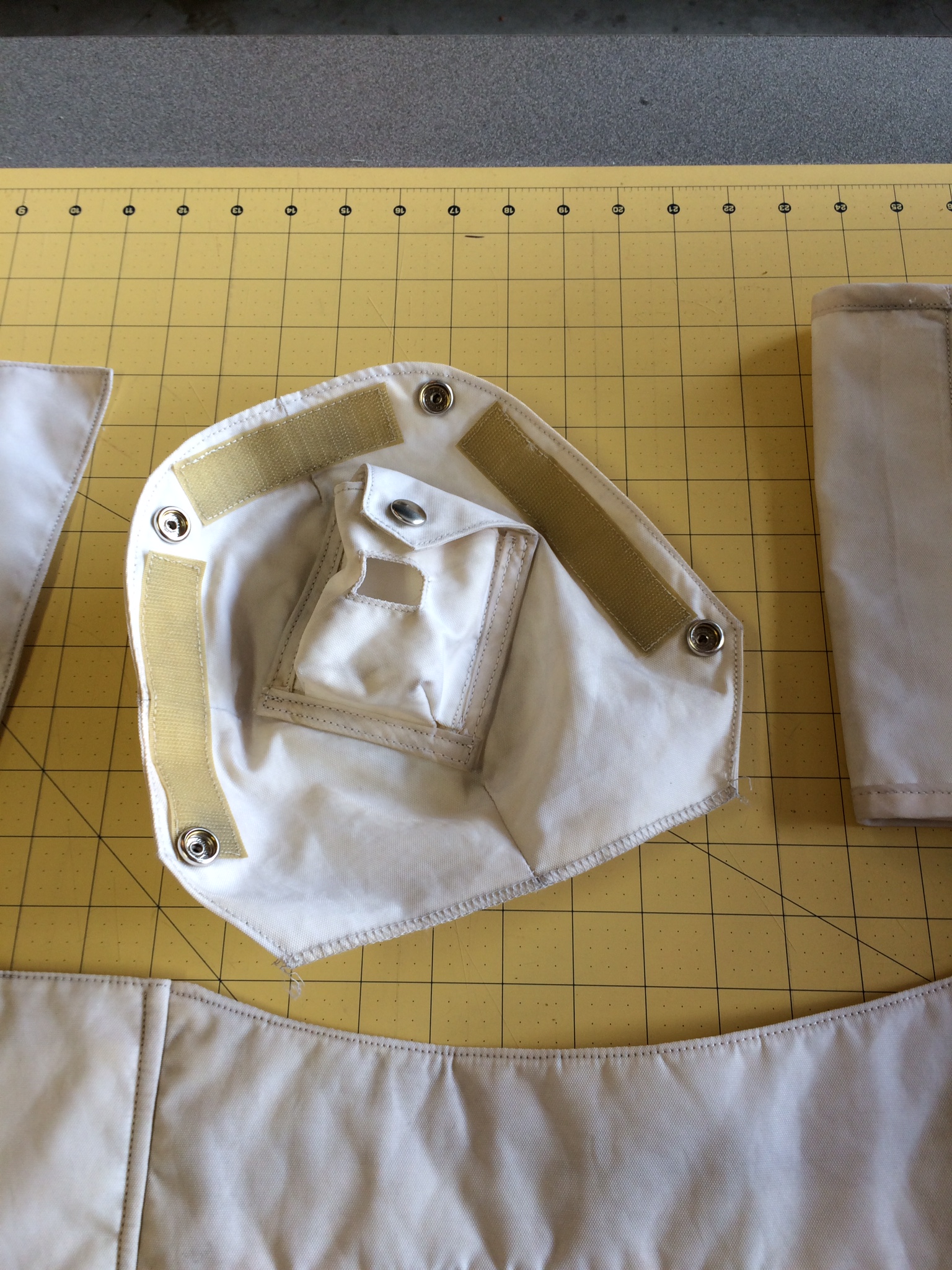

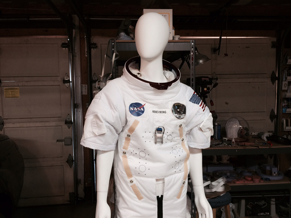

Sewed on the patches, added the snaps, velcro, and other details. Just for the heck of it, I used the faded filter on my phone for a vintage look:

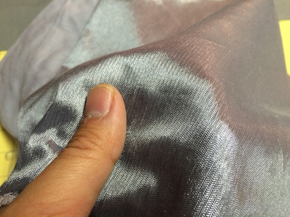

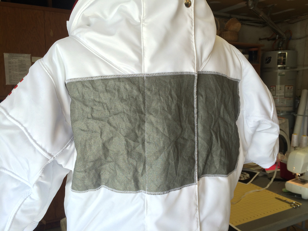

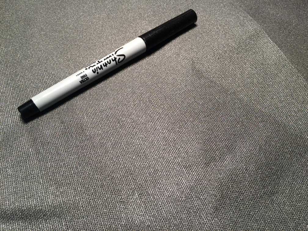

I found an amazing fabric to represent Chromel-R on my suit, but for some reason, I only had the foresight to buy a couple yards of it. Chromel-R is a type of fabric woven from stainless steel fibers and was used on the back of the Apollo suit, as well as the lunar boot and glove covers. This stuff looks amazing:

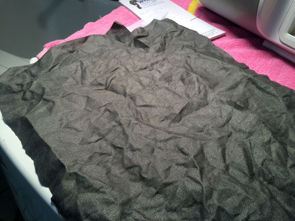

Since I only have enough for one suit, I'm saving that fabric for my deluxe suit. I found another way that's almost as good to get the look of Chromel-R. I basically took a gray canvas type material, dusted it with metallic spray paint, then crumpled it up:

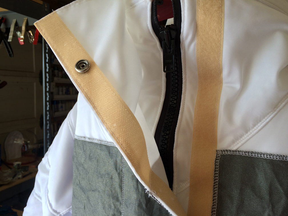

I also sewed in the back zipper and fabricated the zipper dust cover:

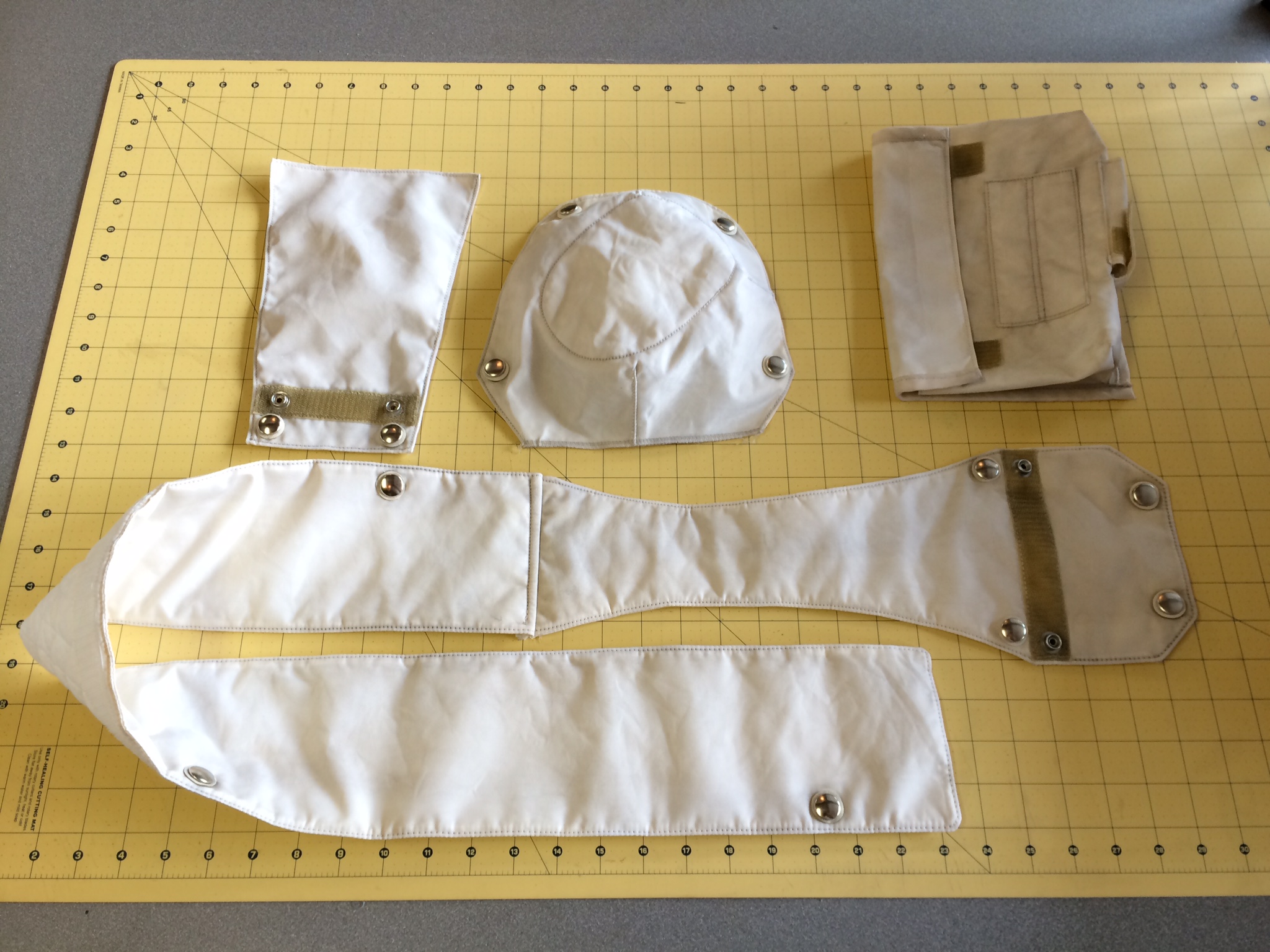

Started patterning out the legs. The actual A7L legs were sewn into a "curve" at the knee. It took me the longest time to figure out why the leg of the suit looks totally flat on the back and bunched up and wrinkled on the front. It's because there is a curve at the knee to allow the knee convolutes to move with ease:

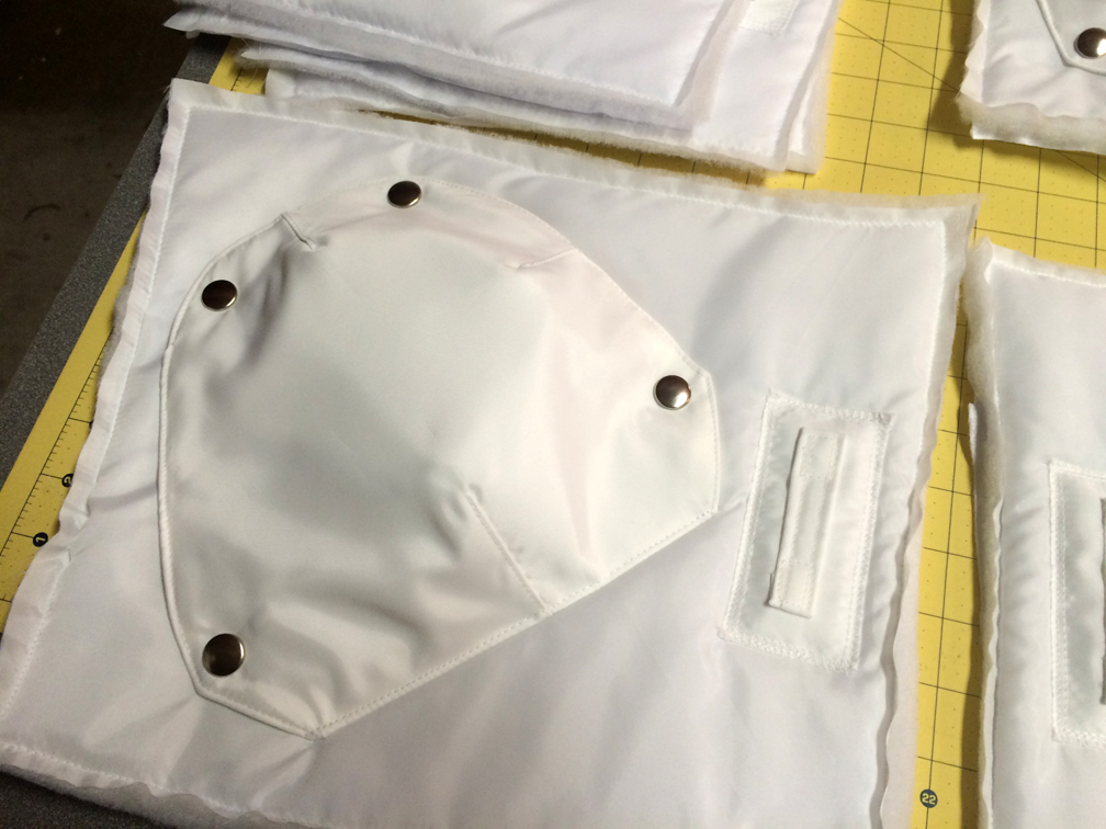

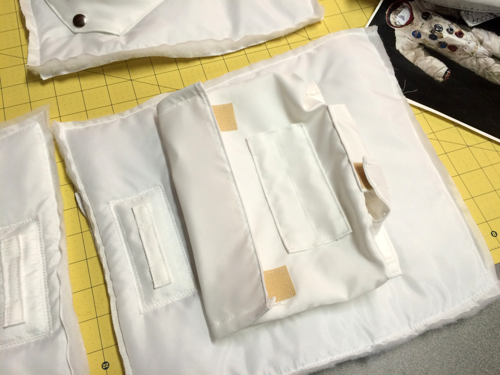

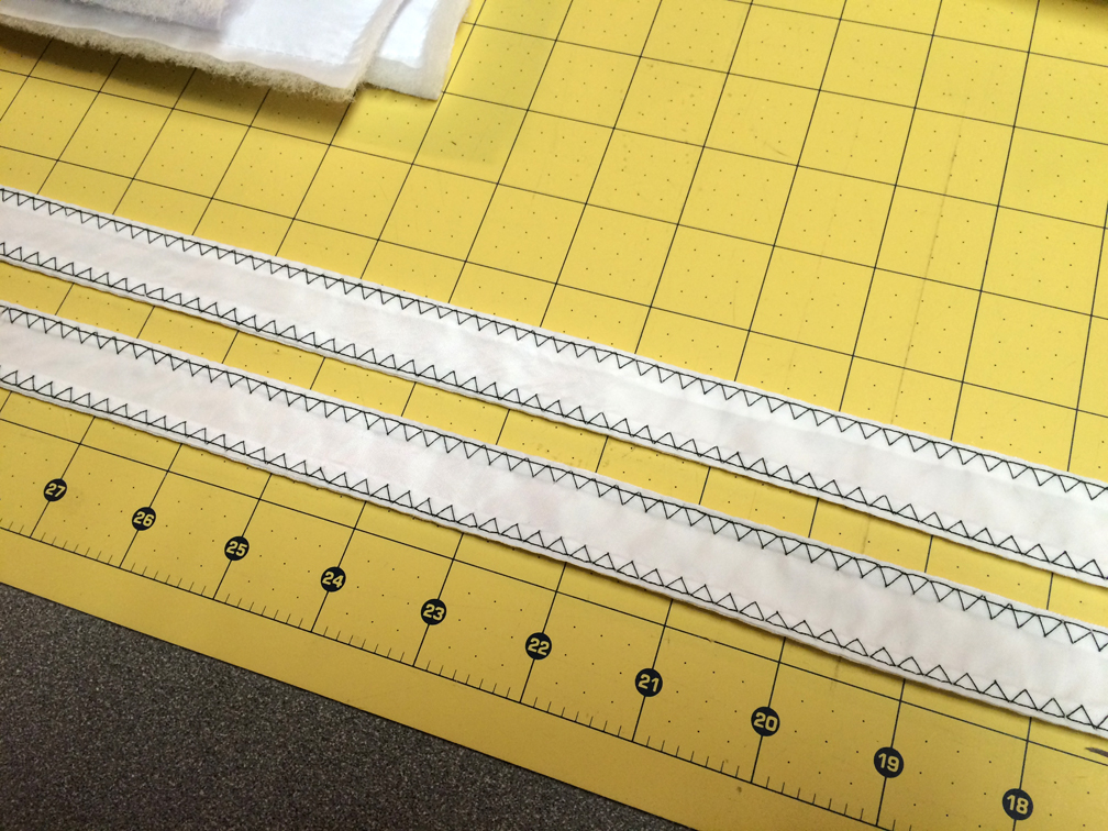

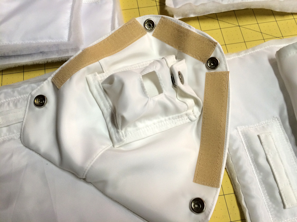

I also spend a long time patterning out and sewing all the details for the legs. The made the straps, pouches, loops, etc:
I'm learning a ton about this suit in the process of making it. The clamshell shaped pocket on the thigh is a cover for the urine transfer system (I still have to fabricate this) and a medical injection site. The inside of the pocket has ANOTHER pocket sewn to it which holds the PRD (Personal Radiation Dosimeter).

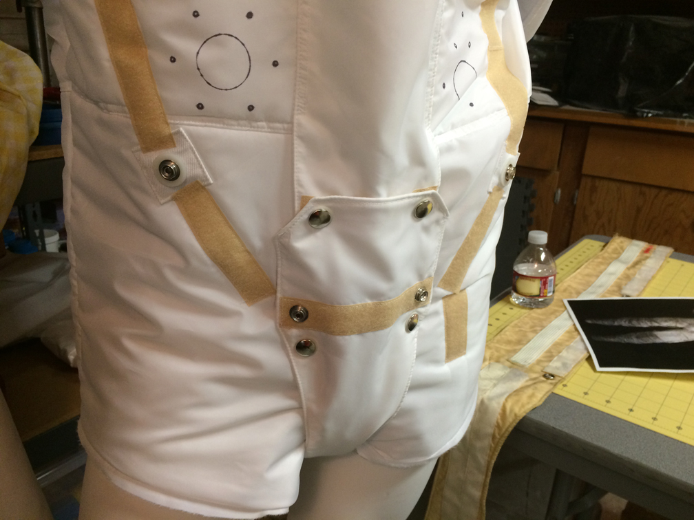

I attached the leg assemblies. I still have to close them up at the bottom, but they're pinned in place. It's really starting to come together.

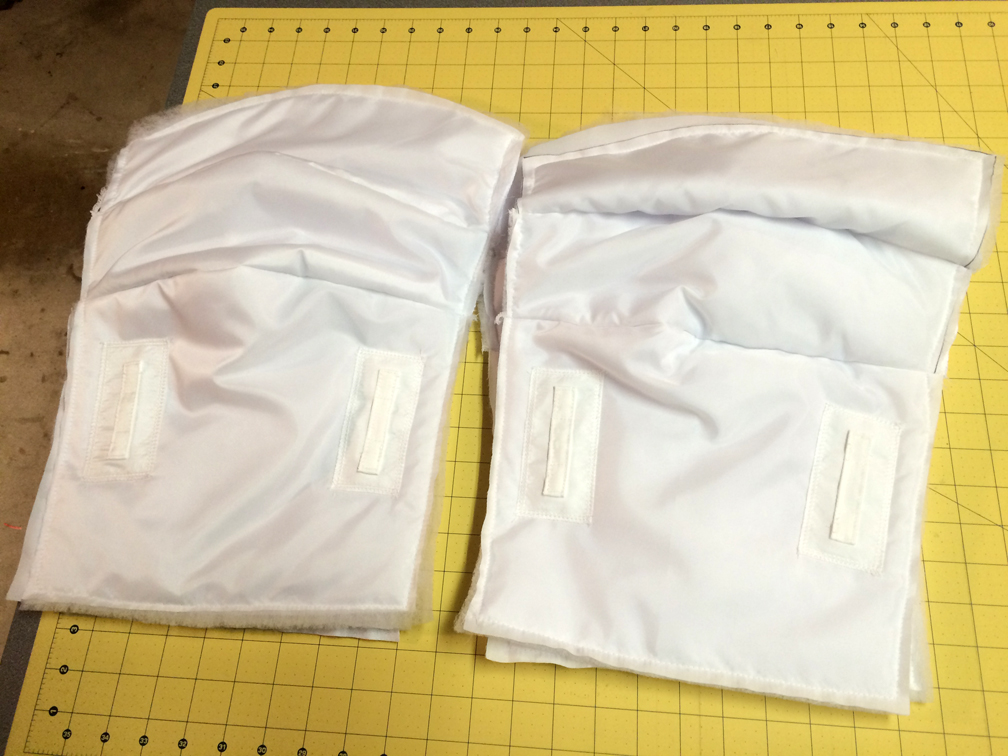

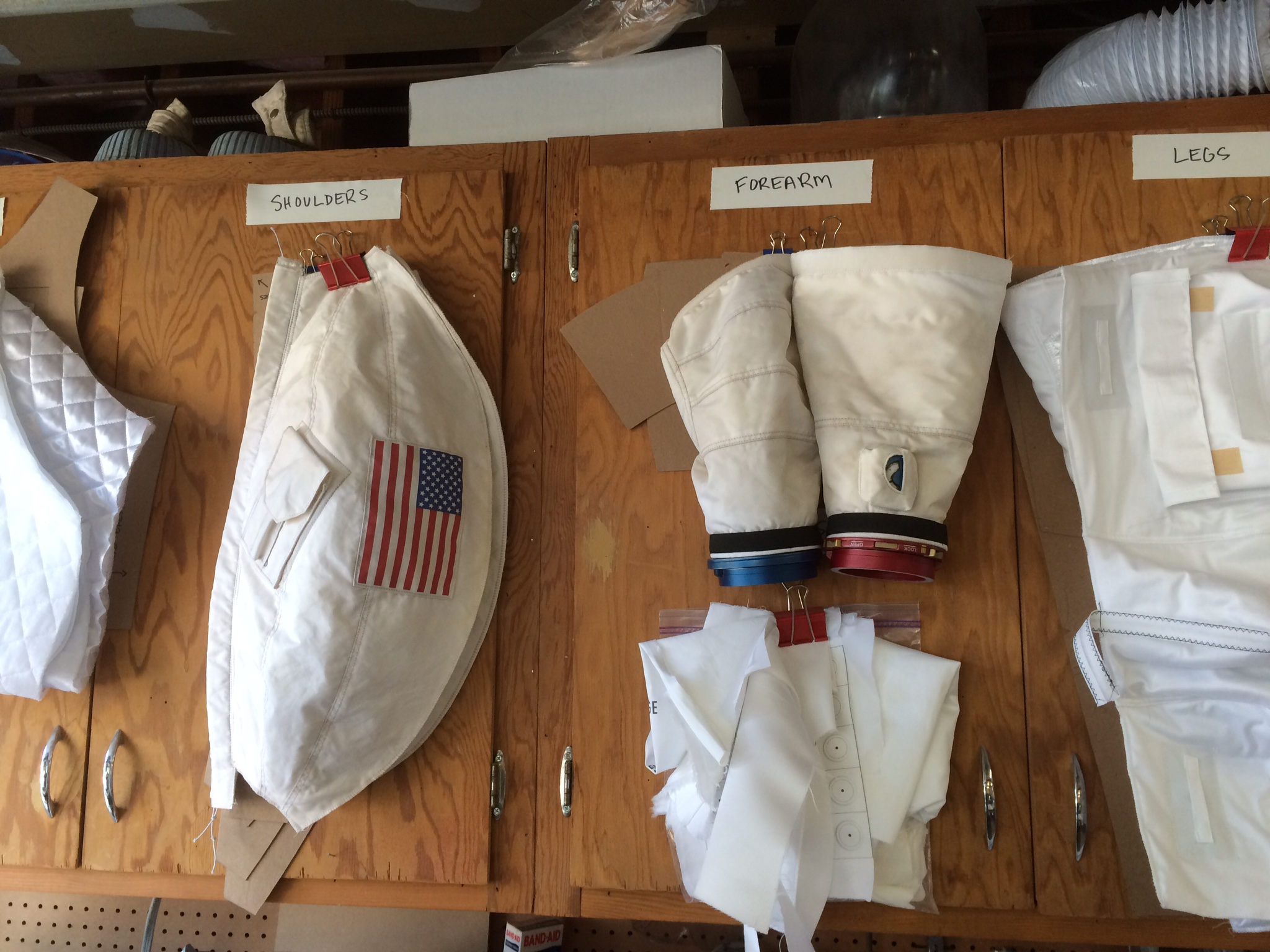

I attached the connectors and the arms. The connectors were a pain to install. I have to remember to sew the holes in the front panel before I incorporate it into the suit, because trying to sew anything onto the entire suit now is difficult because the garment is huge and bulky to fit in the sewing machine. It's much easier to work with subassemblies and sew the whole thing together at the end.
I'm still tweaking the inner structure a bit. I also need to prop the helmet ring up into the correct orientation. The real suit had steel cables pulling the shoulder joints in. I used elastic to simulate this. Otherwise the sleeves sag down. If you look at photographs of astronauts wearing the A7L suit, the glove rings sit pretty high up on the wrist. If I didn't put the elastic cables in, the rings would fall all the way down to my hands.

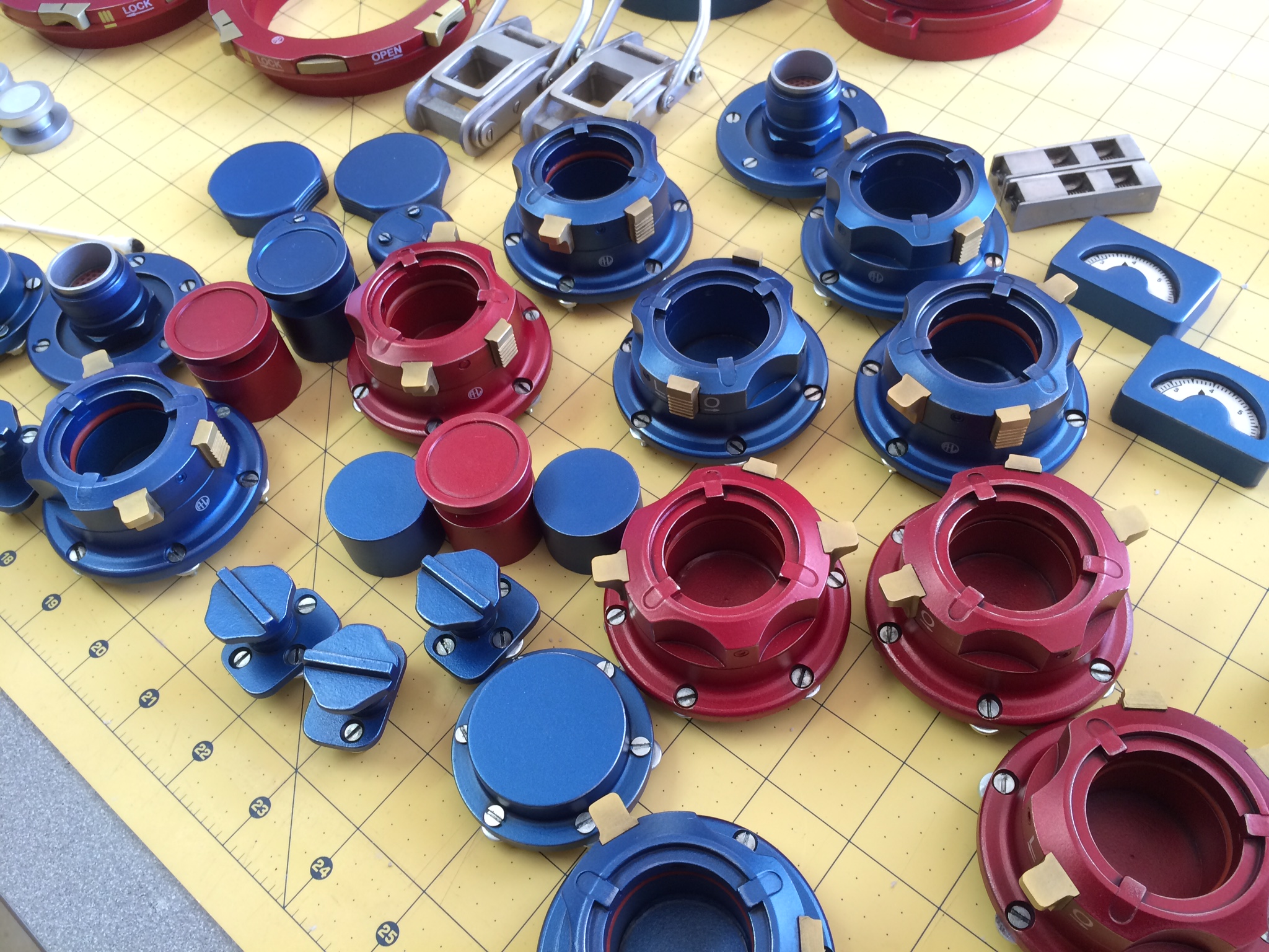

This is my "B" suit. The "A" suit has my last name on it. I used the old 3D printed connectors on this suit and the Spaceworks connectors on the other one. They're a little bit undersized, but only a few millimeters, so it's barely noticeable to anyone but me probably. The old connectors still look pretty great.

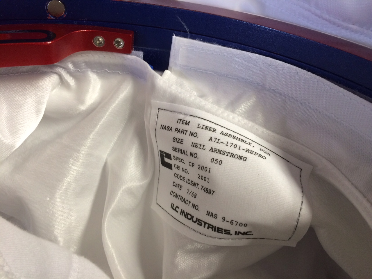

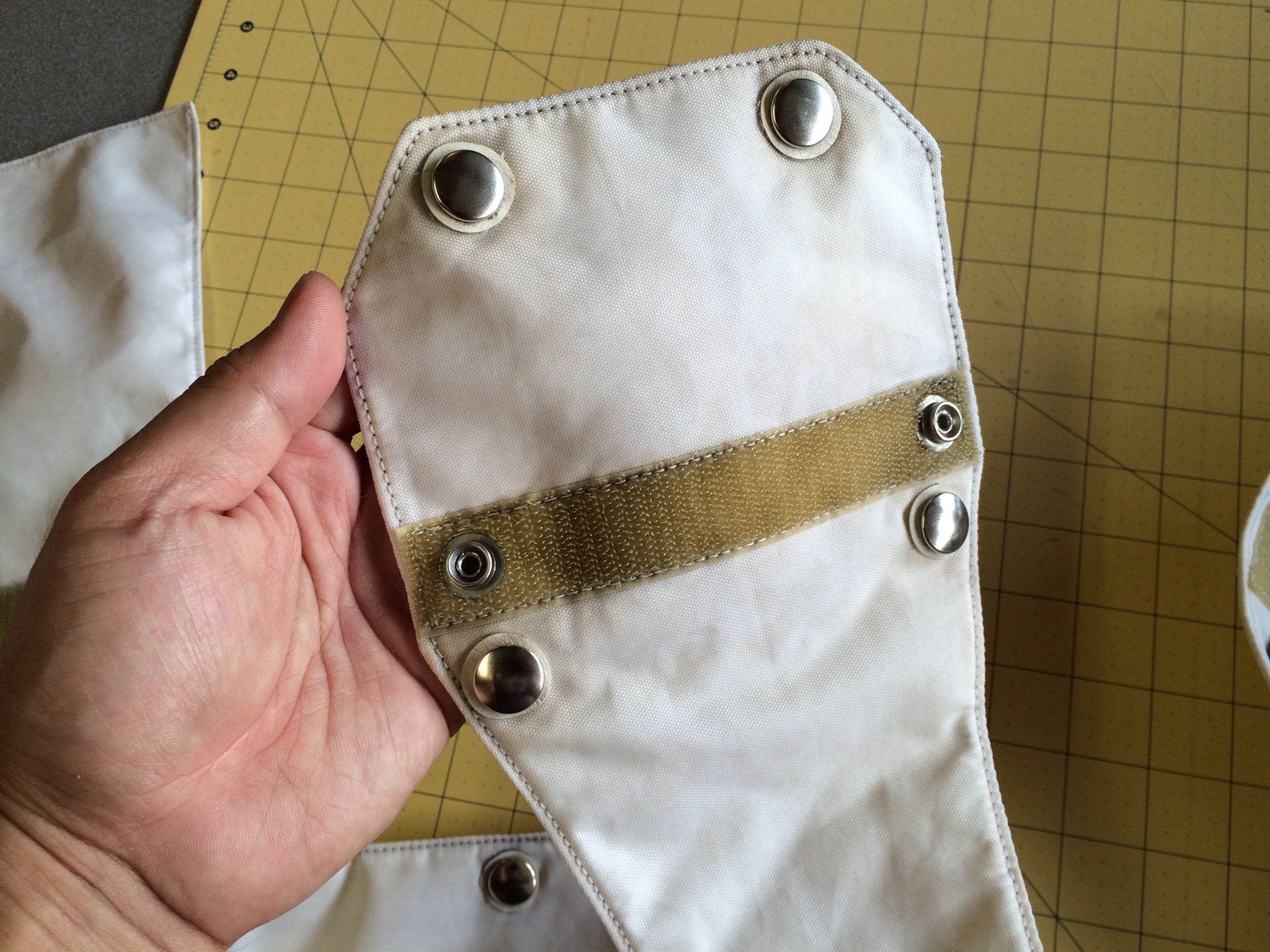

Made a partial liner (only the part visible in the neck ring when the suit is worn). Including an accurate ILC label.

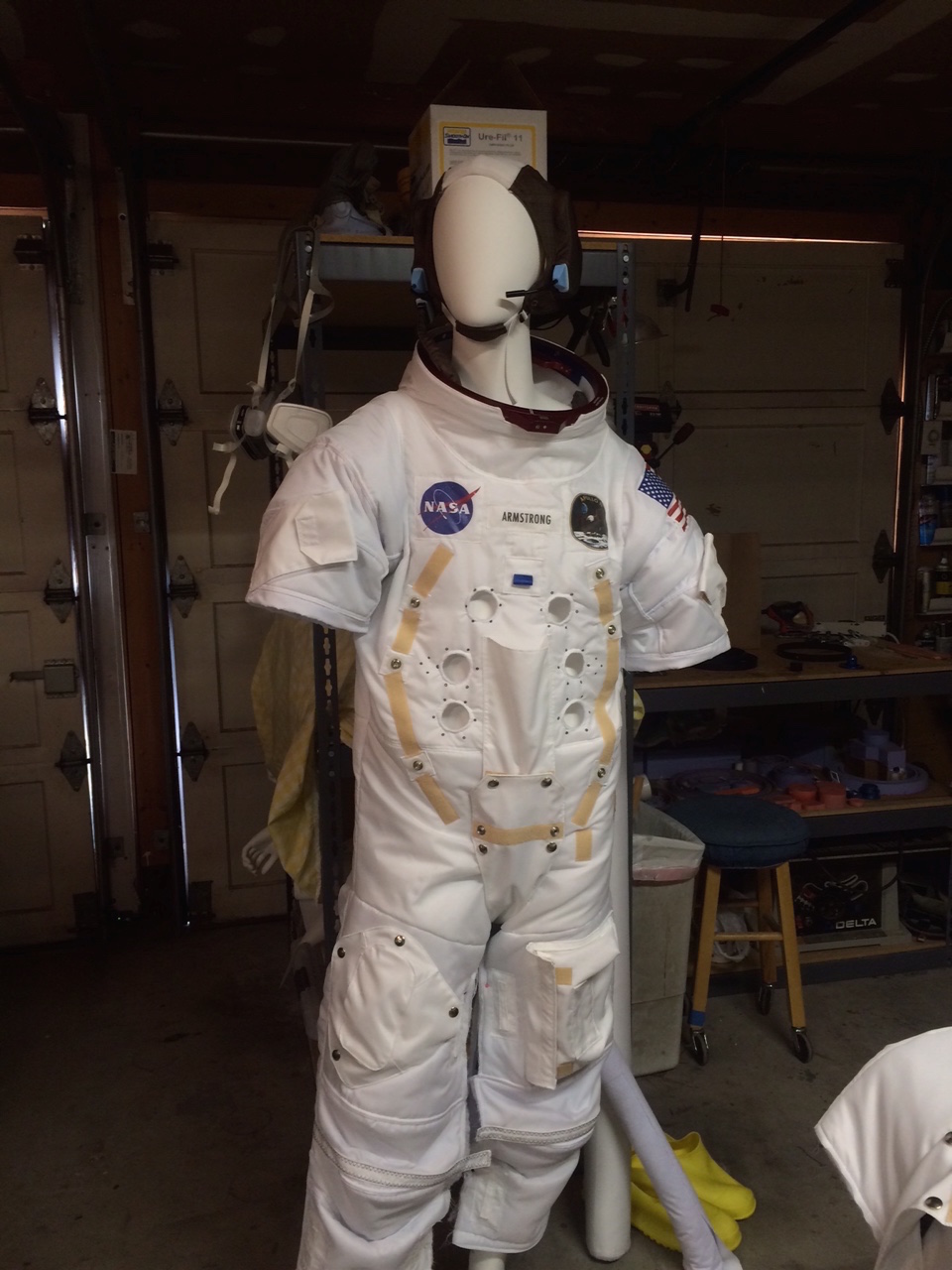

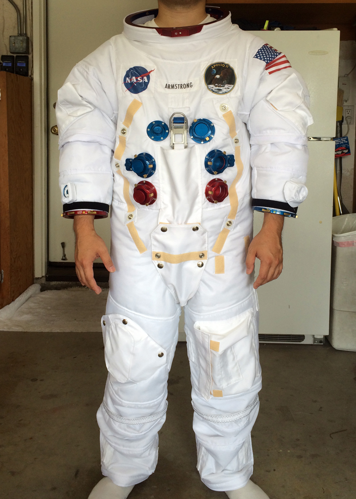

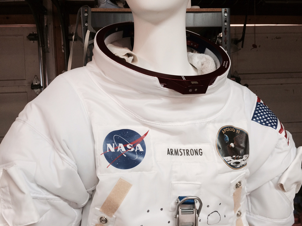

I finished my prototype suit and took some proper photographs after the prop party this past weekend. I'll be tweaking the pattern a bit for my next suit and eventually doing an AC unit and all the extravehicular components. But here is my replica of Neil Armstrong's Apollo 11 suit. Slightly weathered to look like a real piece of hardware:
More photos here, including some of my Mercury and Star Trek suit:
http://www.ryannagata.com/otherstuff/apollo-space-suit/

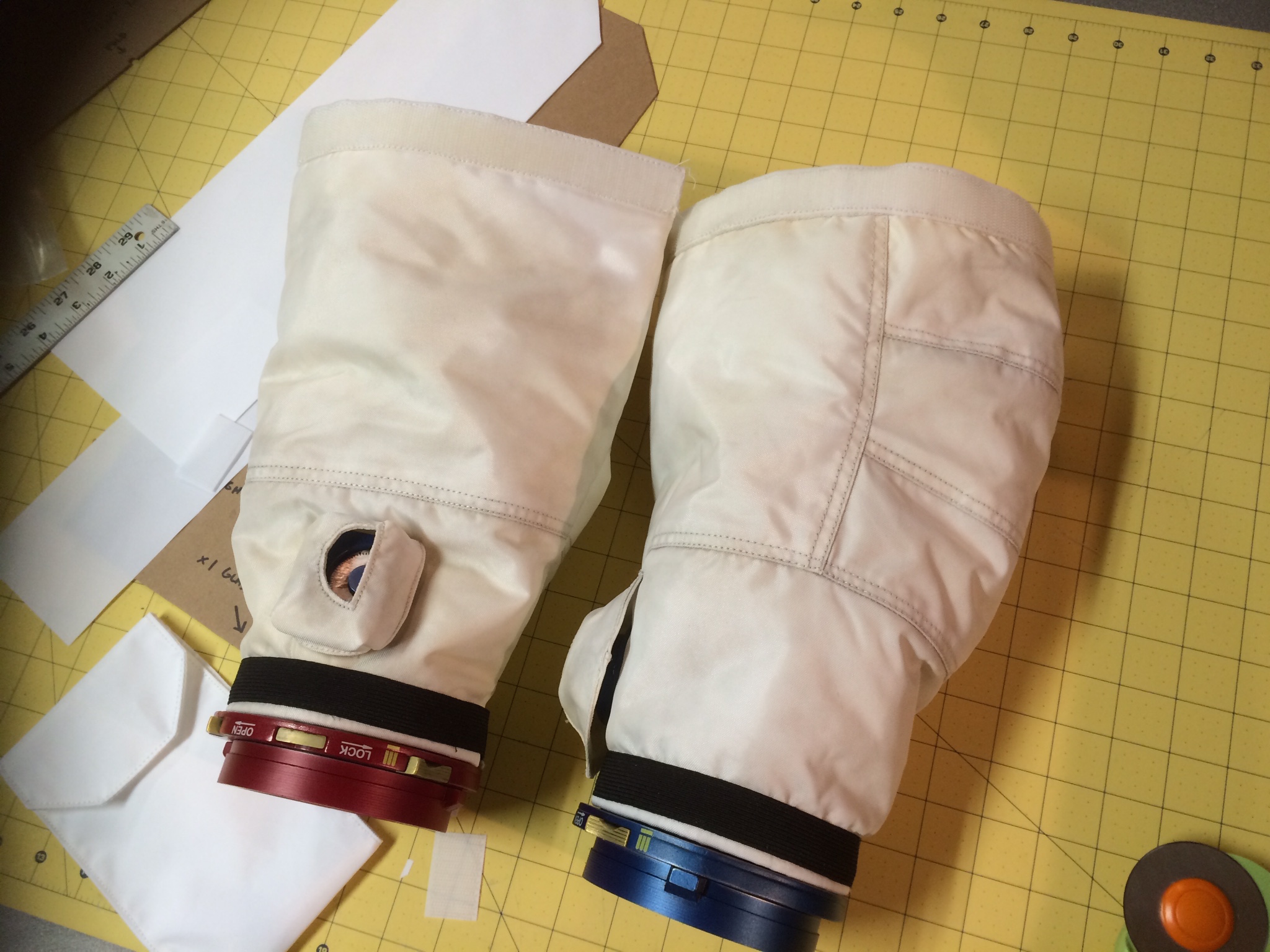

Since posting pictures of my prototype, I've gotten many requests from museums and private collectors to make Apollo (and Mercury) space suits. So I've been hard at work creating new, more accurate parts and patterns. I will also be making all of the EVA components of the suit (LEVA visor assembly, PLSS life support backpack, RCU chest controller, lunar boots and gloves).
I've switched over to a heavy duty nylon fabric and use nylon upholstery thread now, so the overall weight of suit looks like an industrial job. It's very nice. I'm also pre weathering each piece of fabric and each fitting so I can be more meticulous about it.

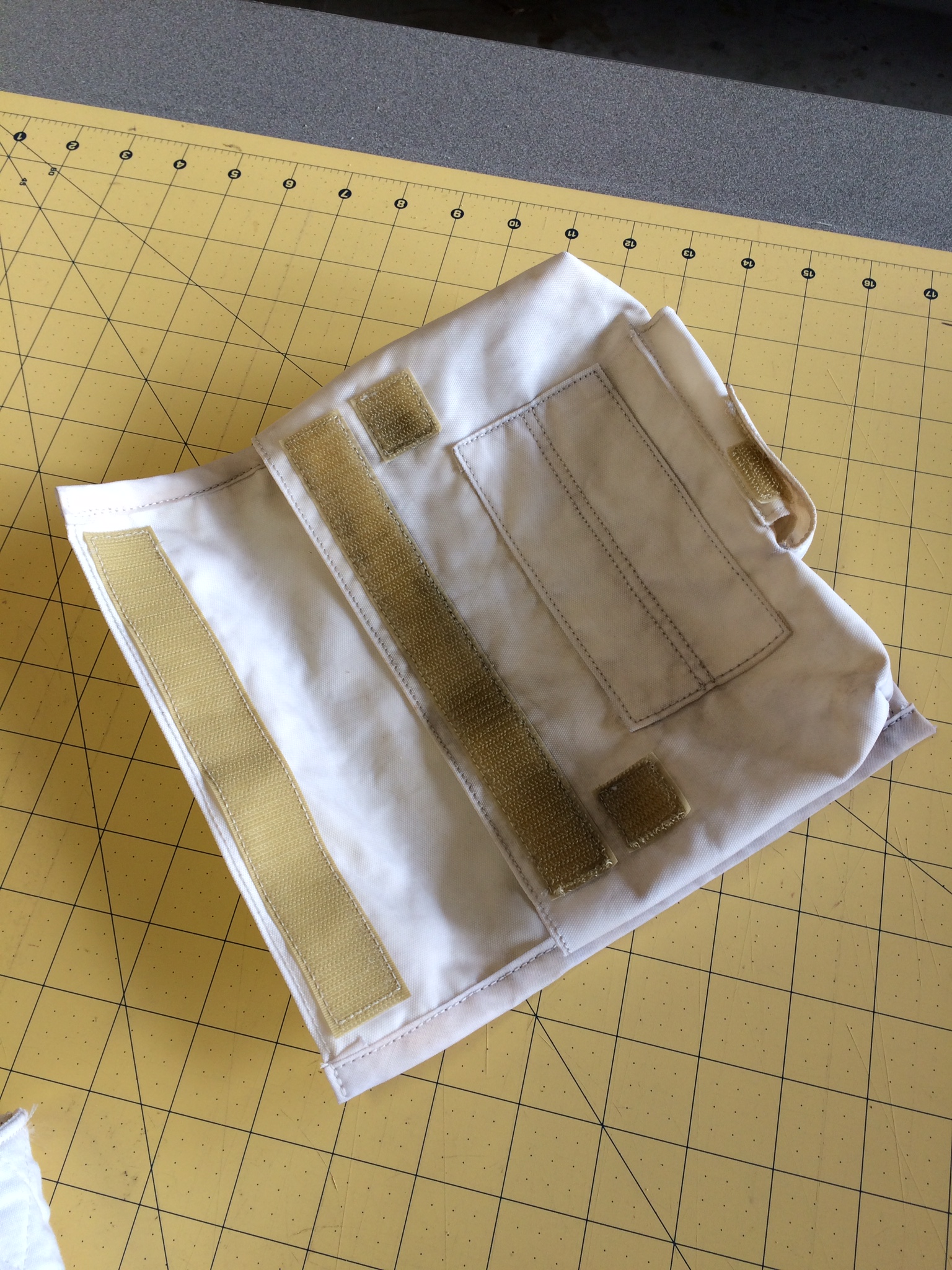

I've made adjustments to all my pattern pieces, so the new suit will be more accurate in terms of it's structure. I also finally found the correct velcro loop for the suit. The standard napped loop stuff was not the same type used on the Apollo space suit. It looks a lot different:

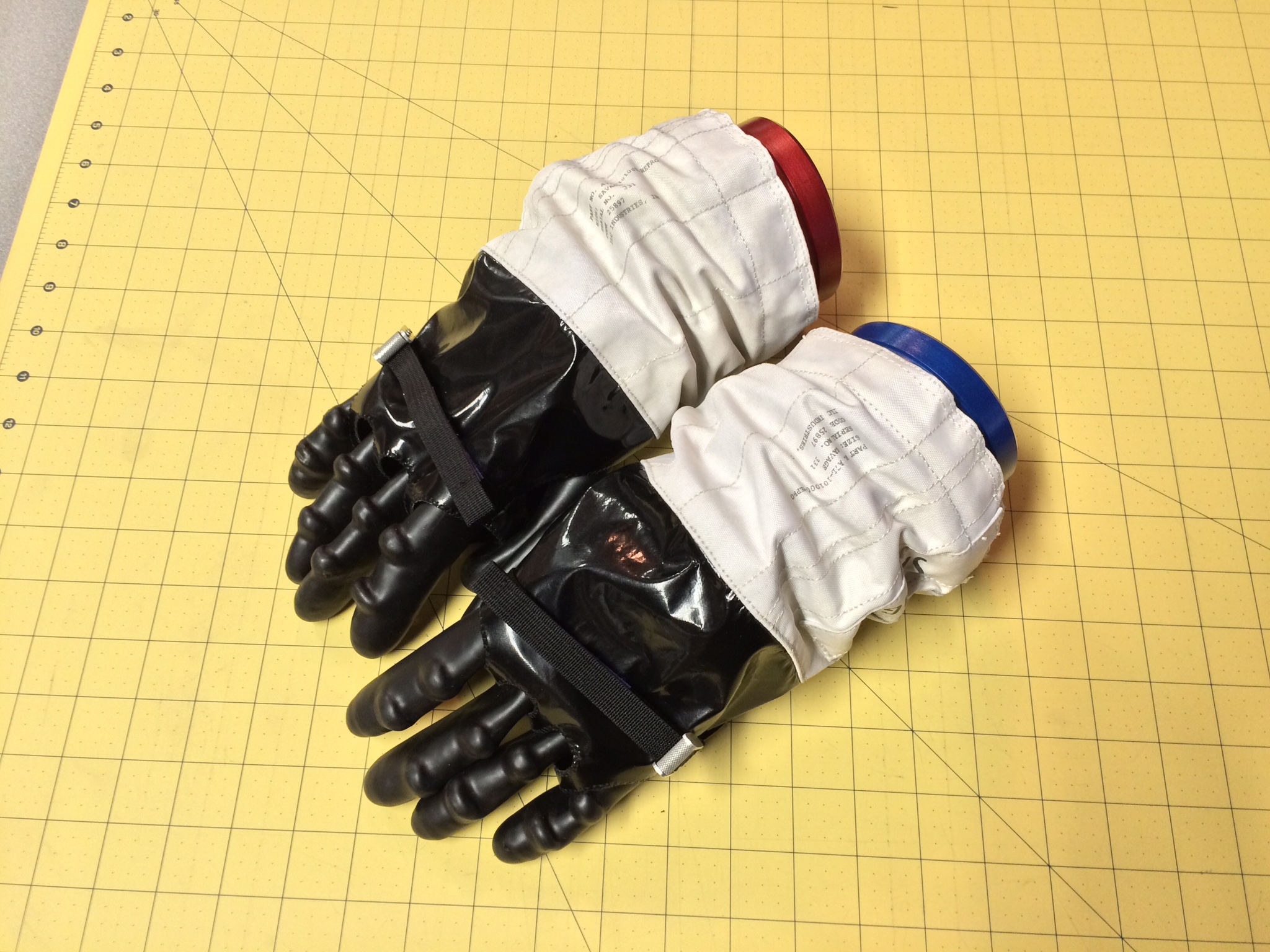

A small detail, but I also added the correct data stamp on top of the intravehicular gloves:
