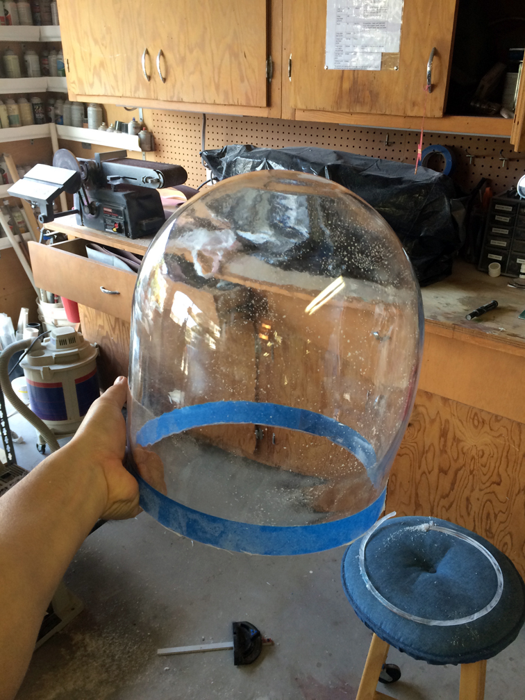

Unfortunately, I had to buy the whole thing, but I'm completely scrapping the helmet ring and back pad and fabricating my own. They aren't entirely accurate anyway. The bubble is pretty good (except for the extra height at the bottom).
How much did you spash out for the bubble helmet? The Spacetoys site has the helmet with ring for $750US. Were you able to purchase it much cheaper without fittings?

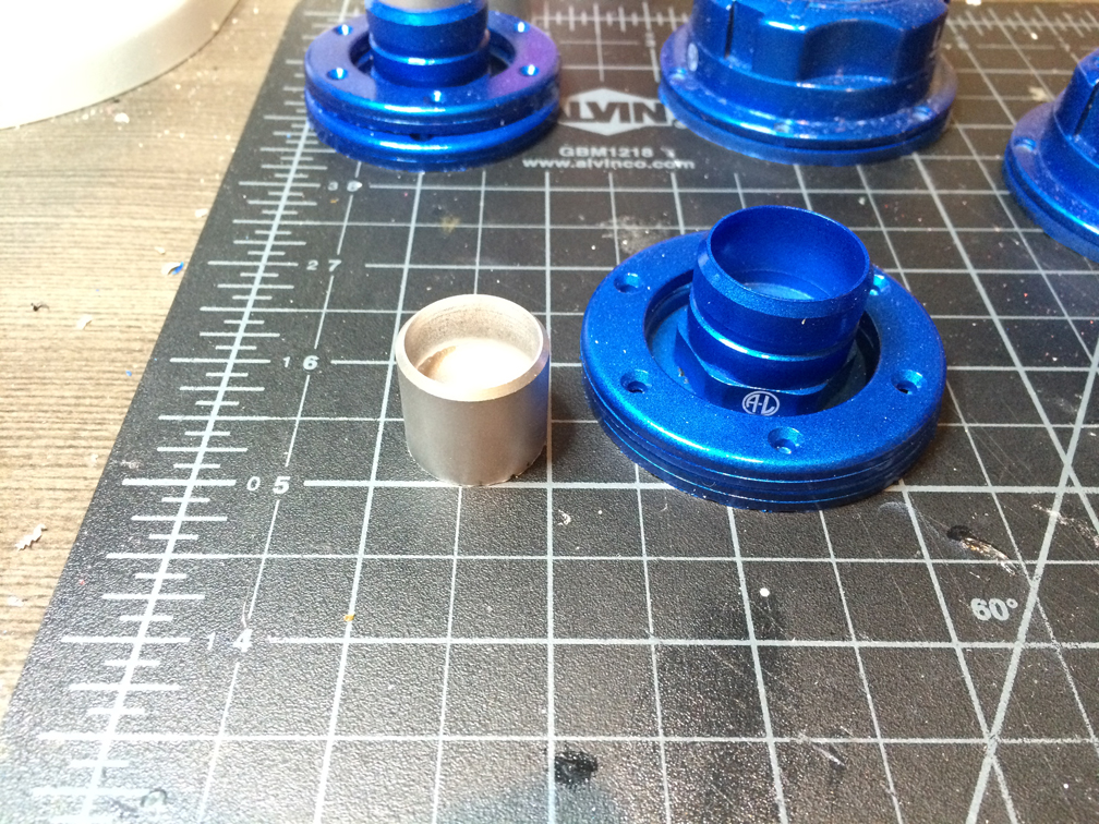

Not a huge update, but I did work on my space suit a little more. I'm doing all the hard parts of the suit first. Finally cut channels for the o-rings on the chest connectors. Made my own custom cutting tool for this.

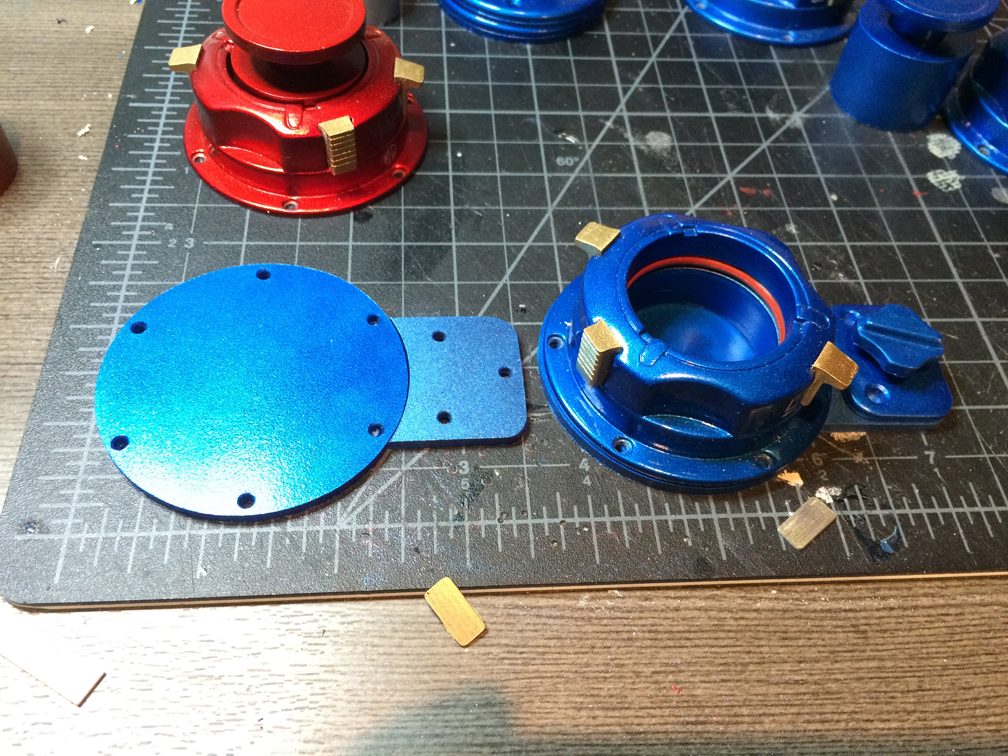

Made the electrical connector in three parts. The connector, the inner silver sleeve, and the retainer ring. I still have to make the insert with the matrix pins:
Also made a little back plate system so I can mount the connectors to the suit:

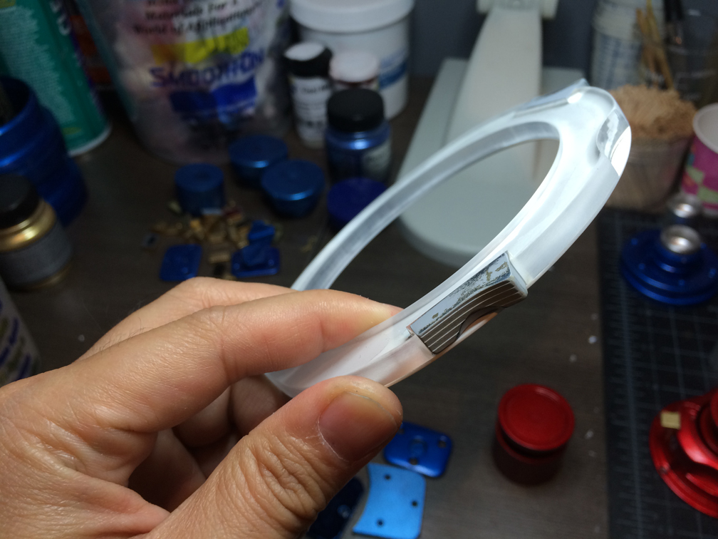

I started making the glove rings. They will connect with magnets (the little protrusion on the side of the ring is for a rare earth magnet). Not finished with these quite yet:

Your attention to detail is very impressive, most people wouldn't bother with the o rings. What material did you use for the wist connectors? Are the ones shown masters for casing or for your suit?

Ryan, Those gas connectors are shaping up very nicely! I'm going to look into that magnet technique. How much holding power will that have?

The wrist connectors are PVC and ABS pipes that I turned on a lathe to the correct dimensions. The wrist rings are router-cut acrylic. I cast them all up in resin. I brush metallic pigment into the mold so the metal finish is quite durable. I spray anodize paint color on top of that. So if they chip, the faux metal finish will be revealed underneath so they will weather realistically.

Thanks! Depending on the size, rare earth magnets can be VERY strong. I just installed the magnets inside the connectors that will serve the dual purpose of holding in the plugs, or holding in the tubes that connect to the portable air supply at launch, or the PLSS for EVA.

Update. Installed magnets in the wrist connectors and gas plugs.
They're fairly strong. I made some videos showing the mechanism and how it works. It should make it fairly easy to don the full costume when it's done.

Started working on the helmet. I cut the Space Toys helmet down about an inch or so because it was too tall. It's a more accurate height now and I made a new necking that will connect to mine:

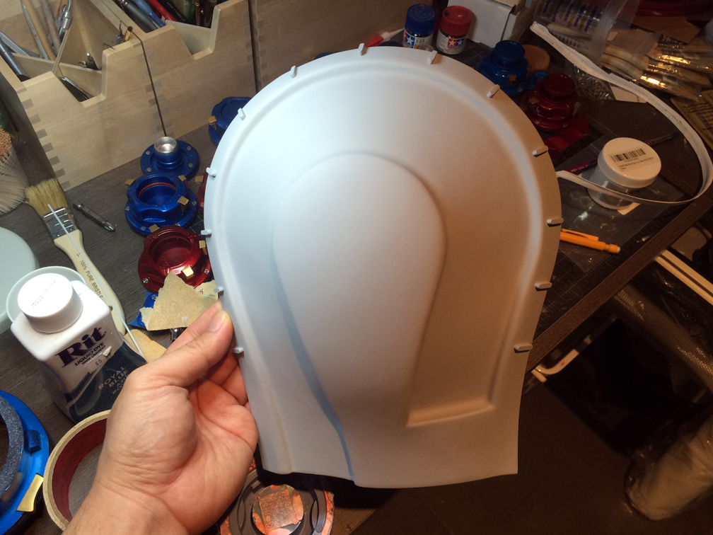

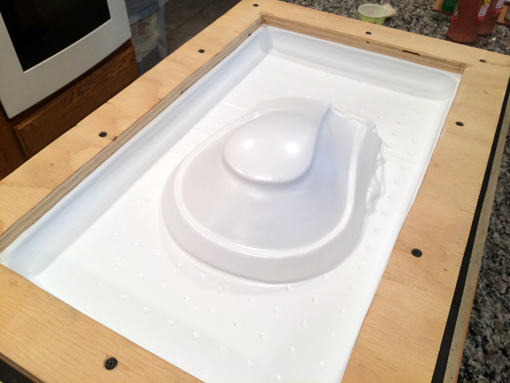

I'm working on the plate for the back pad. I vac-formed it and added the spacers that will allow the stream of air to disburse throughout the helmet:
