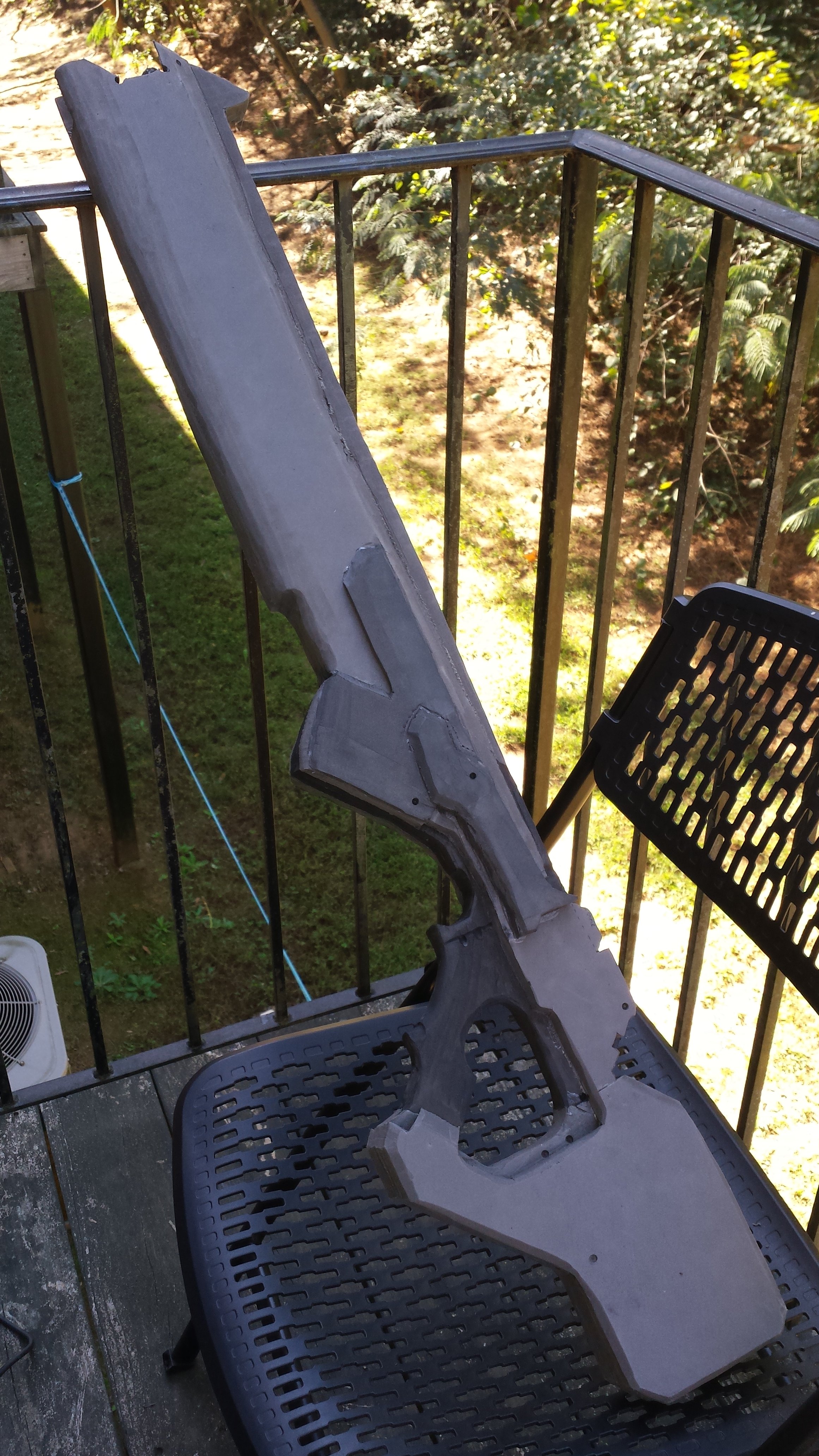

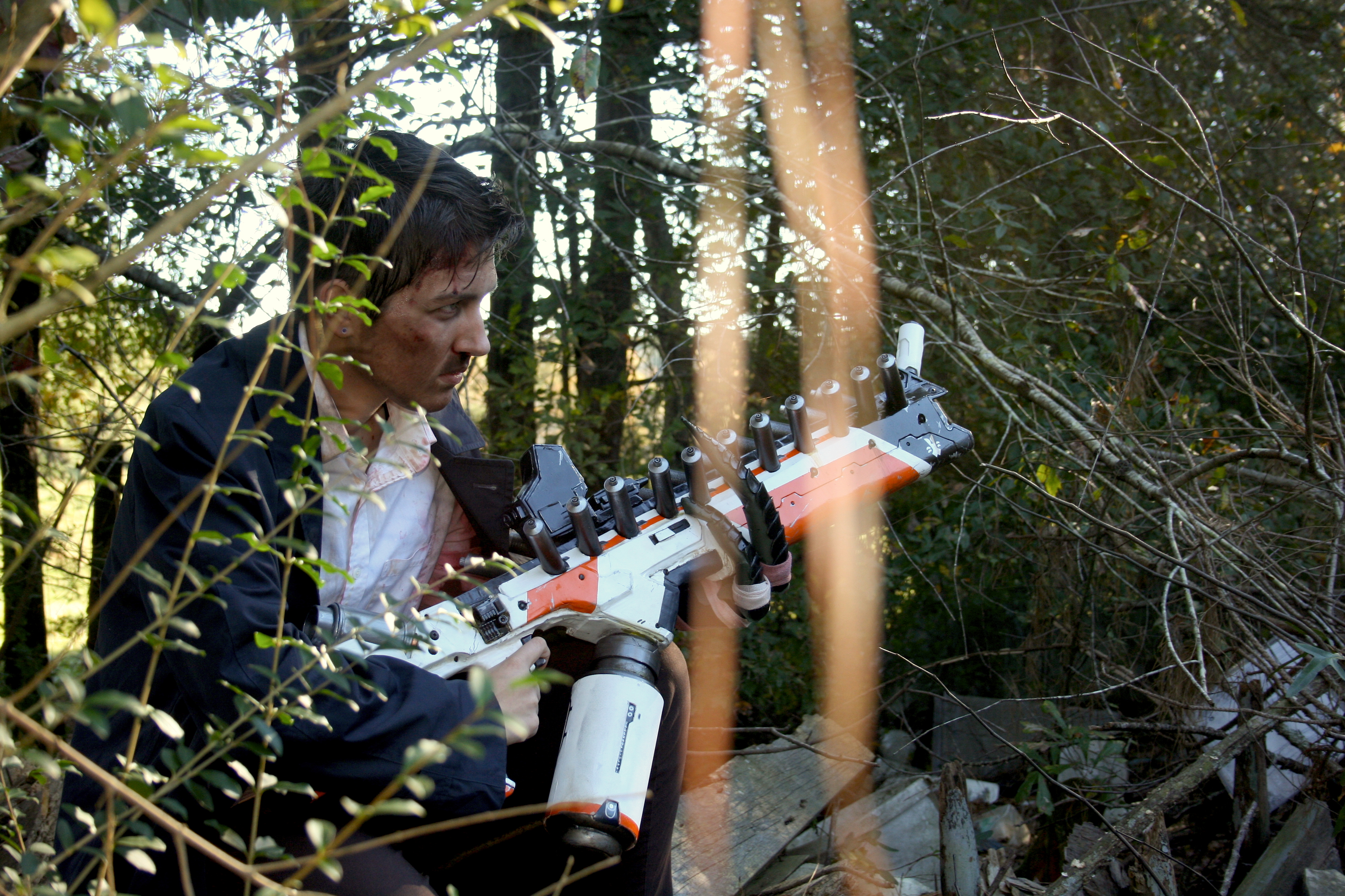

1. So basically, I projected some concept art onto the wall using the projector at the lab I work at. Traced it, made templates using some of the Uhaul paper I line my bird cages with, and started cutting leftover EVA donated from a fellow DragonCon-er. Do not use newsprint, it sucks. Use card stock like everyone tells you to. Also, pinning the template with sewing pins is really helpful, but still sucks with newsprint.
2. I used a generic brand contact cement to adhere all the pieces. I did this in one prematurely cold afternoon. I used hot glue for small details which turned out to be a major mistake.
3. I "borrowed" my dad's Dremel to sand the heck outta the thing. There are a lot of rounded edges and being terrible at cutting (always have been), I elected to Dremel most of the edges down rather than bevel. The small amount of beveling I did pretty much butchered some parts, so...for future project, bevel the pieces before gluing them on. Why was the hot glue a disaster? Well, common sense or not, I figured the Dremel would sand the glue before it'd get melt from the friction, but I was wrong. It melts instantaneously when you put a Dremel sander to hot glued pieces. Destroyed several tips before I figured out what was going on.
4. I did a LOT of research -- days of it -- before deciding on Mod Podge to be my gap-filler. Probably about 8 layers. Time-consuming, but since I don't need flexibility in a gun, it worked really well. I used a tape technique to fix some goofs. Worked well in small doses, but large amounts of tape buckles and wrinkles. I recommend tape for small boo-boos, but not large areas.
5. Ah the ever-useful Plasti-Dip. I went a little crazy and figured, THE MORE THE MERRIER, and did about 8 layers of this. It took 3 days because I found it put a much better coat when a. it wasn't cold and dewy outside, and b. the previous coat really had a good chance to set up. In future projects I may do even more coats, because there were still areas that weren't metal-smooth enough for me. I really didn't see a downside to piling on the Plasti-Dip for this project.
6. I normally don't prime things. I'm super lazy. But for this I slapped my wrist and said, "just do it, it can't hurt you." I have no idea if it helped, but I'd rather be safe than sorry. I feel like it helped stiffen it up and I didn't have to use so much spray paint because it didn't soak in or set unevenly.

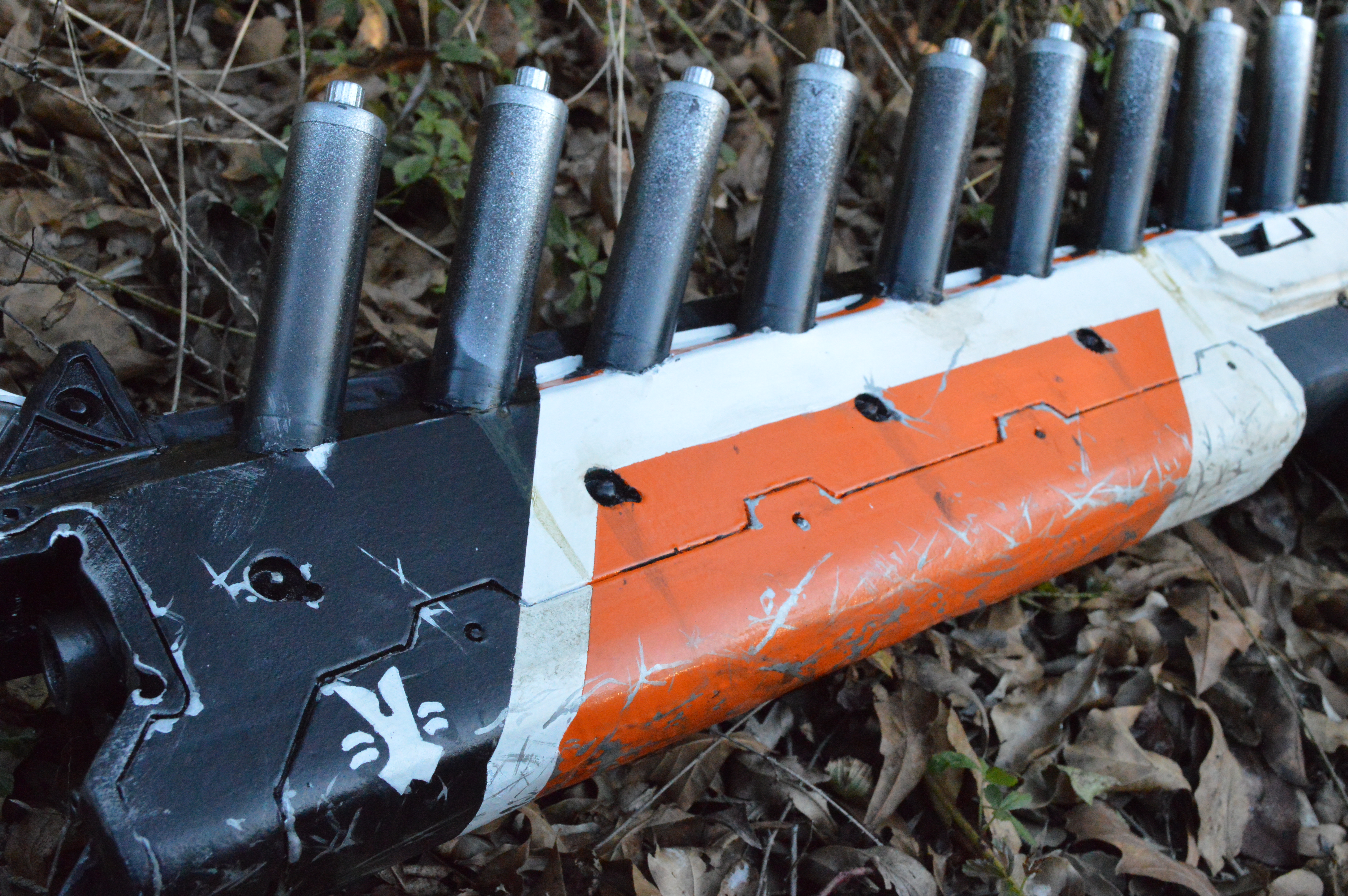

7. I did a bunch of test paints on Nerf guns sitting around the house. Finally I chose my paints (spray paint from Home Depot): semi-gloss white, black, and gloss orange.
8. Found Objects for the canisters. I used a Nalgene, a PVC glue can, PVC pipe, bottle caps, and syringes to make the various doodads. Paint before attaching. I hate doing that because I'm so eager to see it put together, but really, you just have to, ugh. I didn't glue some of the pieces in real tight because I have a friend who may be helping me 3D print the exact pieces to give it that extra finish.
9. Weathering and such was done in a few hours with some regular acrylic paint. It was 2 days before Halloween and I wanted it done! Sadly, I know I could have done better, but I'll just have to up my game on the next go around.

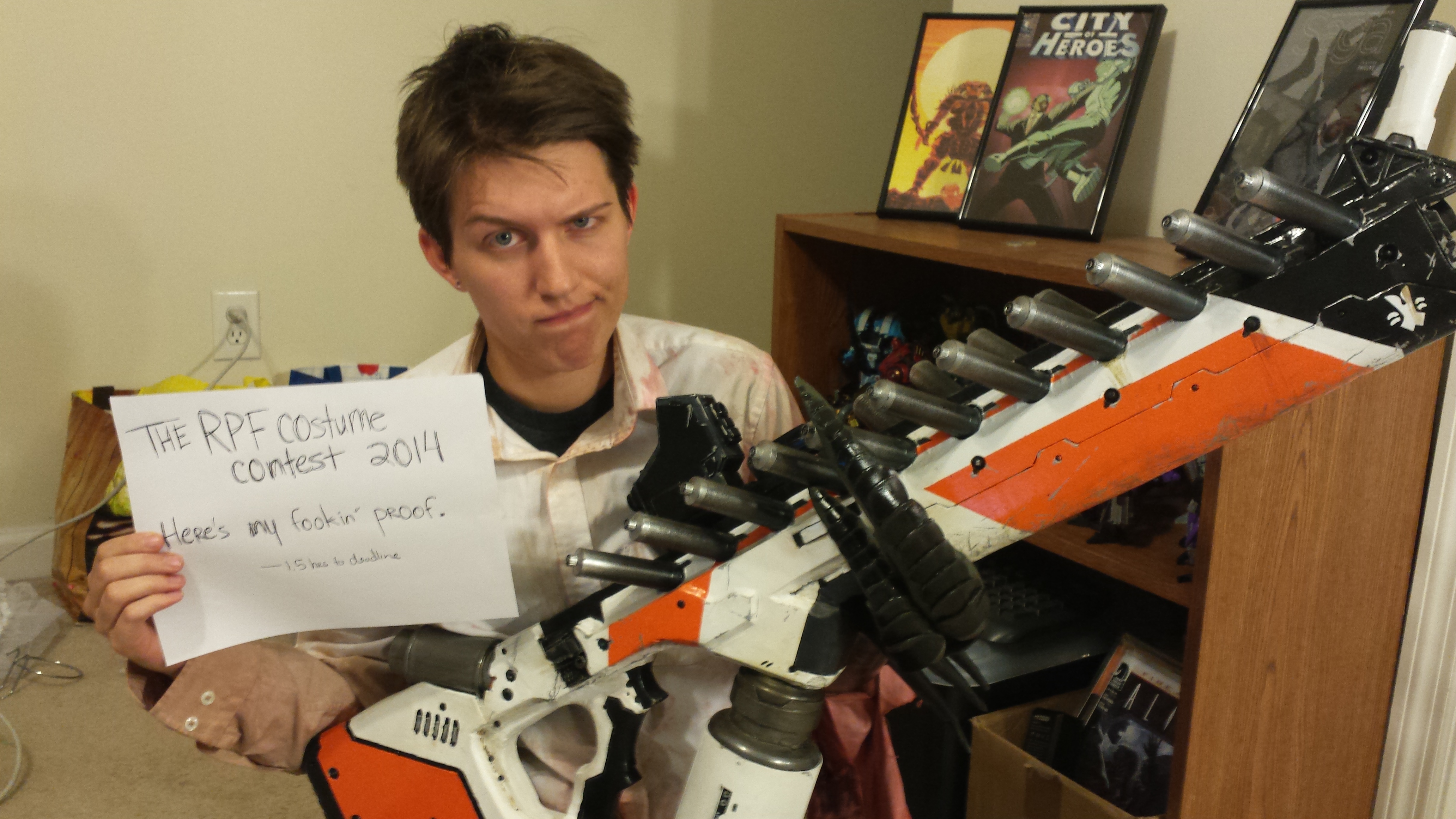

Oh, and apparently we need proof, so if the above isn't enough, I threw on my costume for a quick photo. I didn't have 2 hours to do the make-up, I am sorry :(
