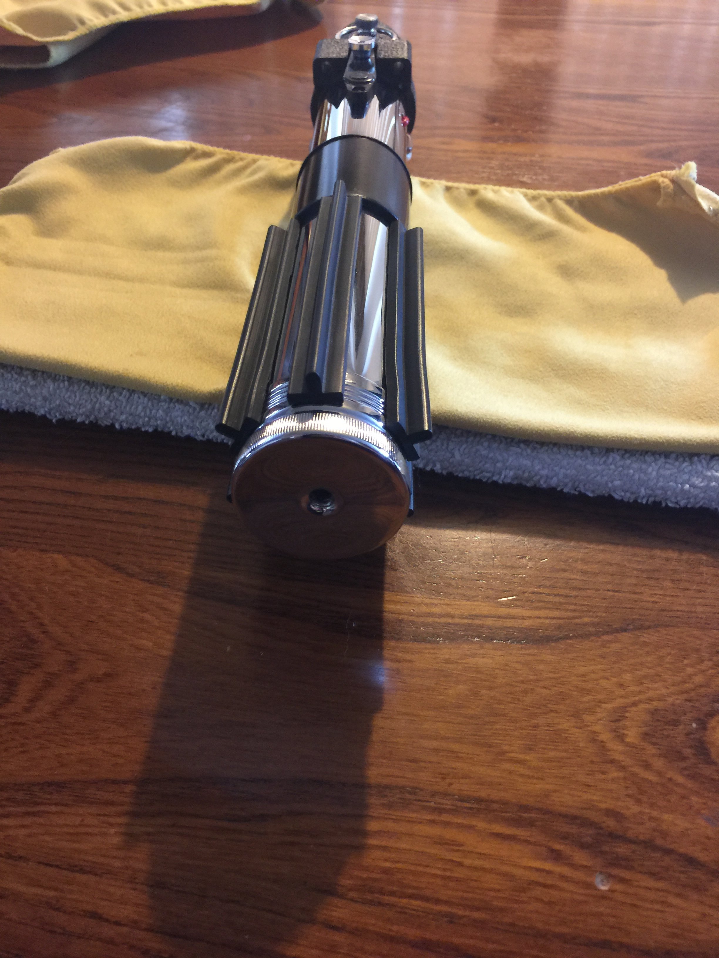

Hello everyone. I've known of this forum for a really long time, but only recently joined. First off, I have to say that there is a wealth of knowledge here. It's nice to know that so my people share a passion for the same movies I have loved all my life. Enough to collect "pieces of history" (or their closest approximation). It's even better to know that people have the skill to help the rest of us acquire those things. With that out of the way, I thought I might be able to add something that may help someone.

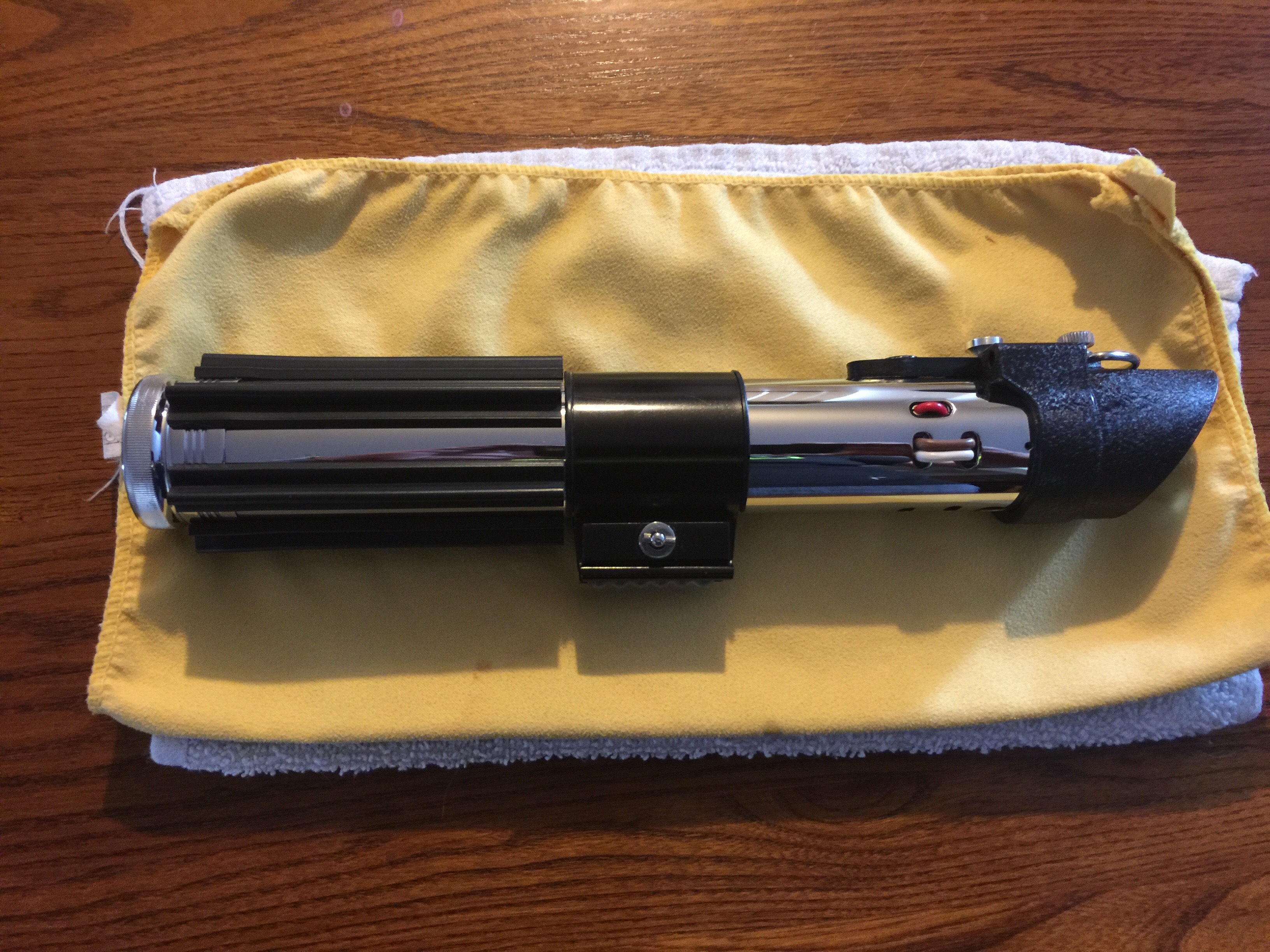

This is a picture of my Heiland Sychronar converted into a Vader ANH lightsaber. It is put together with a combination of 2 kits. One from YodaHouse and one from EDC Studios. The only part I truely liked for EDC Studios was the shroud (although I may replace it with Roy's).
The flash was in poor condition when I purchased it on eBay about 15 years ago. I found a company online and had it replated. I polished the sidebars as YodaHouse's came dull and had a "brushed" look. As for the hole on the bottom. I dug through a pile of scraps in my house and found a piece of thin sheet metal / tin. I cut a small square piece and epoxied it to the bulb socket. The bulb socket it slightly flattened and can accommodate it. I then sanded the piece of metal with 3000 grit "spongy" sandpaper and handpolished it with Meguiar's metal polish paste. I was pleased with the result. I hope that this helps someone or even gives someone an idea to improve upon it.

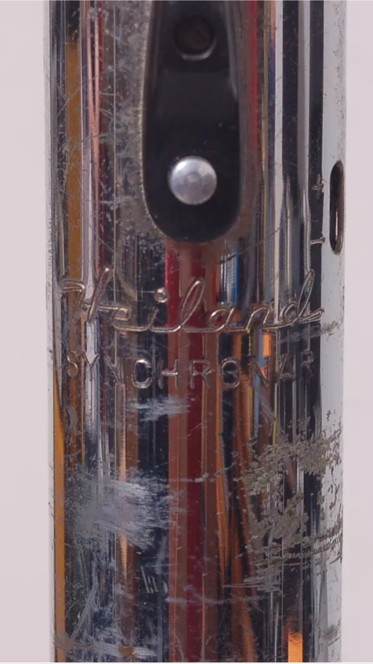

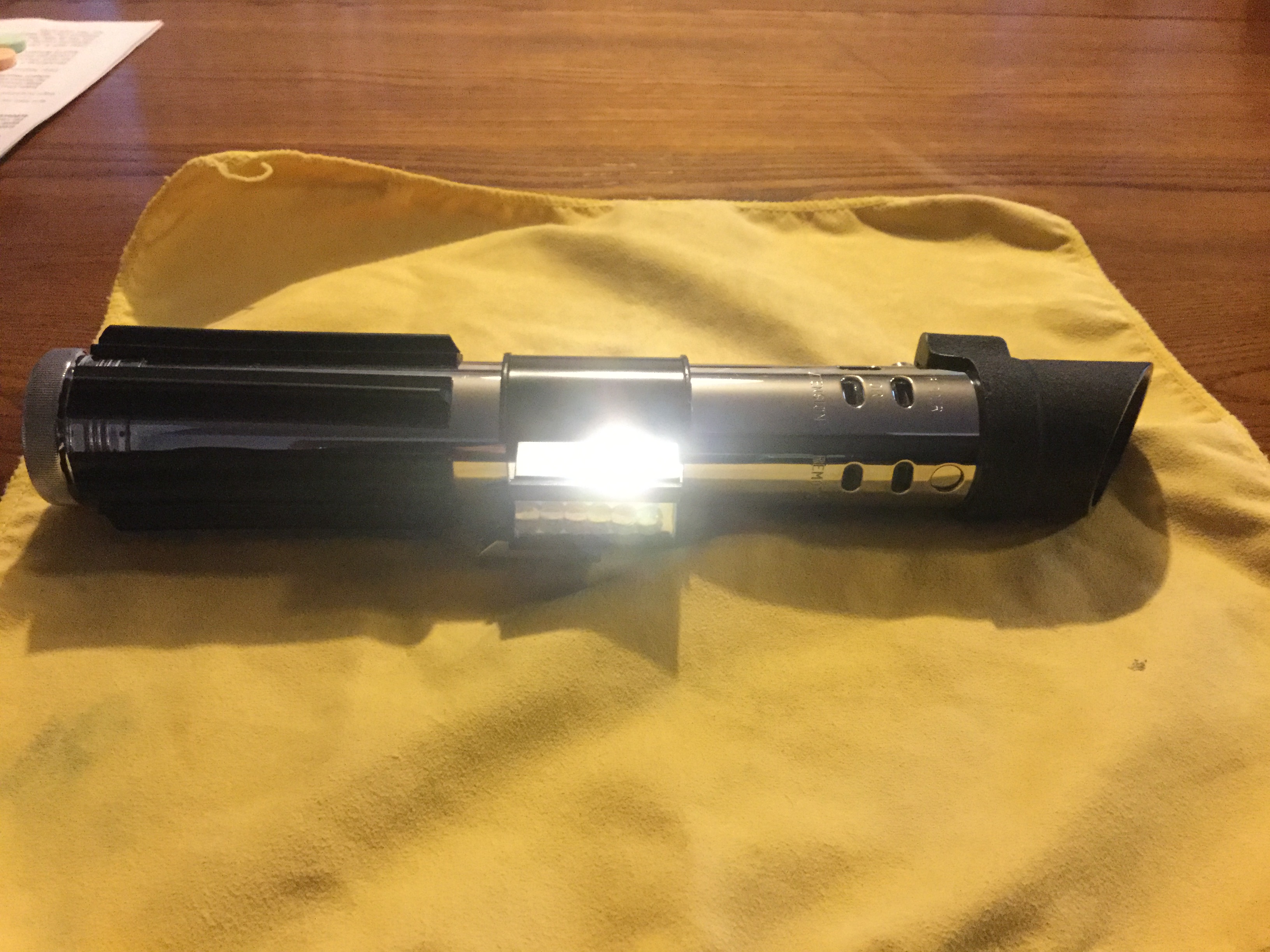

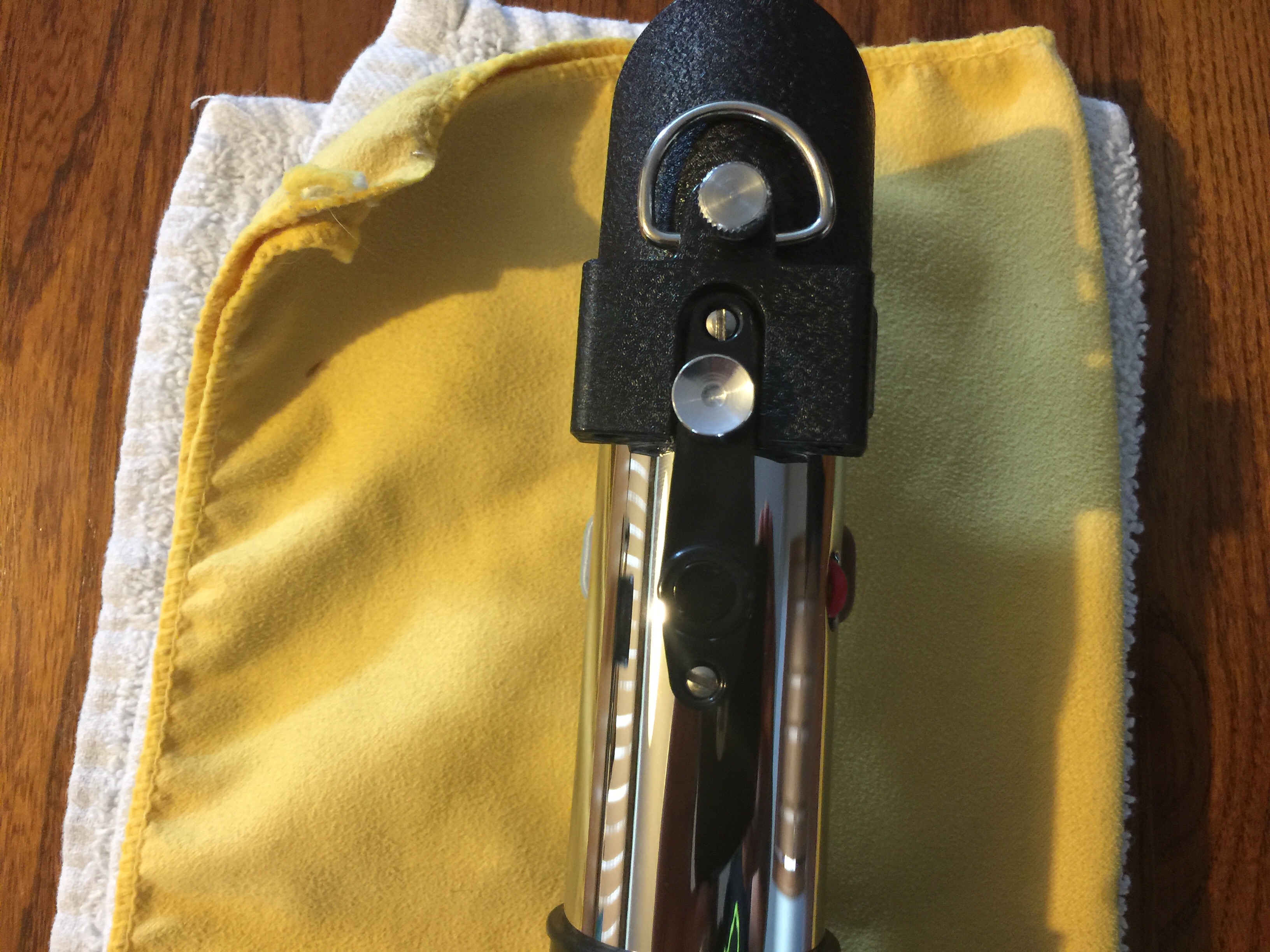

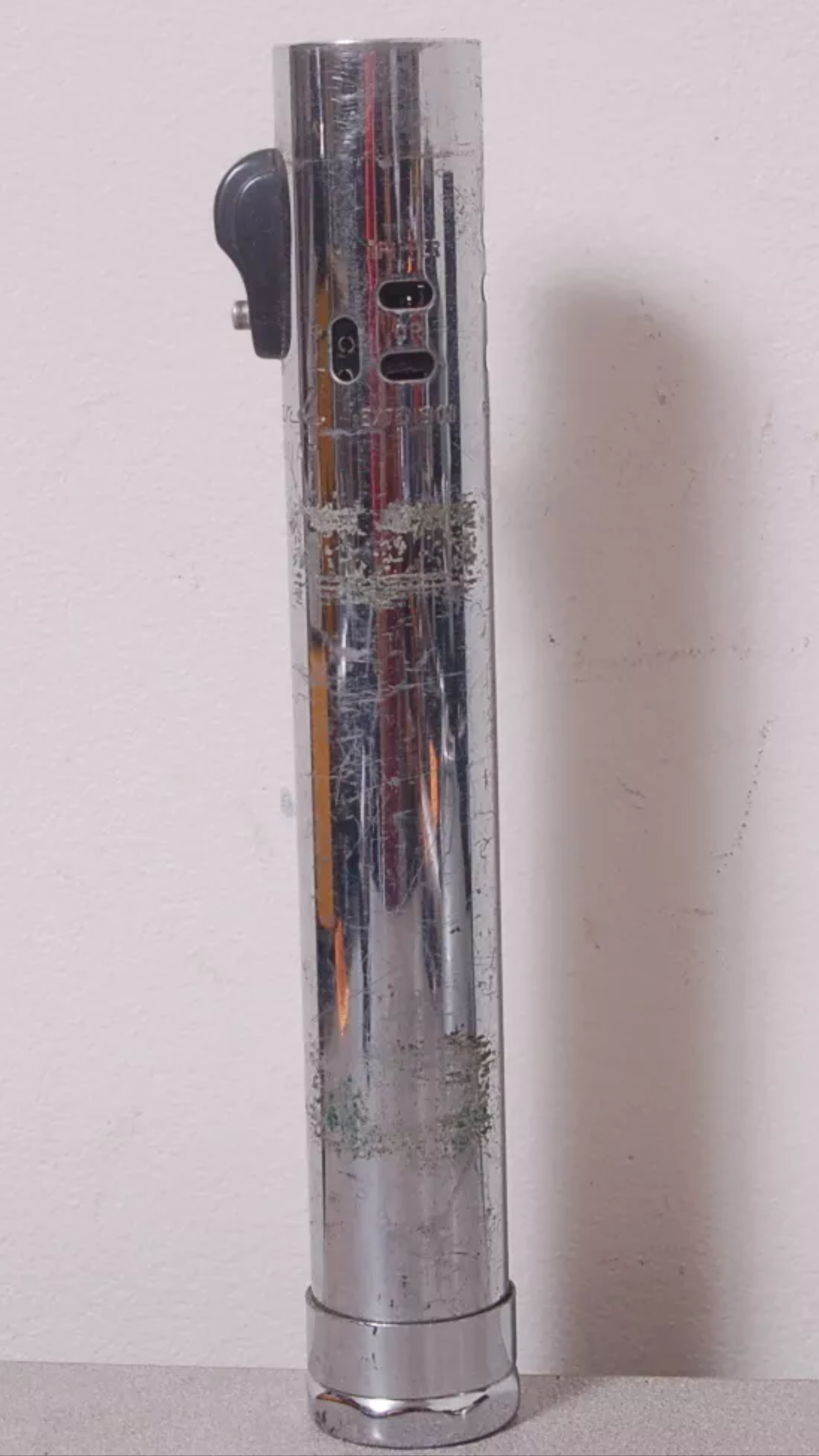

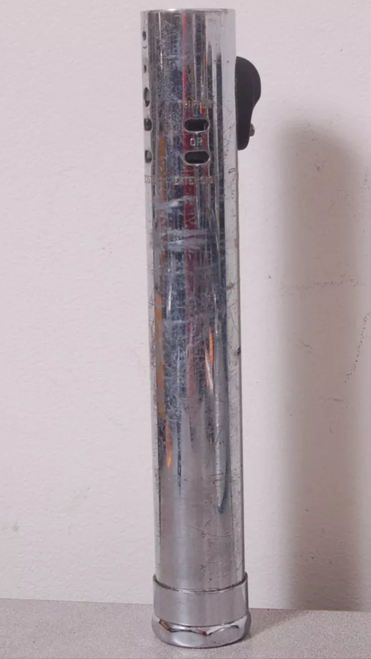

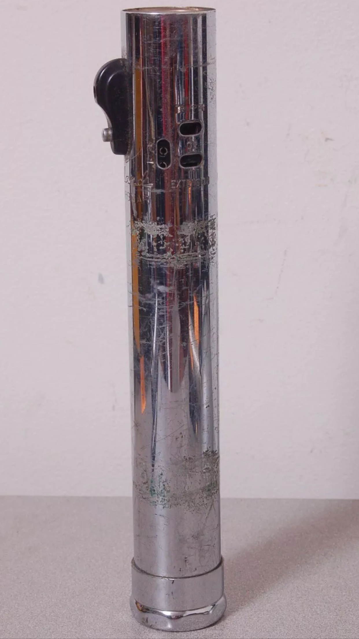

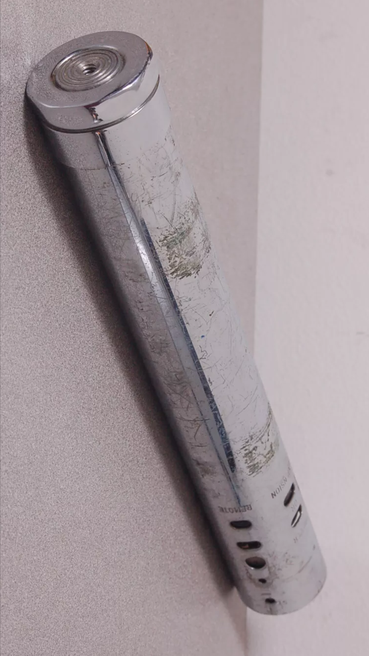

I posted earlier in the thread regarding the hole in the Heiland Synchronar flash. I want to post again to show you another lightsaber that I just finished. My Vader ESB lightsaber. I used a Heiland Synchronar flash, however, I used a different Heiland end cap then what came with it. I that I felt it worked better. A Yodahouse / Blastech clamp, bulb release and grips were used (had them for years and couldn't see scrapping them). The clamp lever was modified. The lever was removed. The roll pin was used in lieu of a small nail. The end of the lever bolt was ground down to a "roundish" shape. It was the sanded and polished. Roygilsing's shroud and wire set were also used. Fantastic shroud sir. The Heiland flash was sent to a replating company. All the Heiland script markings were removed and it was rechromed. This company did a fantastic job. I thought I would share some pictures.
Before:
After:
I guess I didn't mention and I've seen it discussed a lot. I used the adhesive strips found in a package of 3M Command Strips. The clear ones, not the white foamy style. I take some denatured alcohol and wipe my flash tubes (Graflex and Heiland) lightly with it. It does a nice job of removing residue that can interfere with the adhesive bond and they stick very well.

Really nice job above. Looks great. The new finish is very impressive.
Congrats.
