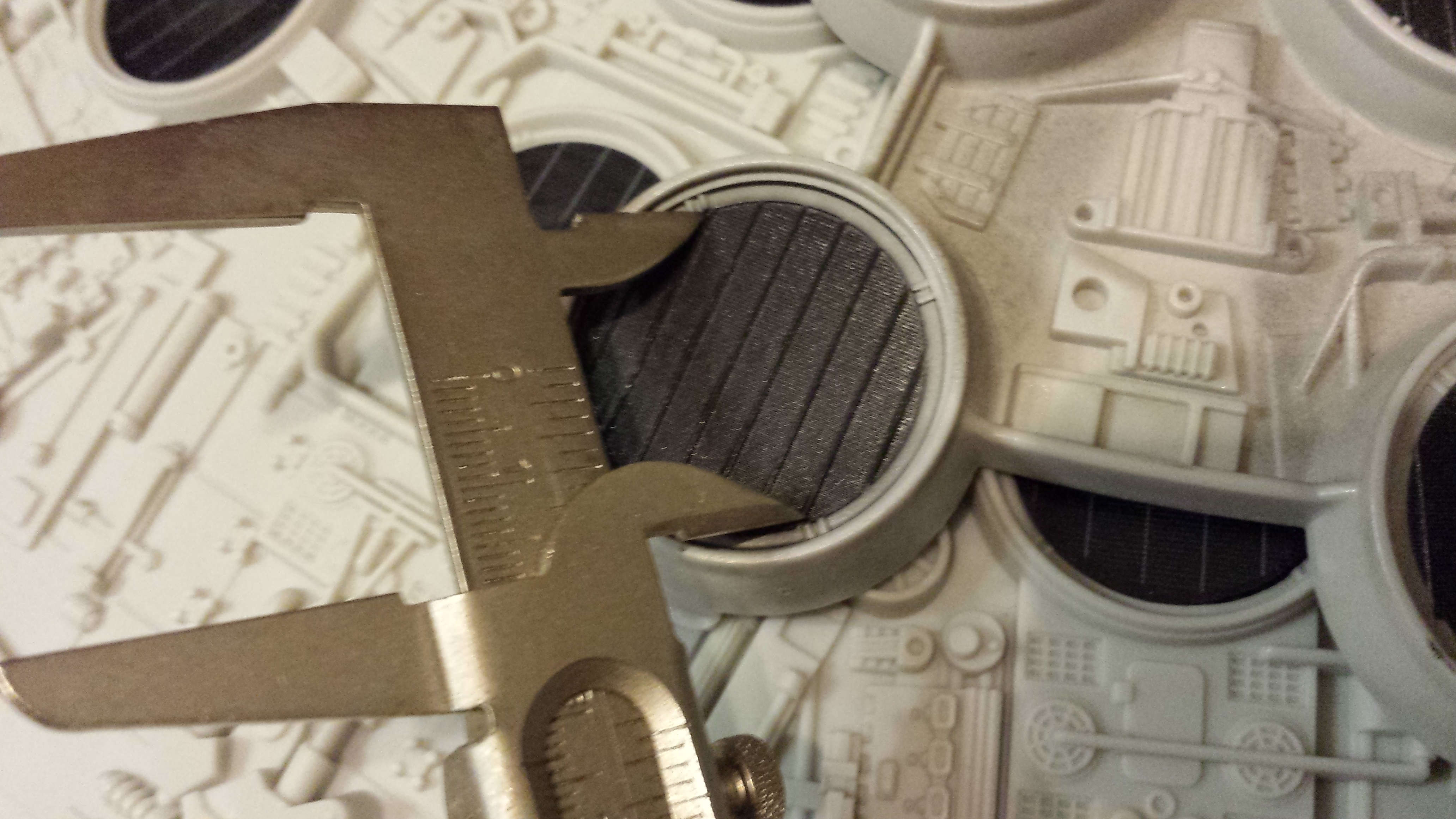

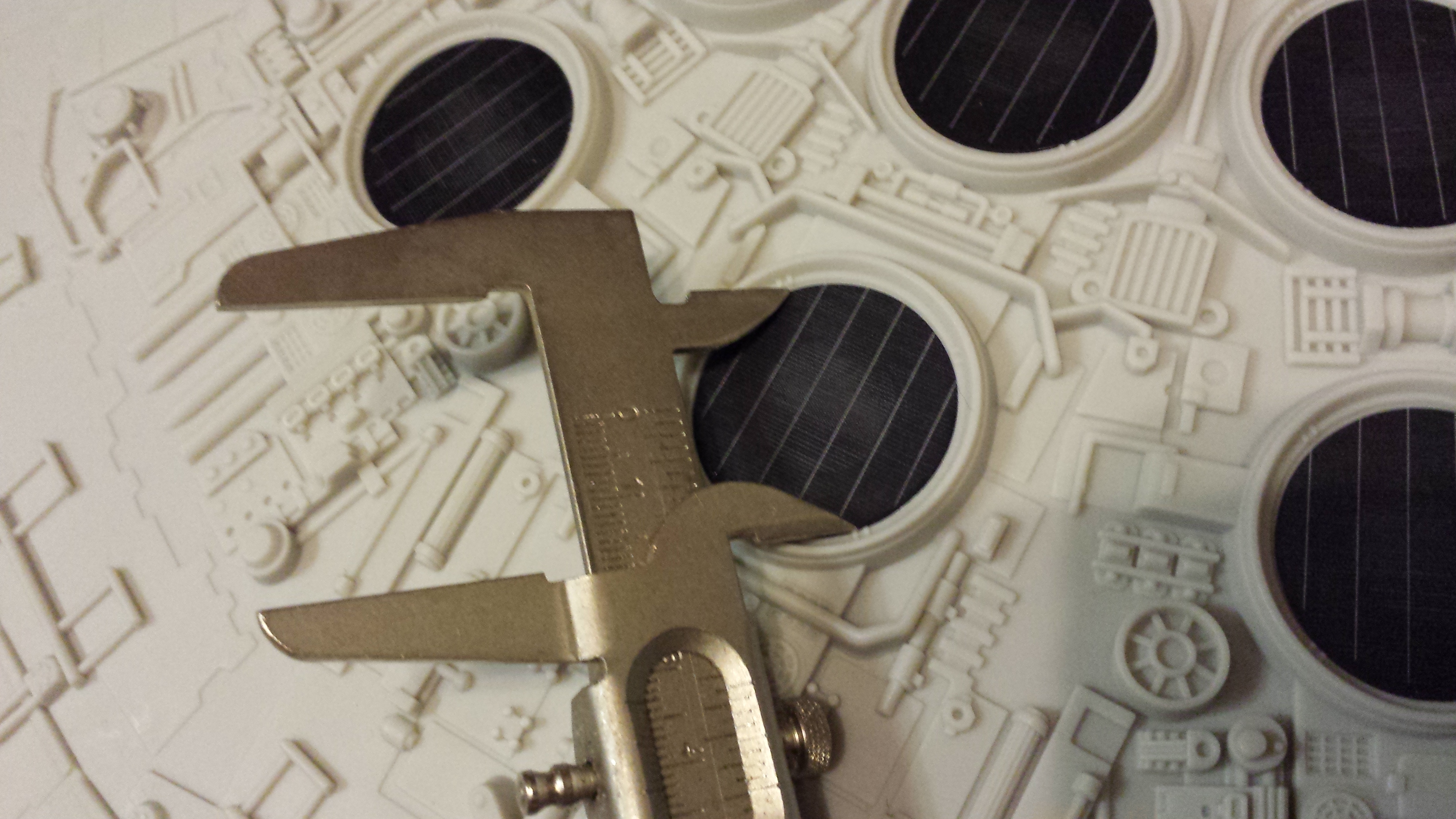

Another option you could go is using the vents from the Legacy BMF battery cover. They are both 33mm from comparison measurements. I picked one up from eBay and plan on using the dremmel to cut them out. I guess you could cast the centre part; the battery cover koolshade detailing is quite crisp :)

Looks like the 1:72 Dragon and Airfix Shermans (MK1, crab, and with LCM variations) are all promising. Airfix is definitely the cheaper option to go but the Dragon kits are always moulded superbly.
Kinda answered my own question but just throwing the info out for anyone who's interested!!
