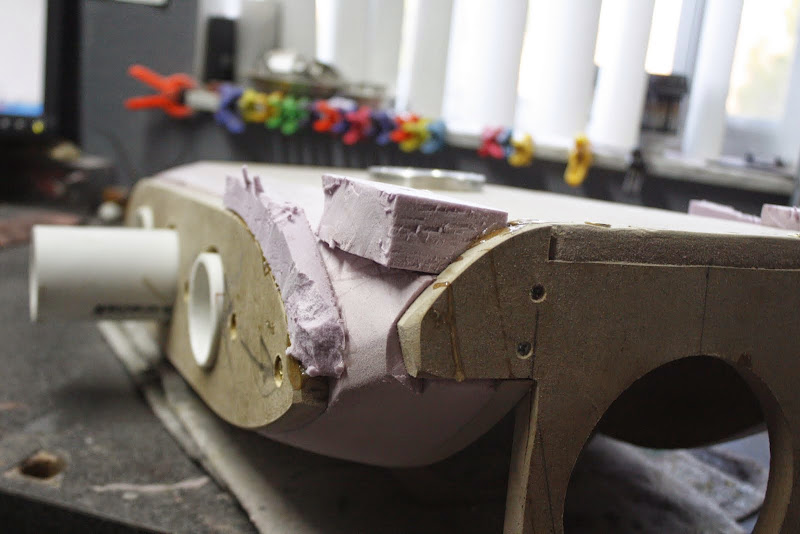

Had a few foam spots to fill,
Sanded with 80 grit on a sanding block for basic shape, we will get finer later, righ now i'm only interested in basic form
Installed two tubes to begin the internals for the rear section, cut to length and screwed in place, with a spacer cut and dry fit on the very back
Added some more foam fill-ins on the rear
Marked,
And cut the forward bulk head
Marked, cut and boxed off the rear section of the forward bulk head
Main body ready for epoxy resin sealer layer
Painted with a layer of resin and left to dry for 24 hours
Marked and cut 1/8 thick styrene to position as key blend/ transition points
Boxed in the forward neck section with 1/8" styrene sheet
Started to box in the rear section
Front,
Bondo'ed up ready to sand
Gunna let it dry real good and then give her a bit of a sand
