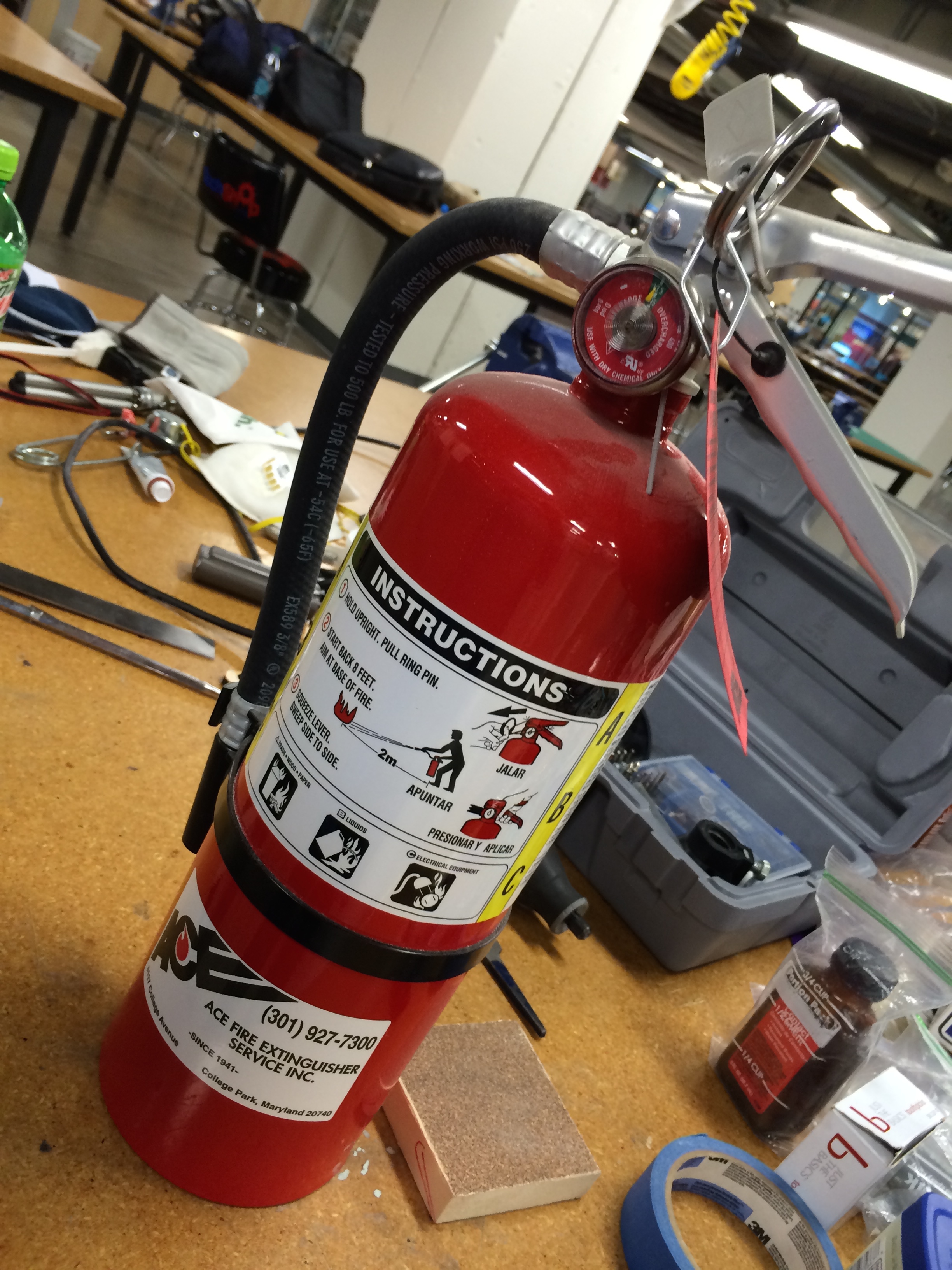

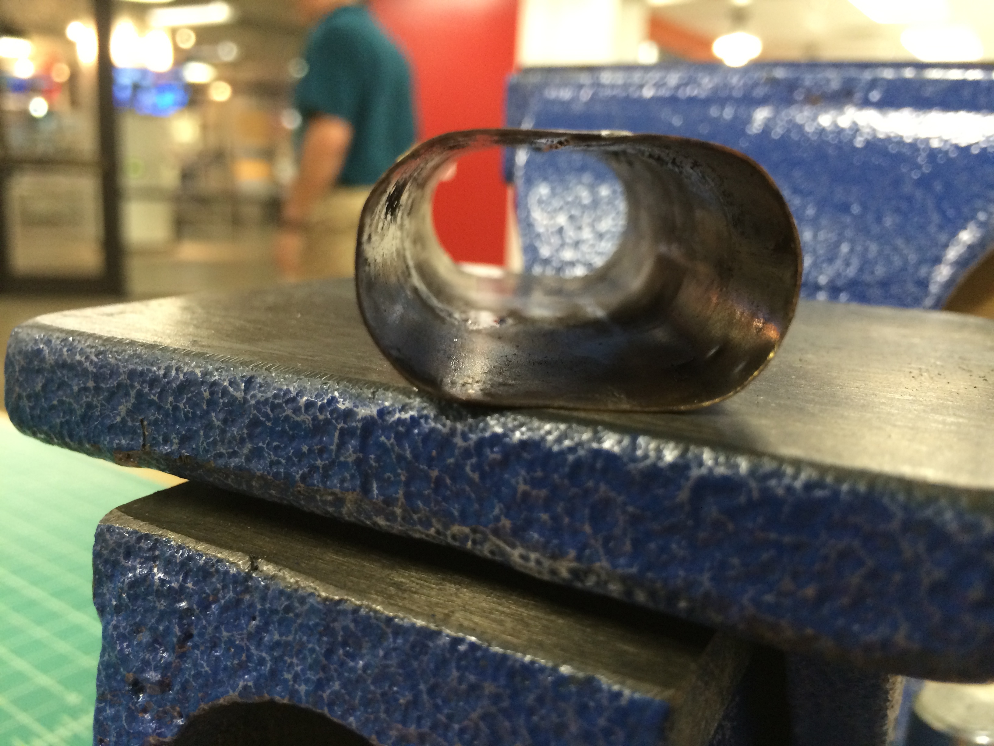

I decided I'd better anneal the brass after all, or I'd be working on this past Christmas. As I explained above, annealing just means heating it and cooling it to take the fight out of the metal. After I brought one of these over to my bench...
...I got down to it. I made this little 30-second video to show how it's done:
How to Anneal Your Phaser Handle - YouTube
Yes, I know how tempting it is now to turn this thread into a discussion of my use of symbolism and montage vs. Sergei Eisenstein​'s, but we've got a job to do! :p

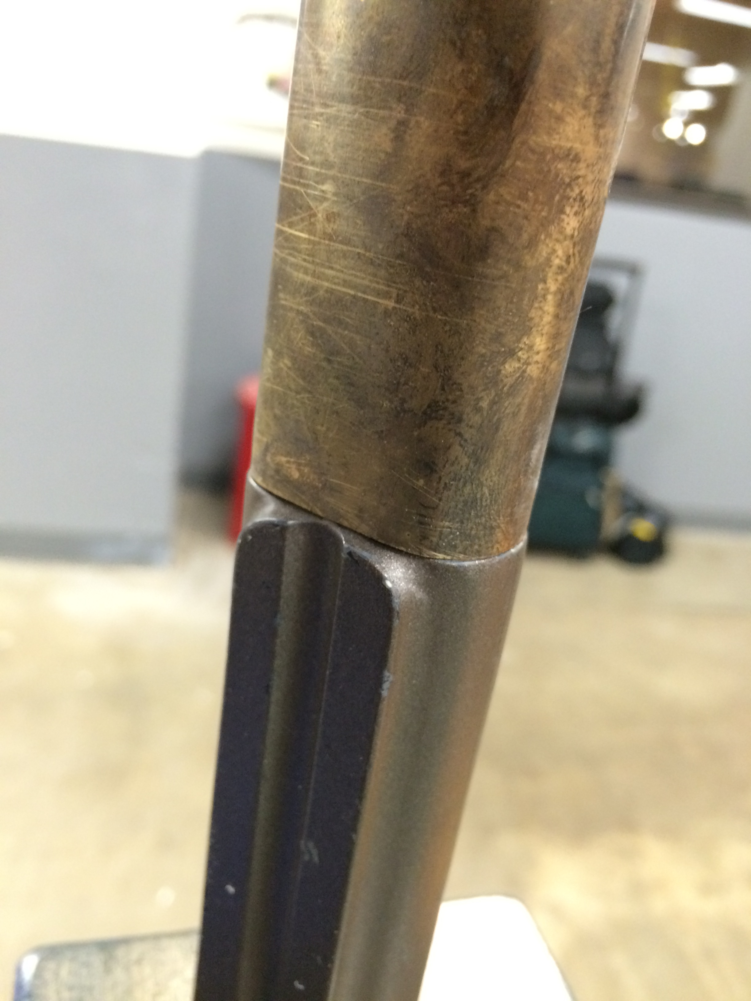

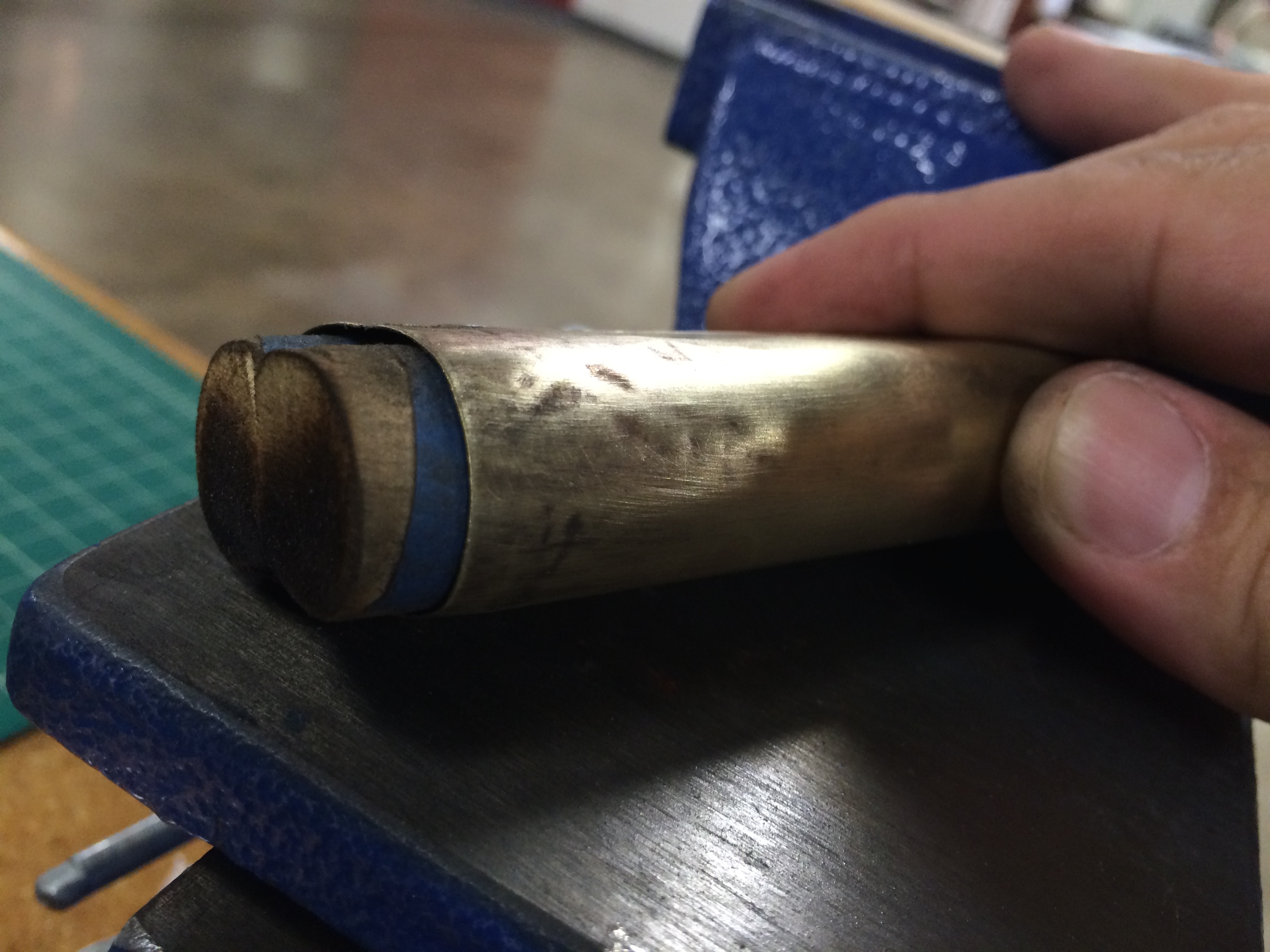

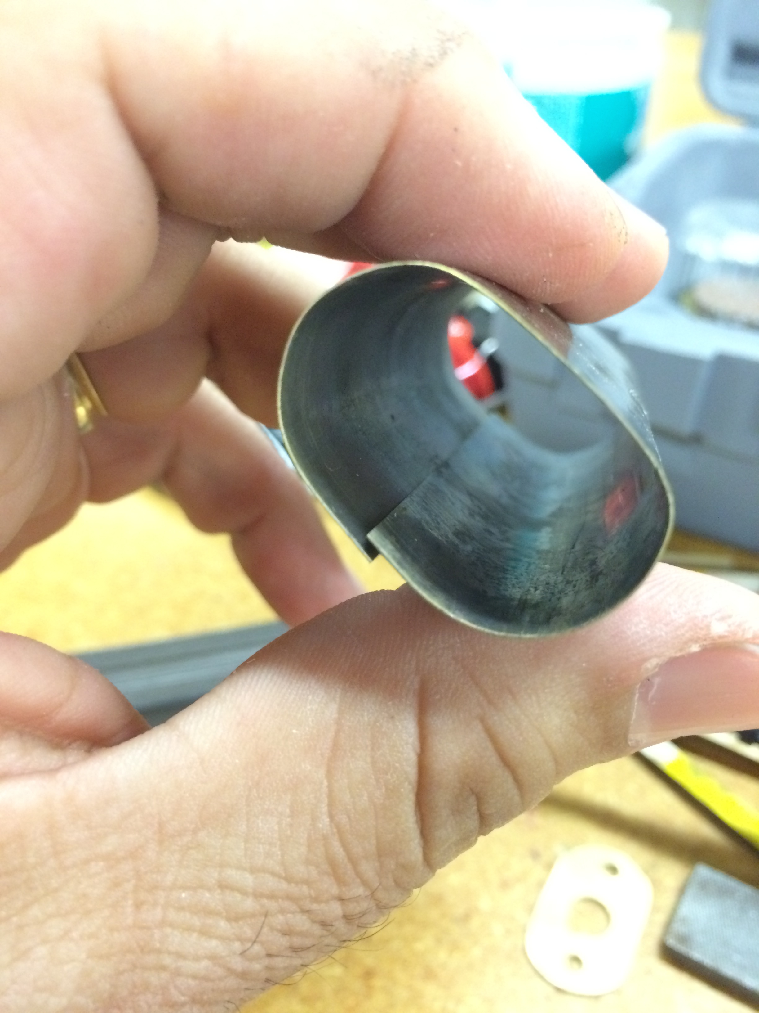

After I annealed the brass, I wrapped it tightly around the form again and gave it a good, long squeeze in the bench vise.
And it came out great, and ready for soldering at last! The annealed brass was no longer springy at all and conformed perfectly to the wooden form.
See how there's still a wee bit of overlap? Not enough to cause a problem. It helped out in the soldering process, though next time around I'll be going for a straight-up butt joint. That's not how you usually smoke those, but hey, new century, right? :p

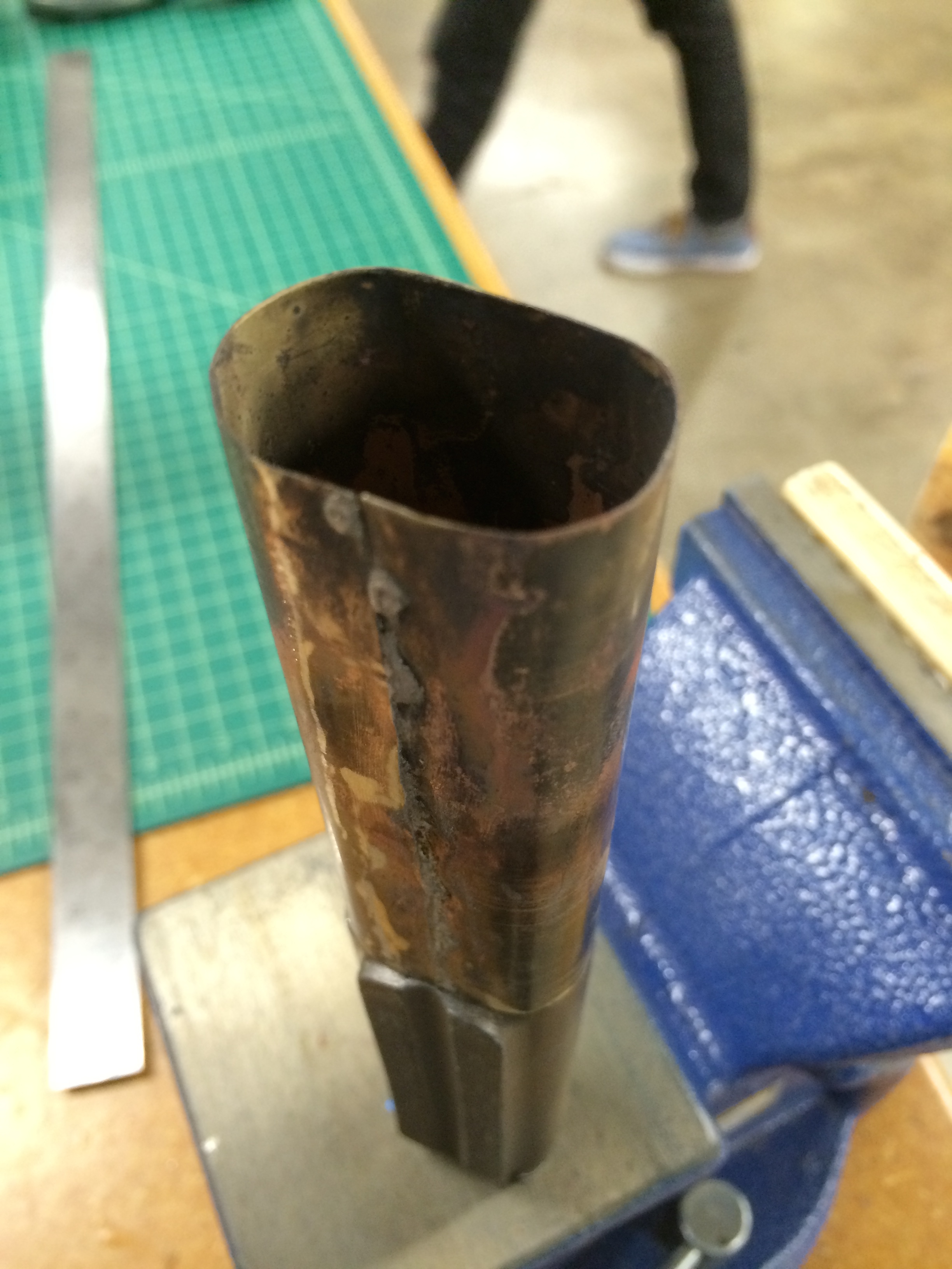

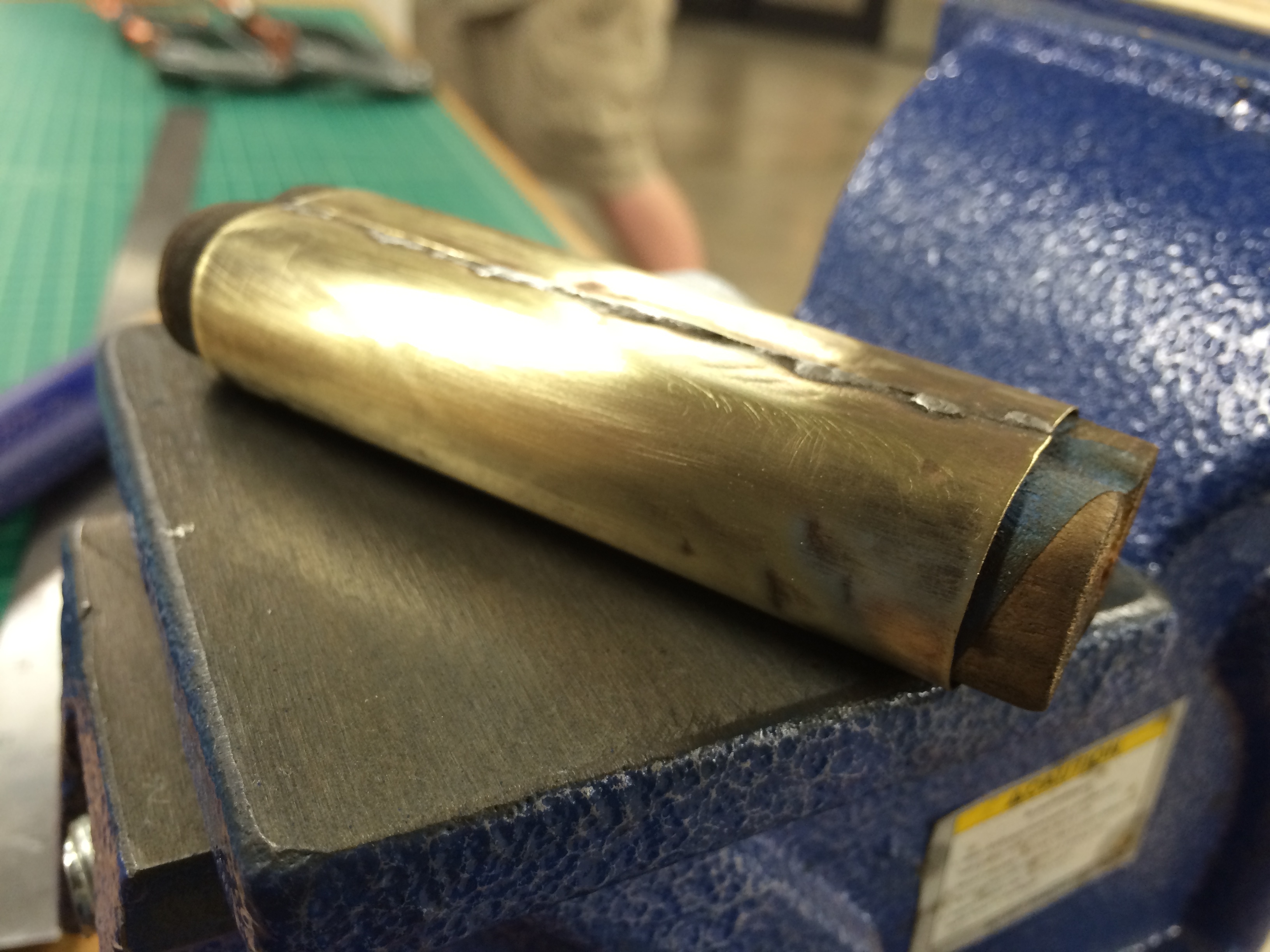

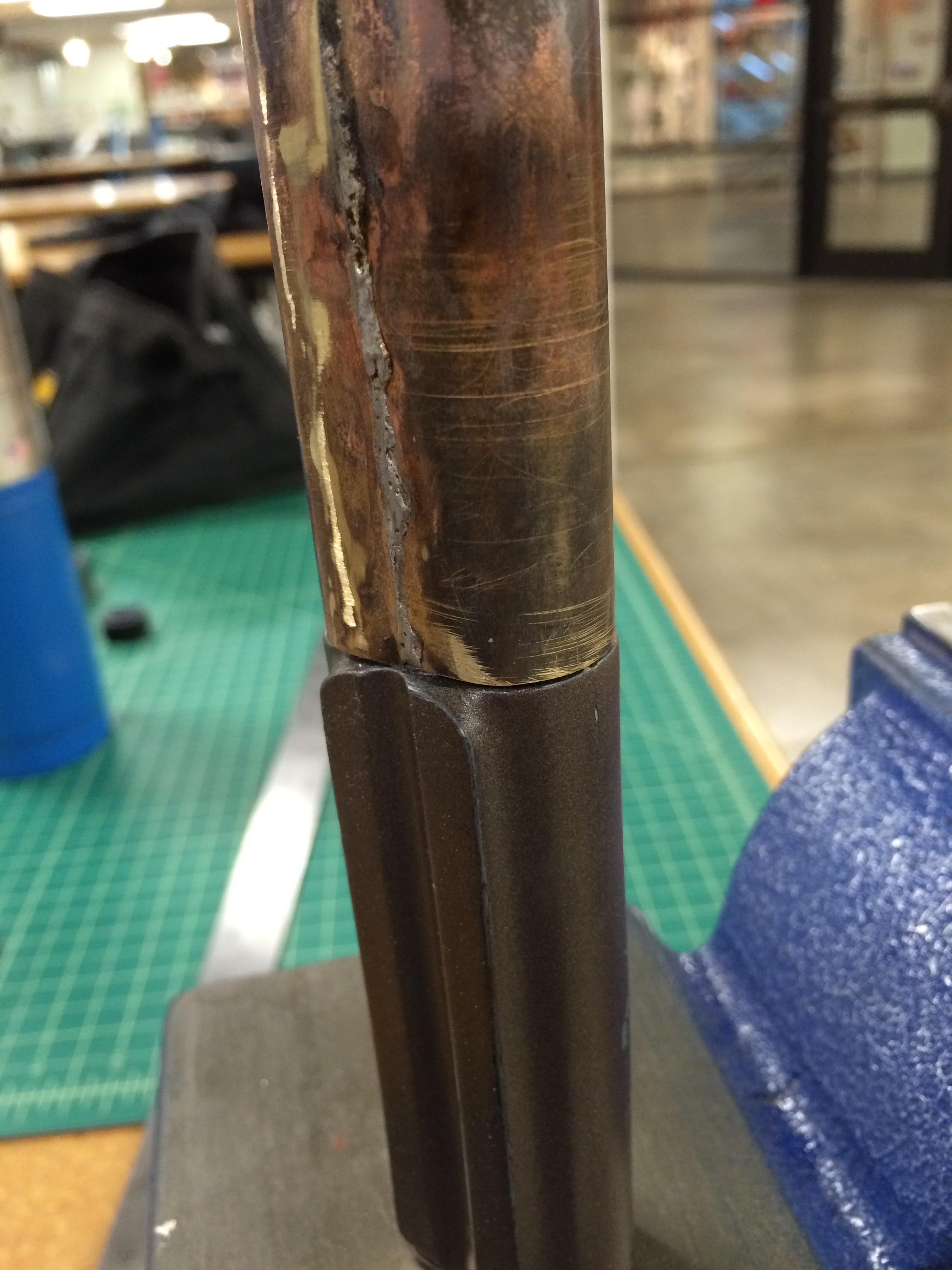

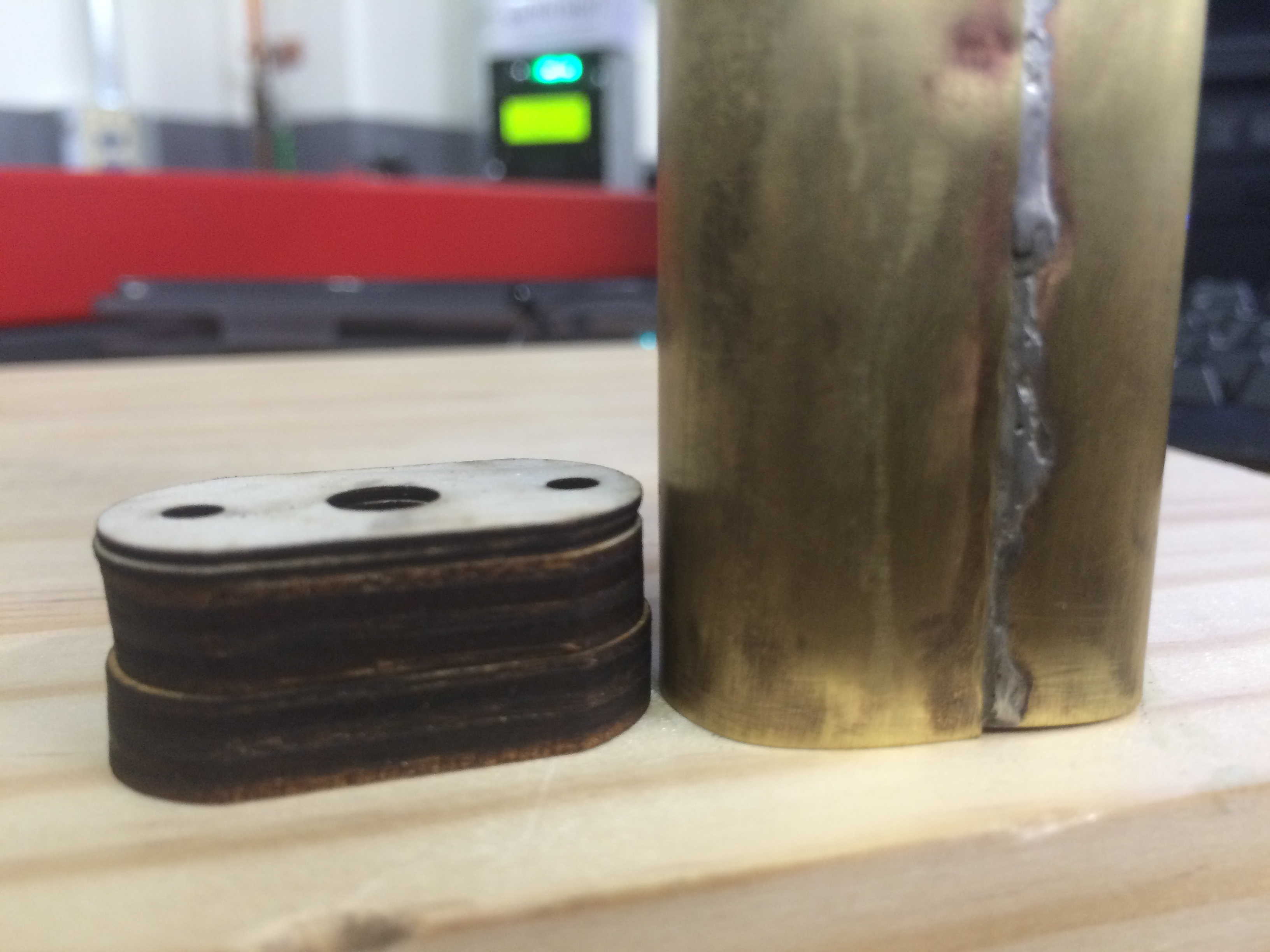

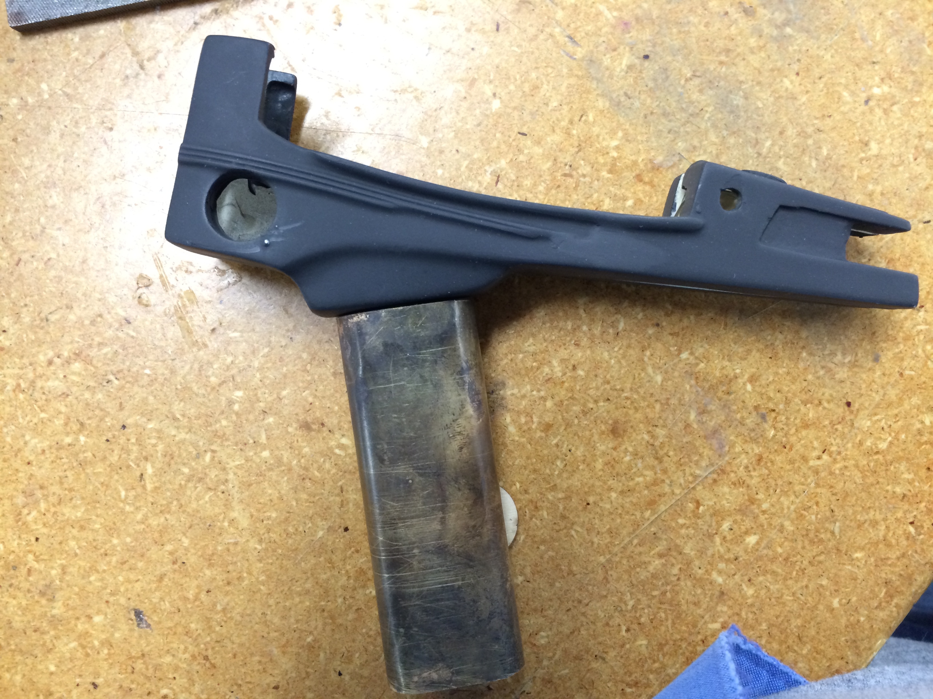

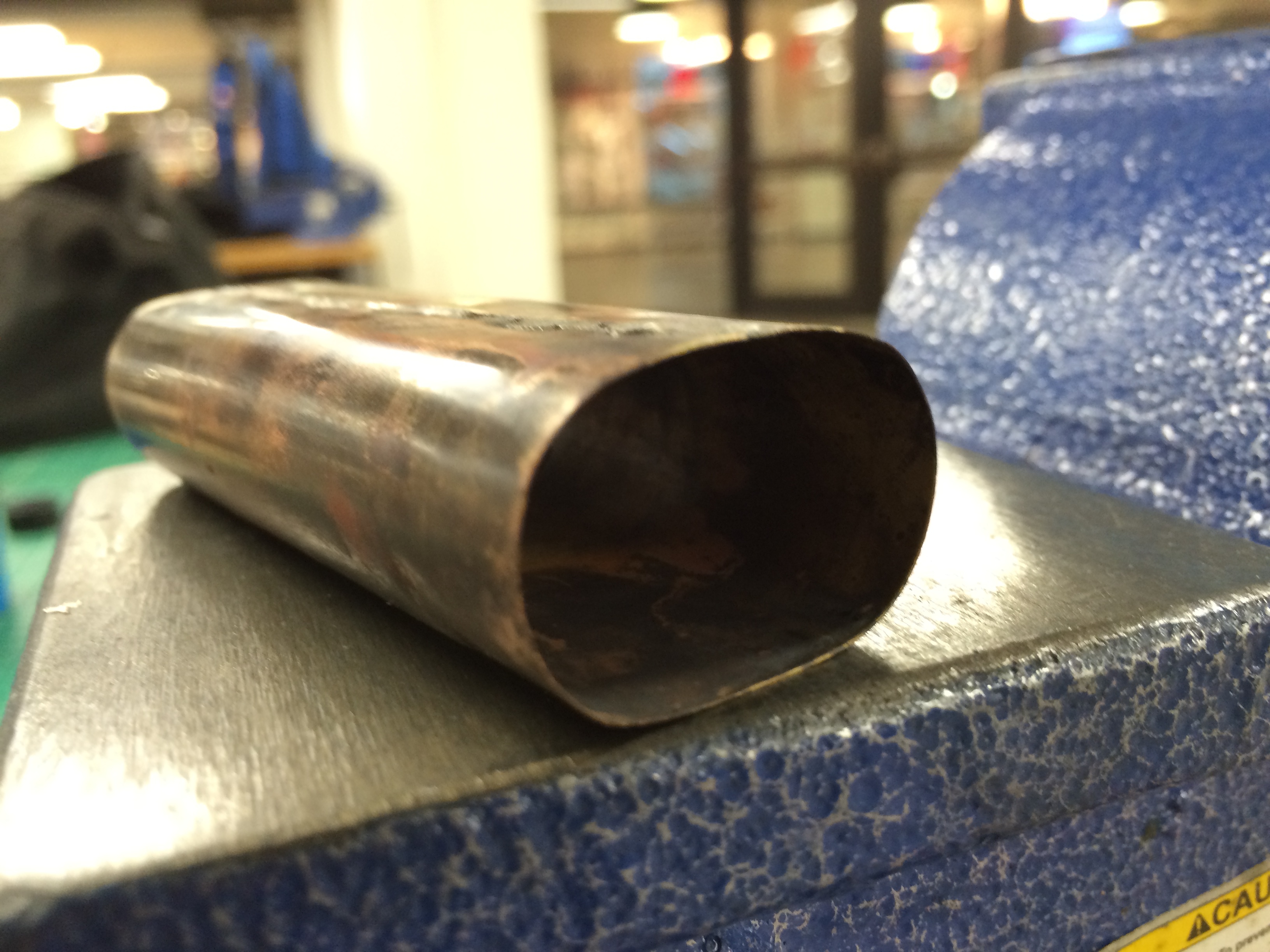

After soldering, which went okay but not my best work, I had me something that was beginning to look like a phaser handle...
As the late Freddie Prinz used to say to Jack Albertson, Lookin' goooood!
Of course, no way I could resist...

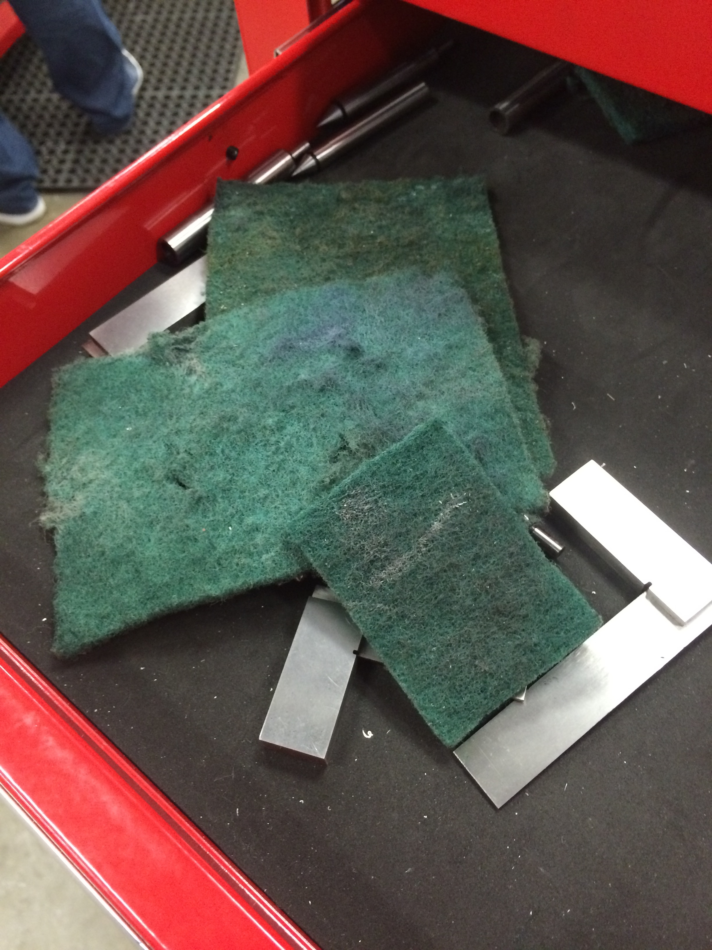

Next stage: clean it all up. It's got soot, dirt, and flux all over it.
This is Scotch-Brite. We keep it in the machine shop for making metal nice and shiny. For a while at first, I was scratching my head about where to get it, because I didn't recognize it.
Then a few months ago, I remembered. This is also Scotch-Brite:

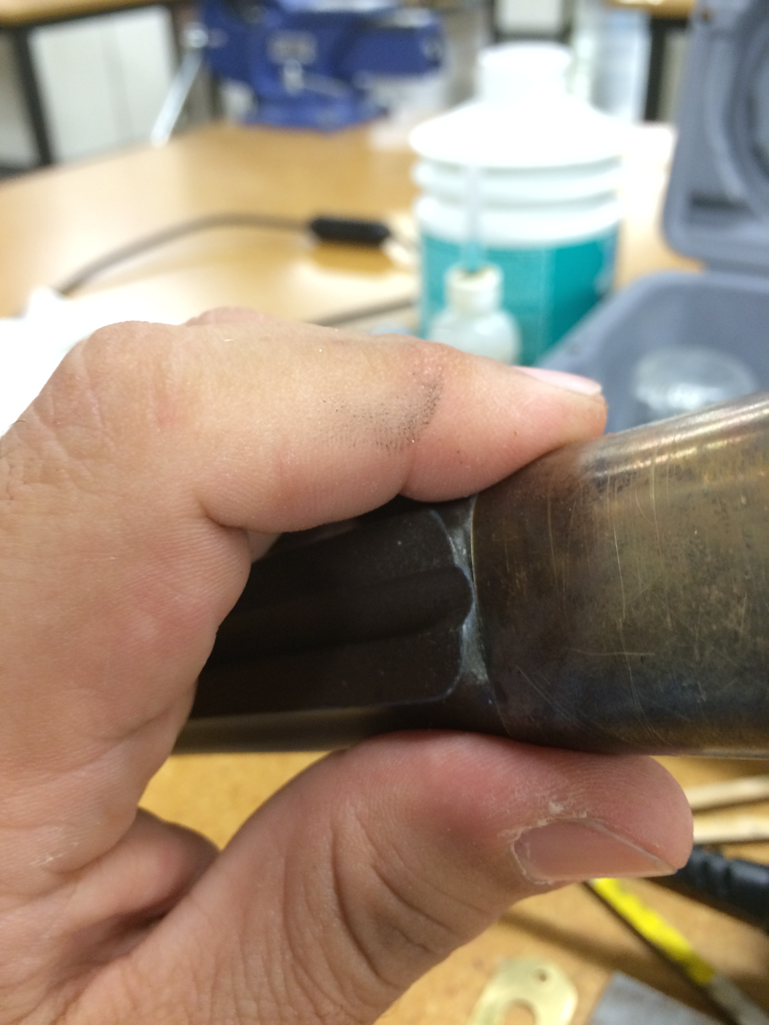

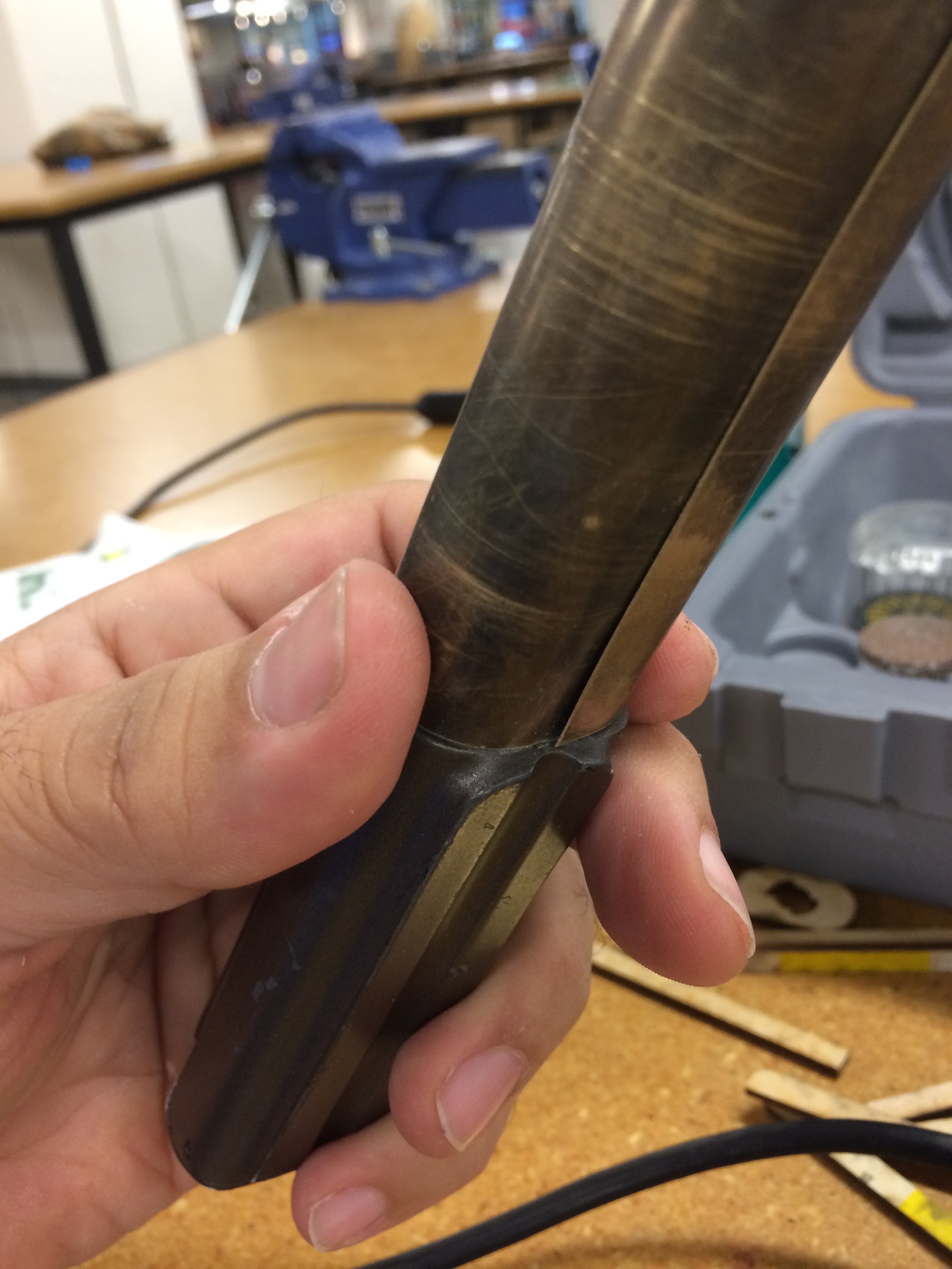

You can get it at the grocery store pretty cheap, and they even sell it without the sponge part. Does a helluva job brightening up metal. Most of the grunge came off with this stuff pretty easily, and the flux paste just flushes away with water. After drying it with compressed air (because life's too short to wait for it to dry on its own), it looked like this:
Hmm... dents on a phaser handle... nope, never seen those before. ;)

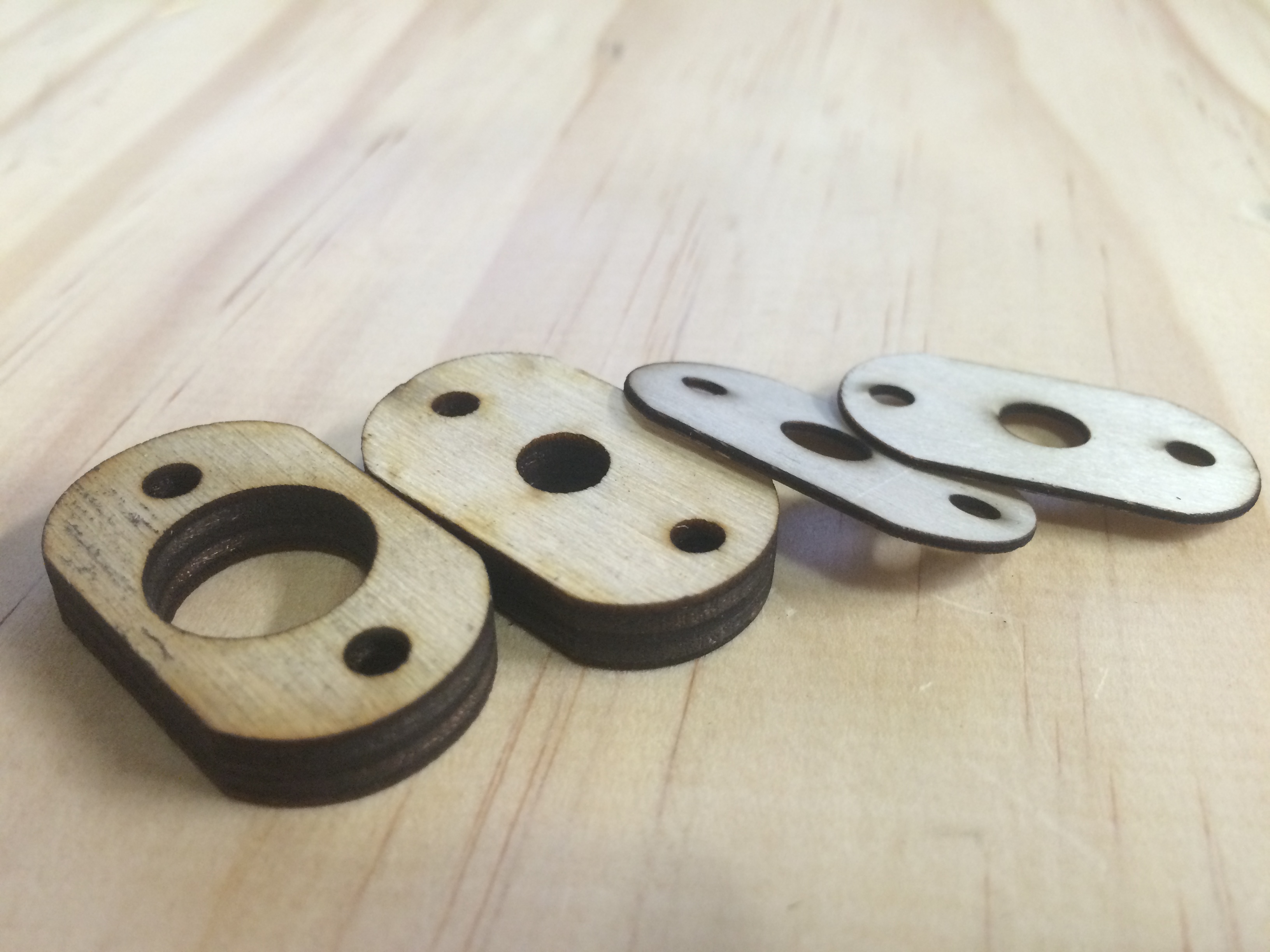

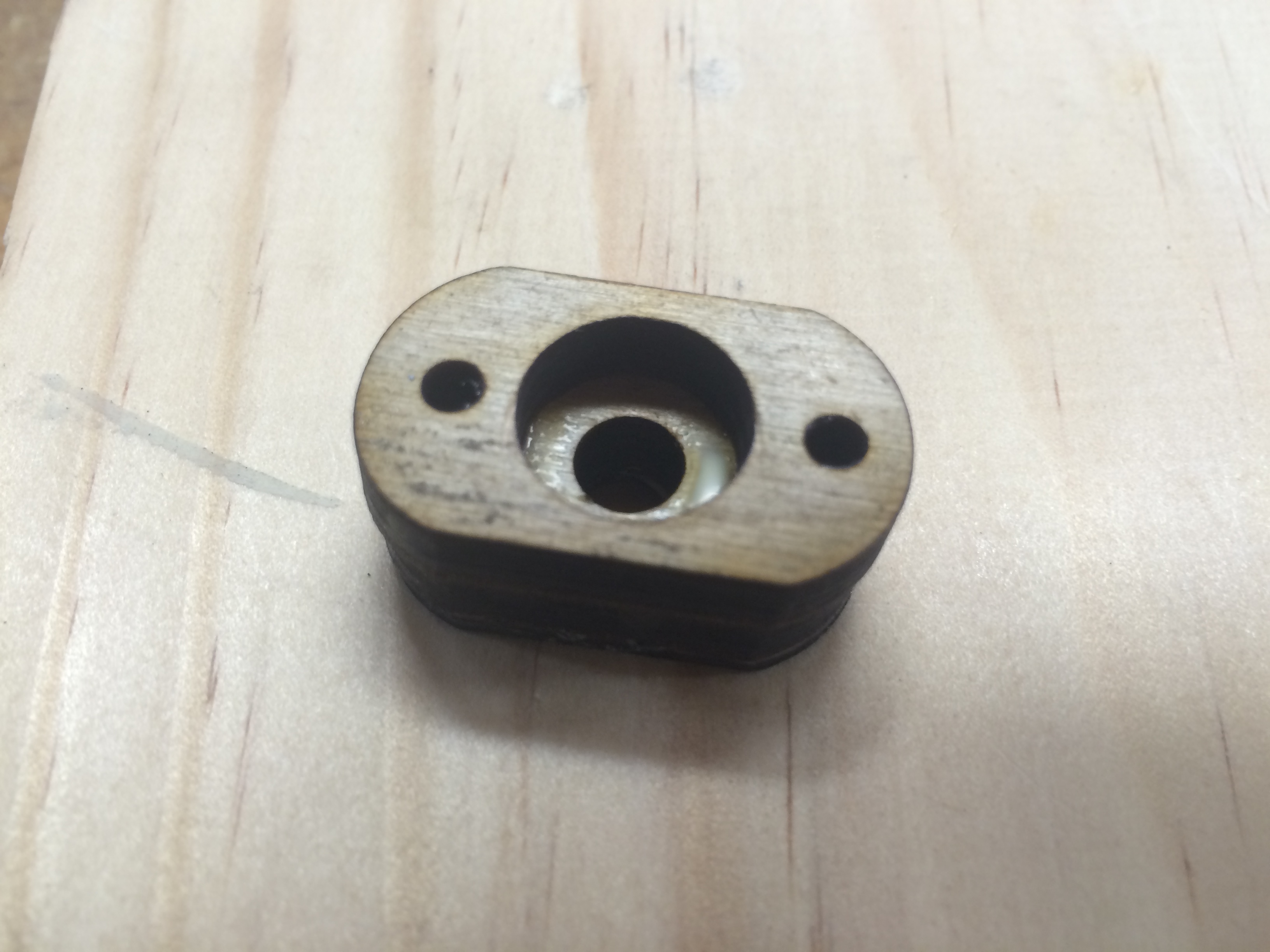

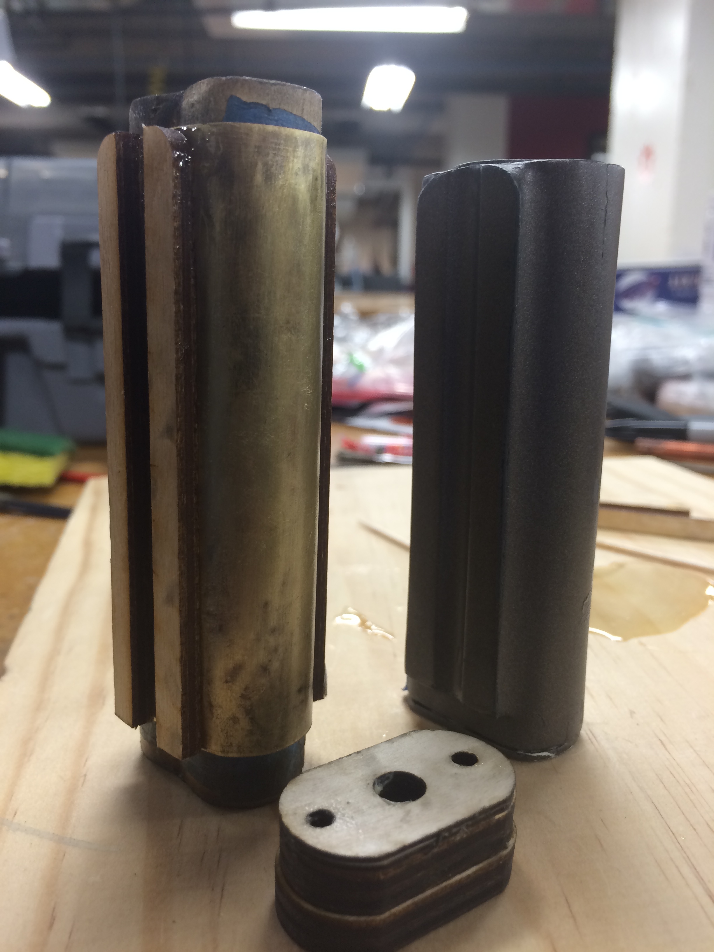

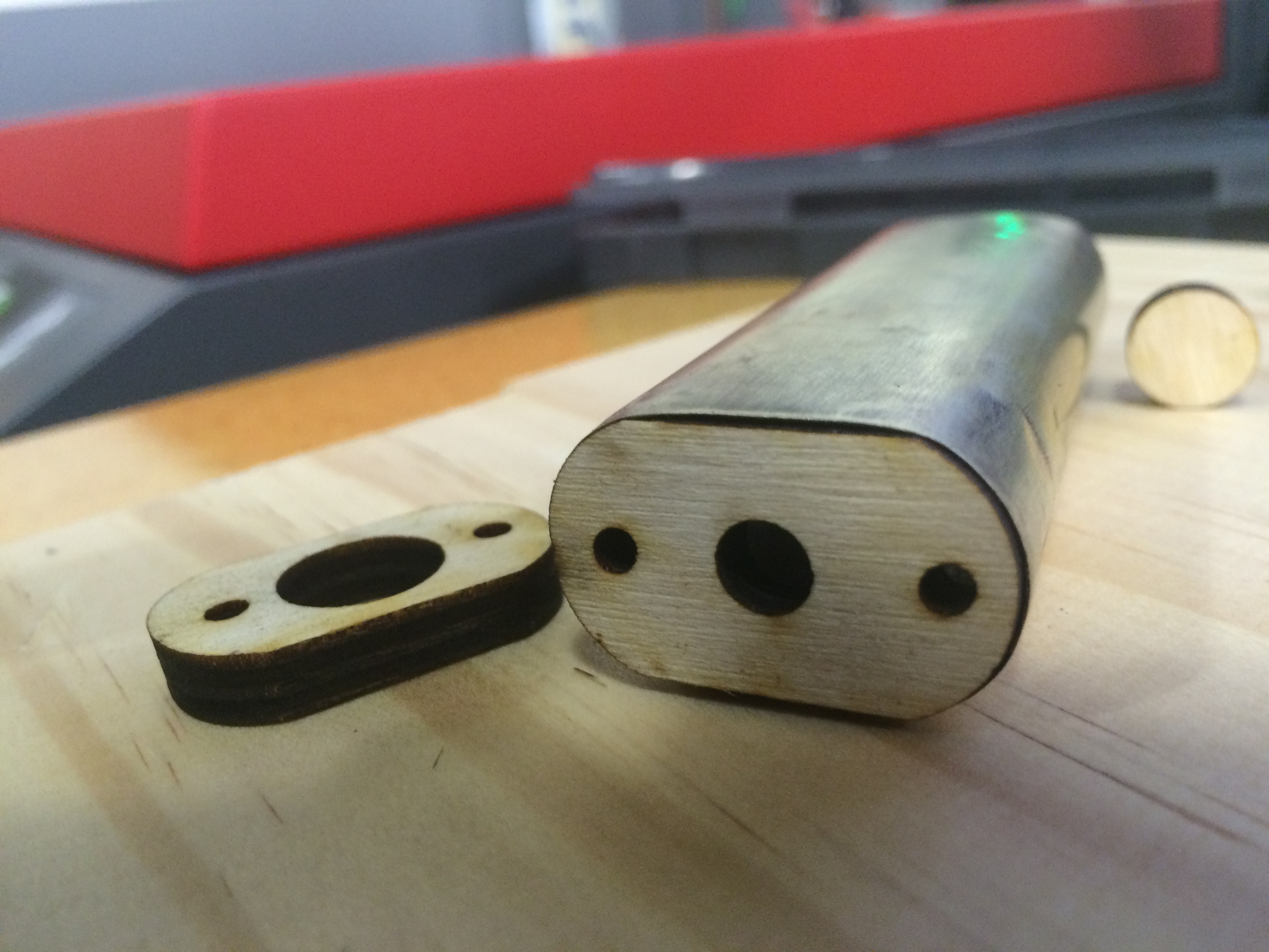

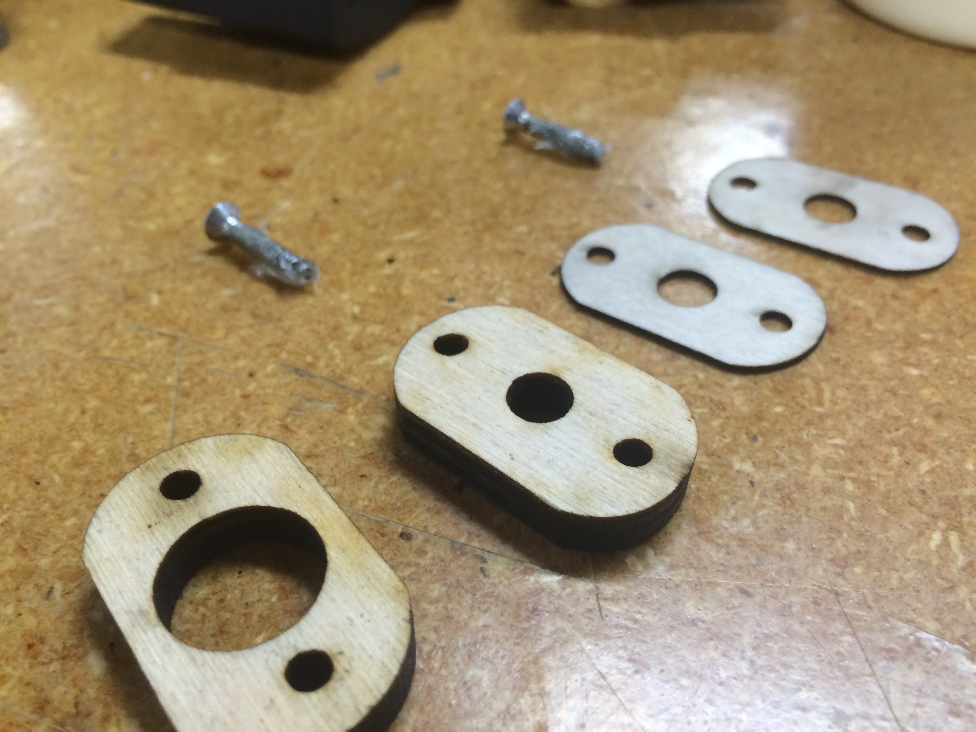

So, back to the laser cutter, this time with better-sized artwork and more thicknesses of wood. The thicker stuff is basswood, the thin stuff is 1/32" birch plywood. All of it's from Michael's. Pretty decent wood prices there, cheapest dowels I've seen in my area, and of course... coupons!!
So the one with the large hole is the base, and it's the same diameter as the handle. This took a little trial and error. The thick one with the smaller hole is the inside part, and the thin ones are just to help me eyeball the thickness. Wood never needs to be the exact thickness. It's easy to laminate, and easy to sand or plane down.

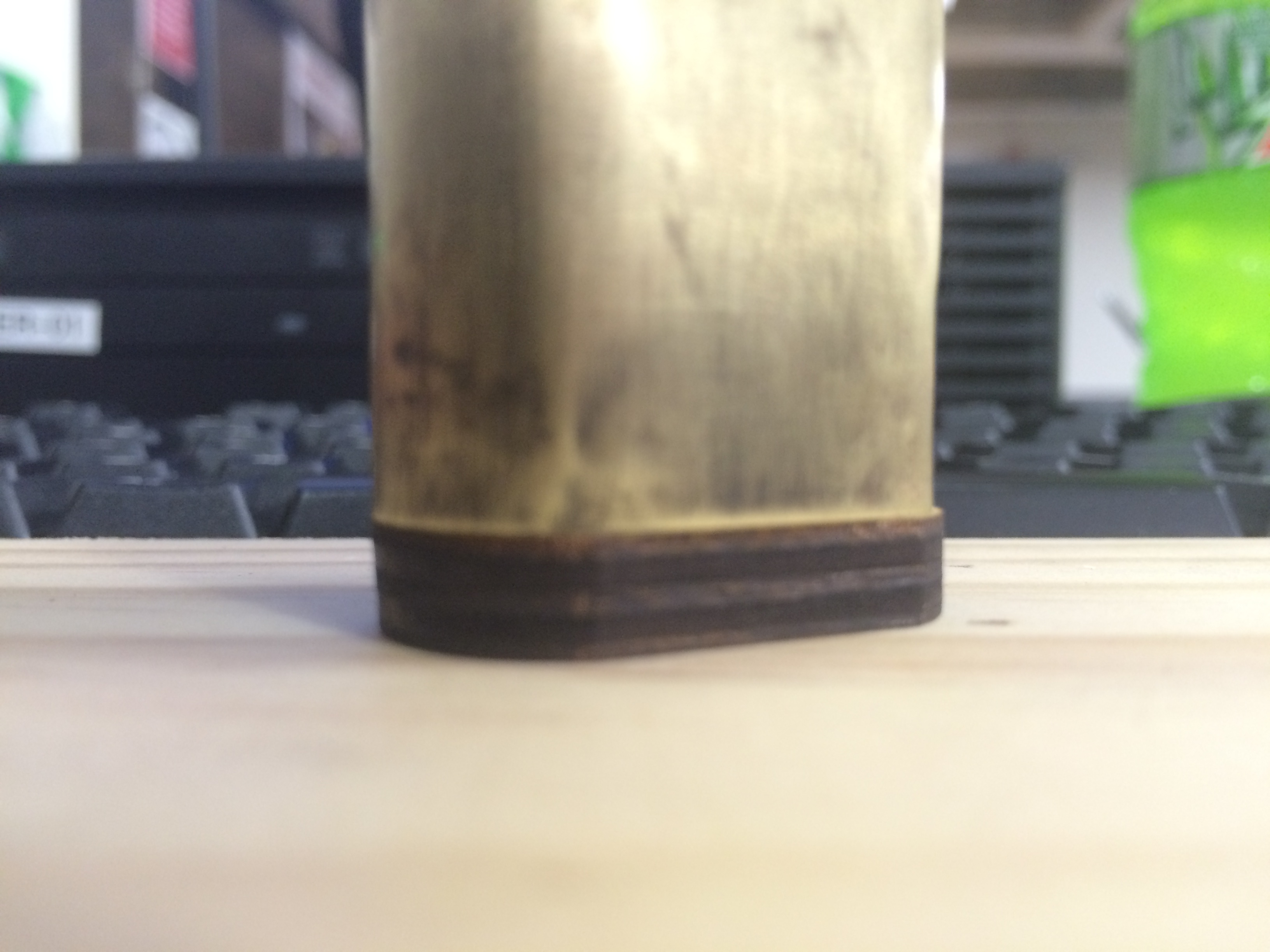

Here they are ready for laminating. Those are two phaser 1 screws to help me stack the wood sections more easily, and they've been dunked in vaseline for ease of removal. The other picture is the bottom view, after I removed the C-clamp. The larger hole is sized to match the outer "wings" of the butterfly cutout, which seems to be the way the original is done, as well as I can tell from the photos. I'm going to do a final visual comparison with the photos next session just to be sure, since I think I may have used one shim too many. If that's the case, it's 80 grit for a couple of minutes and let's move on.

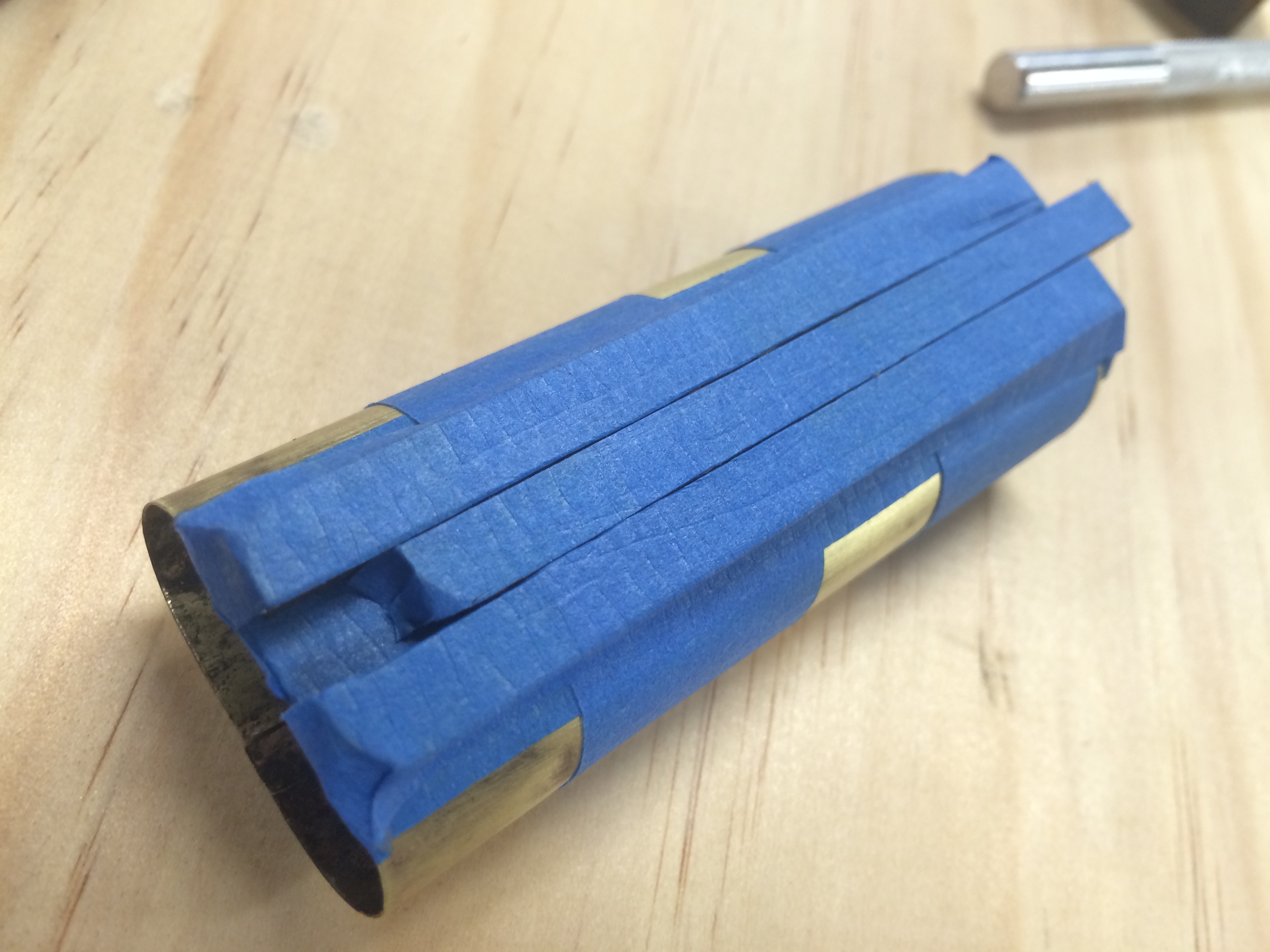

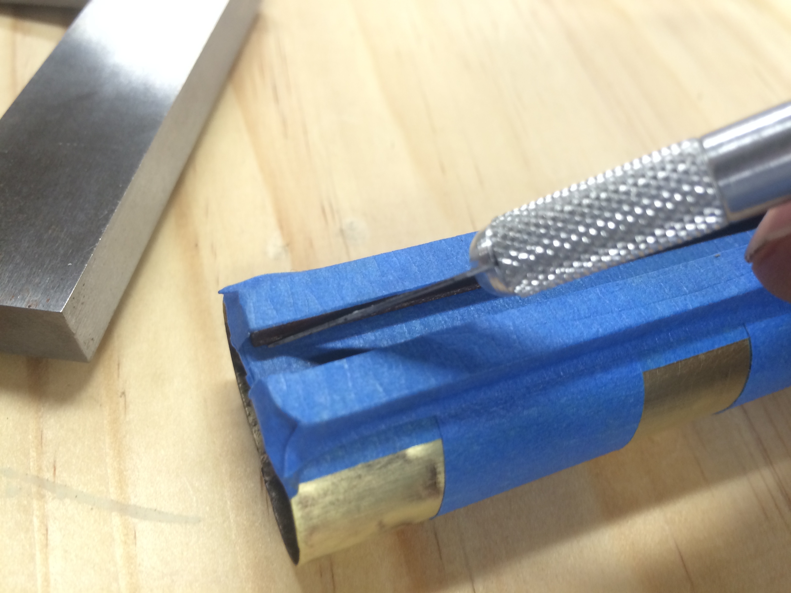

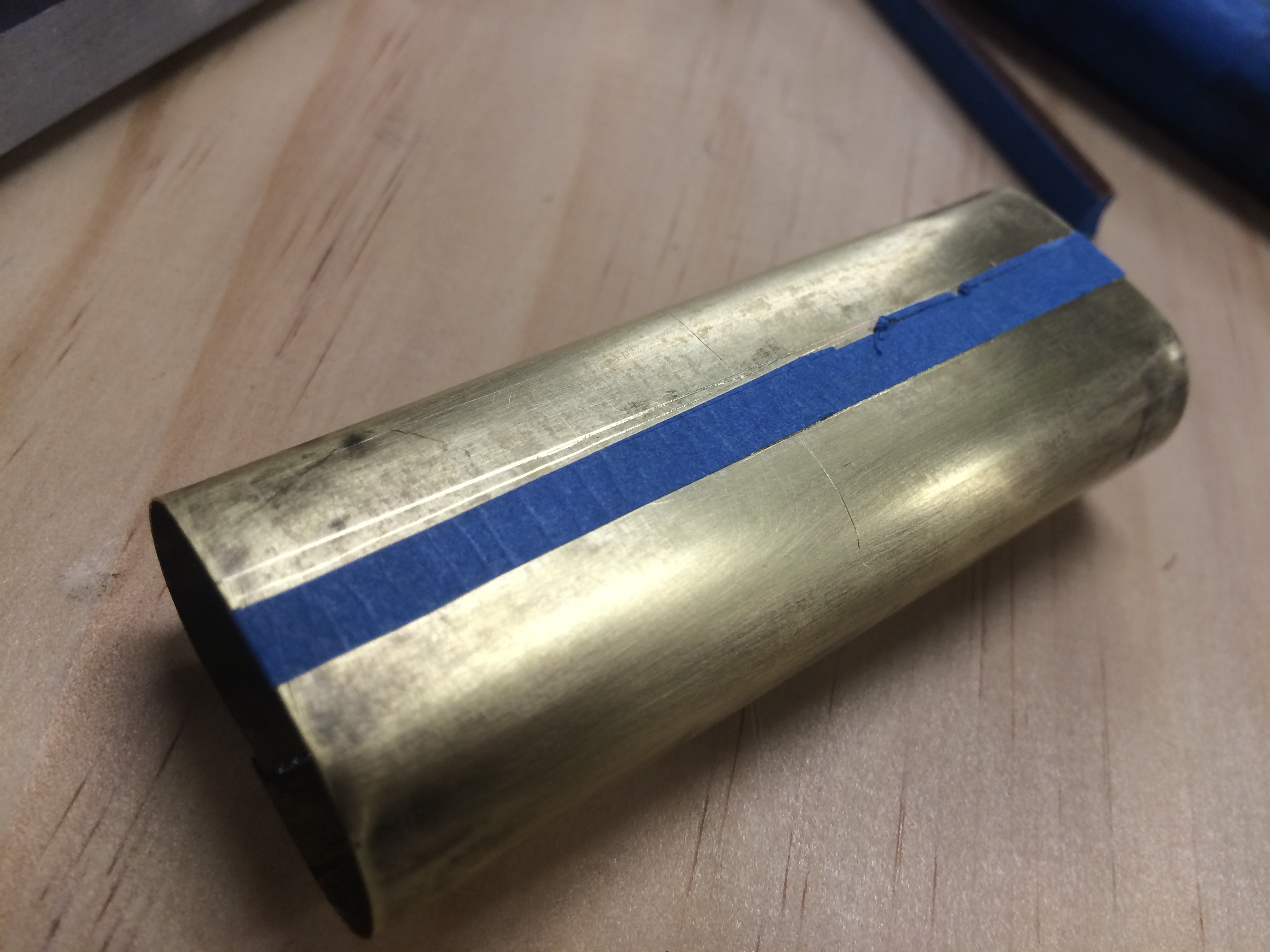

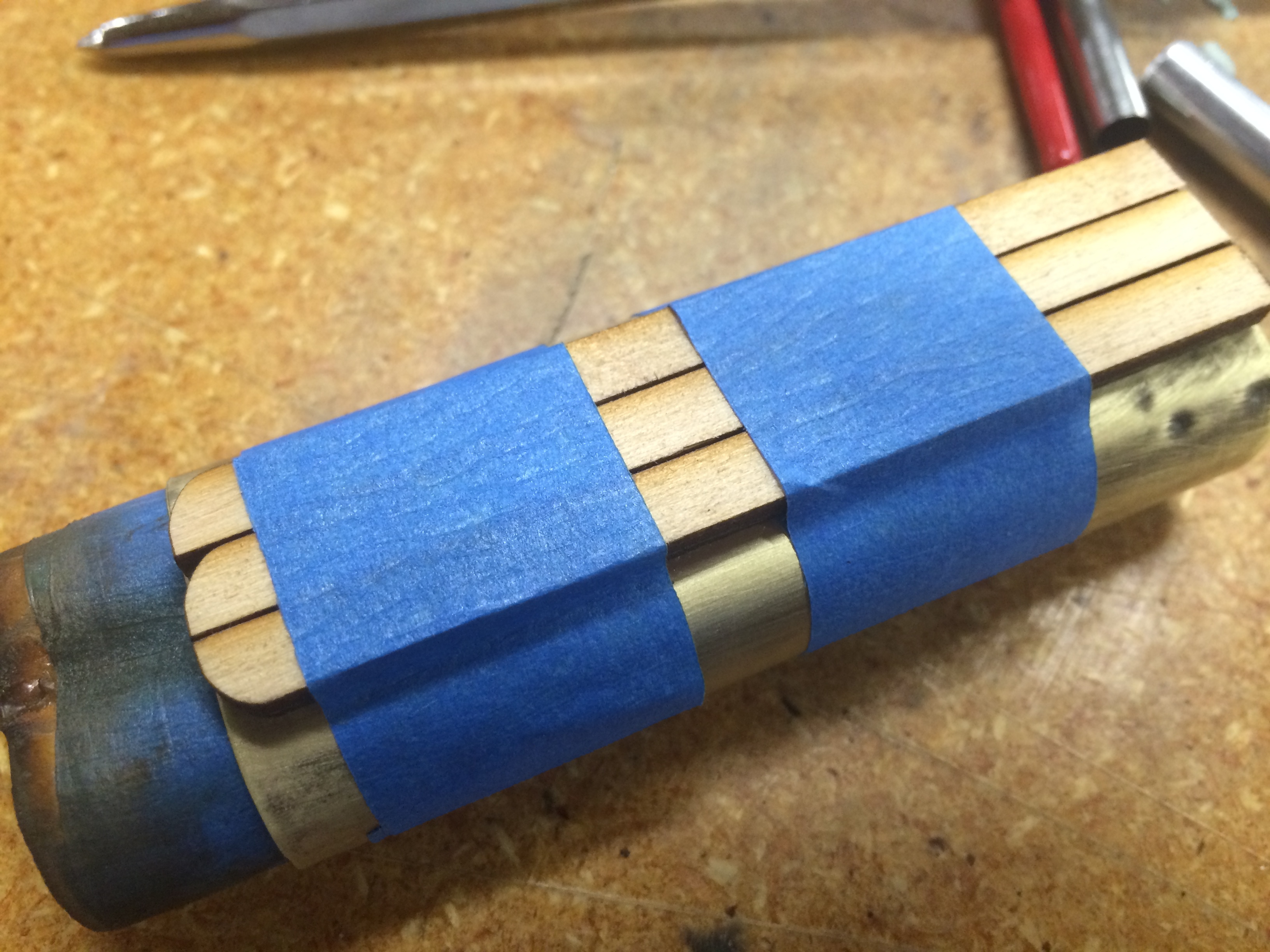

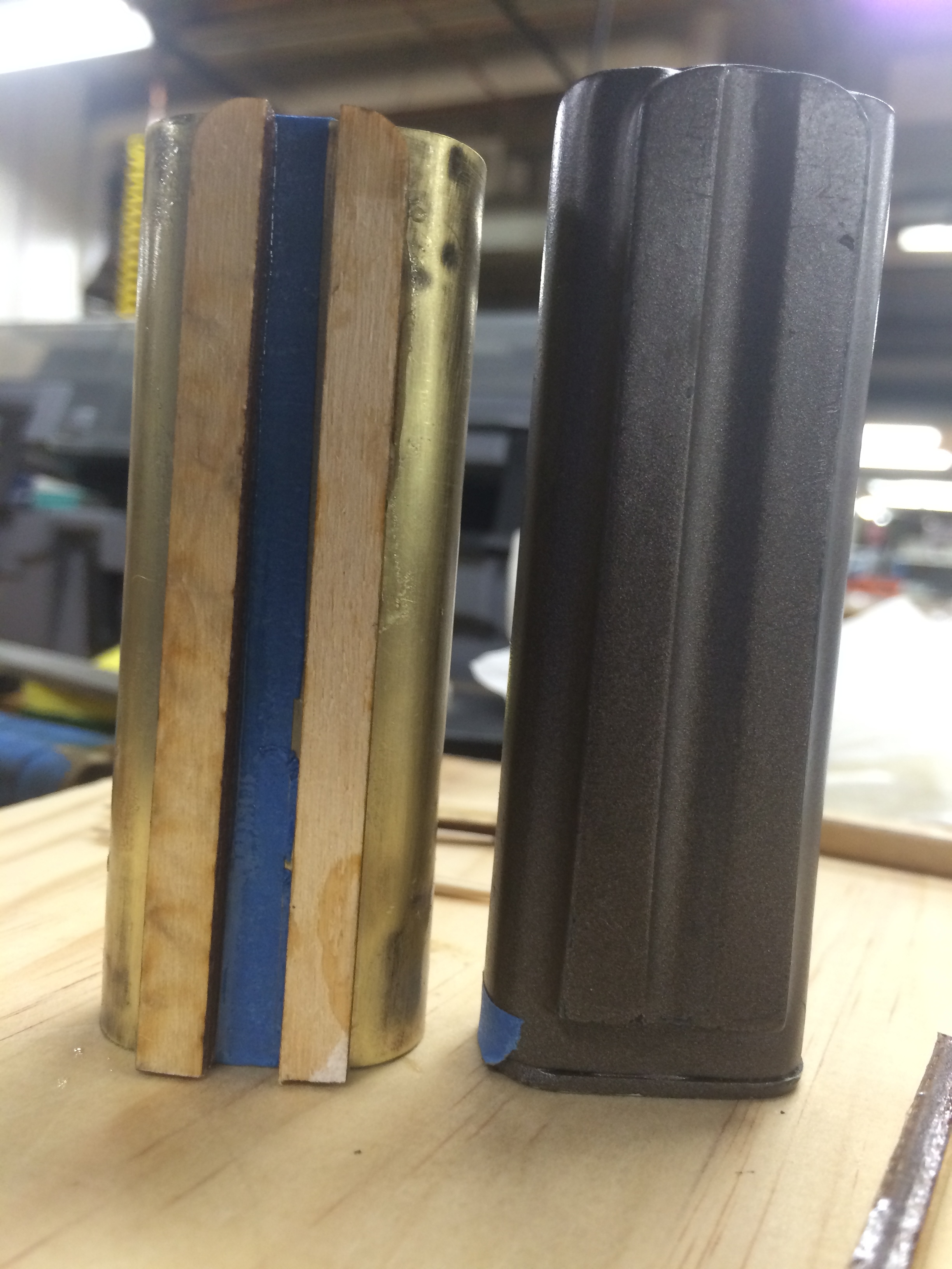

Okay, so here's the bumbling that convinced me to make a jig for this stuff for the rest of my handles. I figured I'd make a tape line to lay my sticks against for gluing into place. It worked, but personally I found this to be kind of a pain. Before you can use the tape to line up your sticks, you have to line up your tape in the first place. So you get this kind of chicken-and-egg thing going, and at my age that just makes me sleepy. But as I said, this worked. The third stick in the middle is for lineup and spacing -- this keeps them exactly 1/4" apart and perfectly parallel.
Just cut through the tape around the middle stick, and slide it out. Then cut the tape that's on the handle, using the inside edges of the sticks as a guide. Remove all the rest of the tape, leaving just the strip. At this point, I probably should have laid outside strips too, because the epoxy wanted to skate along the surface of the brass, and this made lining up a pain.
But like I said, I'm definitely making a jig next time out. And that might be its own thread, or maybe I'll do a handle-only thread or something when I really have the method nailed down.

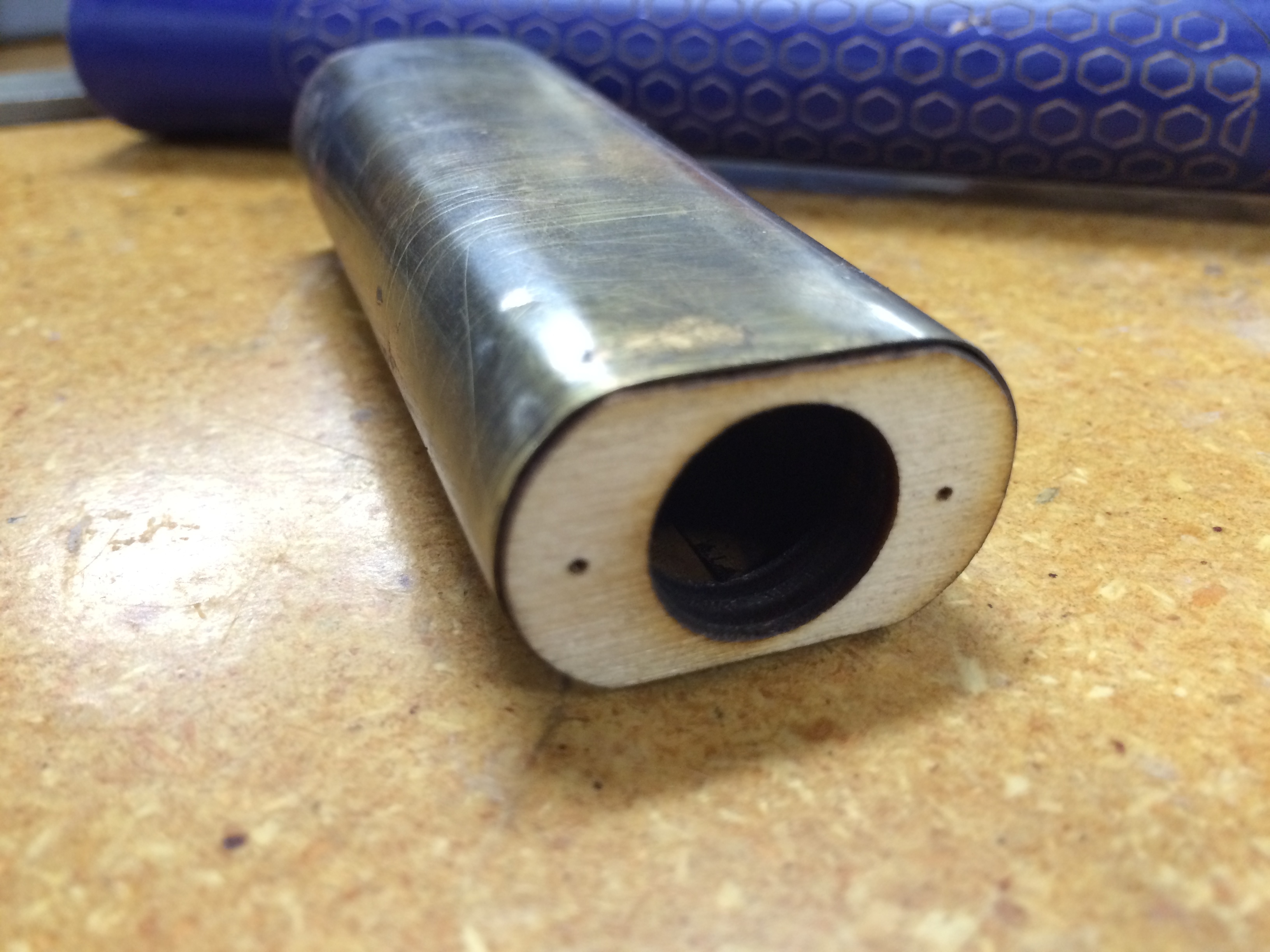

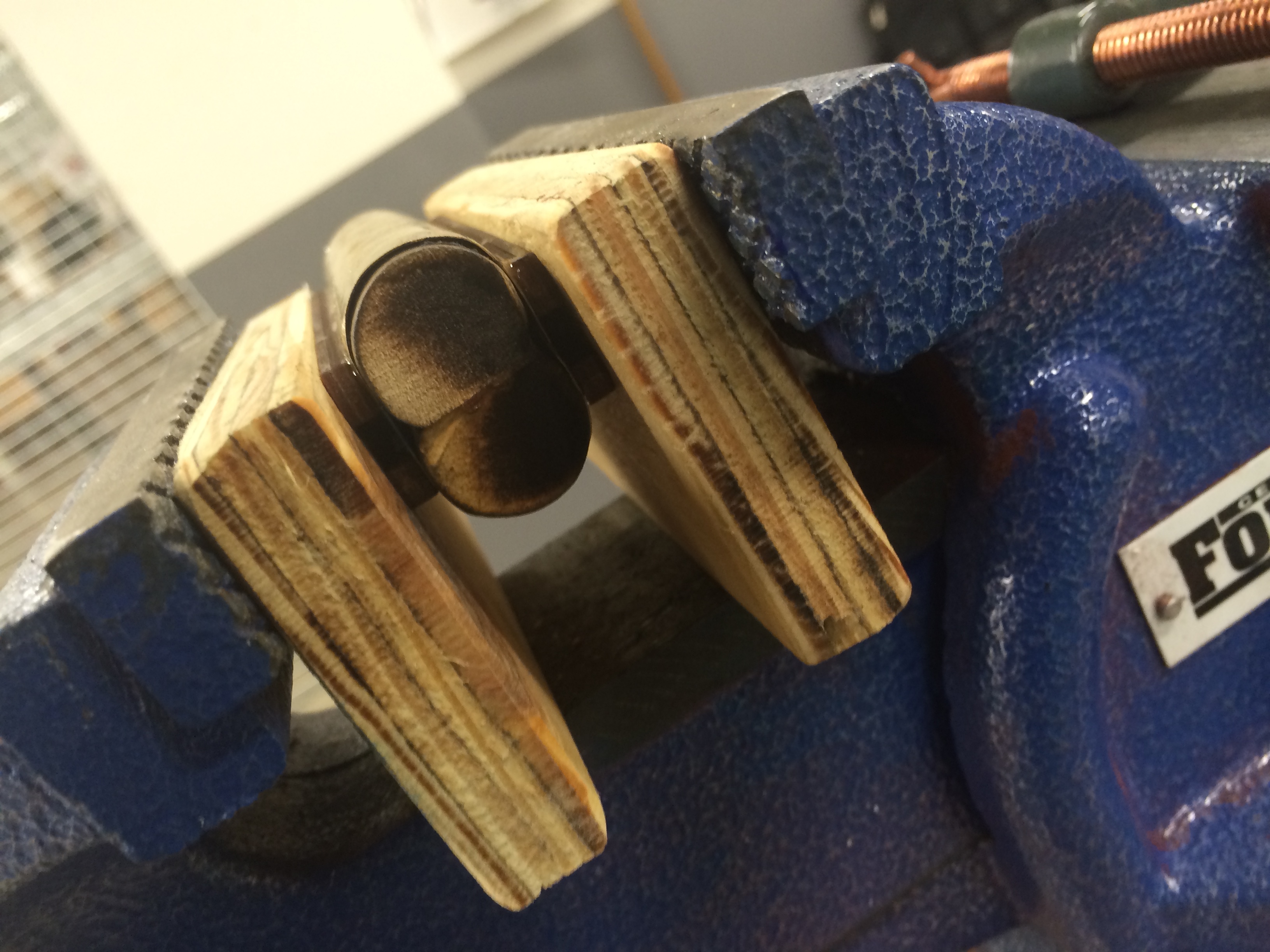

And there it is! Ran out of time to start the puttying and priming process, but I got this far. So while I cleaned up, I gave it one last squeeze in the vise...
And that's all she wrote till next session on Tuesday! Happy Monday guys! :)

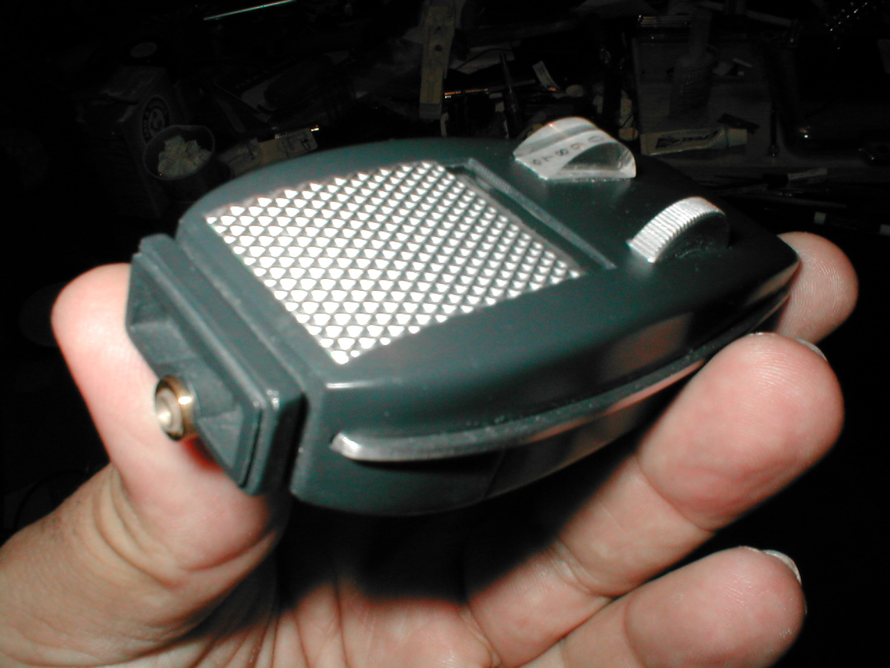

Meanwhile, here are some vintage photos of the MM P2 I'm now refurbishing, back when I first finished it. Please excuse the old-timey sepia tone, I had to be very careful digitizing the tintypes. BTW, I think I voted for Coolidge that year.

The MM looked like a nice build. I think that P1 looked more right than the one from John's hero kit, especially when compared to the ones in Assignment: Earth.
