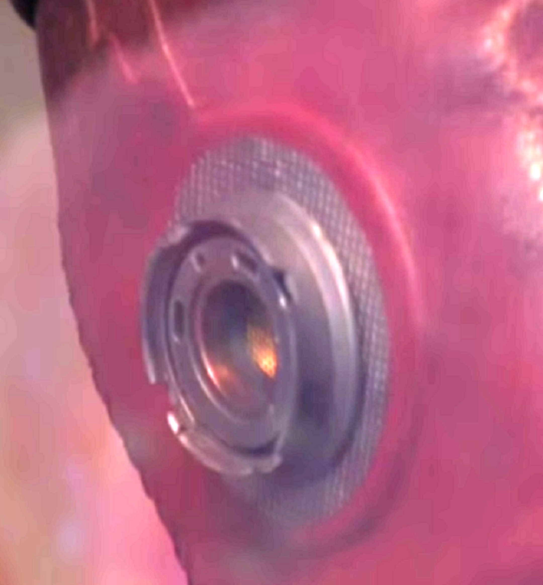

There isn't a hole for the valve, it sits on top of the leather. The silver mesh is glued down on top and the valve on top of that.
Staar Lord Maan;3677180[SIZE=3 said:
[/SIZE]
Yes, I said it...hole...god help me....

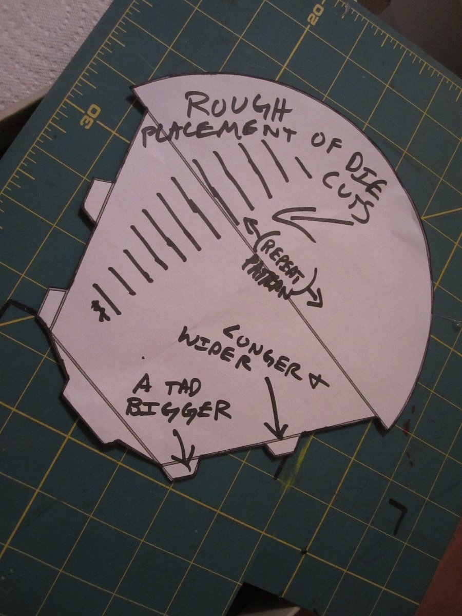

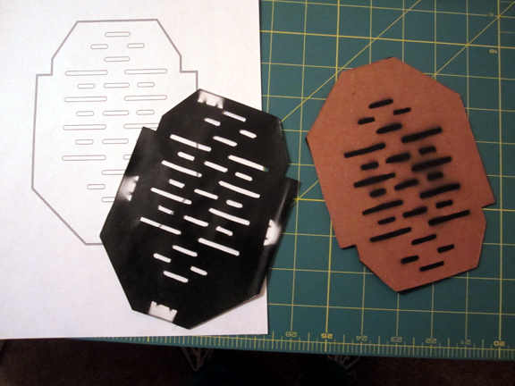

I was knocking out some templates I got a while back for some Star Lord's boots and made the discovery that using a razor blade to cut the die-cuts out was okay for paper, but that 'cheating' with spray paint to transfer that pattern over to a more rigid medium caused over-spray,
...but that's not why I'm posting, (I've already ordered the oblong punch tool for the leather)
The 'foot cap' pattern I have doesn't have the location of the die cuts on it so I took some notes from reference images and thought I'd pick the minds of the more experienced here...
Before............... After...
With all that in mind, does anyone have an accurate representation, (in pattern format), for the placement of the die cuts for the foot cap piece?
Also, how does the lower part of the spat align with the foot cap? If there is a dotted line representation somewhere out there i'd be fully appreciative if it were magically posted, here. Thanks!

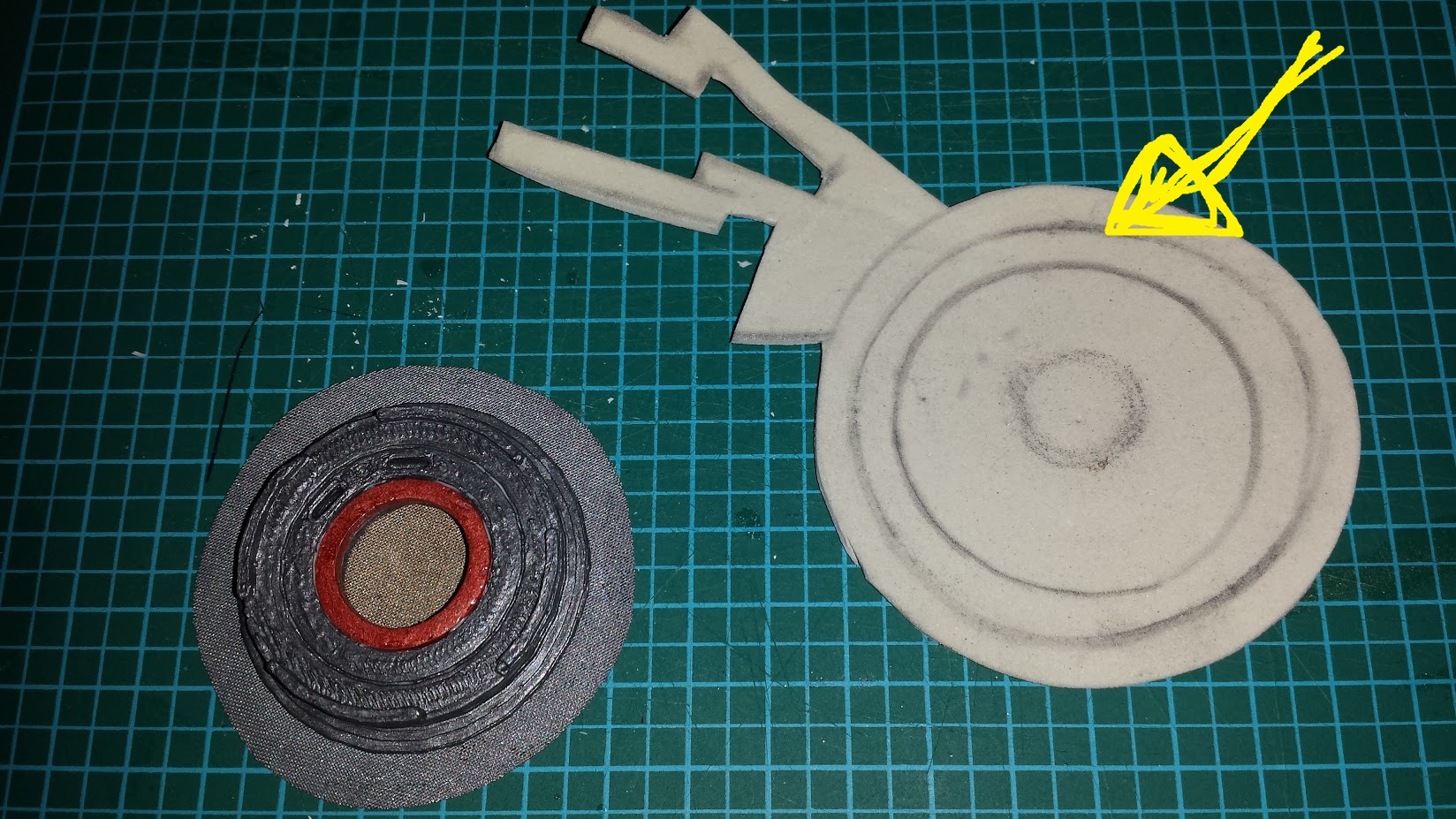

In addition, I have not seen the Rocket Sub Strait out there which looks *exactly* like the one depicted in the image with the red highlight below.
The green highlighted image depicts what comes with the 3D printed kit ordered through Shapeway
This green highlight depicts what comes with the 3D printed kit ordered through Shapeway which is not screen-accurate and too flimsy for what I plan to do with it...

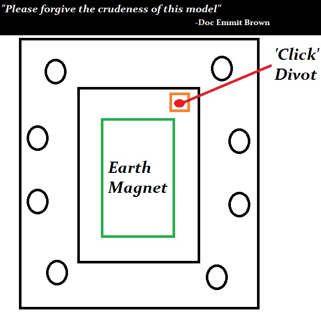

Side note, if you're wearing a Gamora outfit, you can install a magnet on your lower back panel of your cosplay...
Boot Rocket - Gamora magnet placement.JPGWheee!.jpg...get it? :D
Anyway, having a mount with a hollow chamber in it large enough for me to embed that magnet with plumber's putty and E-6000 would solve a ton of problems for me.
http://www.therpf.com/attachment.php?attachmentid=497345&d=1436193151&thumb=1
http://www.therpf.com/attachment.php?attachmentid=497347&d=1436193380&thumb=1http://www.therpf.com/attachment.php?attachmentid=497346&d=1436193442&thumb=1
http://www.therpf.com/attachment.php?attachmentid=497349&d=1436194479&thumb=1
http://www.therpf.com/attachment.php?attachmentid=497350&d=1436194479&thumb=1
http://www.therpf.com/attachment.php?attachmentid=497351&d=1436196947&thumb=1http://www.therpf.com/attachment.php?attachmentid=497333&d=1436196730&thumb=1 ...get it? :D

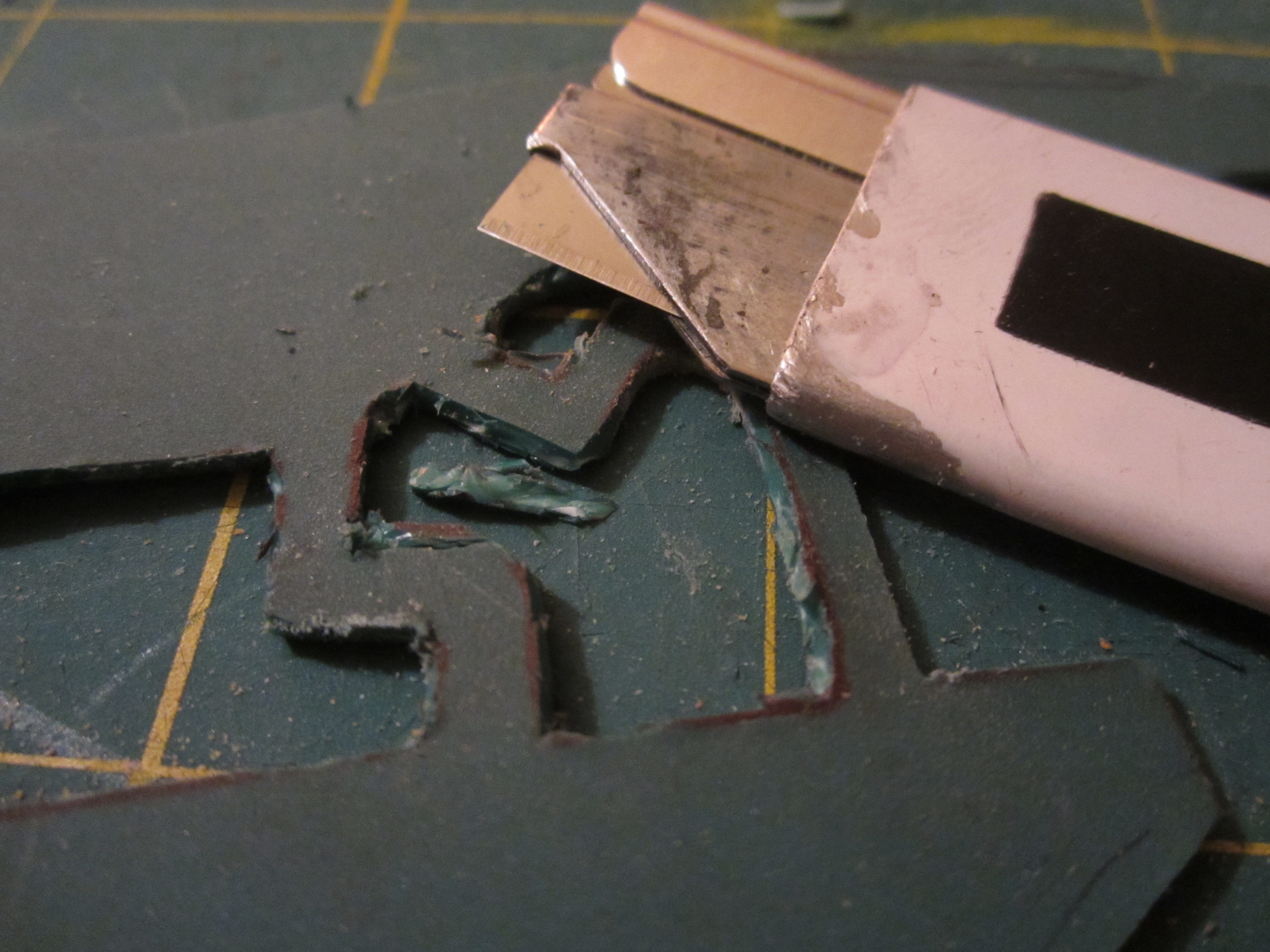

how do i get the foam cut out that goes behind the leather, behind it? inside
I just taped it to the exterior, held it in place while I turned it inside out...then traced markers around the shape. I then took that shape and placed it onto those markers, (making sure I've aligned them appropriately to accommodate for the seam), and used a sharpie to draw the shape directly onto the back side of the leather. You'll have to rip the seam in the jacket liner first, sorry...
Now, I see you are using foam...you may want to use something more rigid for the E-6000 to adhere to, otherwise your embossing won't look as crisp.
yes, can see them now :) what would you suggest to use instead of foam thanks
Head to the hobby store and look for sheets of plastic about the thickness of a cutting mat. OR...heh...do what I did and use a cutting mat! that can get pricey, but I had an old trashed one laying around that was askin' for it...

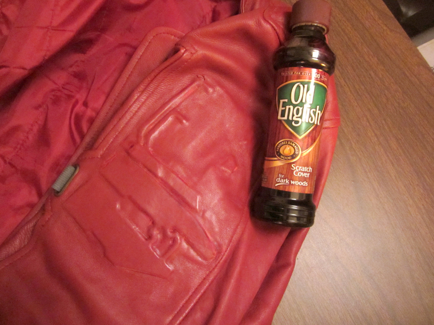

Okay, so I'll admit...'wet molding leather' is now a 'thing' in my toolbox of 'things' for doing 'things' to 'things'.
or something...
It being my fist time, I kinda sorta got a bit too enthusiastic, so here's my repair work...
BEFORE............................. AFTER
As you can see, when I rubbed the leather raw with the end of a coated paintbrush (probably too small and pointy), I exposed a much lighter shade of red. Old English scratch remover (the dark stuff) Rubbed on with a paper towel worked great. The porous nature of the scratched leather picked up the oil whereas the finished leather allowed it to be wiped away. Bonus: It looks like a little shadowing, now!

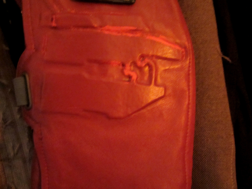

On this update, Staar Lord Maan swallows a LION!
Also, he does wet molding for the placard behind where the valve sits...

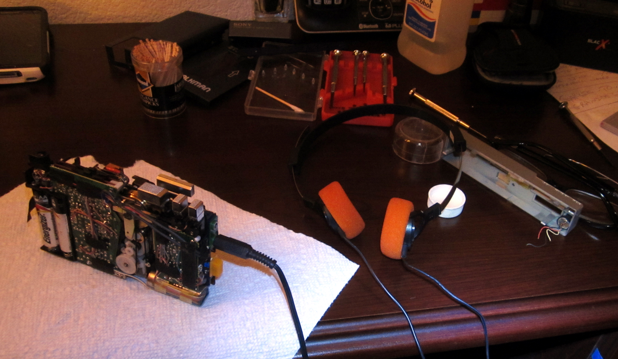

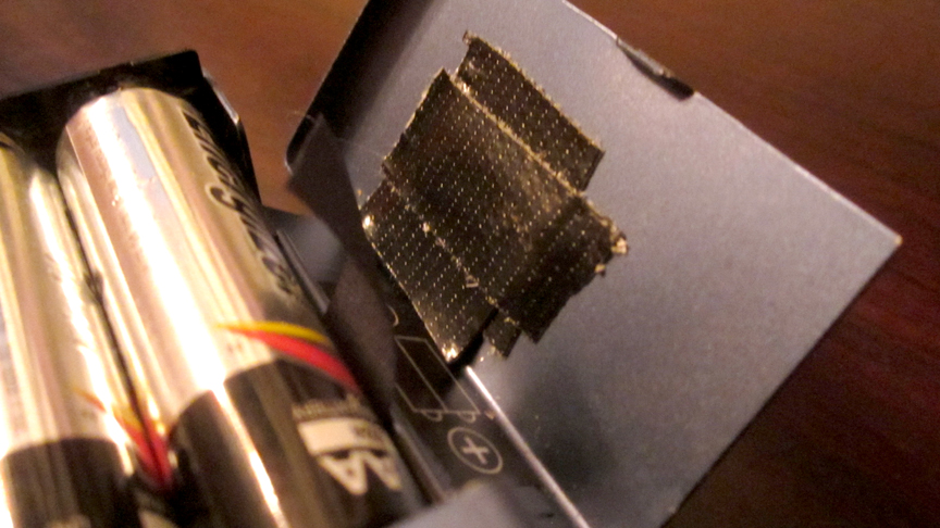

Couldn't sleep...Might as well figure out what's going on with this thing eating tape...
I wound up taking some Isopropyl Alcohol to some rolled up paper towel bits and squeezing it into the gears...gentle scrubbing, in some cases with a toothpick swaddled in paper towel. worked like a dream.

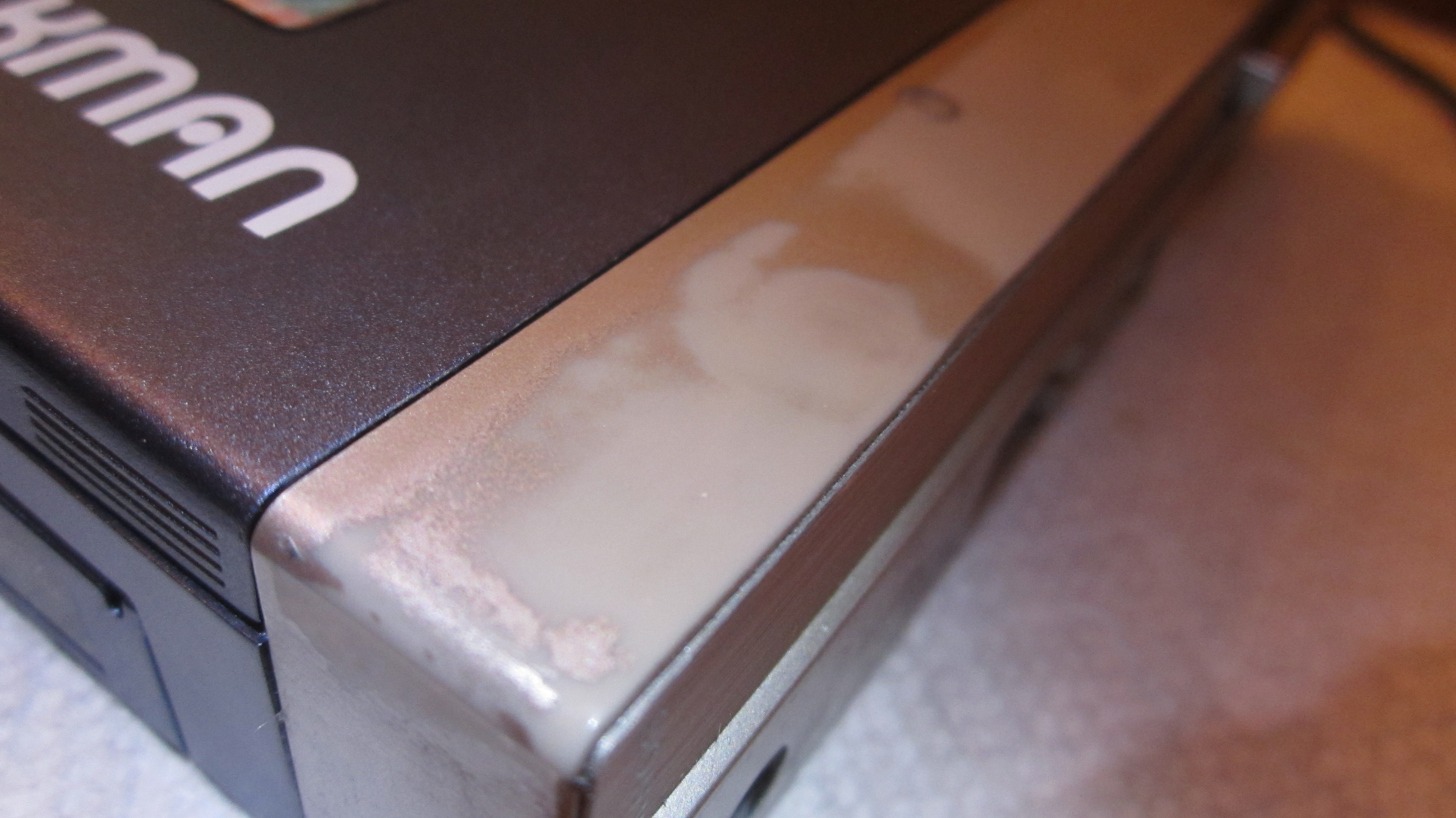

I am curious to know what sparkly paint they used on the plastic instrument cowl. The paint has rubbed off over the years from having been stored in it's 'protective' vinyl case. [hashtag 'Friction']
Lastly, as it is with some of these units, if you move them just right, you can dislodge the batteries in side their bay, so I remedied this through the use of one small strip of Gorilla tape...then another slightly larger one, then finally another larger one. I created a little bump on the inside of the battery bay door, but made sure to have it be on the leading edge of the outer-most battery to hold everything in place. It works pretty solidly, feel free and steal this idea :)
