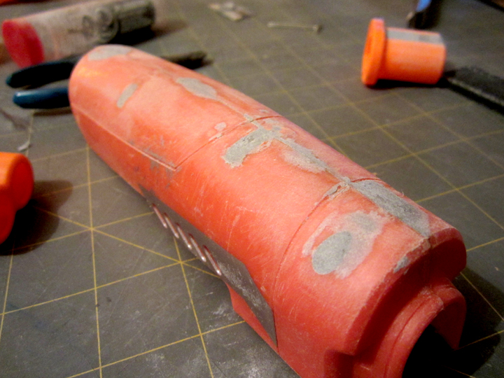

Before it hardened all the way, I took a razor blade and VERY carefully laid it flat against both barrels and sliced the excess putty off. After it hardened, I hit it with a coarse 100 grit nail file. Accidentally did a bevel on the end, but it'll barely be seen.
Here, we see the lower cowl and where I filled some holes. because this is a two piece part, I did a little sealing on the inside and where the seam meets outside. Sloppy, but smooth for paint. What's your favorite plastic filler for this kind of an application?
...Here I am sanding this piece...

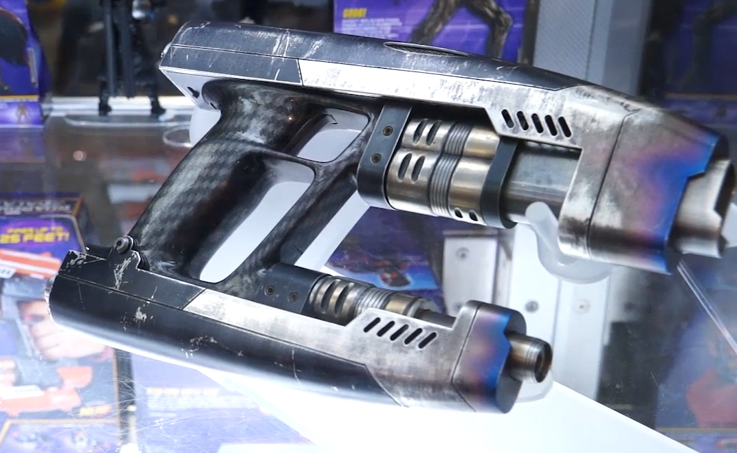

So, this morning I decided to make this image, but in the process, I accidentally mis-clicked on 'Save' rather than 'Save as' and lost the image over which I placed my close up shots.
If the image of the hero prop depicted in the to half of this image (and more specifically, the angle), looks familiar to you, please post a link or email me the image itself.
It's so rare to find an image which displays on my computer screen in ACTUAL SIZE.
I could kick myself, but in the name of helping you all out, please reference this photo instructional for your Quad Blaster cut template ..The shaded areas are where I intend to cut away the plastic to achieve the correct shape before attaching more 'bits' sourced from the item in the second image

and here's that image I thought I lost;

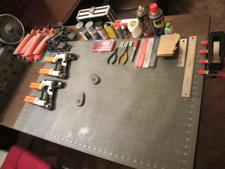

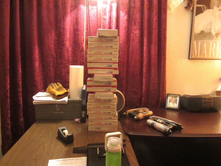

Hey everyone, if I were to caption these it would be "Clean Desk" and "Sick Mind"

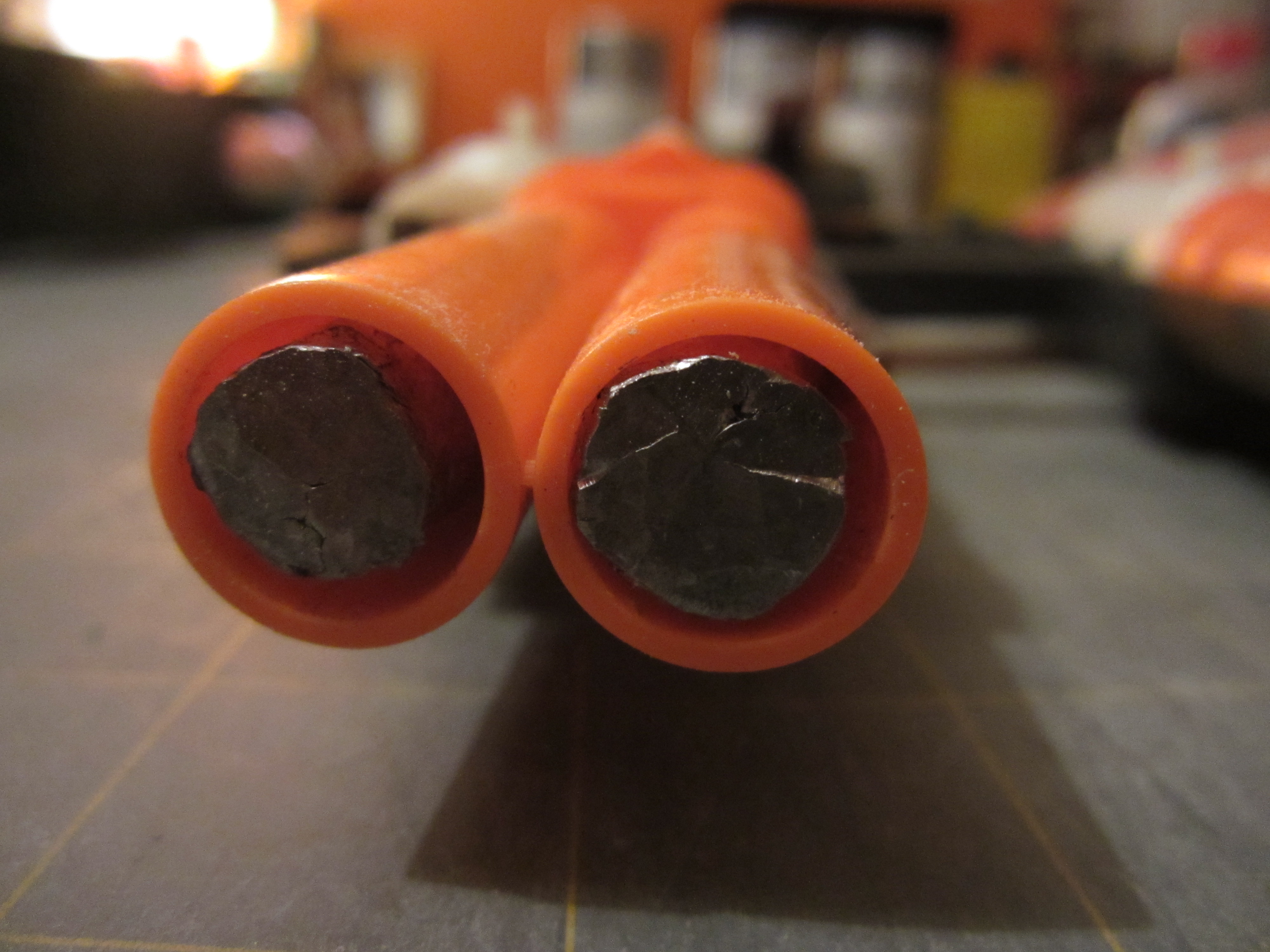

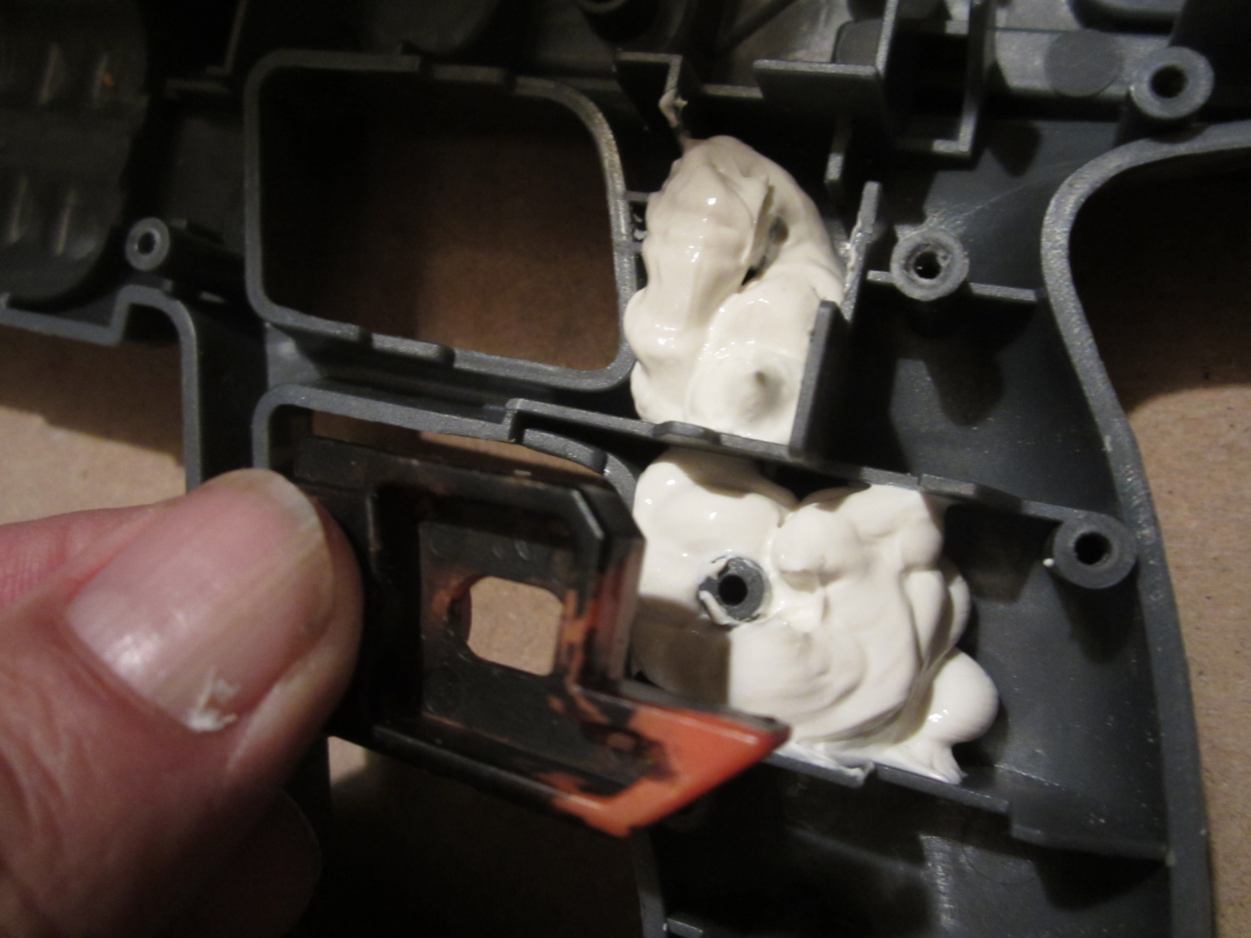

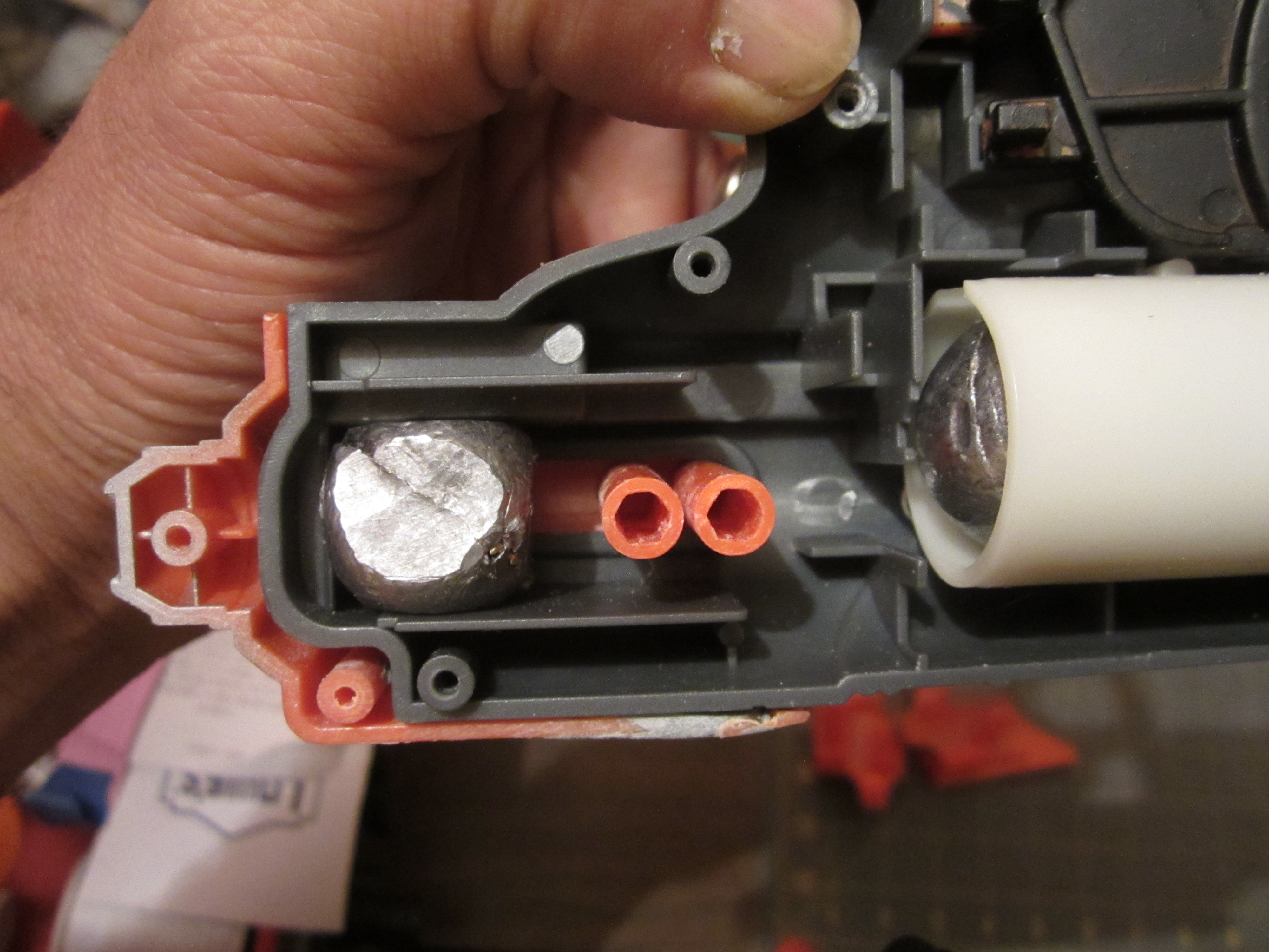

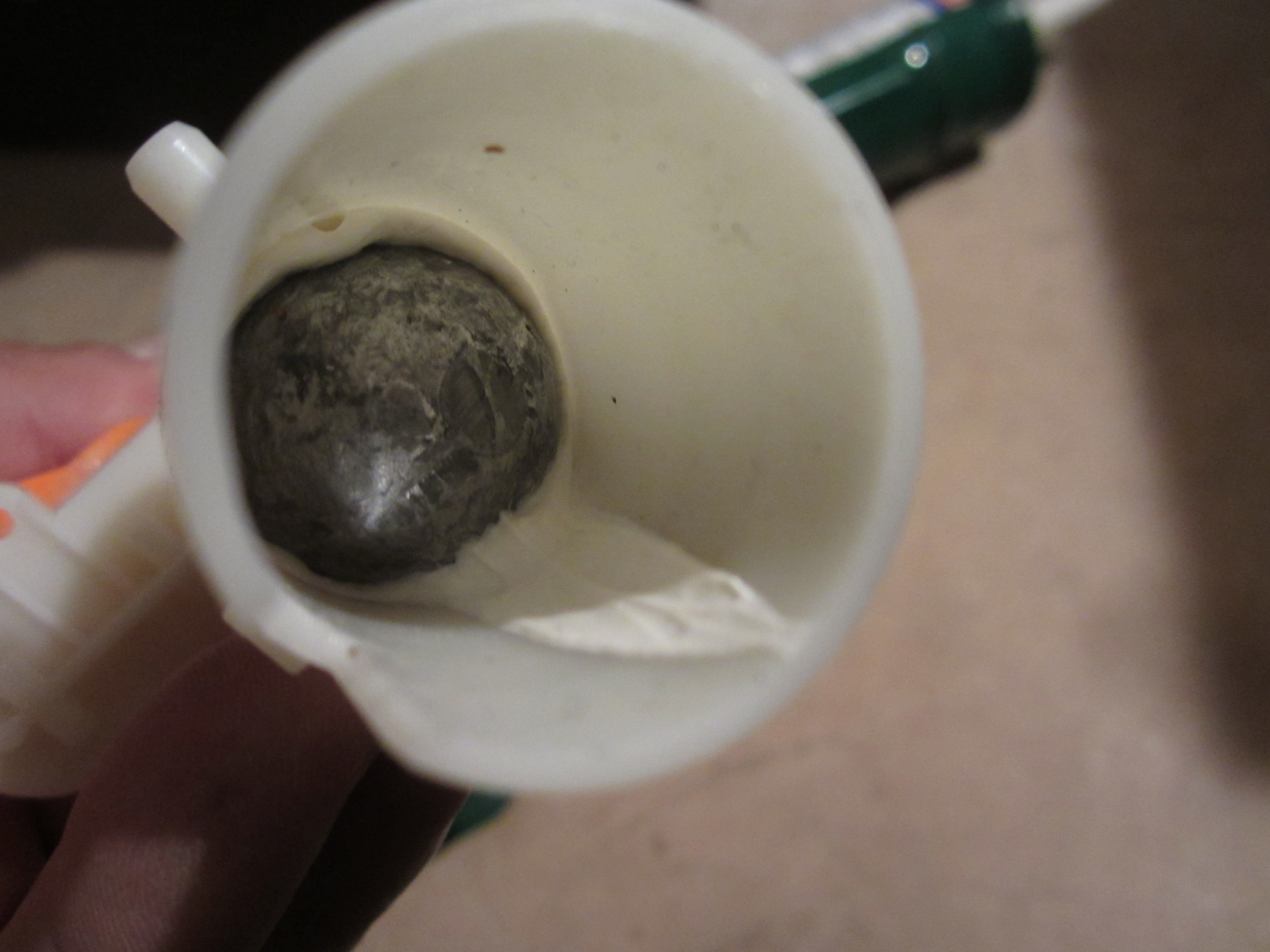

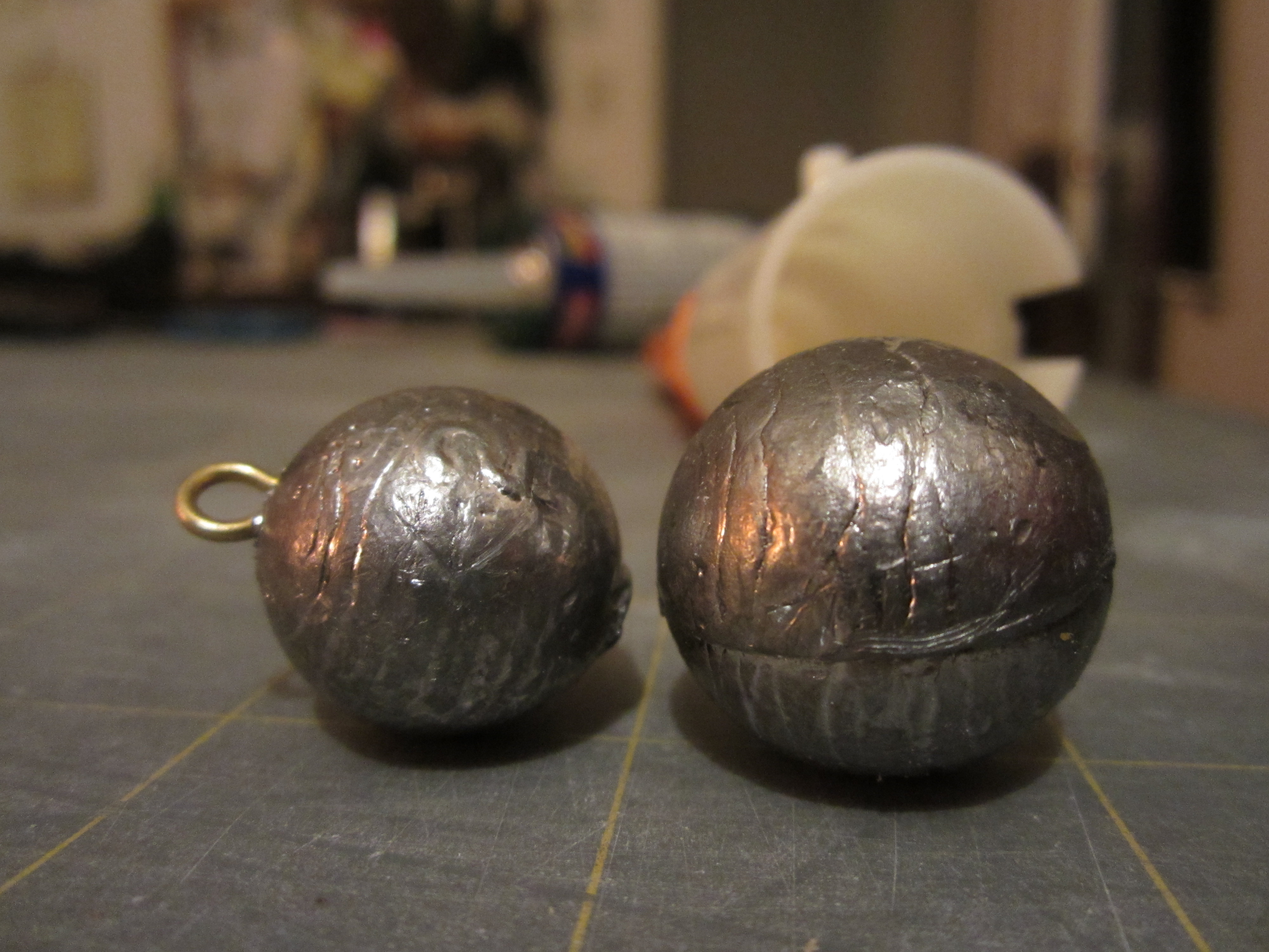

I've had to hold off on filling the rest of the holes in the handle of the Element Guns because I needed to find the right lead fishing weights. Like an idiot, I forgot to take a picture of the oblong weights I used for each of the barrels, but here's a shot of how they looked after I pounded the snot out of them to make them fit;

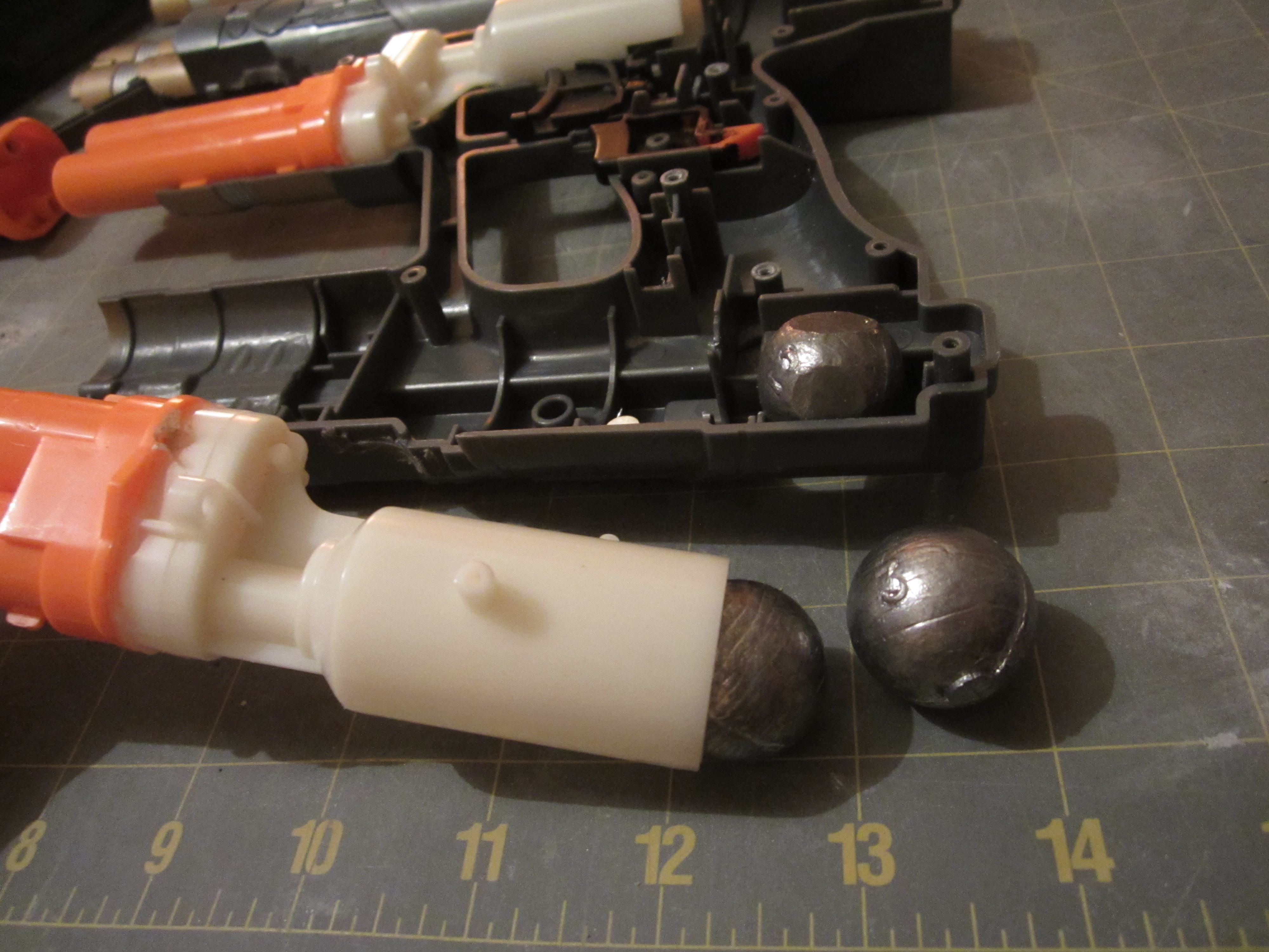

Next, I hammered the spherical ones into submission so they'd fit inside the chambers in the interior of the quad blasters. If you do this, pay particular attention to placement with the rear half of the cowls inserted in the last two images in this series...
You may notice the size of the weights for the air chambers were just a little bit bigger than for the body of the weapon.
I then used construction adhesive to keep them from rattling.
The triggers needed the same treatment. I'm not concerned with lights and such, just the weight so that when a kid holds it, well...'heavy' means 'real' which, I hope, will instill some grandeur as they handle it.

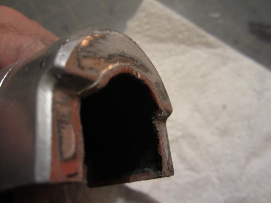

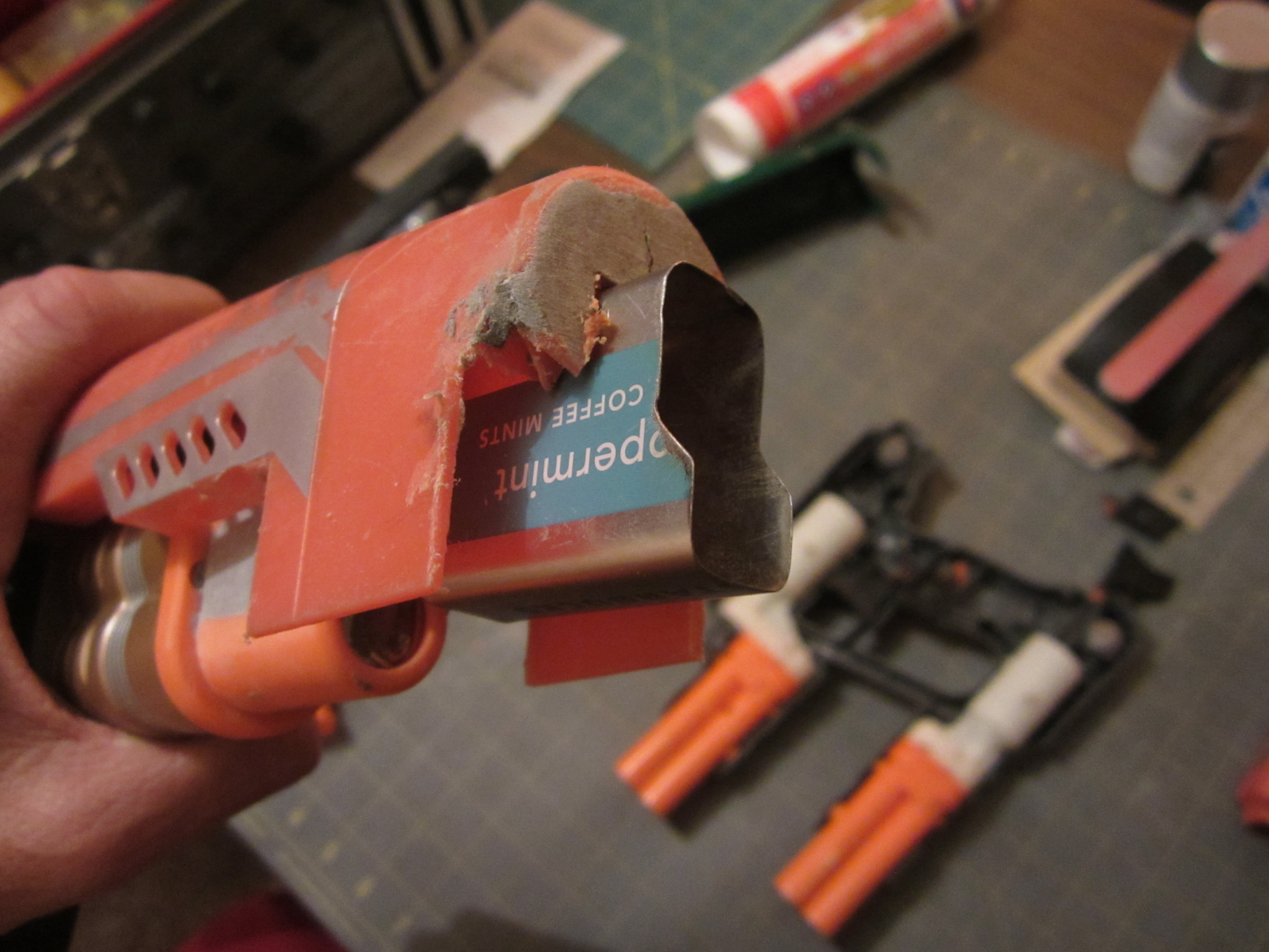

And finally, a sneak peek at how I'm handling the ends of each barrel...

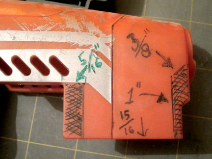

Soooo...It's been a while and I have been slacking with posting here on the RPF, so here's a quickie for those who were curious about the front of your Nerf Quad Blasters...there needs to be some cuts on the upper cowl.
The Shaded areas depicted in this, and the next image denote the material which need to be removed to approach a more accurate look for the top cowl.
I used that pink template but realized I probably would have people asking me questions about measurements sooo.....
Sooooo.....

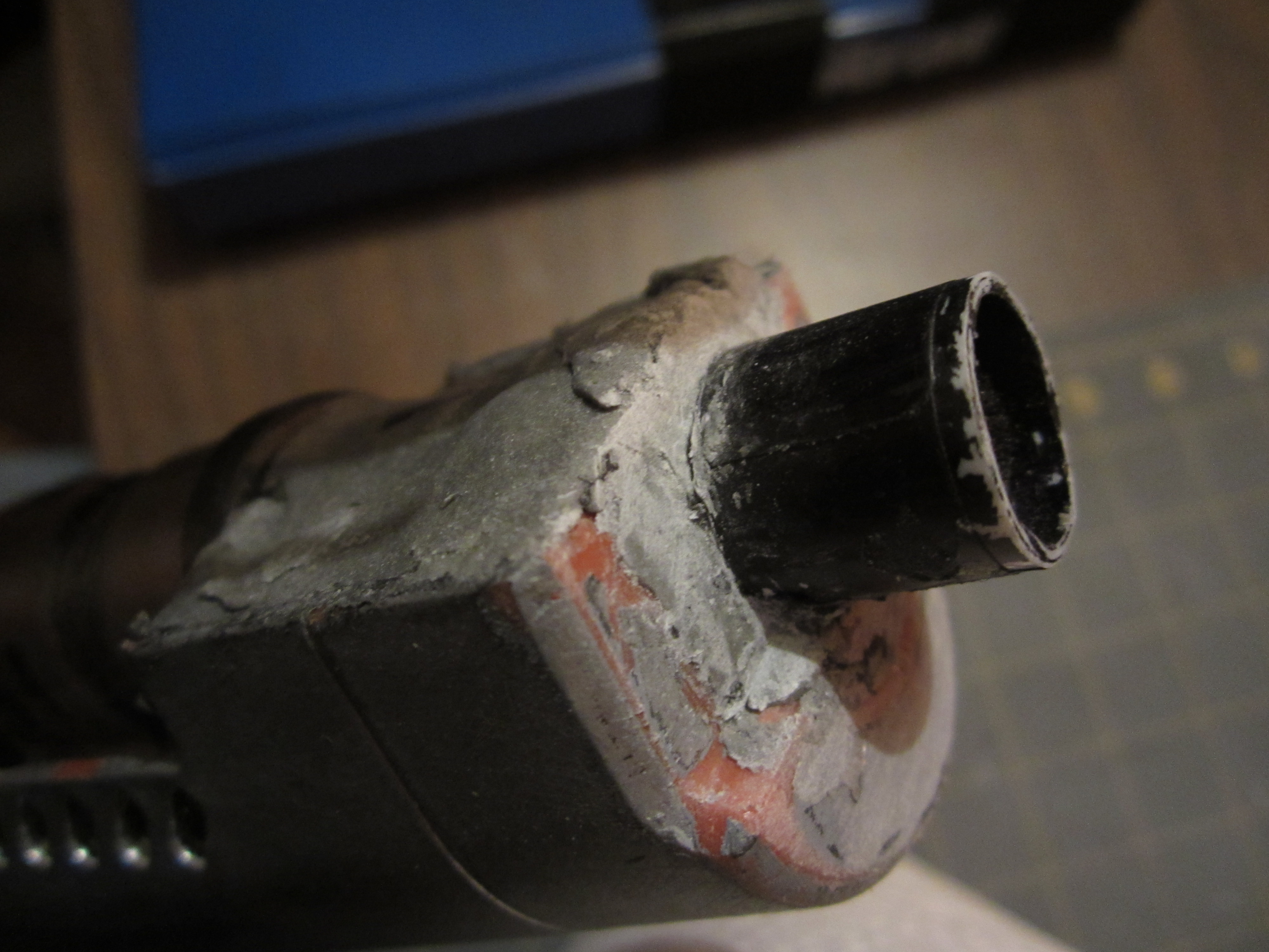

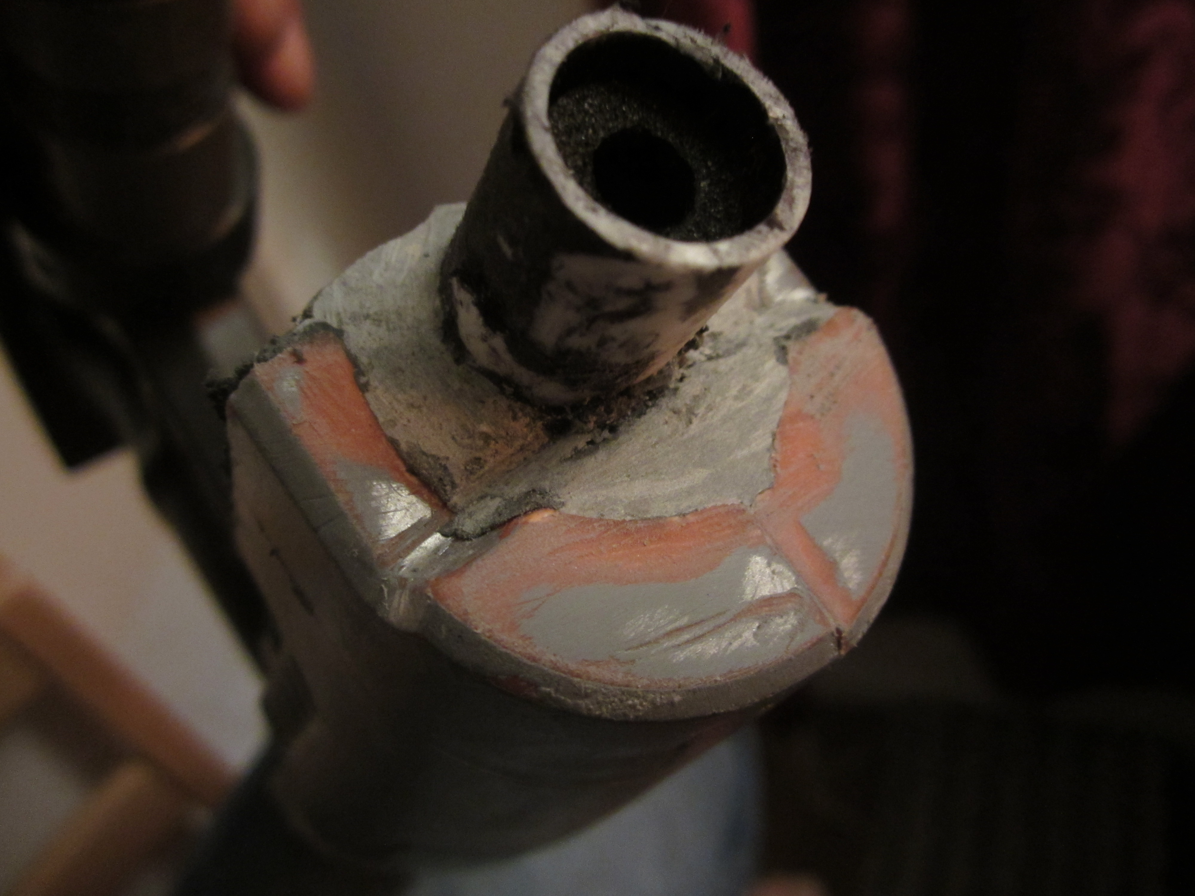

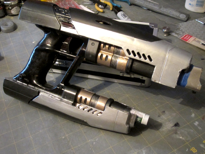

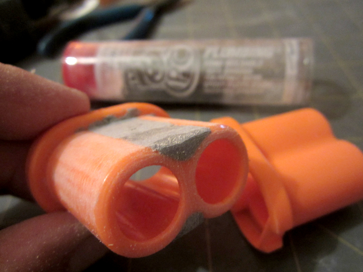

Here's a Photo Essay on how I'm converting my Nerf Quad Blasters into proper Star Lord Element Guns. I'm using Plumber's Epoxy and working pretty quickly with it because once it's mixed, it cures in five minutes. Five. As in; "ONE...TWO...FIVE! [three, sir] *THREE!*" Once this stuff gets super-warm, I have less than 20 seconds to manipulate it into place, usually, with a lot of force. #owmyfingers

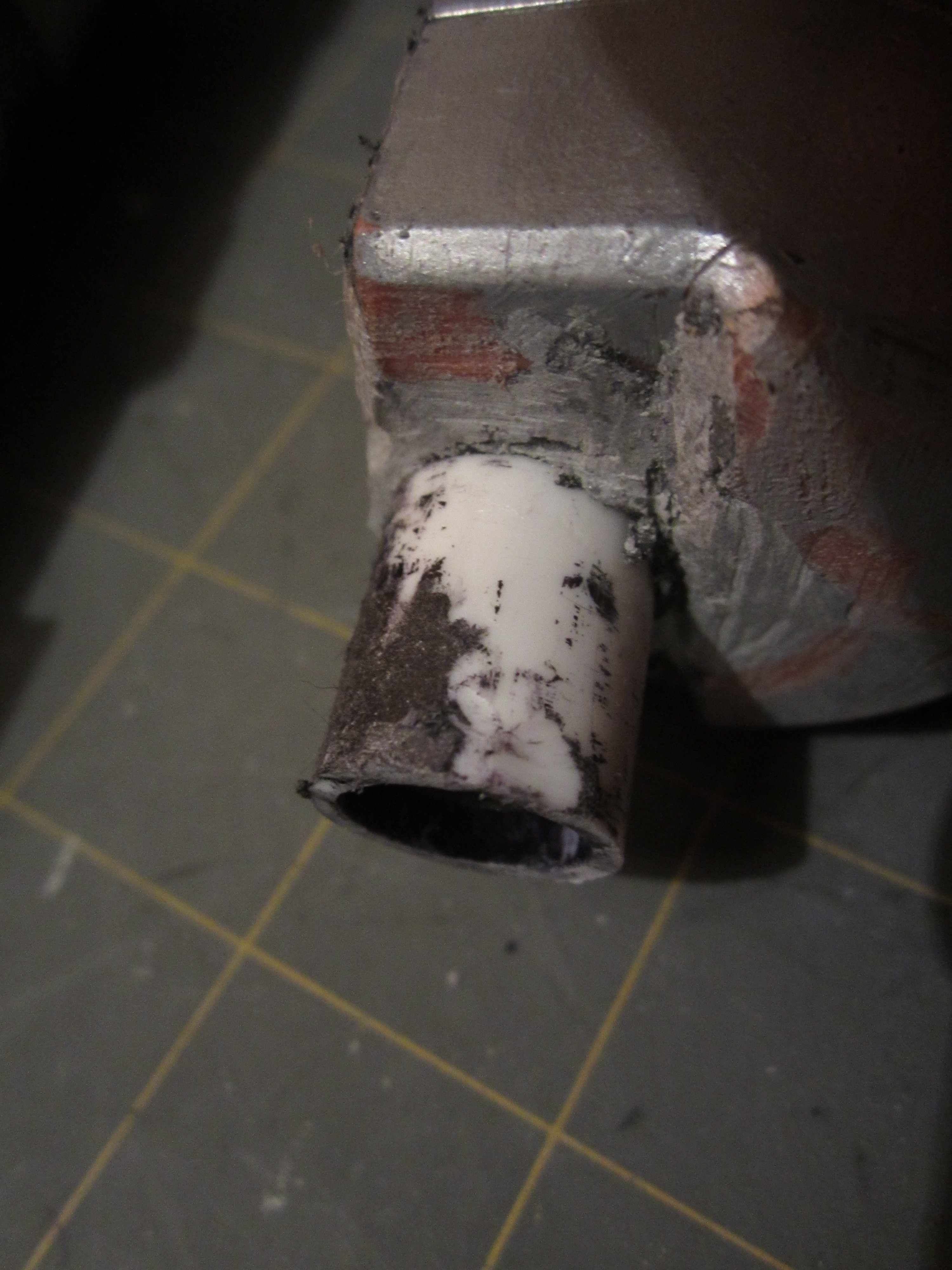

The lower cowl was moved back, glued down, gap filled and sanded smoother than an android's bottom. (ask Data). The tip had a small flange trimmed off and the empty space filled with construction glue, (which is kinda like Elmer's but in a calking gun tube). On top of that was the Plumber's Epoxy...because that stuff's not cheap. I also added a Krazy-Glue sleeve for the barrel. Lastly, (and you can barely see it), just inside of it there is a black Nerf Dart....you know...so retains a shred of it's original foam Rubber Soul?
And yes...the block of sanded Plumber's Epoxy is a little bulky. I know, I know...but I had to split for dinner out with the wife and mother-in-law shortly after I took this...
NOM.....urrp.
Currently, This one weighs in at THREE pounds and TWO ounces, the gun, not the Burrito, but it's a close second). I still need to add another two or so ounces to the top cowl tip.

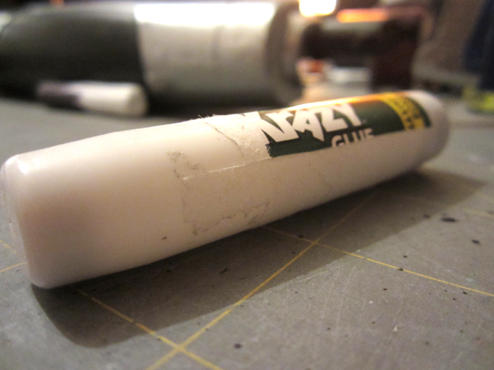

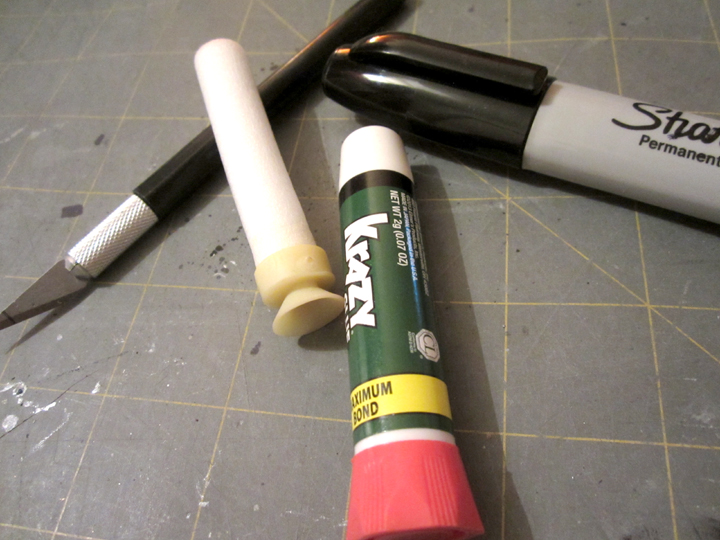

So, I made mention of the Nerf dart helping to retain a shred of the gun's original foam Rubber Soul? So yeah...here's the process...
First, eyeball that Krazy Glue container and have wicked-evil thoughts...

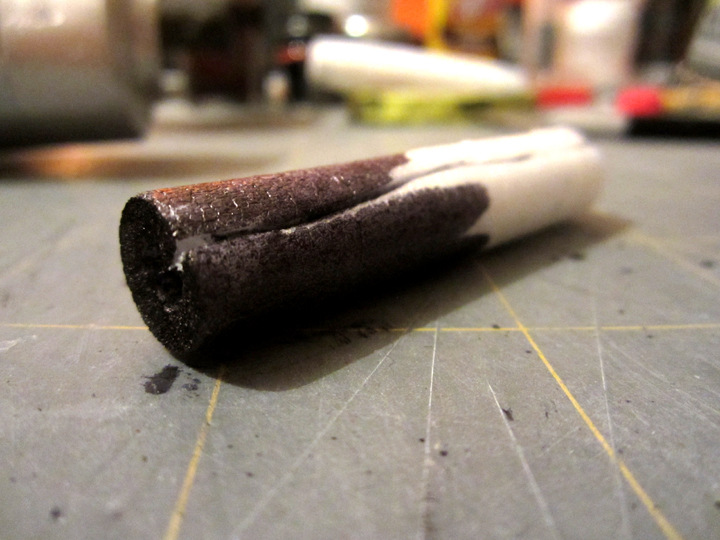

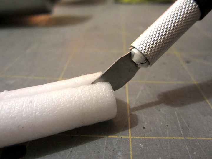

Next, decapitate a perfectly good Nerf dart. NARF!! (slice) gurgle gurgle gurgle....nArF?

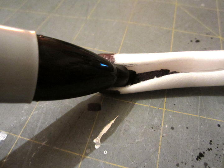

...and then eviscerate it. It had it coming.
Try to blame it on your sharpie.
Let it be...sorta.

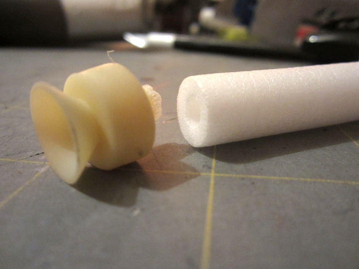

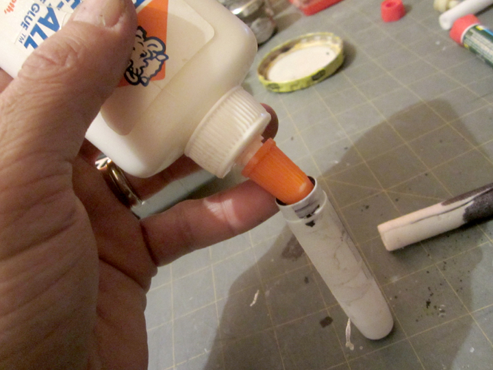

Next, strip naked. NO...the Krazy Glue sleeve you dirty minded...GAH...

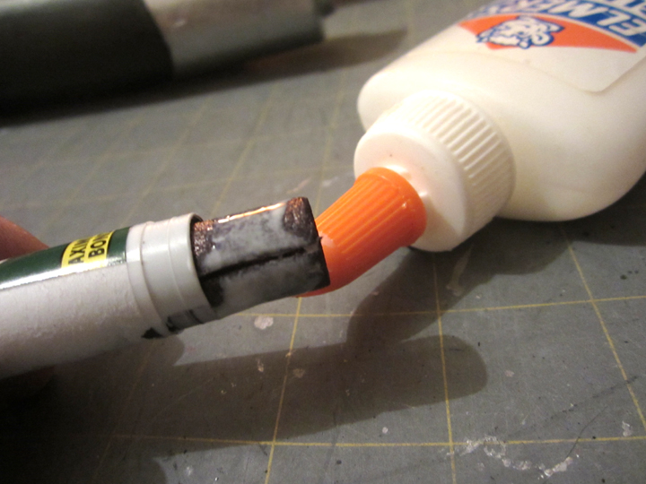

Oh...okay, so you can be just a little dirty minded. (tab 'A' Slot 'B' etc...)

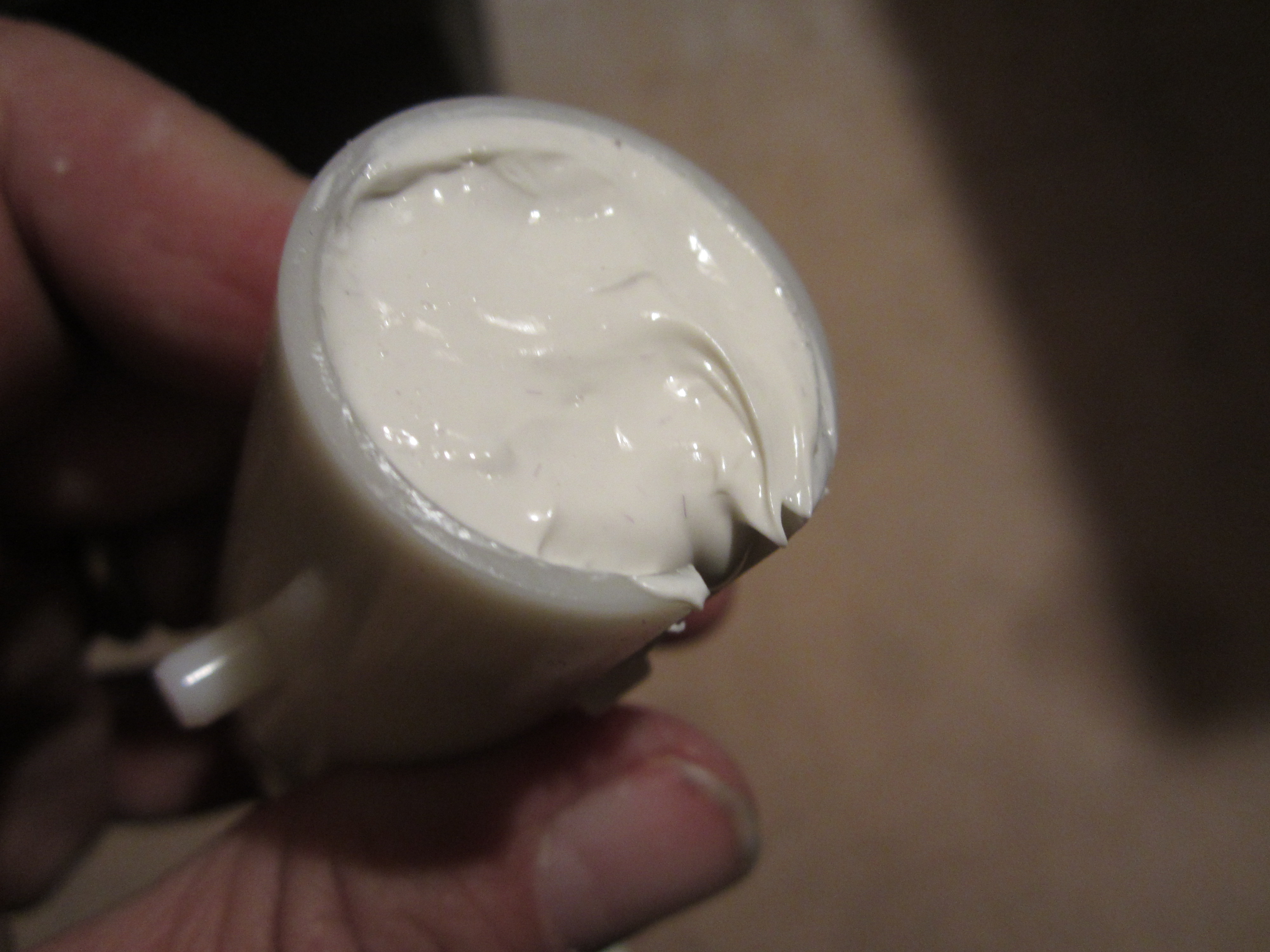

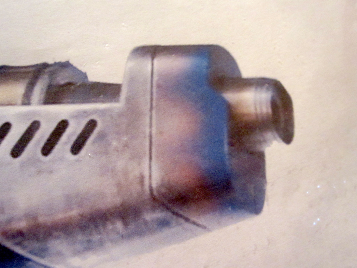

Take a gander at the real thing...
Then see how well you did.
11 Glued to Element gun.JPG ...but if you'll remember from above, I forgot to trim off that flange on the tip, there, so that very cool looking bevel on the end of the Krazy Glue sleeve went bye bye....sadface. I may actually replace it, entirely, with a bit of aluminium tubing after a very carefully executed drilling of that plastic bit....maybe.
