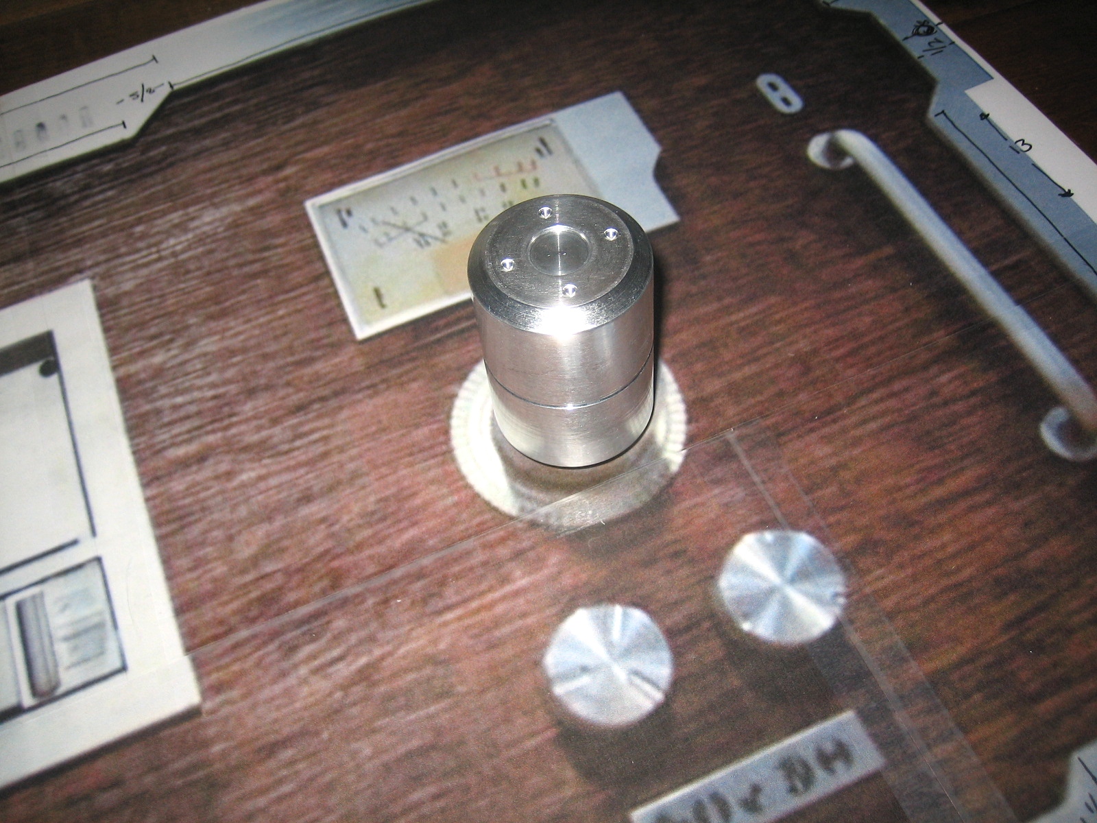

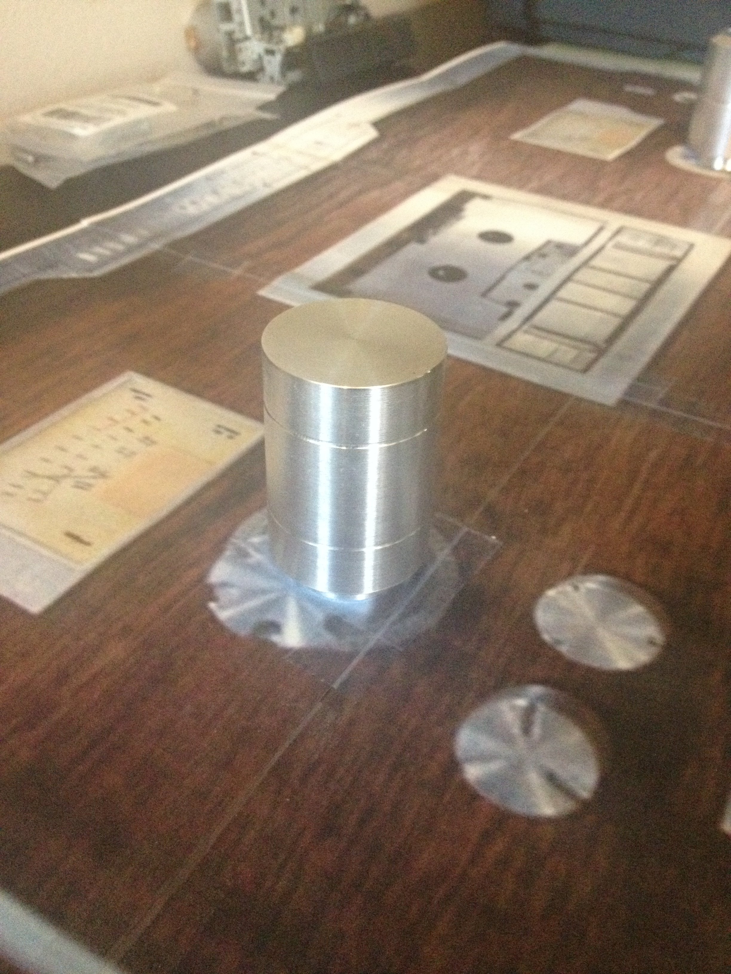

i guess, im machining knobs soon but i really want to know if if the bezel behind the large knobs are a found object?

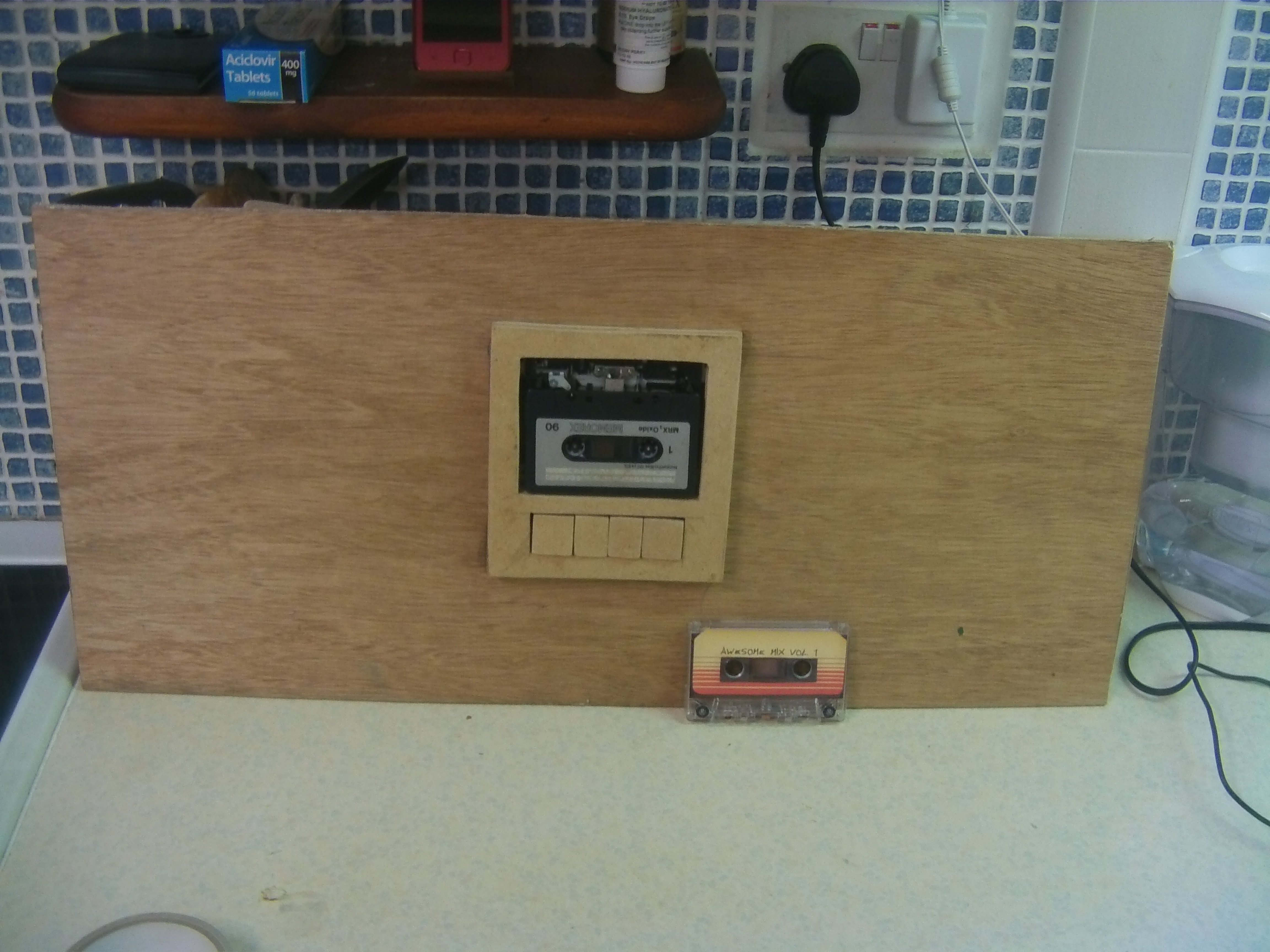

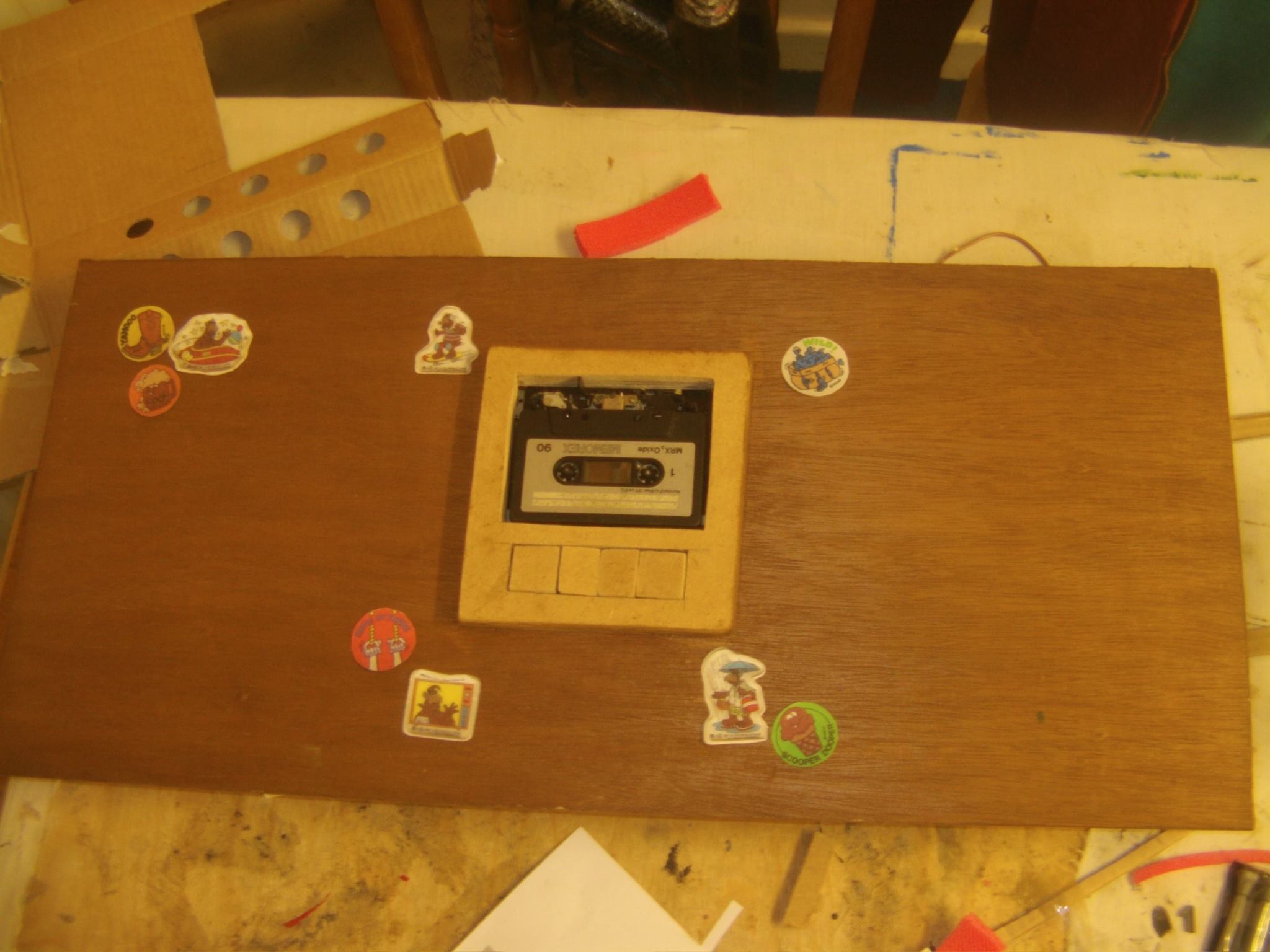

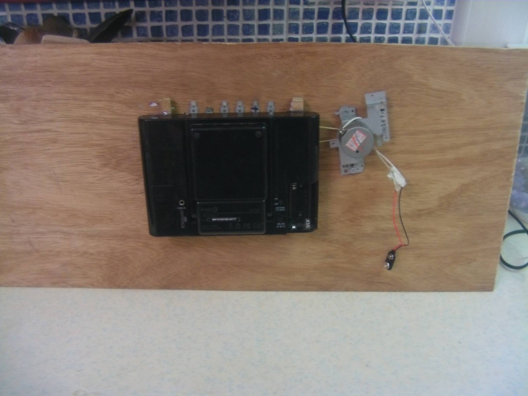

ive been working ion my own replica tape deck its not entirely movie accurate but im working with what ive got
10688048_987823181243505_2076951205001184907_o.jpg1781074_987823244576832_2306054697420807237_o.jpg10494986_987823227910167_1263602133298289338_o.jpg10003684_987822797910210_2295538017664241040_o.jpg
the cassette is set up so you connect a 9v battery and it starts to turn but does not play anything it mnake it look like the sound is coming form the cassette. Ive got an mp3 dock glued in behind the back (the black rectangle) so it can play the music. The buttons under the cassette control the the power and volume of the mp3 dock.

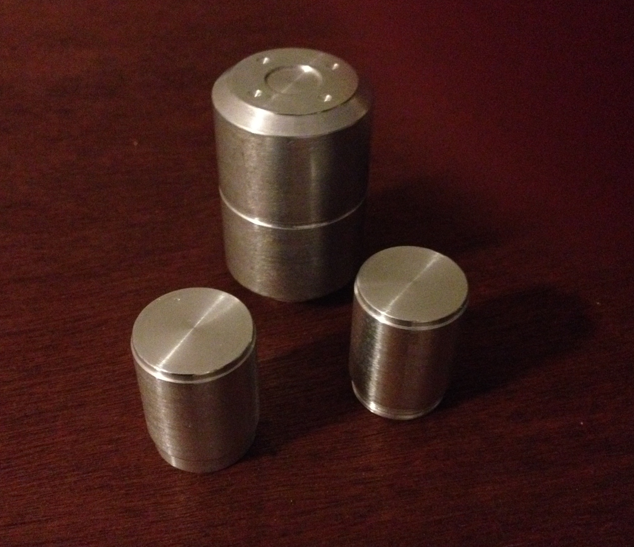

That looks great Cameron, is that polished in the tumbler also? I like that it didnt take away all the machining lines.
Thanks. Yes. It's polished in a ceramic chip polisher on slow for an hour. I checked it every 15 until it got to a point where I was satisfied.
