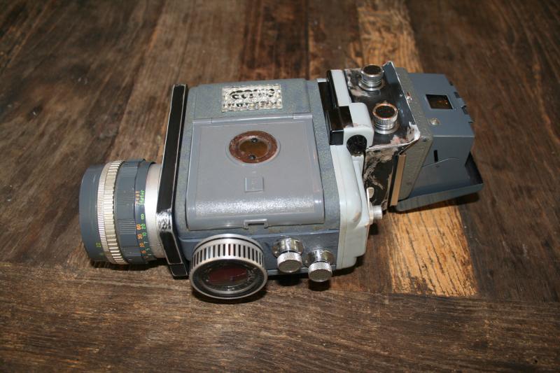

Mounted the lens plate to the Eumig

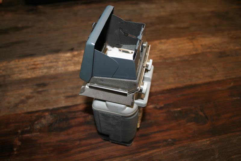

Mocked up T box and view finder
Yup transition box to be made too. My local fabrication shop I use with work has just bought a lazer cutter that he is dying to play with. I was planning to give him the template for the box to do. I,ll quite happily get him to run off more than one, I'm sure there is a template on one of the tutorials but it has no sizes on it.

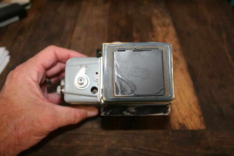

Painted and weathered the transition box, installed the Seagull knobs (yeah I know), and mounted it to the Eumig using the original brass screws that held the lens bracket that was stripped.
I used the screw holes in the chrome view finder bracket, tapped the transition box holes, and my shim with some of the throw away screws from stripping all the cameras. So far my macros are all metal and no resin parts.
I still need to make the pie shaped box with the mesh end and the knob from the stripped Eumig that goes next to the transition box and the mystery box. I'm really happy how this is coming out for my first Star Wars prop

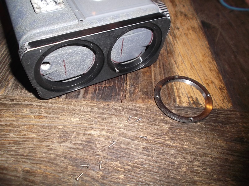

So I figured out how to mount the lenses to the aluminum RussRep lens plate. RussRep did a really amazing well thought out design on his plate. The Kalimar camera is basically destroyed in this build, so I prayed off the raised plate around the lens to release the threaded ring the lens threads into. And what do you know, RussRep machined his plate for this part....I feel so stupid! LOL, I'll find the screws and mount it up tonight with some pictures. I guess all it takes is another thread to motivate me, one more step closer to finishing this build. I still need a few parts and one more Kalimar
