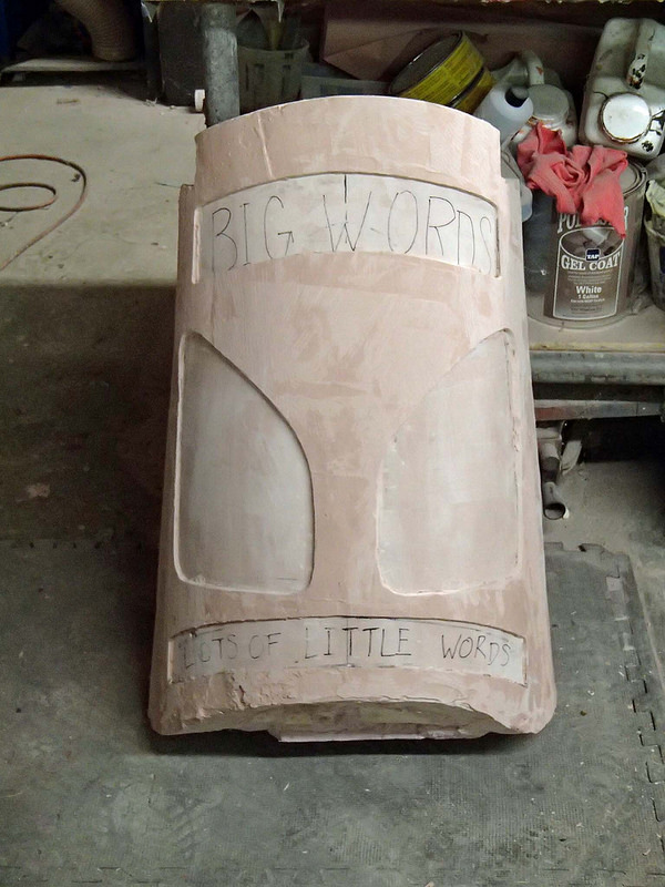

The chest sculpt still has a long ways to go:
But it's still shaping up to be huge:
