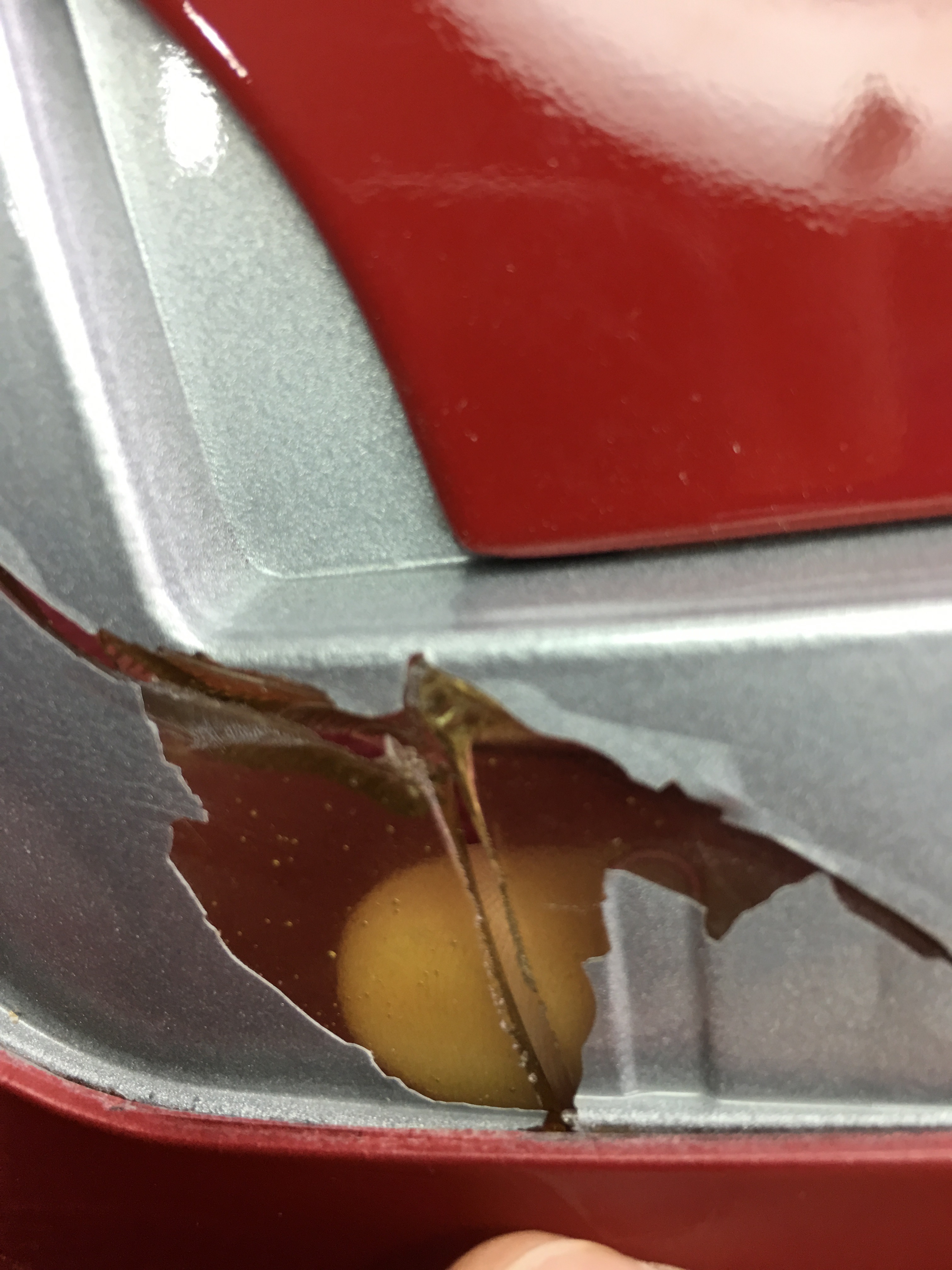

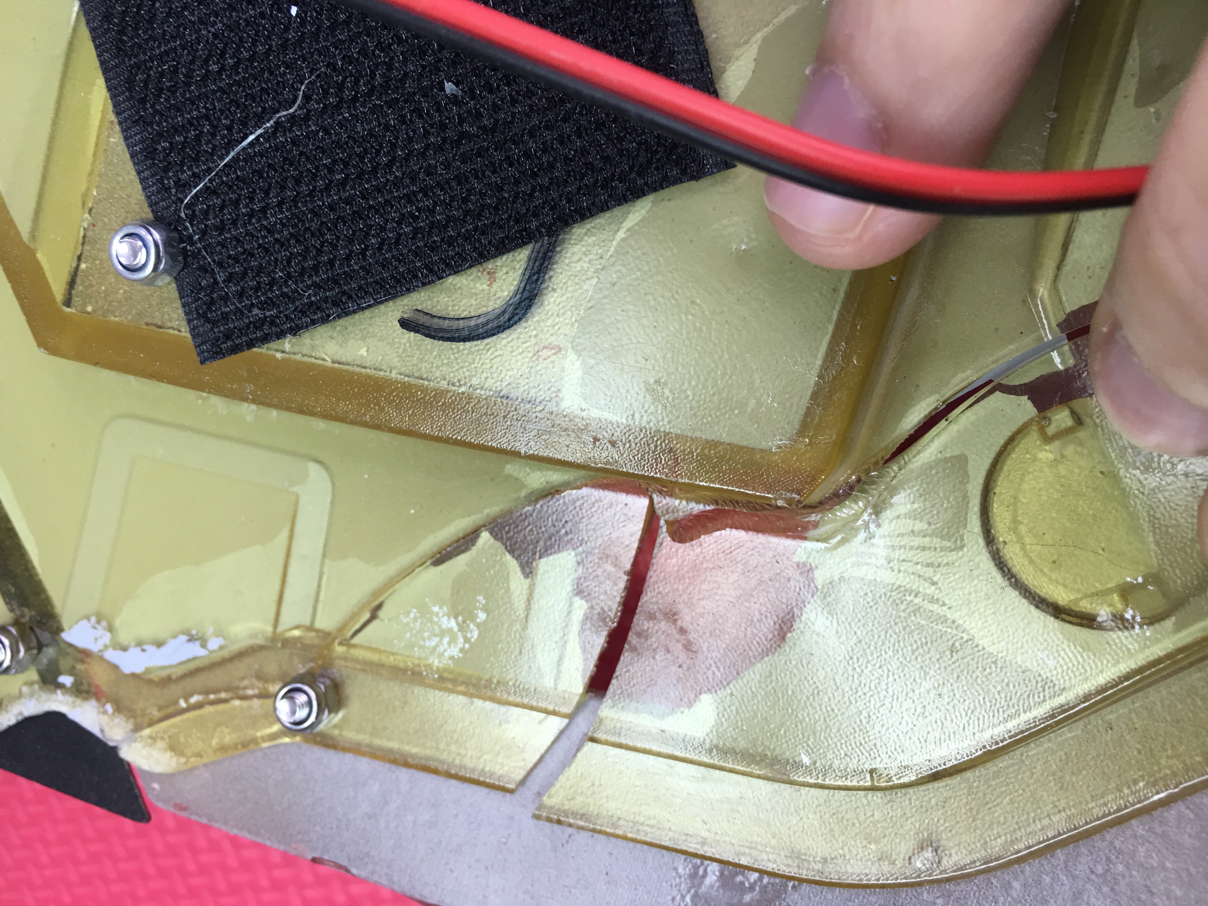

I'll show u the front crash the back one is worst :(
Some people recommend me this glue (they told me that is only for proffesional sector, is expensive, rare to find, but stronger and clear) what u think?

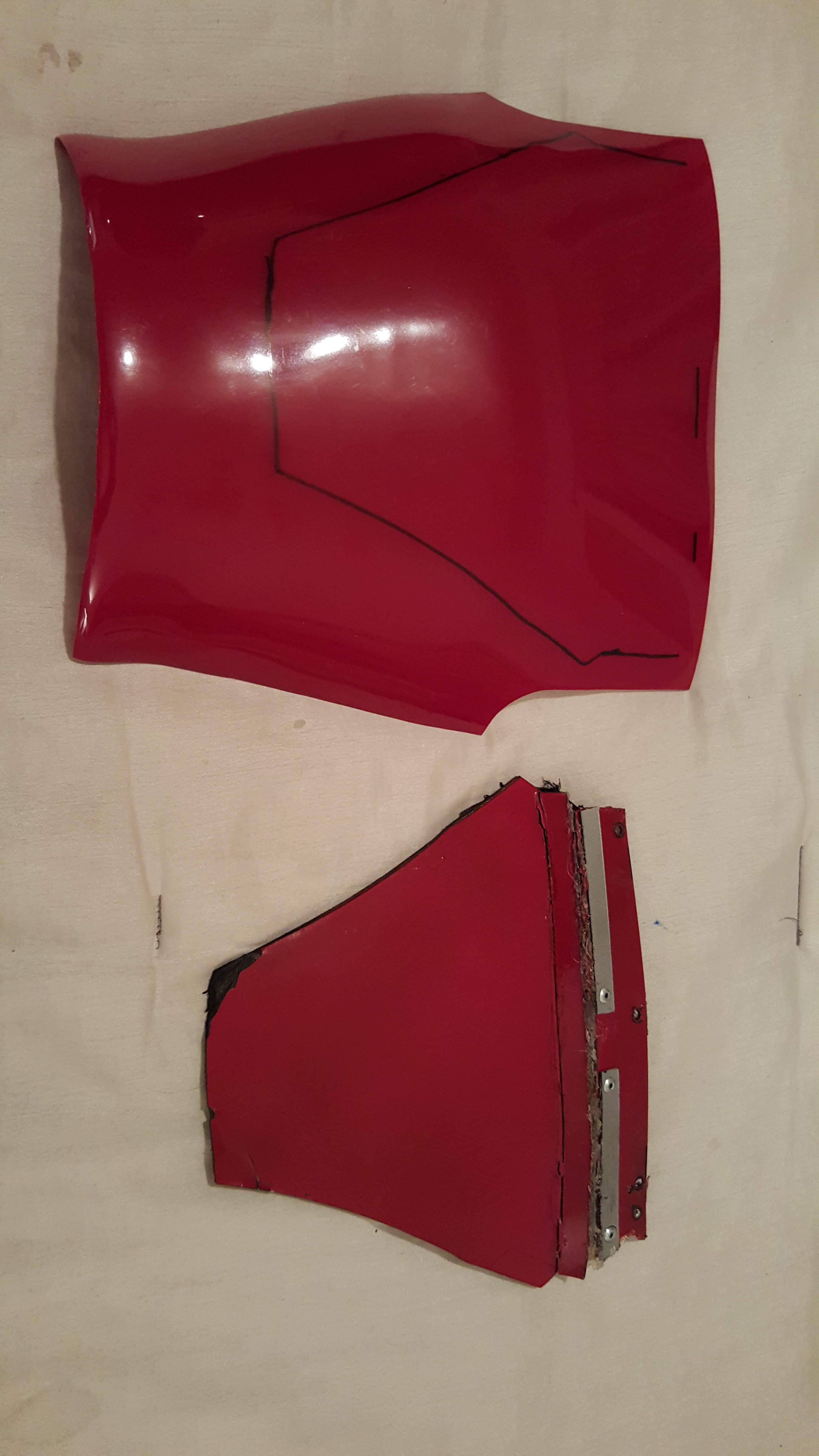

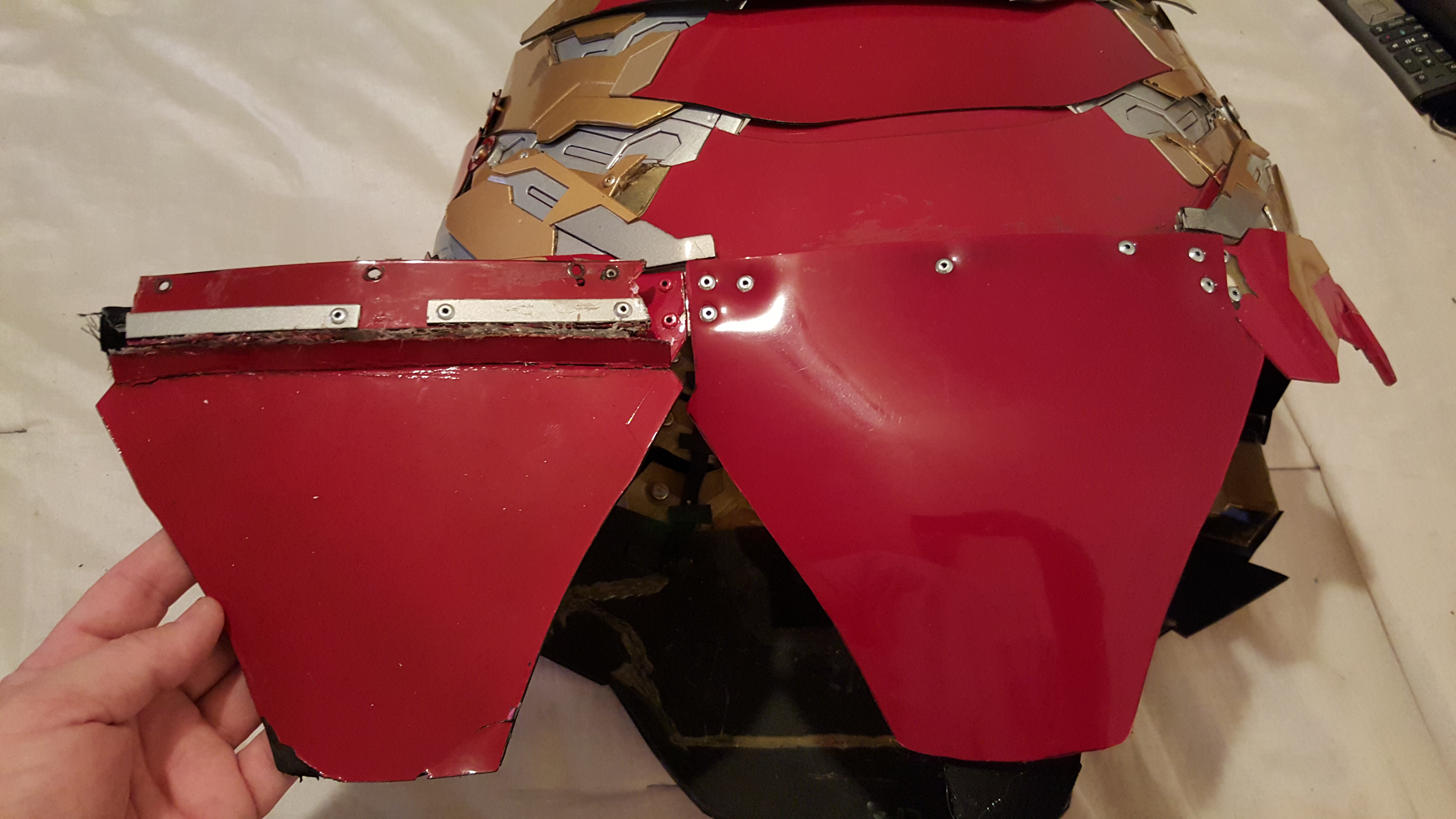

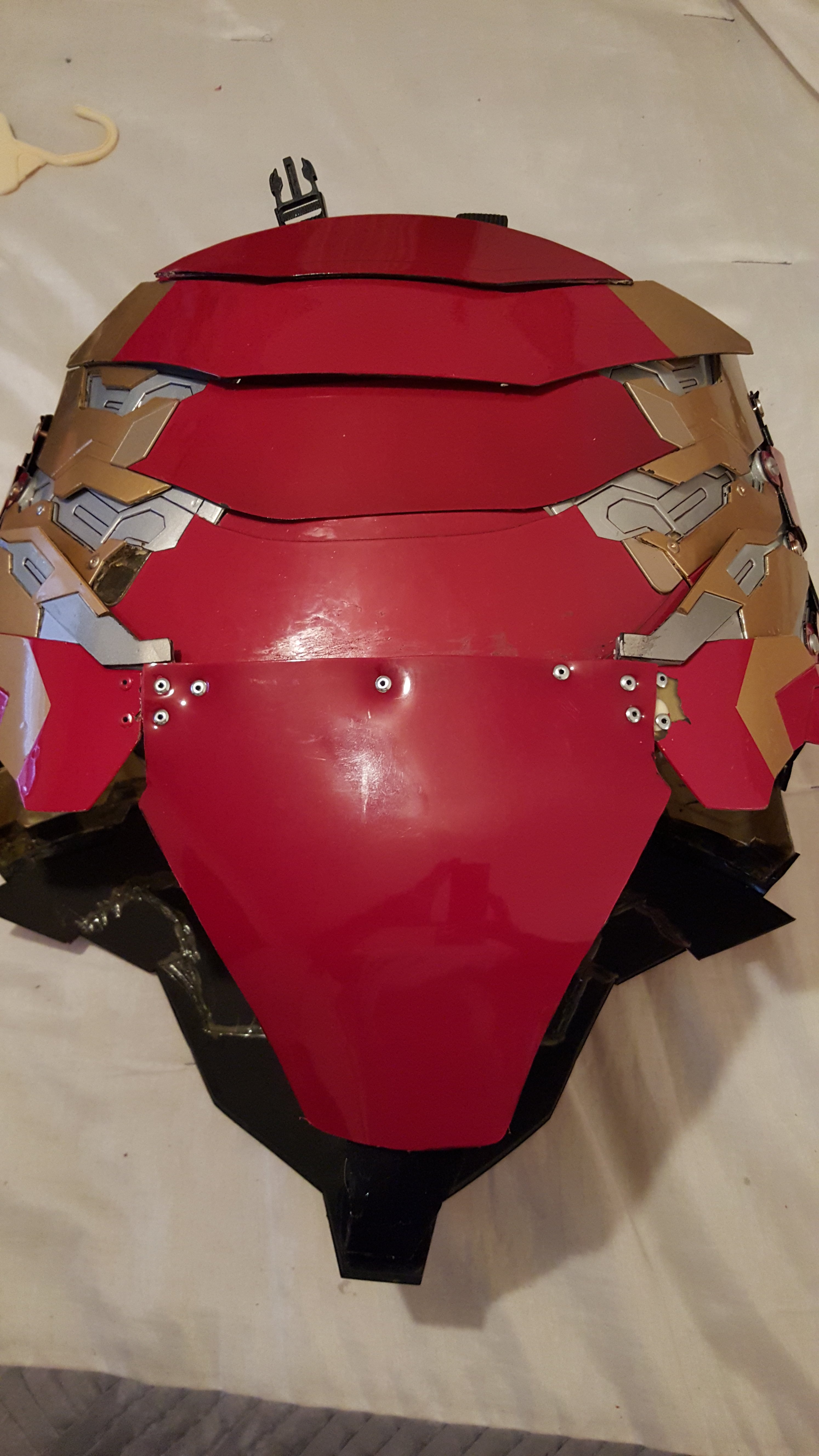

Shade...I studied your pics very closely. With how that split looks like you might want to use either a metal or strong piece of plastic to use as a bracket and rivet each side. Once connected fill in the gap (if any) with epoxy to give it the extra strength. Once it's dry smooth out the surface then paint. Should look good as new. The rivets will give it a machine look and blends in nicely so it won't look tacky.20160107_185647.jpg

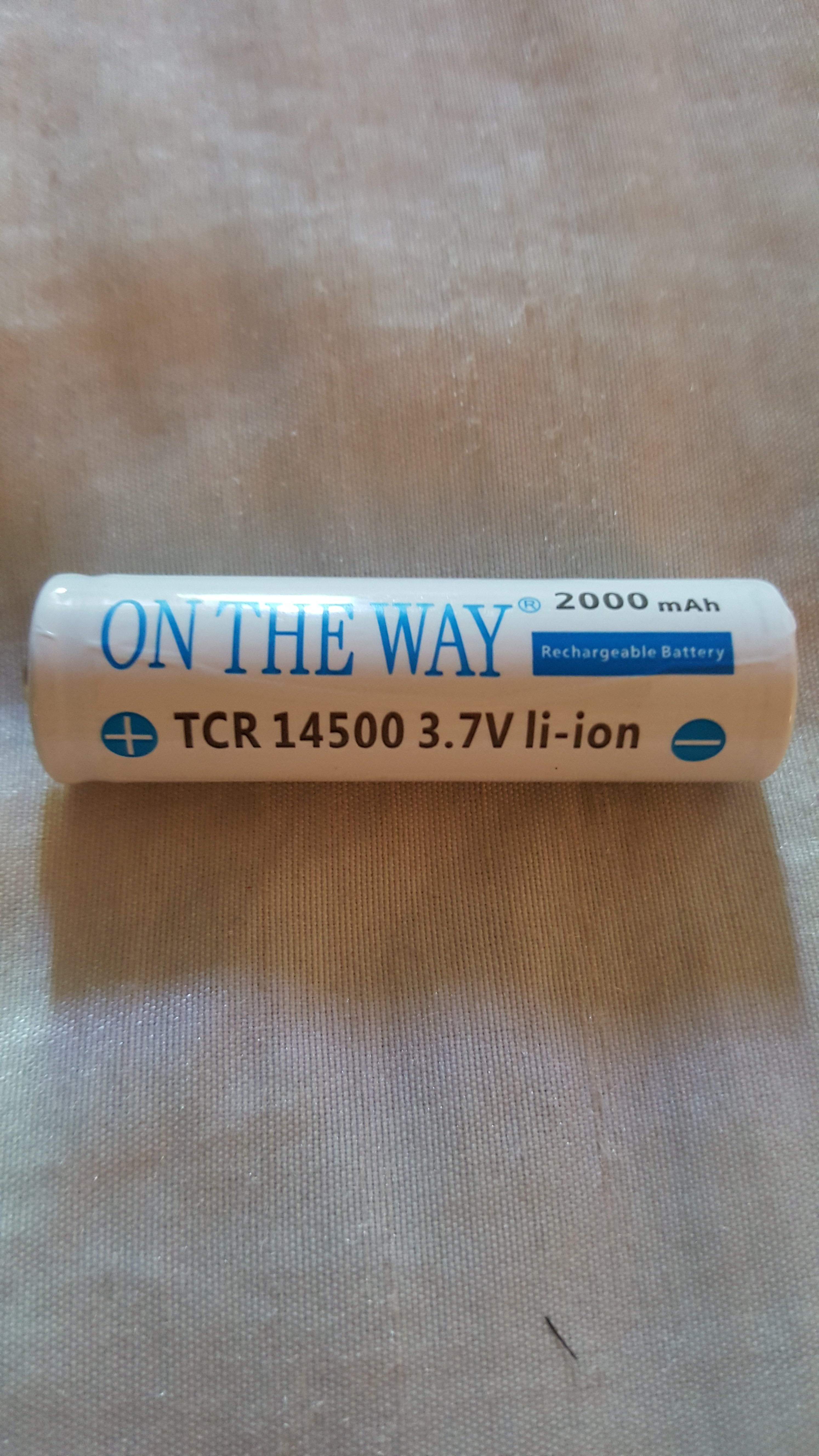

Hi guys, those who received the suits the electronics won't work! The front arch works with the two AA batteries, but when i put in the 4 AA batteries at the back where all the electronics are, nothing turns on? Is there any other switches or batteries needed somewhere inside? Help!
The chest piece is the only one that runs off of AAs, the rest of the suit needs 14500 Batteries. Silly I know, similar size to a AA but 3.7 lots instead of 1.5.I'm using 800mAh XTAR batteries, they seem to work well for me.

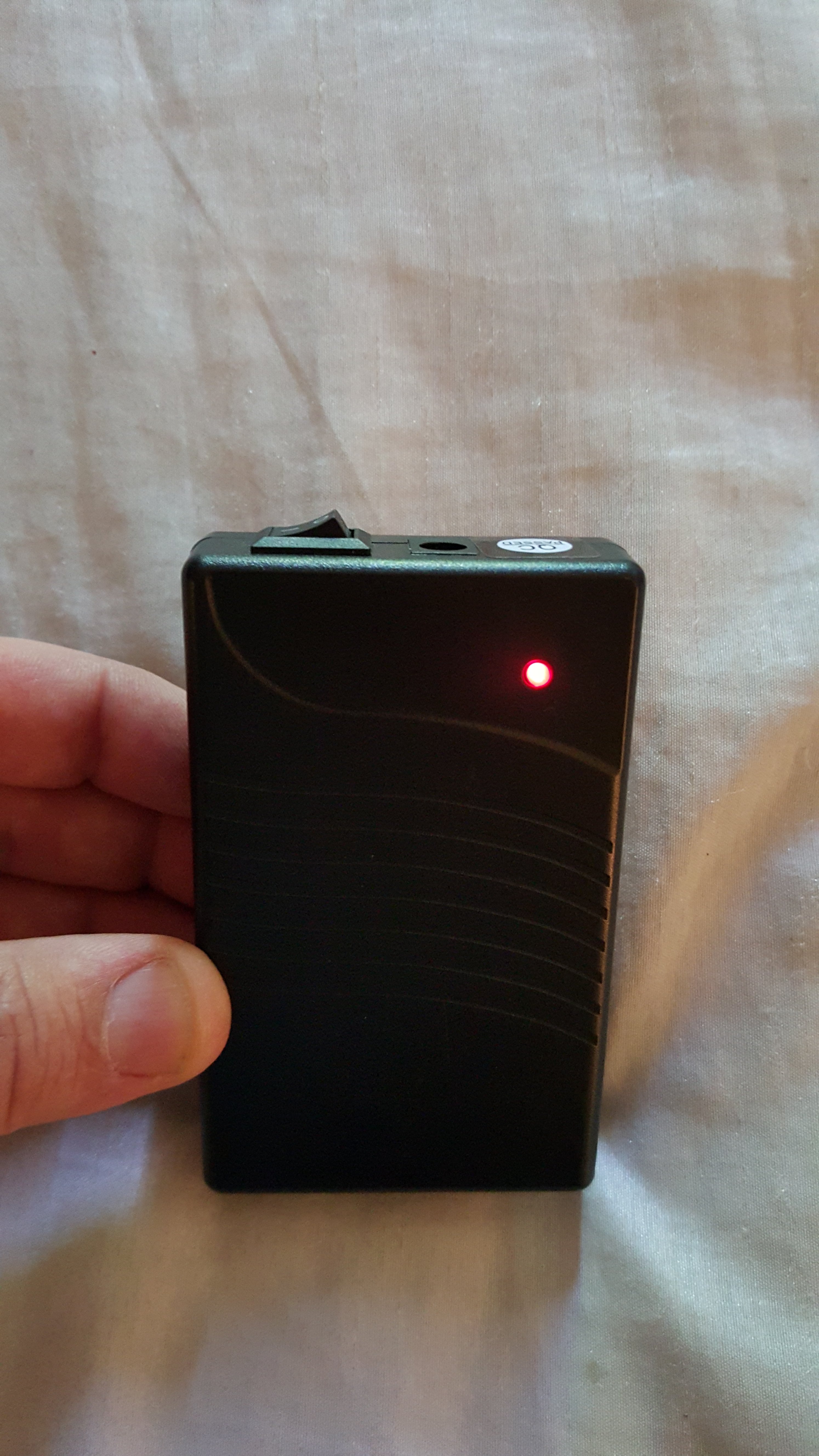

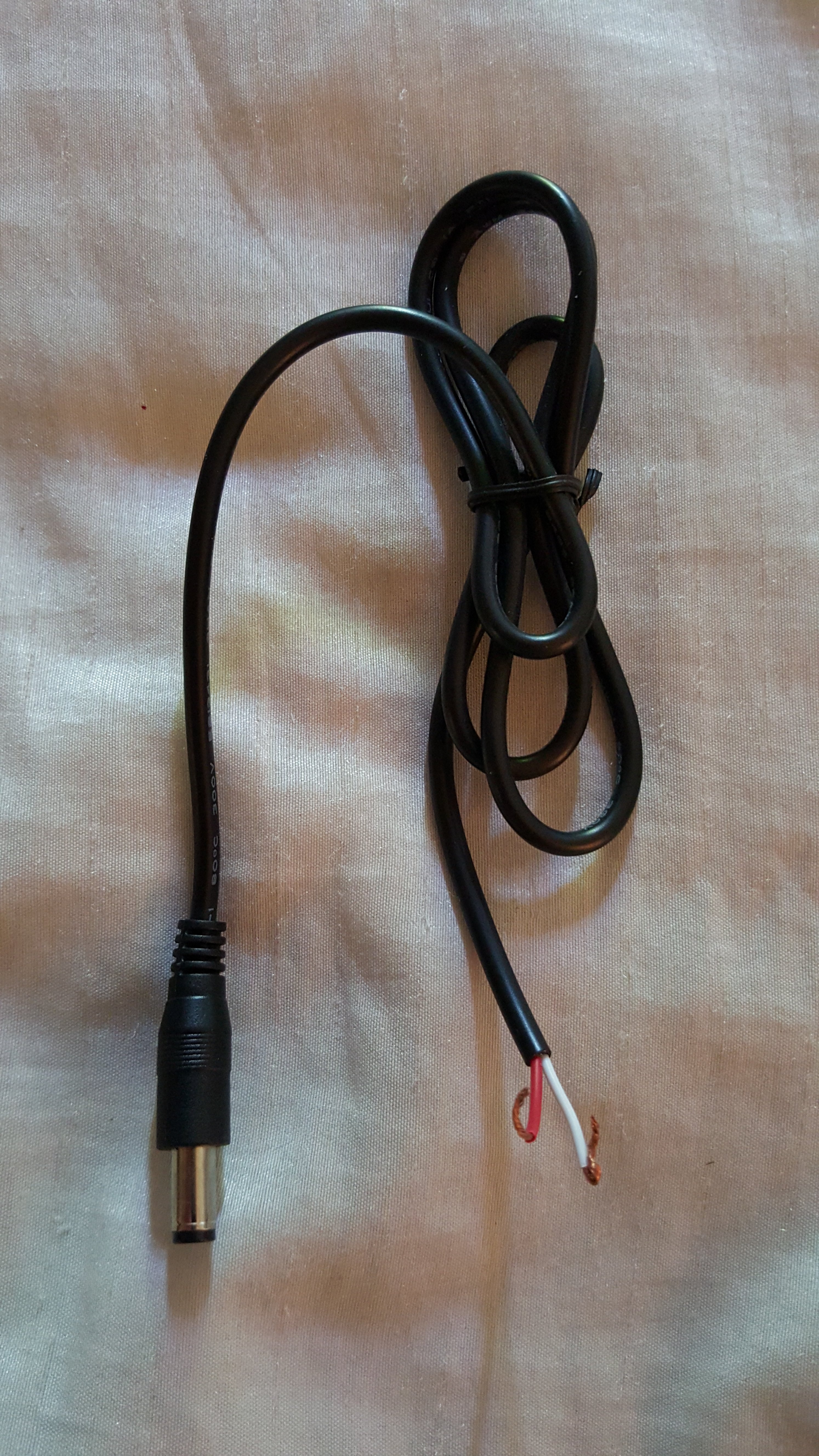

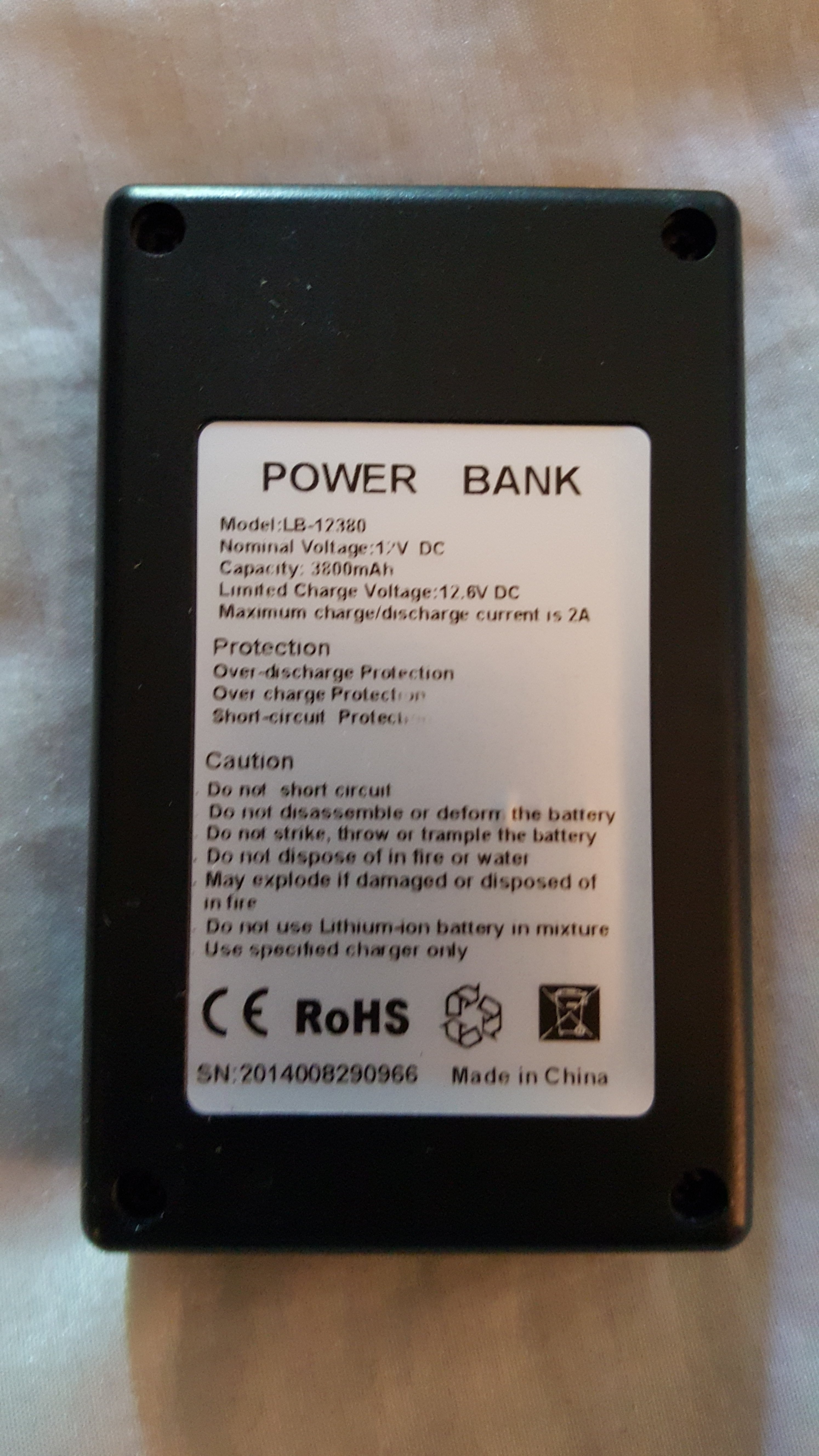

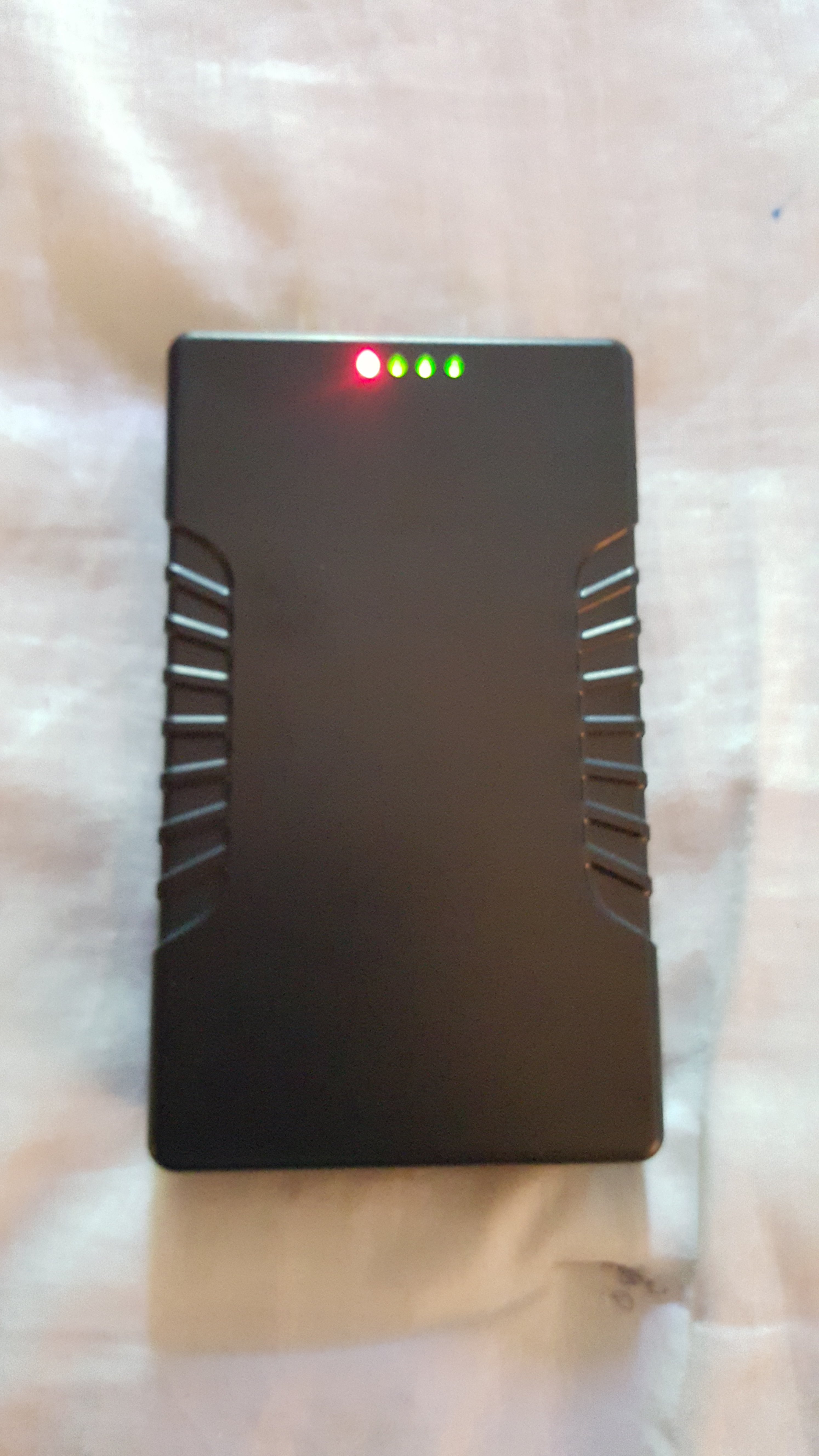

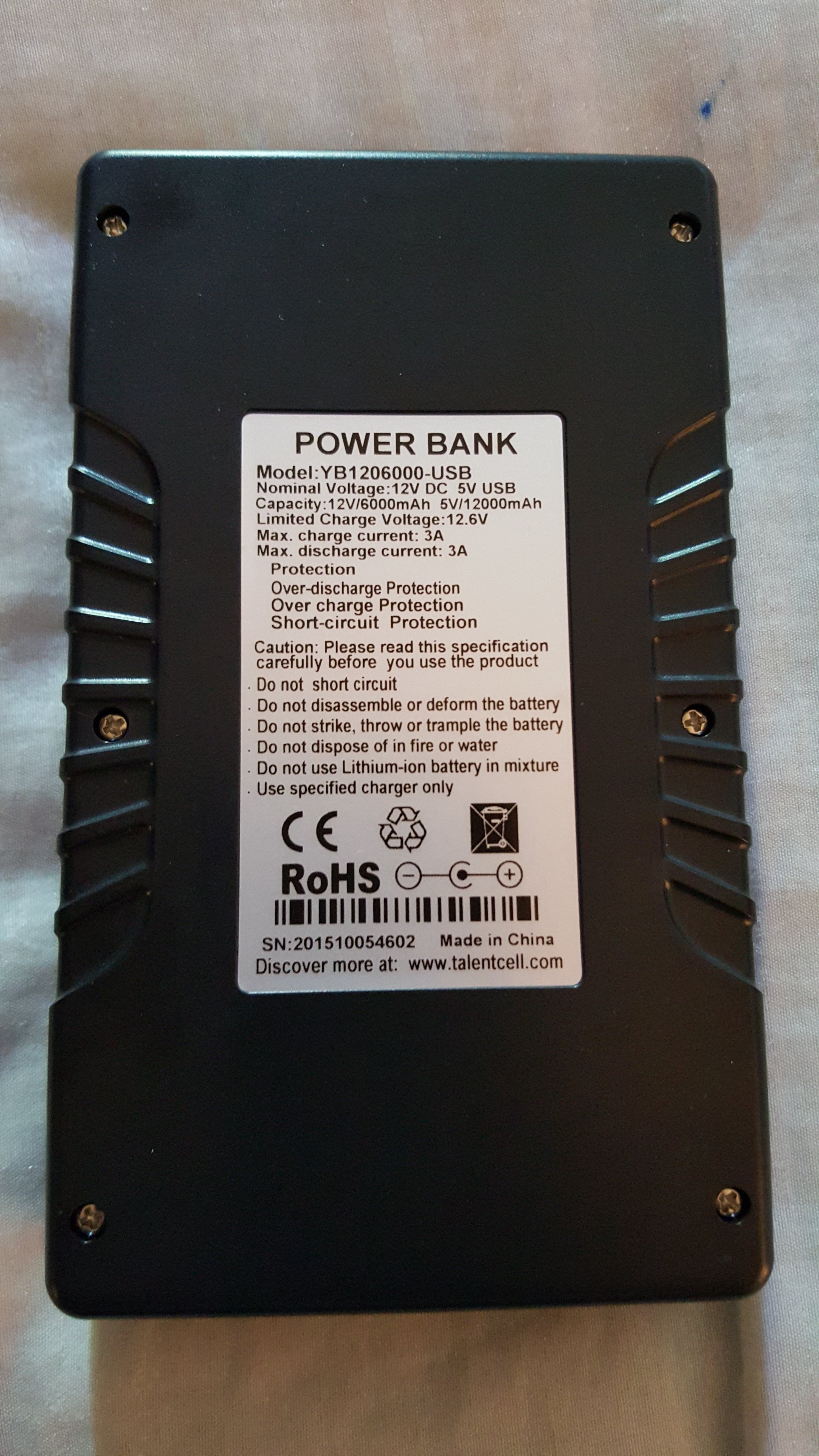

Determinazn...I've switched from the 3.7v AA type batteries to a 12v power pack. The batteries were only giving me about 3-4 hours maximum usage so I now I'm getting around 12+ hours of usage between both packs. I have one smaller than the other due to capacity. You can find these on amazon. Here's the pics...
20160109_113045.jpg20160109_113103.jpg20160109_113122.jpg20160109_113149.jpg20160109_113203.jpg20160109_113235.jpg20160109_113303.jpg
Best check with them, I was originally told either the 18650 or 14500, which made no sense as they are different sizes. I went with the 18650s and checked with them before they sent the suit, they said it was fine, subsequently it looks like they cut and extended the battery pack to fit them.

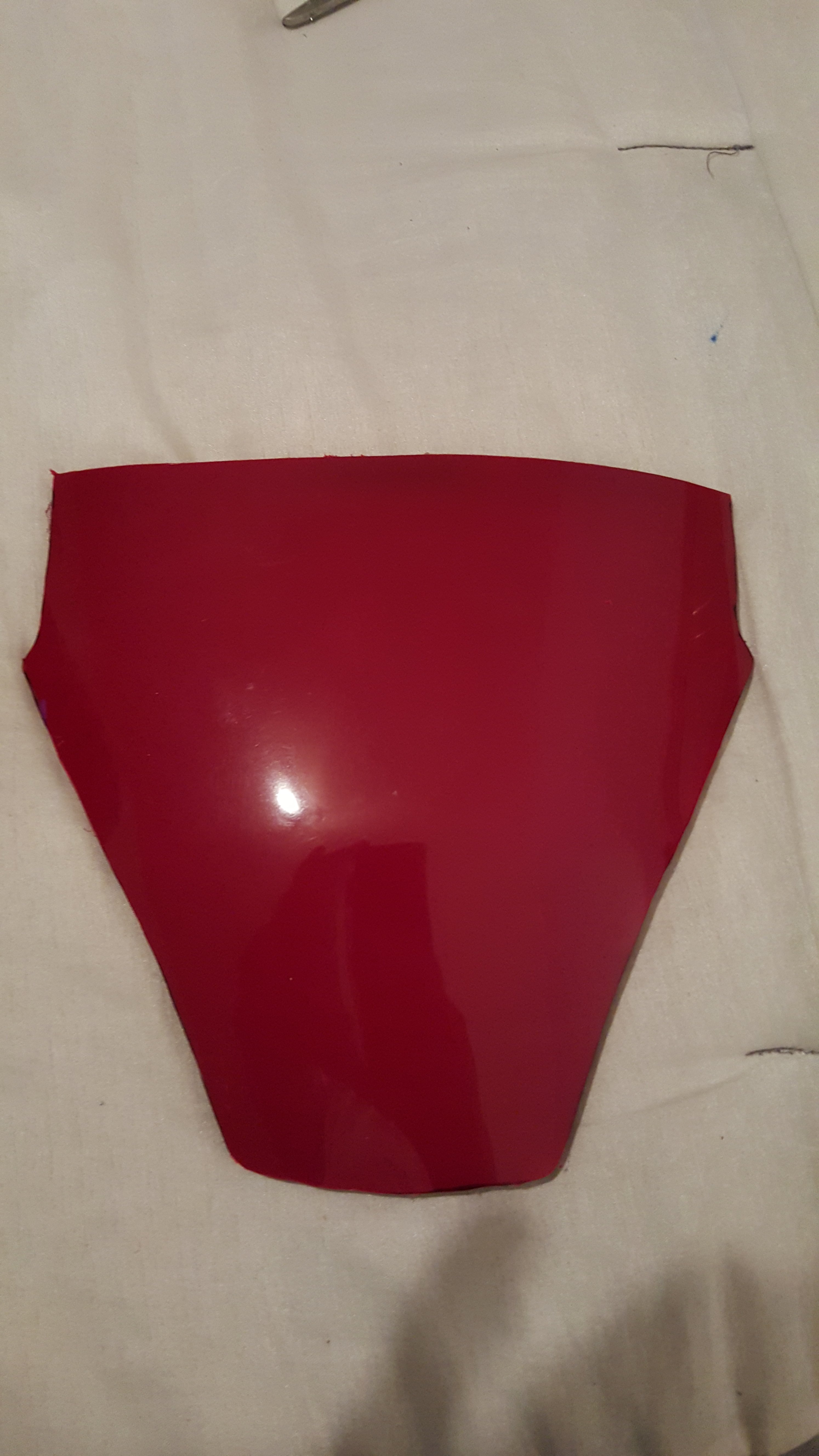

Guys...keep in mind you have a power converter. I metered out the battery pack with the 4 3.7AA types and got 15.8v. The new power packs I bought only go to 12.5v and they're a higher capacity so the battery life is alot longer. I'm doing this because I stay at the conventions a very long time and changing batteries isn't the easiest thing right now. I just ran into another problem last night...my cod piece ripped on both sides so now I have to rebuild a new one. Luckily I have some left over materials from my shoes when I modified those. I'll post pics later tonight. PS...James you still have $#!@ materials and poor building skills.

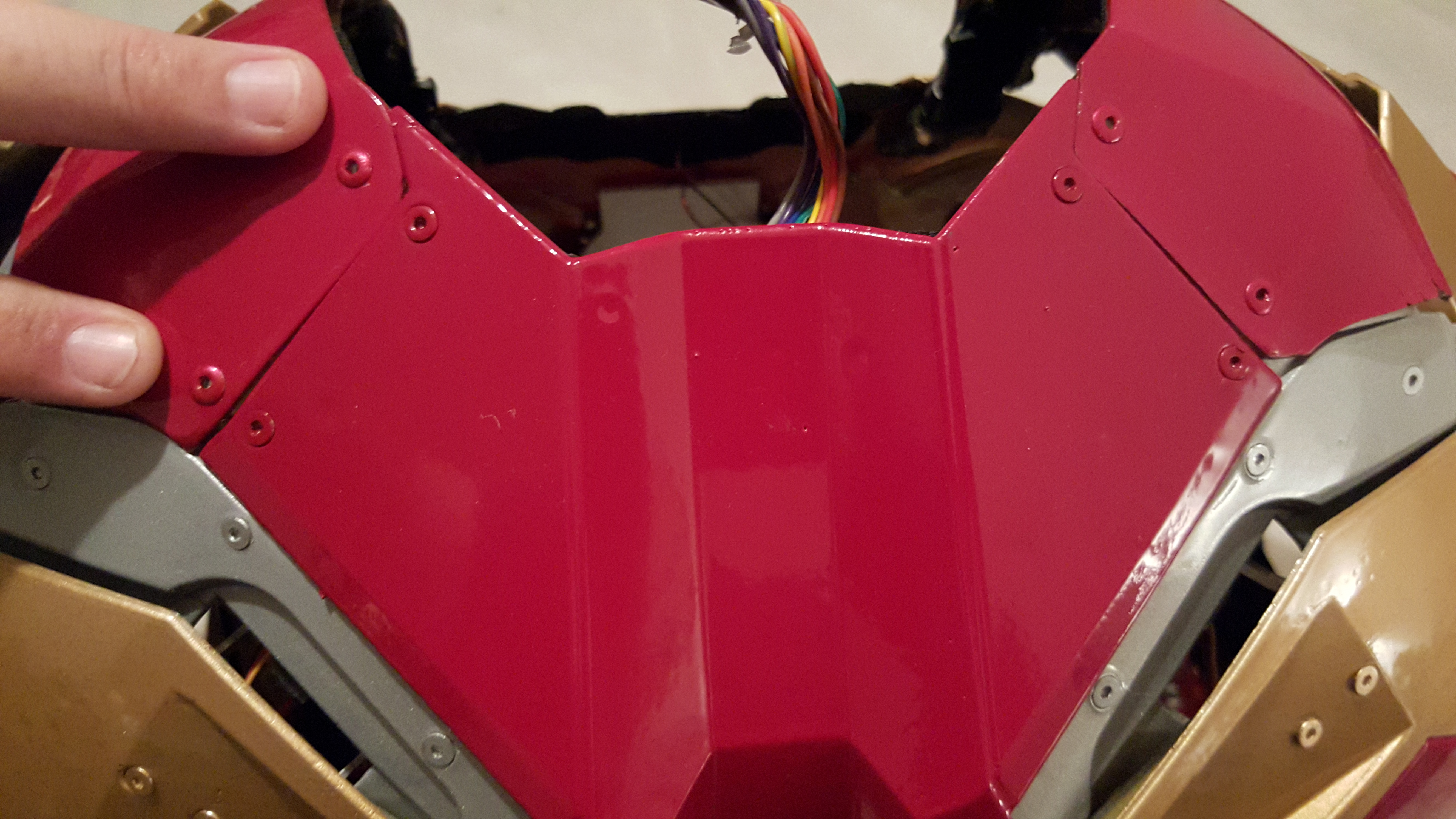

Well, i have to thank Superdave!!
I was working on my old Mark 6 suit from FBA. And the belly pease kept breaking lose. I tried hotglue, superglue, silicone, everything, it kept making it groser and kept breaking.
I don't know anything about tools and techniques, but thanks to Superdave i learnt about rivets.
AND IT'S SO ******* EASY!!!! :D Thank you bro!!!
