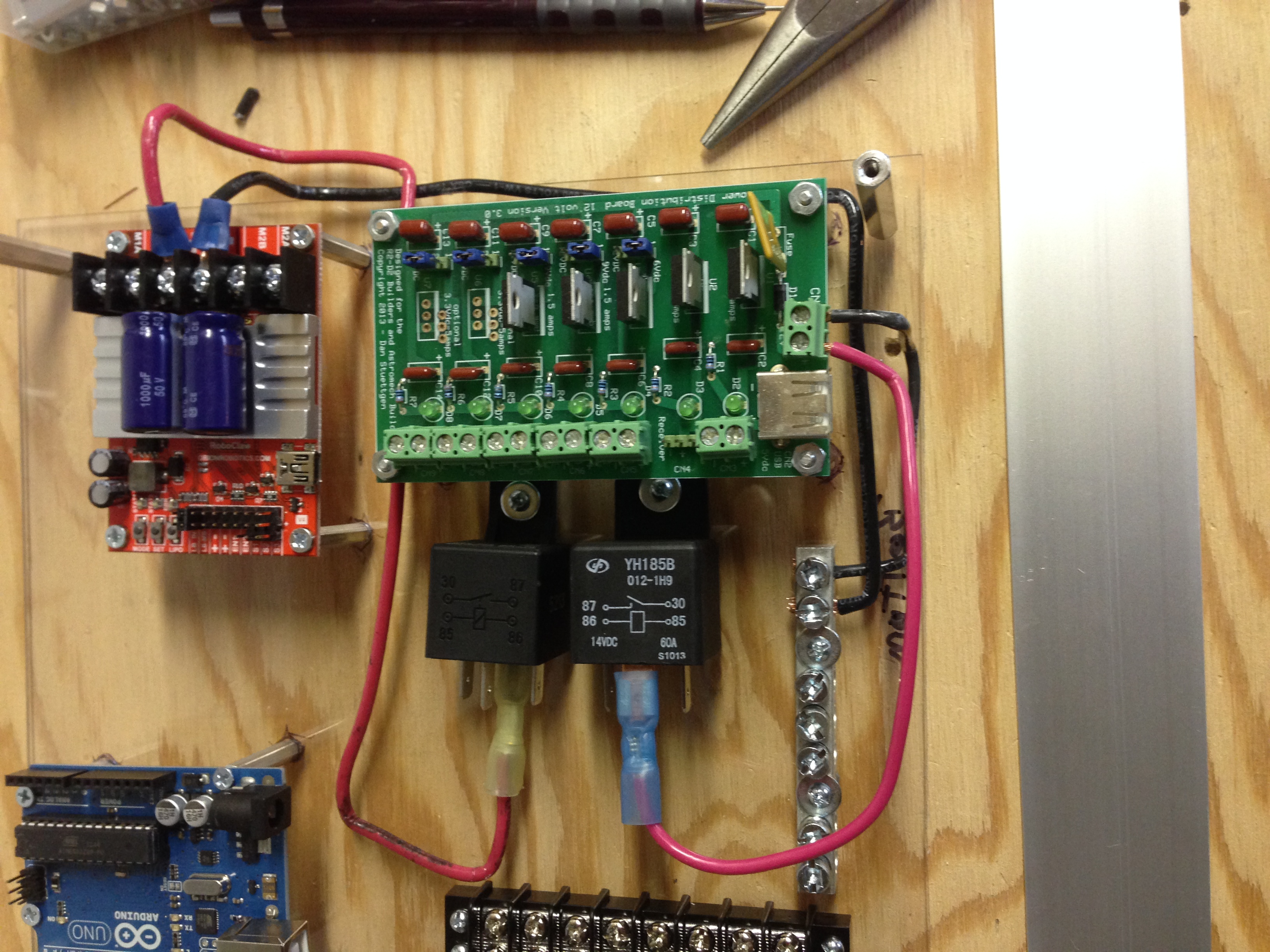

Added screws and nuts to hold everything to the plexiglass. I attached a terminal strip that will become the spot all of the lowers wires will attach too. I added a ground strip, a 12-volt relay, a 24-volt relay, a power distribution board, a 24-volt electronic speed controller and and Arduino Uno.

The two black things in the center of the board are relays (electronic switches). The lower one is 12-volt and the upper one is 24-volt. I am wiring the 12-volt relay to turn on the power distribution board, which will in turn provide power at different voltages to the Arduino, the R/C receiver and my fans. The 24- volt relay is wired directly to ESC because it will be running 24-volt motors. All of the black wires are run to one central ground to avoid ground loops. Not entirely sure what that is but I am sure it is bad.

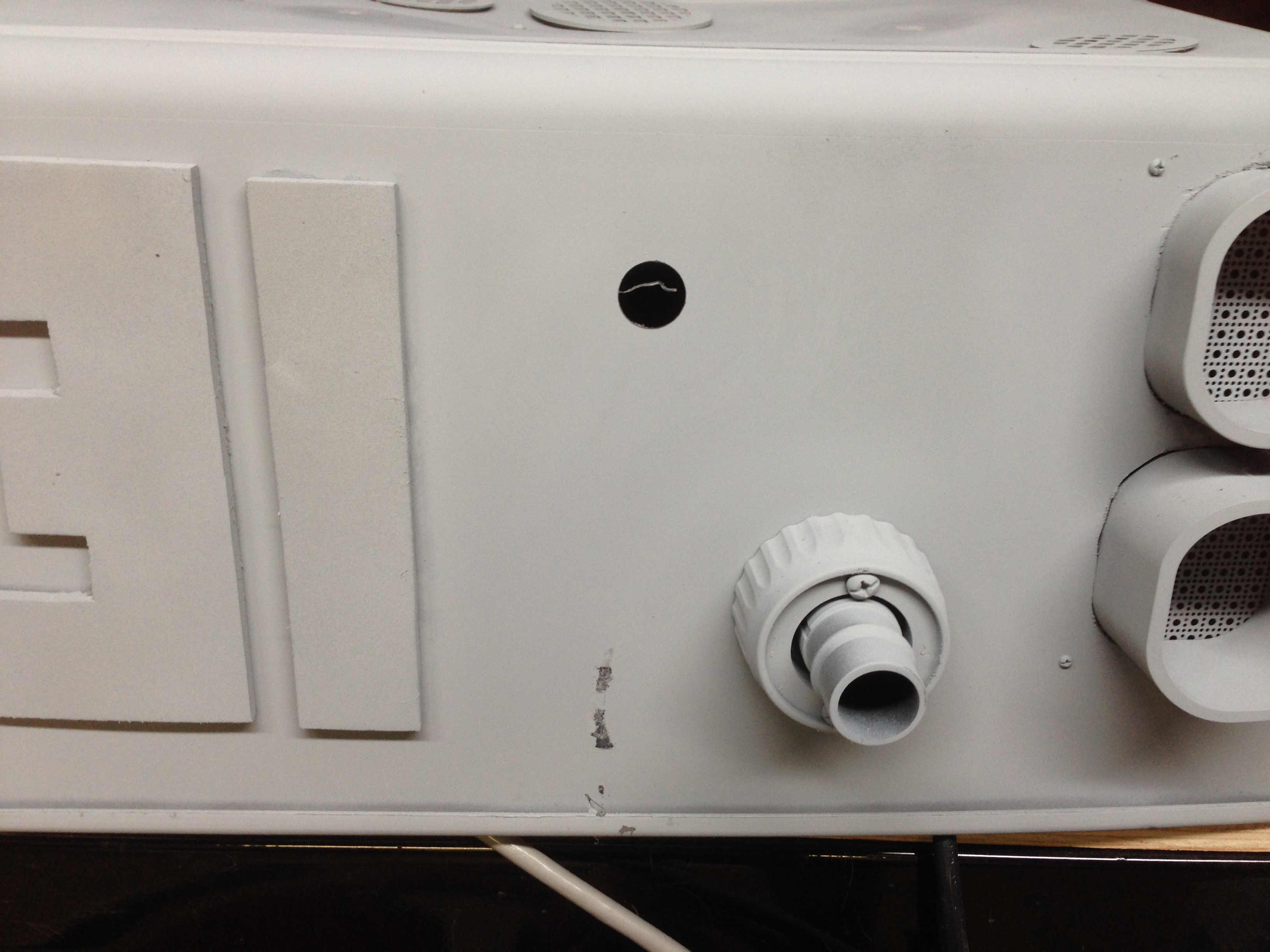

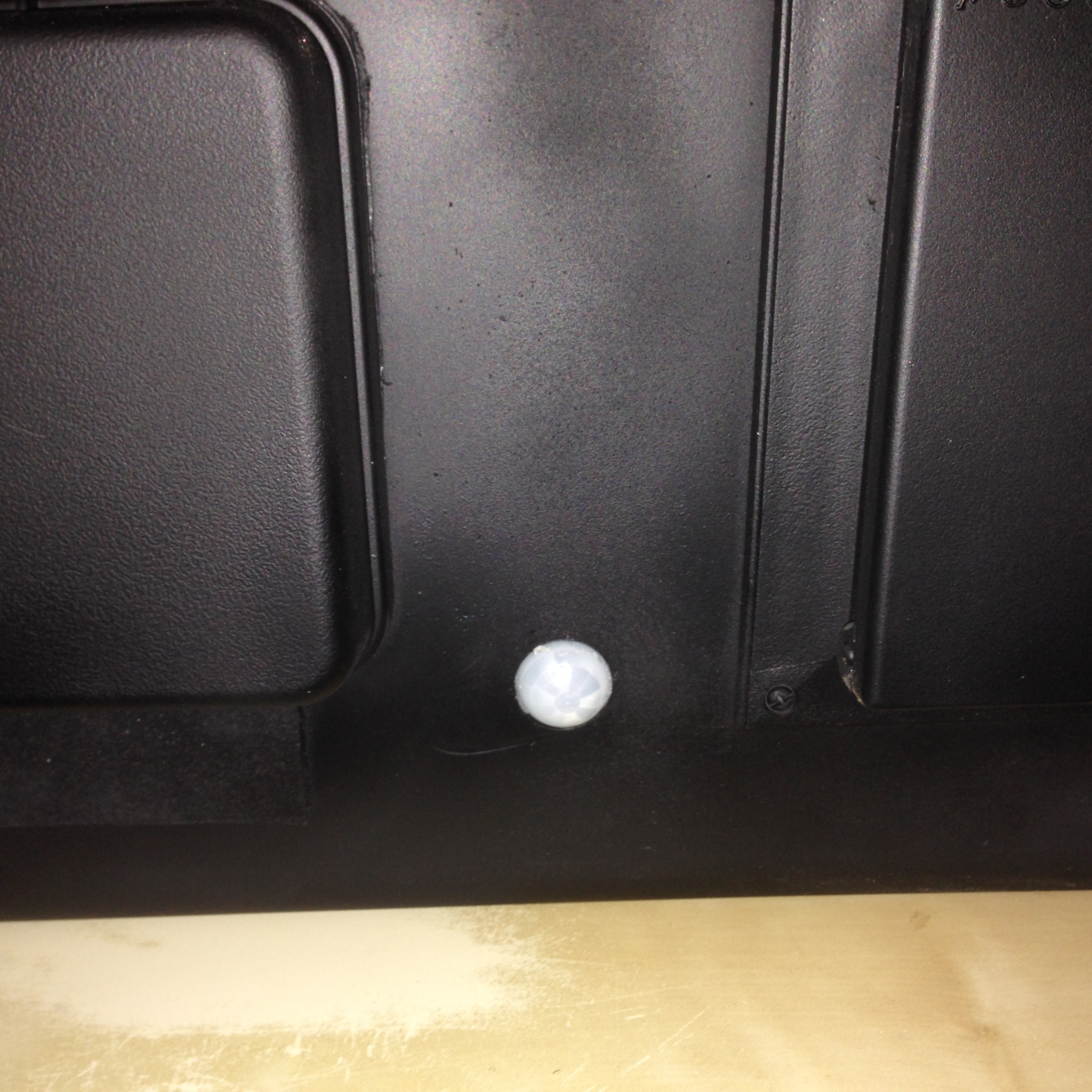

I added a couple more holes today. I needed one more on the face for 24v switch and I added on each side of the droid and one in the front for motion sensors. The motion sensors will trigger a sound.

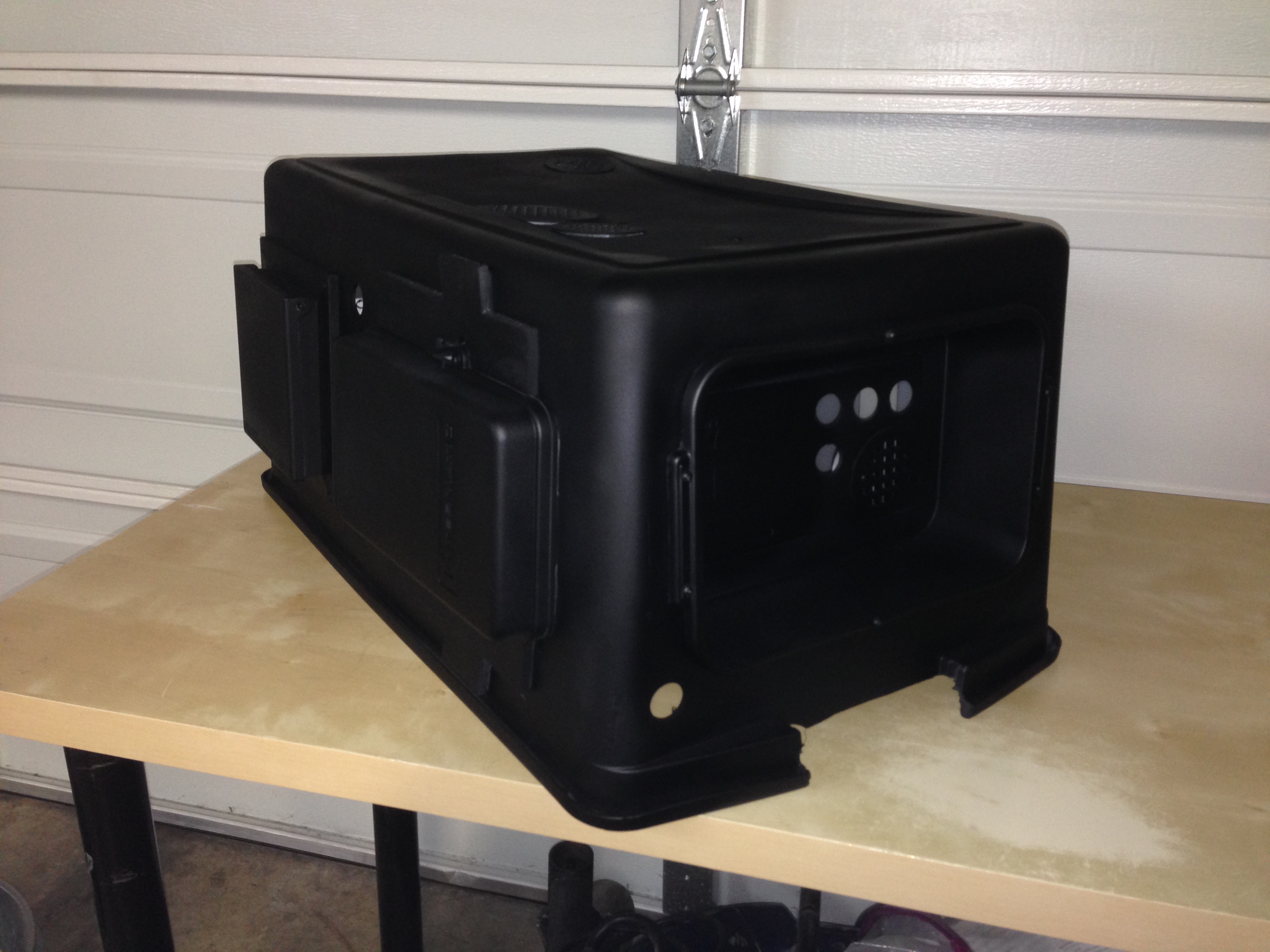

Next up, was to to paint the base coat onto the top bin.

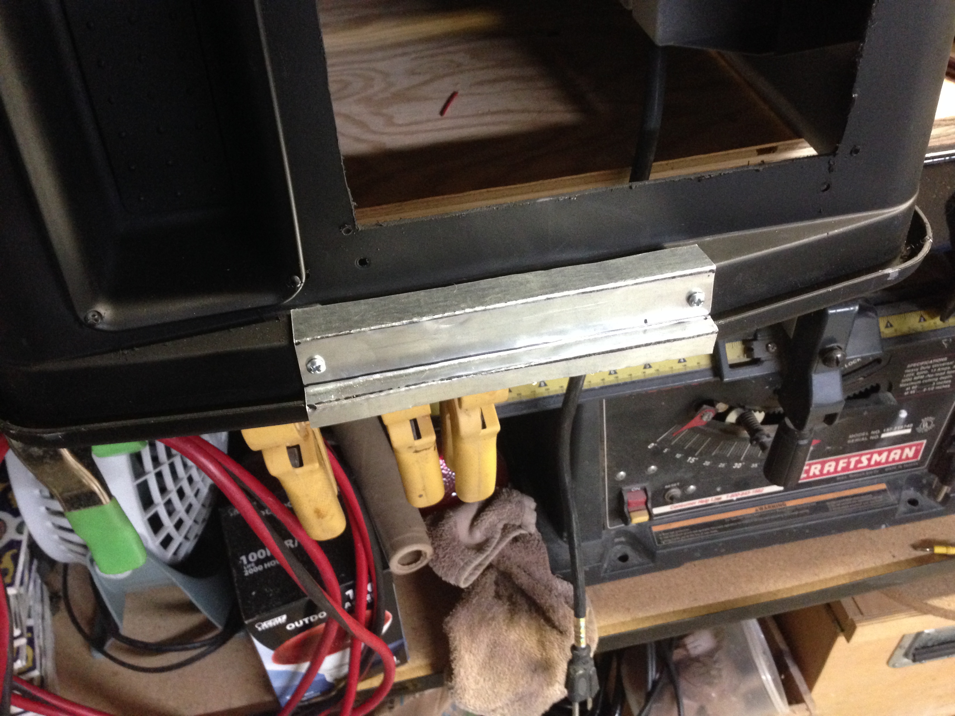

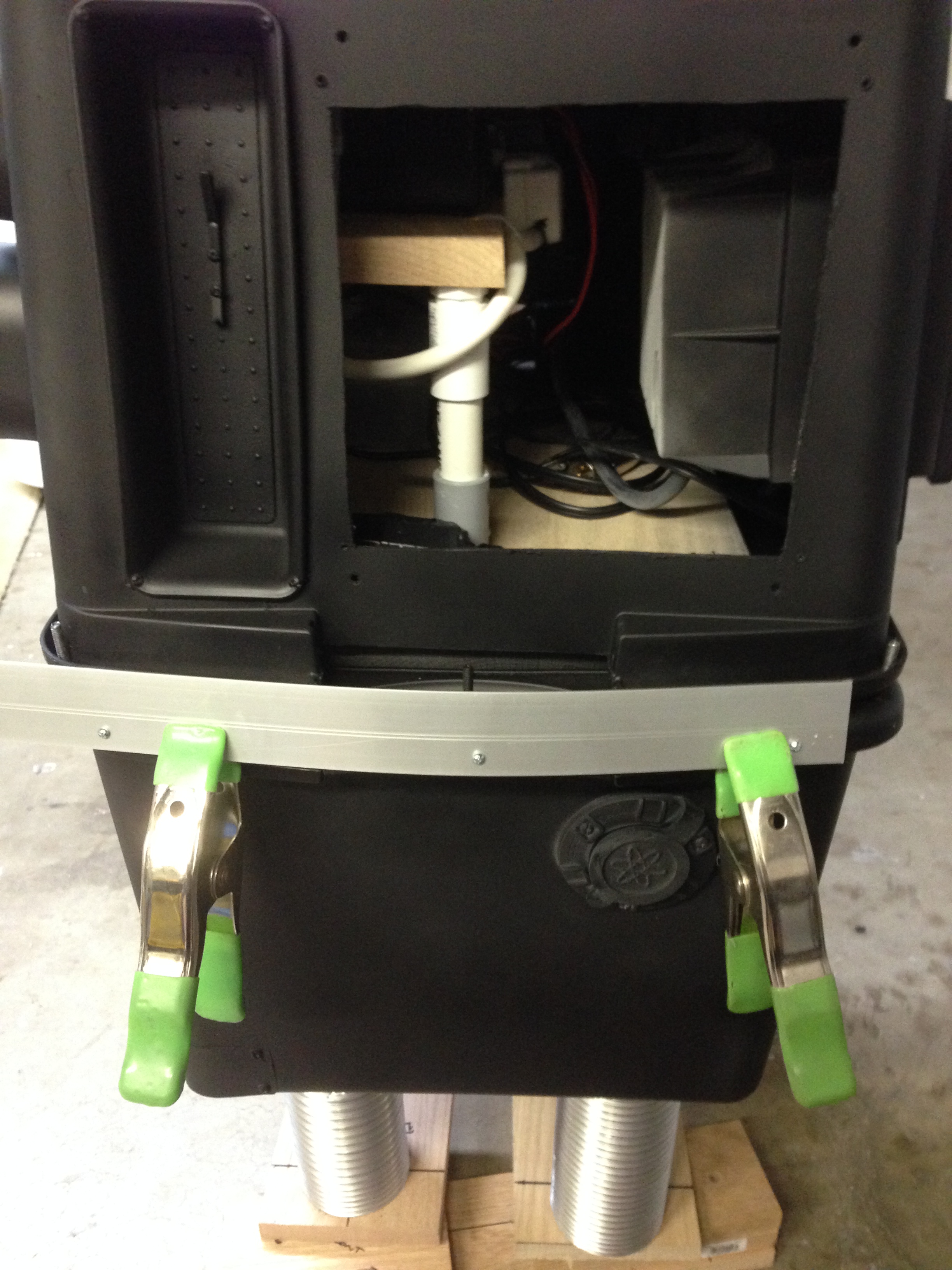

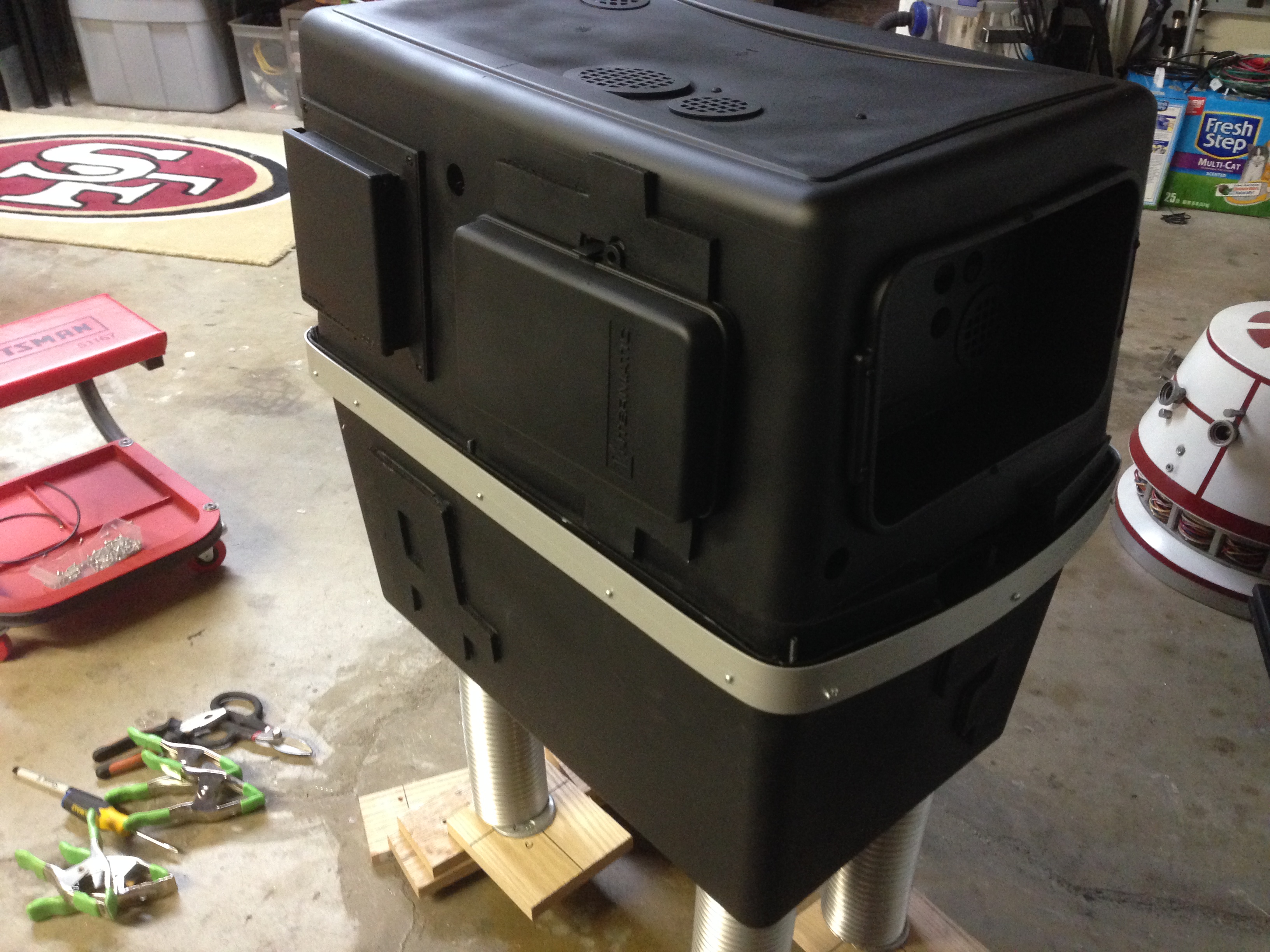

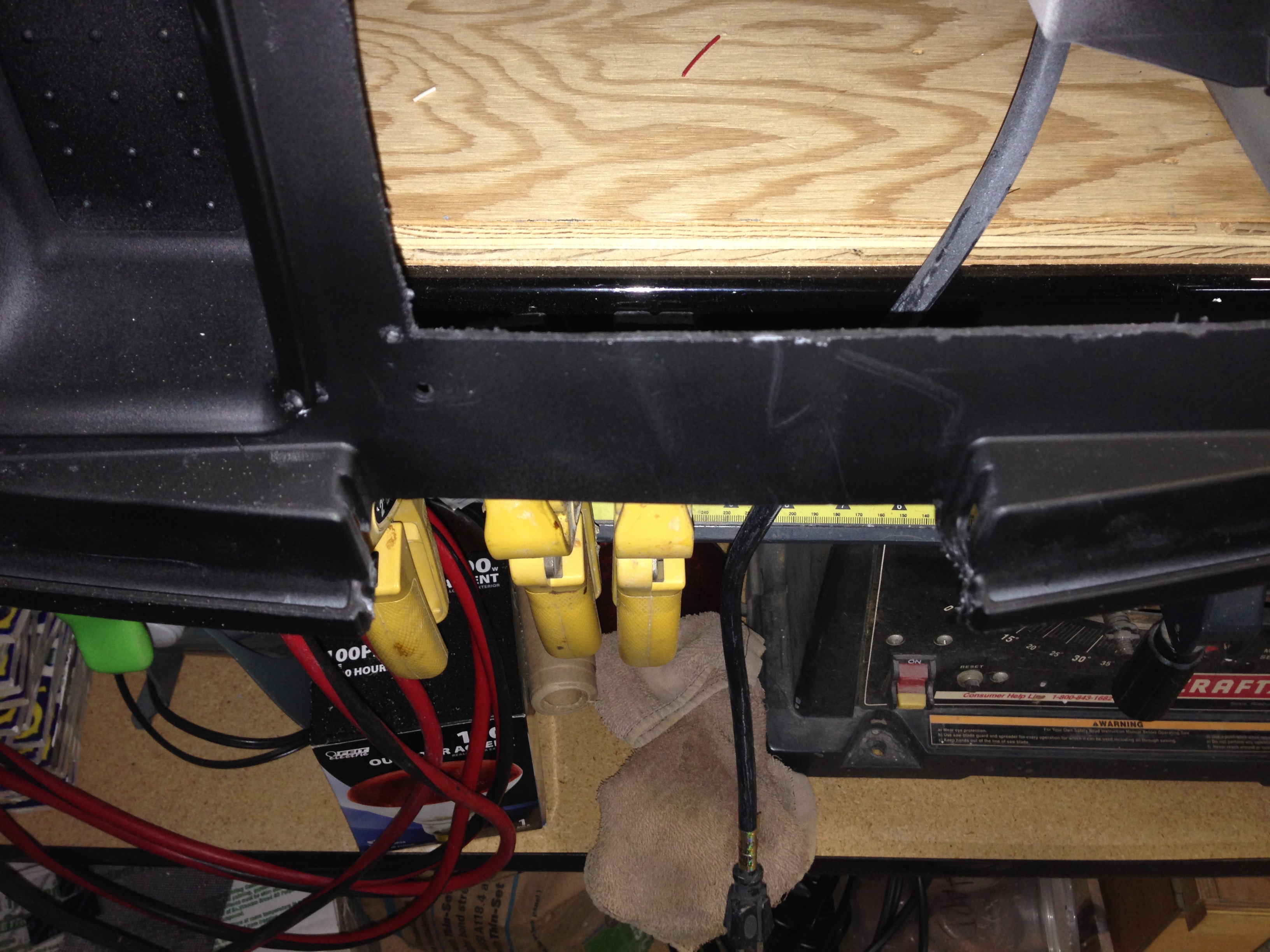

For the seam between the bins I have decided to use 1/16th thick strip of one and a half inch aluminum. I bought a eight foot piece and clamped it to the lower bin. I drilled holes as I went and used screws to attach it to the lid and lower bin. Basically, I want the top bin to slip inside and be removable.
2014-07-27 21.07.48.jpg 2014-07-27 21.20.11.jpg 2014-07-27 21.19.59.jpg 2014-07-27 21.20.31.jpg
And here is what it looks like with the top bin off.

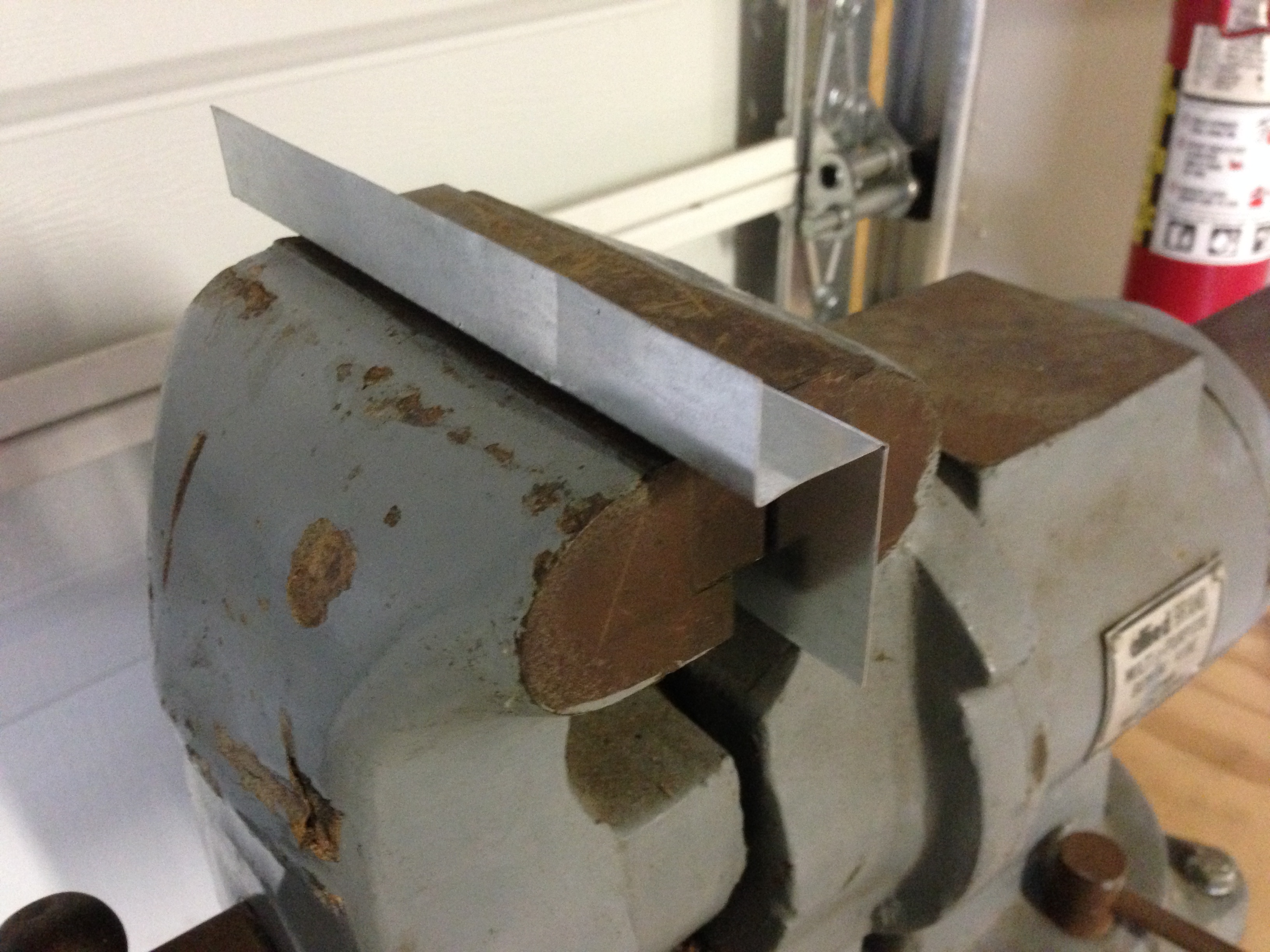

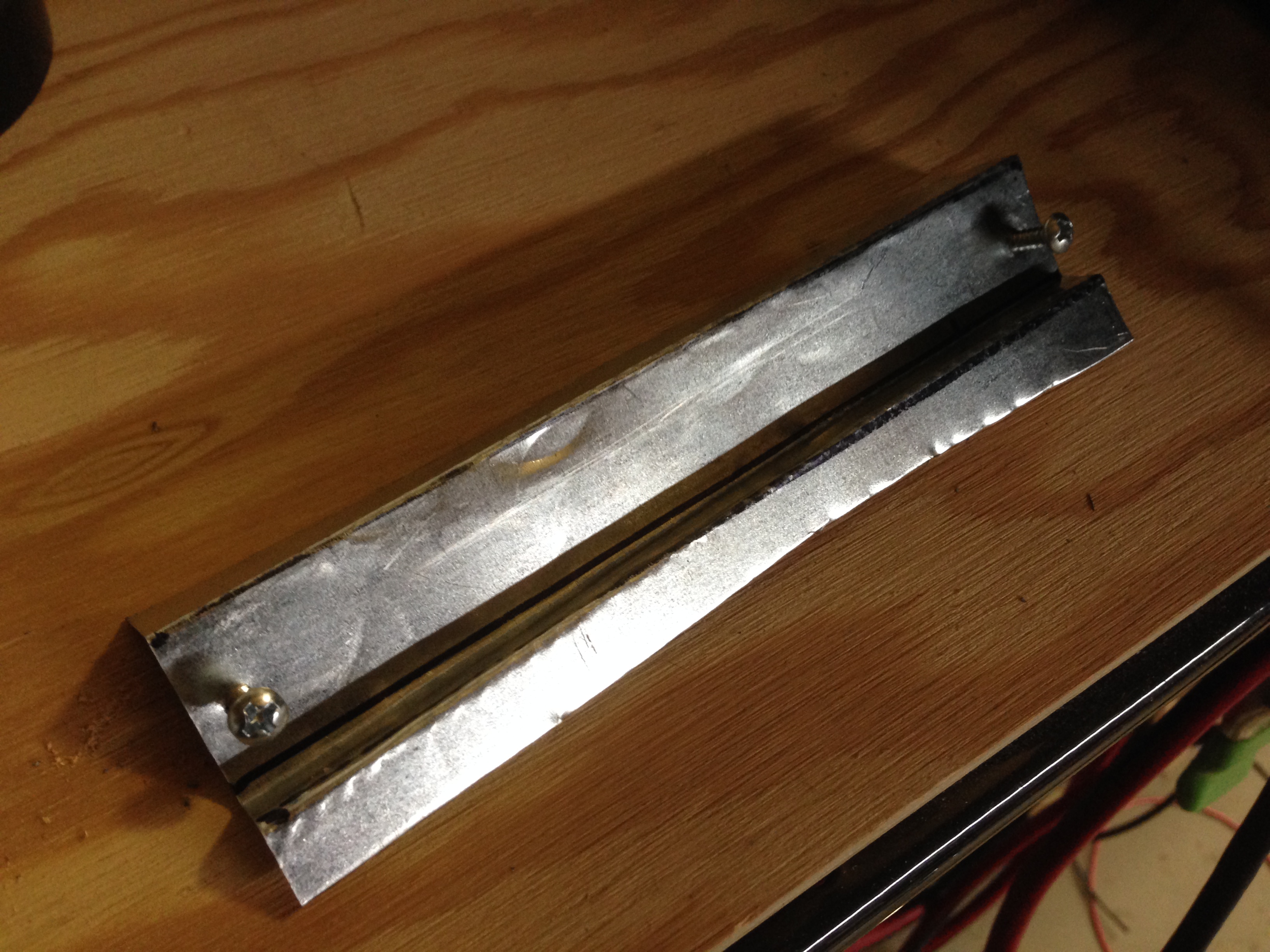

Another small update! I used a scrap piece of tin to cover the space where the handles of the top bin used to be. After I shaped it on the vice, I simply used two screws to hold it in place. I then painted everything black.
2014-07-29 19.15.34.jpg 2014-07-29 19.15.20.jpg 2014-07-29 19.16.20.jpg 2014-07-29 19.17.53.jpg
2014-07-29 19.19.54.jpg 2014-07-29 19.20.34.jpg 2014-07-29 19.26.03.jpg 2014-07-29 19.27.03.jpg

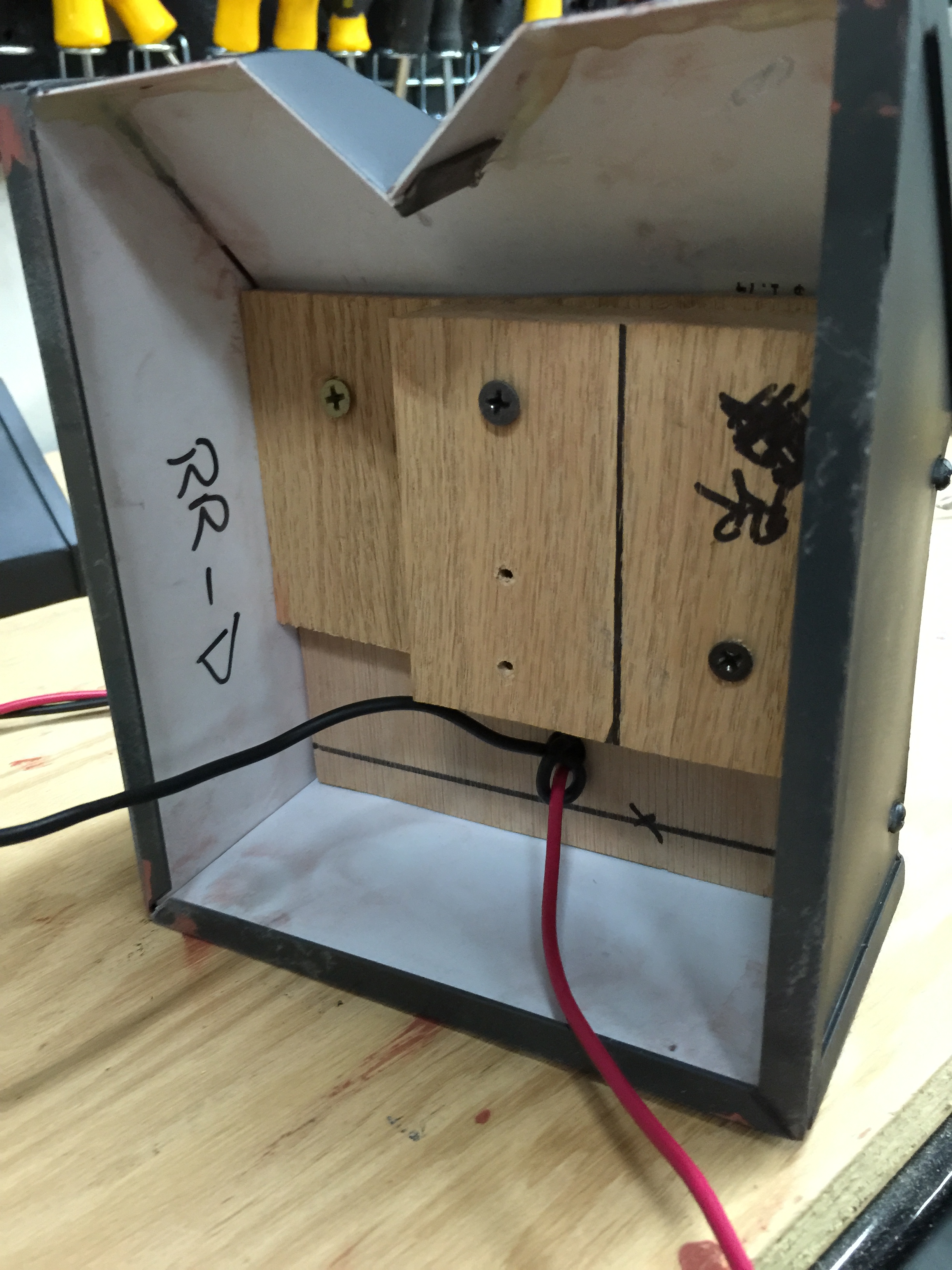

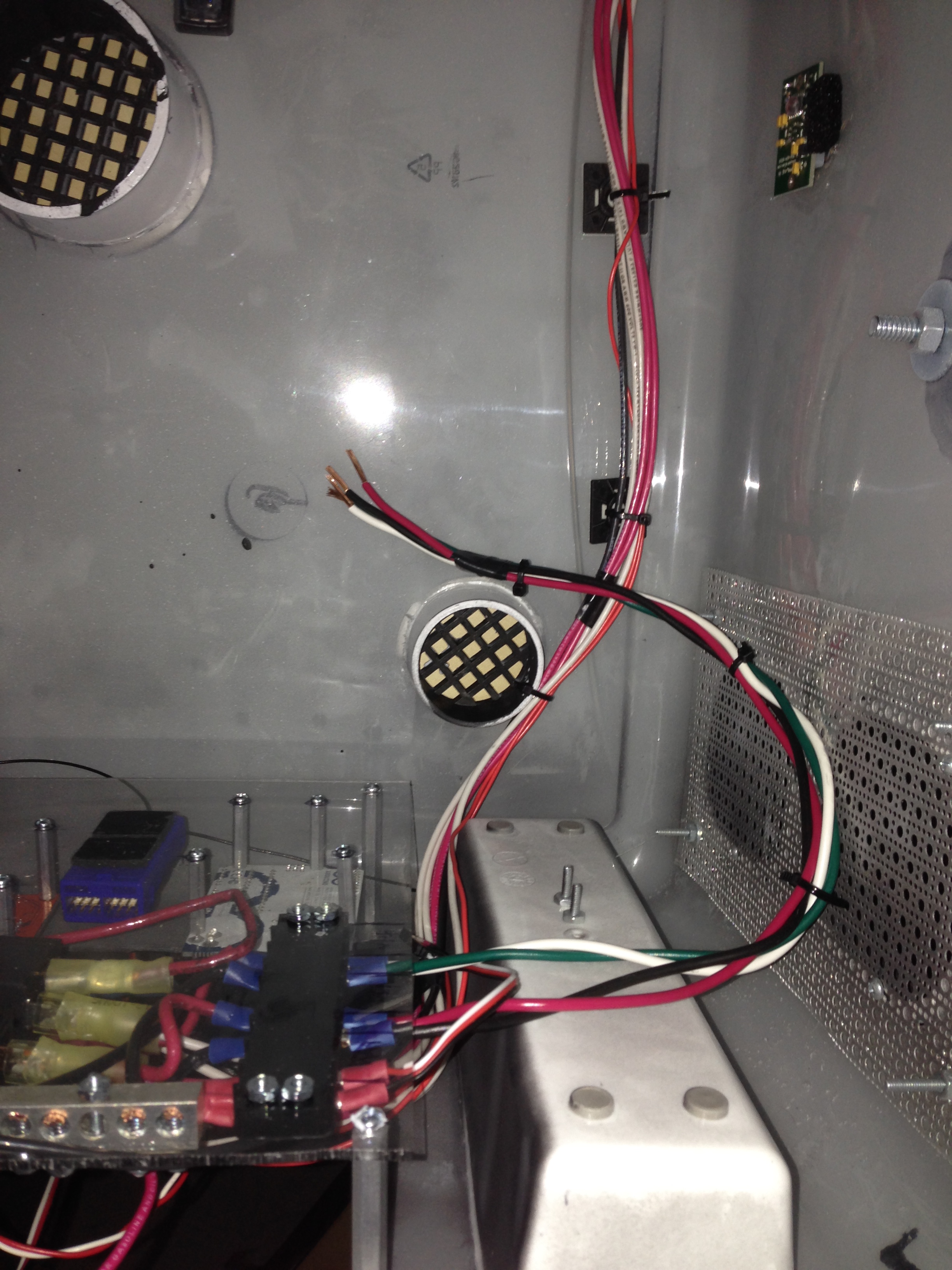

Removed the top bin and started installing the electronics. First to go back in is the electrical panel.
Next, I ran all of the wires to the switches.

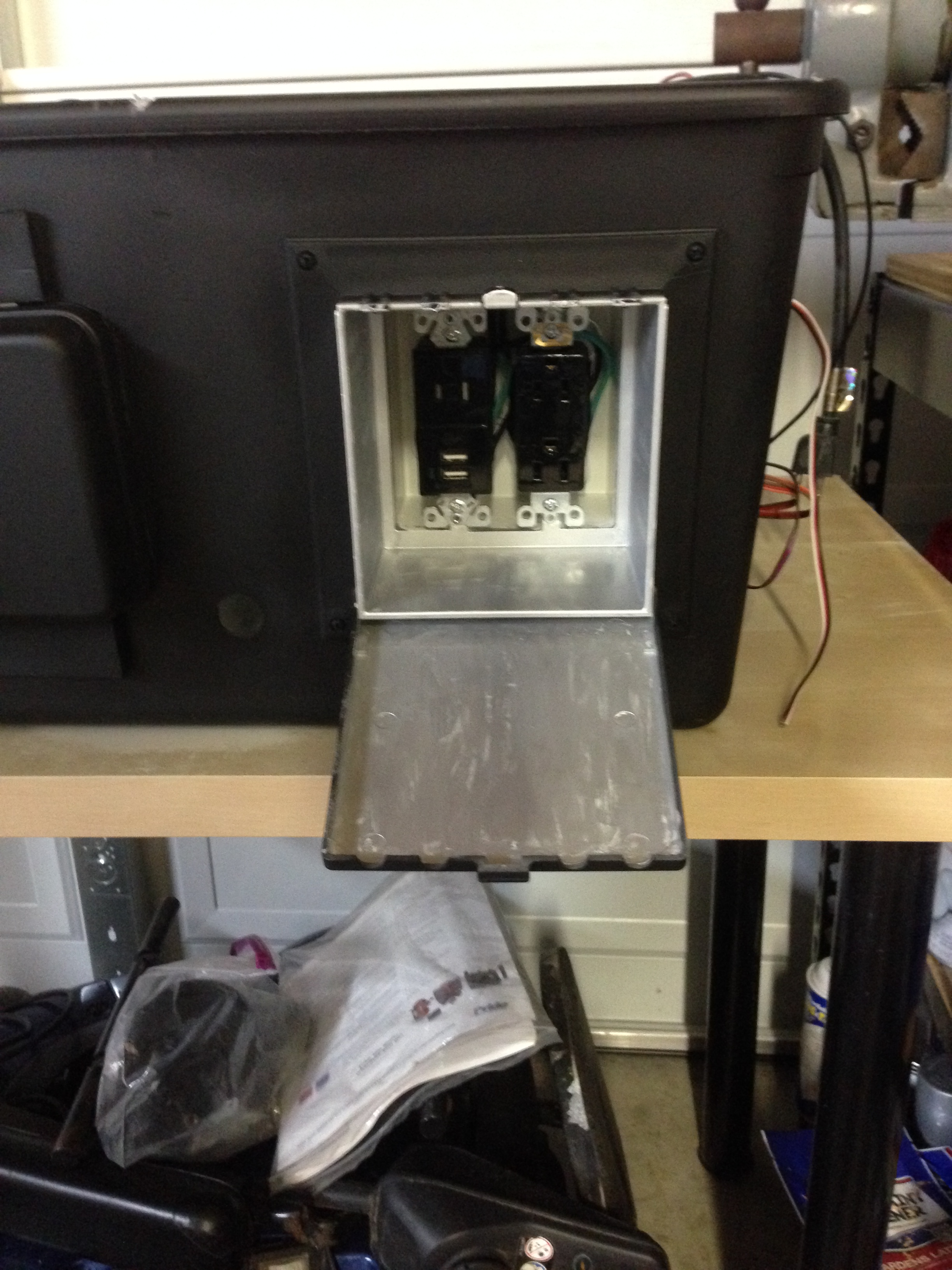

Everything now works and I also tested the 110 volt side. This is the first battery I charged as a semi built droid.
Got a few things done as I am waiting for parts.

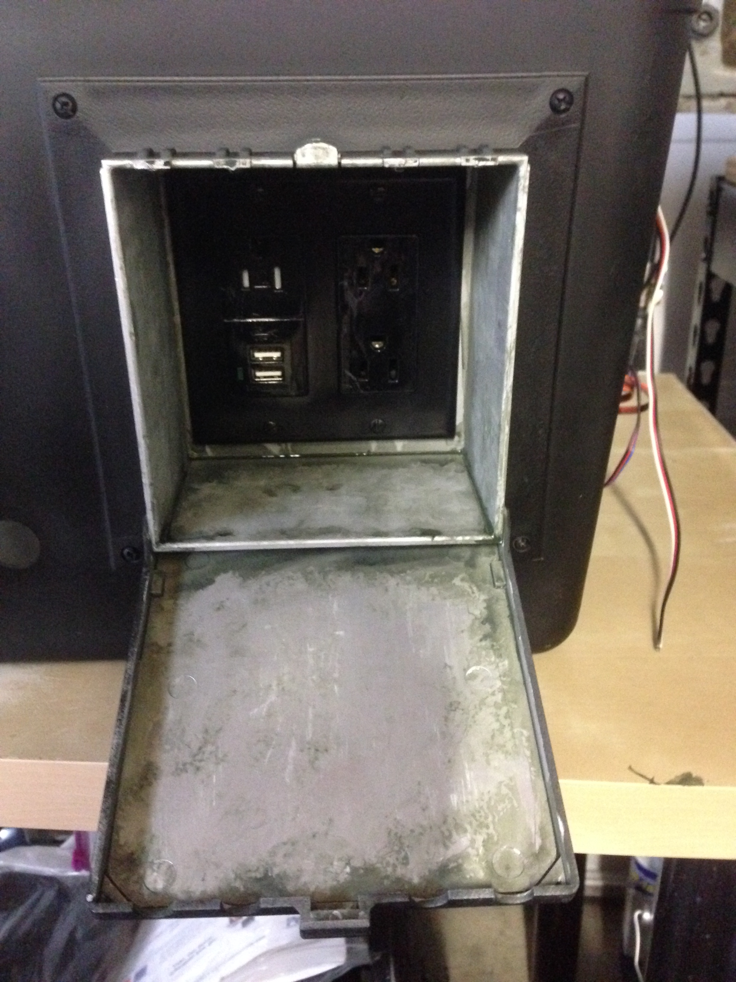

I painted the inside of the 110 volt box silver with some acrylic paint and weathered with an oil color.

I also was able to hot glue the motion sensors into place. There is one on each side of the droid and the front.

And finally I used quick connectors for all of the wire connections between the upper and lower bin. So now it will be fast and easy to remove the upper bin. Because I decided to go this way, now i need a few more parts.

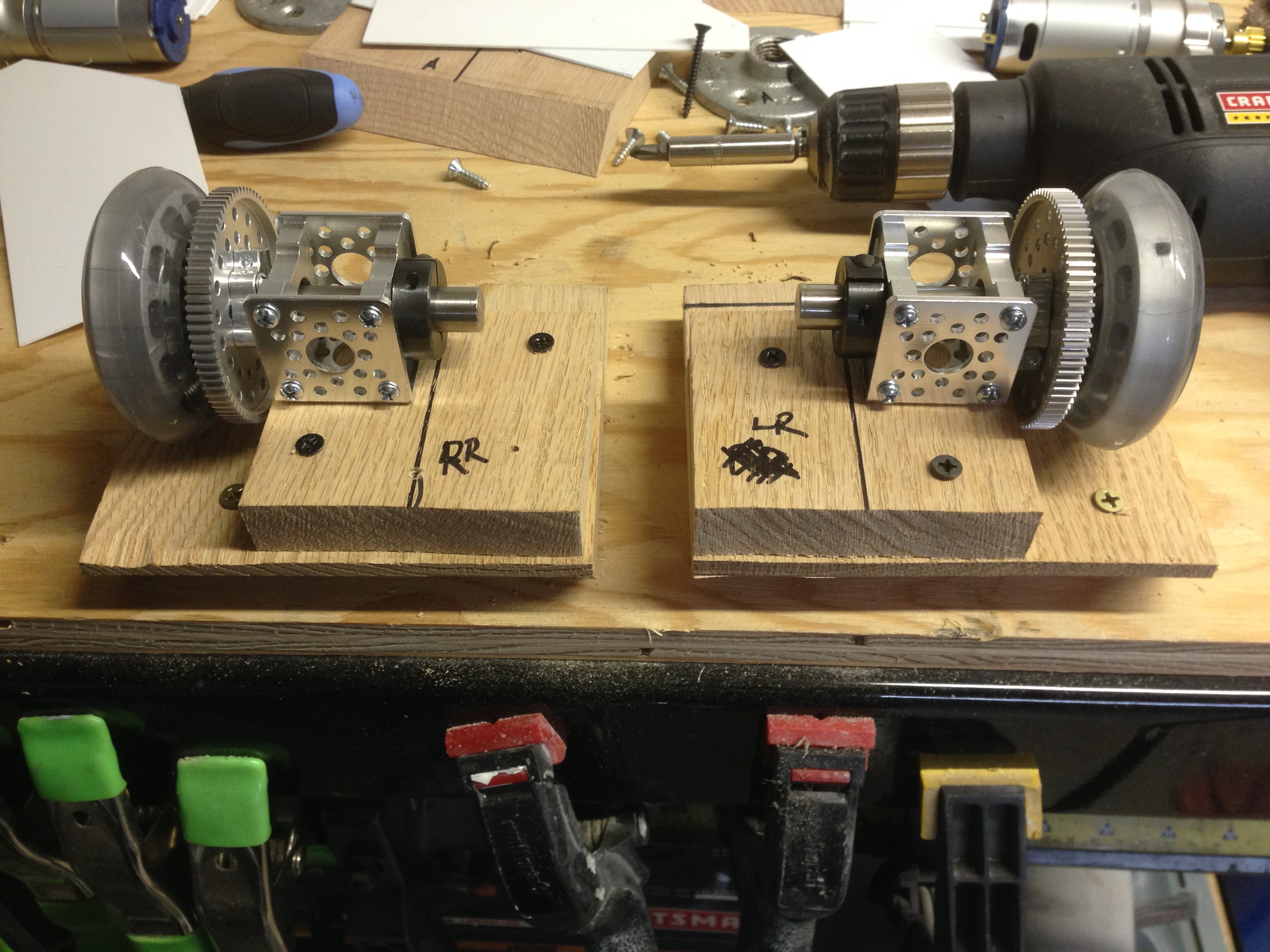

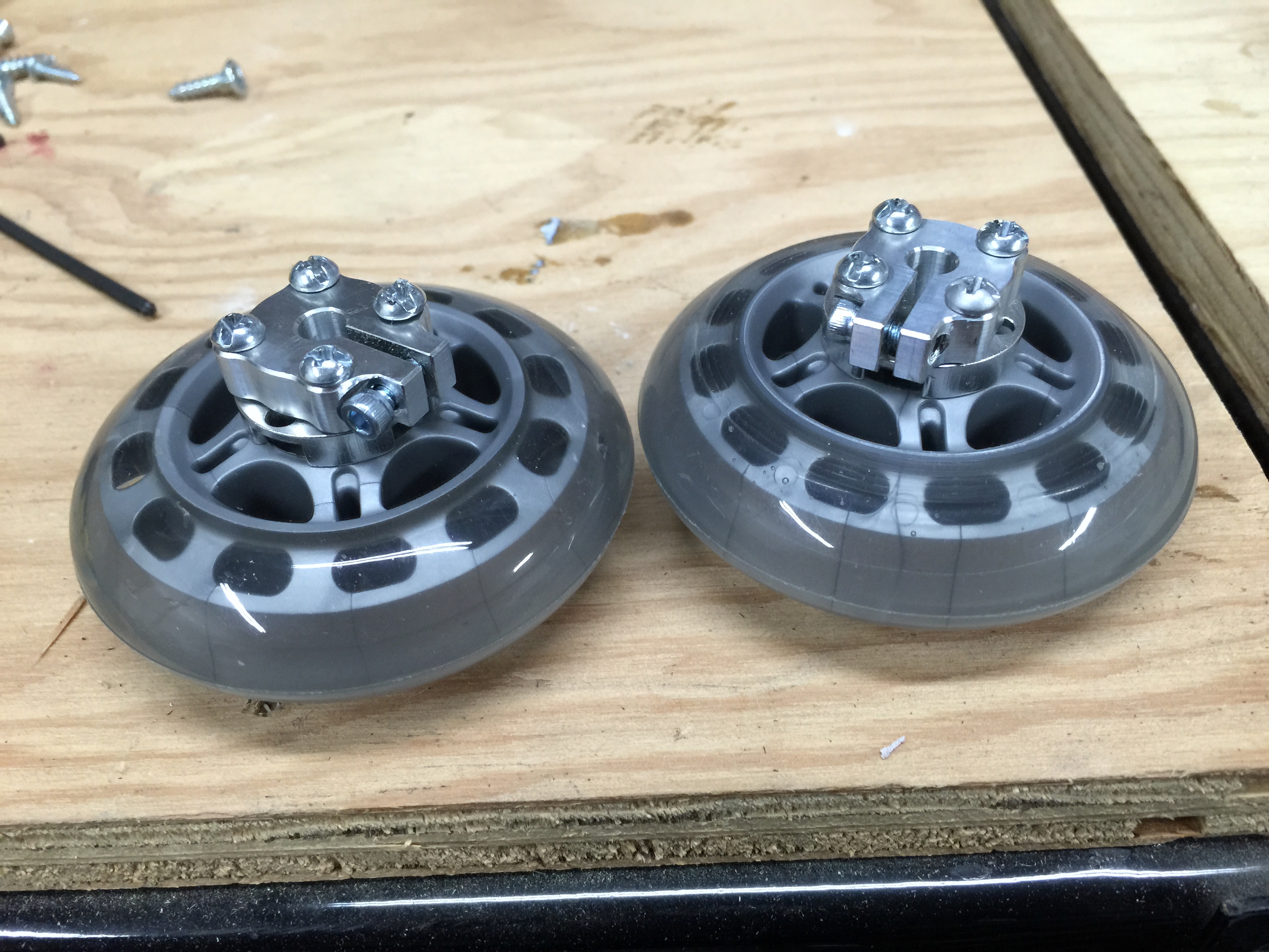

I got the parts for the rear wheels and motors.
2014-08-08 20.34.37.jpg 2014-08-08 20.40.08.jpg 2014-08-08 20.40.21.jpg 2014-08-08 20.41.44.jpg
I bought a swivel mount to attach the motors to the channel, however I didn't get the piece that actually attaches to the channel. After a little research I found that the website clearly states "Hey Idiot, don't forget to buy this piece.
So, this is how they sit.

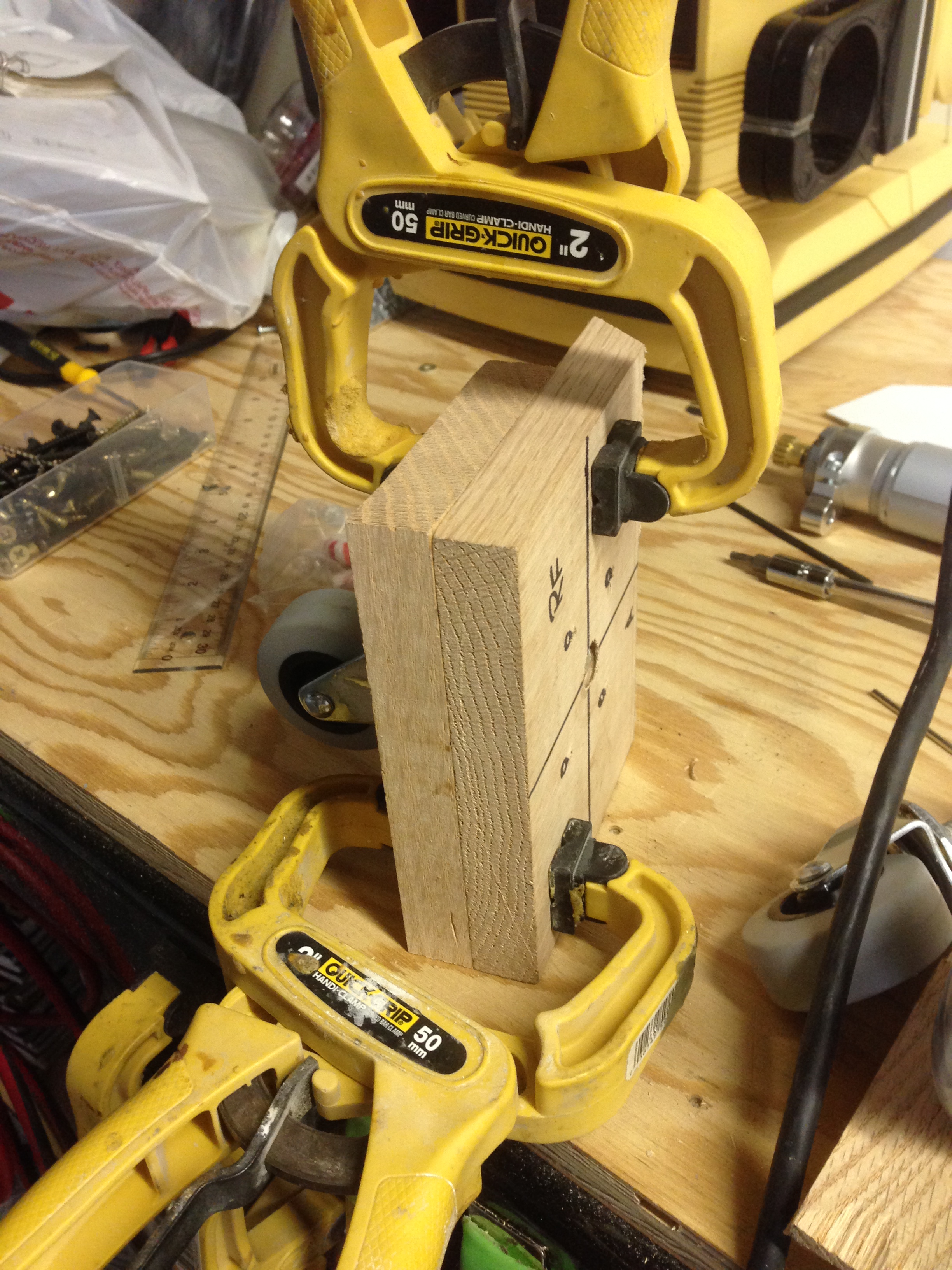

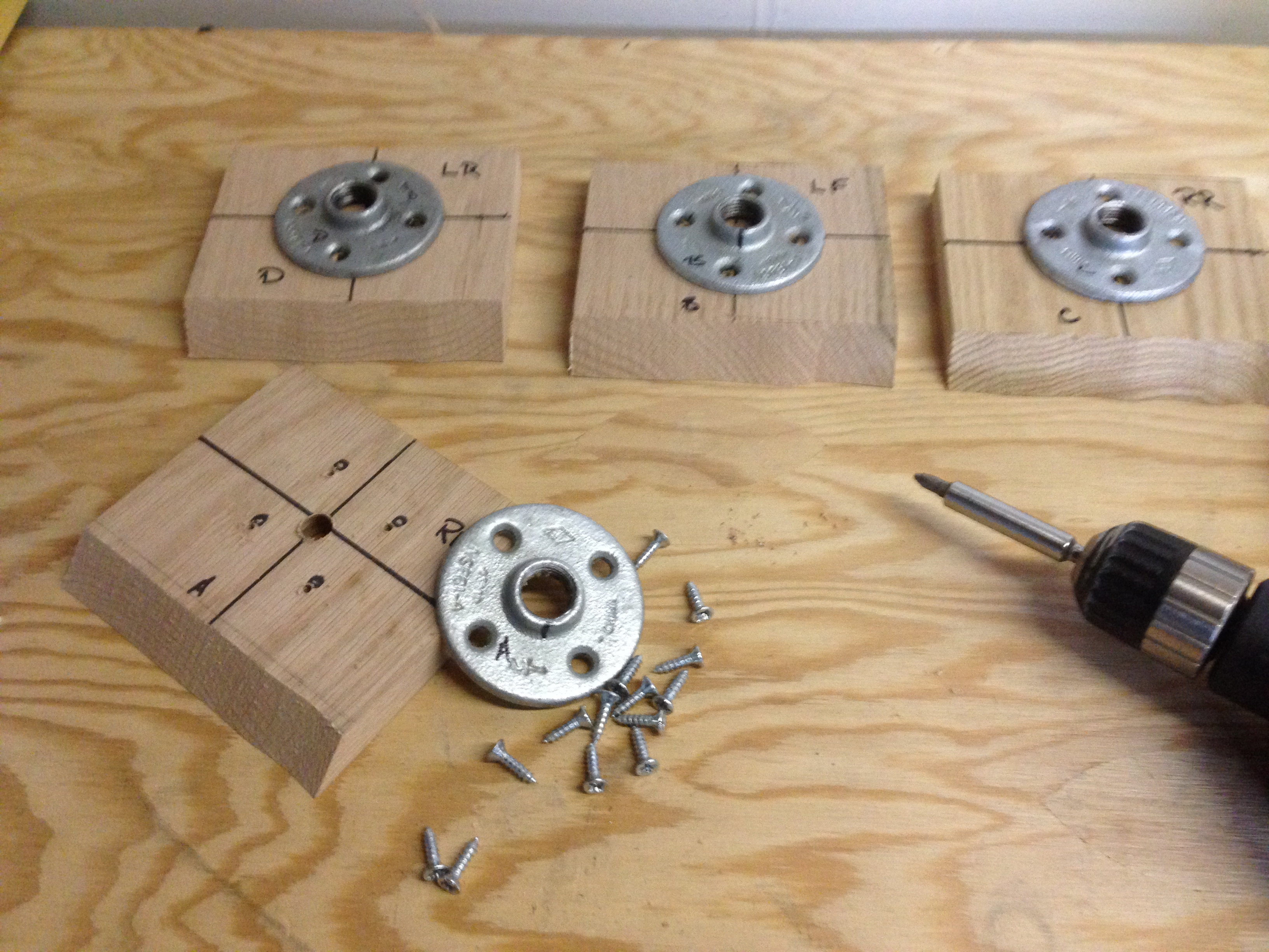

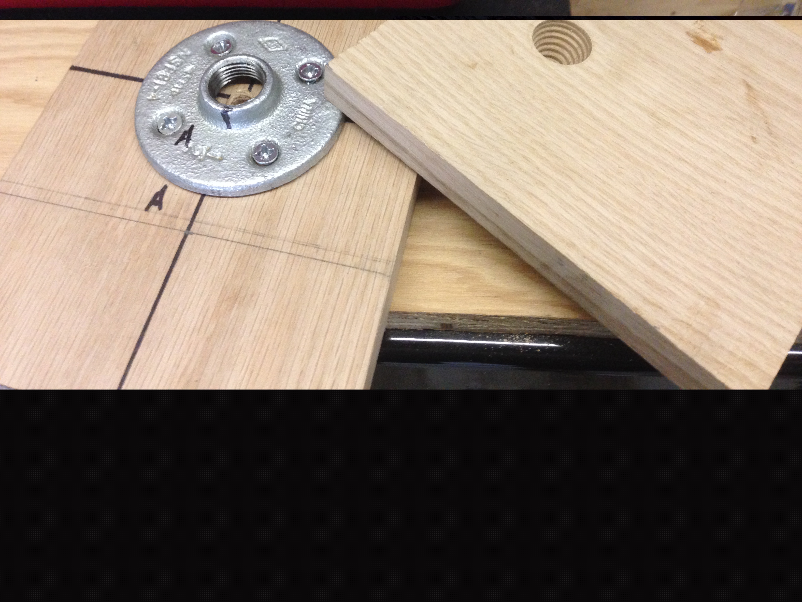

There is a height difference that I needed to correct from the front to the back feet. To fix this I need to add an extra board to front feet. I disassembled all the feet and I bored out some space for the nut to go over the caster.
Once that was completed, I decided that the feet should be six and half inches long with the toes. So I cut down the top portion to 4-3/8 inches at a 45 degree angle.

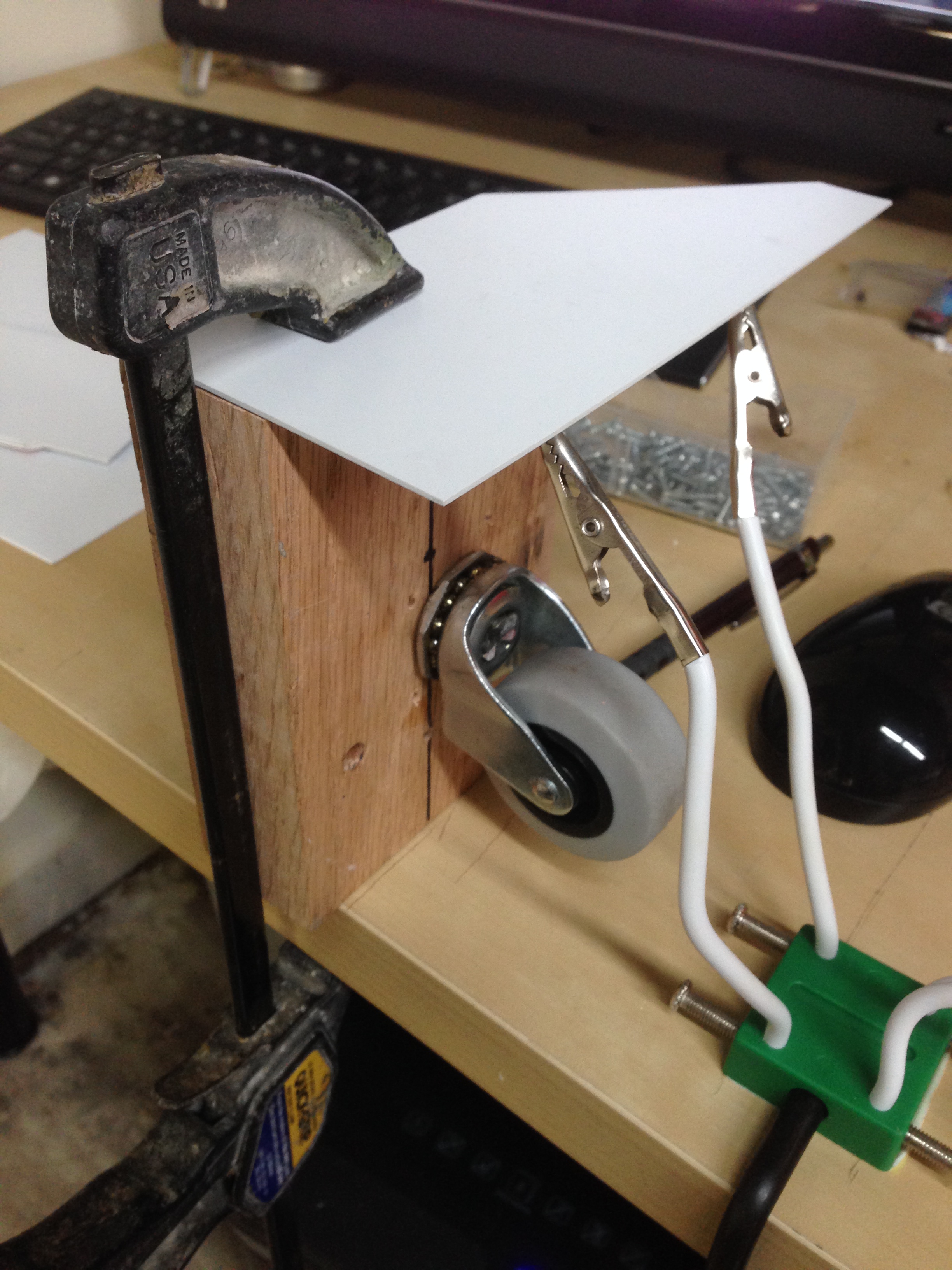

With the wood cut down to the right length, I was able to lay out the cuts on the styrene and cut most of the parts for all the feet.
Next, I was able to attach the rear wheel assembly and attach the casters. Then reassemble the feet.
2014-08-09 22.22.16.jpg 2014-08-09 22.37.41.jpg 2014-08-09 22.54.46.jpg 2014-08-10 18.06.44.jpg

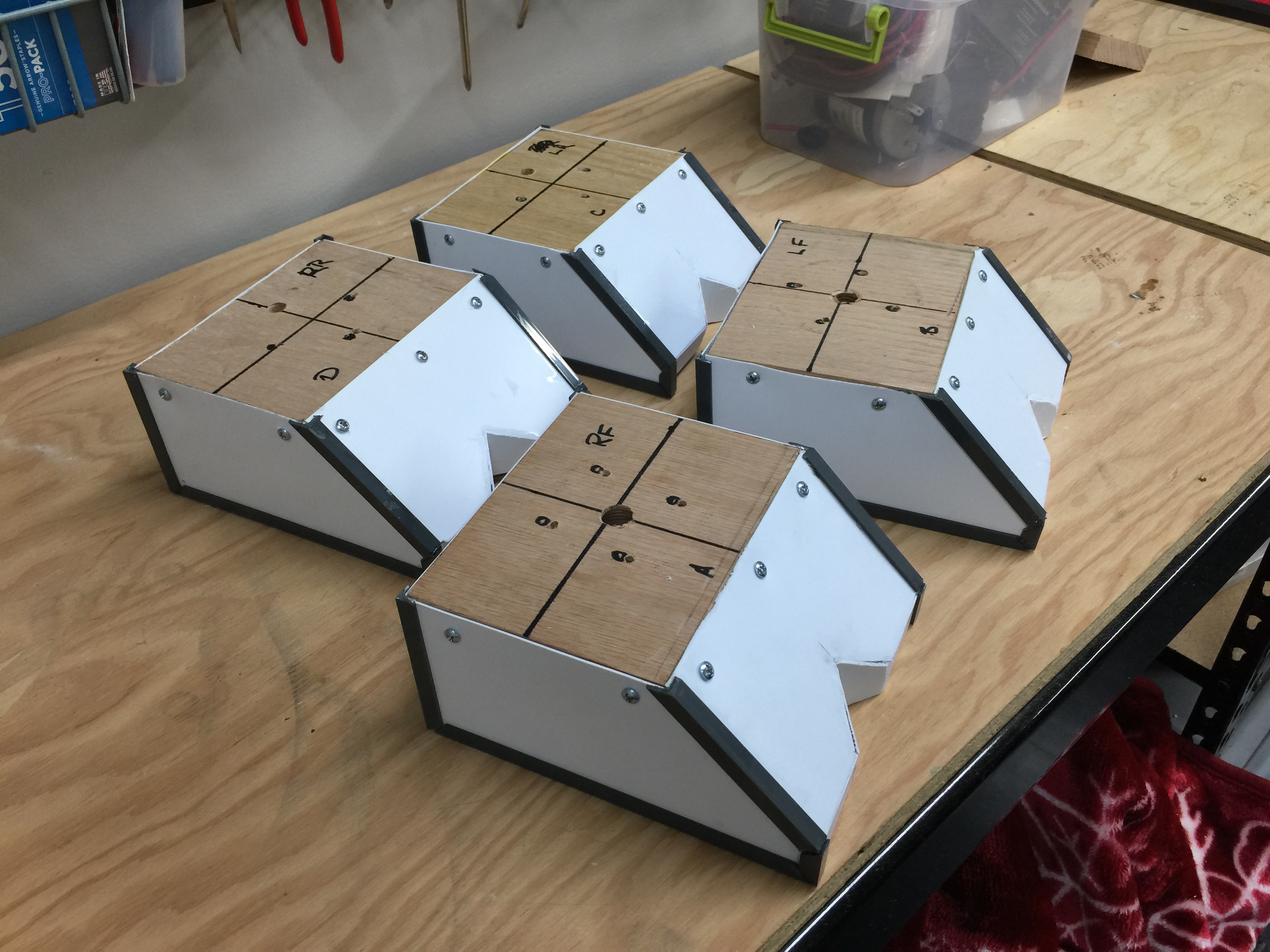

I then used styrene angle strips to frame the foot and give it some interest. It is also adding strength.
2014-08-23 22.33.36.jpg 2014-08-23 22.29.29.jpg 2014-08-23 22.27.57.jpg 2014-08-24 10.23.40.jpg
I finished off the toe area with smaller pieces of styrene.
Then repeat three more times.

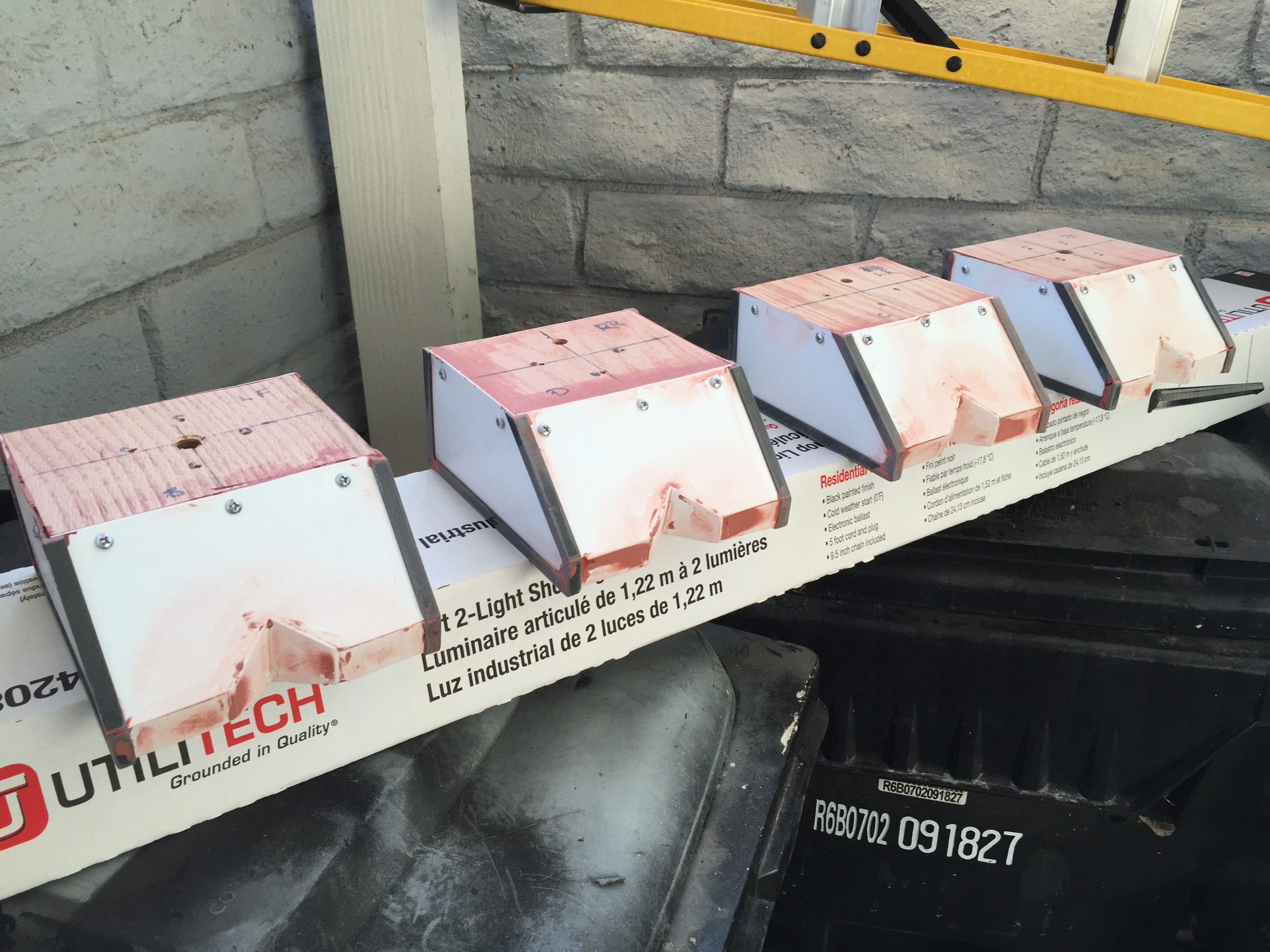

I wrapped up my day with coating all four feet with a little Bondo.

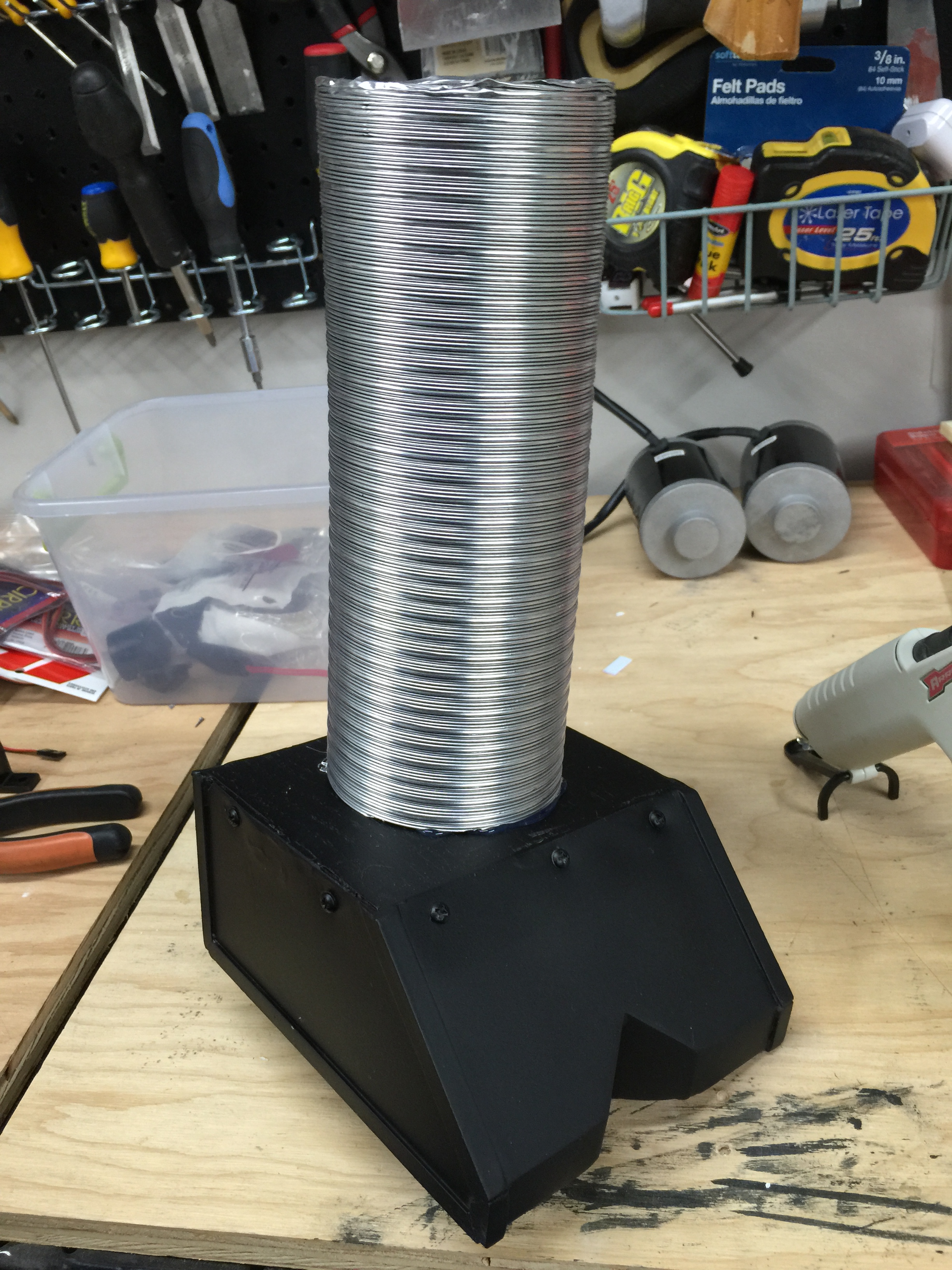

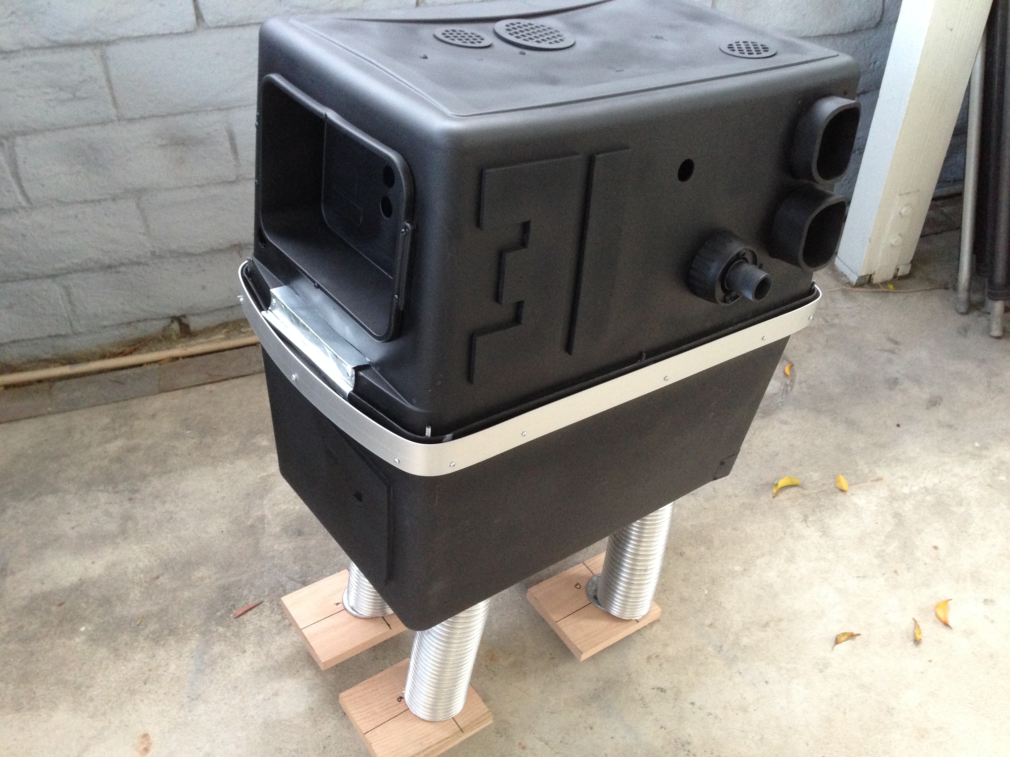

Reassembled the front feet and glued on the aluminum flexible tube that will make up the leg.
2015-01-03 20.41.38.jpg 2015-01-03 20.41.37.jpg 2015-01-03 20.45.11.jpg 2015-01-03 22.09.33.jpg

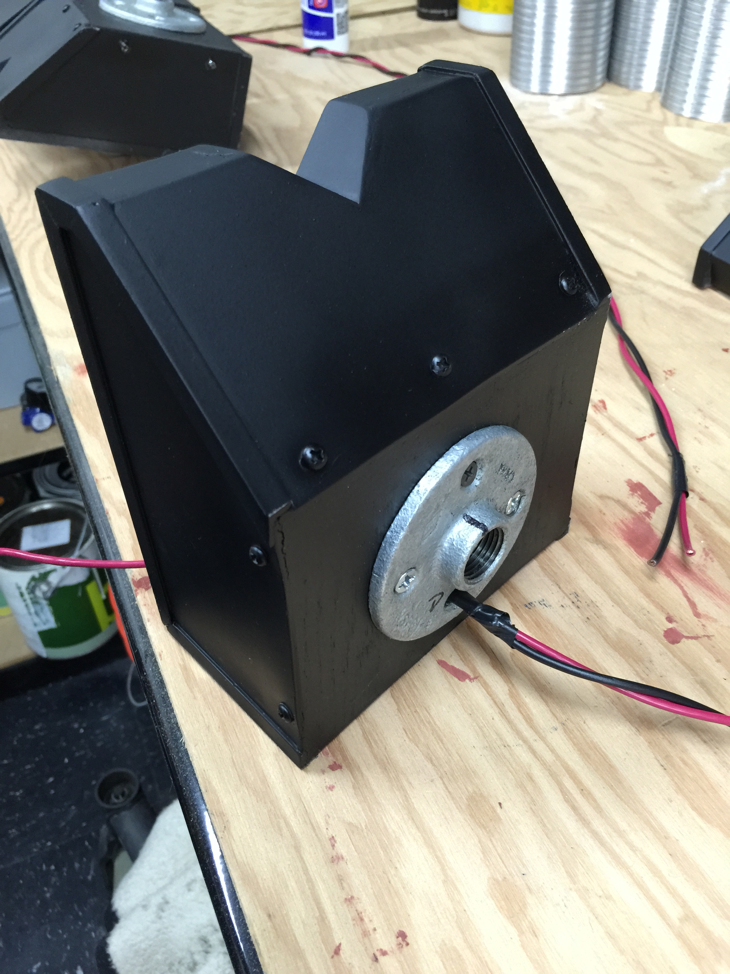

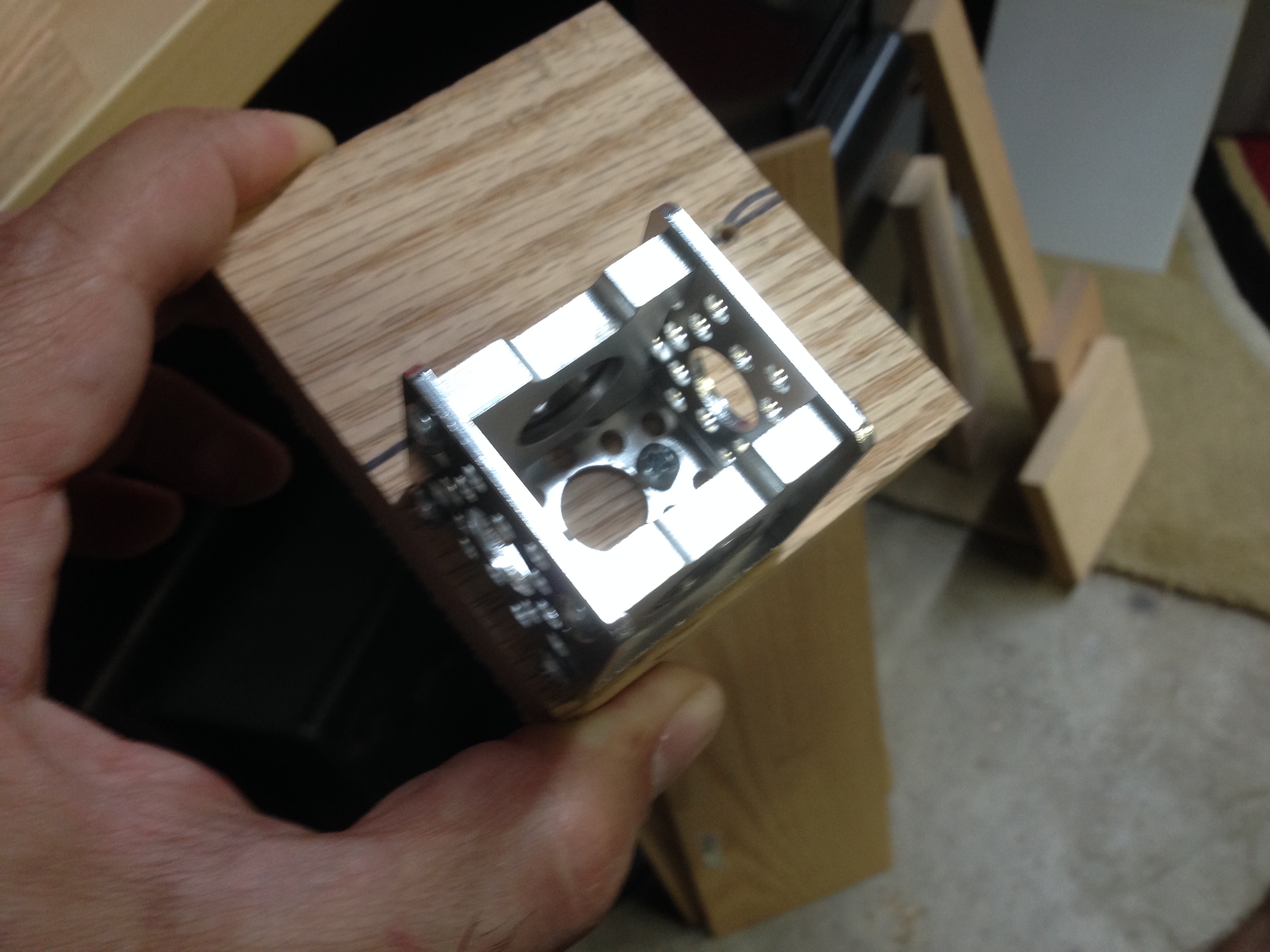

The rear feet also were partially reassembled and the motor wires were installed through the feet.

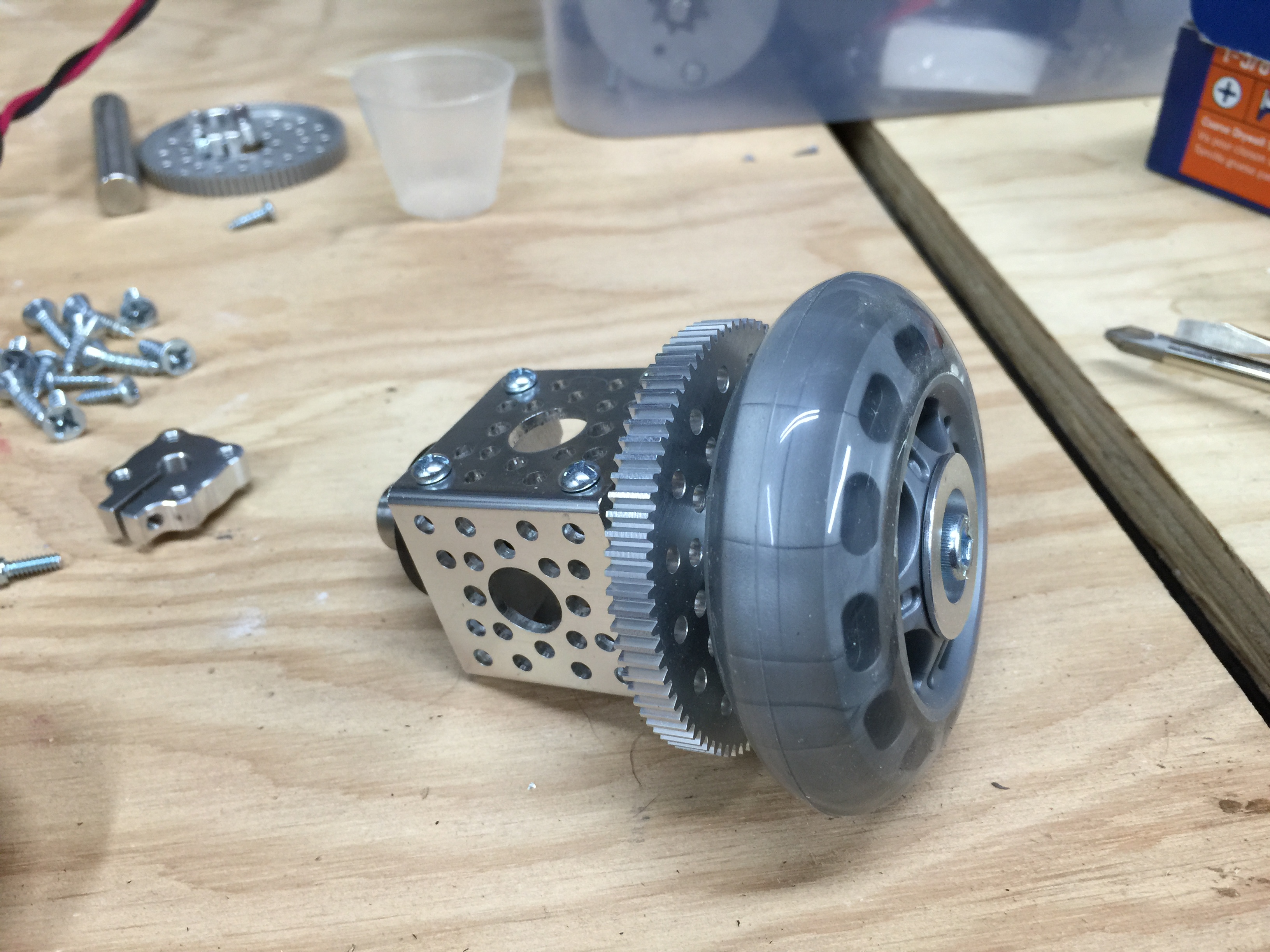

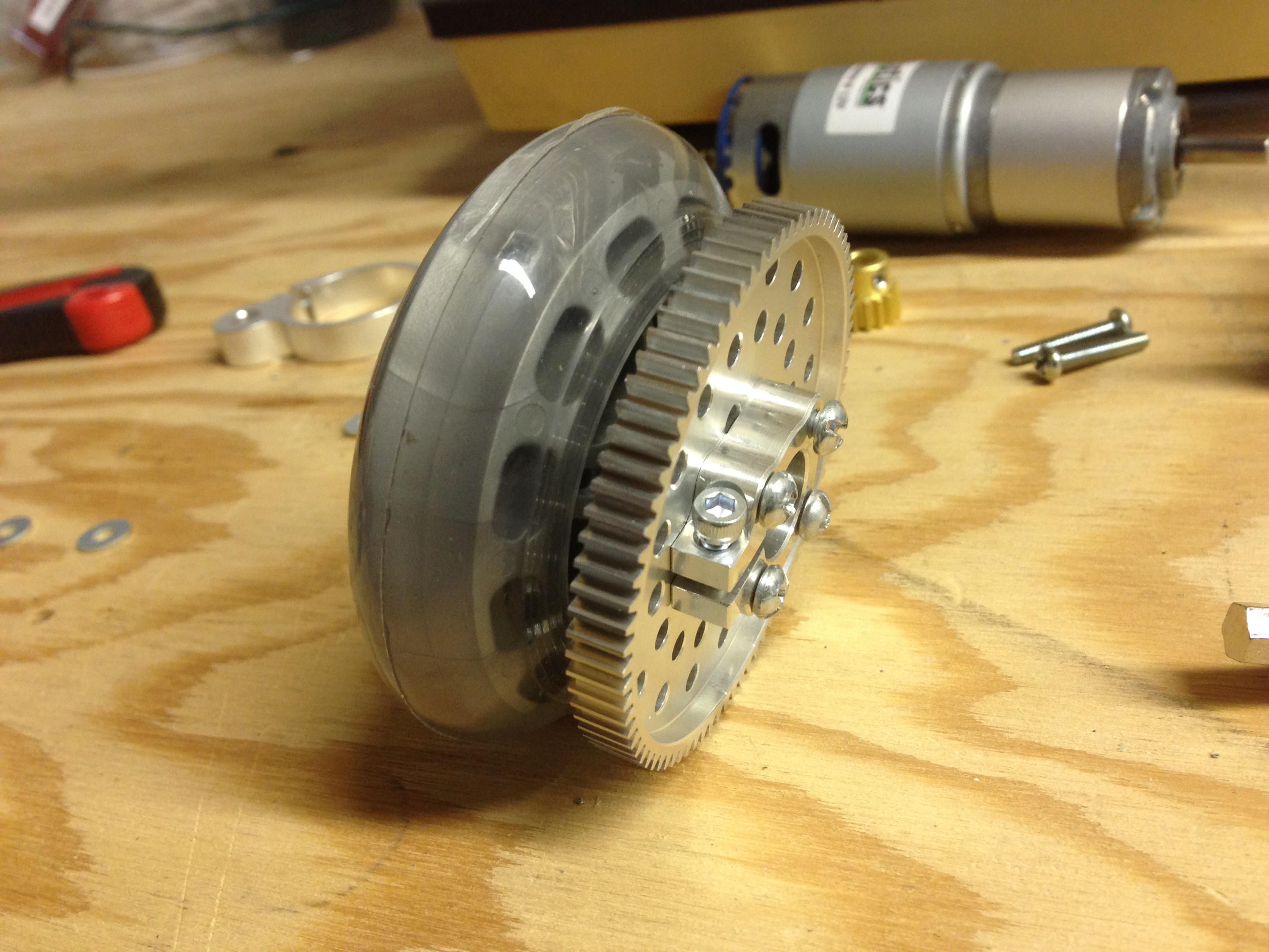

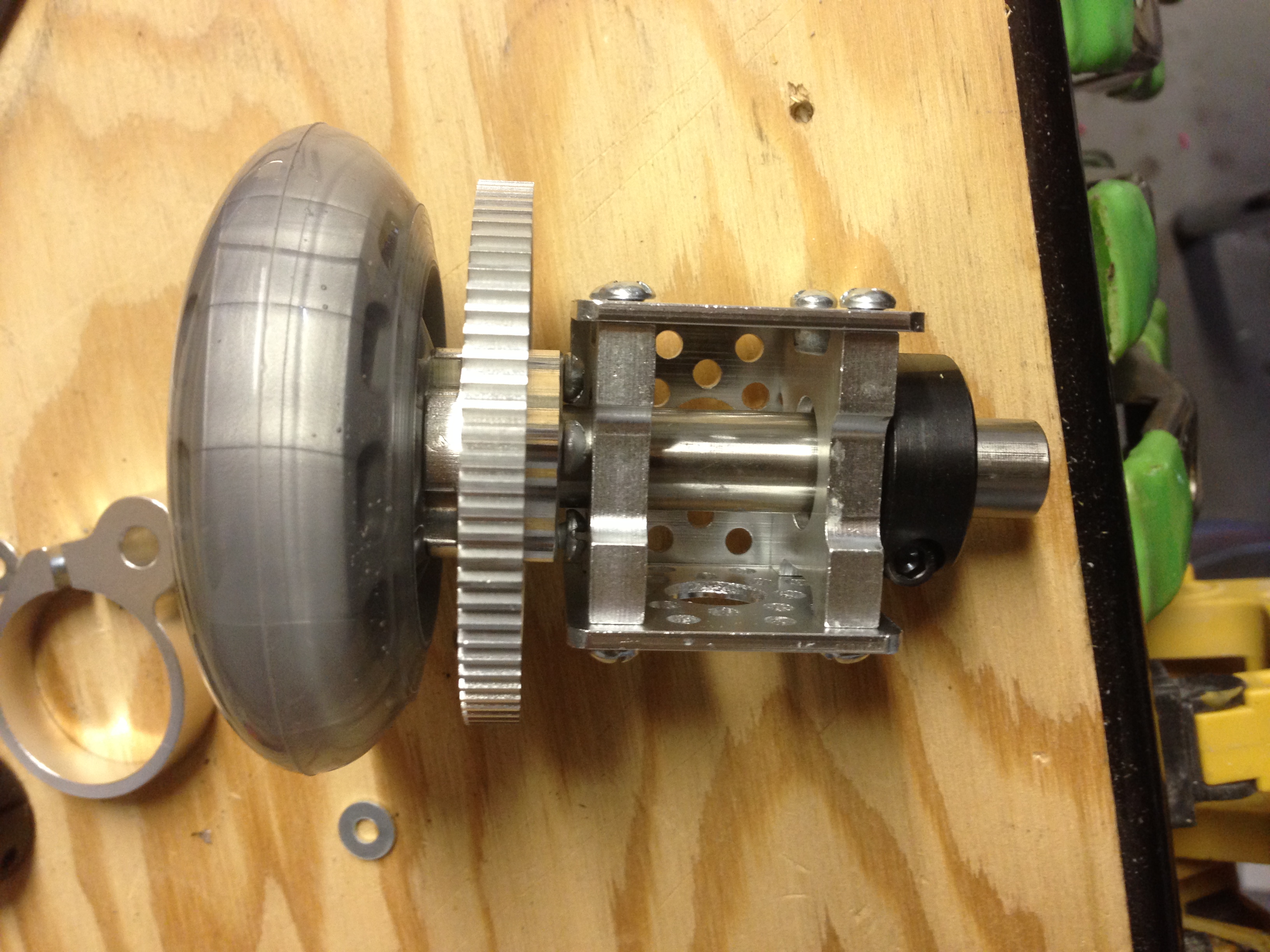

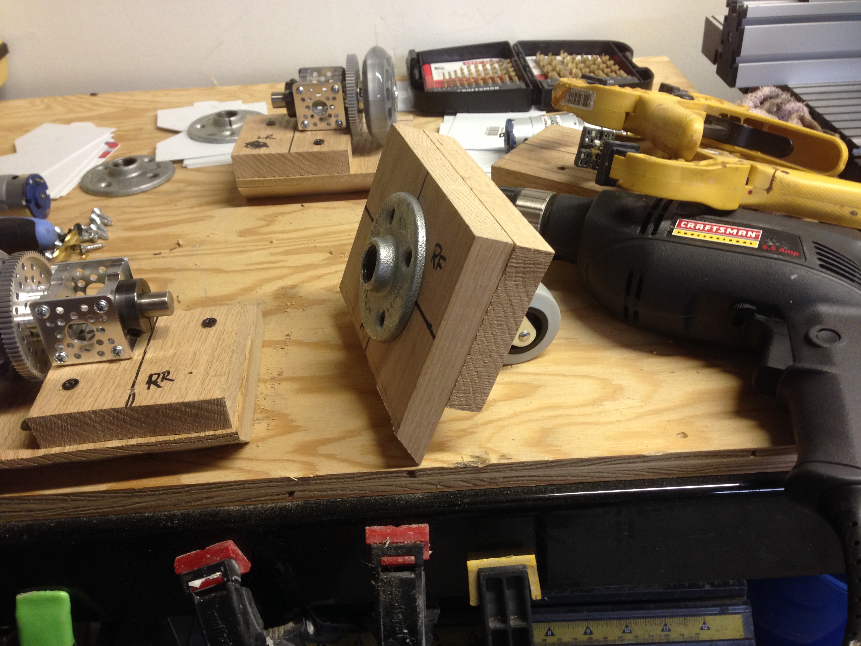

However, I decided to change how the motor setup was going to be in each foot. I posted a while back how the setup would work and now I plan to simplify the whole thing,
Disassembling the original idea.
The new plan a single hub attached directly to the motor.
