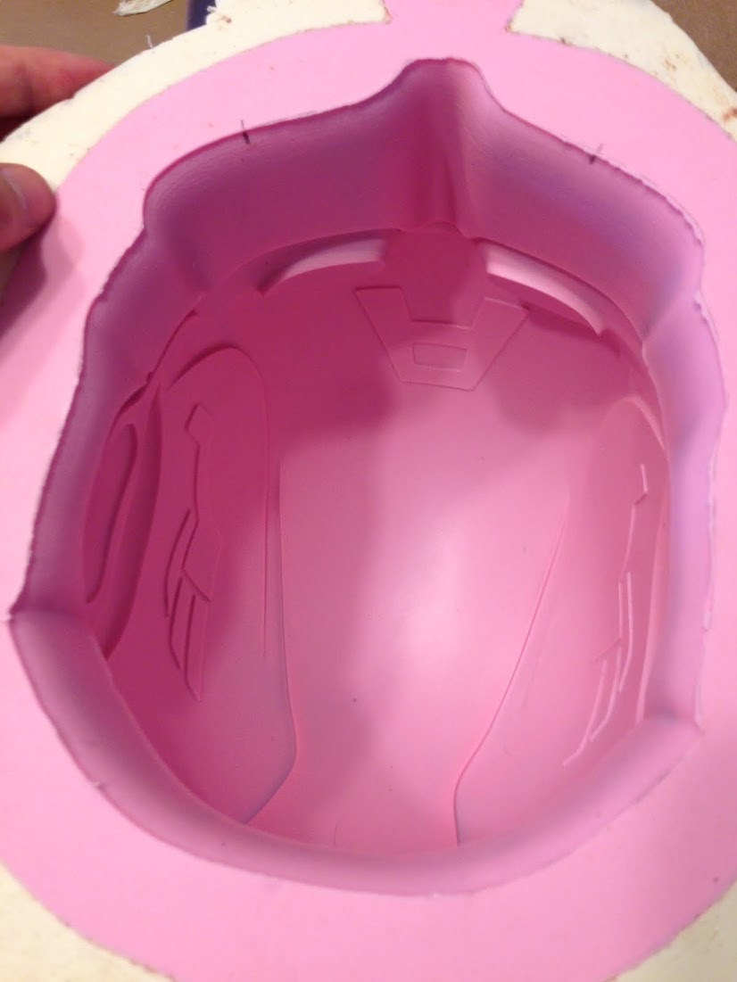

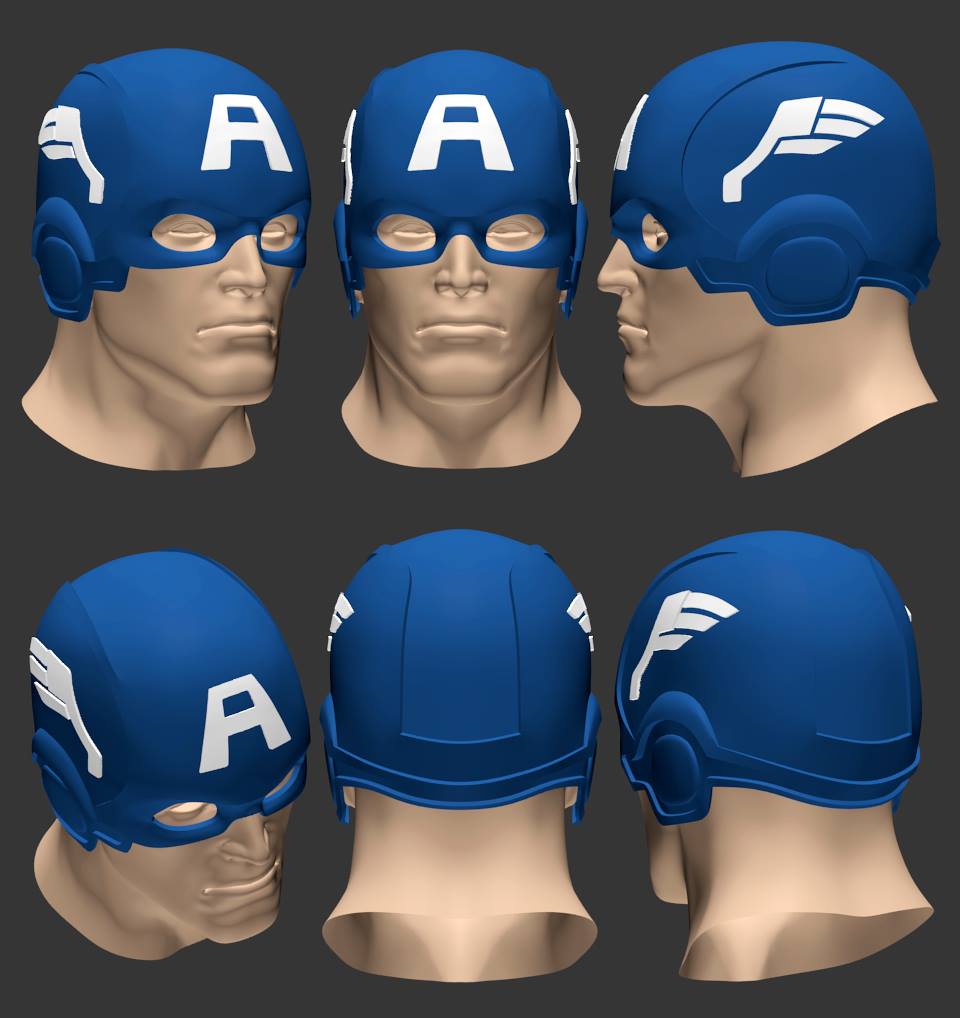

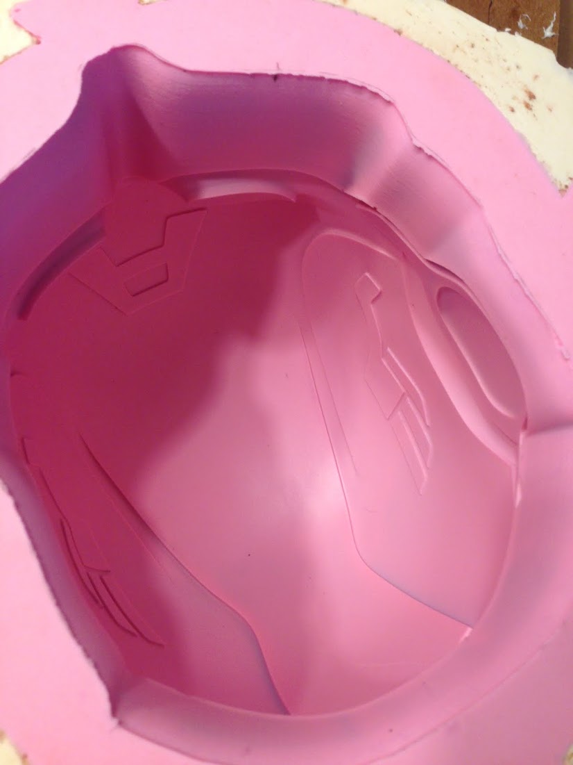

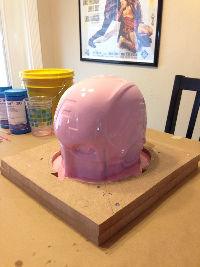

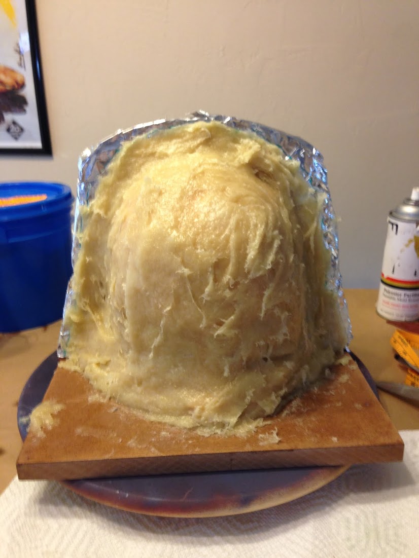

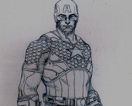

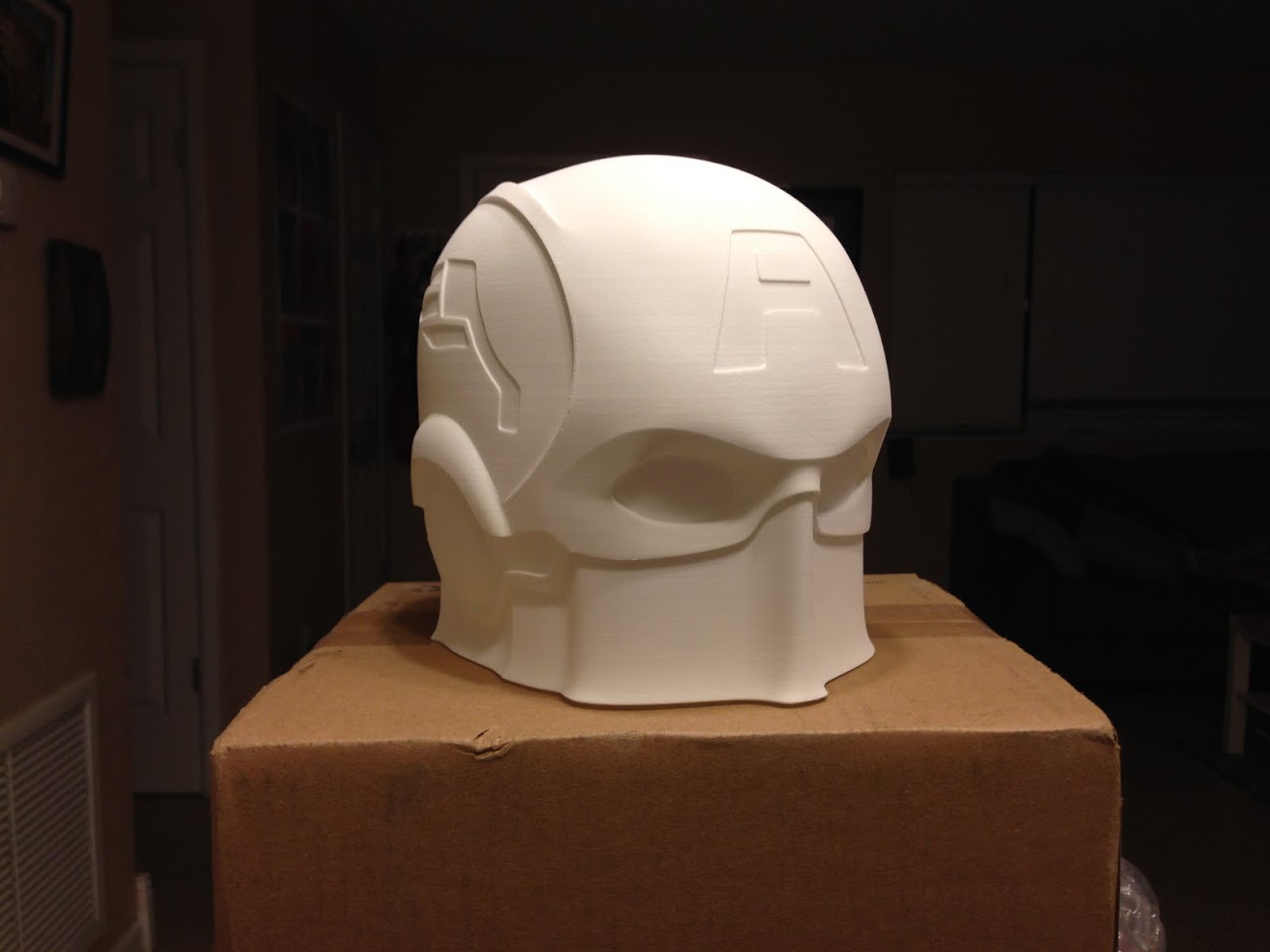

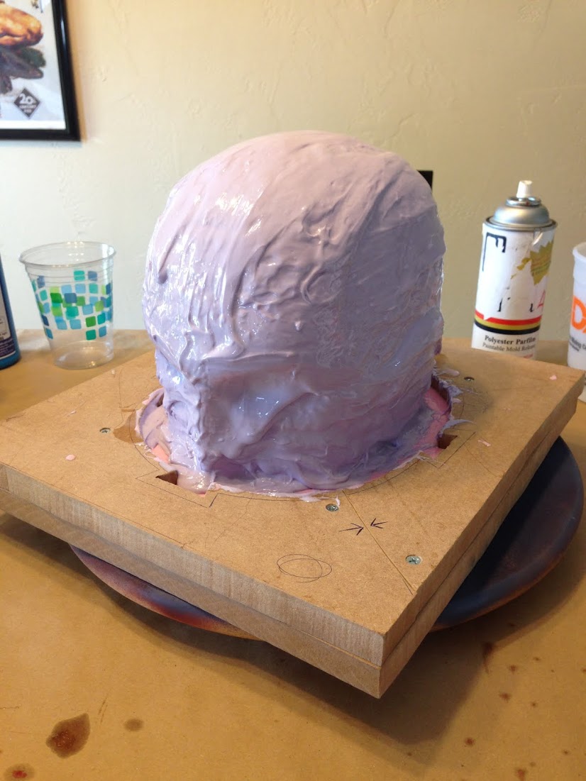

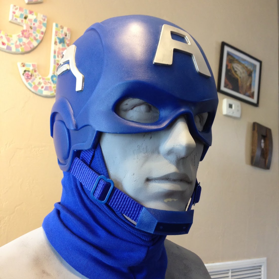

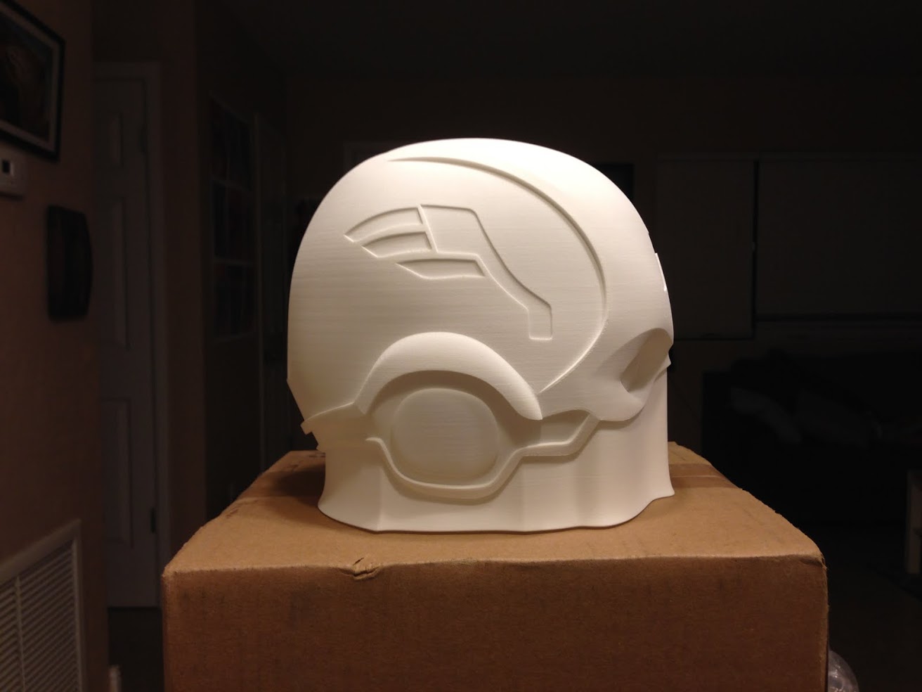

I began by 3D modeling the helmet based on some artwork I was provided, I took creative liberties obviously. I then prepped for print and sent it off to be printed. Once the print arrived, I spent countless hours filling, spraying and sanding until I had the finish looking as damn near perfect as I could. :) At that point I prepped it for molding, molded it, doing the A and Wings as separate pieces, that way they could be tinted with aluminum powders, giving people an option for recessed or relief details. :)
I then prepped the chin cup for print, and did the same steps as above. The strapping was cut and sewn myself as I couldn't find anything I liked out there to do the job right.

Reference Material
3D Model

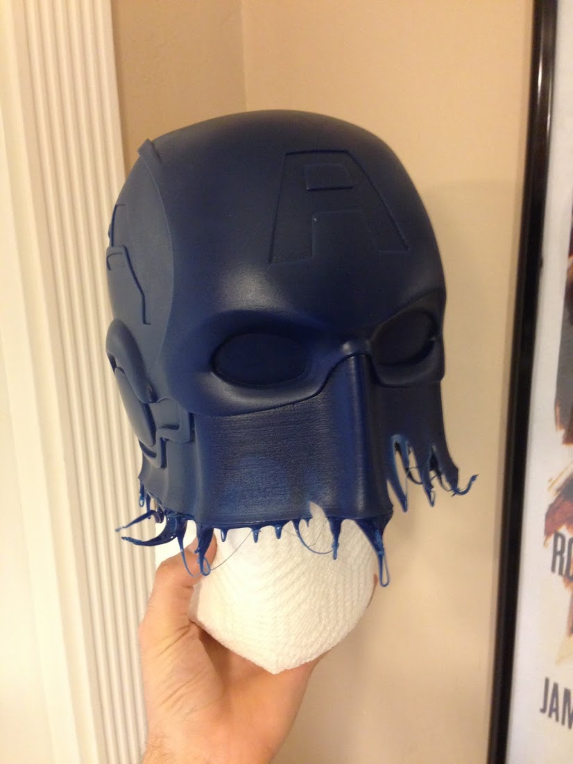

Raw 3D Print

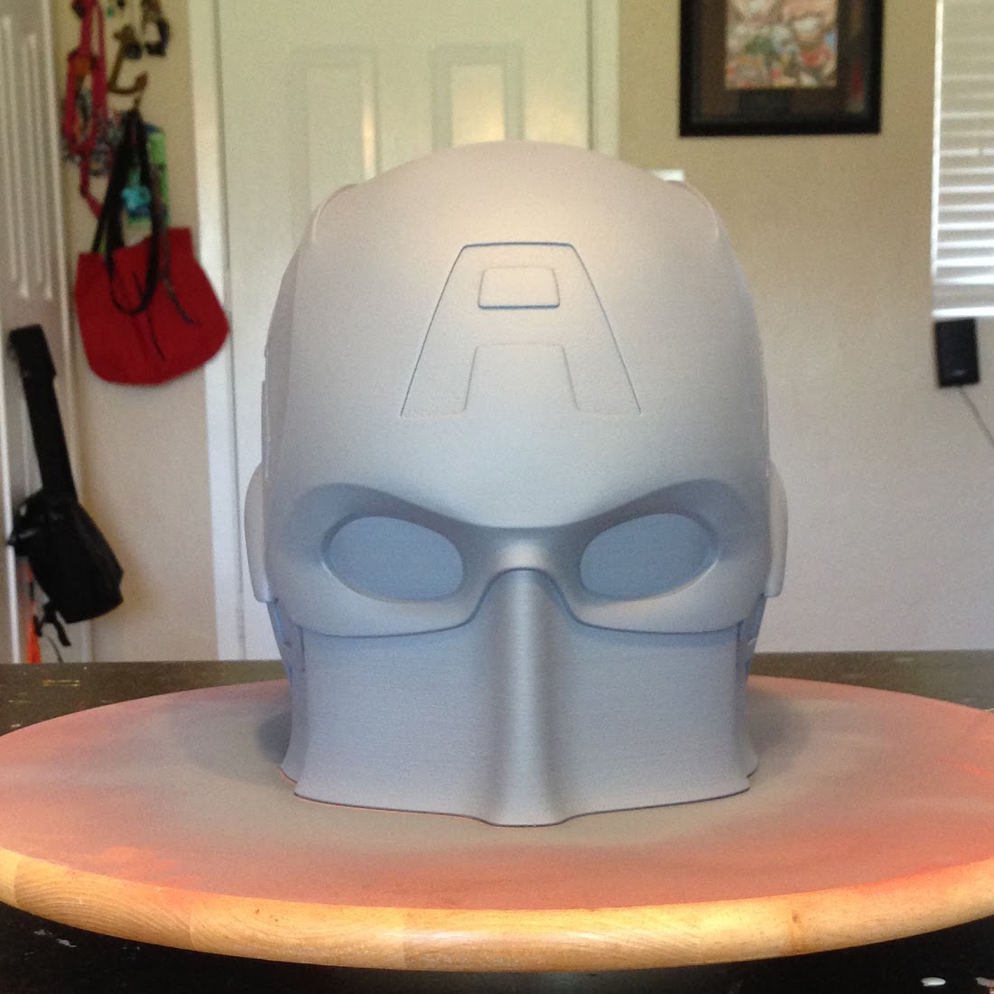

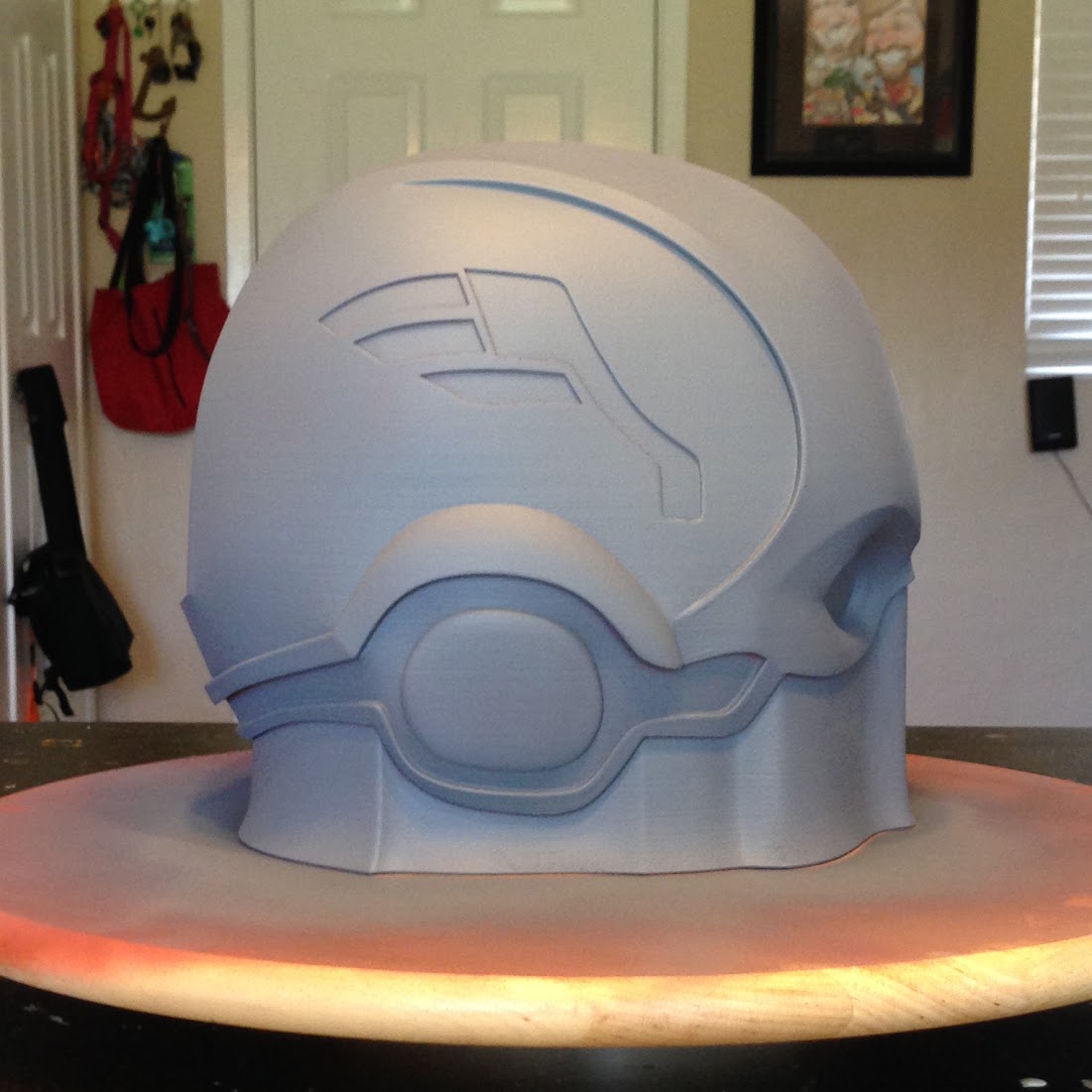

Cleanup Begins

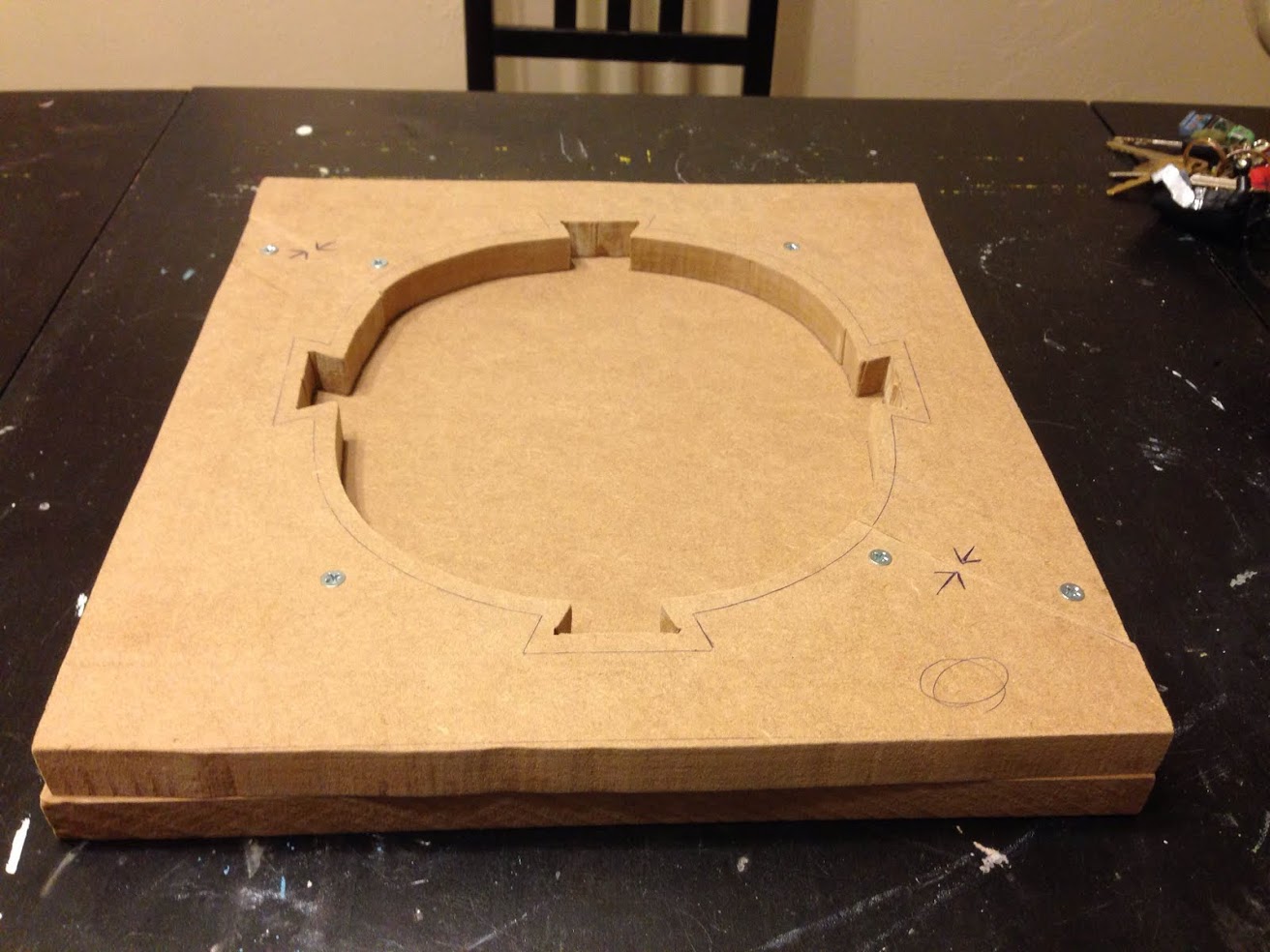

Molding Prep

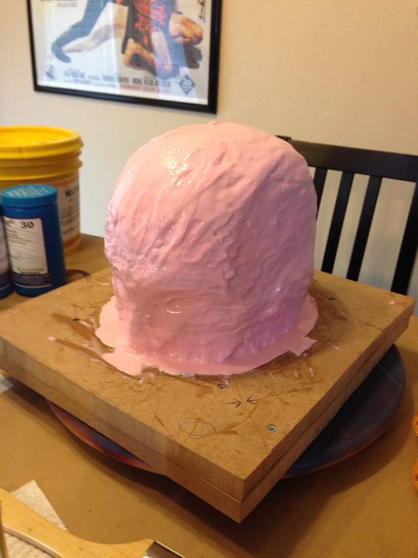

Molding
Finished Mold

Finished Helmet with strapping
You're absolutely right! :) The rubber is tinted blue, and the A and Wings are brushed with aluminum powder before pouring the rubber for those. So yep, no paint, and it's nice and comfy being rubber and not resin.
