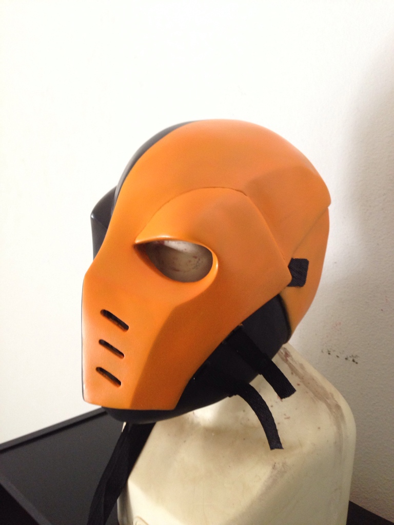

The Collar is an add on. I could see that in those earlier profile shots. I really don't think there is one type og orange in this new suit either. Metallic orange, fluorescent orange, semi-gloss orange, Bronze Orange... i keep having people ask me what color I used for the helmet to match other elements, I've told a couple people not to bother.

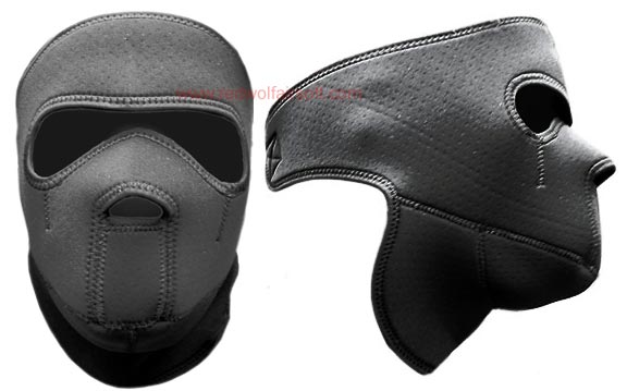

By the way, the black pièce under the mask, over the lower jaw and chin and around the neck looks like neoprene to me. Same stuff as diving suits. It is most likely custom, but I think one of those neoprene Airsoft mask could do the trick ! I'm gonna take one, it'd would make a good base to start with anyway.
Neoprene needs sewn to shape it properly, and I really hope no one makes airsoft armor out of it. I was thinking about doing the collar, but every bit I seen in both studio shots of reference it either looked Neoprene/ soft, then in some shots it looks like a thermo-formed kydex ballistic collar that gives the character a bottleneck look.
They do make Airsoft mask out of it :
This one doesn't have a full neck cover, but you get the idea. Would wear a balaclava under it to complete the look though
The seamlines on that would match up to. i just don't get into the airsoft thing, so excuse my ignorance. It just seems like the Neoprene wouldn't absorb impact that well.

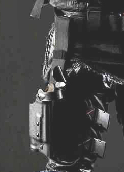

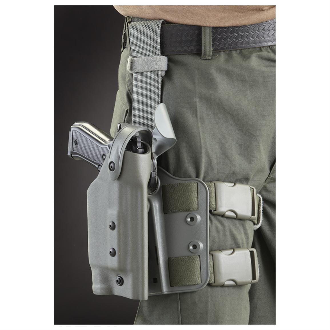

Been focusing on the holster, it looks a lot like a Safariland SLS with Surefire to me :
View attachment 328987View attachment 328986

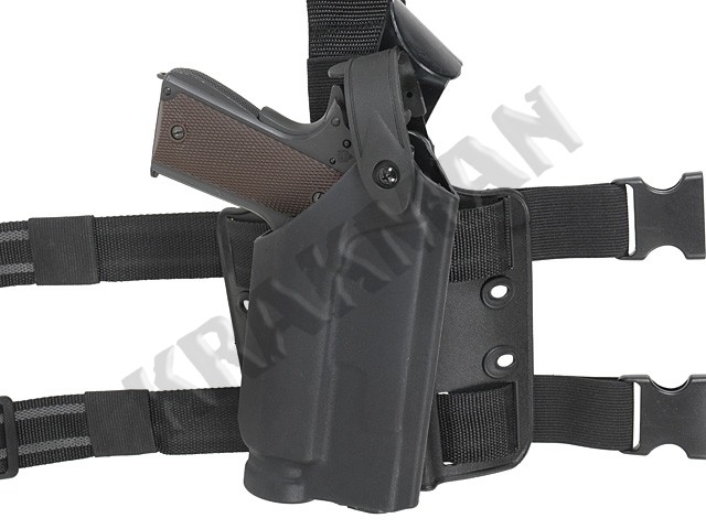

But maybe an older model, because most SLS dont have the three screws on the side and don't have the same shape, they look more like this :
I could only find the right model for Beretta or Sig though, so the Tisas must fit in one of these, or they modified one to fit the Tisas.
The other leg has the same safari land platform with a dual pistol mag pouch, by safariland also I believe. They have done something to the straps though, they re-arrange the way they go through the platform, going behind it instead of in front of it like in the pics, put some orange stitches on them, and wrapped some of that blue carbon fiber pattern on the platform too.

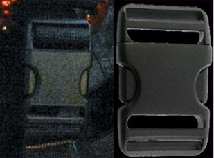

It's a detail, but I think I found the buckles used in the suspenders (and possibly on the arms too) :
It's called highlander quick release buckle 38mm

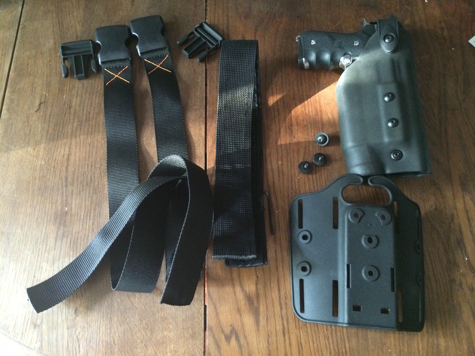

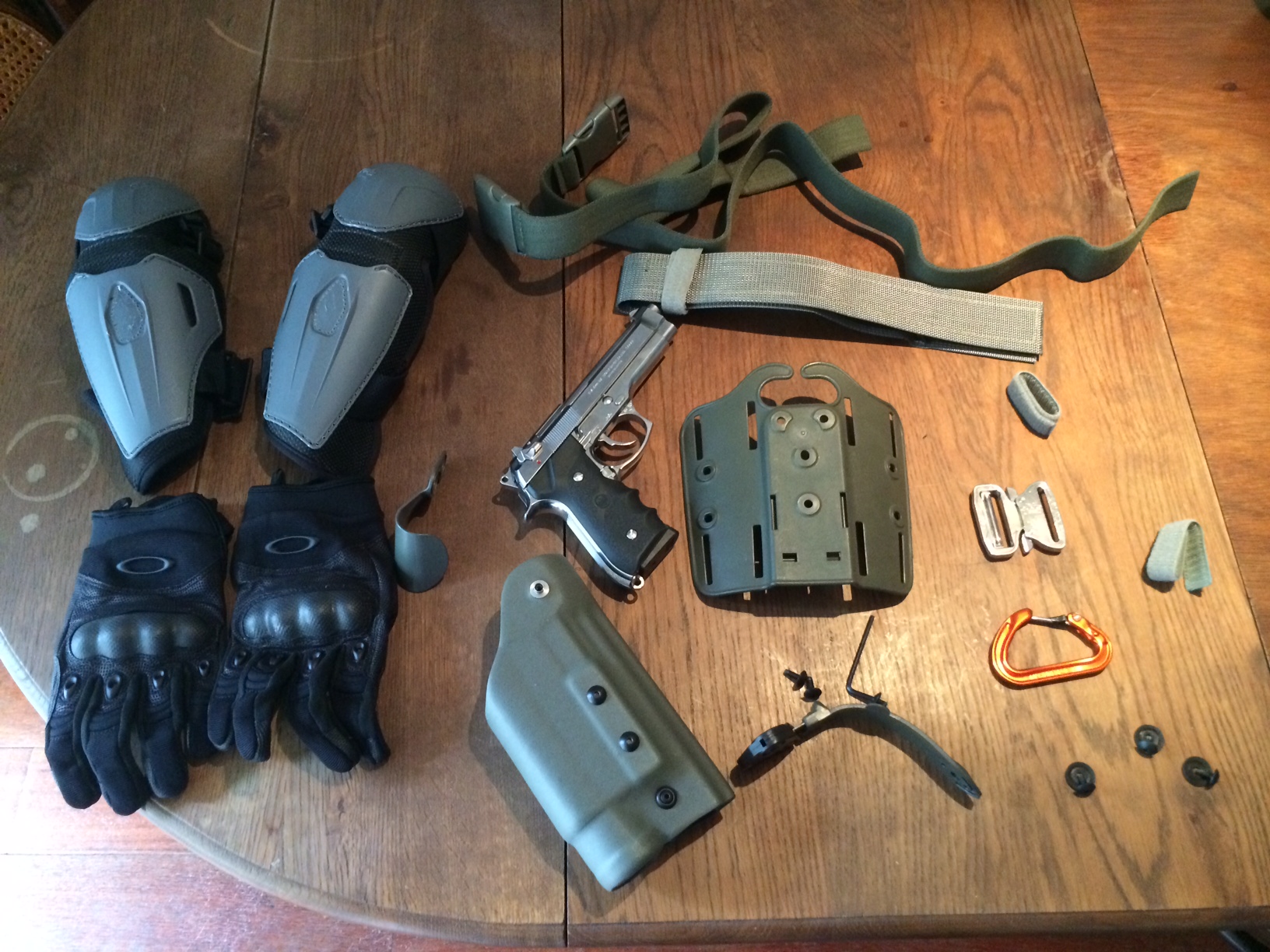

That's not the right holster though, this one is the correct model, but not the correct color (OD instead of black) : New listing SAFARILAND STX TACTICAL LEG HOLSTER BERETTA RIGHT SLS 6004-736-541 GREEN - NEW!
I couldn't find it in black anywhere though, I got mine in OD and painted it black, dyed the belt strap black and made new leg straps in black since the dye weirdly didn't take on the leg straps (but the belt one did...Go figure...)
Before / After (and I realise now the holster itself could use another coat of black again)
That's not the right holster though, this one is the correct model, but not the correct color (OD instead of black) : New listingSAFARILAND STX TACTICAL LEG HOLSTER BERETTA RIGHT SLS 6004-736-541 GREEN - NEW!
View attachment 335373View attachment 335374

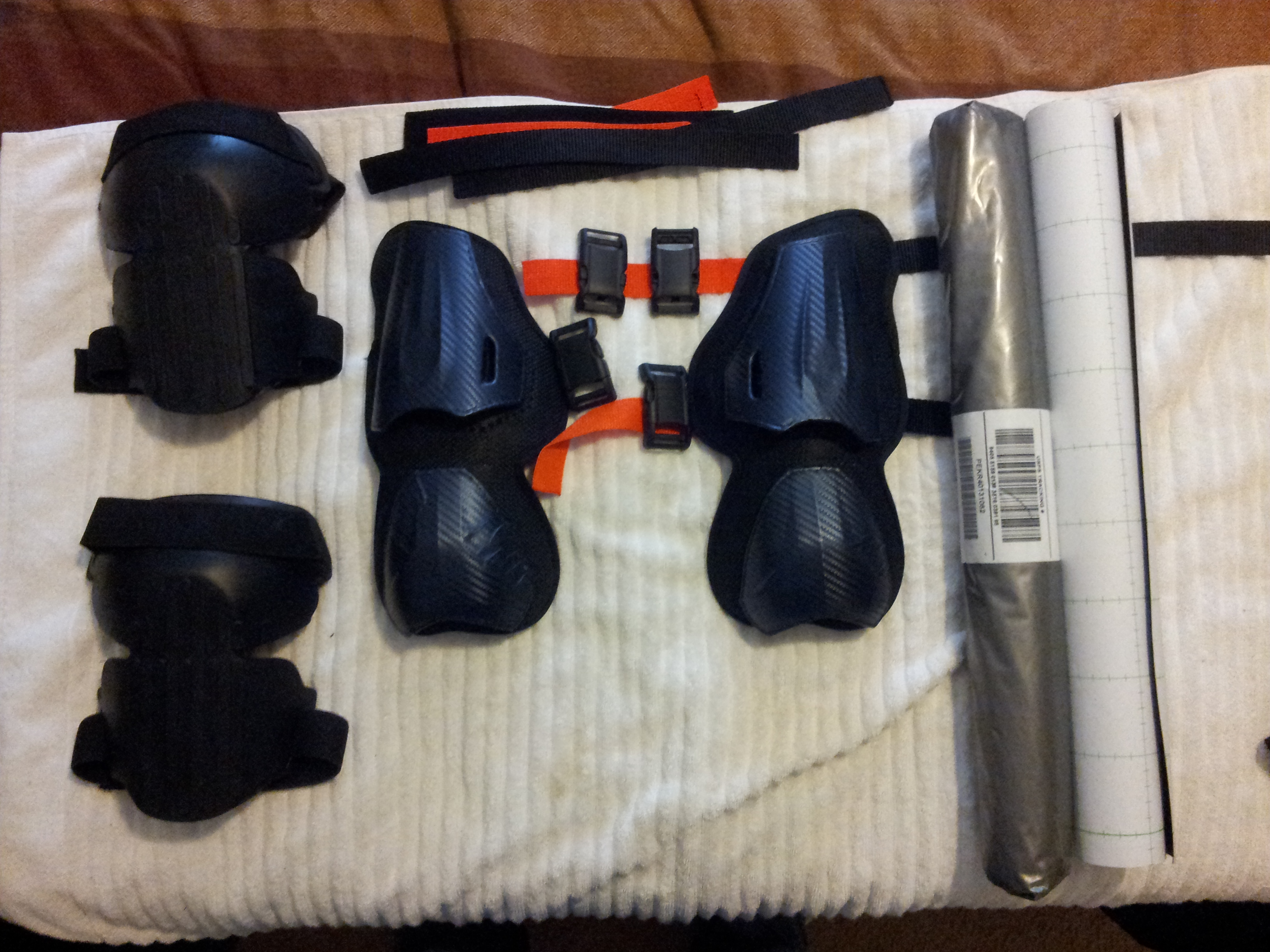

Does anyone have tips on applying carbon vinyl on complicated curves ? I tried doing the elbow piece today, it's a nightmare ! Even with the heat gun it still makes creases everywhere :(
I'm sticking with the beretta because I already have one, and the tisas is just impossible for me to get indeed. But it makes sense it's a sig holster, the tisas is more blocky like a sig.
I was going to go with Rubber Cement or Superglue when I got to that stage.
The stuff I linked earlier goes on a lot easier. I highly recommend it.
