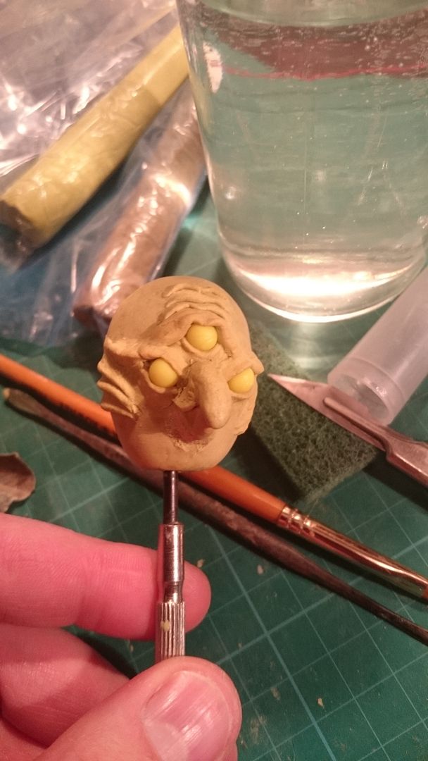

Yet to come: some detail in the cockpit- maybe a sculpted Martian? Definitely something other than the current scrap of tissue paper as a light diffuser, anyway! Some detail in the two cutouts on the underside of the head, and I'm wondering if I should have a basket for captured lunch, er, humans, or save that for the Martian Handling machine model that will inevitably come along later...

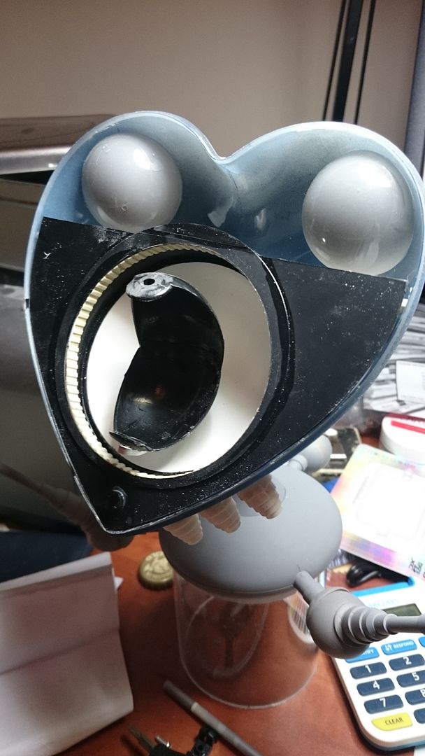

Firstly, the cockpit I was working on just wasn't working, so I scrapped it and started again, coming up with this cockpit bucket:
With a shaped seat, made out of two LED lamp covers that had sacrificed their gooseneck bases for tentacles:
Which go together like this:
I'm aiming to add controls and a Martian creature to the seat, maybe over the weekend...
