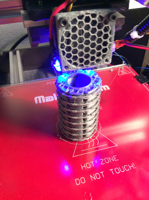

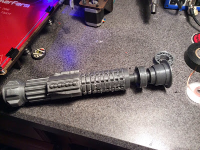

This is so awesome. here's my build. just got my printer and this was my biggest build. In case anyone is curious how the process looks, it's like Valcrow said a computer controlled very accurate glue gun. here's the grenade being started and about halfway through. the extra material is support material to keep the melted plastic from drooping. the grenade took me about 8 hours. I was pleasantly surprised at the accuracy and how clean it came out. I'm still trying to remove the support material from the grenade, mine got really set in there so it didn't come out easy.

I gambled on my grenade and printed without support knowing what a mess it would be to clean up. Fortunately it came out perfect!
Thanks everyone!
There probably should have been more instruction in hindsight, but it is designed to be printed without supports including the grenade part. If you look really really closely, the angle of each row of grenade squares is less steep on the overhanging side than the top side if you orient it the way it's printed. enough to make a bit of a difference when printing the overhangs, but not quite noticeable enough visually as a flaw. You shouldn't experience any printing issues unless you're running too hot or fast.
There are a few areas where it's accuracy sacrifices for the ease of printing in the 4 piece, that's the part where the pummel attaches to the bolster thingie, the buttons, clampy lever thing, the connection between the grenade and the clamp and the emitter is angled deeper. That's where the 14 part one comes in, it corrects all of those flaws for print, but only the most discerning crowd would really notice (I'm sure I'm in the right place for that :p). It also allows for mods if you wanted to put in lights or a crystal chamber or something.
