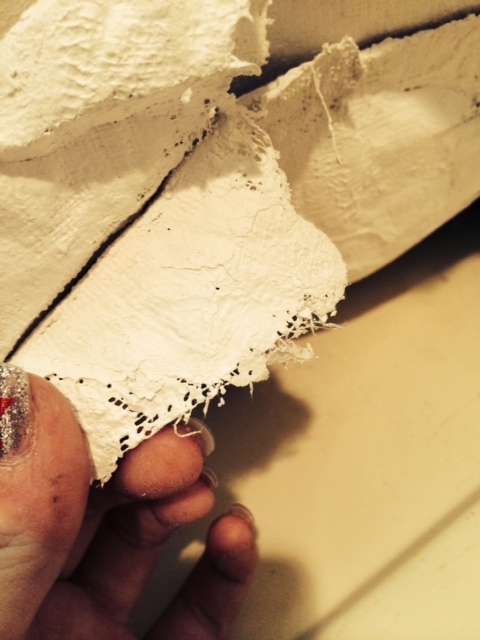

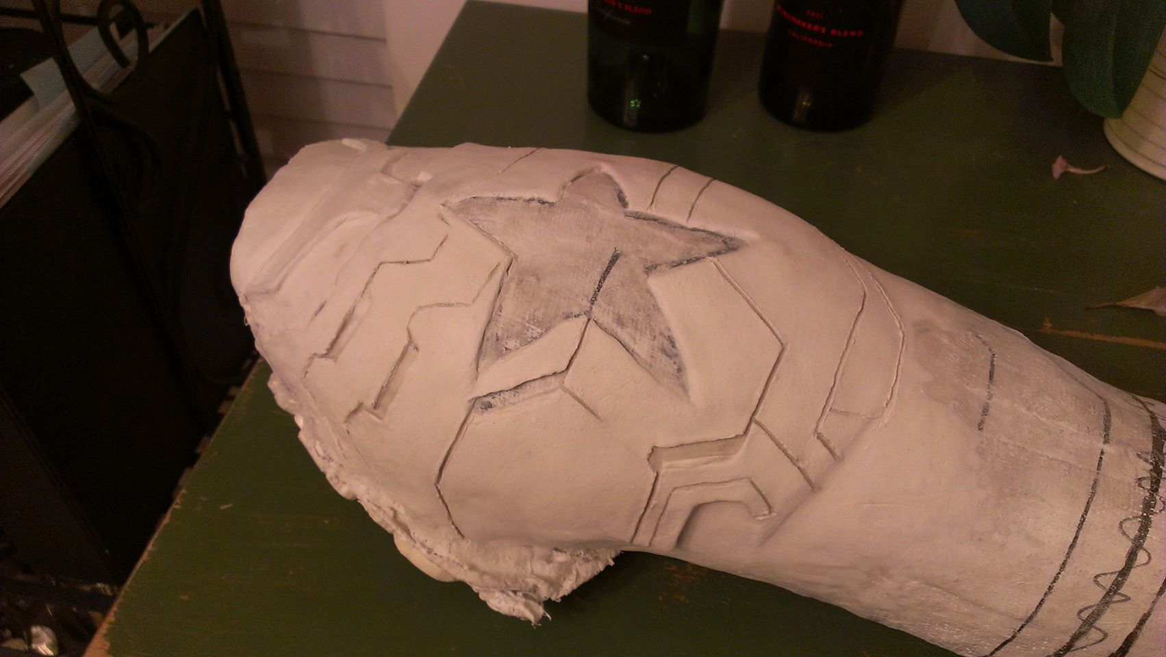

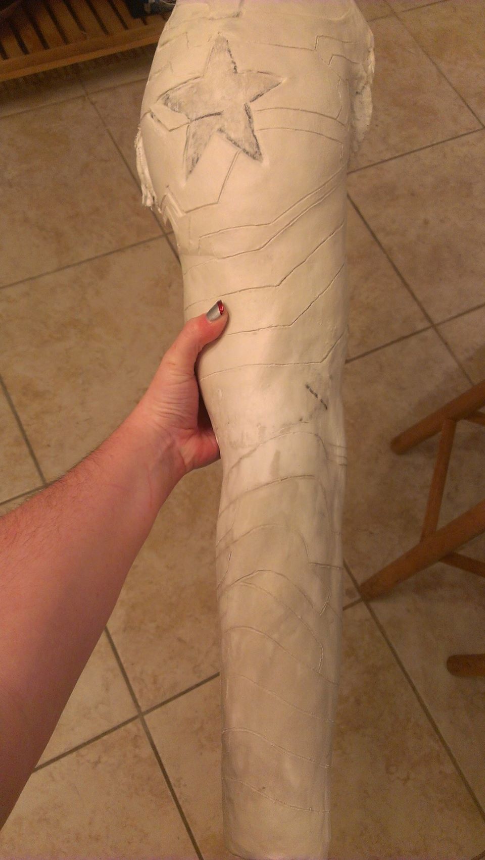

First I casted my arm. [Be sure to cover your arm with something or you'll end up with a nice hairless arm.] Once the cast dried, I filled it with expanding/hardening insulation foam (GE Large Gap Insulation Foam). After the foam hardened, I had a hard cast of my arm to work with which let me make the details and toned muscles with air drying clay:

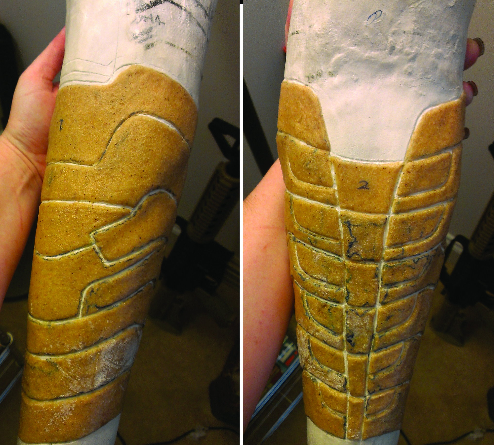

Each piece/band of the arm above is its own piece of Worbla- the medium sized roll was more than enough. I traced each piece on computer paper and then used that as a template on the worbla, and then heat gunned each piece into place on the cast. Once it was on the arm and still malleable, I molded it with a boning tool:
I strongly recommend a numbering system, especially for the forearm (above).
