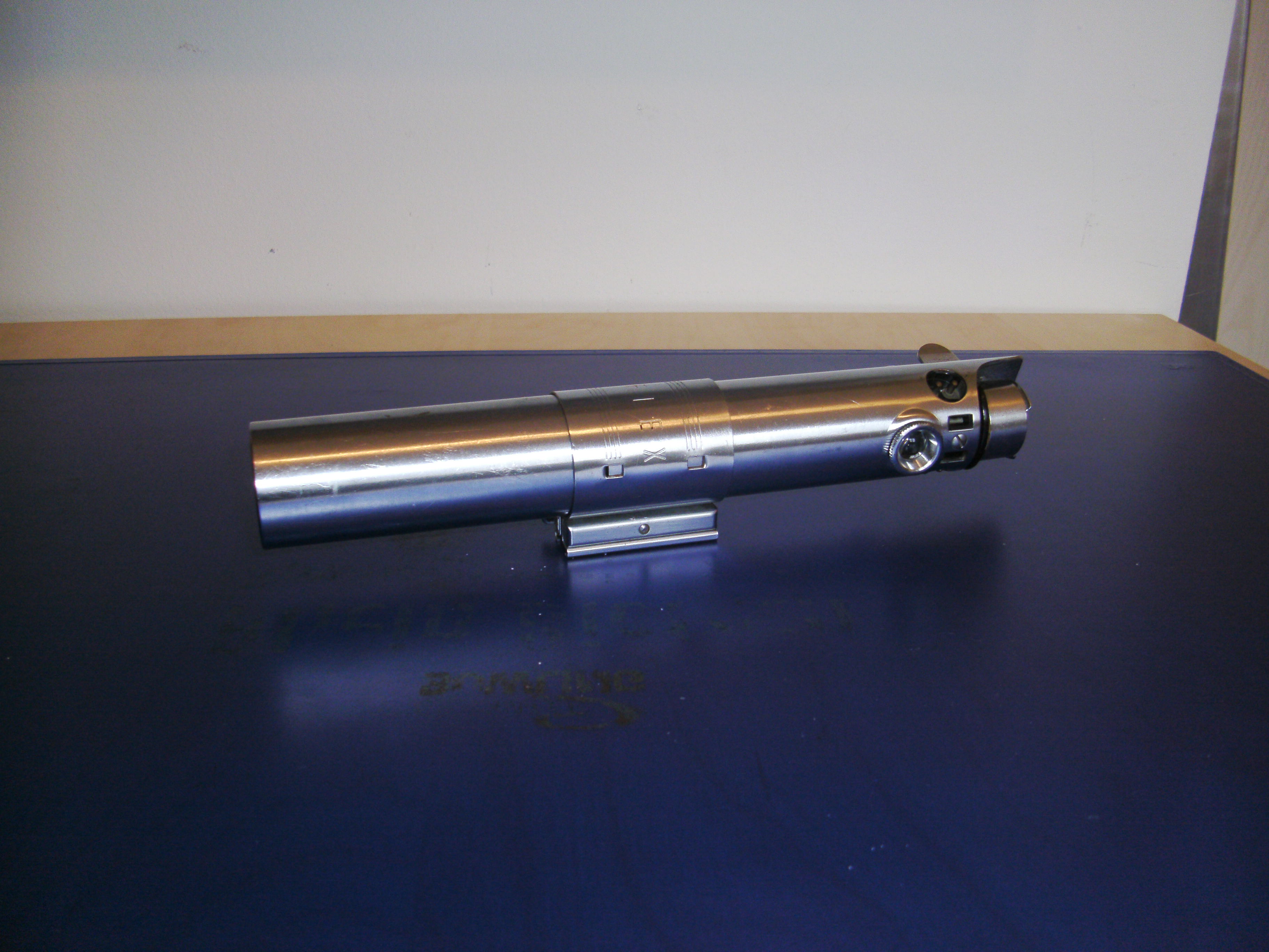

The finished saber you can see in this post: http://www.therpf.com/f79/prop-newb...mber-pic-heavy-206607/index2.html#post3220750

And so get my hands on a real vintage Graflex IV. My holy grail.
I will convert it into the first lightsaber I ever saw. The Luke ANH lightsaber he got from Obi-Wan.
I already got the pieces and have to assemble everything.

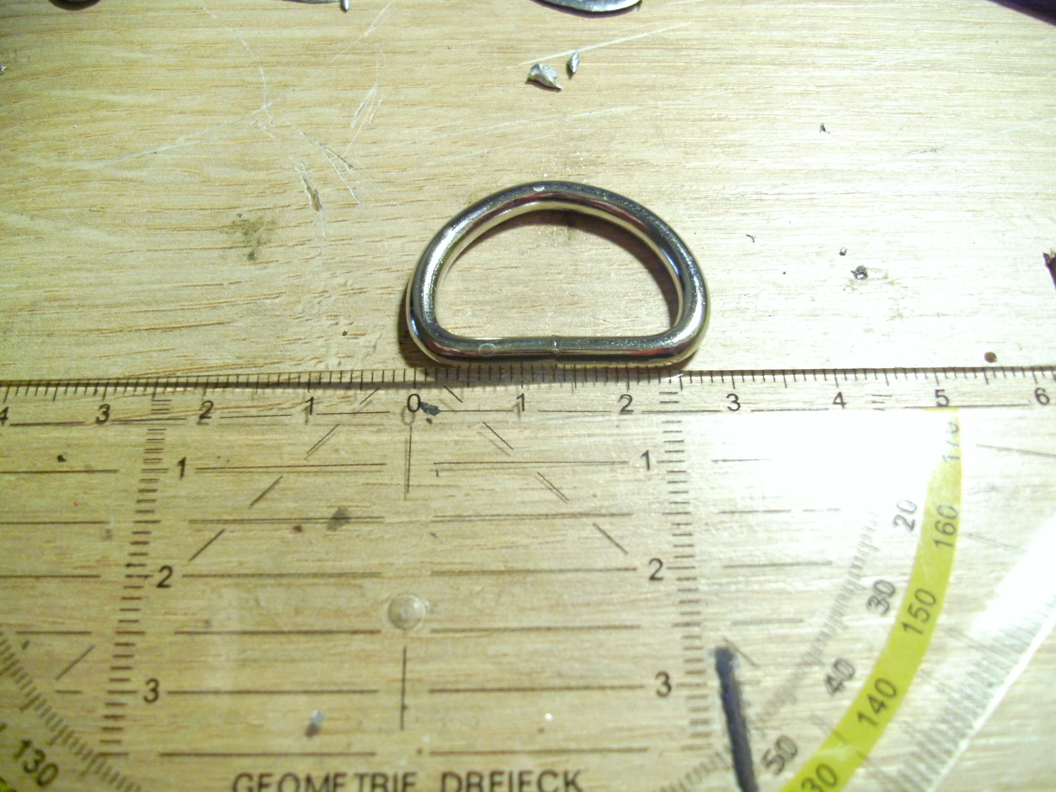

  • T-Tracks are from Marv
  • Original Bubble-Strip from Exactra 20
  • The D-Ring is from Amazon and has the right dimensions
The D-Ring-Clip is made by me. I followed the instructions found on the RPF (thanks Sym-Cha)
I will post some pics when it is finished.

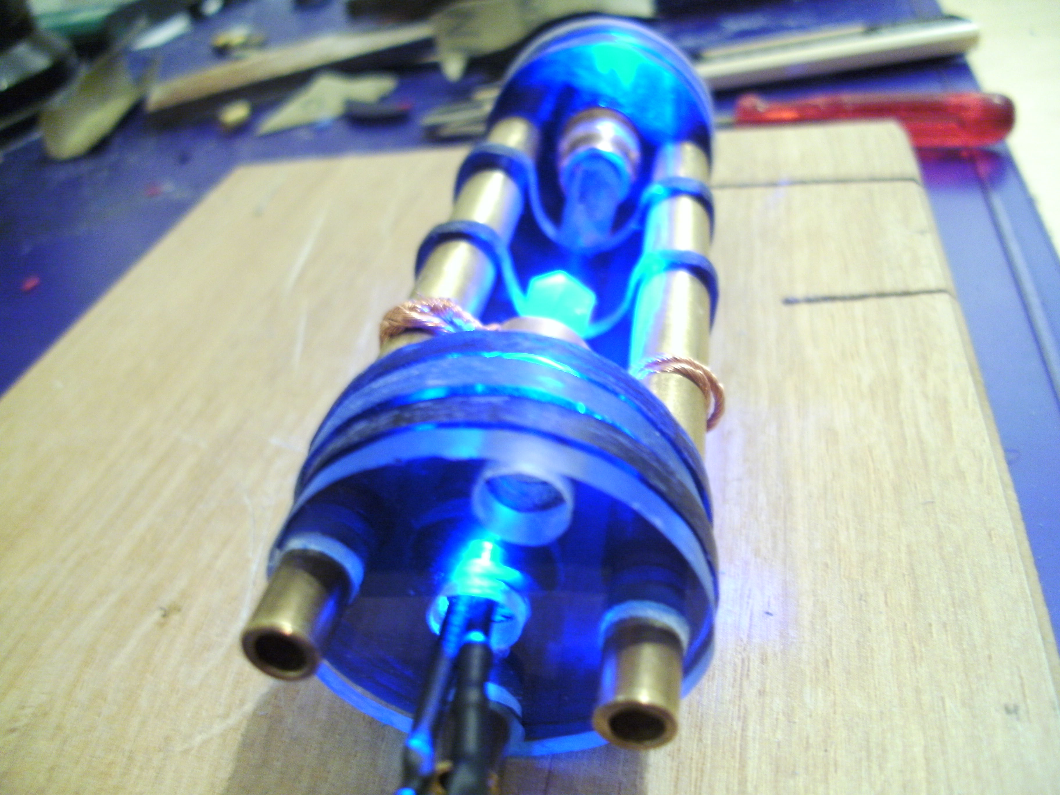

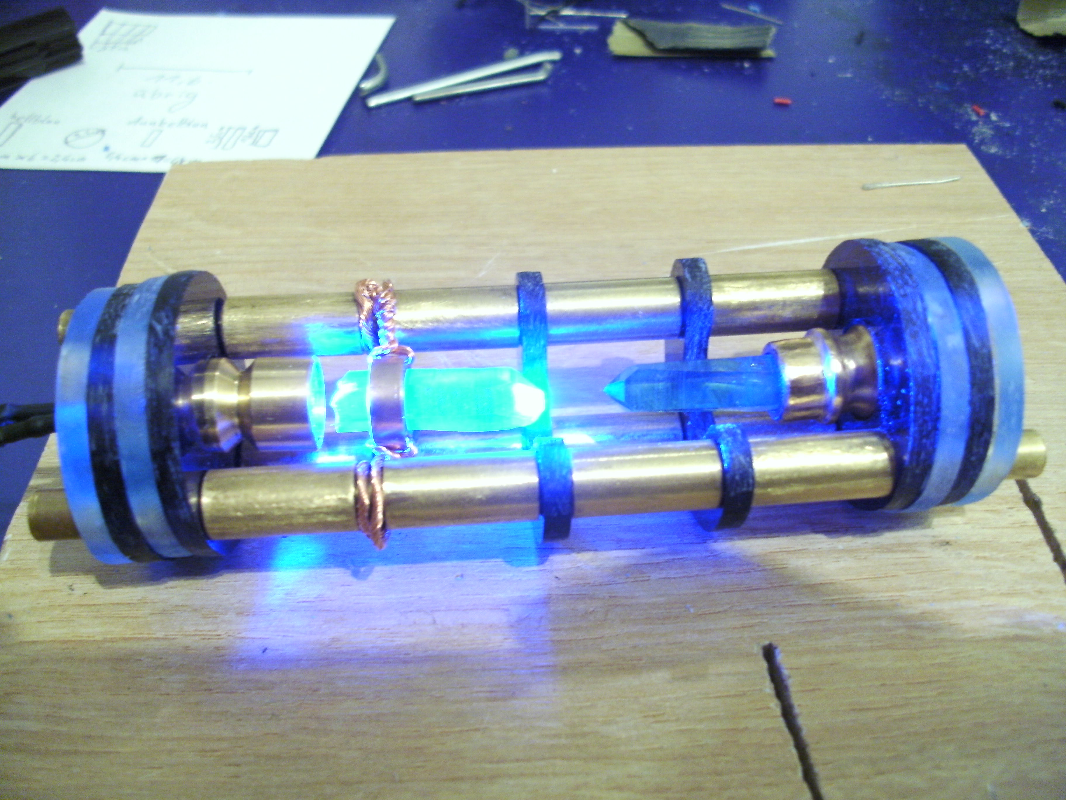

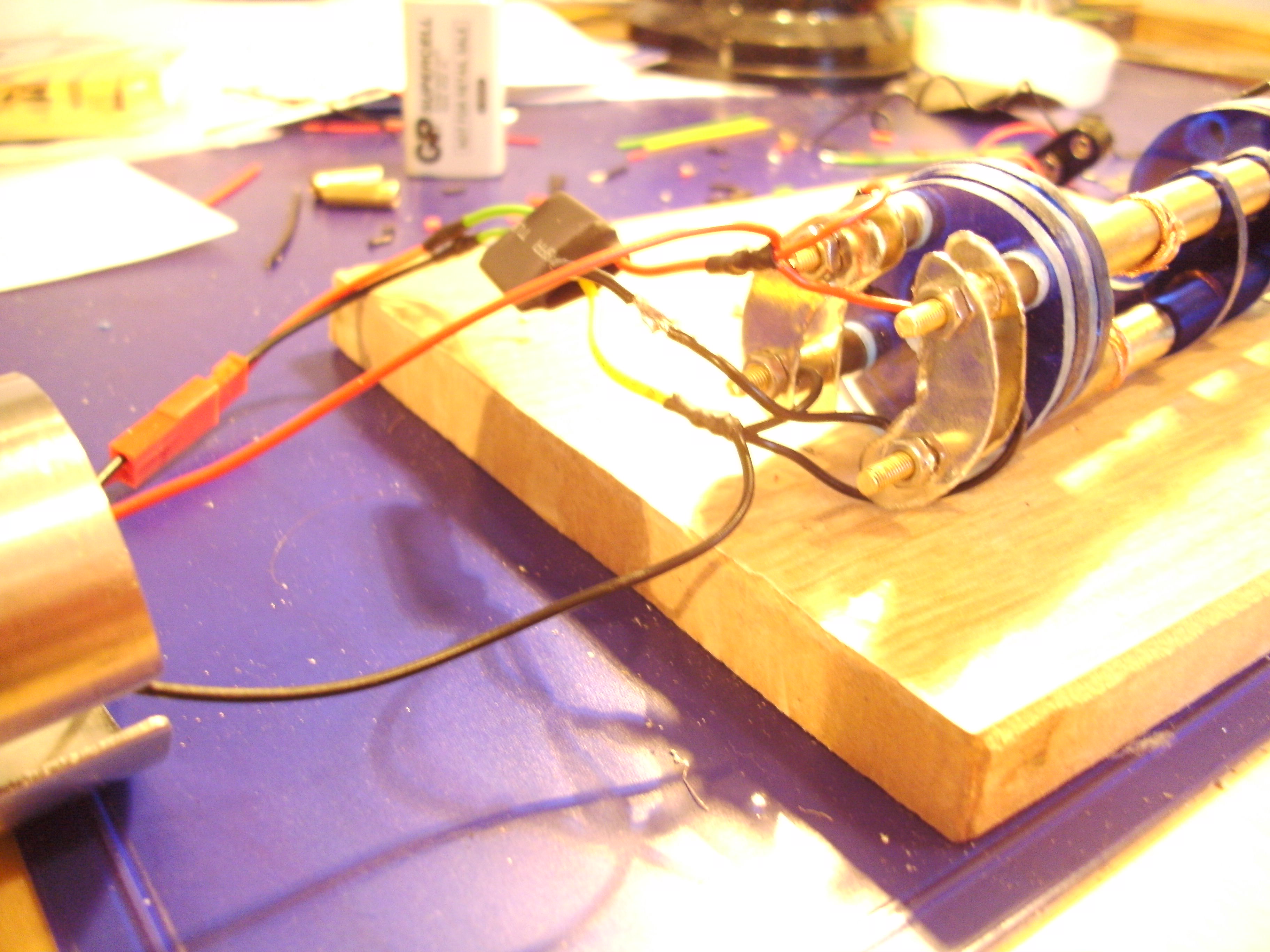

In addition to the outer appearance, I want to build a Crystal Chamber from found parts and some bought parts like the electronic, LEDs, crystals and the acrylic glass I used.
I started with nothing except my imagination and some suggestions I got from reading some threads here on the RPF.

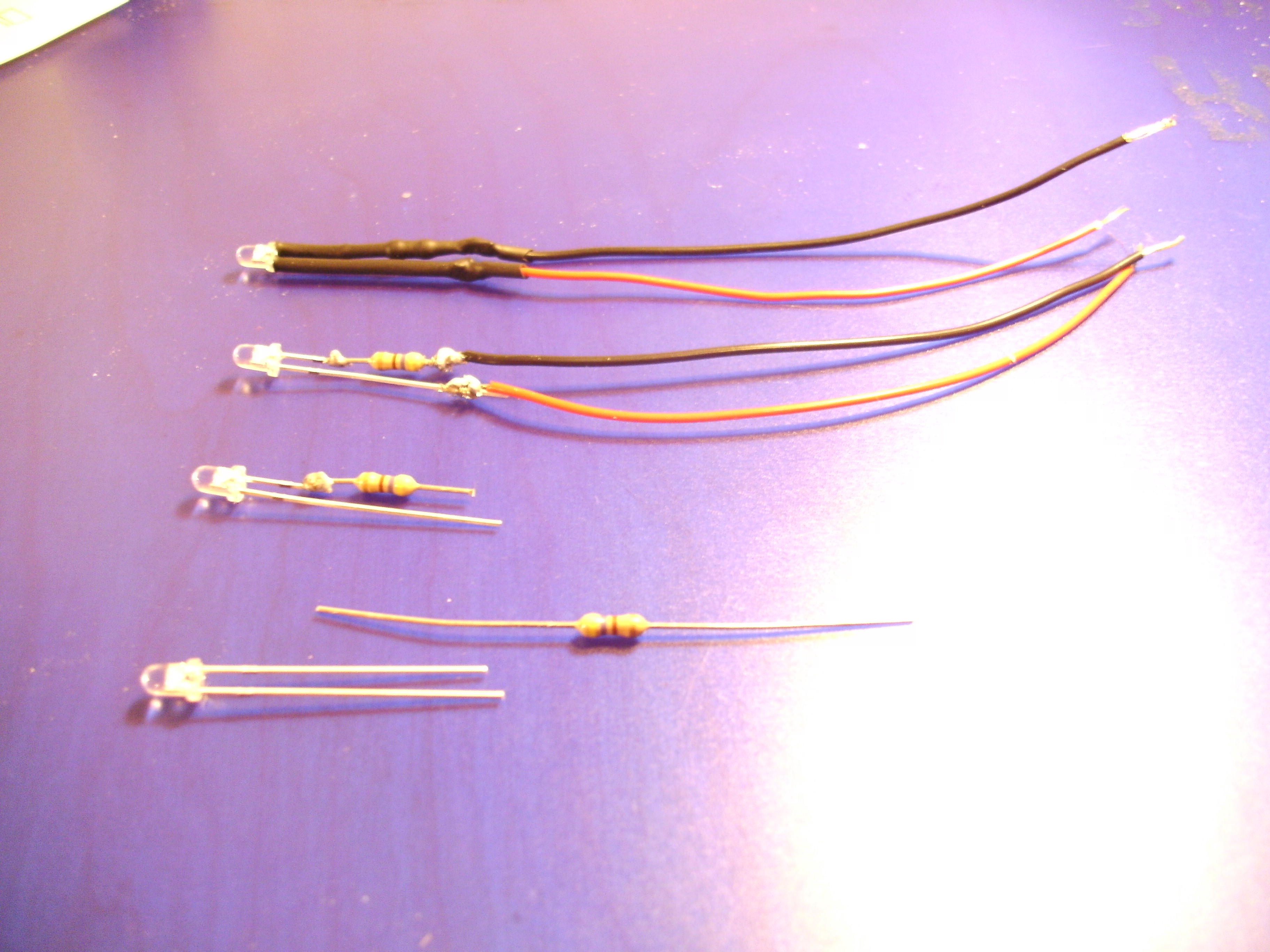

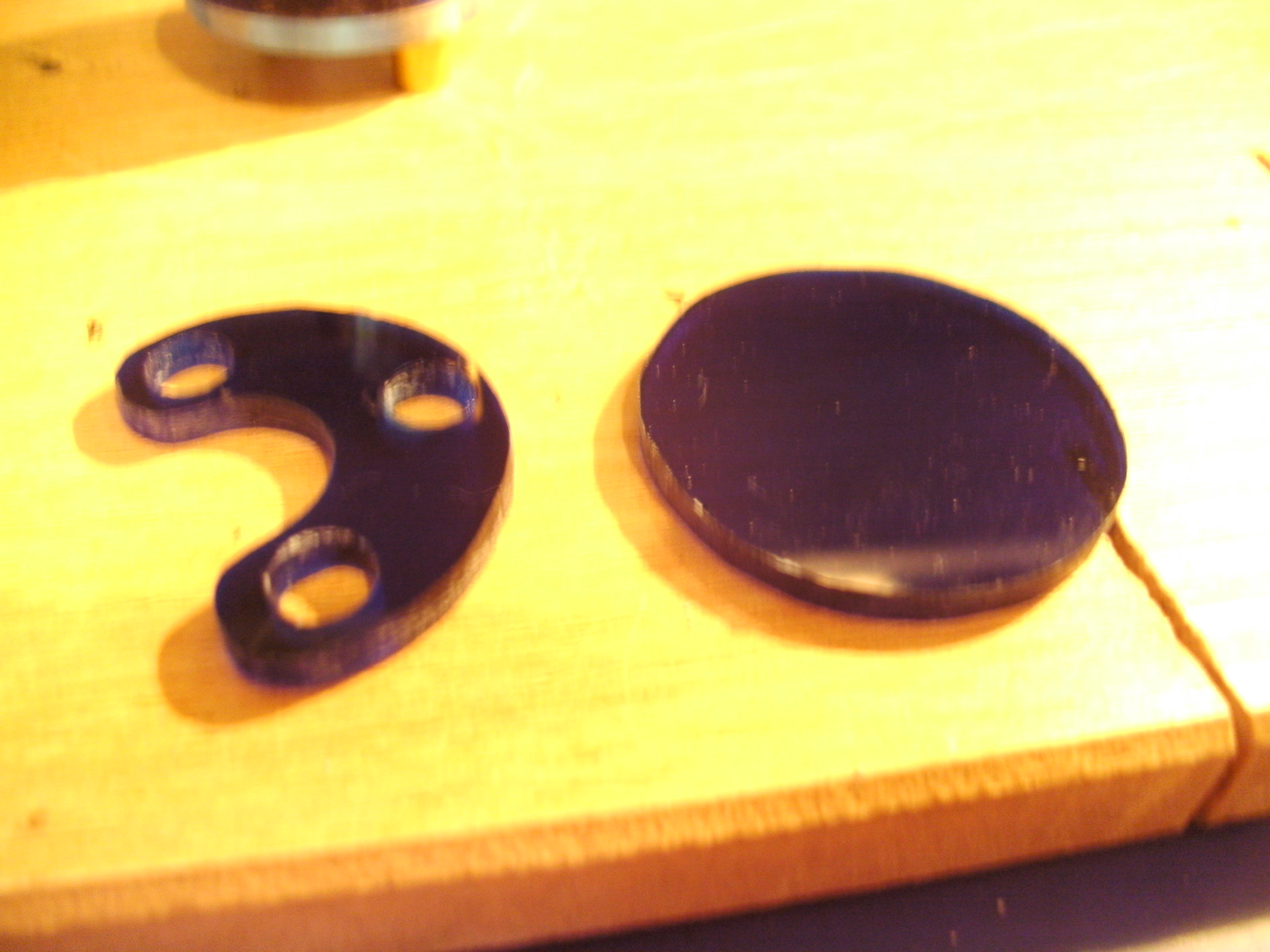

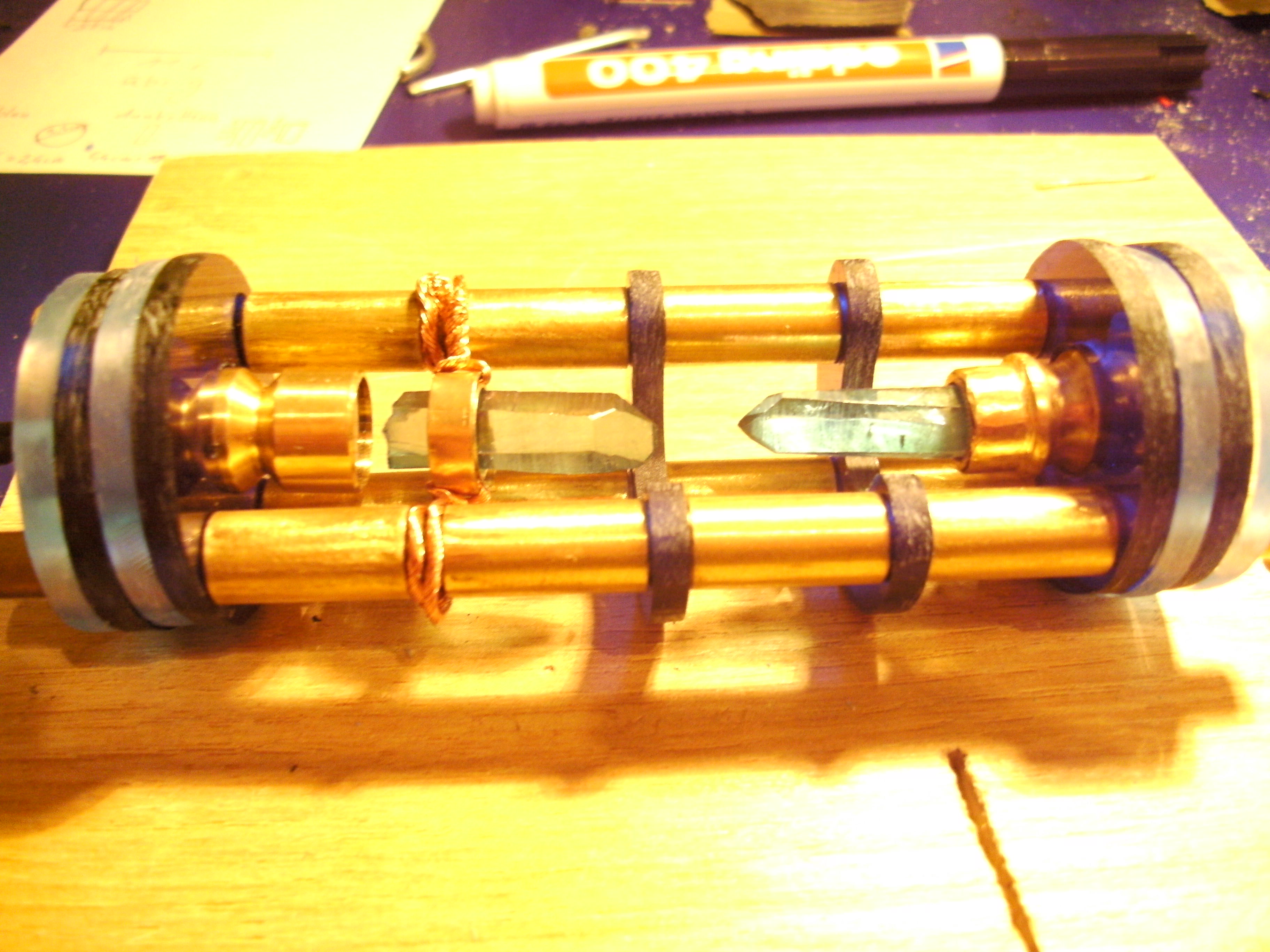

I cutted some discs out of acrylic glass and sanded the edges, drilled some holes and stuck them together with some metal-pins I found. I use blue high power LEDs together with a 9V battery.
LED test.
One side finished.
For the other side of the crystal chamber I sanded some of the acrylic-discs down to this.
The two parts combined...
More than 24 pics per post aren't allowed, so I have to "double-post".
Re: Vintage Graflex Conversion to ANH Lightsaber/Crystal Chamber (Pic heavy)
Some LED tests.
There will be another LED on the other side for the second crystal.

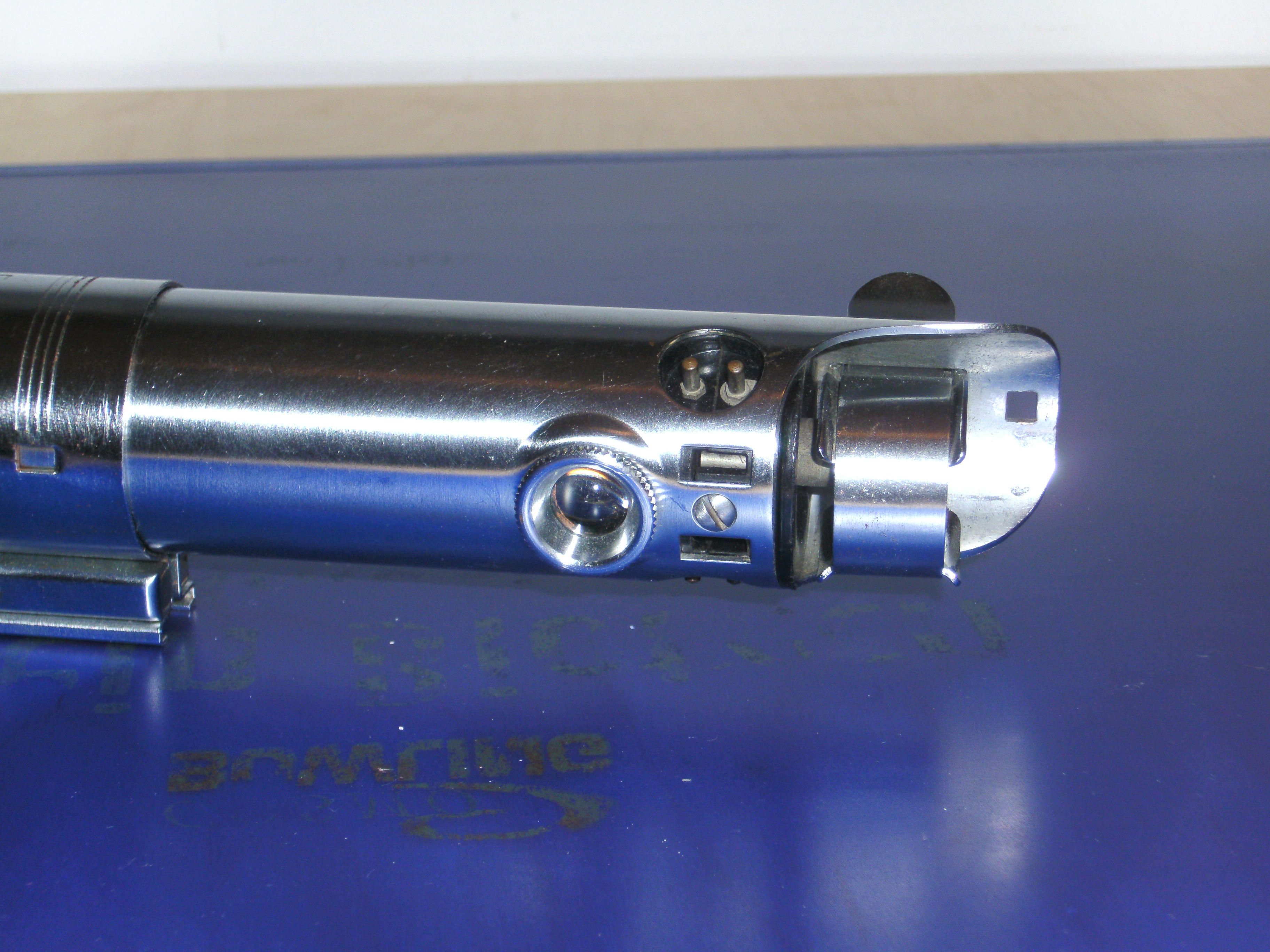

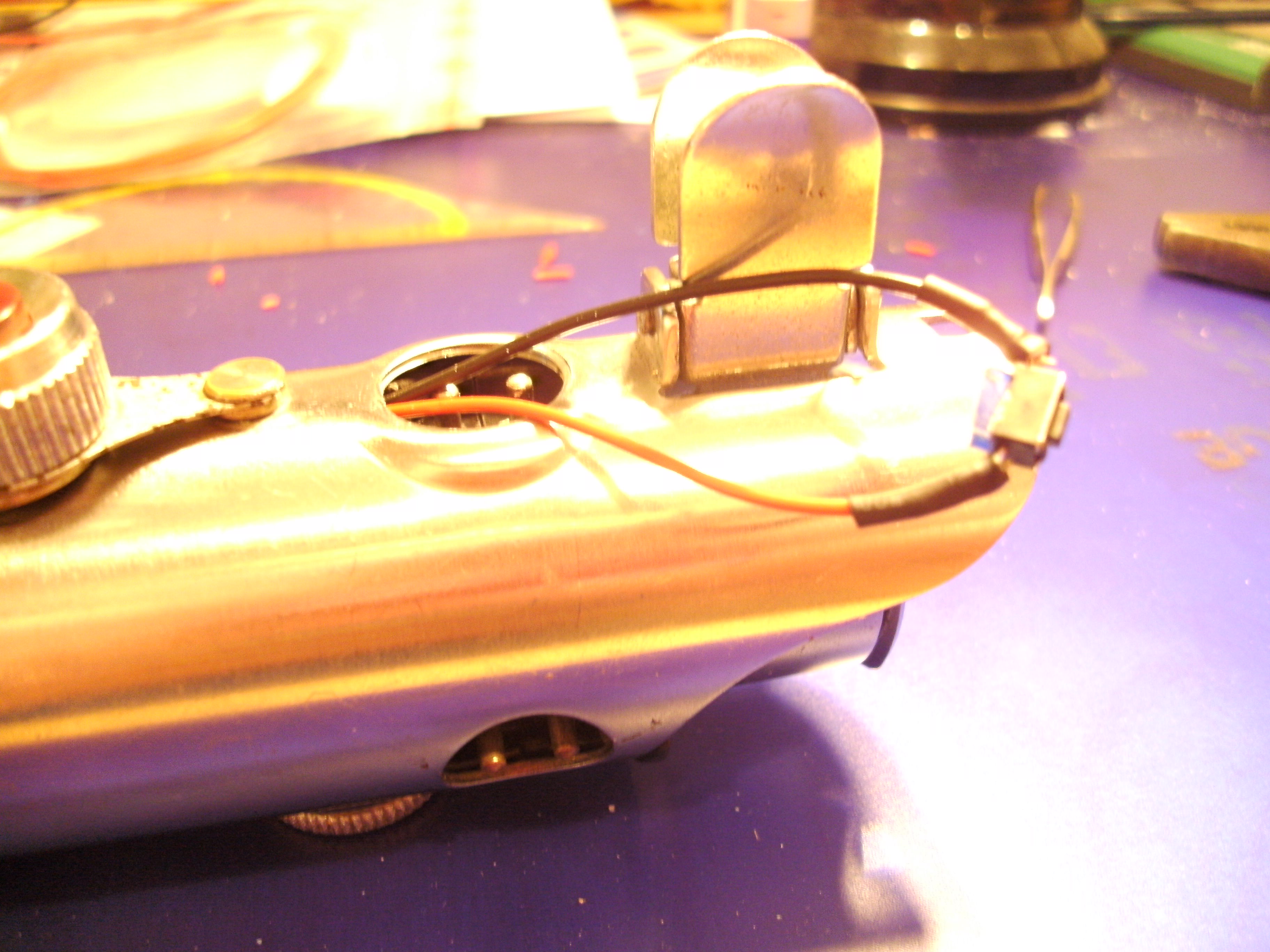

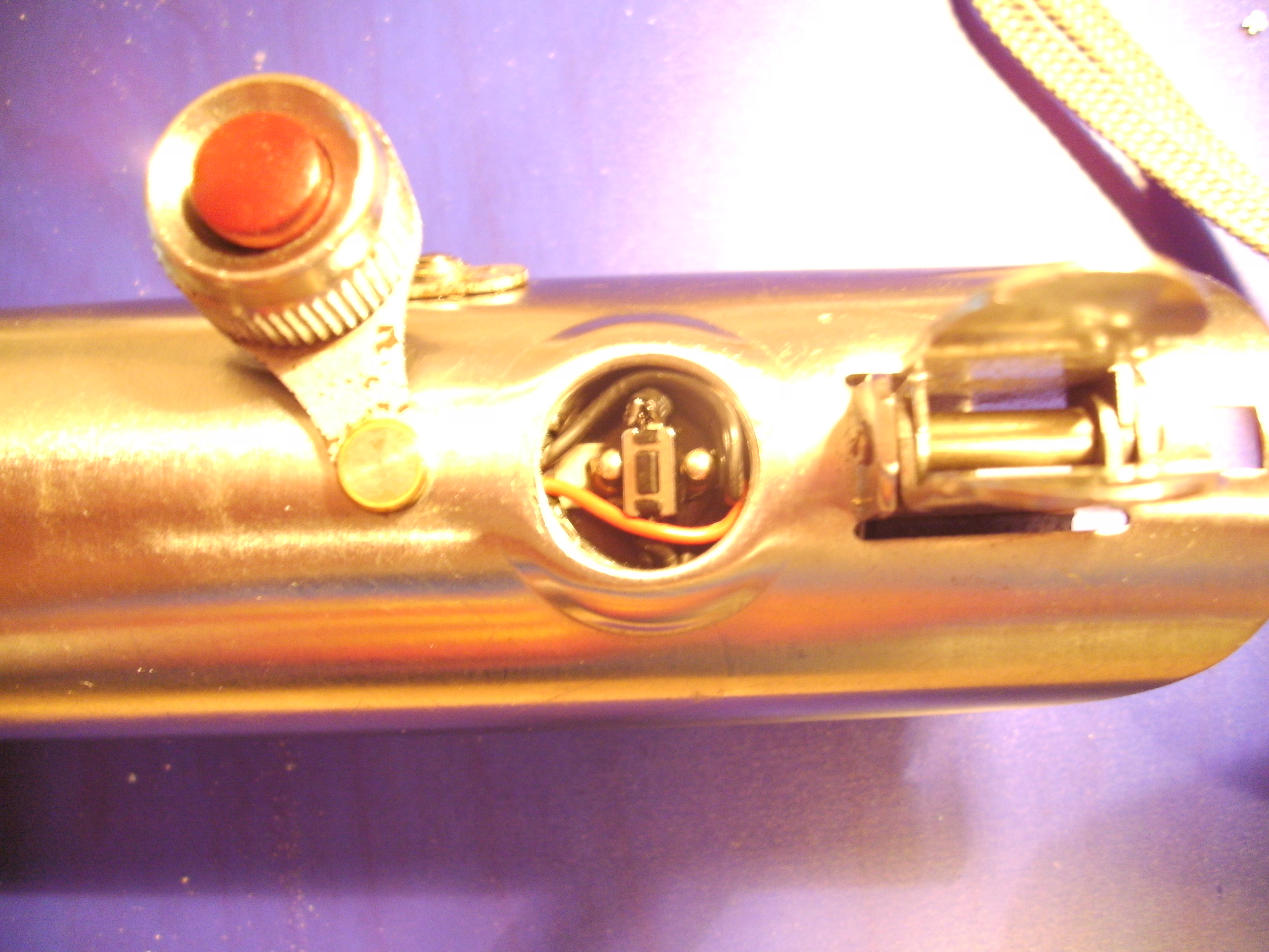

Then I wanted to have a nice way to turn the power on and off.
So bought some micro push-buttons.
One of these will be set under the red graflex-button like this...
... it's possible to press the push-button by using the graflex-button.
Then my problem was that these push-buttons doesn't turn the LEDs on permanently.
So I bought a modul in an electronics-shop that converts the push-button into a switch.
It's called an "Operating Sequence-converter". I bought it in the Conrad online-shop.

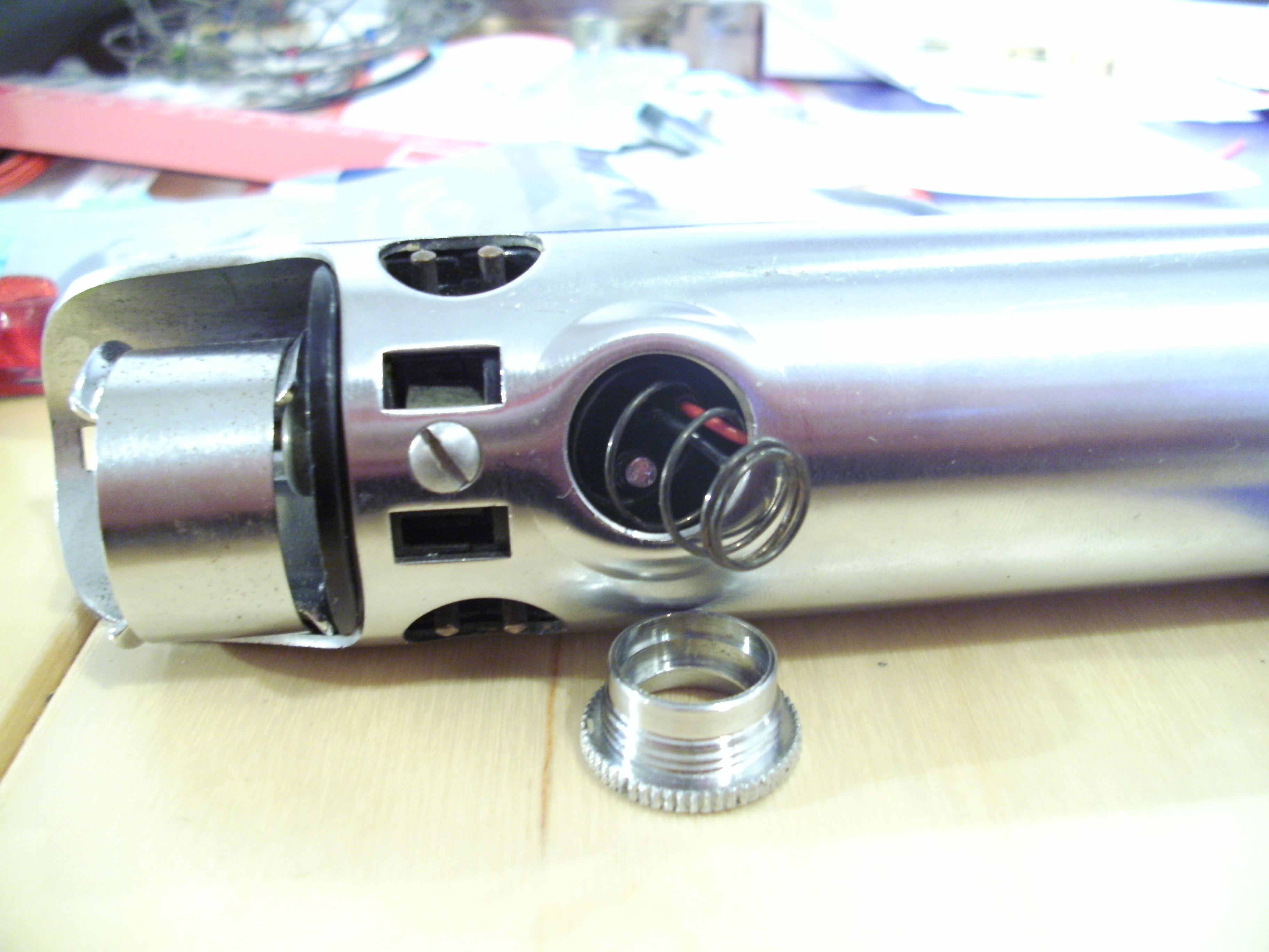

that's indeed a wonderful lightsaber you've created ... wow and a crystal chamber as well ... so cool! Looking forward to your work in progress ... and are you going to sand those Exactra 20 bubbles so they will fit underneath or will you choose to just 'clamp' them between the sides of it? And I just noticed you've got the all round version of the bubbles* too which are quite rare, so you only need to sand a little of underneath to be able to 'clamp' them in between the edges of the grafex clamp.

Sym-Cha: I will Sand the Bubbles a little bit down. I want them to fit underneath the sides of the clamp.
I've read the thread of the all-round Bubble but didn't realized that the Bubbles in my possession are of this type. Thanks for pointing this out.

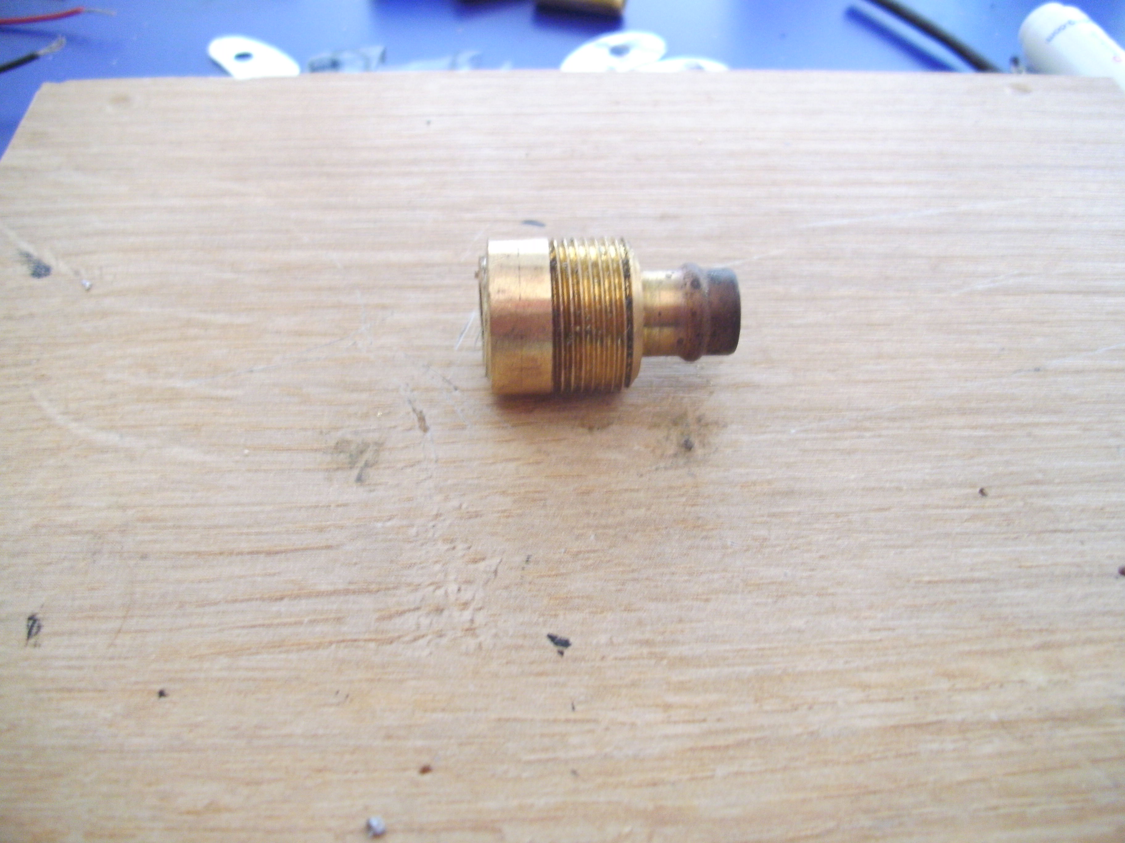

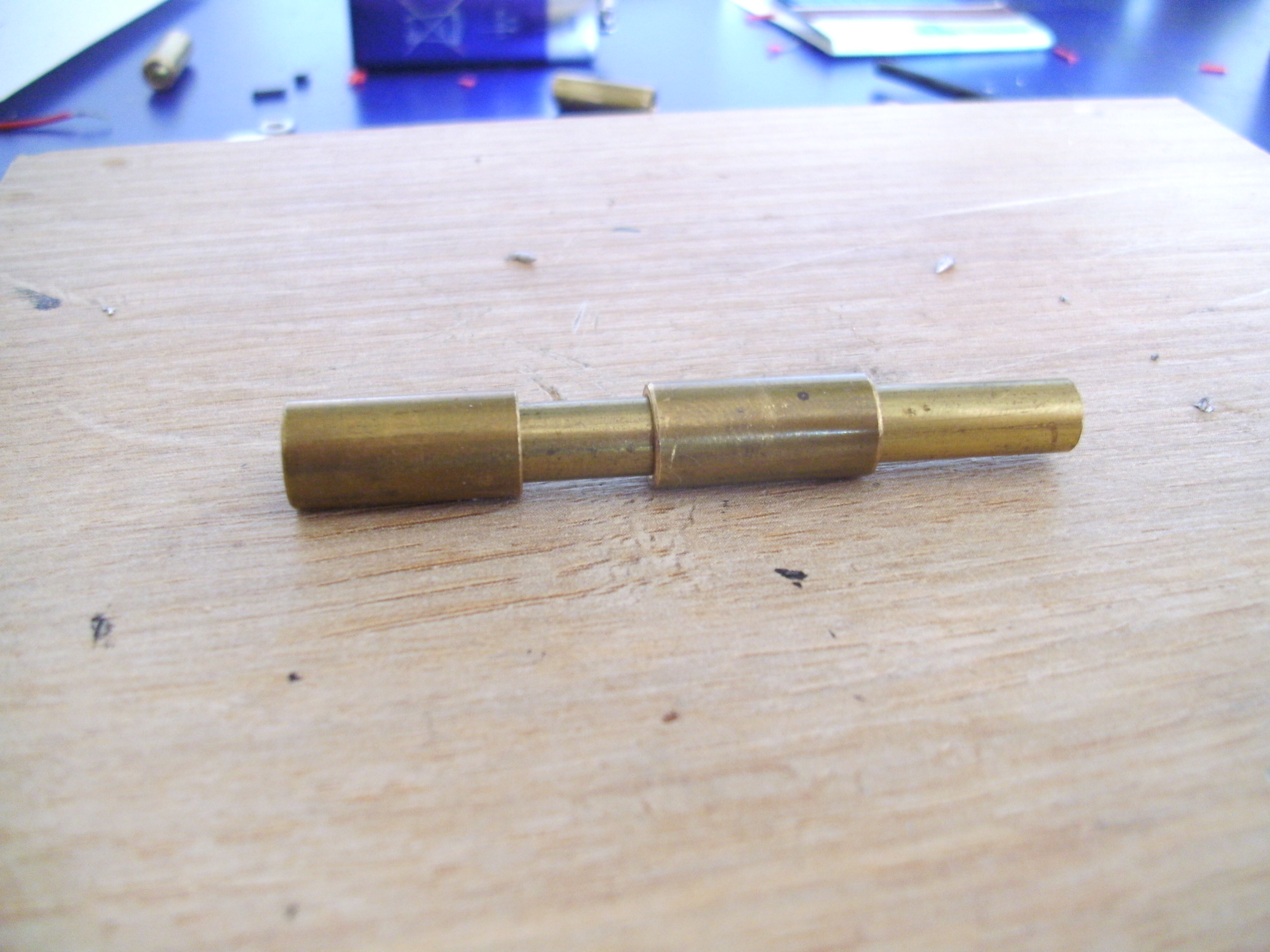

That's a great looking Graflex. What did you use for all the little brass parts, like the ones holding the blue LEDs? How did you cut your acrylic disks? Looking forward to more progress!
Re: Prop Newbie Vintage Graflex Conversion to ANH Lightsaber/Crystal Chamber (Pic hea
The brass pins I used: I don't know exactly what they are. I found them on a "junkyard".
There are two pieces which could stick together like this...
As you can see there are spaces left of aprox. 4mm as the acrylic glass dimensions I used.
I cut the acrylic glass with a metal-handsaw, and sand it down with nail-polisher my girlfriend uses for making acrylic/gel fingernails.
The parts I used to put the LEDs in or on the other side the crystal are found parts out of store.
The first one is to hold a doorstopper on the wall:
On the other side the crystal holder is something to attach a gashose. I cut one side and used it as crystal holder. THe other side you can see hear:
I think, that I will finish the crystal chamber next week.

yeah those 'round' bubbles are not in every Texax Instruments Exactra 20 ... only the ones with the much darker view window usually have them ... just be careful when adding them into the clamp ... don't put to much pressure on the clamp lever ... they can snap and break.

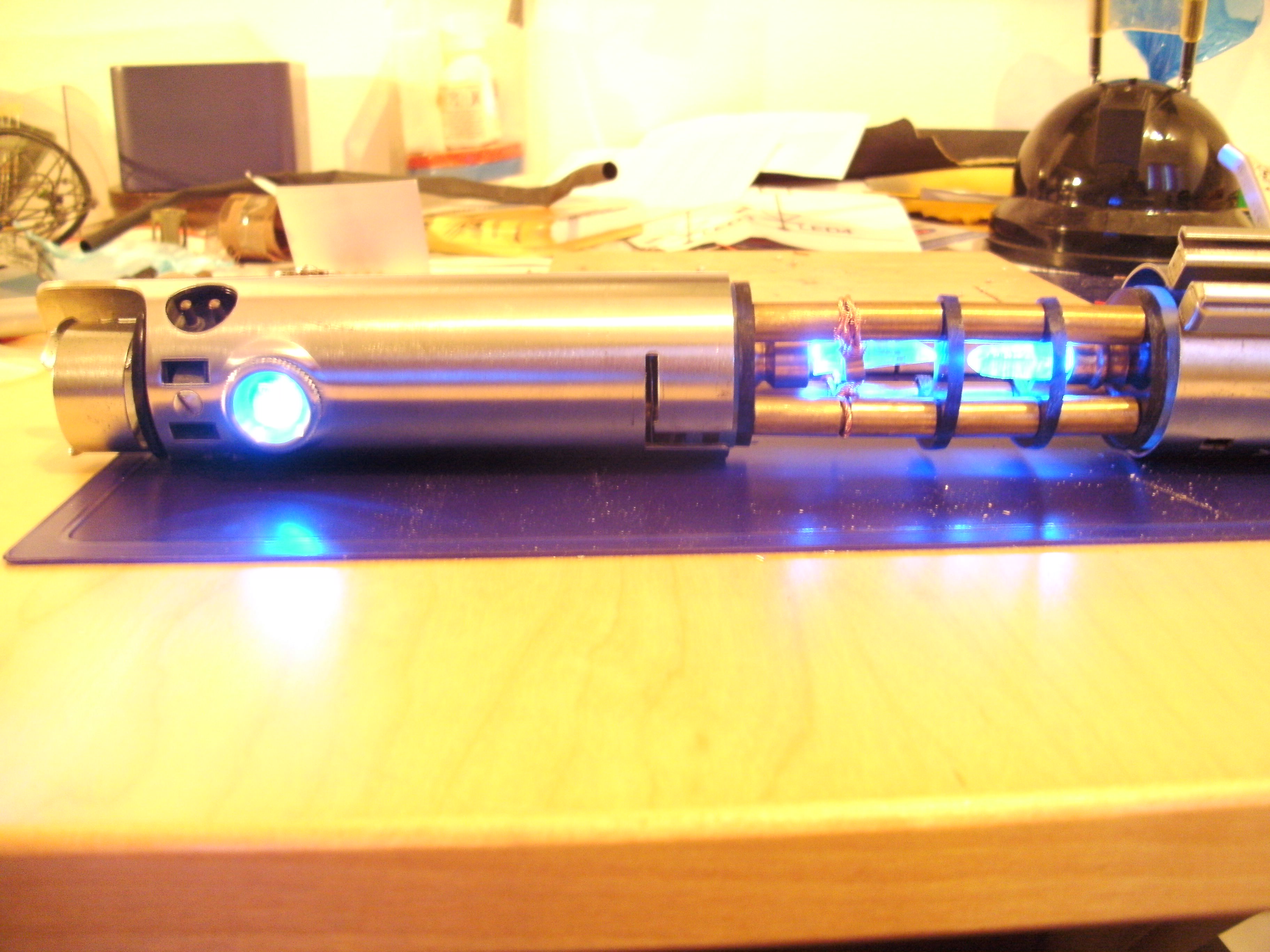

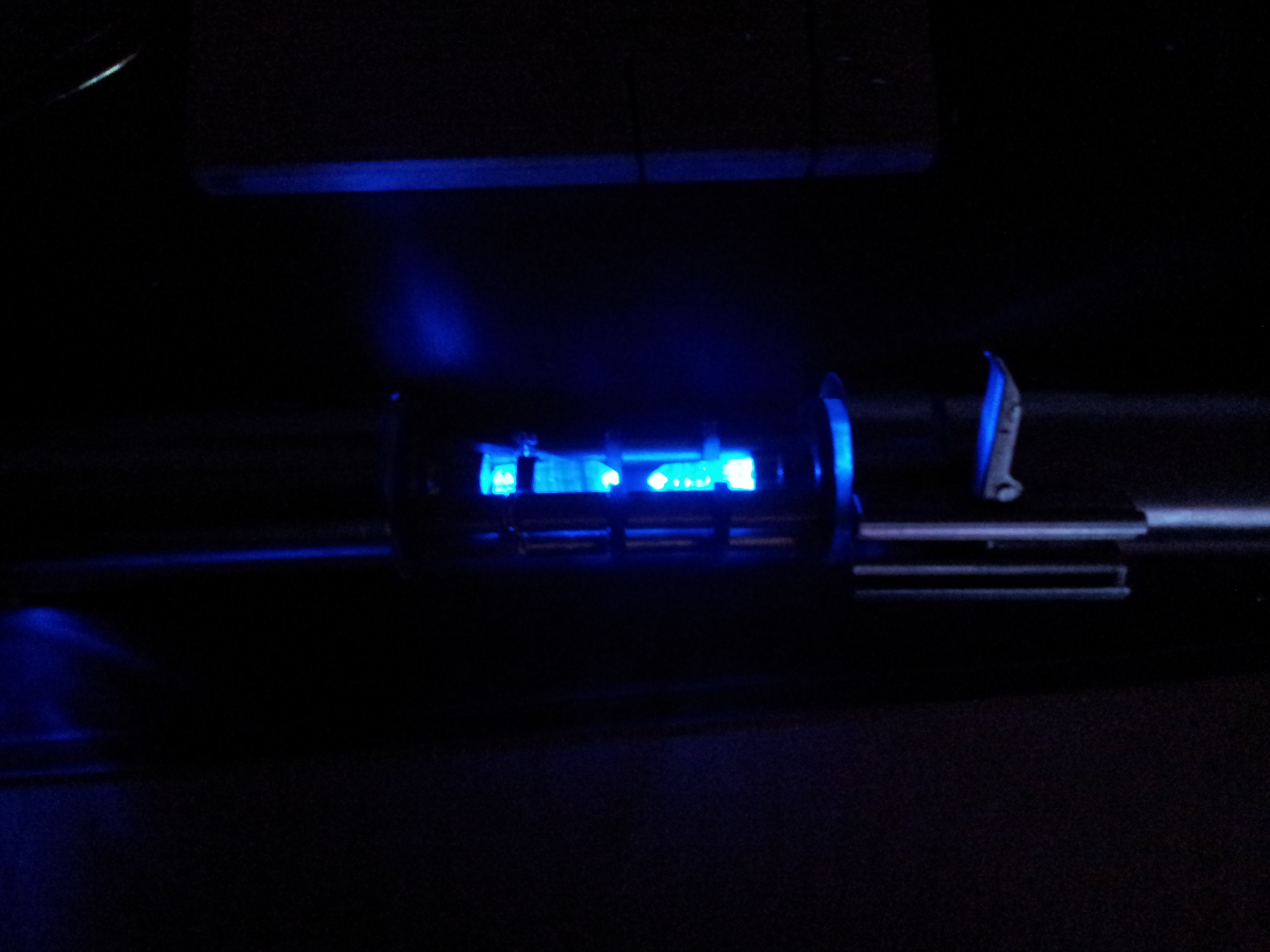

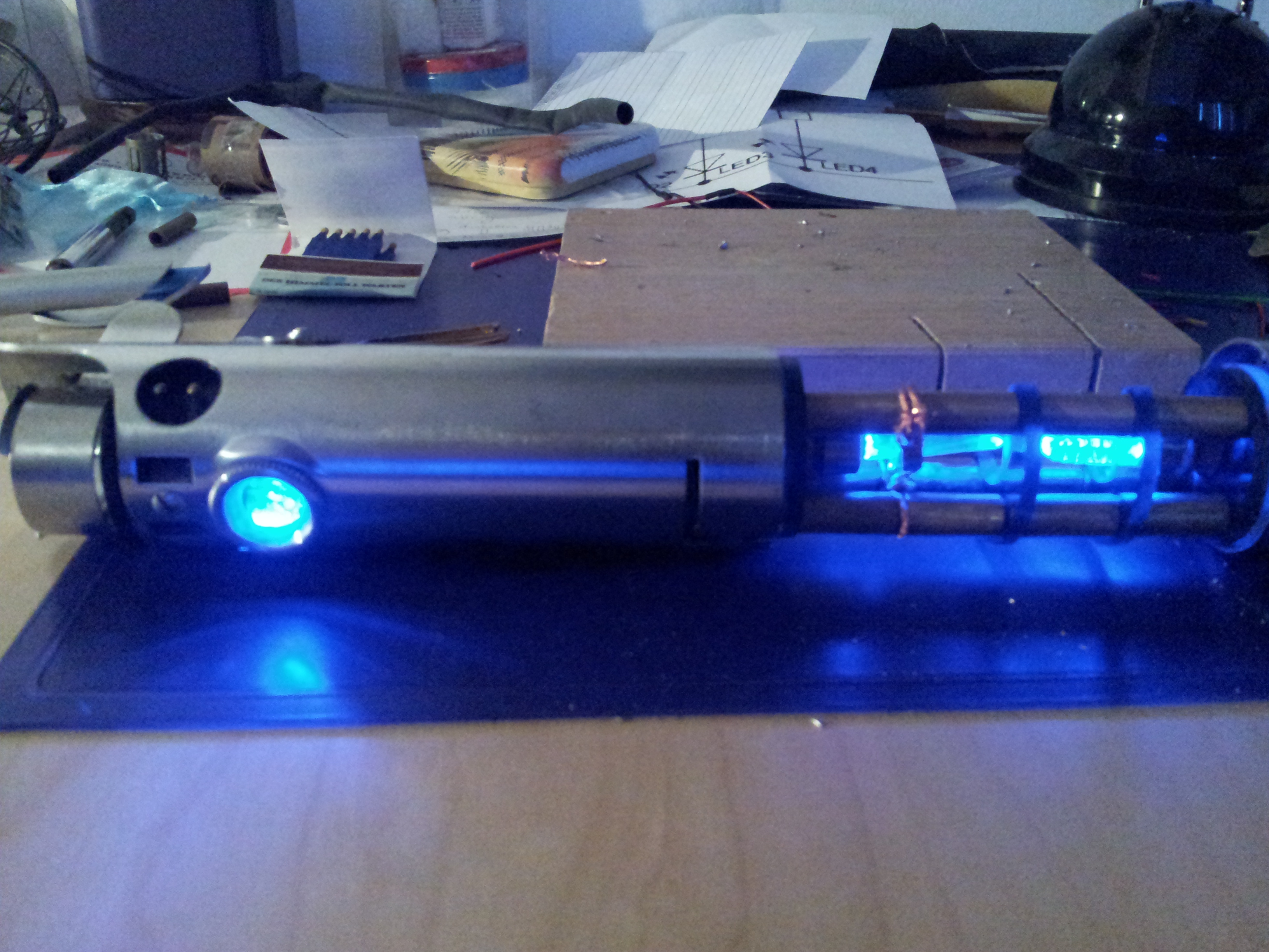

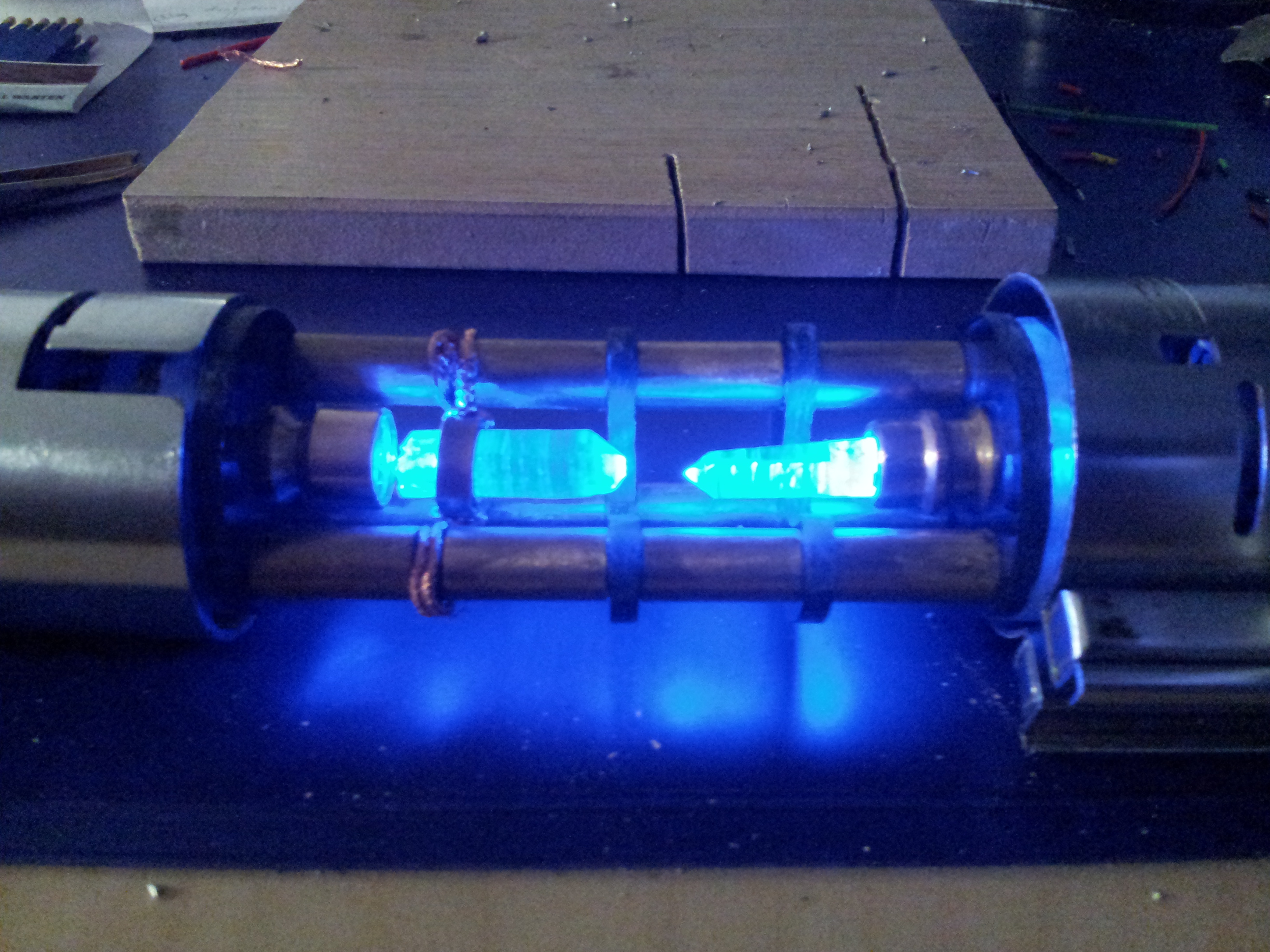

I finished the crystal chamber...
So here are the pics.
I wanted the Graflex glass-eye to shine blue, too. So I set an LED behind the glass.
Then I did the wiring.
There are lots of pics from the LED test.
BILD4693.JPGBILD4702.JPGBILD4703.JPGBILD4704.JPG20140217_175055.jpg20140217_175209.jpg20140217_175039.jpg20140217_175224.jpg20140217_175200.jpgBILD4694.JPG20140217_174947.jpg20140217_175008.jpg20140217_174957.jpg
I'm very happy how the lighting looks and a little proud with myself.
Hope you like it.
yep ... indeed I like it ... very much :)
Chaim
