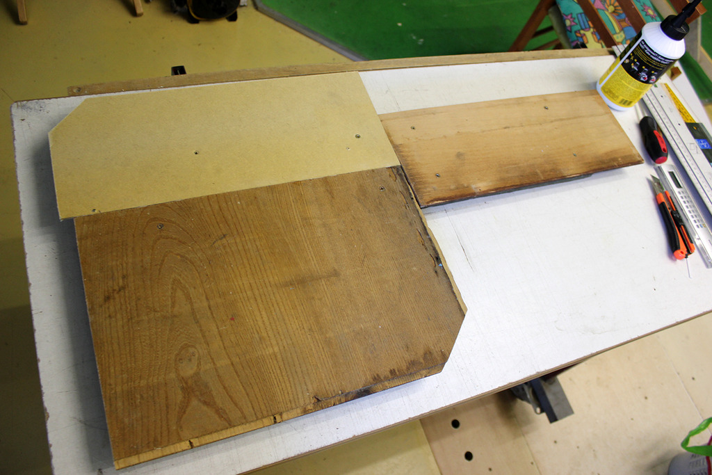

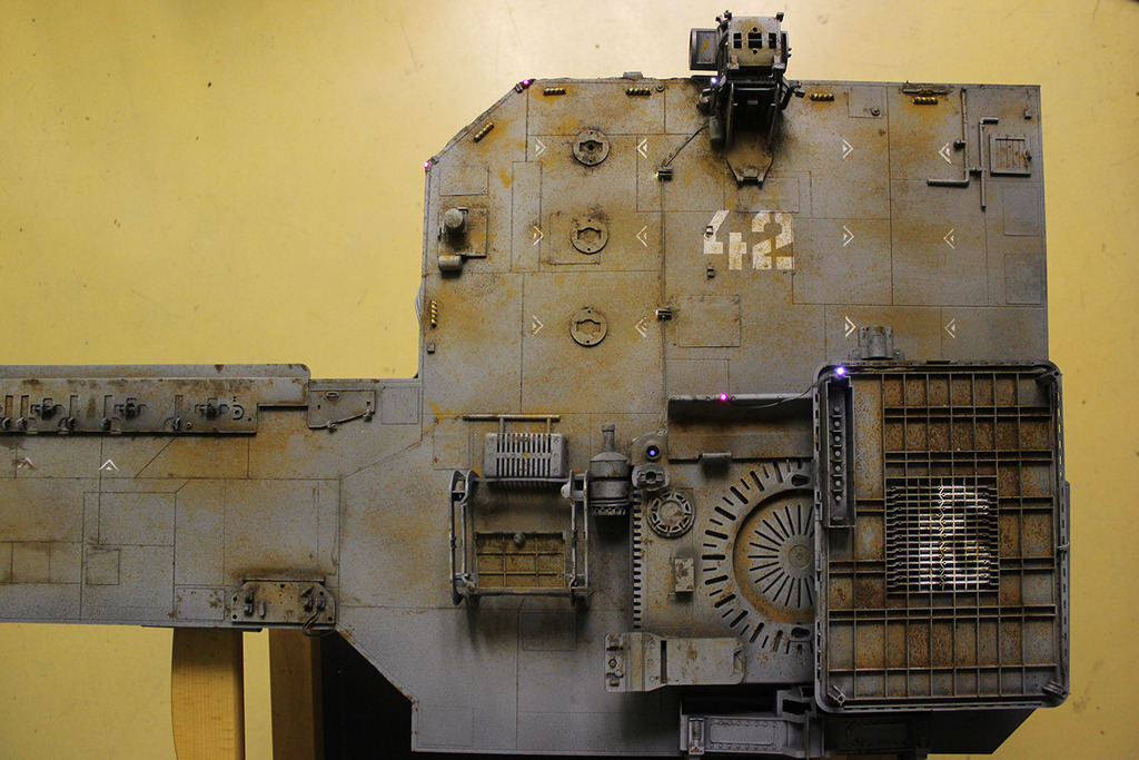

Ok, I built one more building. Well, actually it's a platform.. I think I'll use it in a couple of shots in the film.

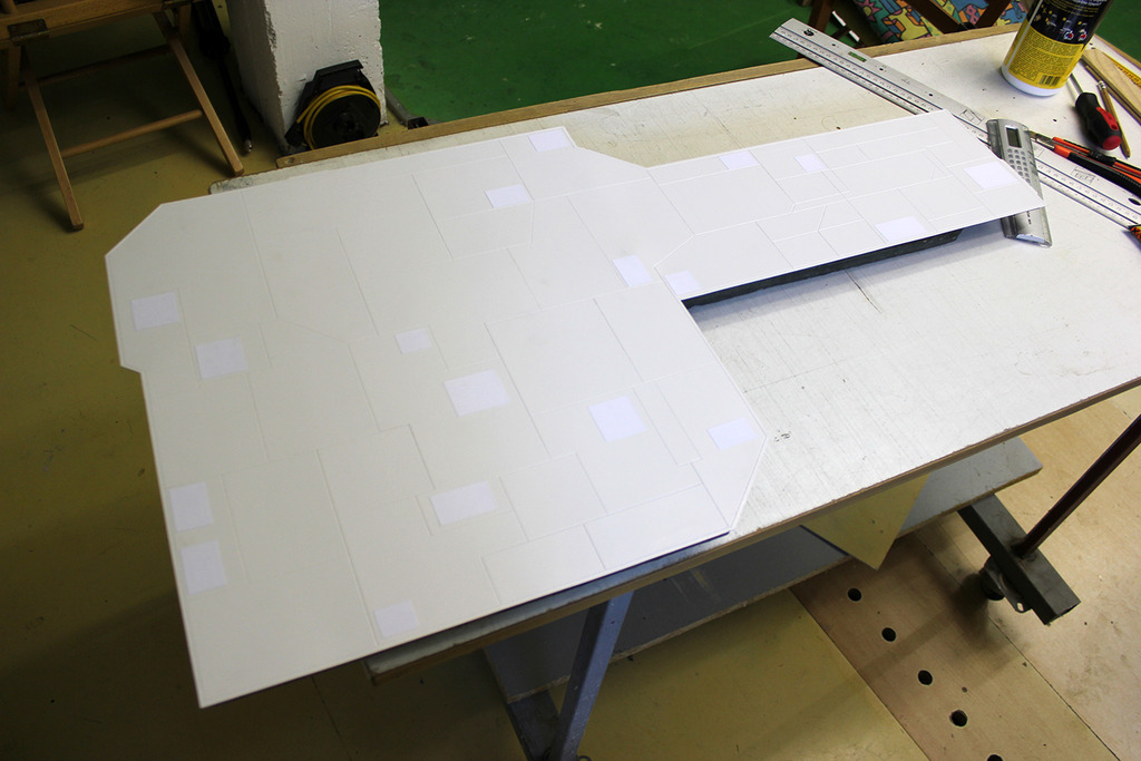

I started with some scrap pieces of wood I had lying around.

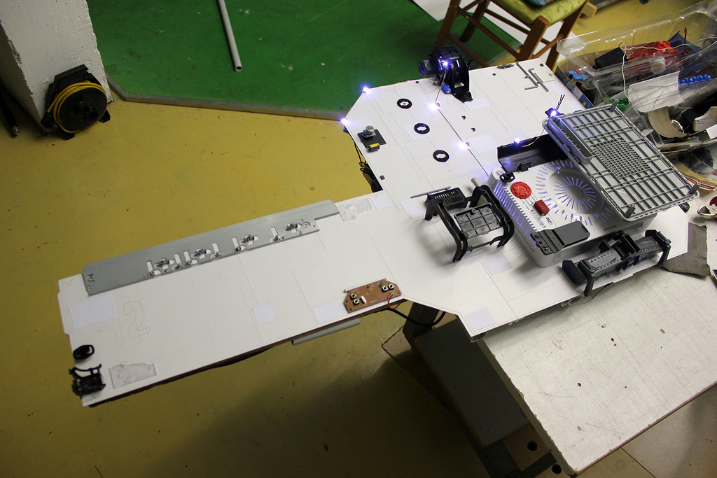

Next, I glued styrene on top of it, and carved the usual SciFi panels.
A couple of hours, a printer, modem, and a circuit board later: :lol

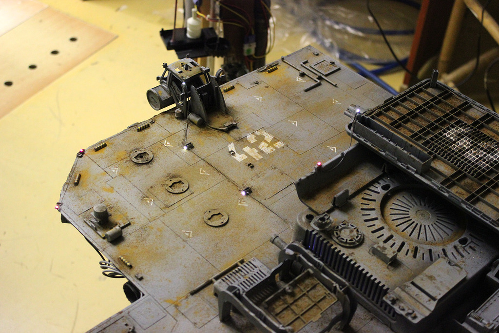

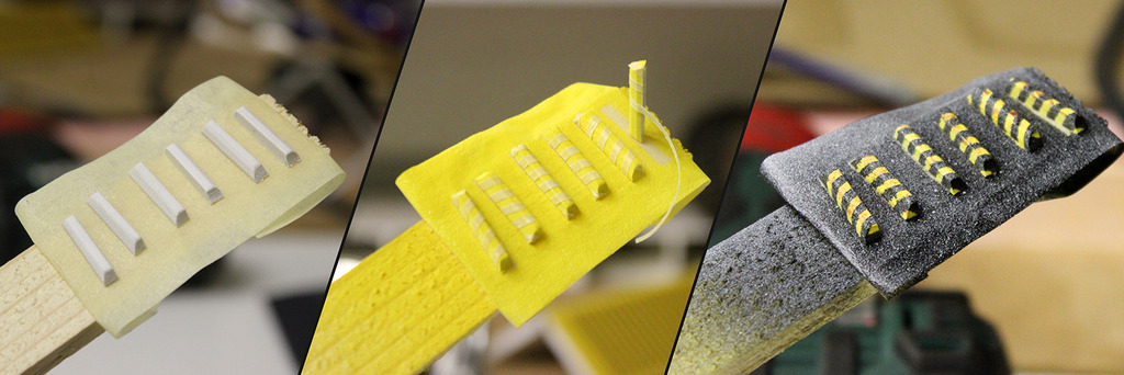

Then I tried to make those concrete "warning" blocks.. I don't know their name, but you know what I mean.. Sprayed them yellow first, then wrapped masking tape around them, and sprayed a coat of black.
Everything in place, and rusted pretty good with that "real rust" technique.
And for the grand finale, a quick test shot with the new buildings..

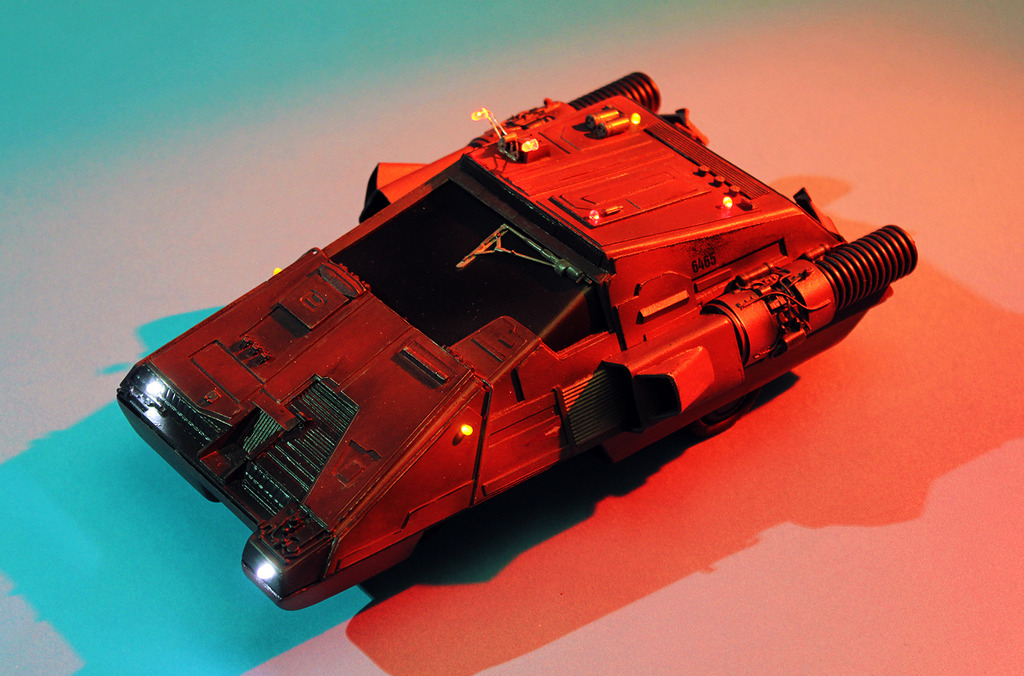

Today we have a different situation where I started to replicate a famous Blade Runner car - Alfa Romeo!!! It was only a matter of time, haha. It's not completely accurate of course, but I tried to respect the original as much as I could, and that's why it's going much slower than the buildings. I wanted to build it for quite some time now, but I'll also use it in the film for random flybys I guess.

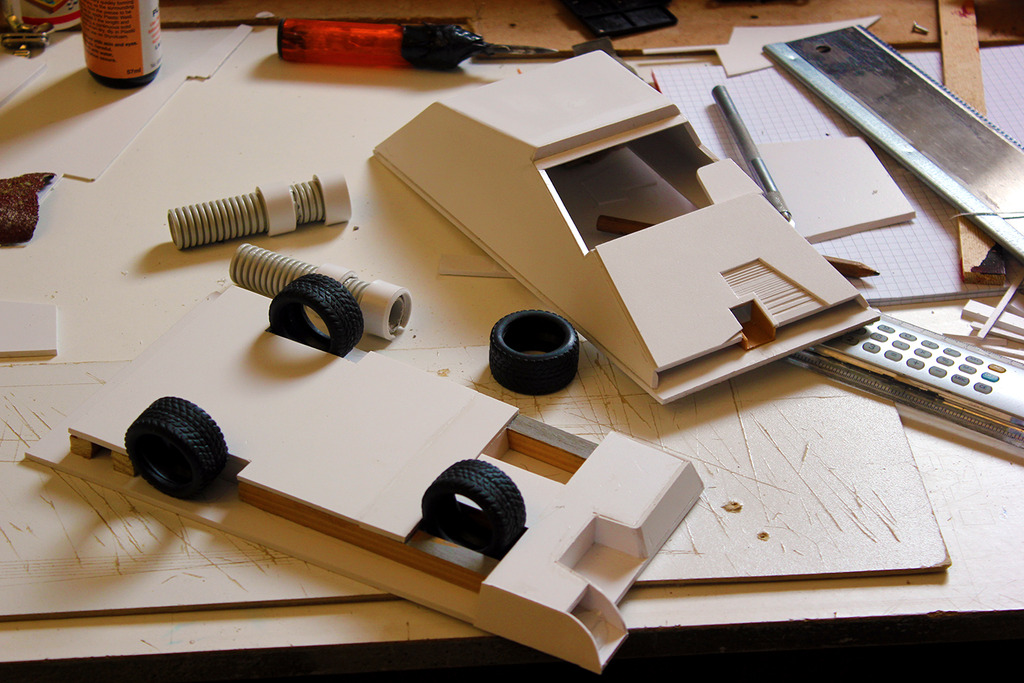

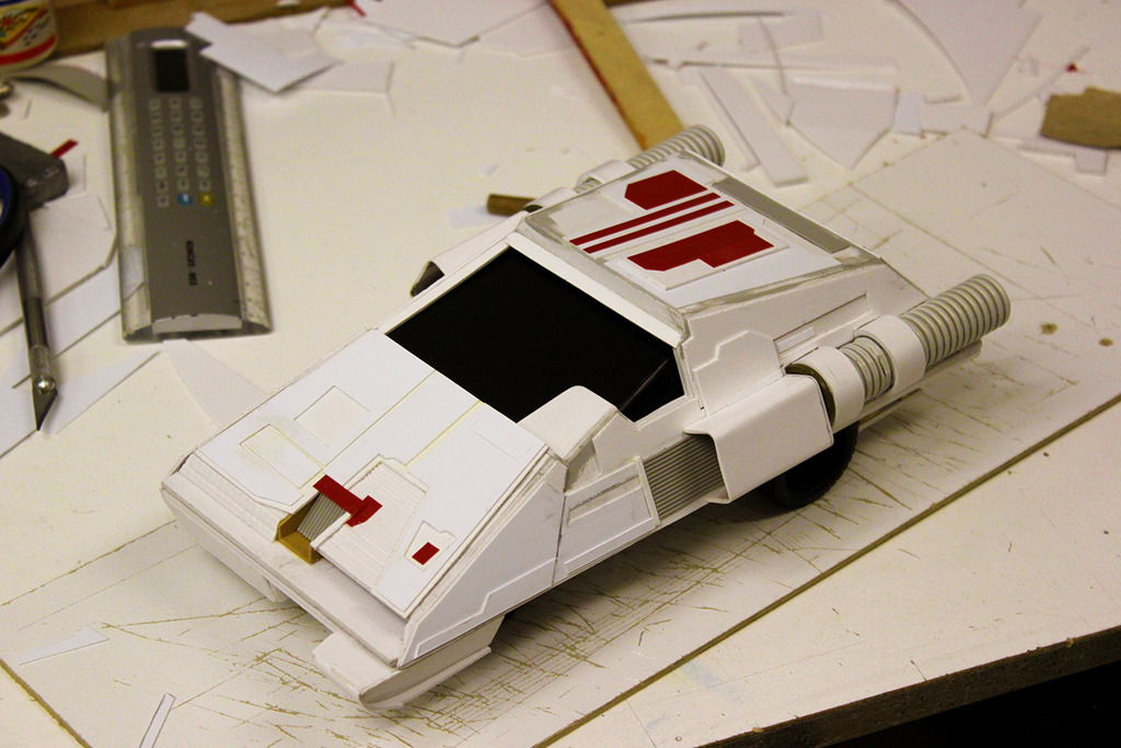

Ok, so I started with the basic shape, and I decided to build it in two halves so that I can open it if I need to fix any LED problems.

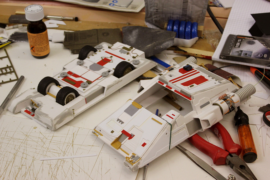

Then I started adding all those layers of plastic.. The paneling.. That took a lot of time.
And here are the two halves mostly finished..Obviously not one kit part is accurate, but at least I tried to use similar parts.

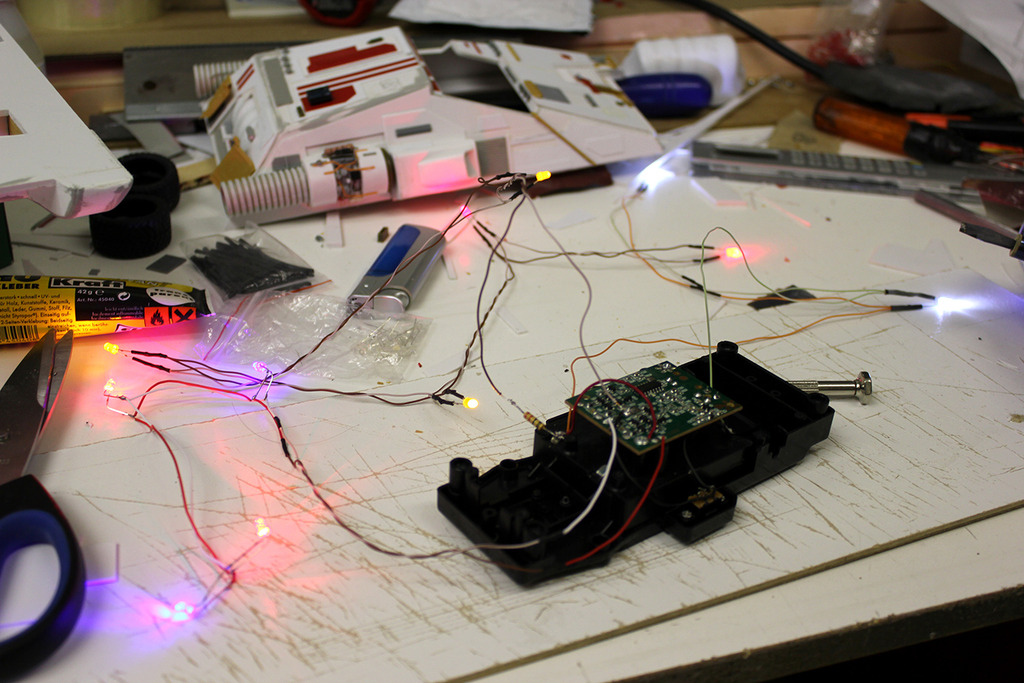

I had some toy lying around and it came with a preprogramed circuitboard and 4 blinking leds. I figured I could use it for Alfa Romeo, so I soldered a couple more leds on the same battery source. The blinking leds will go on the roof, the others to the front and back of the car. The original model had far less lights, but I'm thinking you can never have enough lights. :lol
That's it for today.. In the next couple of days I'll paint it and take some photos in the smoke.

Had a lot of work to do in the last couple of days, but I finally managed to finish Alfa Romeo!!

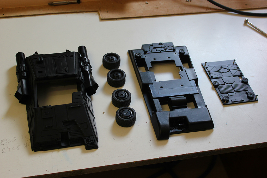

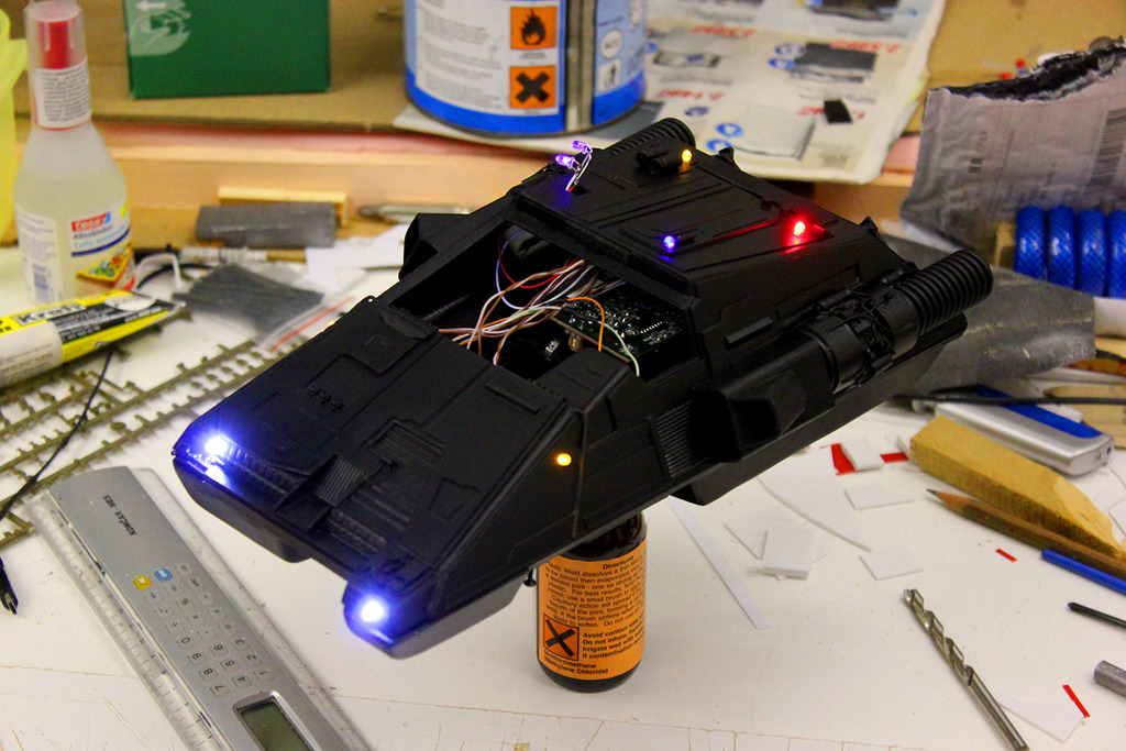

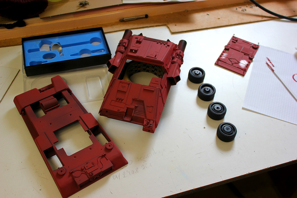

After all the building it was pretty awesome to start the painting process. First - the black primer. I also put the lights roughly in place for this shot.
Here's the model broken down into main pieces. There's top and bottom part, tires are separate, and also there's the "battery lid" on the far right.

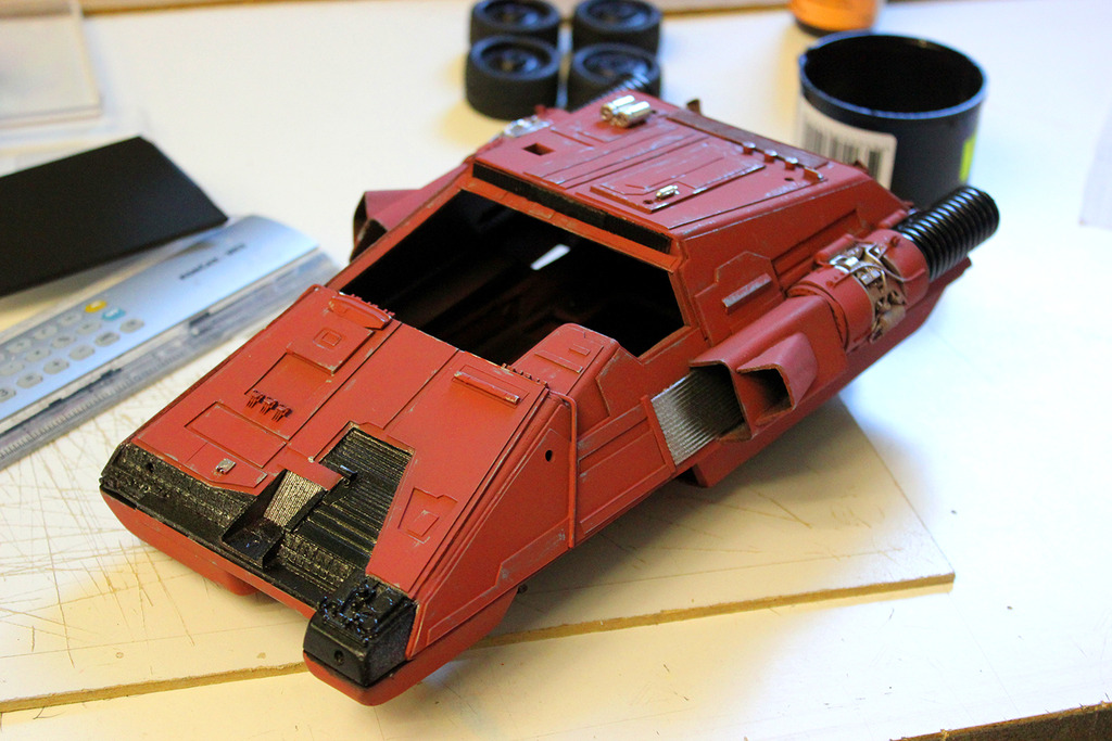

I bought a cheap 15$ made-in-china airbrush some time ago. It's giving me tons of frustrations every time I use it, but it's still the best solution I have for painting stuff. I developed my own "supersecret" mixture of cheap acrylic paints that clogs the airbrush all the time, hahaha! :wacko Anyway, I managed to paint the Alfa its signature red color...

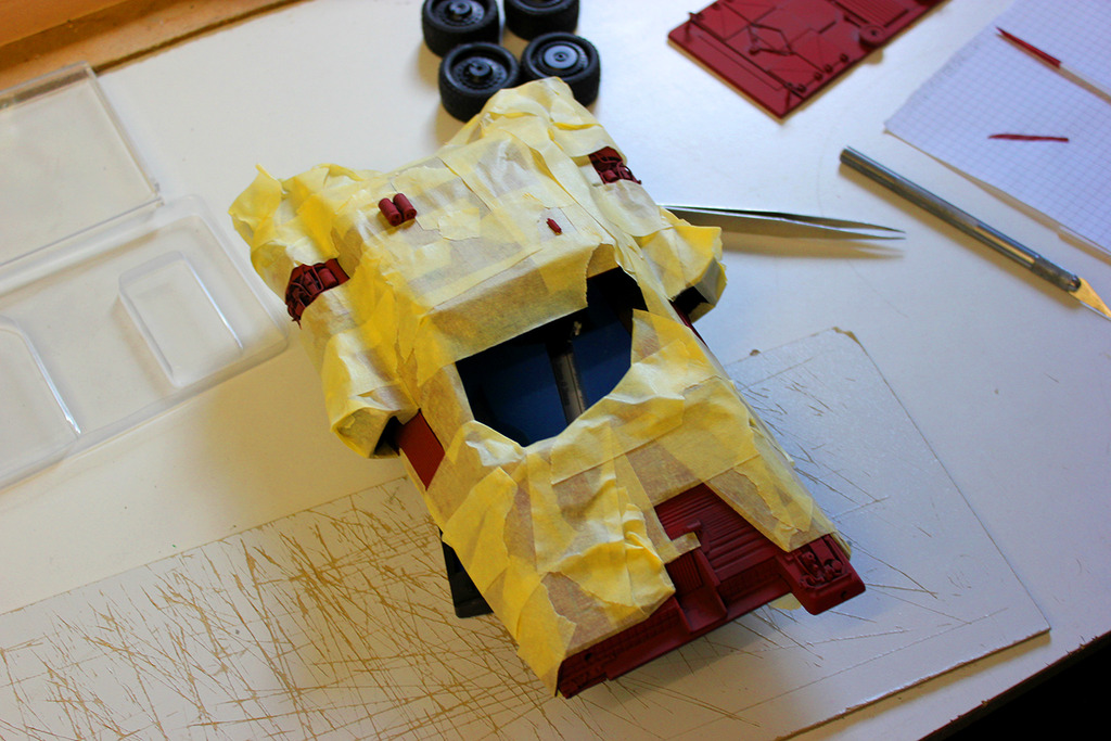

On the rare occasions when it actually works, it's really enjoyable to paint with airbrush. Next, I had to mask the model to isolate the silver parts, and to bring back some of the blacks.
Here's the painted car, but without the windshield, LED lights, and before the washes and the dirt.
And here's the car with all those things: :lol
The rear side:

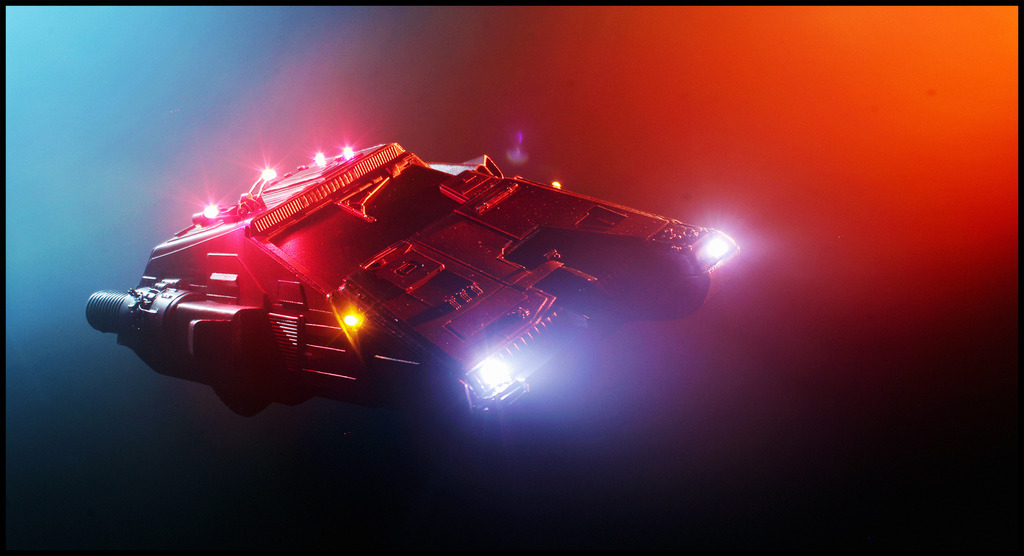

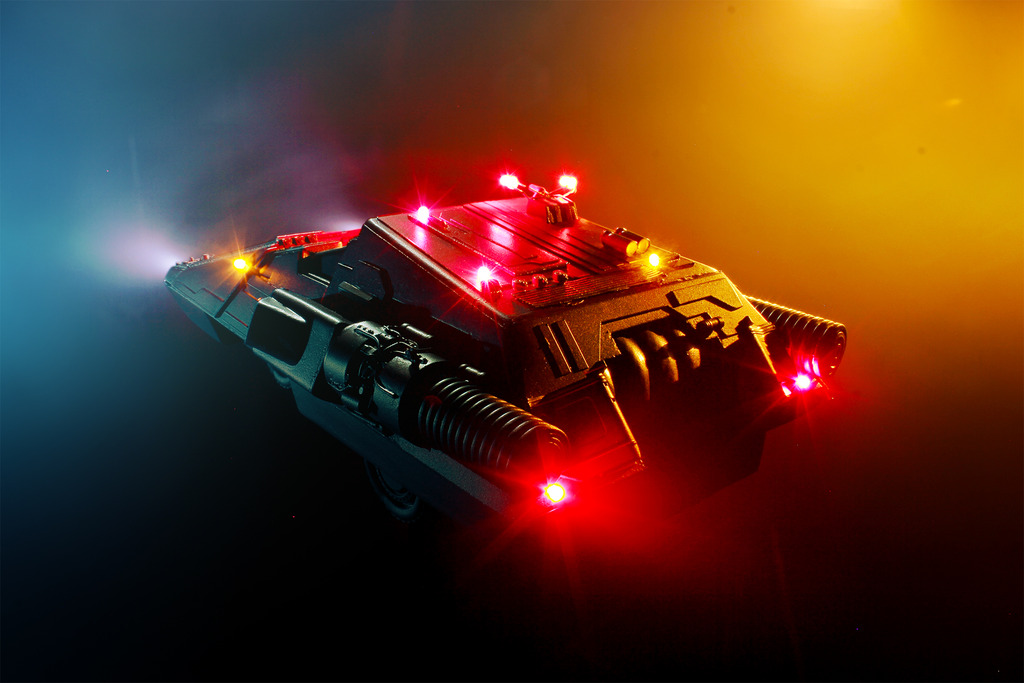

And as usual, a couple of beauty shots in the fog:
As I said, I added much more lights to the model than the original had, but I think more lights is always better! :D Also, the ones on the roof blink.
