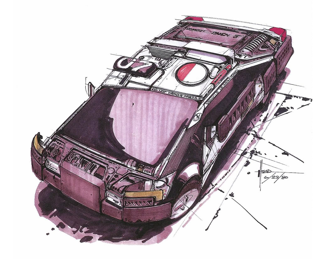

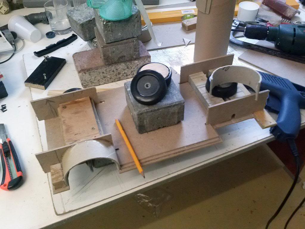

okay, back to the film.. So, one of the most prominent models in the movie will be a car that the main protagonist drives.. ..well, flies actually. I love the car design of the 80's. The -not so aerodynamic- hard lines. So that will be the direction I'll take.. It shouldn't be a clean and beautiful spinner type of vehicle, but rather an old, well used but loved piece of junk. There is a FANTASTIC sketch from Sid Mead that he made for blade runner, and I'll reference it loosely..

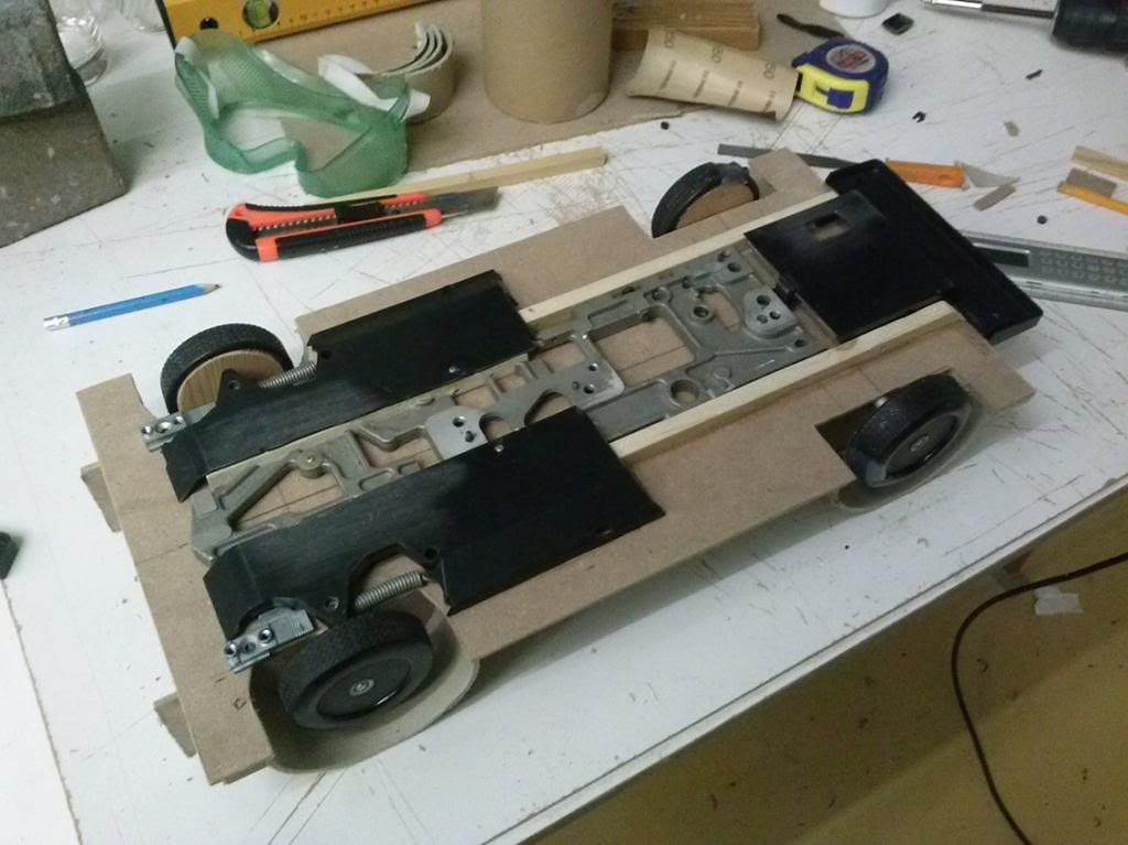

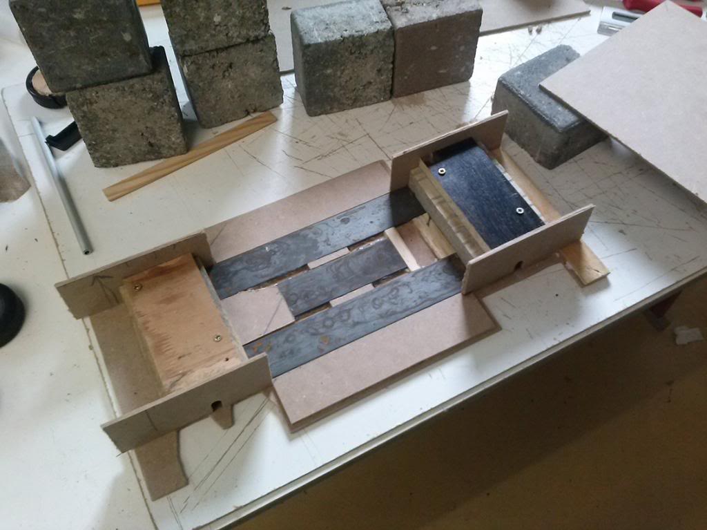

First I started the chassis. The car will be mostly made of wood and plastic. Those big boxes on each side are actually primitive suspension mechanisms I invented :lol. I want the car to feel heavy, so when it lands it should sink a little. So I made it heavier with some metal sheets.
I took the tires from an old model car and reworked them a little:
Here is the underside.. I'm' using random junk of course, there's many parts of an old typewriter in there.

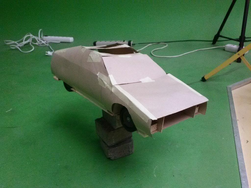

Next step was to make a crude paper body, just to figure the proportions.. It does look deloreanish in that photo..

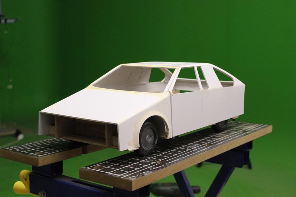

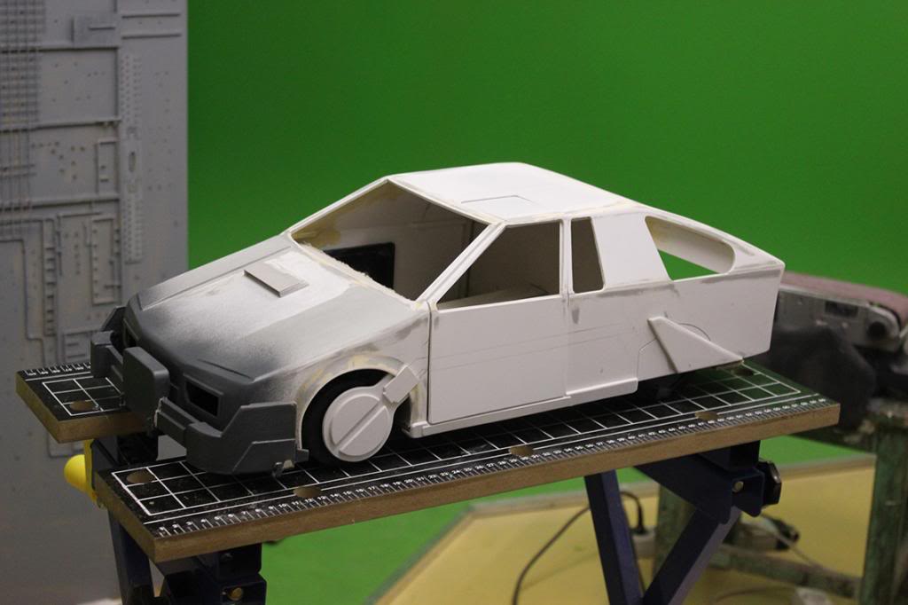

And here's what I made so far.. The body is made from plastic, I bondoed the seams and now I'm sanding it.

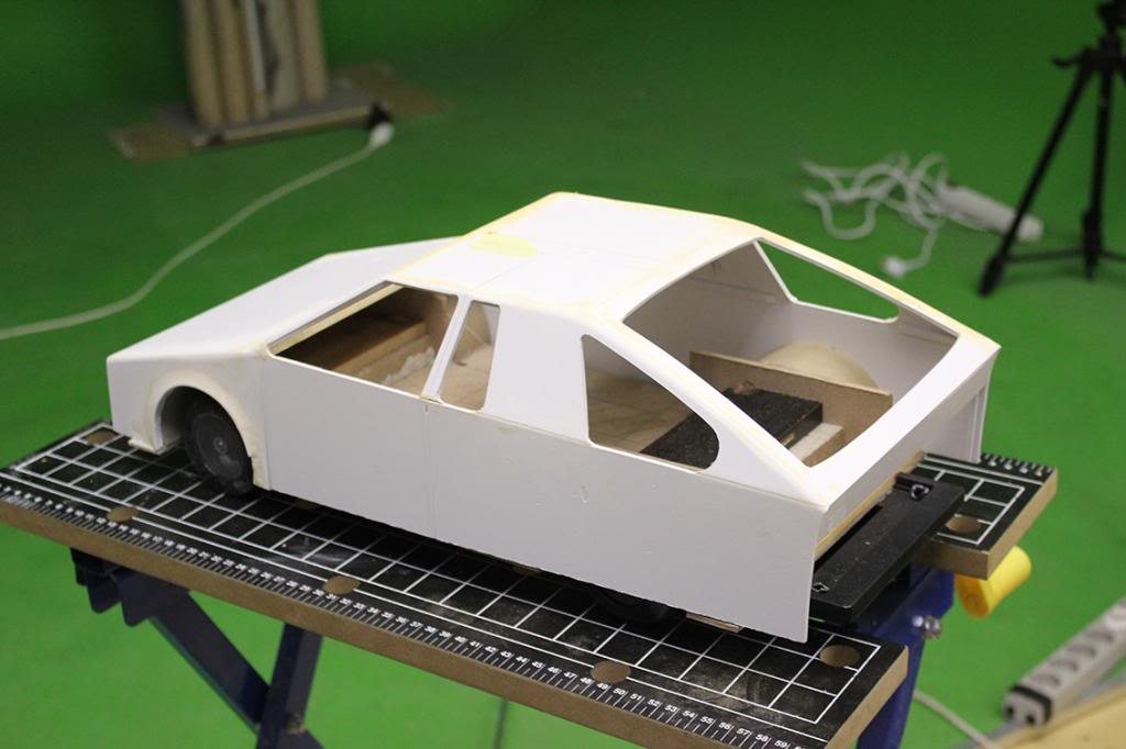

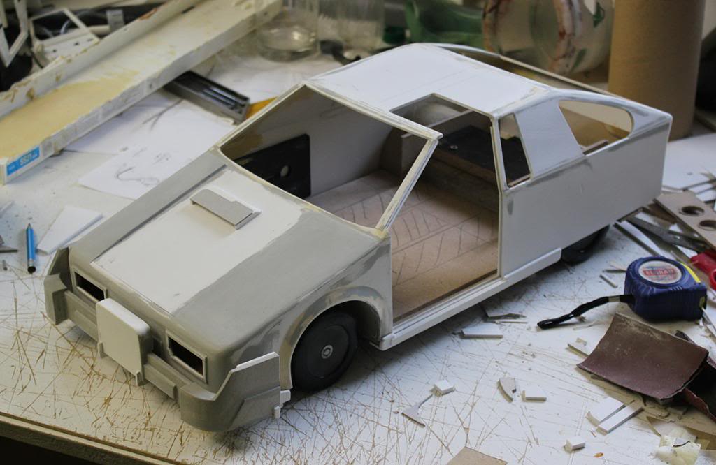

Well, here are some pictures of the progress with the car. It goes quite slow, and I'm still in the "basic shapes" part of build, but soon I hope it'll start being more fun! Here I tried to make gull-wing door.. (don't mind the cassette, It will be covered with lots of stuff later on :lol)

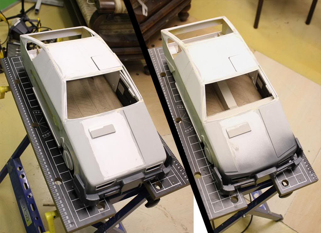

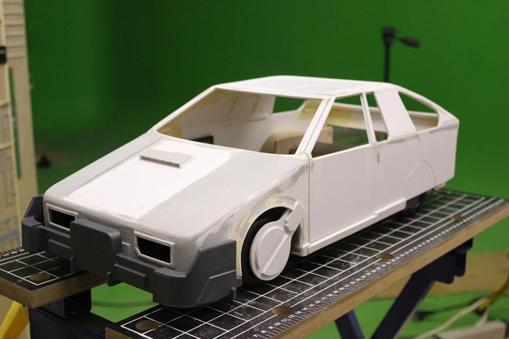

OK, so a day or two went by and all I could think of was how that front part sucks.. It is too flat. The car should be a bit more aerodynamic, even if its from the '80,right? So - it had to go under the knife again! Here's the before and after:
(I also like this view from above, I should remember it for the poster - the car ascends high above the Sushi bar.. :D)

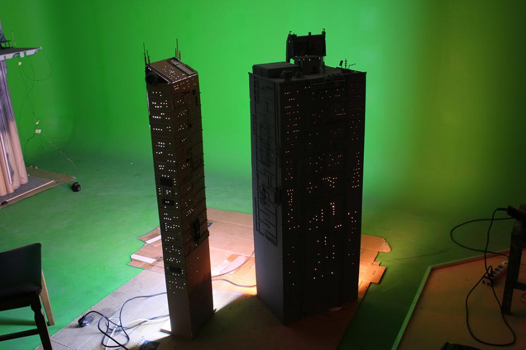

Meanwhile, my friend comes now and then and makes random buildings for the backgrounds in the scenes.. Those are not precisely done, he glues on them literally everything he can get his hands on.. But in low key i figure they'll look just fine.. They will be lit with a single source from the inside, like in this test shot:

Well, somebody is tackling the fun and difficult stuff at once and so far you've impressed me with all those builds. Building should always be done in a diagonal shape so you'll have a 3/4 shot (moving from left to right). Your lighting test looks good also. Eager to see more next time:cool
That car with the revised front end looks spot on. Great job, I like how you guys are using everyday objects to build this stuff.
dude...i keep seeing this develop at work but never get the chance to say anything. this is freakin SUPERB. Love everything about it. And those buildings are freakin sweet. Great work man
