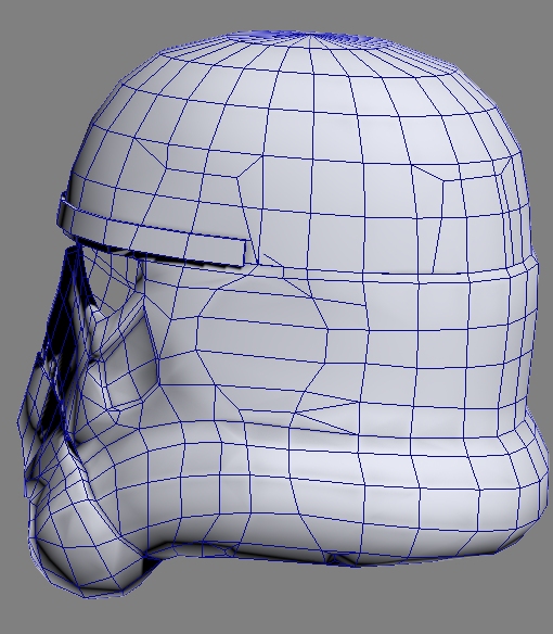

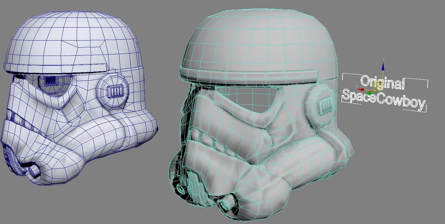

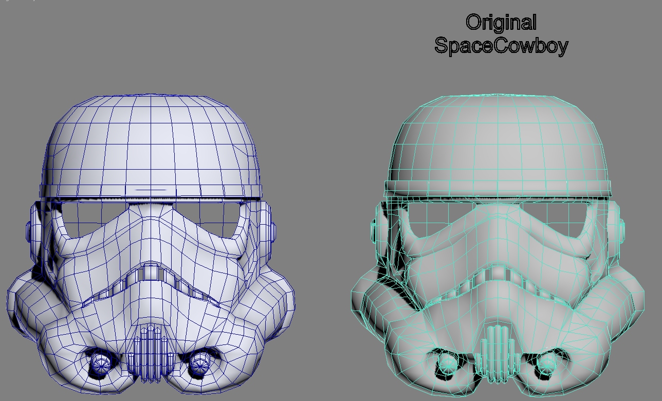

Here's the current stage (The ones on the left are the new):
(The "mouth" looks a bit wide, I know, will fix later)
I've also marked the place of the earpiece:

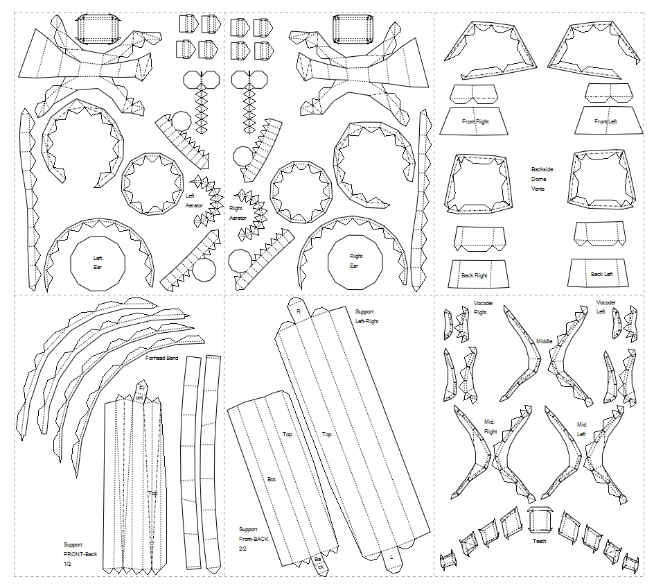

Sure, I'll try to do both versions in .PDO and .PDF files as well. I just need a few days to finish putting the first print together. I don't want to share something "untested".
I think I'll do the unfold again and put all the details in a different pep file.The profram merged some of my edges and made the taps and numbers weird, I don't like it.
Here are the files I came up with:
upgraded_spacecowboy_stormtrooper_helmet
All .PDO and .PDF files are in one ZIP
If you have any trouble downloading, building, or just simply find some mistakes in the peps please let me know. I only printed thje WIP version and I had to unfold it again since so it's kind of untested.
Any feedback/building log is welcomed!

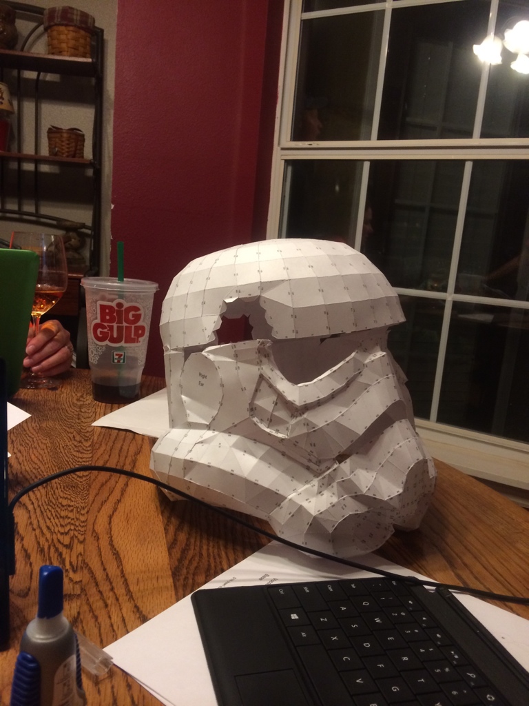

namivanmar I used your pep file and it was awesome, really easy to put together. I'm on to the bondo now and it's looking great ImageUploadedByTapatalk1395873233.922380.jpg
agester I'm glad you liked it, and that it worked! Please keep us posted how the build goes.
(I'm at the bondo stage too, but that project is put aside a bit for more important things.)
