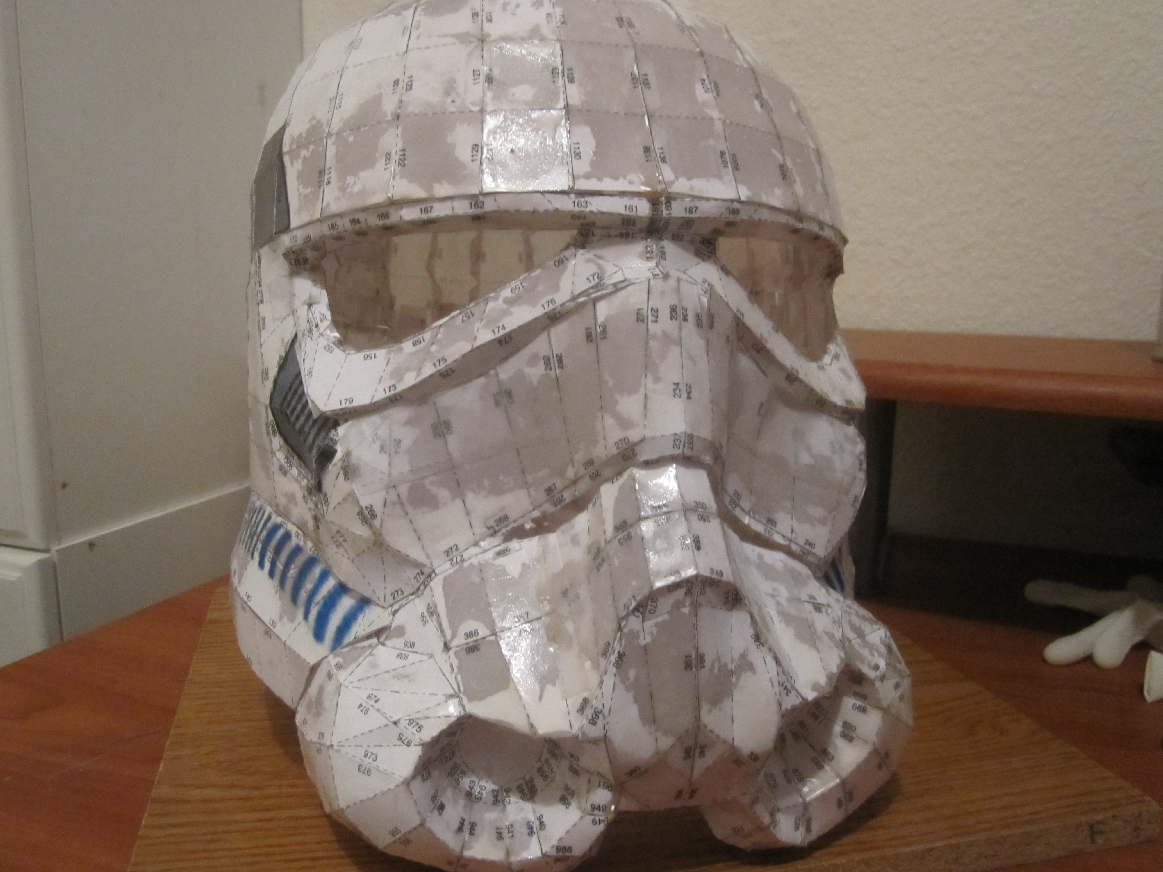

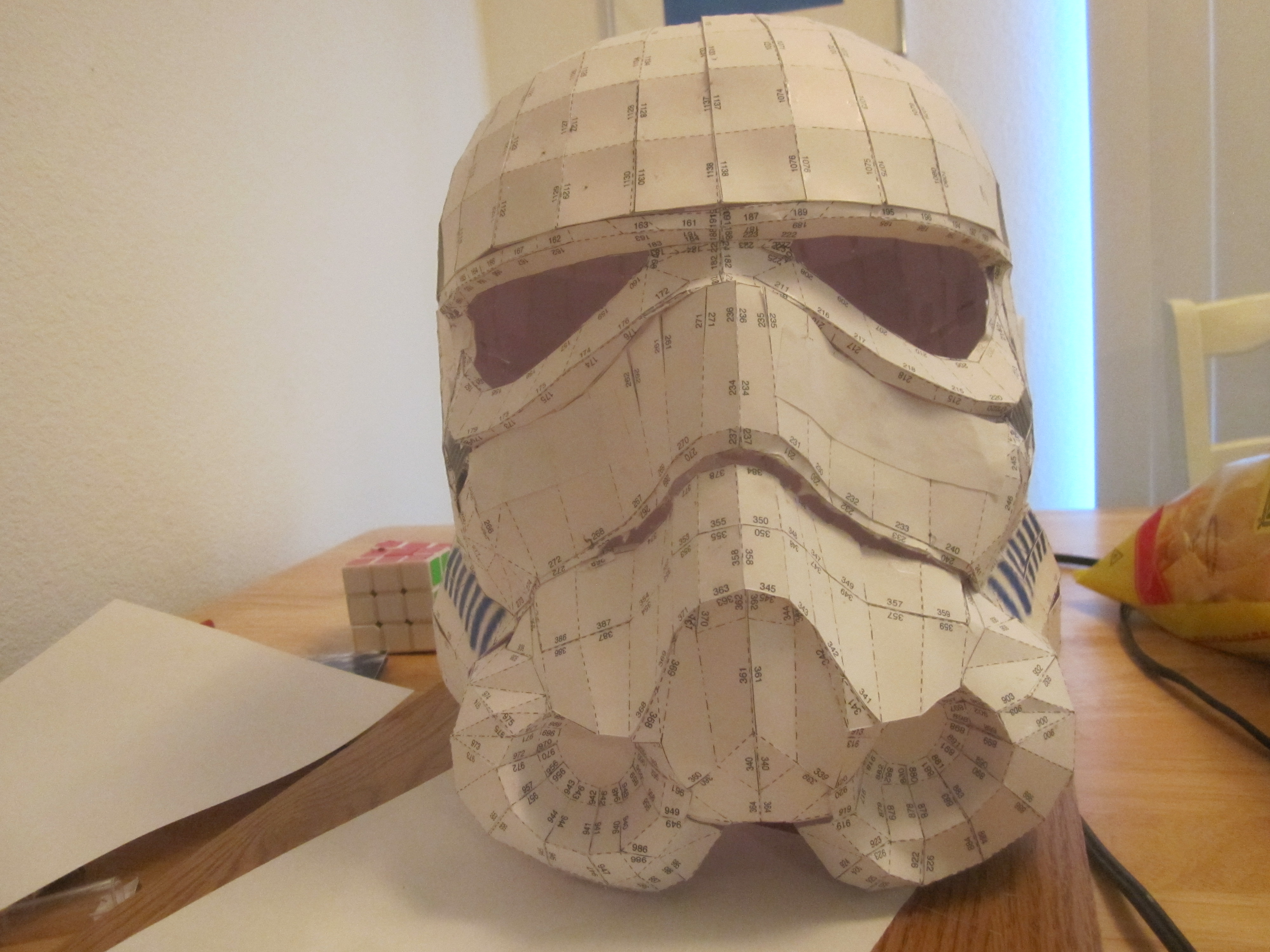

About two weeks ago I was looking for something to make my girlfriend, seeing as Christmas is right around the corner. She is a star wars dweeb, and so I was looking in that area. Then I came across the world of pepakura, and set off on my own adventure making a pep stormtrooper helmet. I used the PDF files from SpaceCowboy because I couldn't get pepakura to work with wine on my mac. But I printed off the files and then get to work. It took me about a week to finish the pepakura, and that was way longer than I expected. The lack of tabs connecting the pieces gave me a hard time, and because I have a mac I couln't see where the pieces had to go. But in the end I got everything working out. I bought some Bondo, and a bondo fiberglass kit, which includes resin, and that is where I stand as of now. If there is any way anyone can help, that would be amazing.
View attachment 266686View attachment 266687View attachment 266688View attachment 266689
I definitely have a lot of work to do with the bondo, the side tubes and such are way off, input would be amazing!
You Must leave the gap for the tooth open, or your complete faceplate will have wrong proportions!
If there is no hole for the teeth, should i cut them now? BecAuse i didnt have the pep beiwer, so i didnt know what it was suppOsed to look like. I saw someone else that bondoed and everythibg first, and then cut in the frown and inserted the teeth, and thats what i was thinkibg about doing, but this is my first so im still kind of lost.
Go and get the Pepakura Viewer, it is for free!
Without you always have to guess how something maybe have to come together.
There are already the "teeth" on the printouts, so you maybe glue them in the gap to get the right distance.
get the pep viewer!! i think that a version for mac has to exists!
all the time that you use improving the helmet on the "paper phase" is time that you will gain on the "bondo phase"

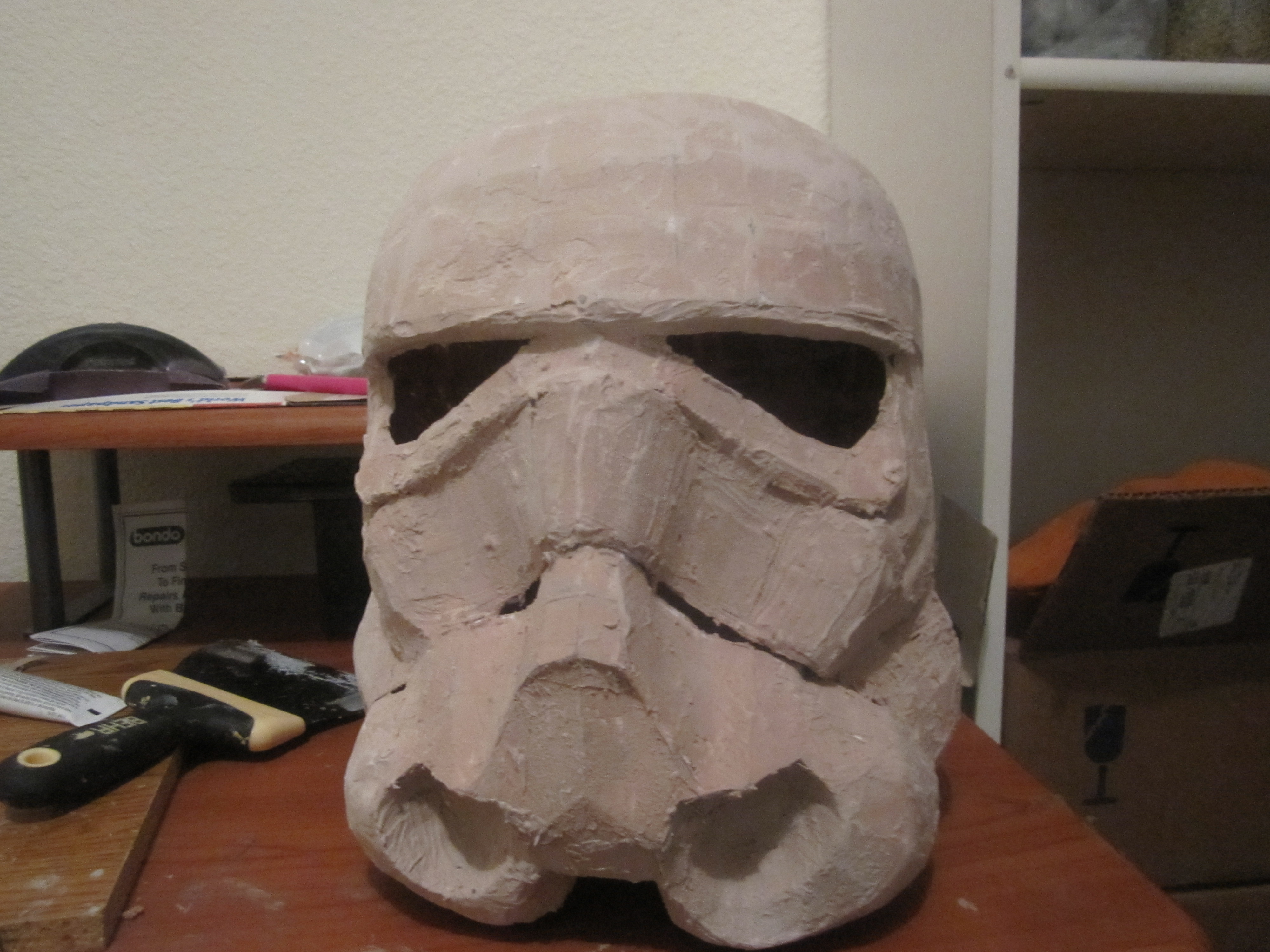

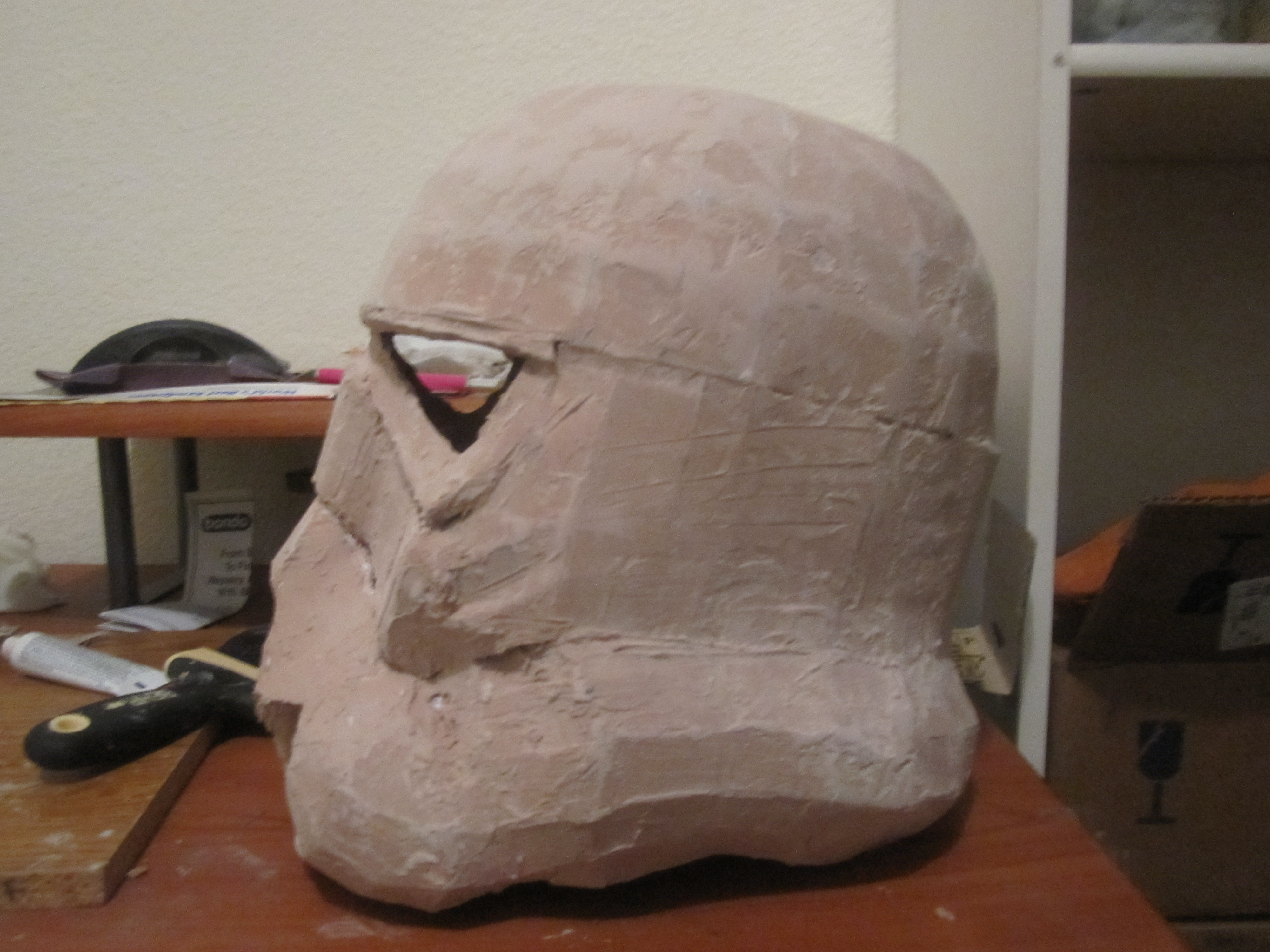

First layer of bondo, and in the middle of sanding. I have a lot of work to do, the dome is caved a little, and the frown also caved. I'm planning on getting something similar to milliput (any suggestions?) And filling stuff in. I have a dremmel so that I can get all of the spots I couldn't by hand.

The Faceplate looks somehow collapsed or "sucked together" because you don't leave the gap of the frown open!

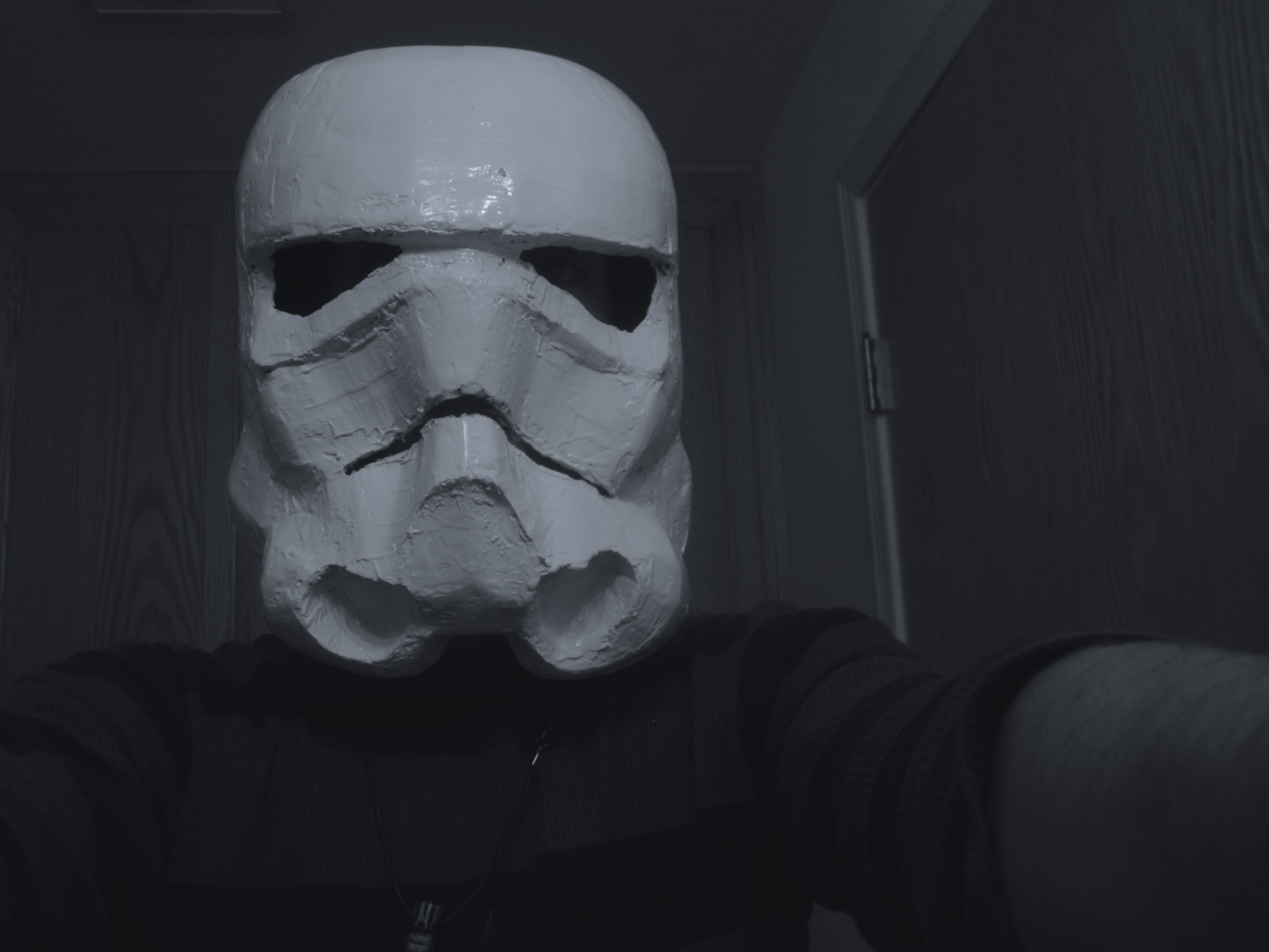

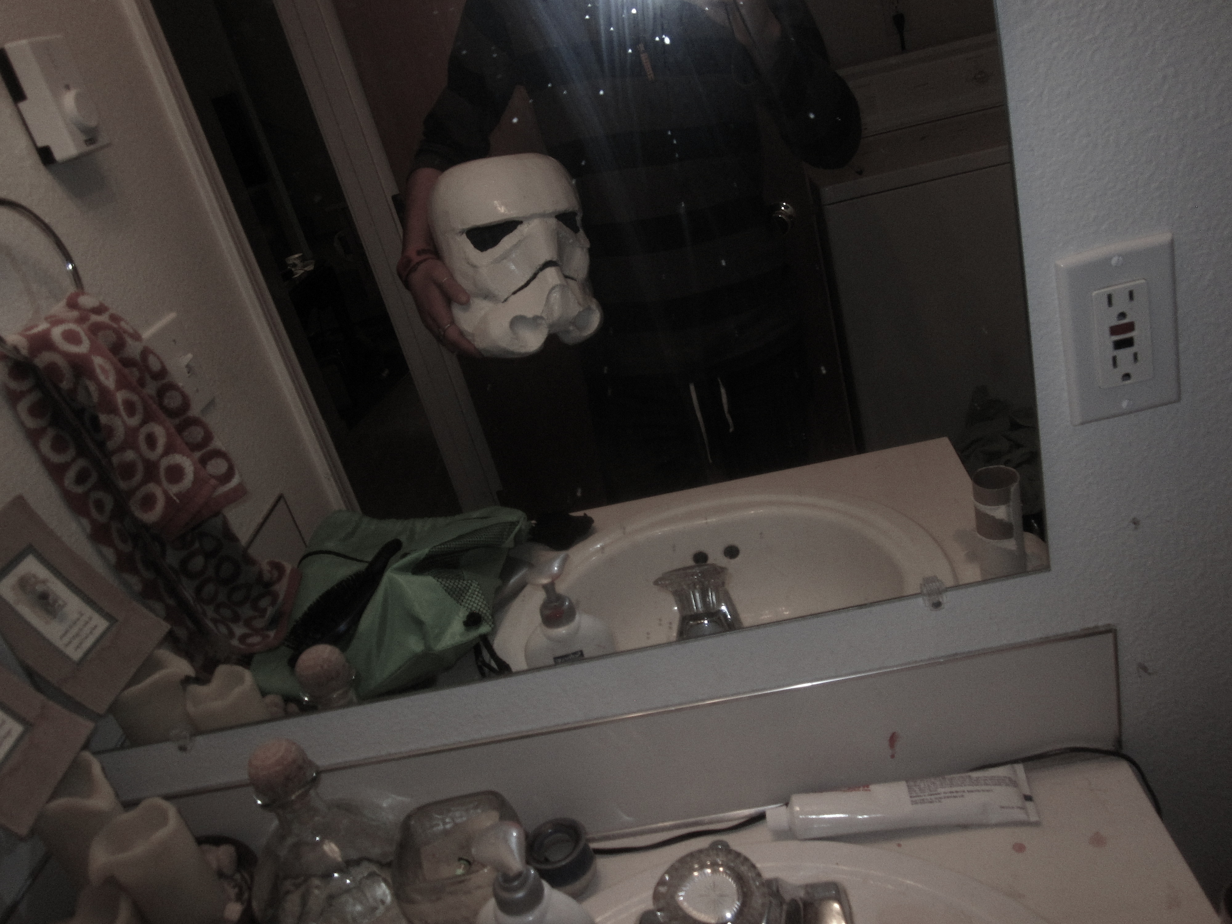

Since this is a presenr i have to go quicker than i would like, so i did the last of the bondoing and sandimg, ill prime and finish it after tomorrow. Pictures later, happy holidays!
