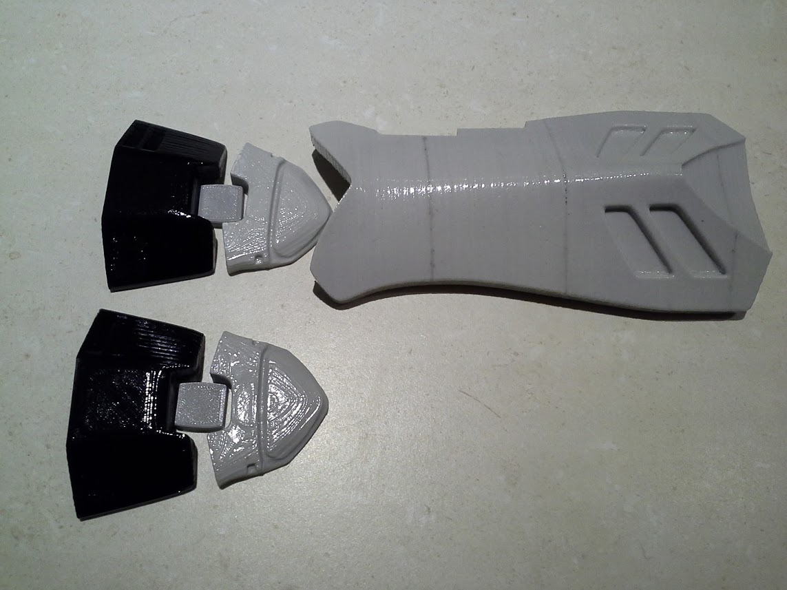

Upper Body Armor
These models where originally sourced from throttlekitty. they requred a bit of modification before they where suitable to print on a 3d printer, as well as needing to be printed in sections then glued together:
But they turned out rather well:
