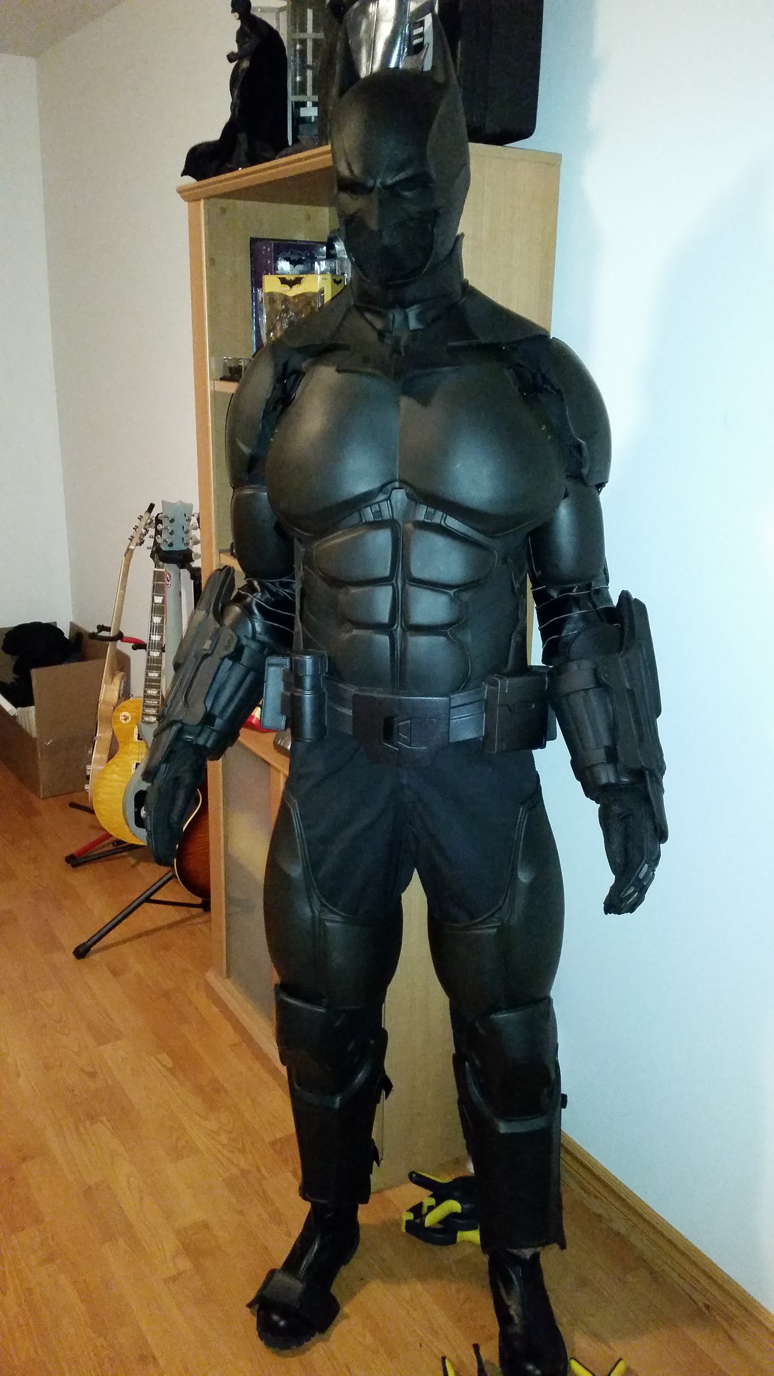

Started putting my Origins suit from Kevin together this weekend. I cant stress enough the amazing quality and detail of the suit. This is my 5th batsuit and by far the best piece of my collection. Props to Kev for the quality of these pieces. I have purchased a few things from him and have never been disappointed by the caliber of his builds. Thanks for the awesome work.
Put a lot of thought in to making this suit sturdy and functional. I will post a few more pics once I finalize everything. I decided to connect the chest, back, shoulder and arm armor with straps and clips ( the shoulders are not completely finished in the picture). The obliques and abs are all glued together and then attached via straps and clips in the back to allow for the perfect compression. The gauntlets, I mounted on a set of leather gauntlets with straps so they will be secure and tight on the forearms. The shin guards are also mounted using straps and clips. The undersuit I used, is a utility or nomex one piece suit in all black. The leg armor was attached to snaps and connected to the undersuit using those snaps. The elbow portions of the undersuit were wrapped in leather ribbing to give that flex pipe looking effect.
Here is a pic of what I have so far. I will attach more pics once I clean it up and finish off the build.
Again great work Kev.
Looks outstanding keep us updated on how you fit it together. Ill be getting mine soon so the more info shared will help make this suit super wearable
