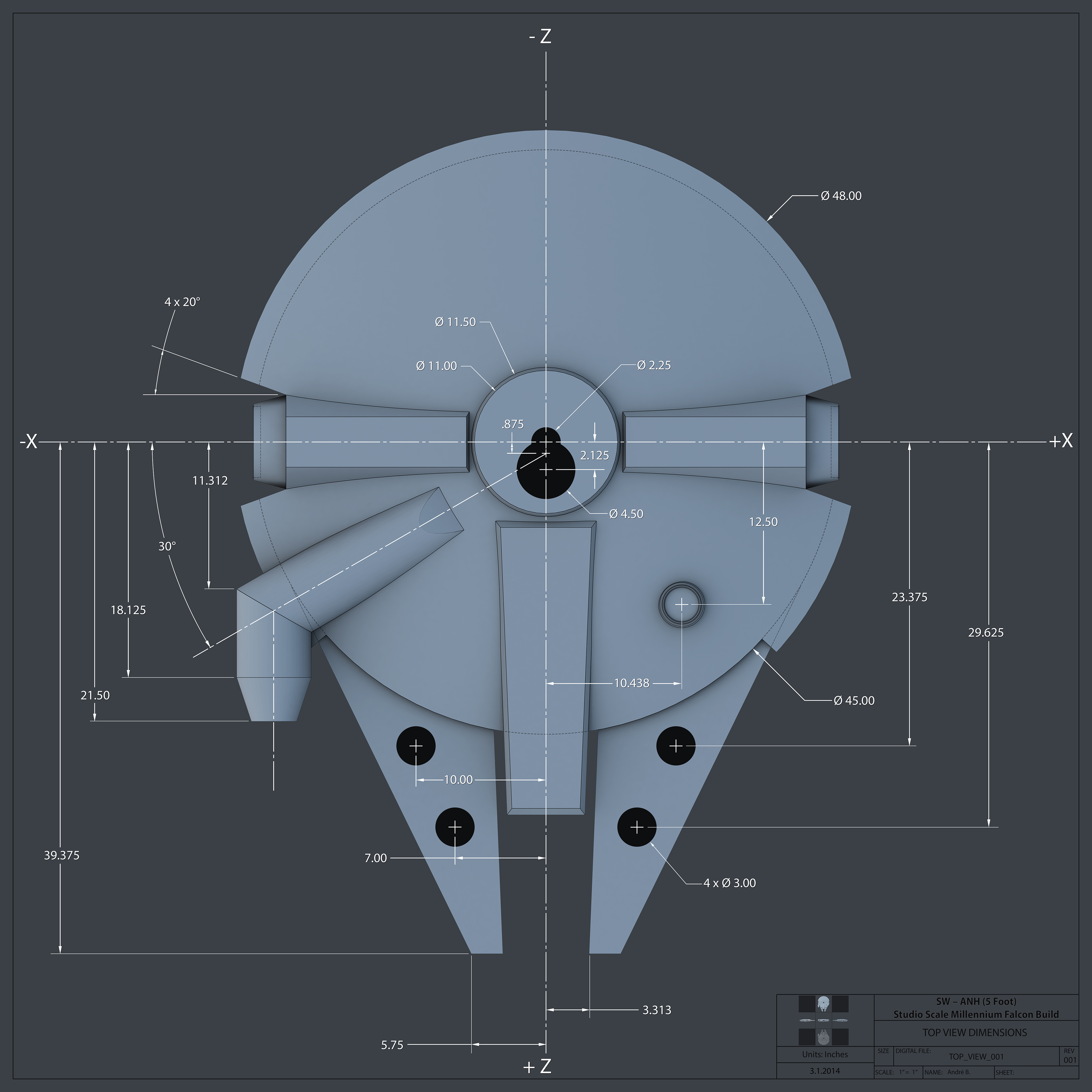

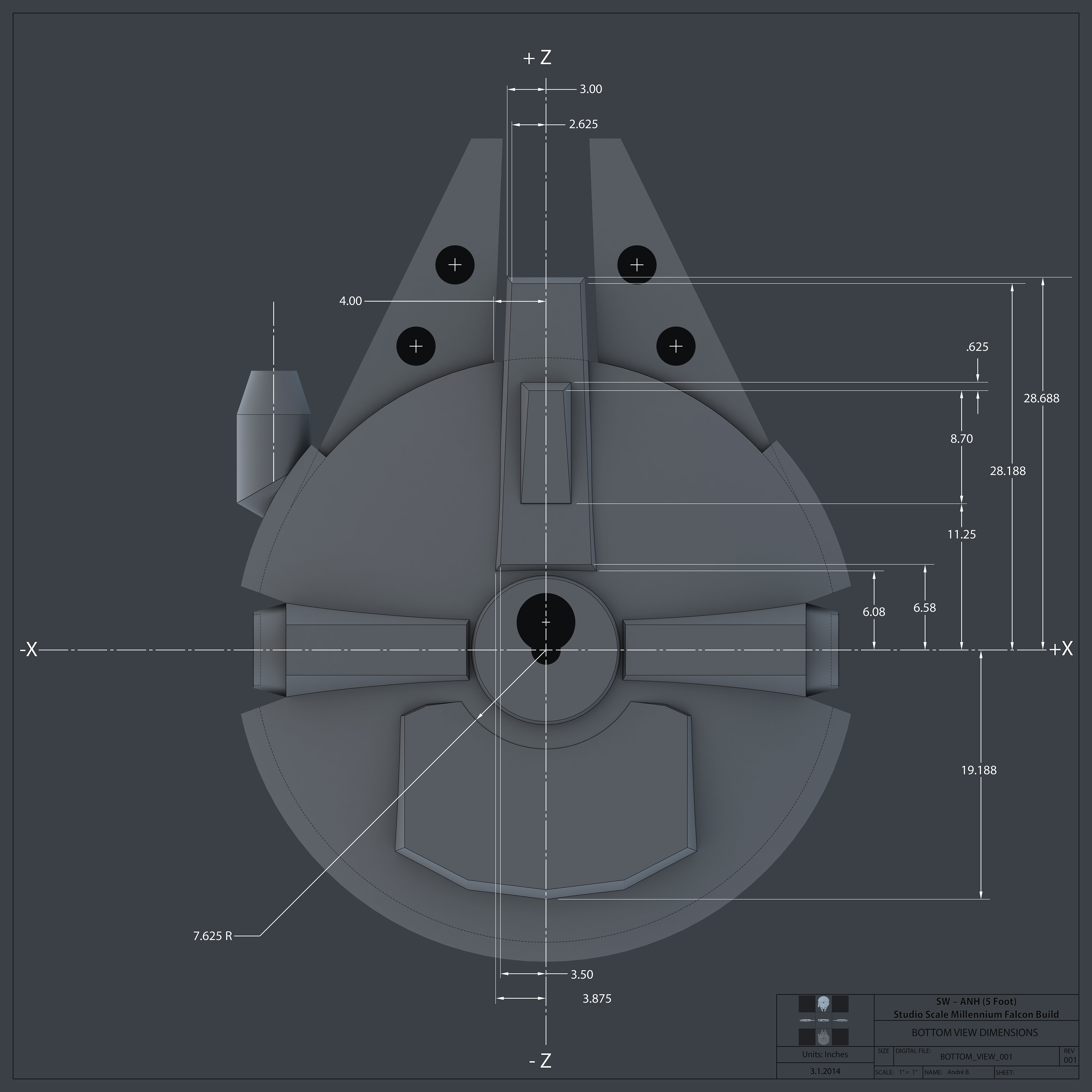

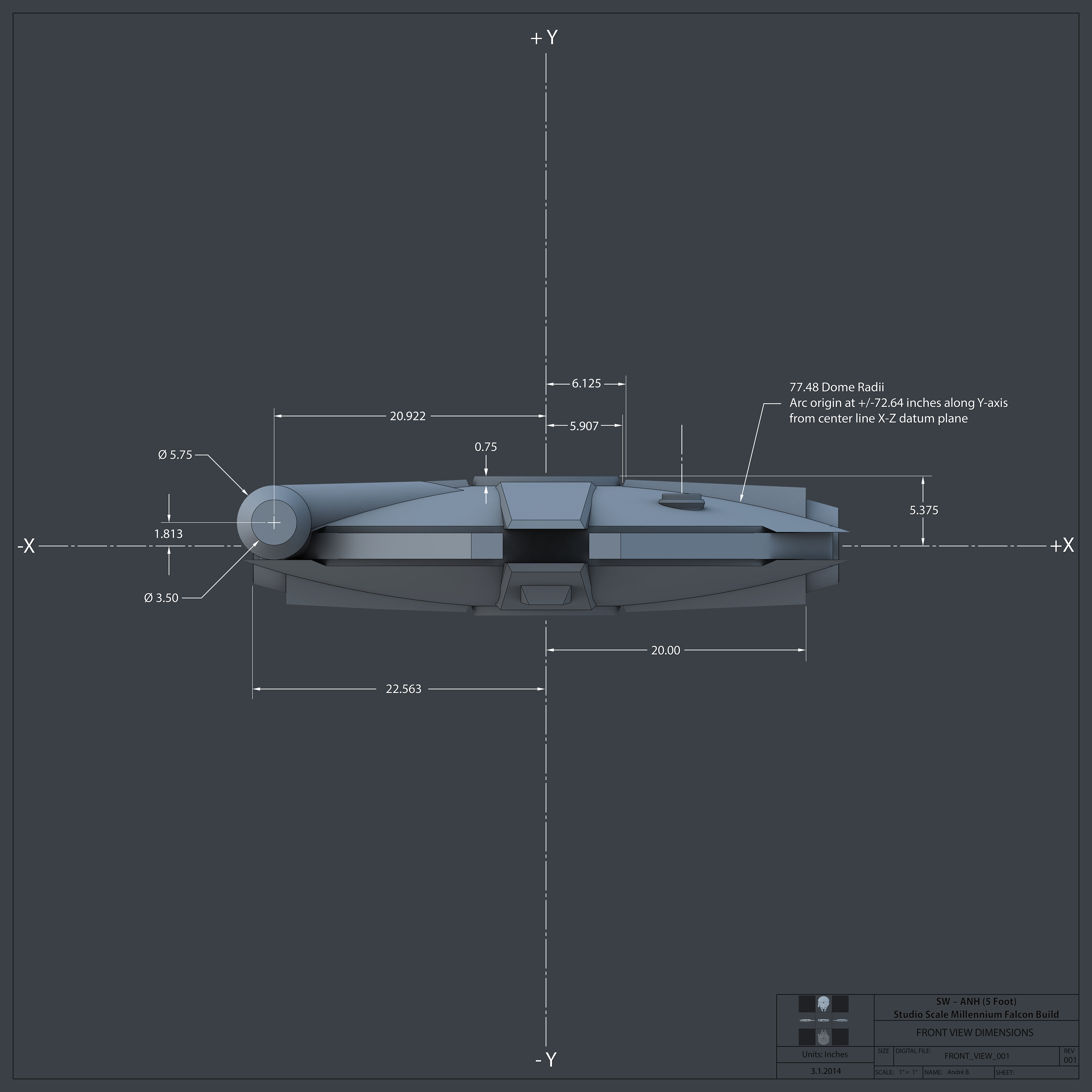

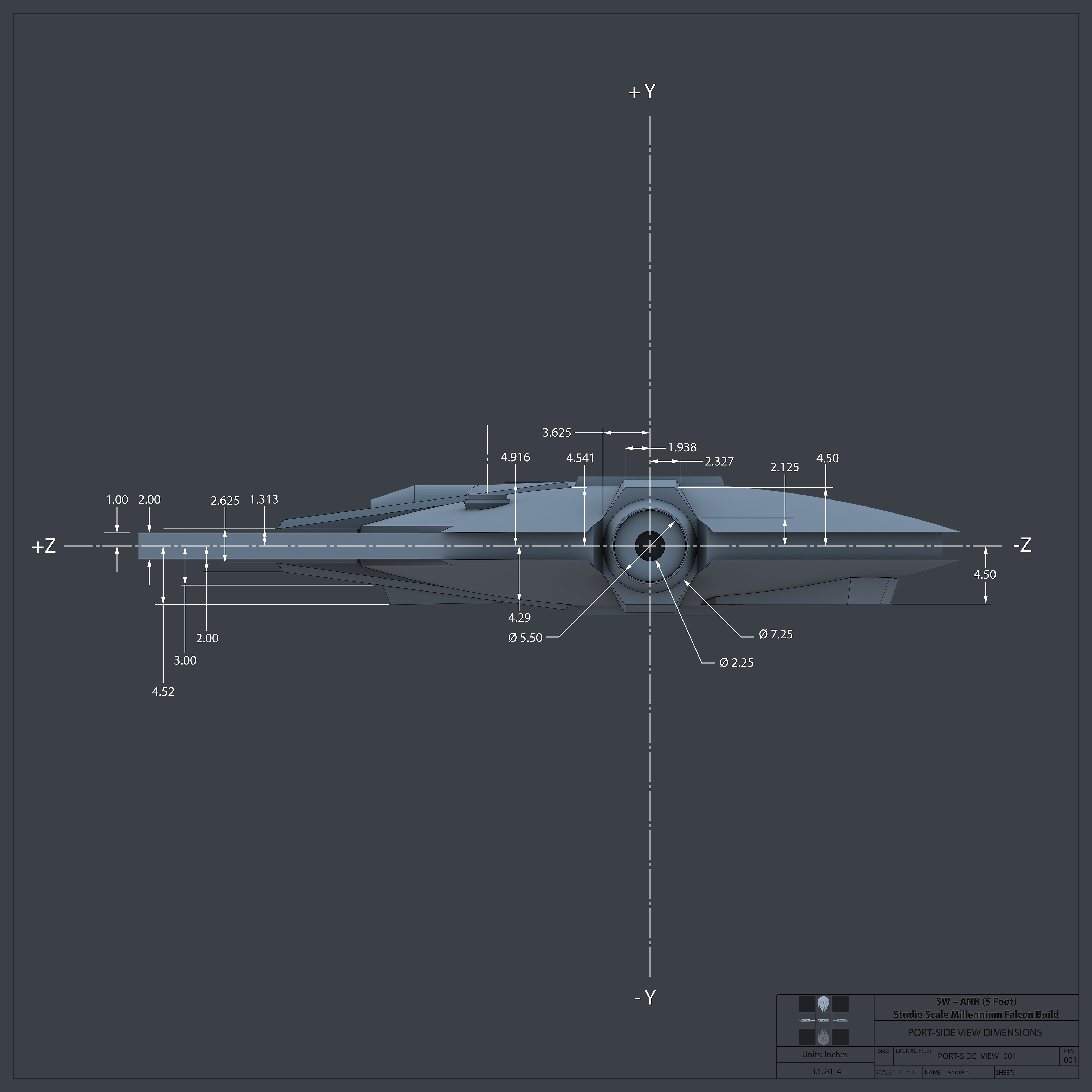

Ok…after too much wrestling with Photoshop, where I thought it would be fun to layout the “blueprints” (I won’t do that again – I’ll use a proper CAD system next time!) – please find below, my initial results.

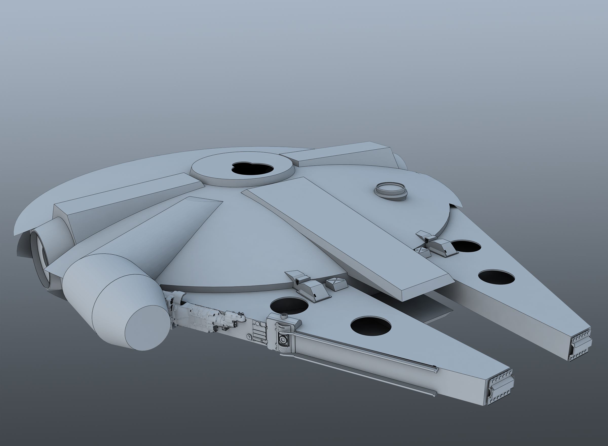

But first, some CG camera snaps and comps to the latest geometry. Overall, I feel it is very close. Towards the end, I was sweating 1/8” or less on many measurements.
It’s not perfect (as I’ll never get there) but close enough to move into Phase 2 – more on that a little later.
more to follow next...
ANH 5’ Millennium Falcon - Proposed Blueprints (ver_001):

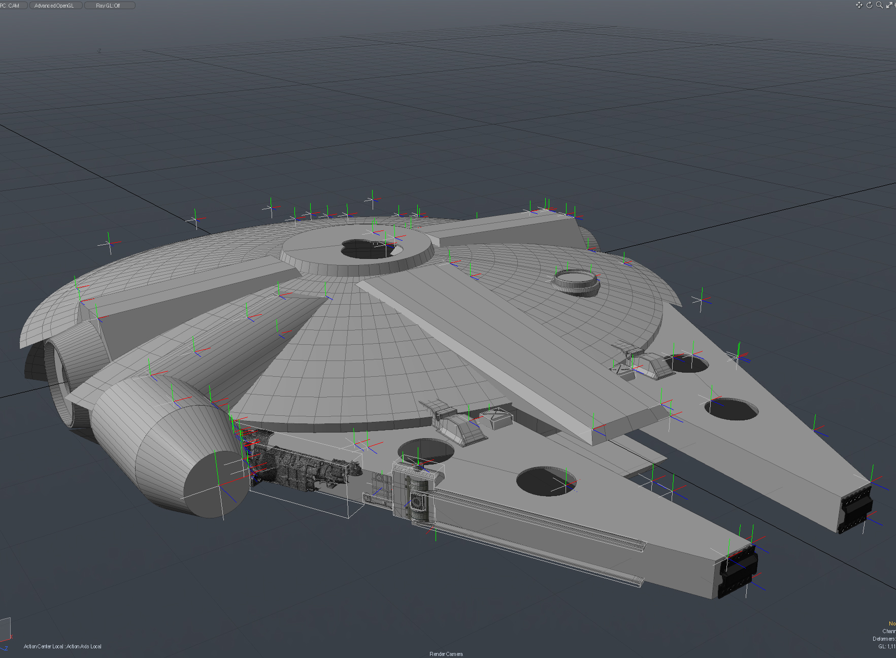

Next up, Phase 2 will involve hanging donor kit parts off the proposed CG geometry to continue to check my measurements and assumptions.
For example, this next image – an example of null locator reference of key landmarks in 3D, derived from both the modeled donor kit parts and stills reference.

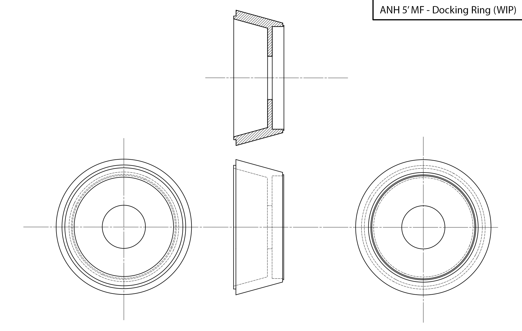

Also, I will update some of the incomplete areas (docking ring detailed measurements and the rear bottom engine box) with more standard blueprint images. For example:
I will also be laying out the real donor kit parts on physical subassemblies as a final check before I move into Phase 3 – the actual build.
Please feel free to review, critique and comment – I’m sure I’ll need to revise a few of these measurements (i.e. the placement and dimensions of the cockpit and access tunnel) and I look forward to the feedback…

Hi Andre, it felt just like unwrapping the biggest present on Christmas opening up those attachments! Thanks so much for the measurements!!! And unbelievable the way you comp geometries onto videos. You're way ahead of your time.

Looking at your renders it really does look like you have nailed the proportions and got something which instinctively 'feels' like the original Falcon. No way could you mistake them for the 32" for example. I see what you mean about the cockpit in the tracked docking bay shot, yet in the other renders and snap-views it actually looks really good, so maybe its more of a tracking/distortion issue?. I think your next phases of kit part comparison will definitely help fine tune things.

this is fantastic! I can't stop stearing on this Blueprints. You did a great job and I can't wait to see this build.

Really love the curvature of the hull (an area a few have a tendency to get wrong; yes, it's that curved!) as for the cockpit area, I fail to see what's wrong with it...could you expand (that or my synapses are not firing properly);)
Heya Andre,
An amazing job done on these blueprints mate. Great to see how the 5 3/4" cockpit tube fits with the hull, I feel it looks good. As long as the Wankel half fits in there as it should, then cool!. Remember the cockpit plating will take up more space as well & also detailing which may give the illusion of it either being too close in or too far out. One to test on an actual build maybe?.
Couple of things I found, no biggies. I have made the gun turret window cutout at 4 1/4" not 4 1/2".
Also noticed you have the large rear underside landing gear box ends, (gun turret end) in the wrong orientation, they don't slope down like you have them, the ends rise up past the horizontal. Do you have a good underside shot Andre which shows this clearly?. If not PM me with your email addy & I'll send it to you.
Critique aside, all looks good, it has the feel of a blank 5' Falcon which is great. Look forward to more measures Andre, keep at it.
Oh, curious to know the length you have for the upper/lower jaw boxes when you have them.
Stu
