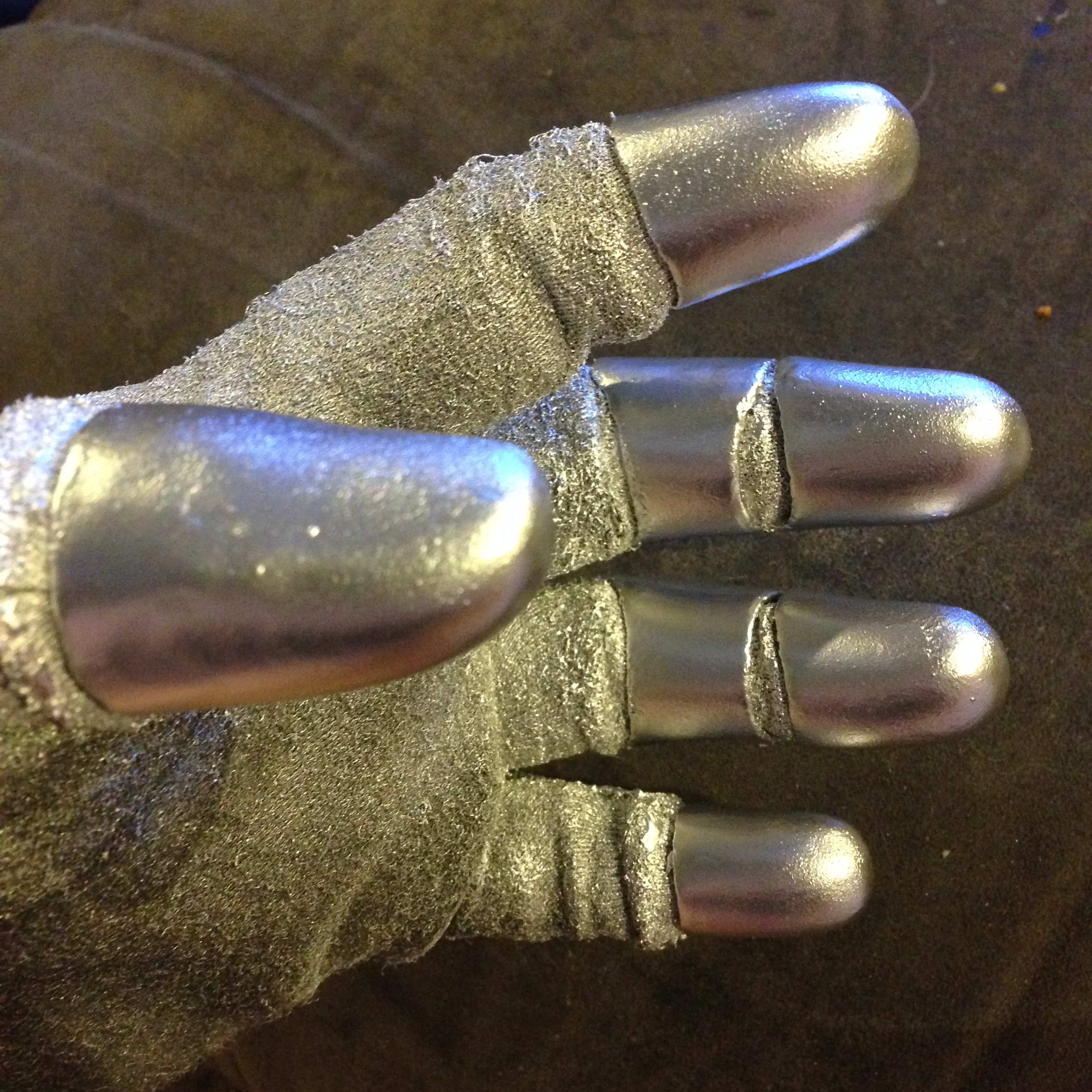

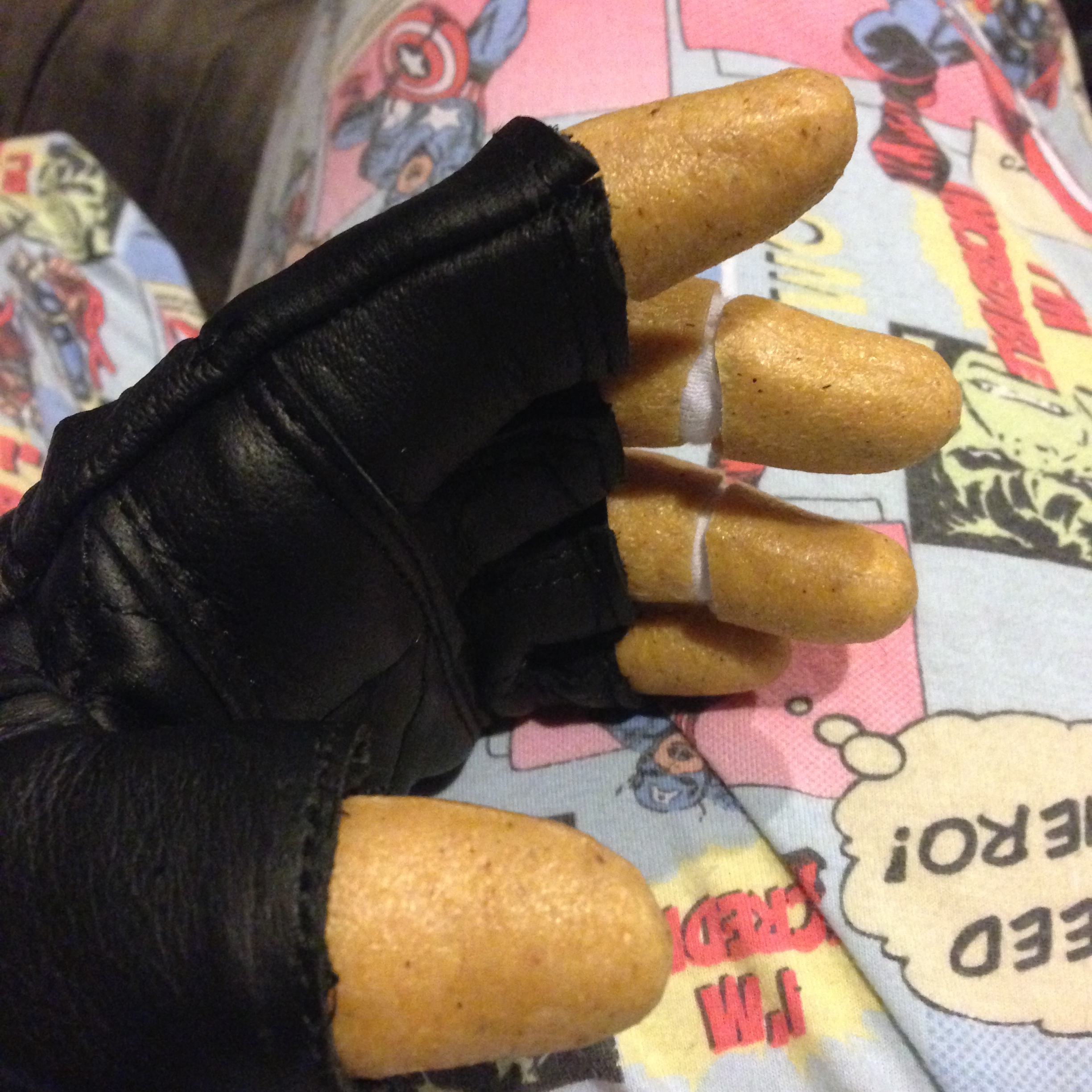

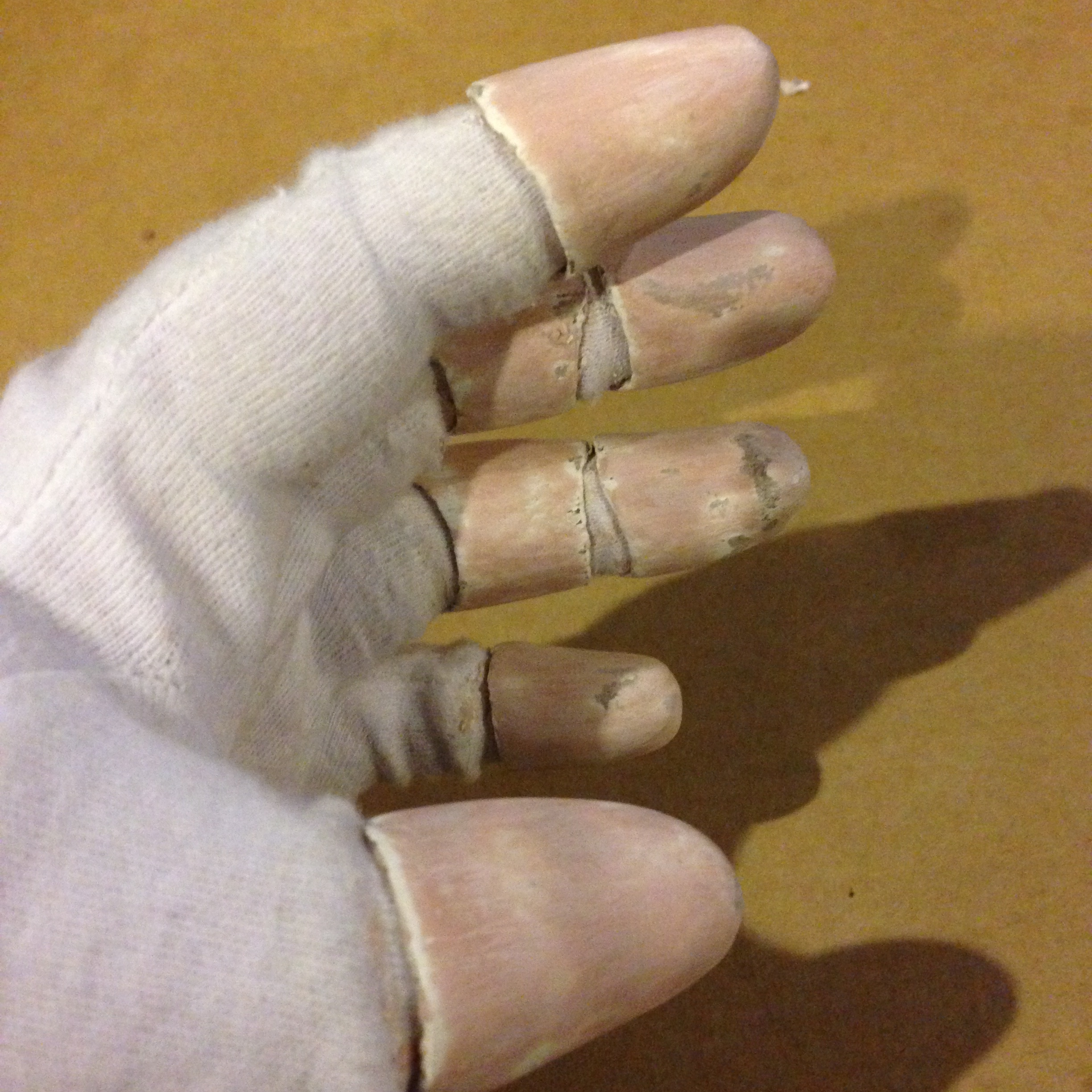

I thought it may be helpful to show how I tackled WS's hand. Hopefully it's useful to someone.
I bought a pair of cotton gloves (available at the supermarket, with the rubber gloves). These provided the base to adhere his Worbla 'fingers' to. I have short little fingers, so I only made the bits that would be seen. The back of the hand will be covered with silver stretch fabric, so I can still have a decent range of motion. It really only needs to be there for the areas that are visible in the glove. If you were super keen you could get/make a silver glove. I wanted the surface to be nice and smooth, and Worbla has a sandy texture, so I did a few coats of gesso, then applied body filler. Sanded it all, then hit it with a primer, and finally two coats of chrome spraypaint (though the pic shows after only one coat). I can't completely close my hand into a fist, but I can still close my fingers - you could probably tweak the amount of worbla underneath the finger so you get a bit more movement. I'm pretty hard pressed for time, building both WS for myself and Cap for my bf, so I don't know that I'll add the detailing on the fingers. Anywho, here's some images to give you an idea of the process :)

Nice work! With the fingerless glove he has on, those fingertips will look perfect. BTW, the movie's effing amazing and I had a great interview with Sebastian Stan today, so I'm pretty damned psyched. How to do the arm keeps me up at nite tho. Lol.
Thanks! Amg the movie is so good. So good. We've seen it twice now! The interview sounds like it was awesome! I'm going to be using Worbla for the arm, in two parts (similar to the arm used during filming). I don't exactly have WS's musculature so I made a foam suit for my arms and I'll use that as the base to shape the worbla over. We're just about to tackle it so fingers crossed it works, and if it does I'll share the process :)
Great work on the mask and glove mudget. I did my glove almost exactly the same way and we have been working on a Wonderflex arm. I don't have the muscle suit but my wife sculpted an arm on a mannequin. So far it is working out ok, you may have better luck with the suit underneath.
