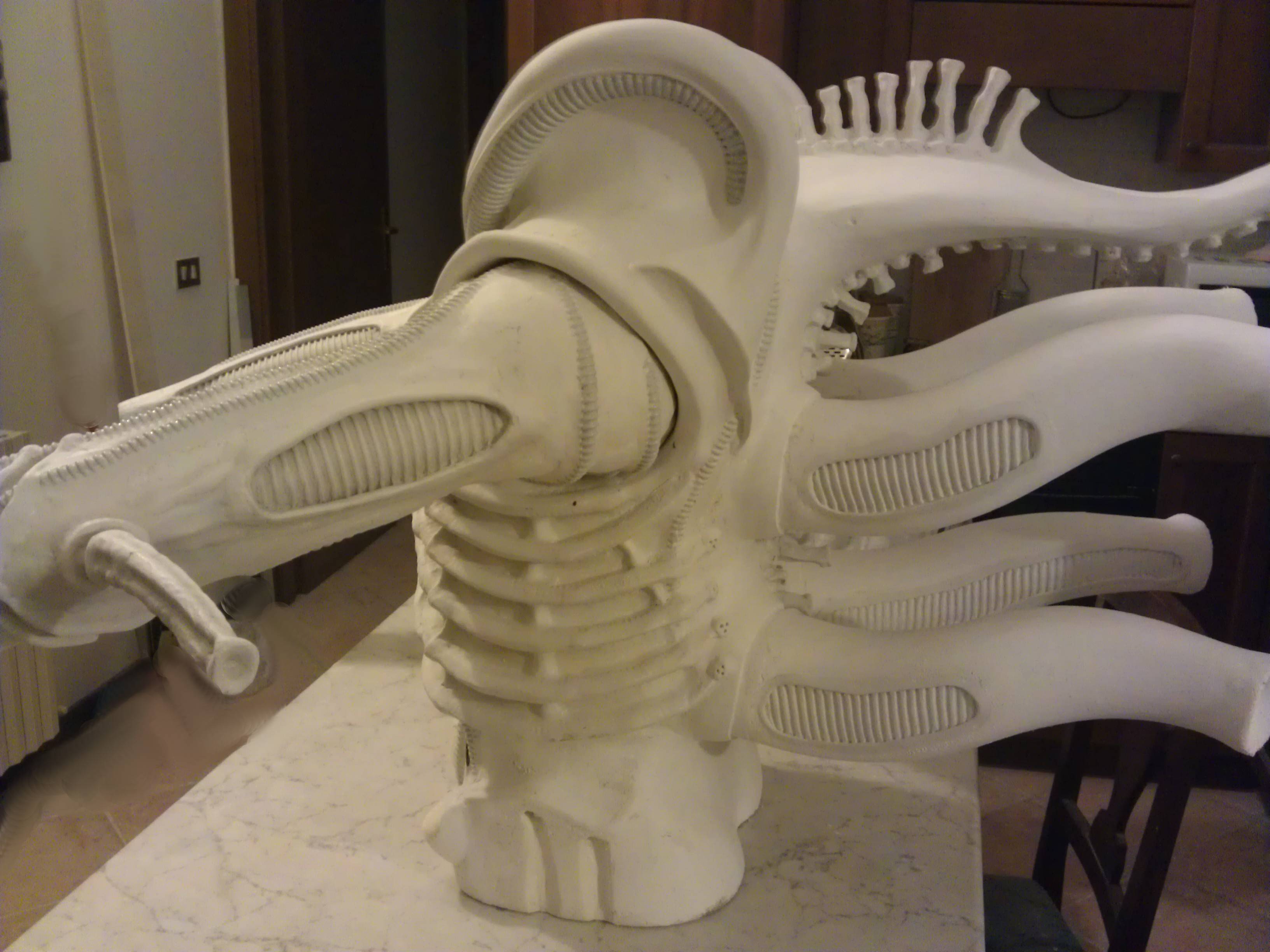

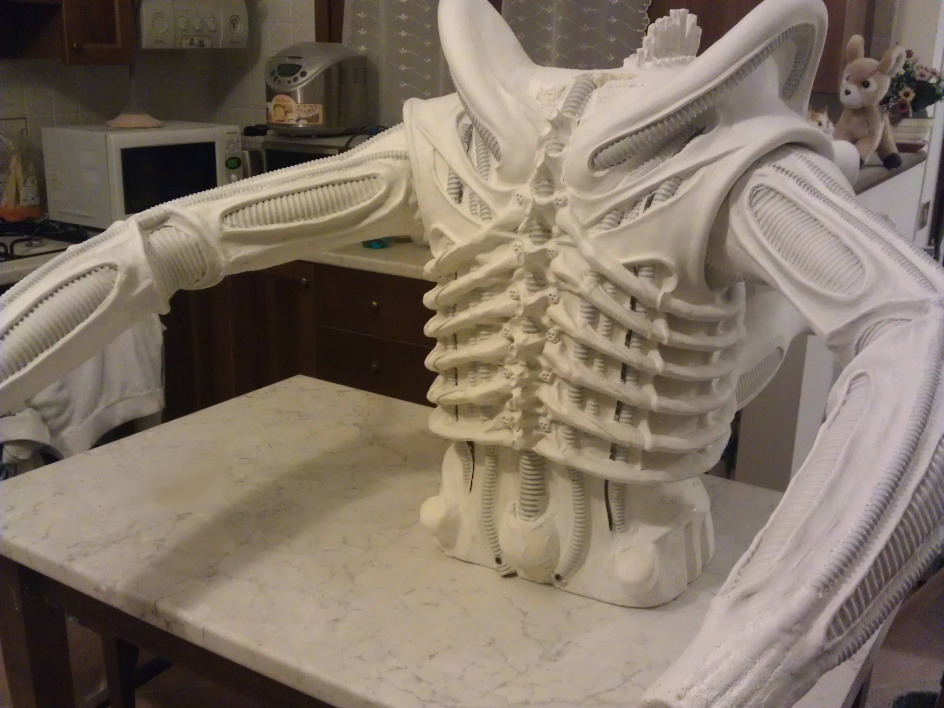

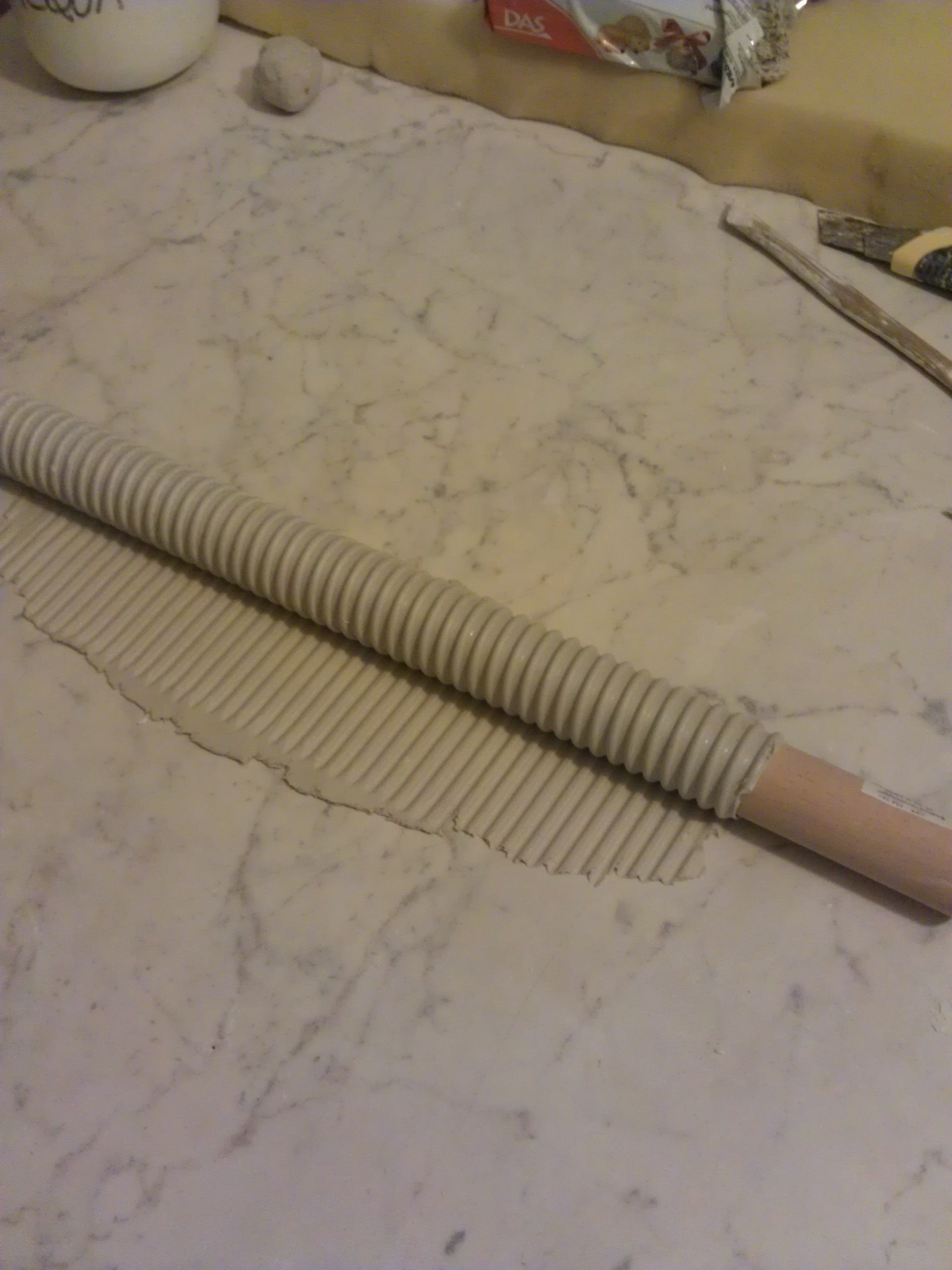

I added the pipes and corrugated surfaces to arms, glued tubes and connected with modeling clay. I used a little 'bigger pipes than the original, because I like the most. Furthermore, for the same reason, I added a corrugated surface outside of the forearm, which in the original is not there. To realize the corrugated surfaces I used a corrugated pipe like a rolling pin on dough modeling, inserting it into a rod of wood.
As soon as the modeling clay will be dried, I will be able to get a sanding surface more smooth, although I prefer to leave it a bit 'rough because I think it is more realistic.
soon with new images. :D

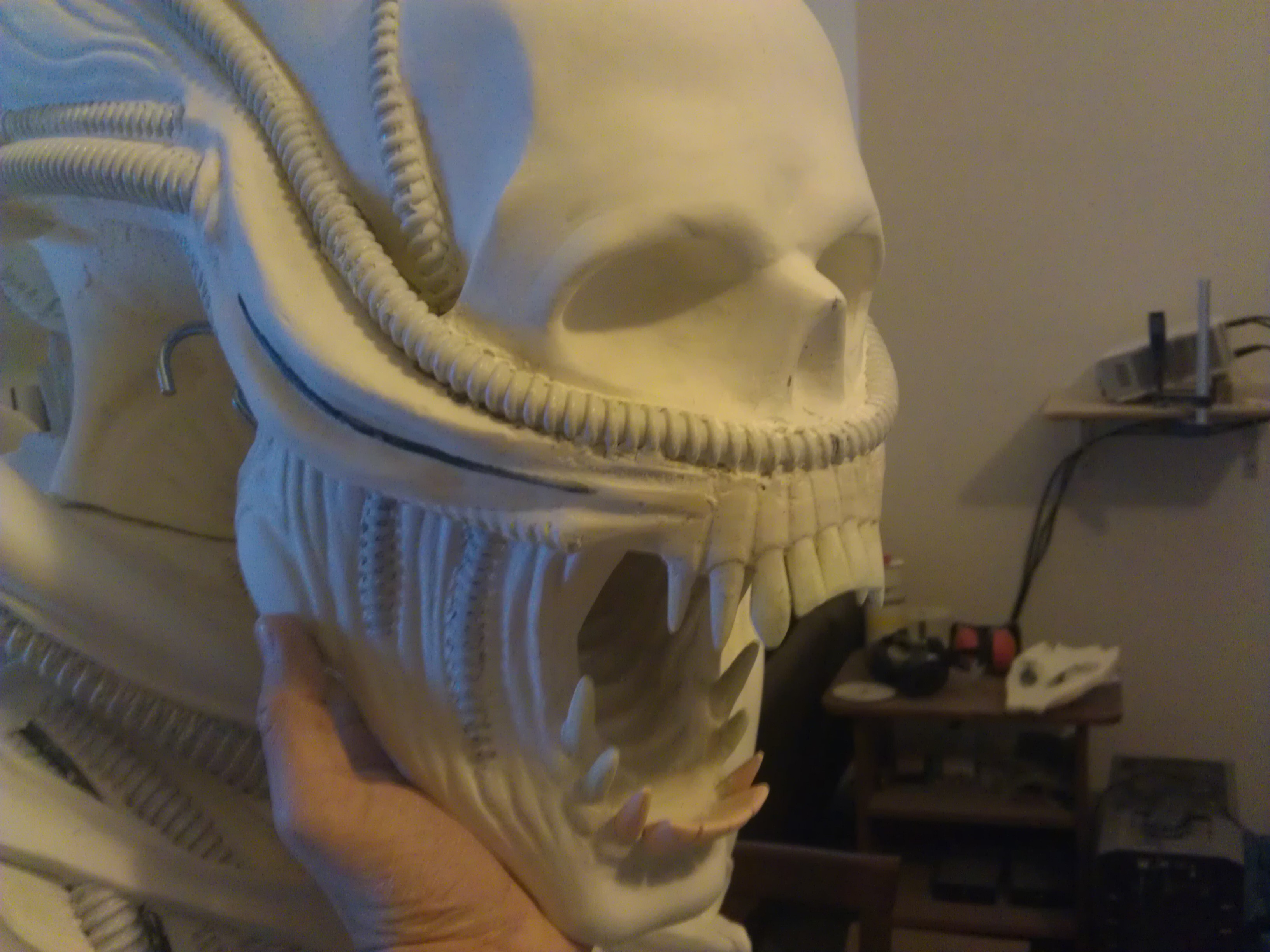

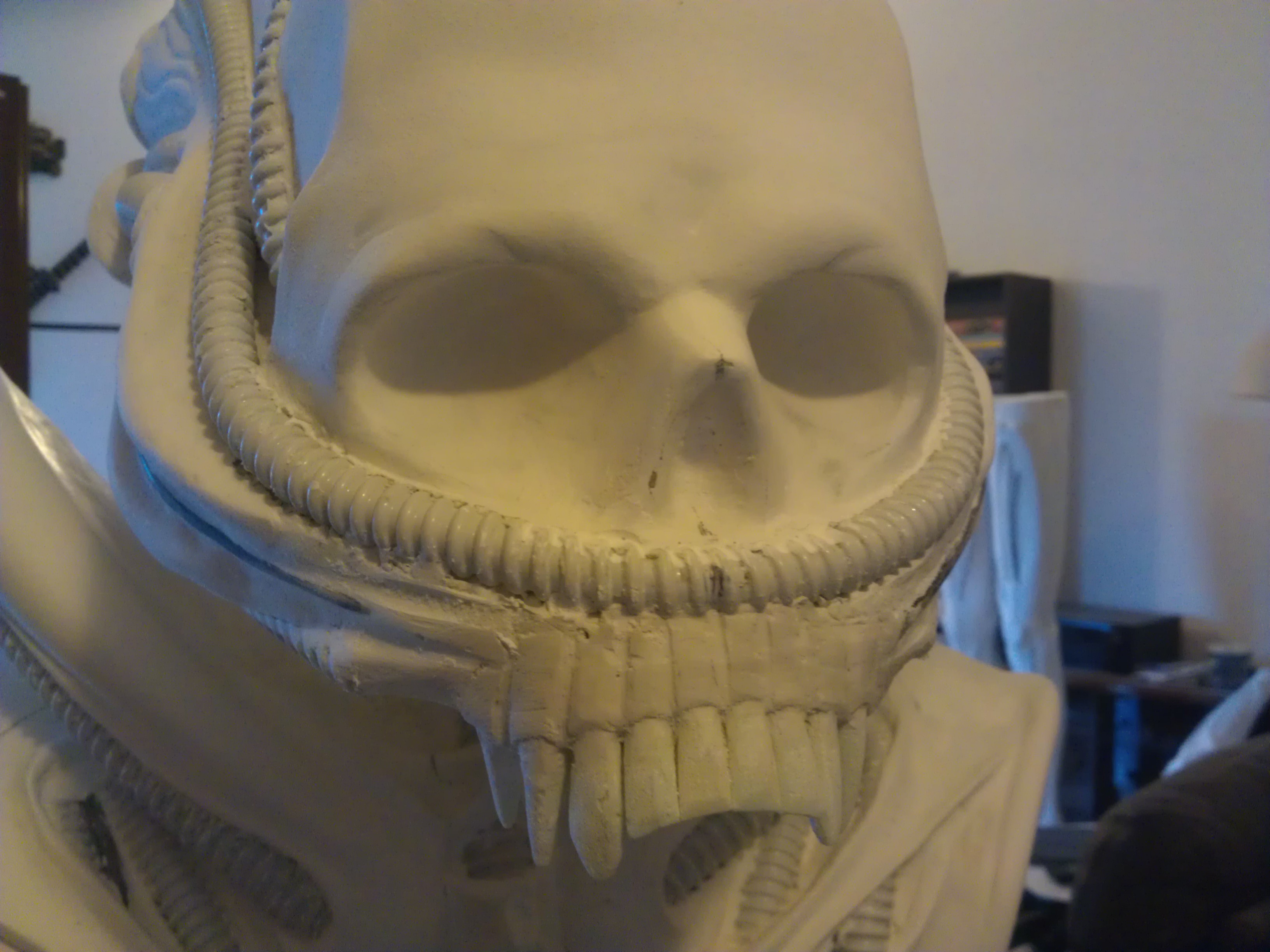

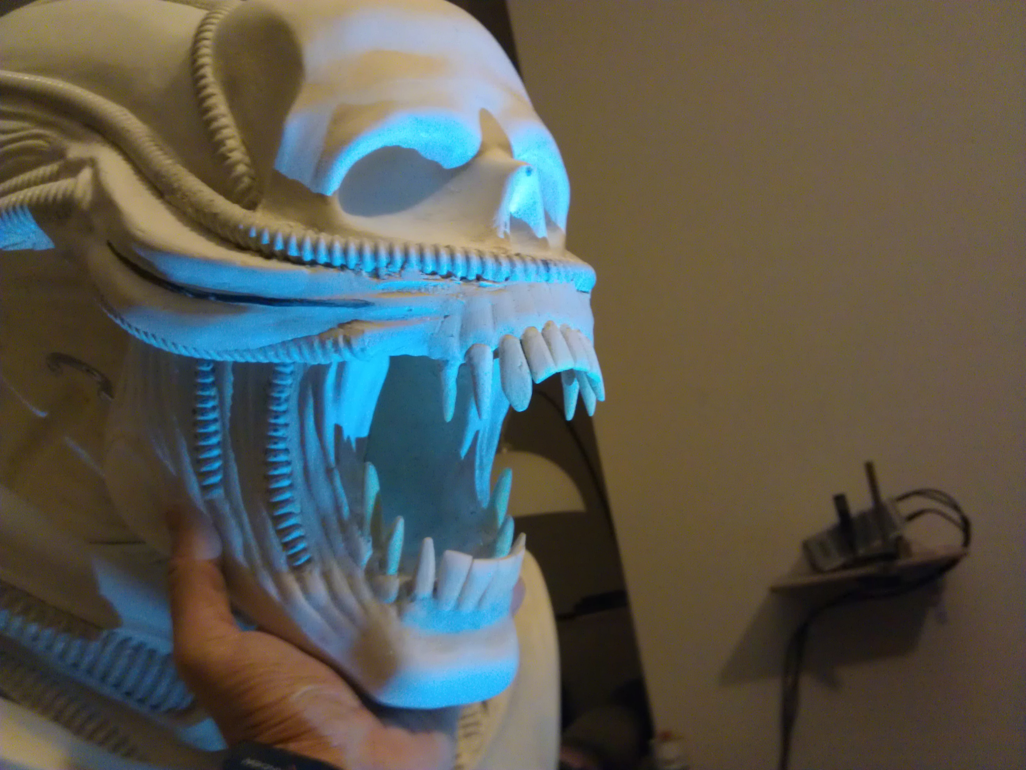

further refinement to follow. I Corrected the upper teeth and lower teeth lengthened. The material of the teeth is 160kg/mt3 density polyurethane foam, which is very easy to shape. In each tooth is inserted a metal pin and fixed jaw with plaster.
