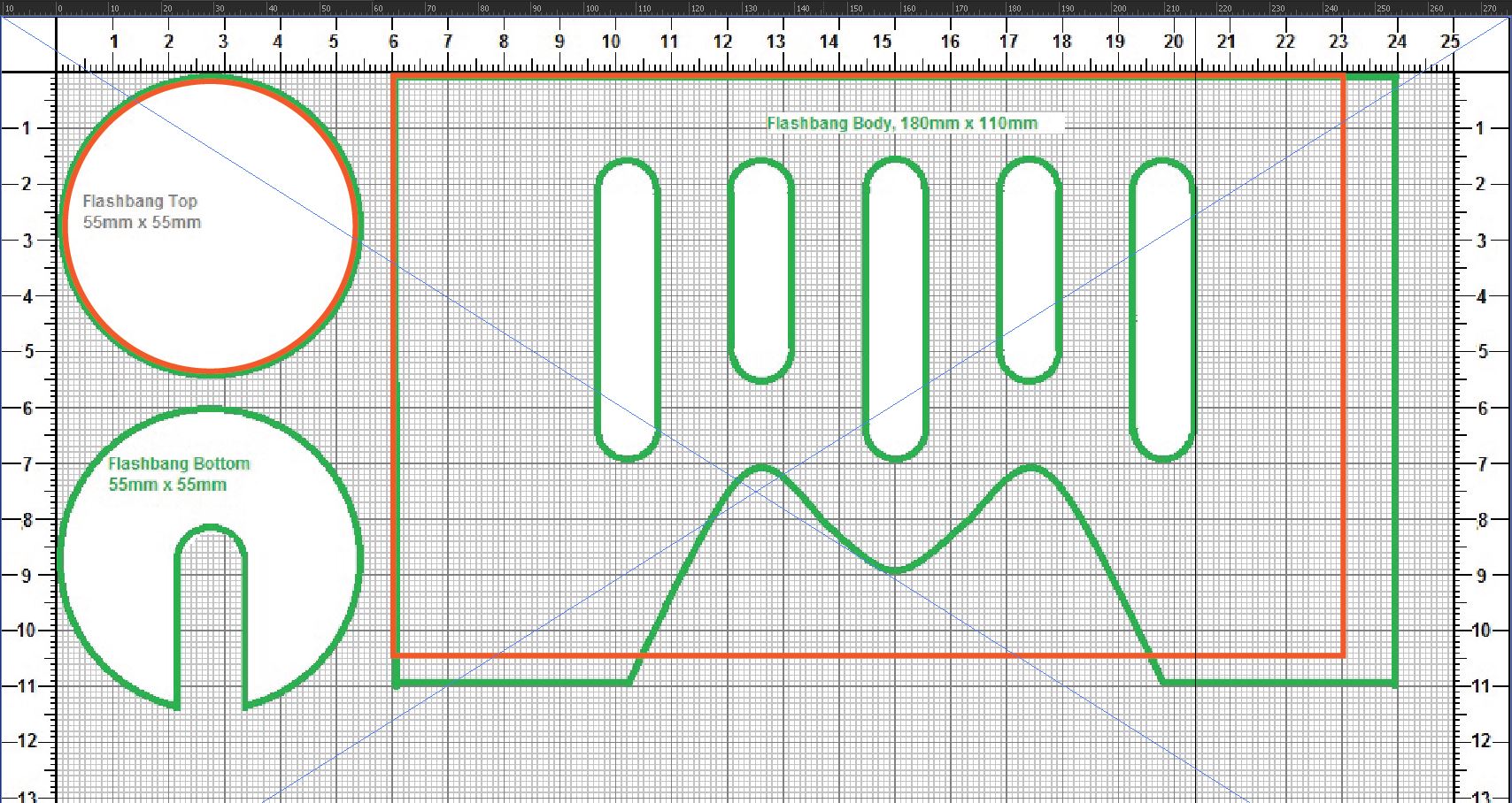

Really? The ones I found, that seems to be the popular ones to use, had the correct size typed out it seemed, but when actually measured they were too large, and I had to scale them down to the dimensions that they claimed to be. (I'm talking about the ones where the lines are green and they are in millimeters.)

Yeah, those are the ones I downloaded, and I downloaded the newest version to, this is what I mean
My orange outlines are drawn to the dimensions typed out on the template.
The orange 55x55mm circle is very close to the green one, but the orange box that is 180x110mm, the green one is pretty off from it.
That's odd. I know the orange boxes are the size stated. I wonder if when the printer shrinks them (the green ones) to fit they end up being a closer to the dimension size? I printed one out and measured and it was bigger than the stated size, and I had my printer set to "actual size" vs "shrink to fit".
The circle is close, but the other part looks like it should be several mm off. I don't know how it's not when printed when it is when I have it up in Illustrator.
I just printed one of them, using Windows Previewer. Unselected "fit picture to frame"; Measure fine. Tried with Jasc PSP9 (don't have illustrator) and it was undersized. I imagine if I had time to mess with the print settings I could getting to work (100% scaling didn't...).
It's no problem for me to redraw them, I'm just not sure how they aren't large for everyone else like they are for me. Was trying to warn everyone they were big, but apparently it's just me? lol I have not tried the others yet.

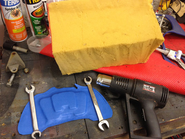

This shows the heat gun I used to heat up the foam, I put some wrenches on it to keep the foam from curling since this test piece was already cut. You don't have use anything to weigh it down, I didn't on my next run. The yellow chunk of foam is what I used to press the heated foam down to the form with:

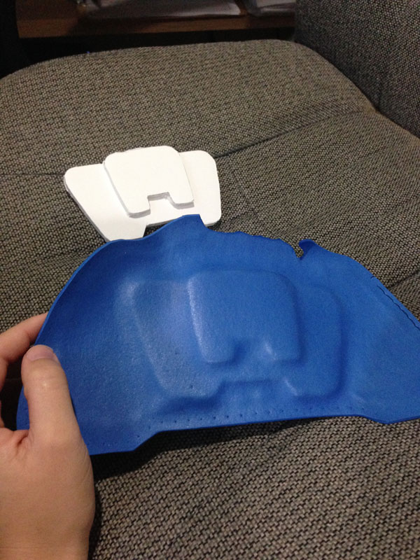

Here is a shot showing the foam board template I cut, which was used to form the foam:

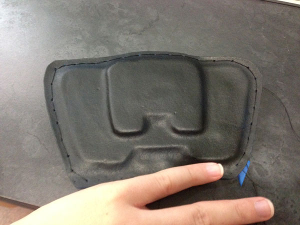

Here is a shot of the end result of the test, I just rough cut it out with scissors and did some stitching to see how it would look. It is black from one quick coat of black plasti-dip. This look satisfied me that this method would work on the "real" pieces, so this is the method I will be using.
Note: You need to put something on the back of the formed foam to keep it from being floppy, I started with cutting each of the two shapes in more foam, and gluing them inside to fill the shapes. Will put something even more rigid behind that as well.

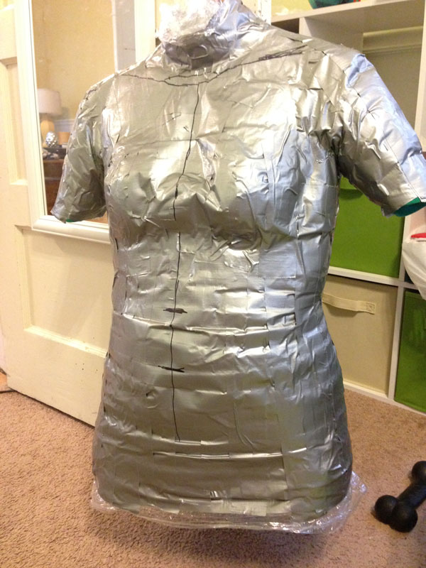

Yesterday I was frustrated from not being able to find some stuff that should have been easy to find for the vest (2 inch webbing, black 1" elastic, etc.) so I made this duct tape torso form to at least feel like I was doing something. Not sure how useful it will be for this project, but I have it if I need it. I have to tape up the cut in the back and stuff it and hopefully make a cheap PVC stand for it.
Not sure if your duct tape mannequin will be vital to your Dredd build either, but it sure does look fun! :)
