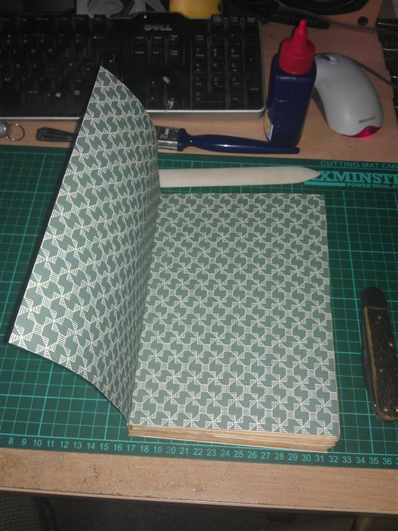

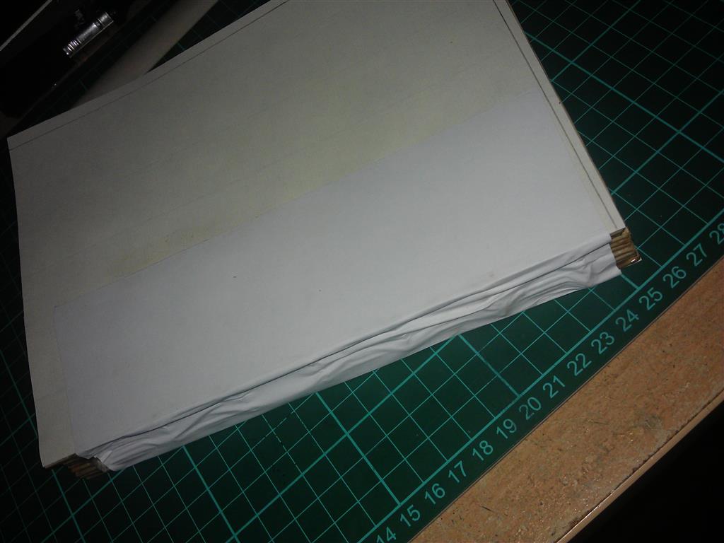

After applying the inside cover pages, the textblock was reinforced with a sheet of paper and a lot of PVA glue:
Once that had come out of the book press, I measured the textblock for the sizing of the covers:

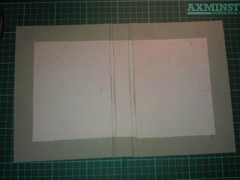

A piece of grey/green cloth was cut which was 30mm bigger on all sides than the book board pieces. Those flaps were then stuck down to all sides, a piece of red cloth was also stuck on over the spine and then it was back in the book press while the glue dried:
