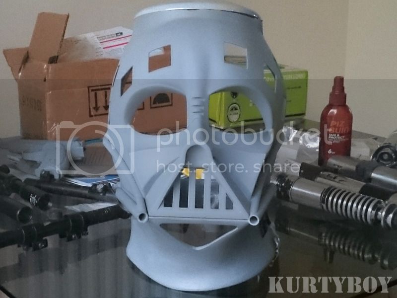

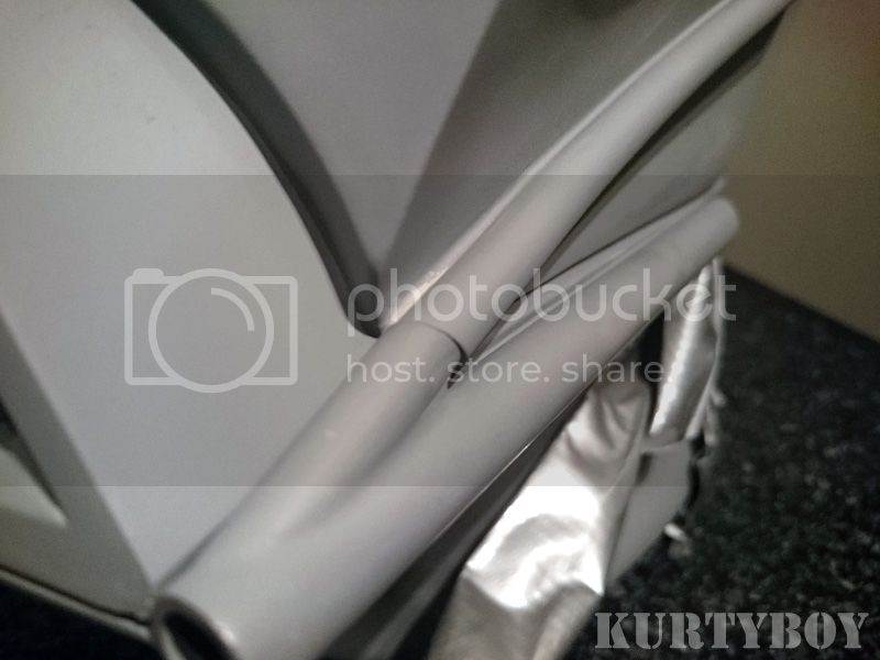

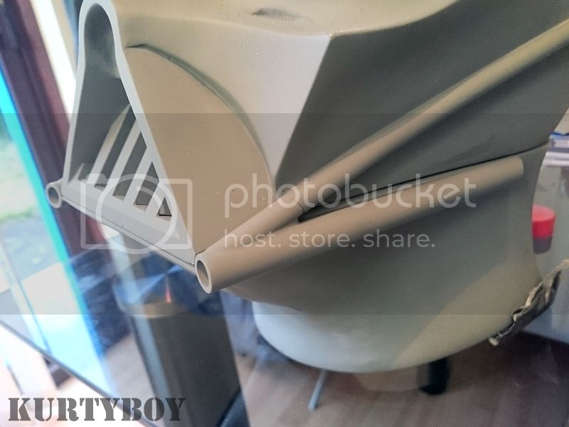

Kurtyboy's new Vader Reveal project. 10 April 2016 - New tubes.
Got a lot done this weekend. First I started fixing the incorrect details where the cheeks meet the nose (this casting had been altered) and the eyebrows which were too thin. These are still WIP.
Once again the rails/grooves were no longer working so I had to reshape one groove. That's the fourth time I've had to do this. You'd think once would be enough!
Added the new tubes which was harder than I thought it would be. I went with two pieces on the face as this is the only way to explain the seam on the original, and it makes it easier to line everything up. This took many, many attempts!

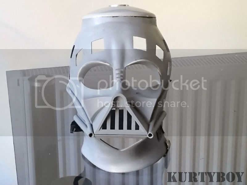

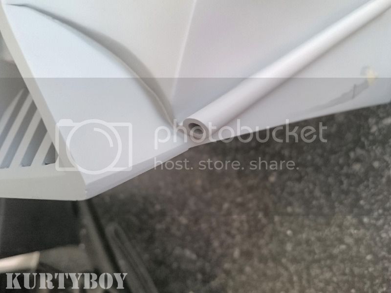

Kurtyboy's new Vader Reveal project. 15 April - Tusk tubes and eyebrow/nose details
Thank you everyone.
I got a bit more done this week. Still some clean up to do on the tube seams once the Milliput dries but nearly there.
And I got Vader's left 'eyebrow' reshaped and lengthened and widened the grooves on the bridge of the nose.
after:
before:

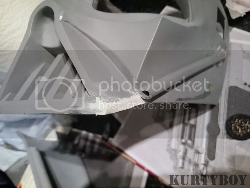

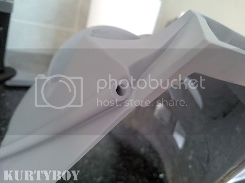

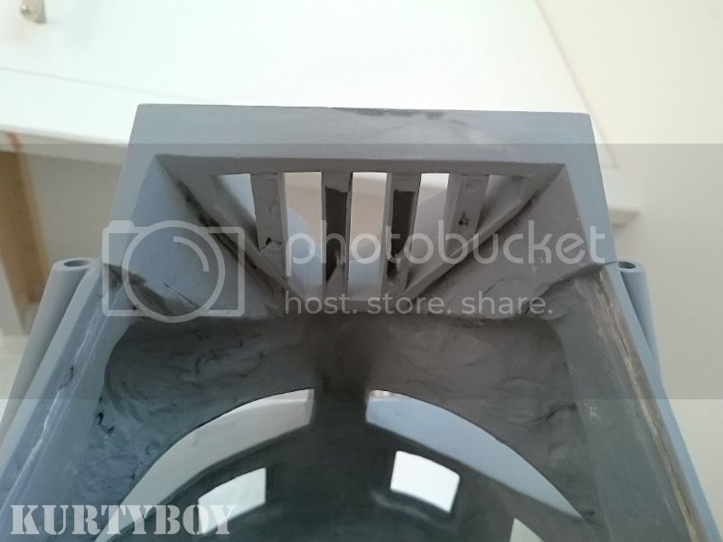

Kurtyboy's new Vader Reveal project. 30 June 2016 - Fixing some stuff

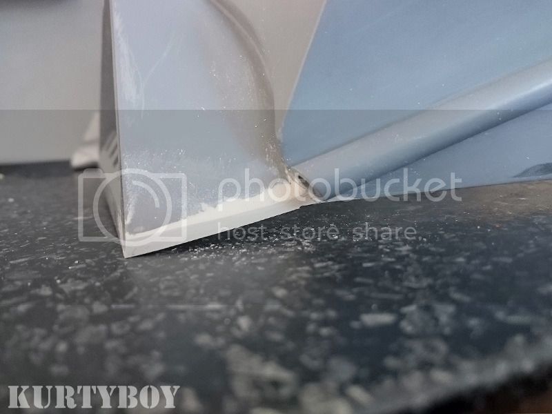

Still had a big gap at the left side of the mouth which I can't believe I had let go before.
A bit of filling and reshaping.
Much better.

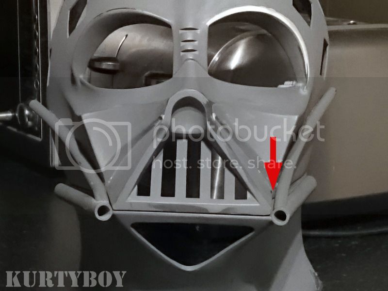

Also had some help from Gonk27 to get the two asymmetrical sides looking right. The area where the tube meets the mouth is completely different on both sides.

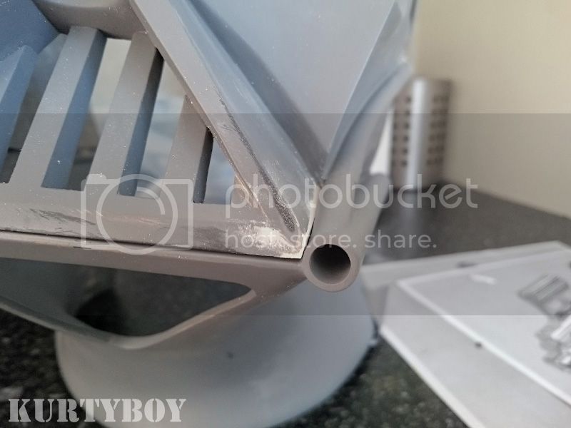

Wasn't happy with the way the tubes lined up on the left side.
Re-did that side.
Much better!
Still got to refine the back ends of the upper tubes, then it's onto the crown redux.

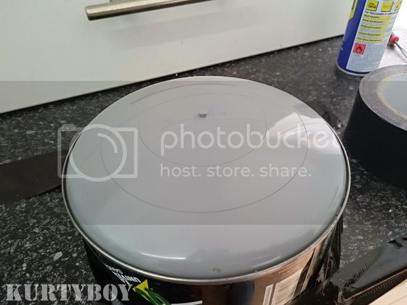

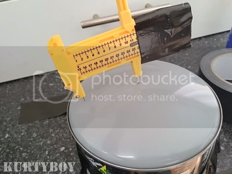

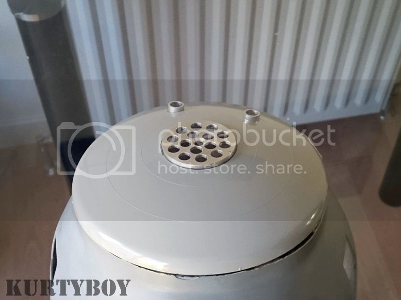

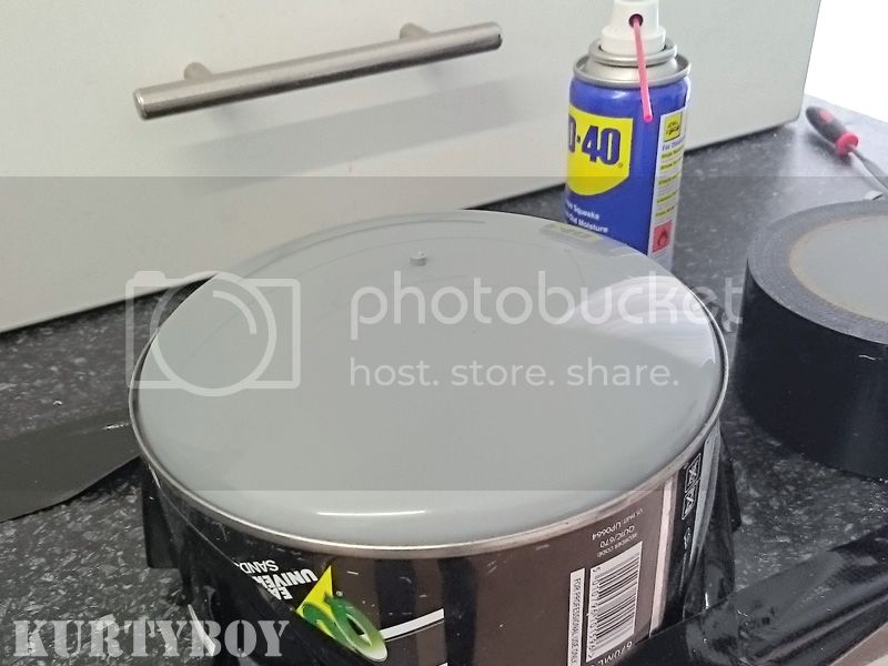

Got the new crown done today. I came up with a near fool-proof method of etching the lines which was a bit of hit and miss last time I did it.
The crown is a perfect fit into the underside of Upol Quicksand filler (probably other brands as well). I taped the tin down so it's nice and steady and used a bit of WD40 around the edge so the crown spins freely with little resistance.
Now using the circle cutter (which I taped up to prevent the scale from moving) it's easy to etch a nice even ring. Hold the cutter firmly in one hand and rotate the crown with the other hand. You should practice first on a scrap piece of similar plastic so you know how much pressure to appy. I had three of these in case I messed up but it was perfect first time.
I then drilled/dremelled out the holes.
